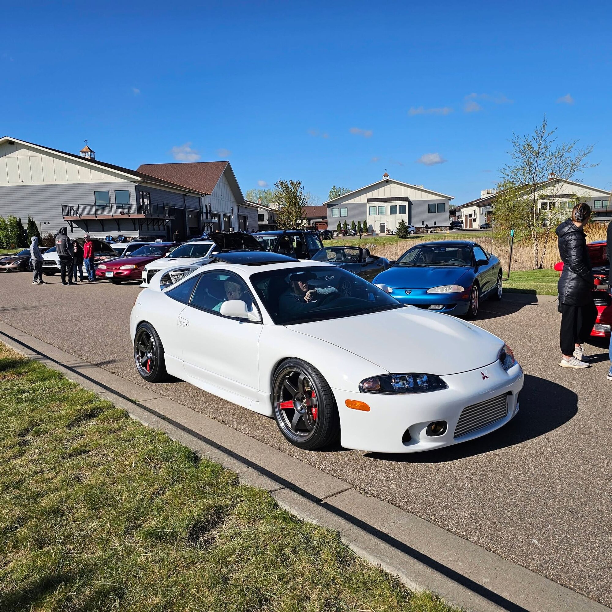

This is the ongoing build of my 99 Northstar White GSX.
Spring detail complete!
Ready to get some more miles on this thing this summer.

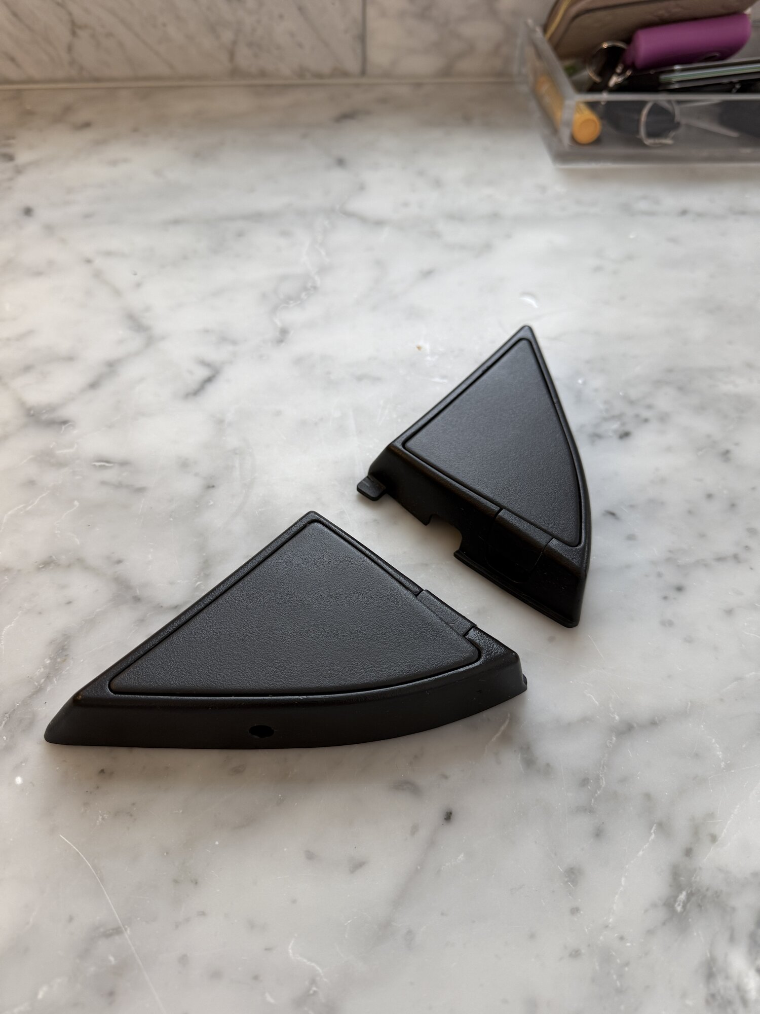

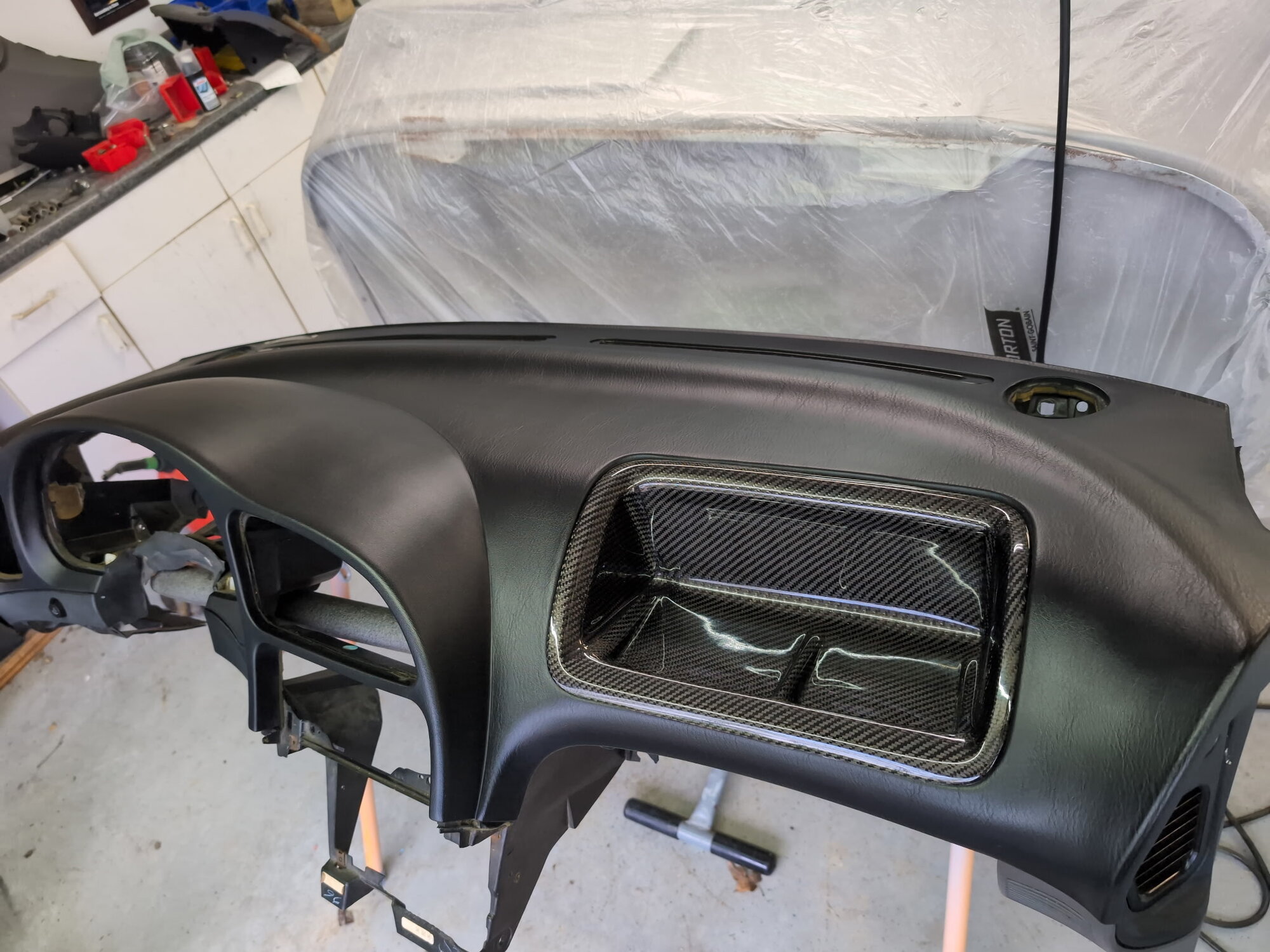

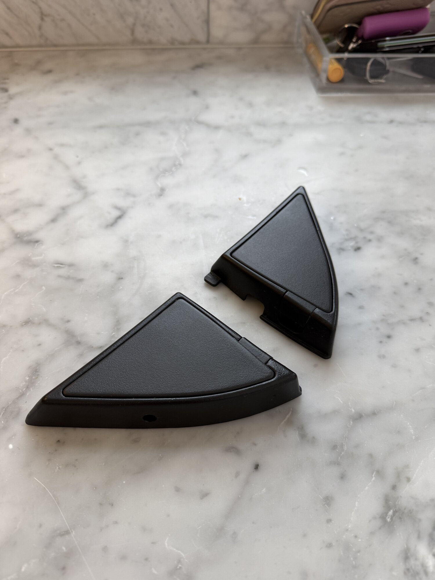

Oh man where did you find those? I just finished restoring/painting and assembling mine. Now it's find mint parts to keep upgrading.
I found them from a local part out in Minnesota, but I actually wont' be using them as it turns out my original ones are in slightly better shape haha.
Nice find! They looked real good and thought they were the reporduced ones.
Well if you want to part with them and ship. I'm your man. I just finished restoring the dash and I really only need a few upgrades to make the interior mint. And that's pretty much it. She is like a new car again. Well... Resto mod car anyhow...

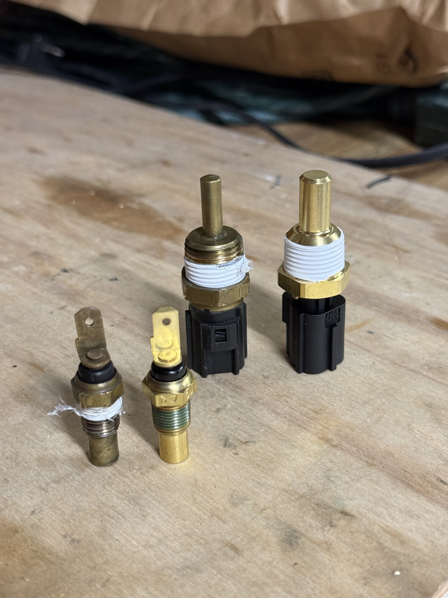

I have been having some weird cooling issues. Link is reading sporadic temps near 220, kicking the fan relay on/off rapidly. This is while its 65 and cloudy driving on the freeway.
I honestly cannot remember how old these coolant sensors are, so I just went ahead and got new ones. Mine may honestly be original... No idea.
I also changed from 50/50 mix to 70/30 distilled / coolant with a bottle of water wetter. Hopefully these things show improvement.
I also went to a local show, getting close to 750 miles on the build!
