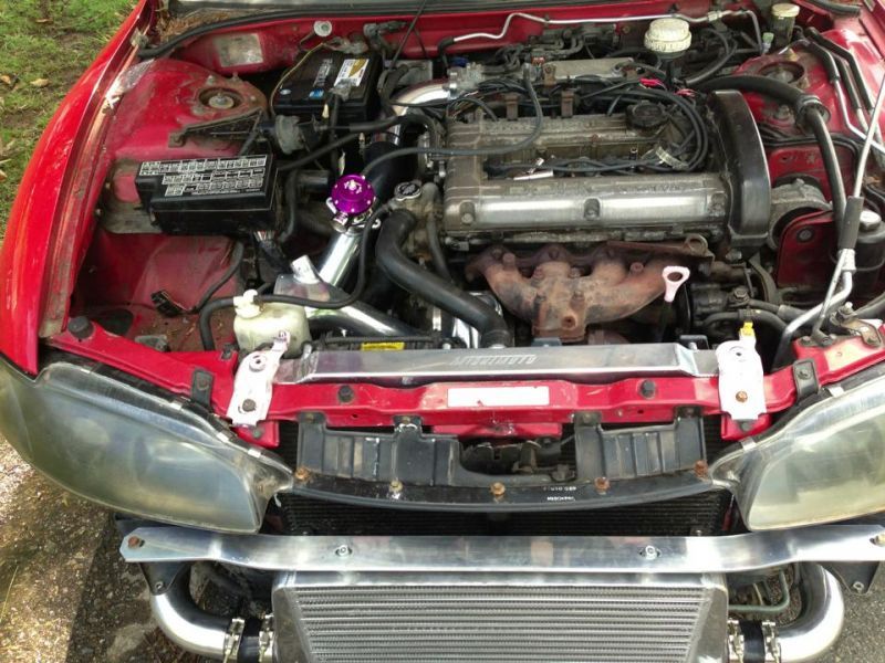

Wooh Whoo! Time does fly by! It's almost the 1 year Anniversary of my DSM owner ship! it has been a stressful year with this car but I wouldn't have it any other way, what work I put in with the DSM she gives back a 1000x more. So the last update I said I was getting was a new bumprer, some gaskets, cluster and some more. Happy to say I got all that and more.
I am happy with this car. It has brought me so much joy ever since I got it. I've learned many things about it and cars in genereal. I am glad that I know YOU guys here and a friend of mine who knows about DSM's as well. I cannot thank you enough for all that you have helped me with! so again THANK YOU! :D
alot has changed in a year. I'm trying to get this engine bay somewhat looking good.
The rebirth build has been coming along nicely. She runs and doesn't have any to know problems. excepts a few little inconviences here and there and some mismatched color but she is happy to be running.
She is my Daily Driver and I have made a clear conscious decision too get as many HP as I can while she still being my daily. (Till I can save up for some beater) I have been install 880 PTE inj. Newly acquired V3 ECU and speed Density set up is gonna be set up hopefully this saturday or sunday. AEM wideband is also ready to get installed. once everything is installed. My buddy will do a good tune, after that process is done we should be decided on where to go next in the build. Baby Steps!

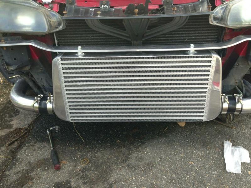

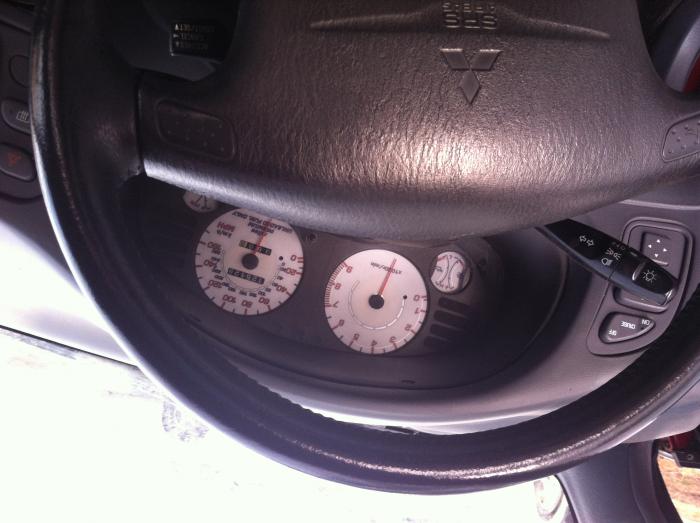

So I had successfully waited for my new Front-Mount-Intercooler, to say i was happy is an understatement! So we installed the Intercooler, and also a new Instrument Cluster, put new gasket's on and long behold upon initial start up the leaks were non-exsistent (For the moment) ,and the car ran like it had NO problem in the world. a few little problems did happen though...The Cluster is still not reading the Speedo, nor is it reading the gas gauge, NOW it's not even reading my Oil Pressure, everything else though is golden.

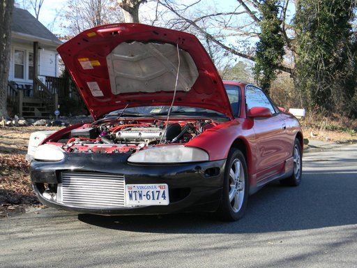

May want to turn some of those pictures around so they're right side up ;) Looks like you saved it from death. Good job... ( :sosad: But that fast/furious bumper should be left off it ;) Just saying...)
Also, since your speedometer isn't functioning with either gauge cluster, you may want to look into replacing the VSS on the transmission. You can also test the fuel gauge if you have a multimeter. I'll look for the post I was shown to help me with that issue and post you the link to save you some time.
Here you go, If you haven't fixed this since you originally posted it. Didn't see the date at first. http://www.dsmtuners.com/forums/mai...ry-fuel-gauge-not-accurate.html#post153350386
The Speedo has been fixed LOL sorry I forgot to mention. The only things that DO NOT work on the gauge cluster are the Fuel gauge and the Oil pressure gauge. I will look into the link your showing me for the fuel and I think I'll just also get a oil pressure gauge as well. I've been putting a lot of gas into her and only able to go short distance before she up and has the fuel light turn on. We figured that problem out last Saturday as the front 02 sensor (stock) is not good anymore ( below 0.2 v ) so where gonna hook up the wideband o2 sensor in the front this Saturday and run the wideband through their. I'm using 30% percent more fuel then I should be LOL. The Black bumper is the ORIGINAL BUMPER. The last one I had on was the tacky aftermarket but I took it off and put the black one on. Once i can find the side panels to the GST I will get her painted and have her in one original color.
