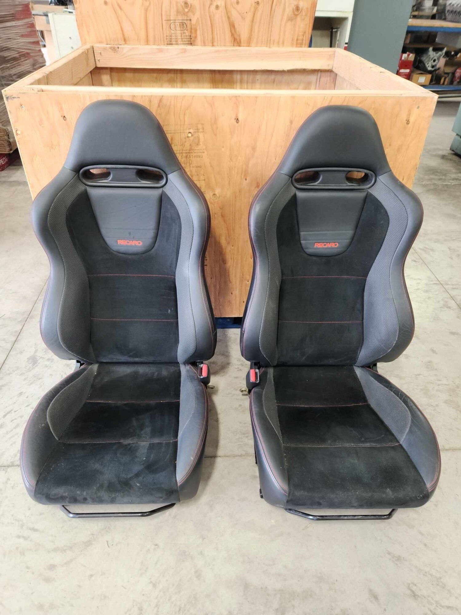

I also picked up some mint Evo 9 SE Recaro's with the red stitching. Can't wait to get back in some of these. I missed these a ton since selling my Evo.
Nice seats!

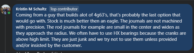

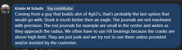

Seems everyone I've talked to within the last year said Eagle's are junk anyways... They are out of stock on extreme and everywhere else btw. 6 bolt stock stroke*.
I told them to find an OEM if they can, if not, I'll get a callies.
I ran an Eagle 100mm crank in my car for 5 years. Never had an issue. But yeah. See what you can do. I have a crank sitting here but it would probably need a cut.
Finding an oem uncut and good is getting tough! I was side skip oem and go straight to a callie forged and be done. You can custom it to i believe as i nearly went with theirs before molnars crank. I wanted a light crank so molnar was the second lightest and also cheaper then winberg which is over 3k LOL out of budget
That’s wild. He definitely knows better. Guess I got lucky.
Ok I’ll ask. Who is Devin?
I assume my OEM crank has never been cut, not 100% sure though. Original owner only ever had the head redone I think. I wanted a forged crank and wanted a Manley, but 6-bolt was no longer avail so jumped on the Eagle one Xmas shopping spree. FML
