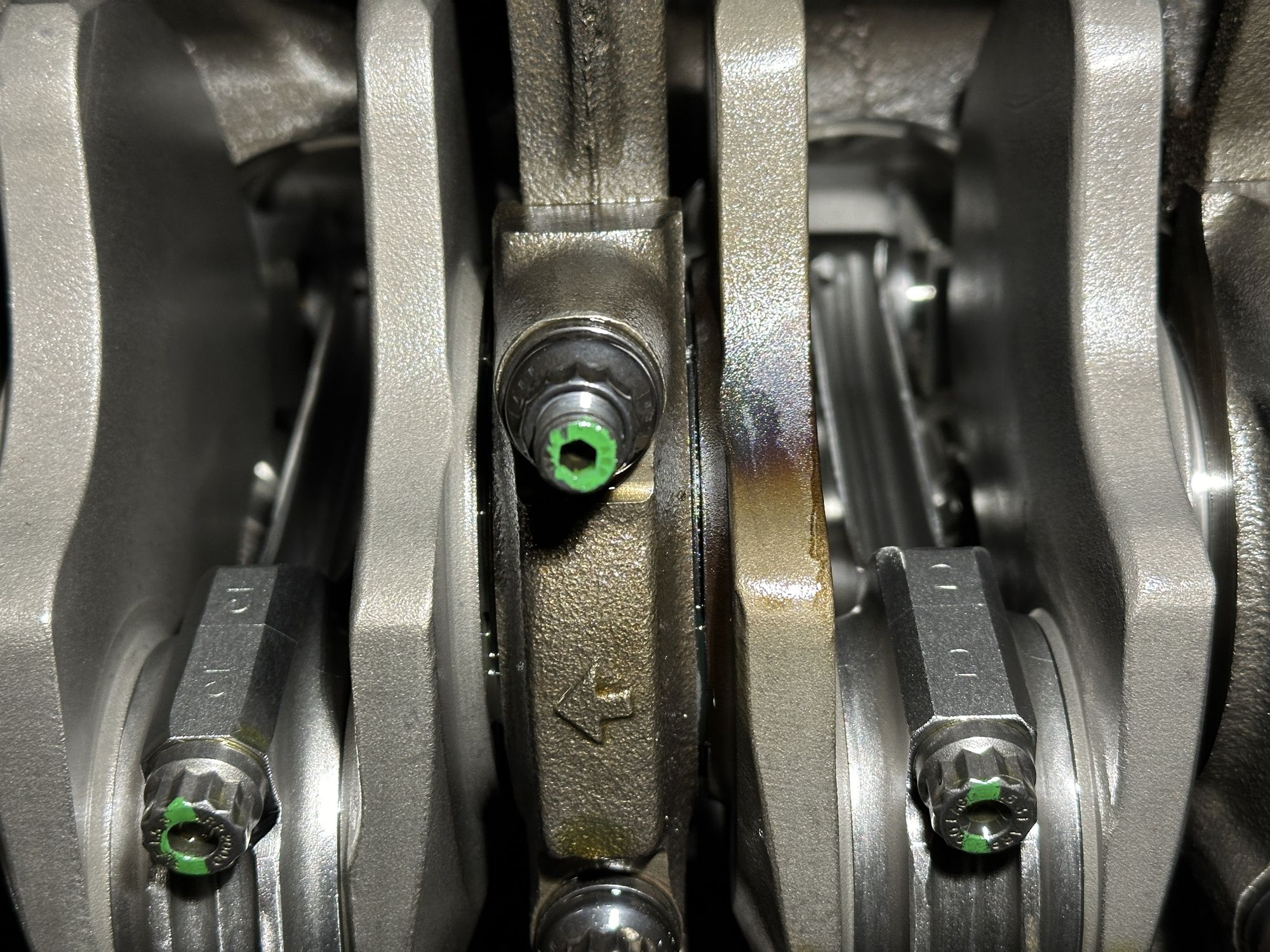

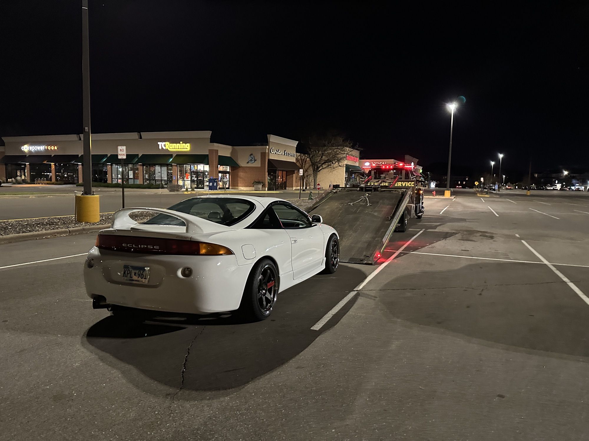

I was just getting a half tank of gas, pulled out, and engine completely seized up.
View attachment 712964Untitled by bradydings, on Flickr
View attachment 712965Untitled by bradydings, on Flickr
At this point, I believe the oil pump seized.. TBD.

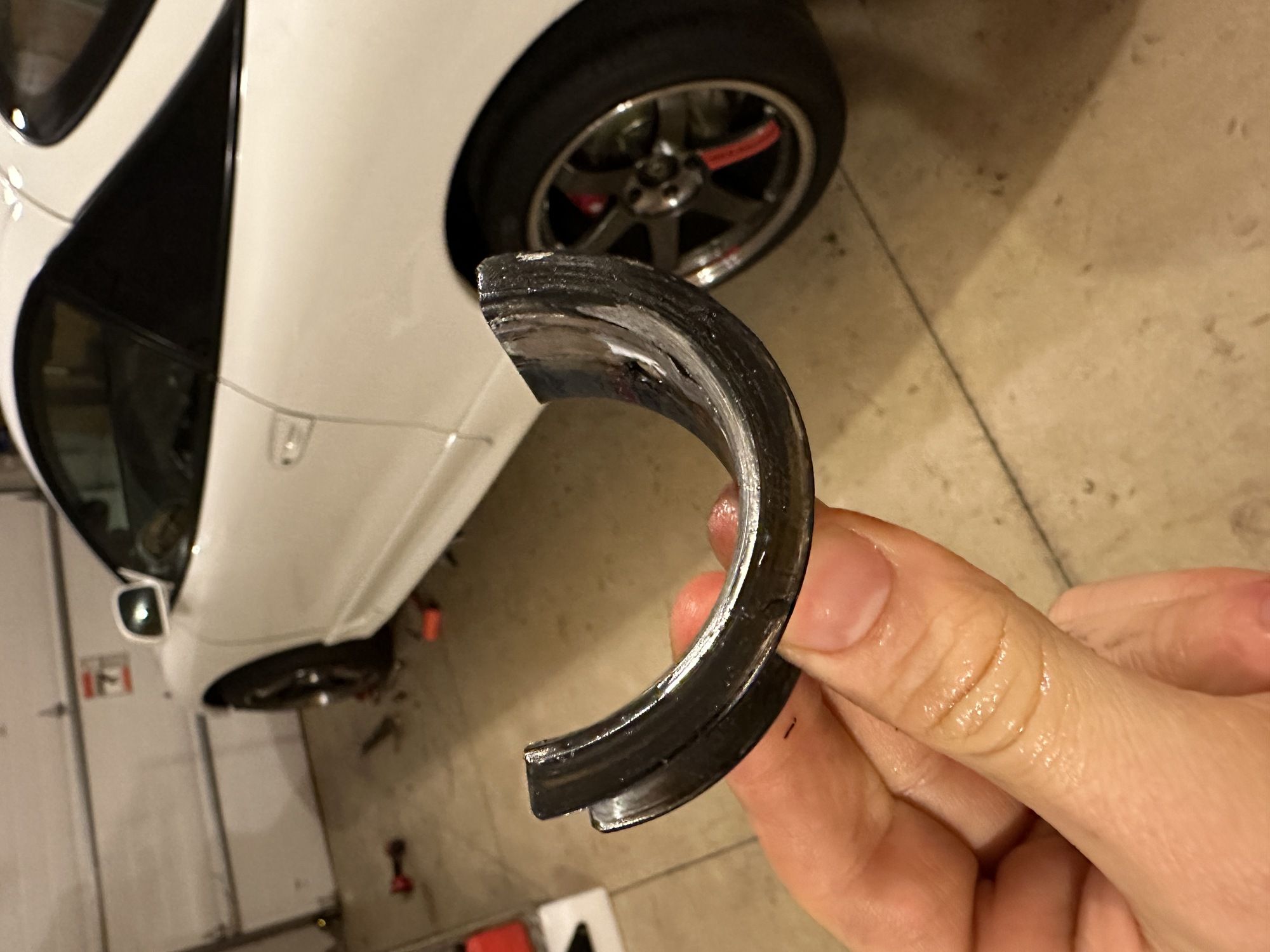

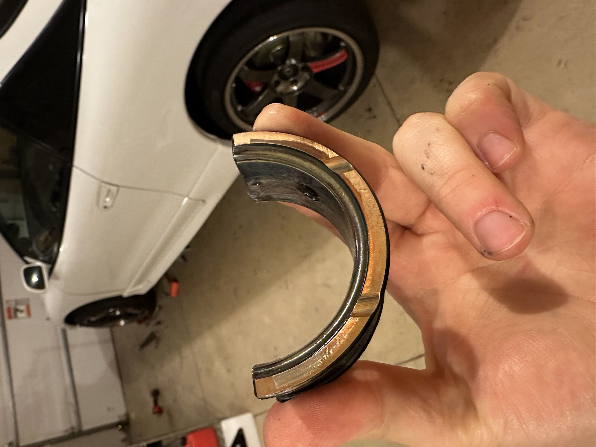

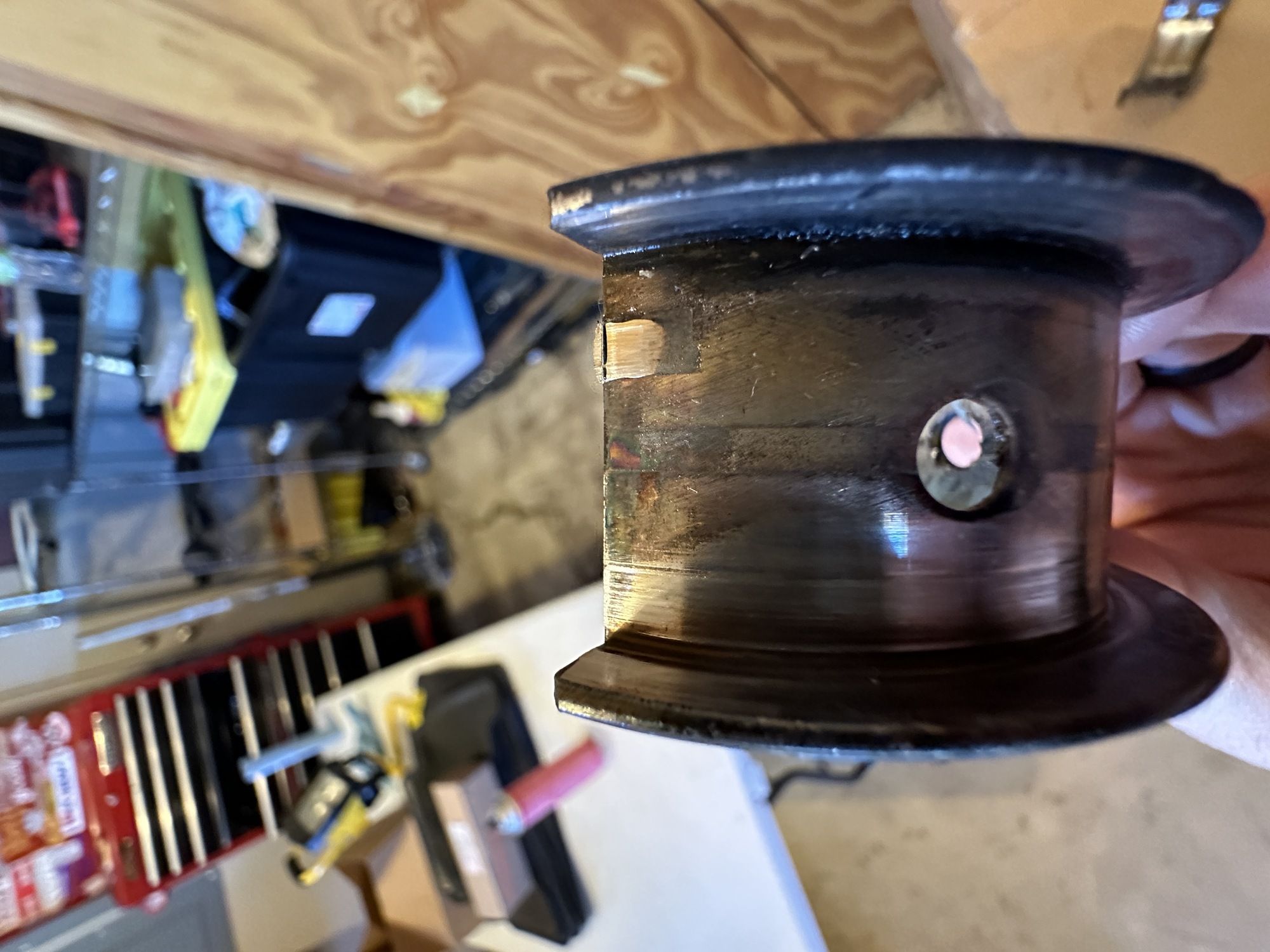

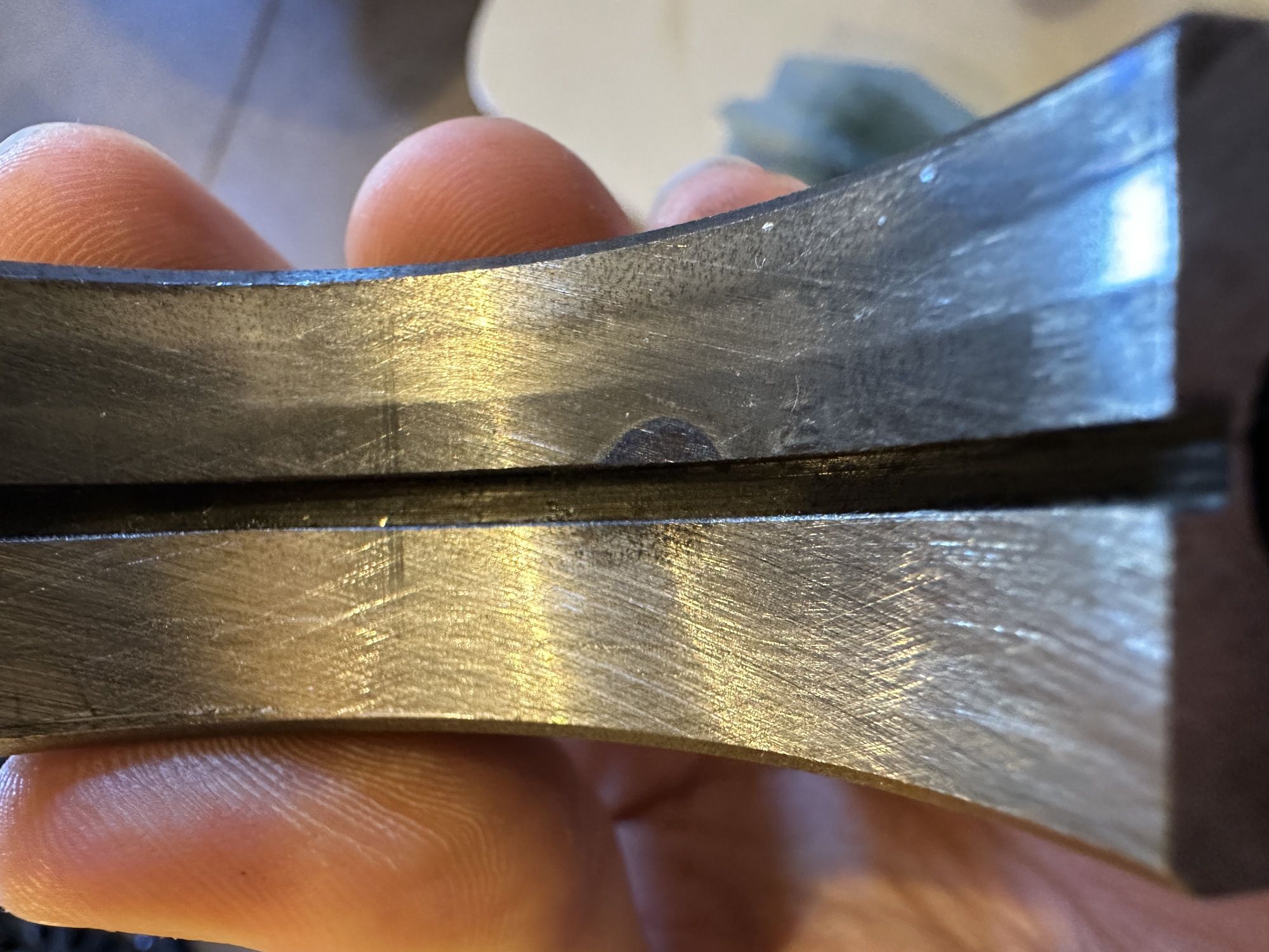

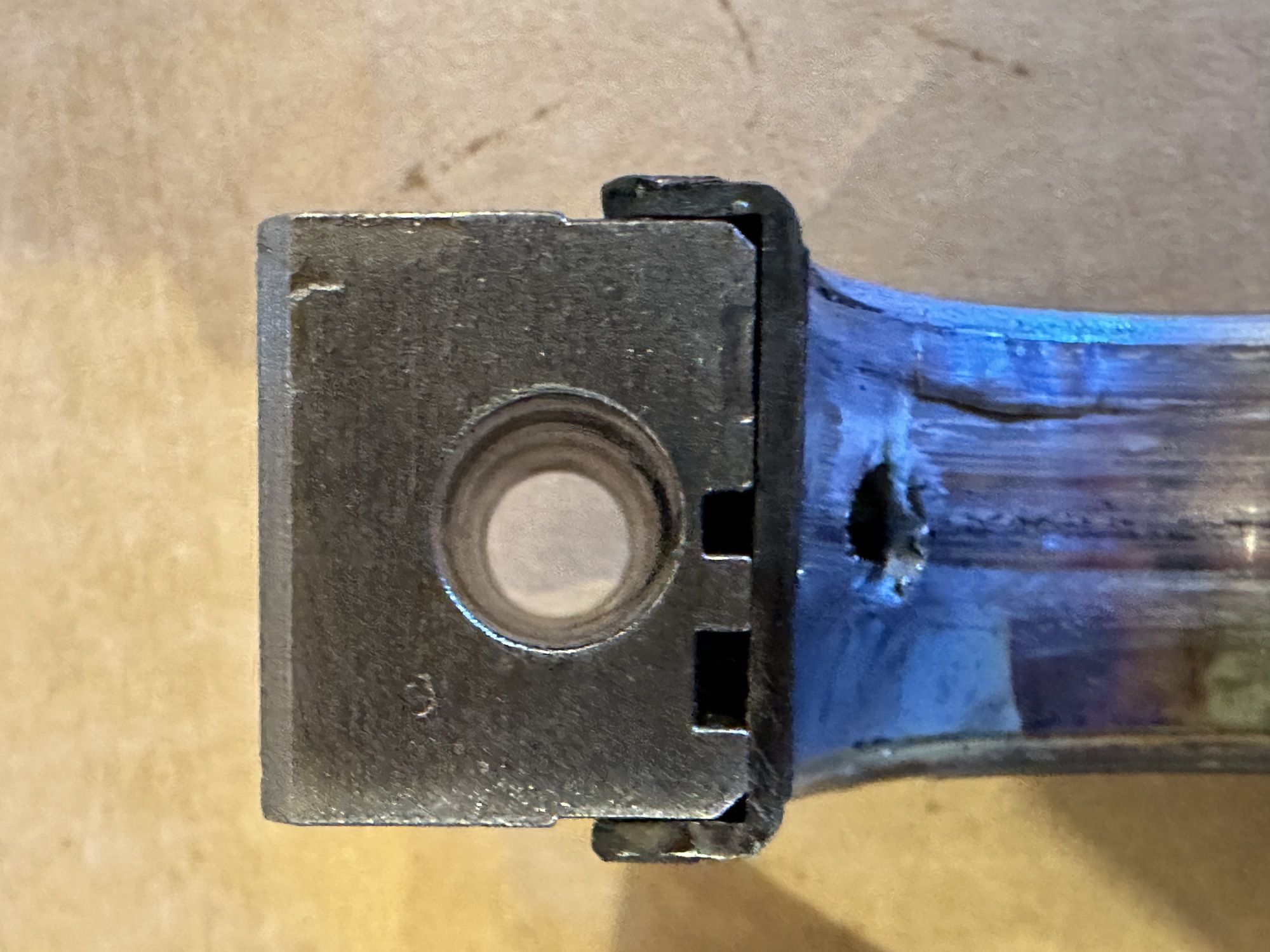

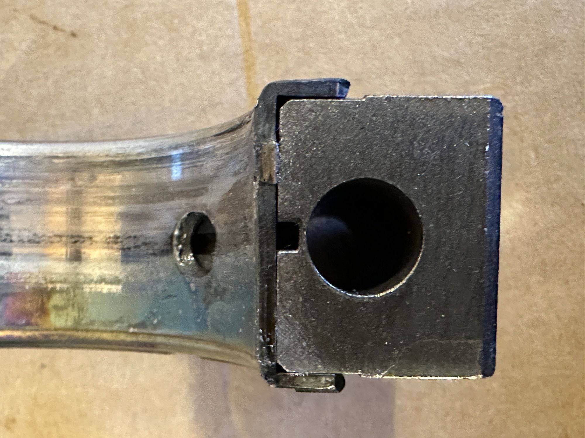

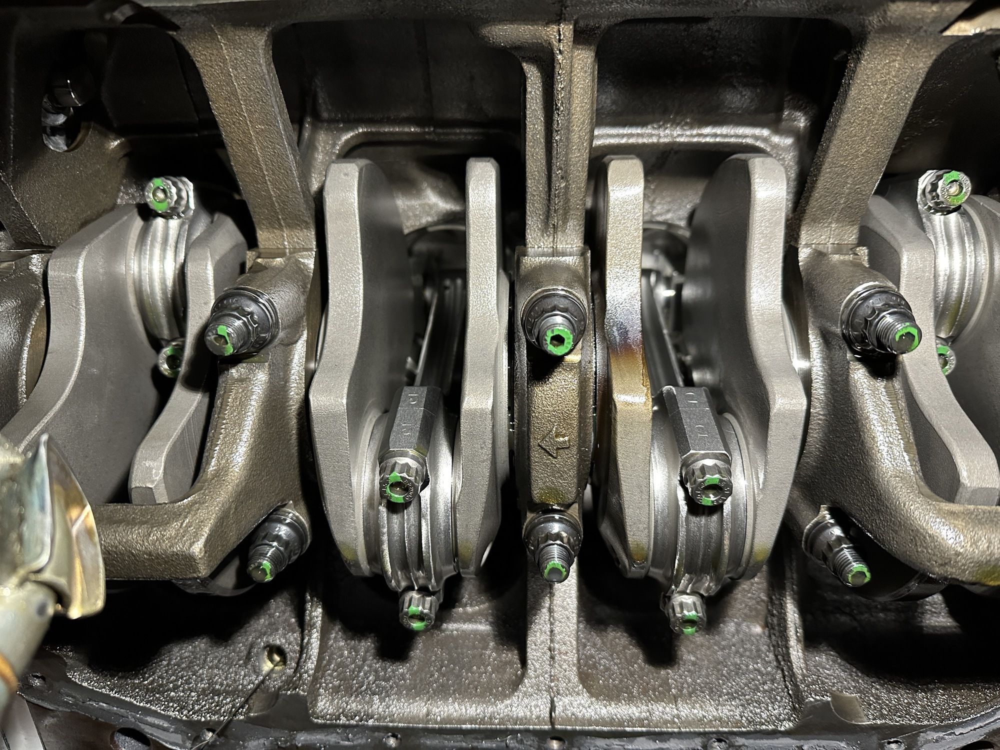

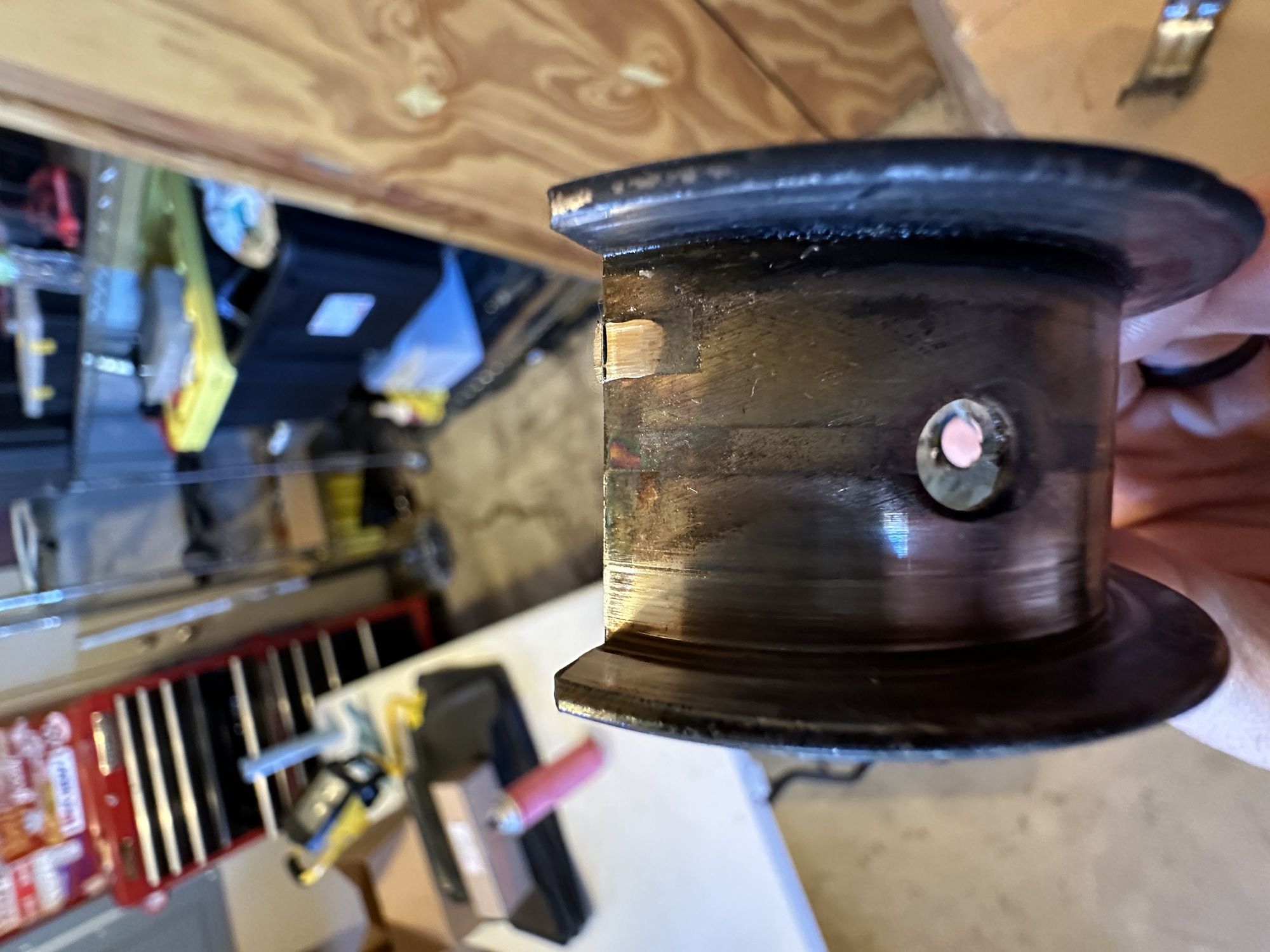

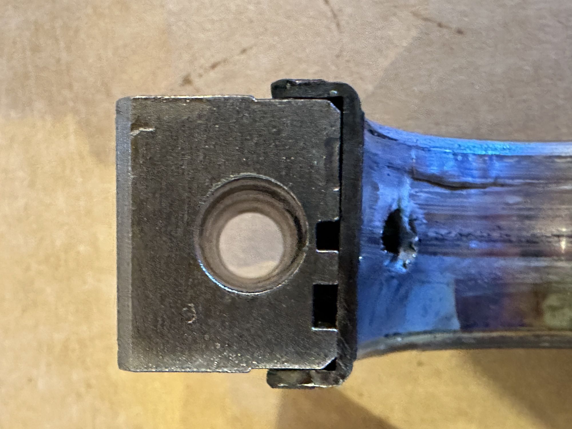

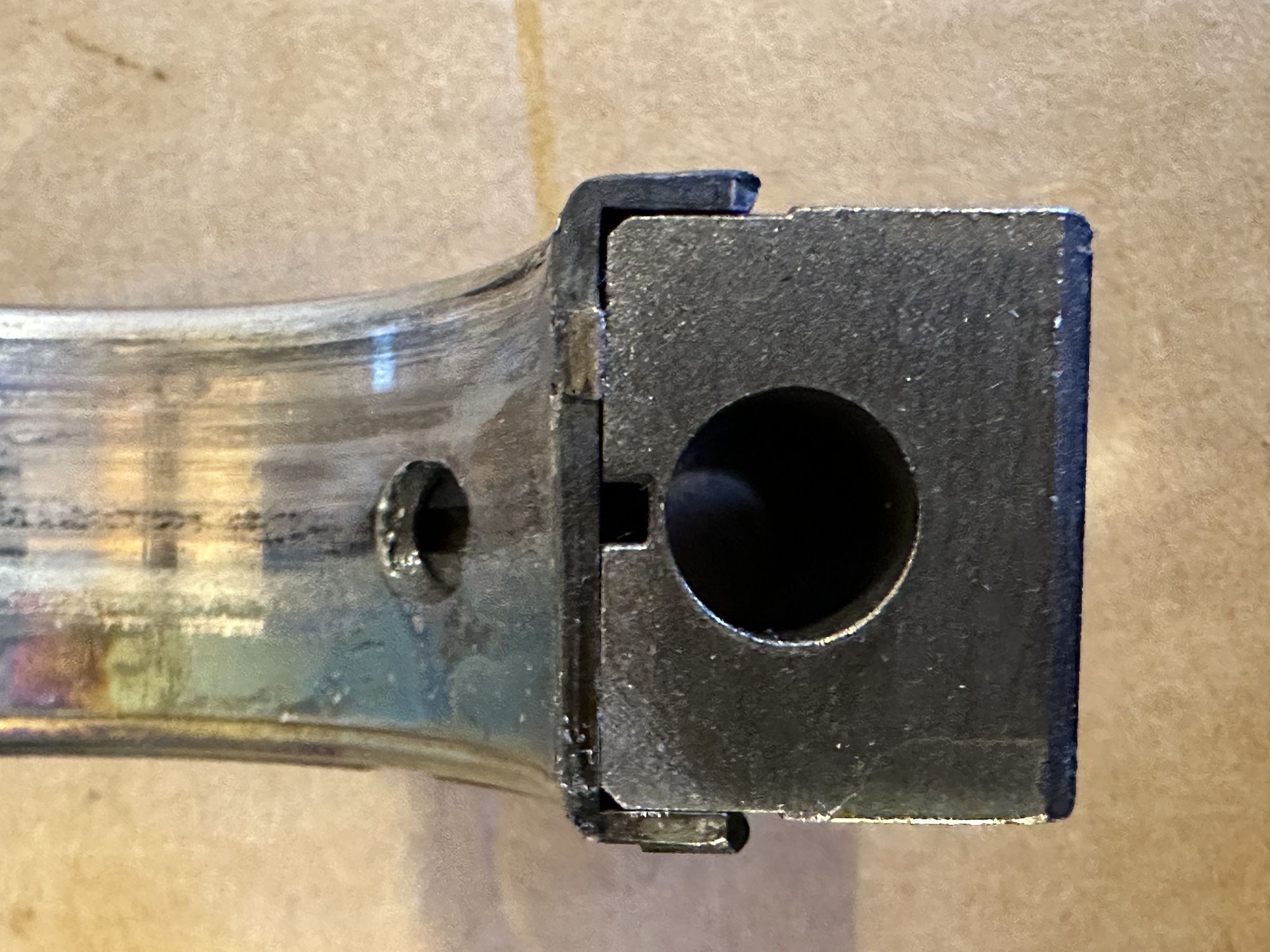

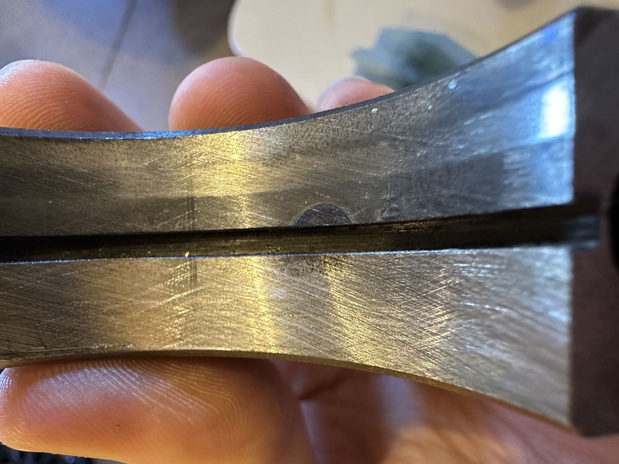

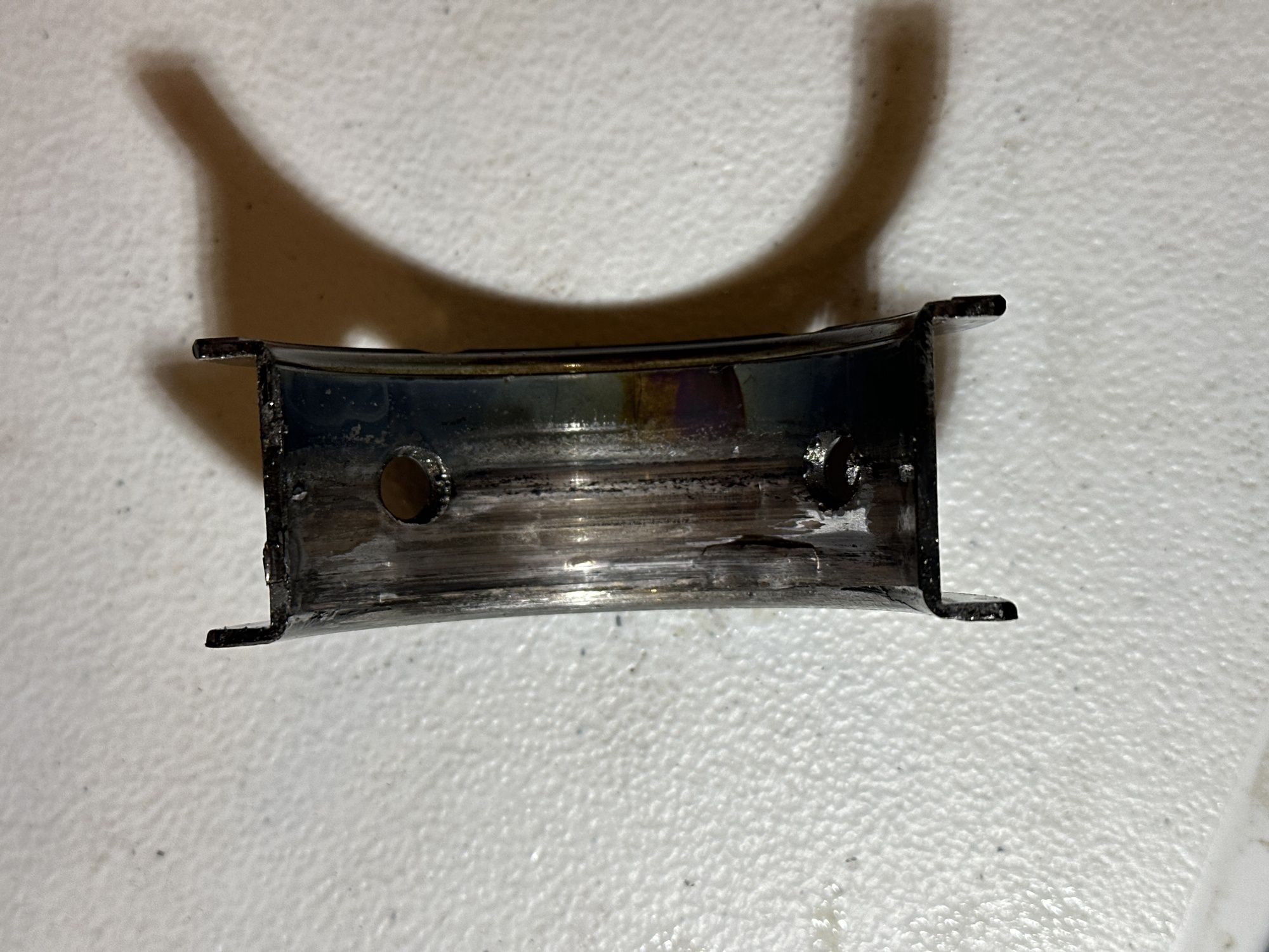

Pulled the pan, pretty unfortunate. Clearly blew through the thrust surface of the bearing, then continued to absolutely torch the bearing until it spun, then seized the crank.
Open to ideas as to what could have caused this in 3 miles of driving, and idle time in the garage with plenty of oil pressure, and engine was primed before starting up.

Damn man perhaps some material in there or possibly tolerance issue when assembled. I see that you are very thorough though. You definitely need to see what caused it or you are gonna have to do it again maybe
Congrats on the baby! I couldn't get any work done for like 2 years when my daughter was born Iol. Luckily she's in kindergarten now, it goes fast!
That HAS to be build error or maybe a defective part. Either way it should be on your builder imo. Good luck with it
Whats kind of kicking around in my brain is something along the lines of not properly refinishing that journal on the crank or the incorrect size bearing was installed. also, take a look at the oil galley in the crank, is there any debris in there? maybe it got clogged. just my 2 cents on it
how often do you start this motor? could it be from sitting for long periods of time and its to dry each time and eventually wore out? Check things like the pickup is not blocked if anyone used RTV instead of the gasket.
just one of the ideas but the trust loading should of been checked ( end play ) and noted down to you in the build.
Sure looks like an incorrect finish/champher on the crank journal. End play measurement, or the lack thereof would've been a dead giveaway something was wrong...when there most likely was zero.
