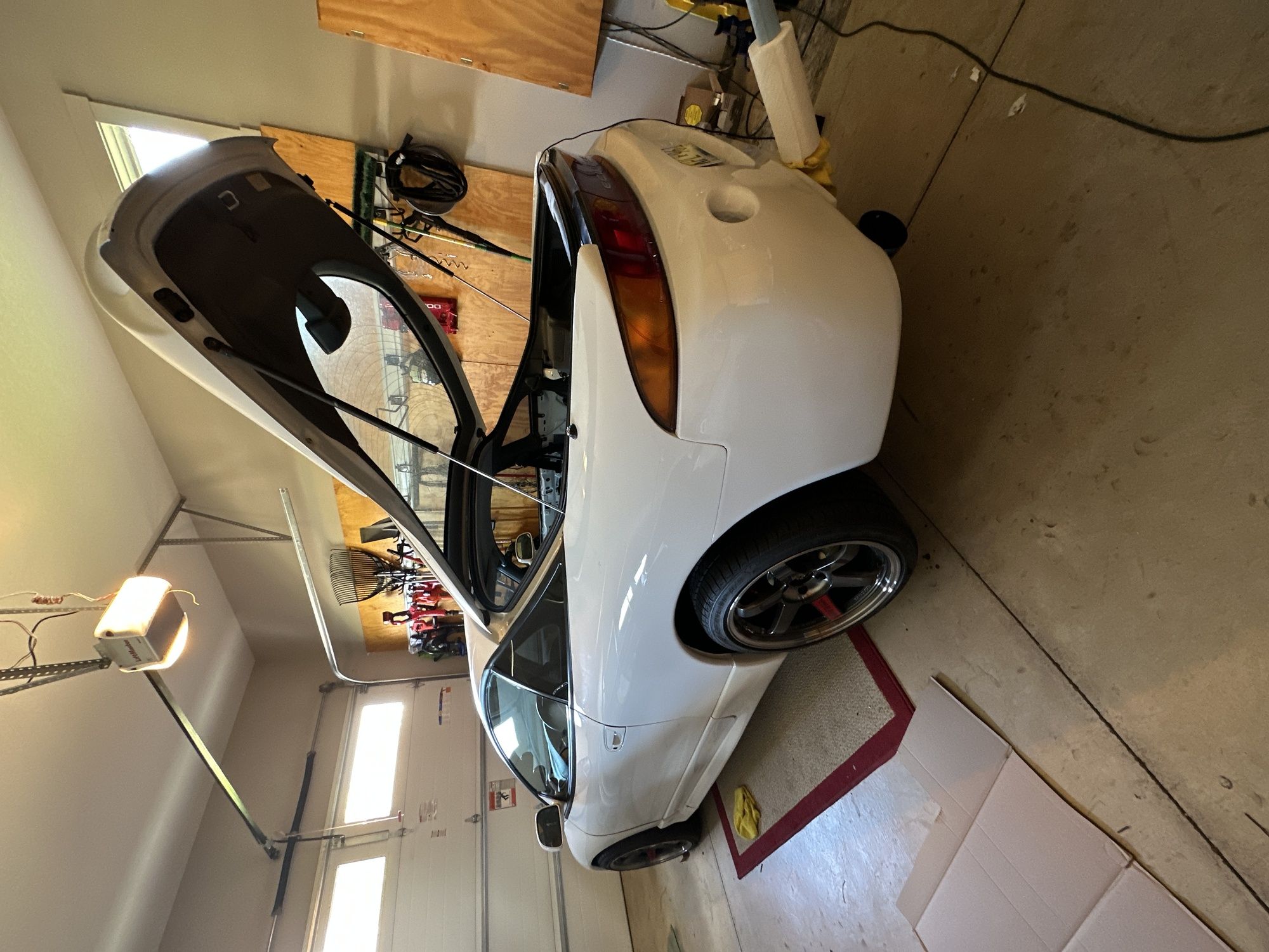

I did also pull the car out of the garage into the driveway so I could do a deep clean of the garage.

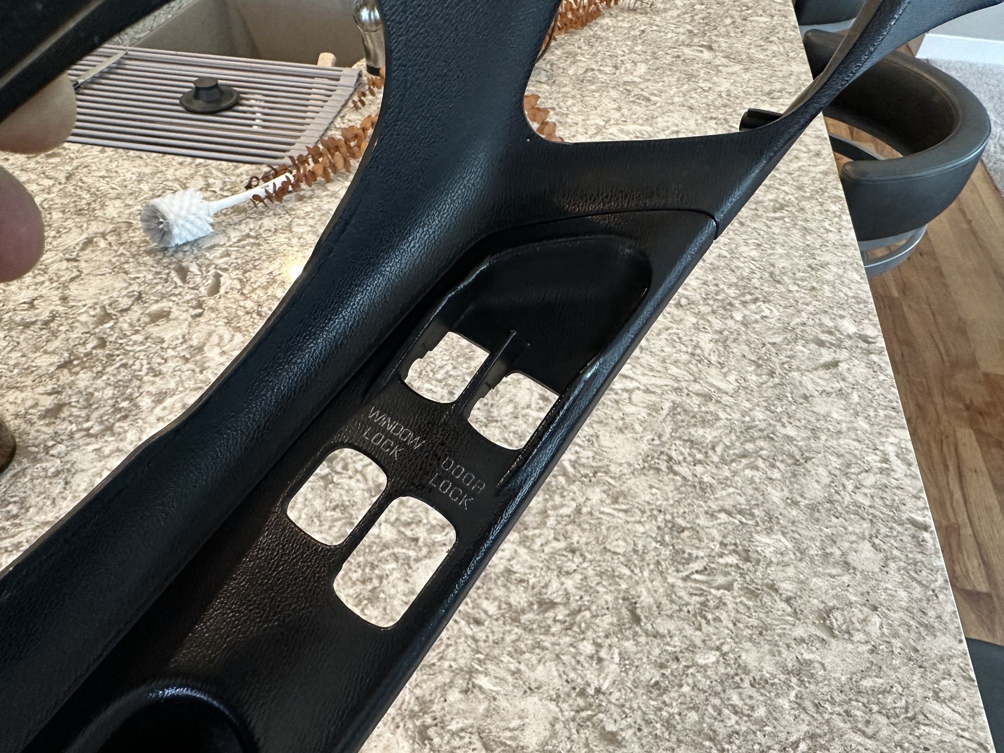

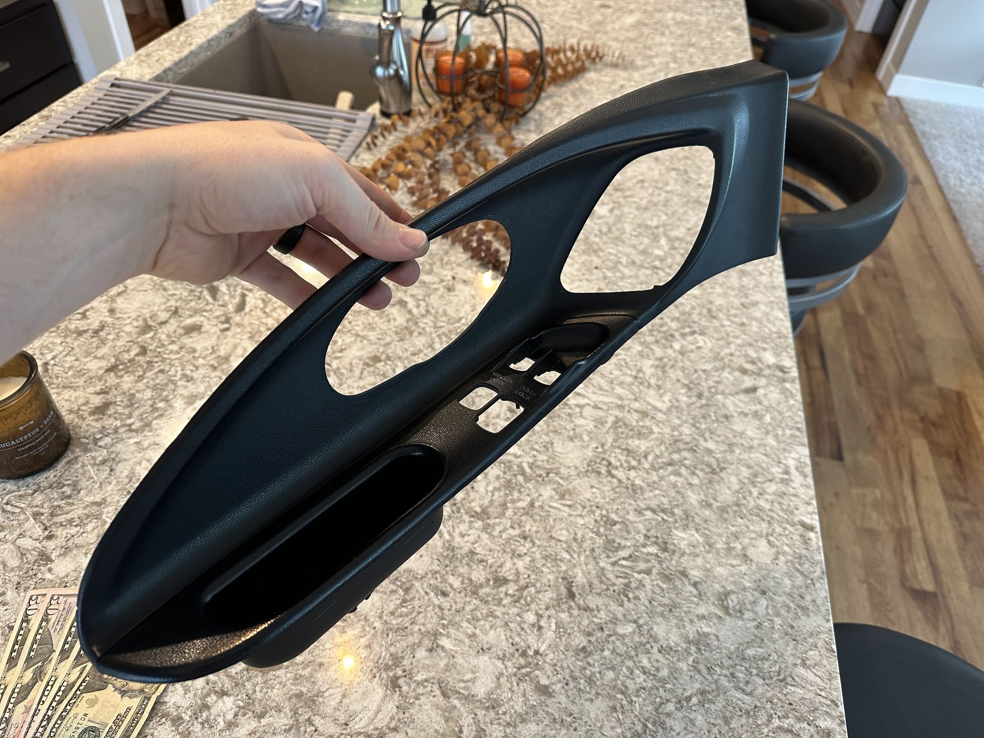

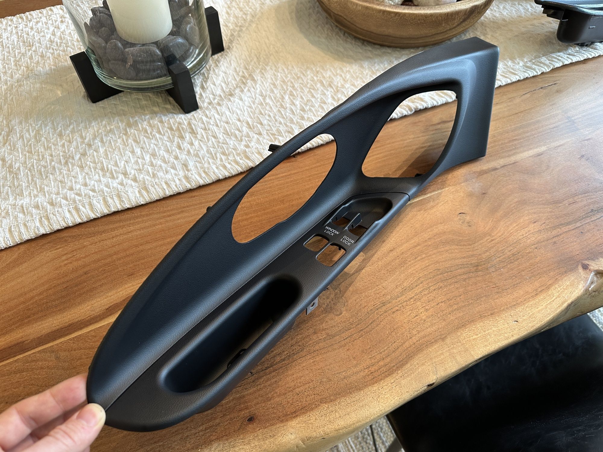

A side project I was working on was getting a drivers side switch bezel that wasn't broken. I unfortunately used too long of screws for the switches like many others have done and hated seeing the little bumps.
I managed to find this one which was basically perfect other than just surface wear over the years. Which I'm super happy with. It matches the passenger one, and is not broken at all.
Untitled by bradydings, on Flickr
I made a lot of posts about this piece on some classified pages and for whatever stroke of luck, someone posted they managed to find (9) NOS sets... So of course I bought one.
It is crazy how the brand new ones look matte. Just from people touching the interiors all the pieces get shiny from the wear and tear.
I'm not even going to use this, and may sell it in the future. It doesn't match anything inside. Unreal how this stupid little part that was $70 brand new from the dealership when these came out is so cool to look at, and really a shame that they stopped making parts for these so quickly after production.
