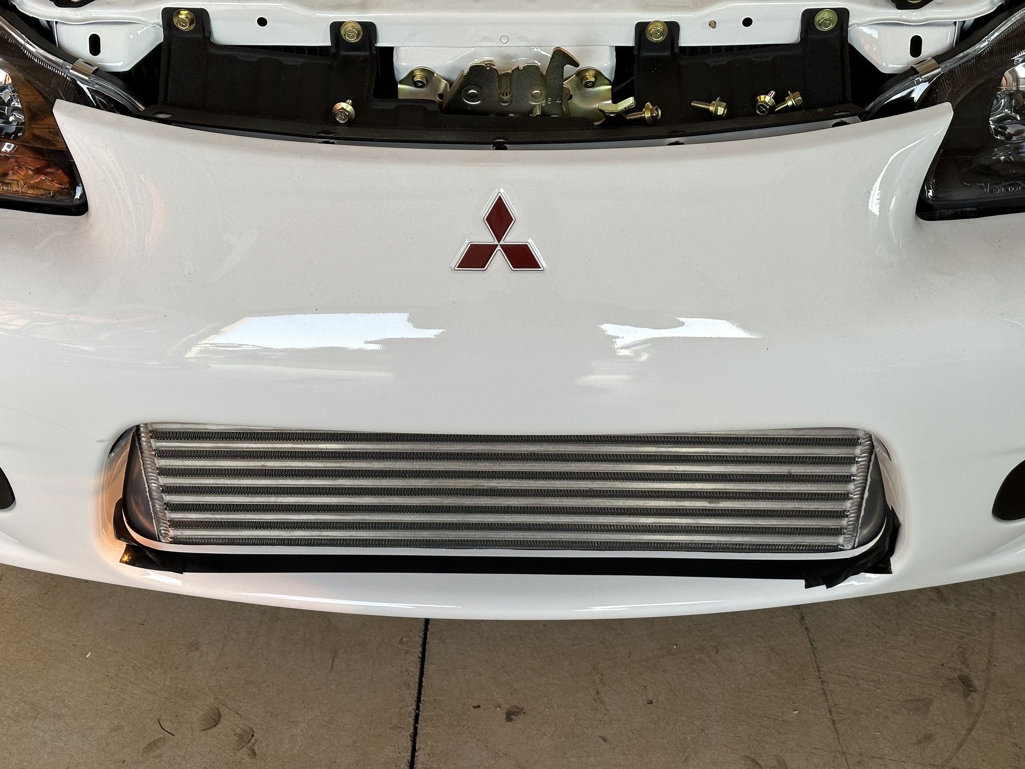

I failed to trim the bumper opening for the huge STM intercooler core, so I wanted to get that done so I could get the bumper to fit perfectly.
Untitled by bradydings, on Flickr
I feel like I trimmed a whole inch off this thing..
I have to trim the hood a bit where my valve cover fittings hit, the hood doesn't close all the way as it is. Kinda bummed, but that is my fault for not slimming the fittings down/doing research on best fitting placement.
View attachment 698960Untitled by bradydings, on Flickr
