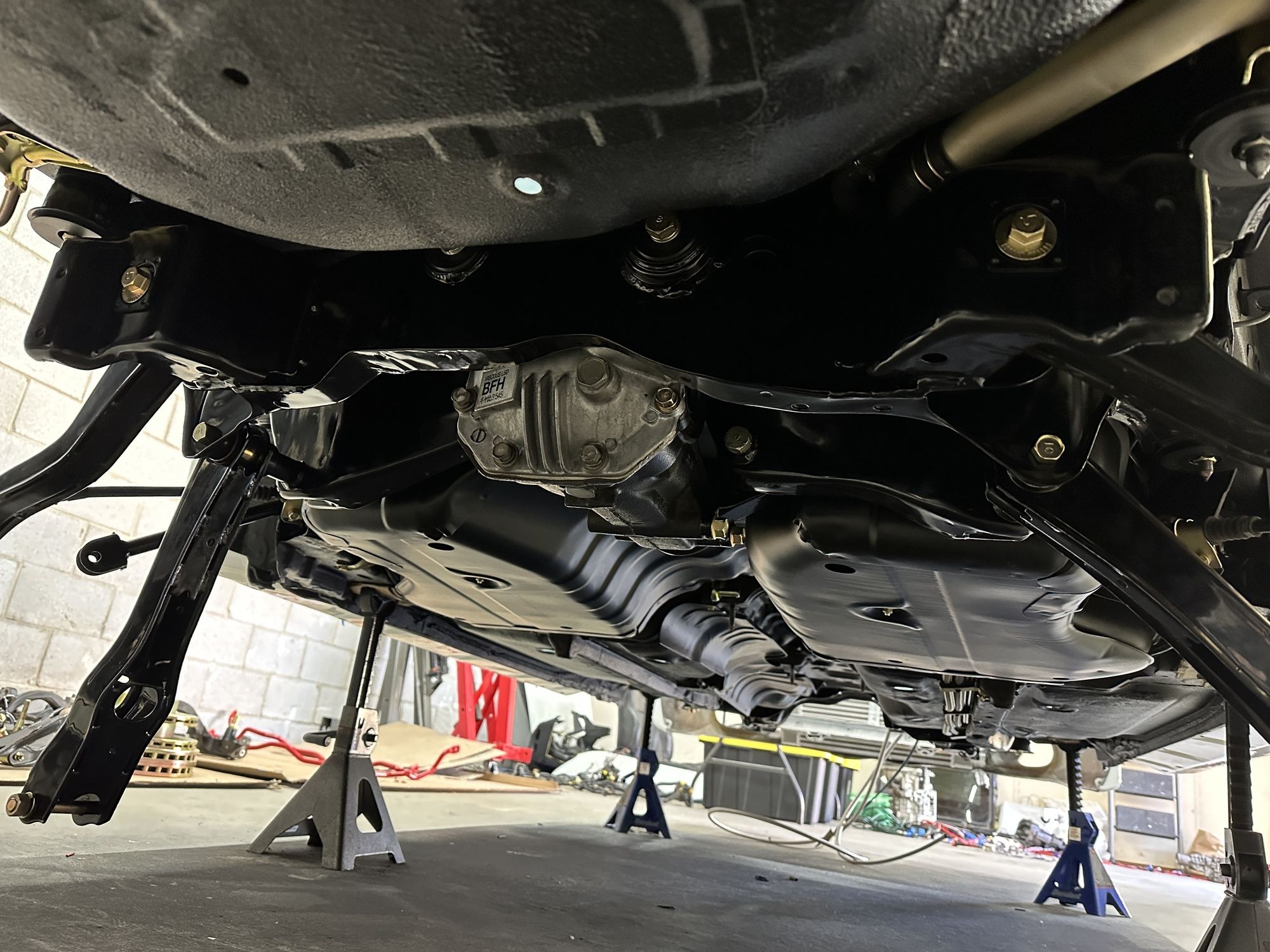

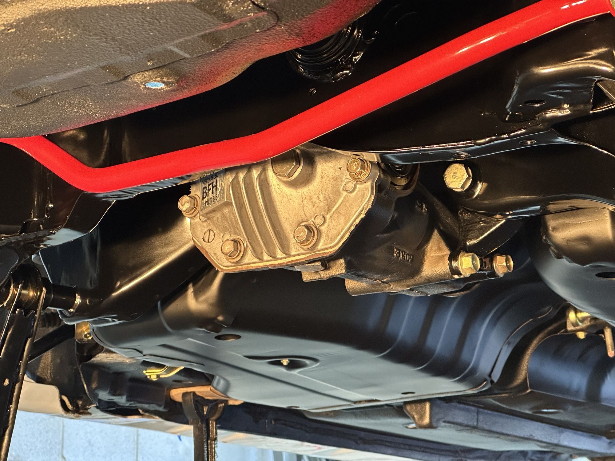

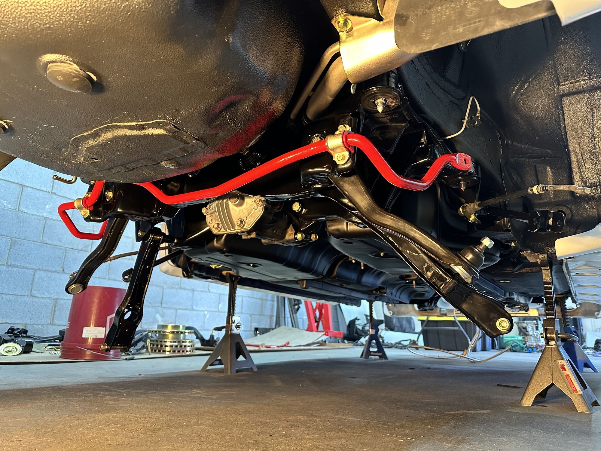

I got started buttoning up the rear end suspension. Diff installed, all control arms mounted. Subframe etc.
Untitled by bradydings, on Flickr
Can't wait to get this thing aligned and have the alignment guy crap himself with how clean this will be LOL.
Also, all the manuals say to have the car on the ground before doing torqueing everything to final spec. How does everyone reach the upper control arm thru-bolt with the car on the ground? Lol

place the car on the ground once the shocks and reset again. measure the hub centers to a bit of masking tape on the arch's and then jack it back up on stands again, then jack each wheel up to the same height and thats very close enough within 1-2 mm's and thats have you do that much easier
