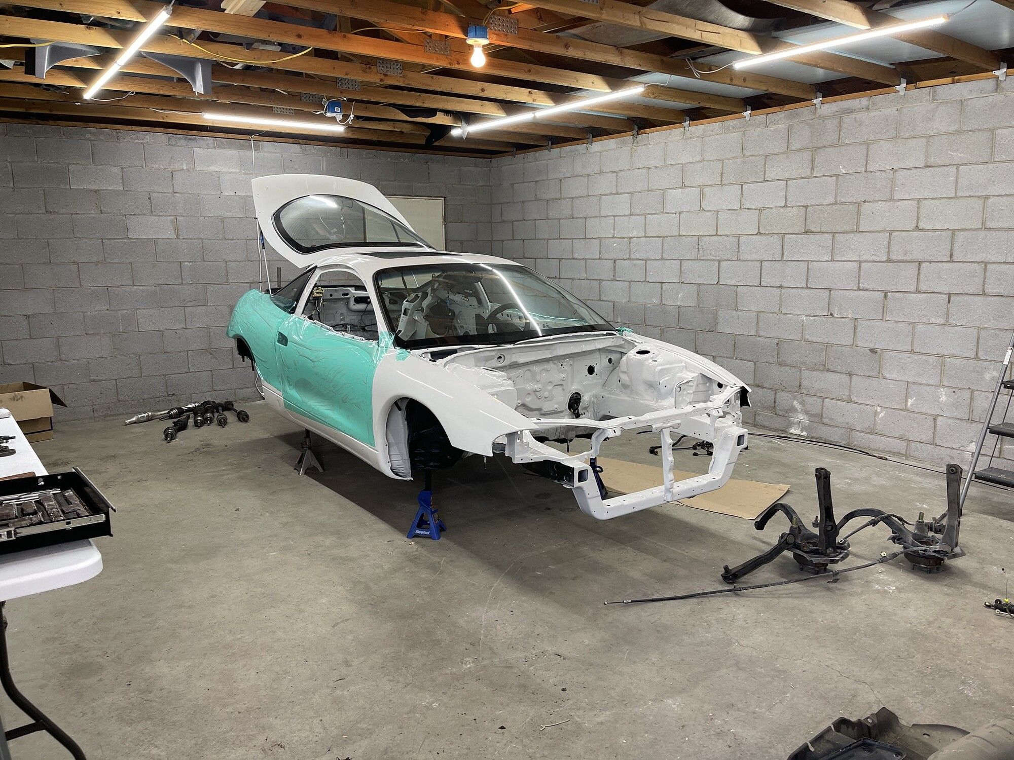

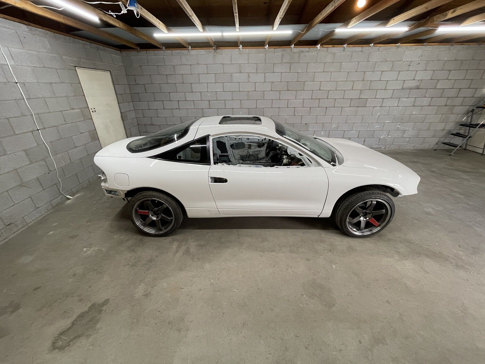

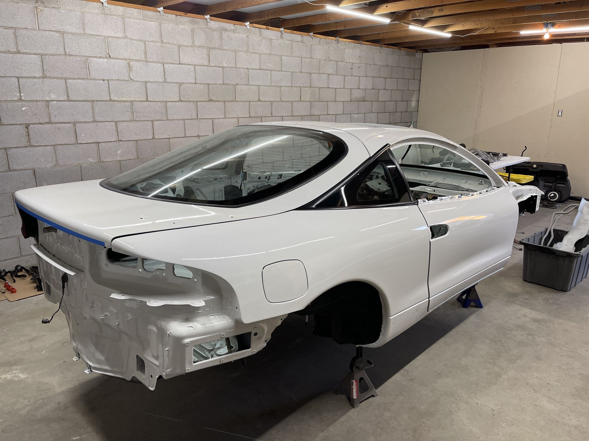

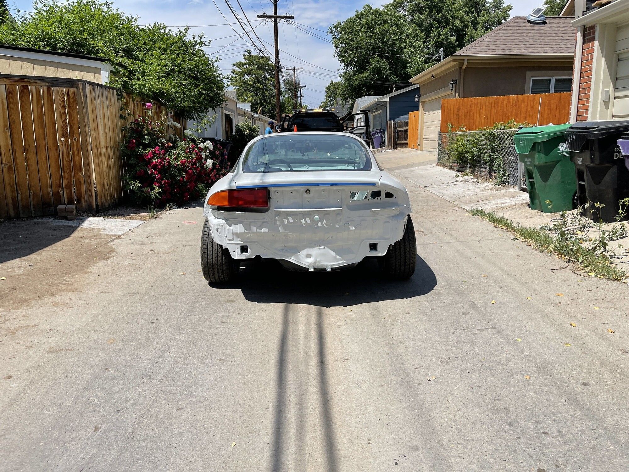

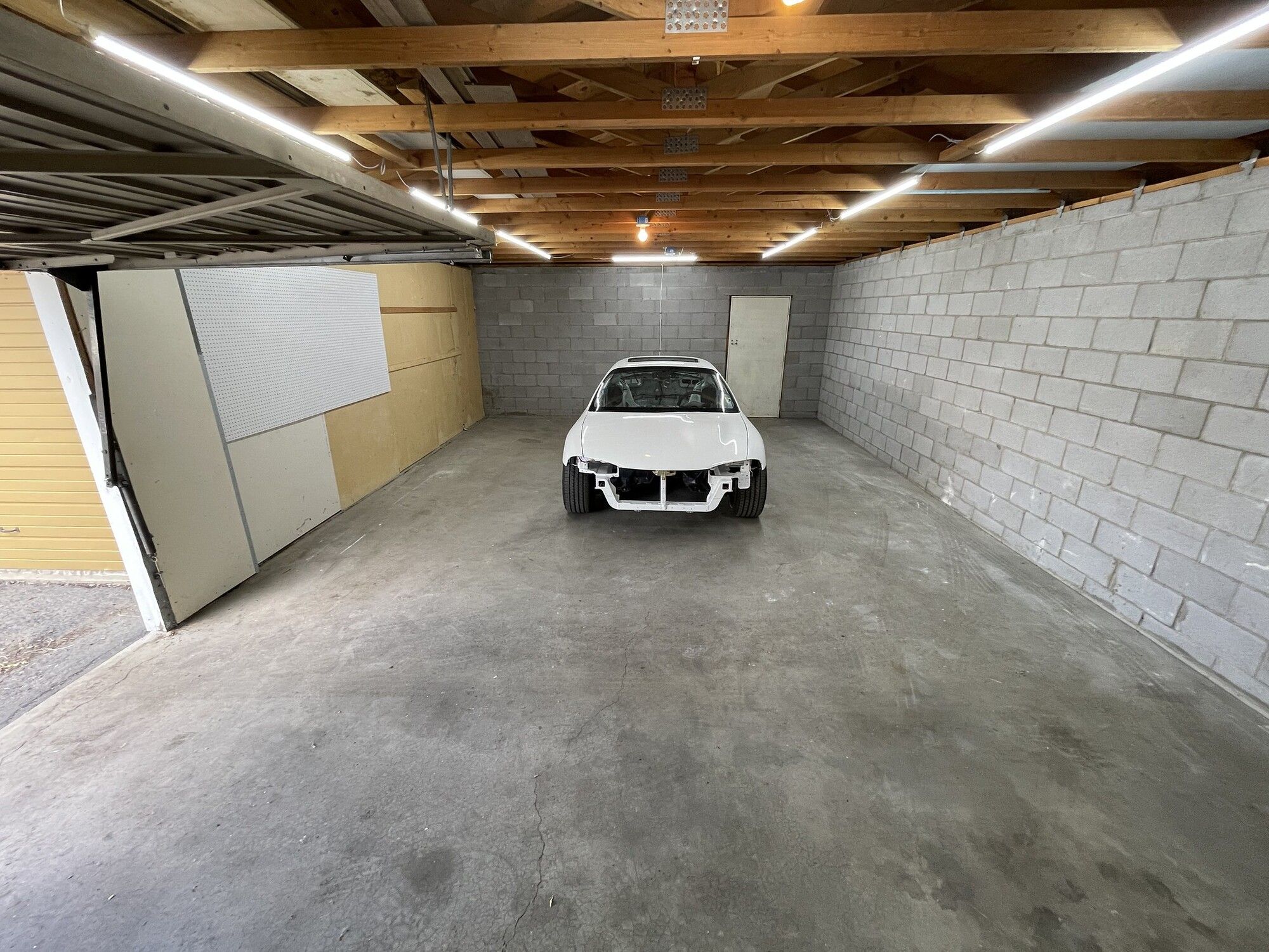

So I got straight to work Friday afternoon getting everything ready to be moved over to the new shop.
Untitled by bradydings, on Flickr
Put the wheels back on it and got it loaded up onto the tow truck for the 20 minutes trek.

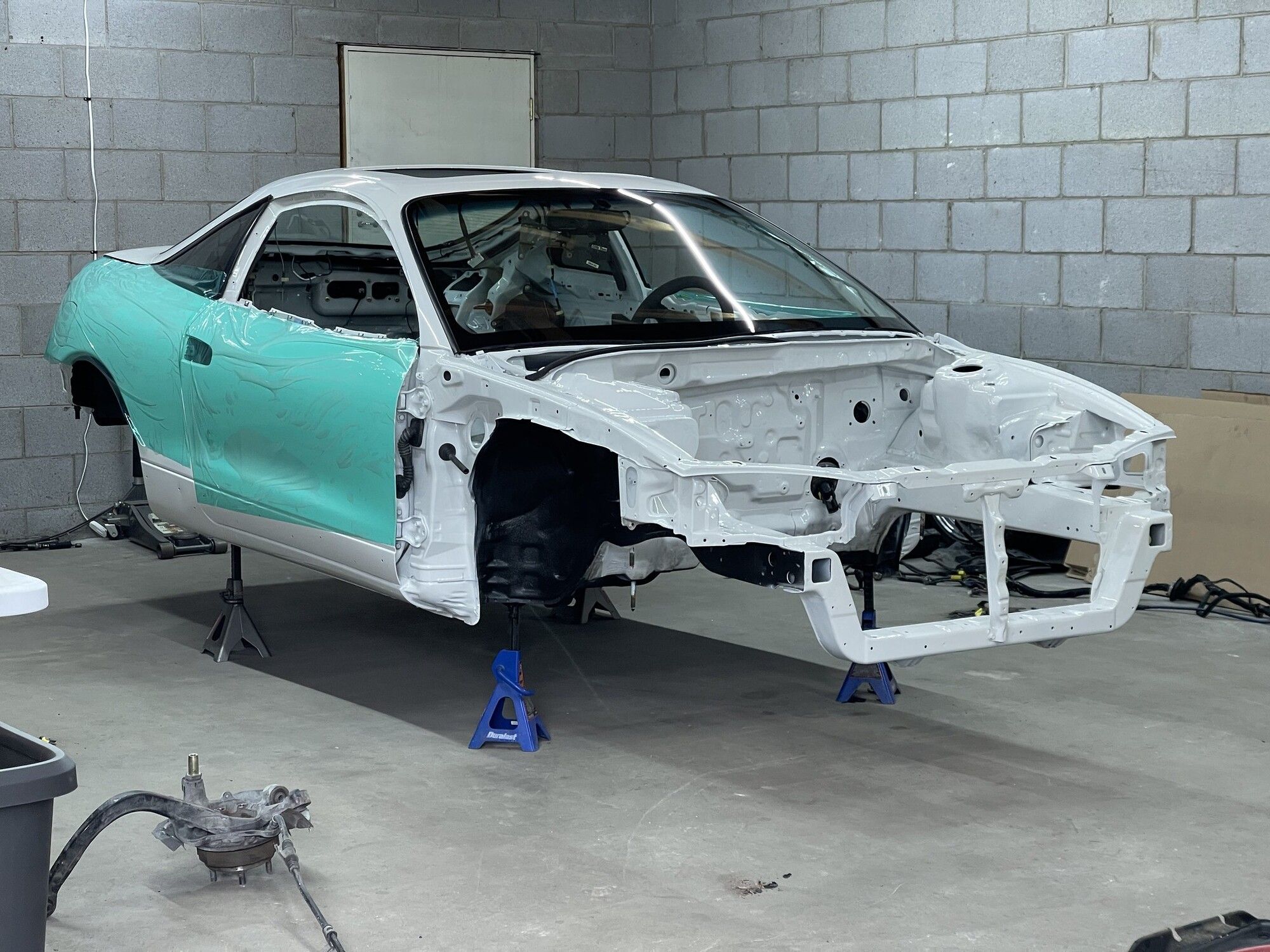

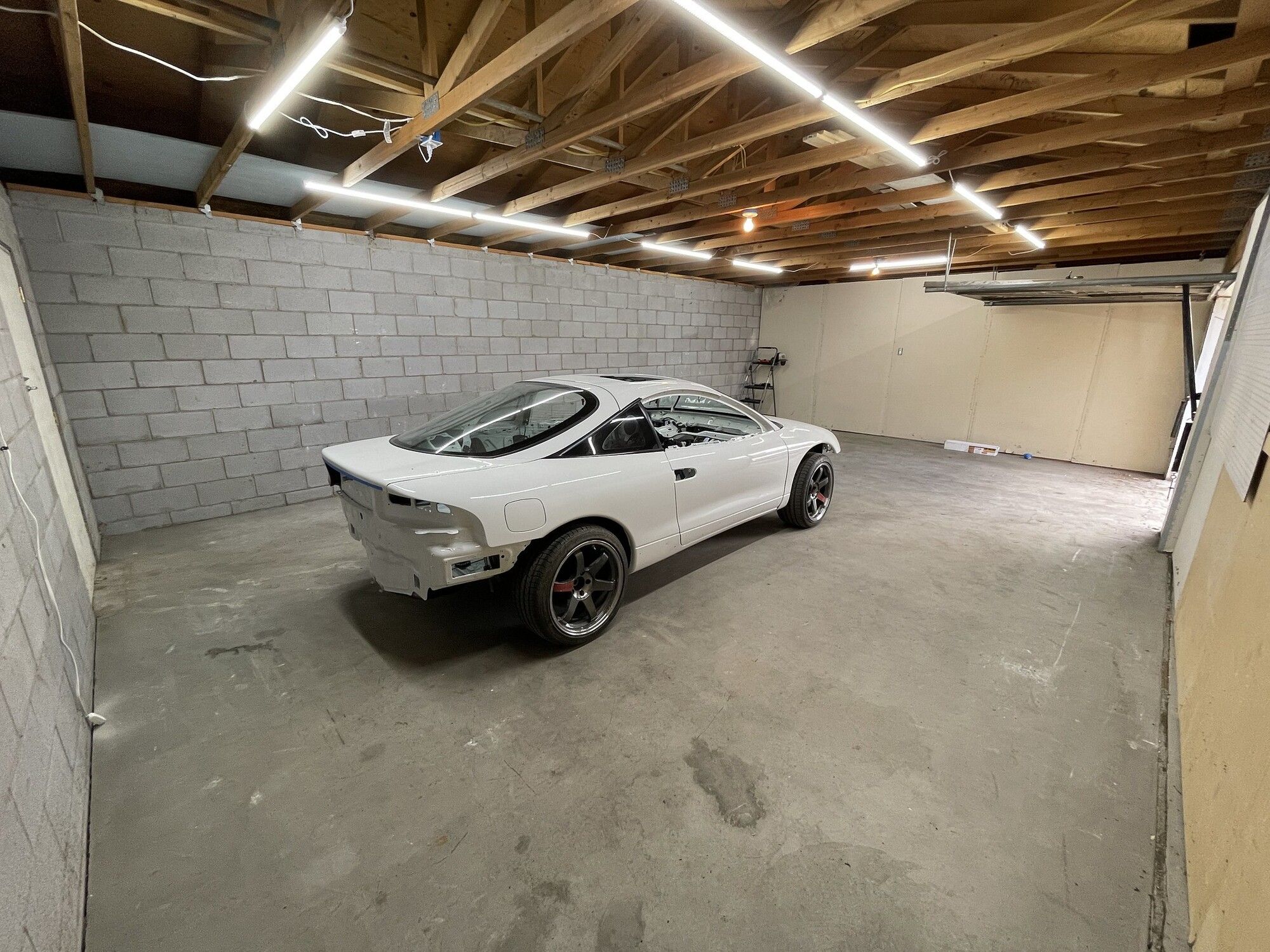

I got it put into the shop and situated where I believe will be the best spot for assembly. This garage stays pretty cool with the CMU walls on two sides and concrete slab thank god.
There is soooo much room. I will start trucking all the parts over and organize/clean everything once more. There will still be tons of things I need to get sand blasted /coated/ zinc'd, but I needed to have it all laid out to stay organized. I couldn't force myself to work on the car with such little room and parts in 100 different boxes, just would have been a nightmare.

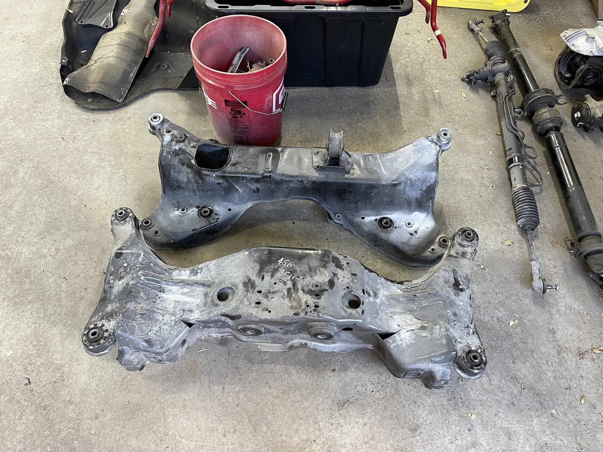

I finally got over to disassemble the last remaining items.
I couldn't work on the subframes or suspension pieces while the car was at paint, so that is what needs to be done before reassembly can happen.

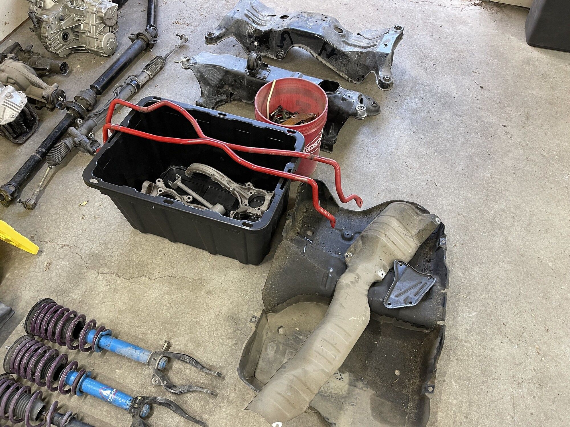

I need to get all the stock bushings out and then get these blasted and powdercoated gloss black.
This is my last bit of items that need to be blasted / coated / zinc'd

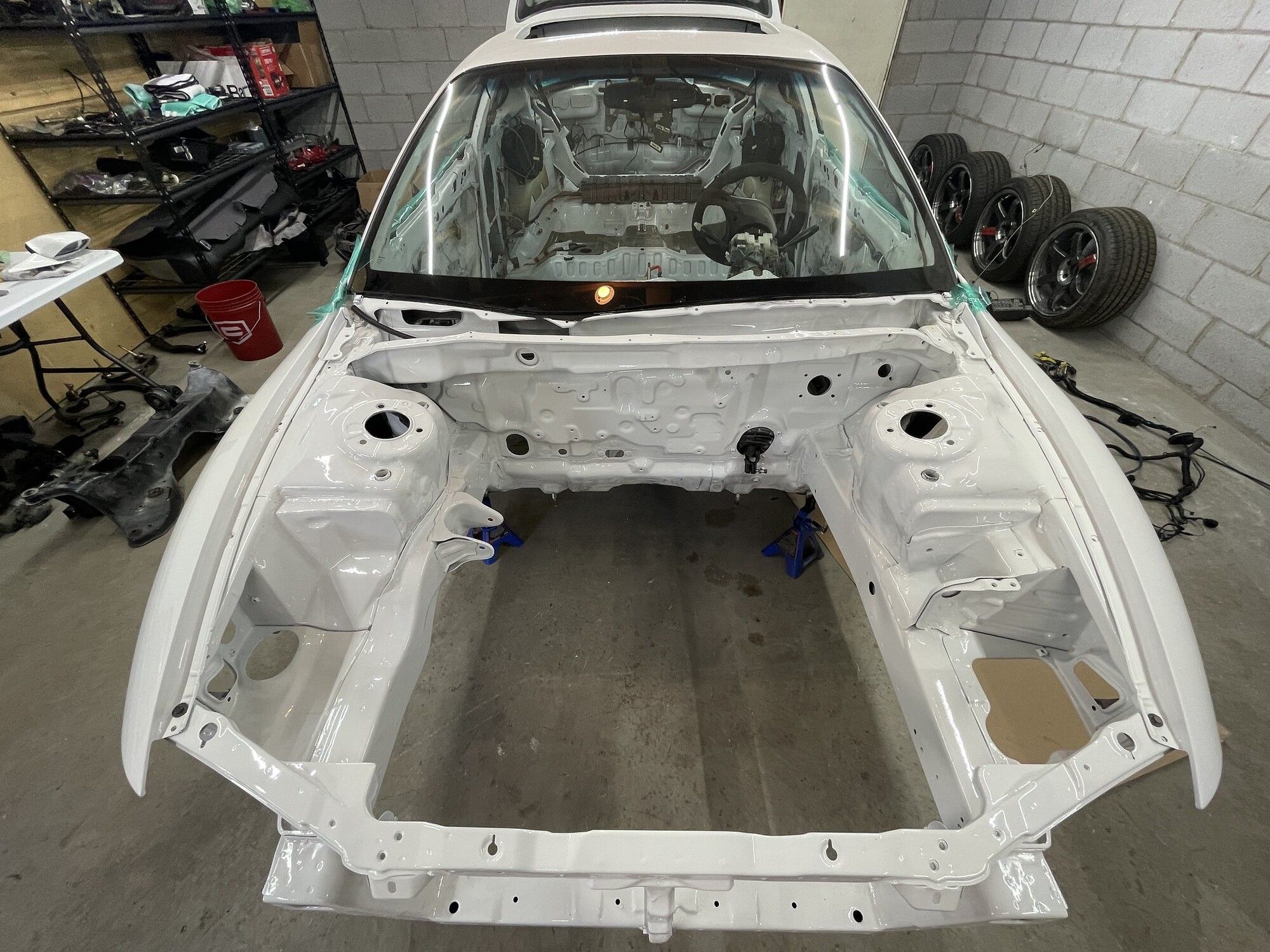

I'm going to get the car running / driving 100% before I even contemplate putting anything interior or exterior on. Goal is having it mechanically perfect before doing the remainder of the installation. Just think that makes the most sense!

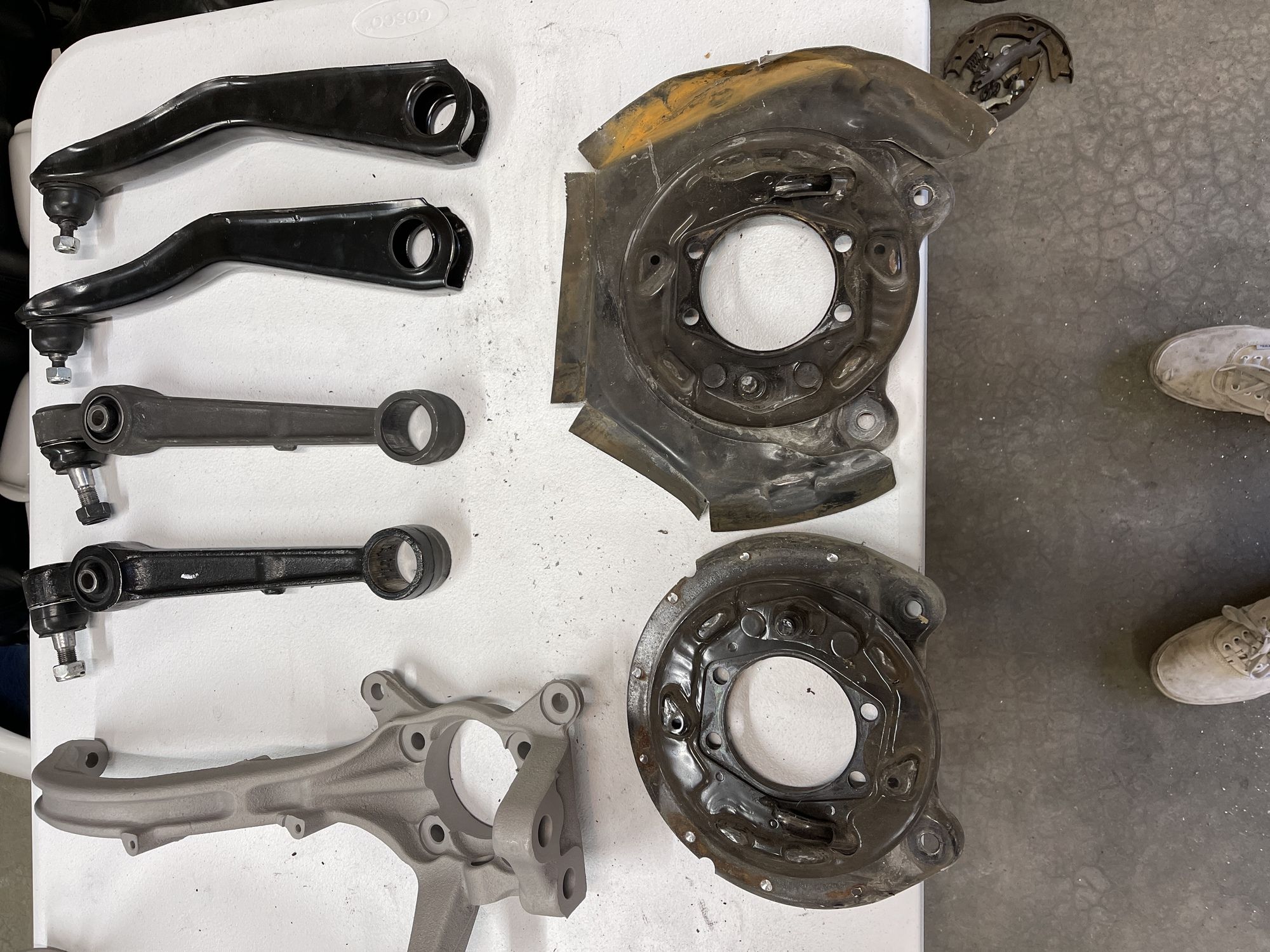

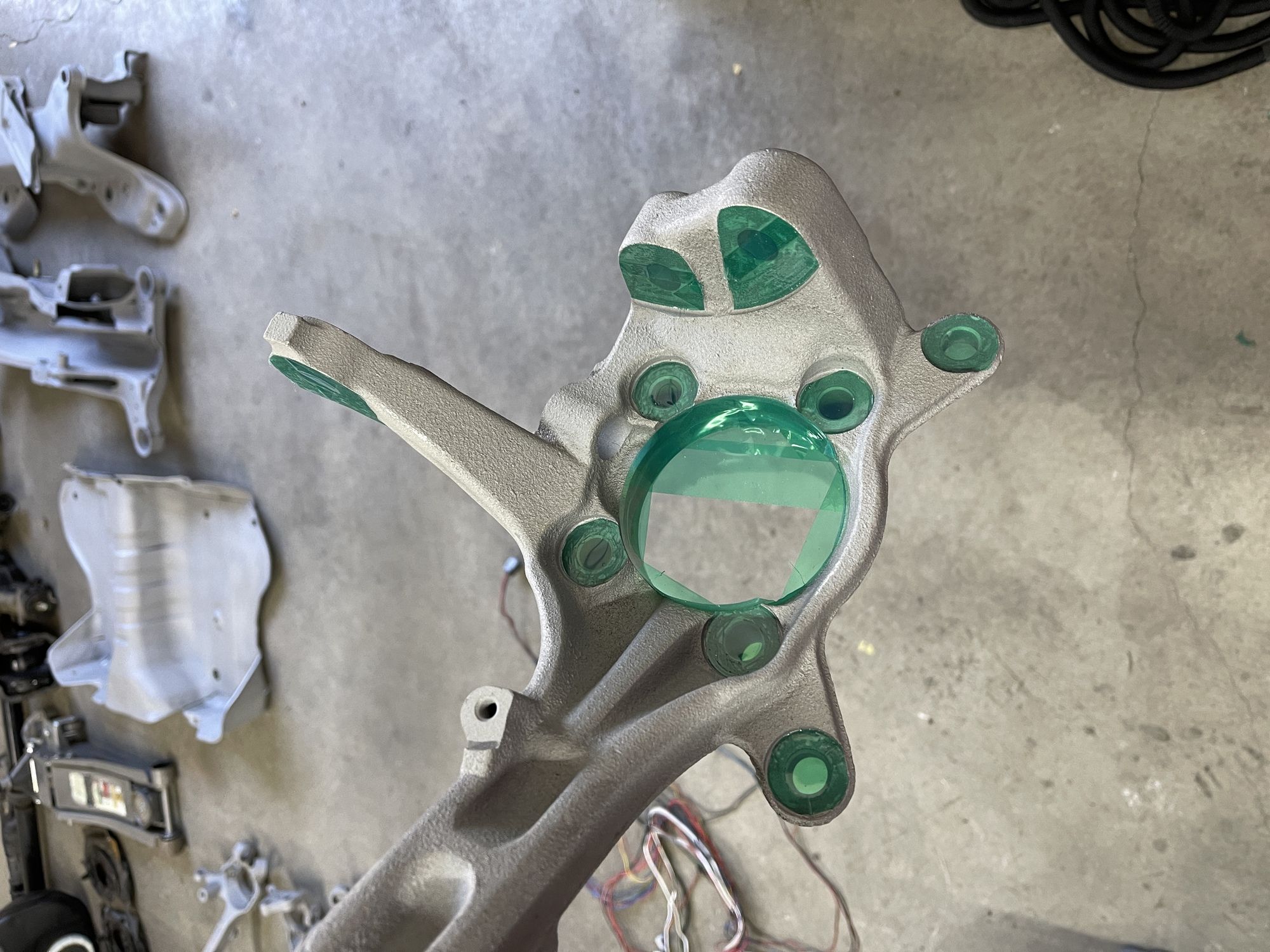

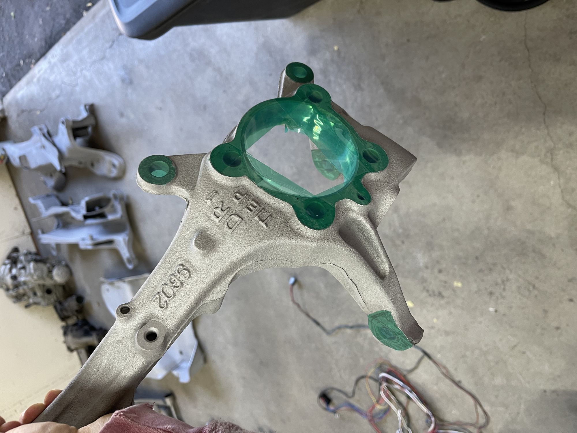

In the meantime I am prepping parts for powdercoat.
IMG_0026 by bradydings, on Flickr
IMG_0027 by bradydings, on Flickr
A little bit of me debated painting these parts, but I've come this far LOL, going to powder them. Masking sucksssss for the knuckles for sure.
I removed the OEM rotor shields from the rear bracket. I haven't run these in the past. I mainly wanted to get these apart because a ton of rust hides underneath these. I may blast and coat these, or just clean them up. Thought about making a new shield, or at least making a template to then have them lasered or something, not sure yet.

love the detail here. Though I'm curious why you masked off all of the bolt holes etc on the knuckle. Are you worried about hole tolerances or fastening over the coating?

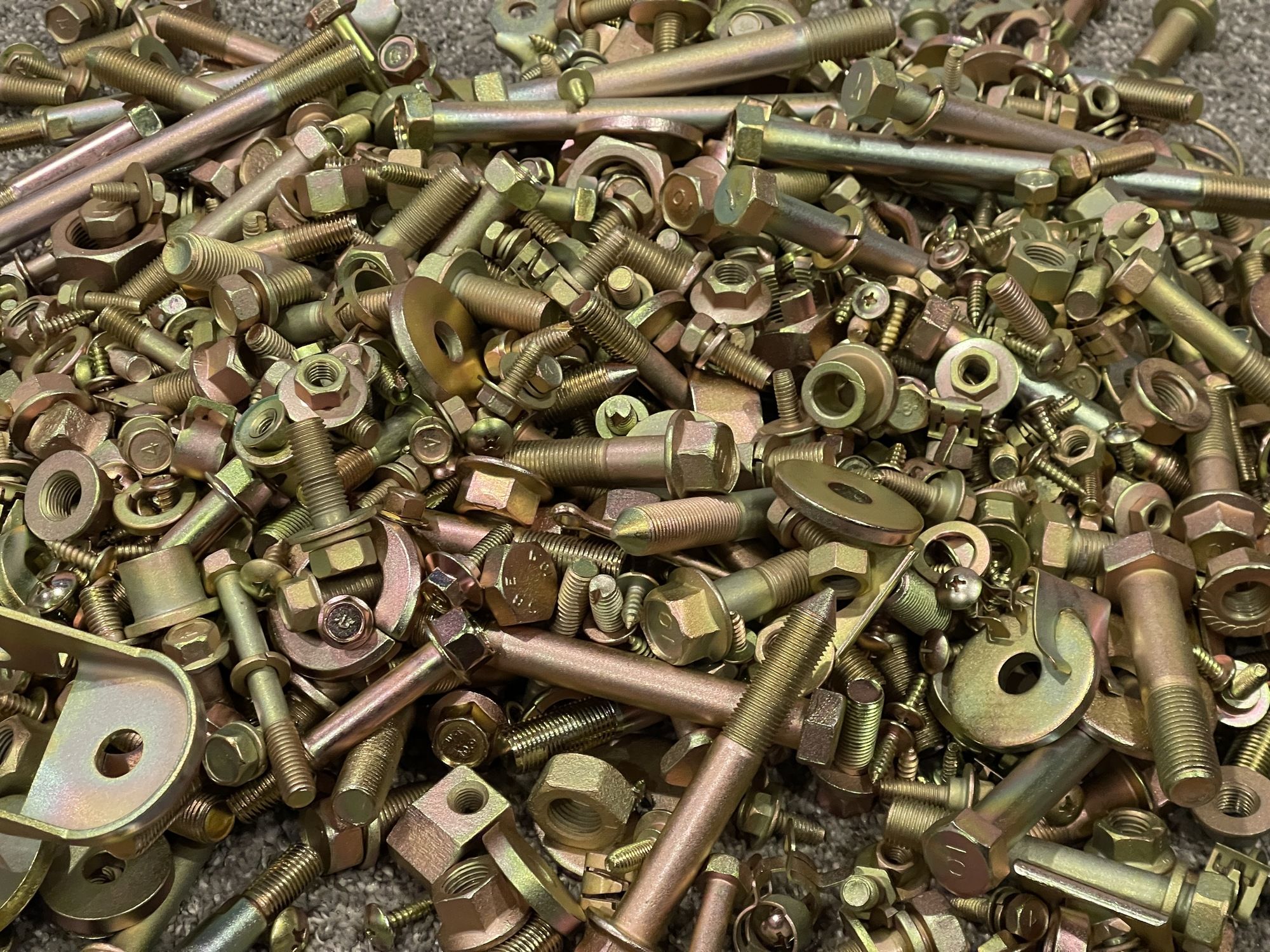

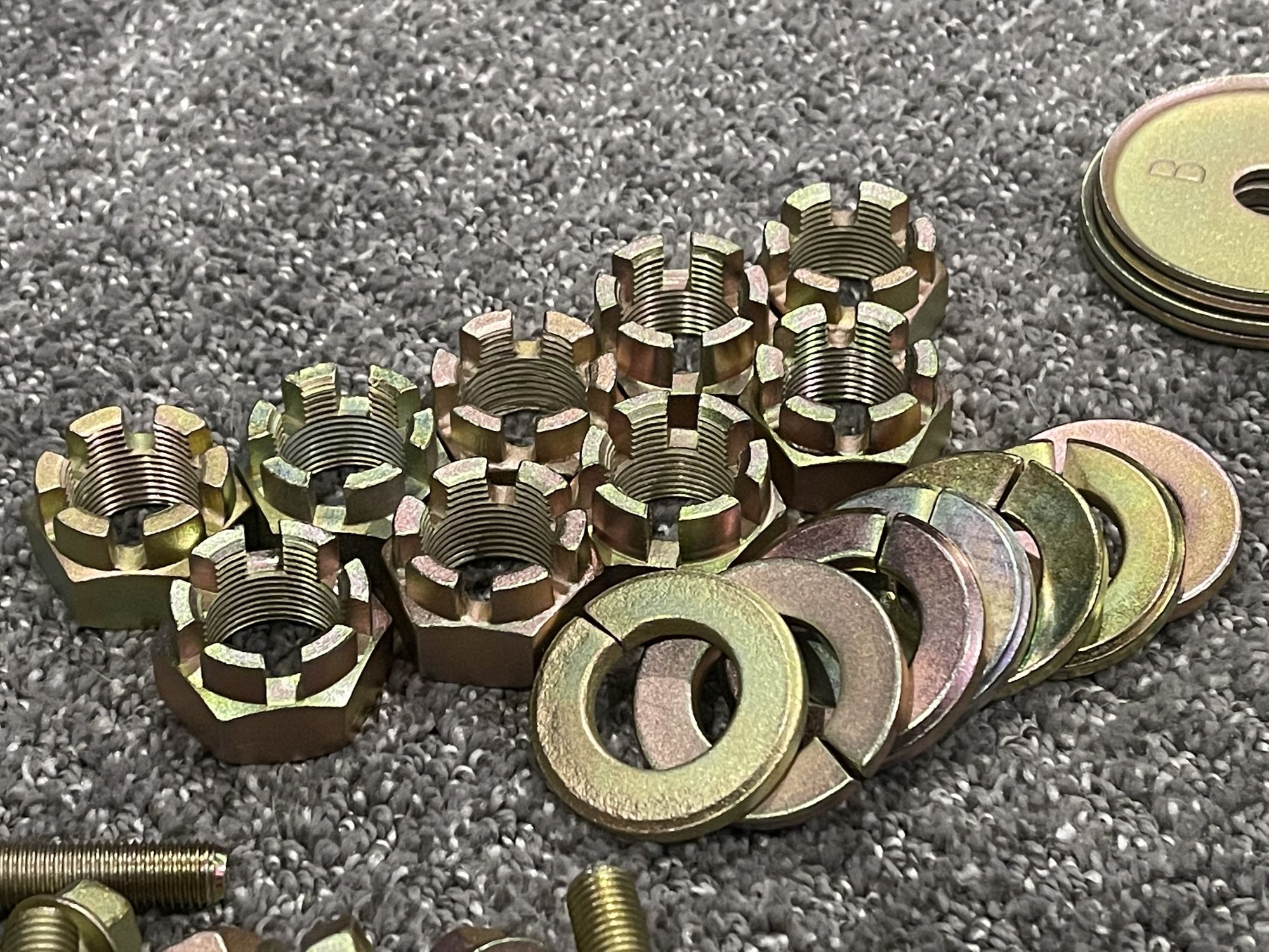

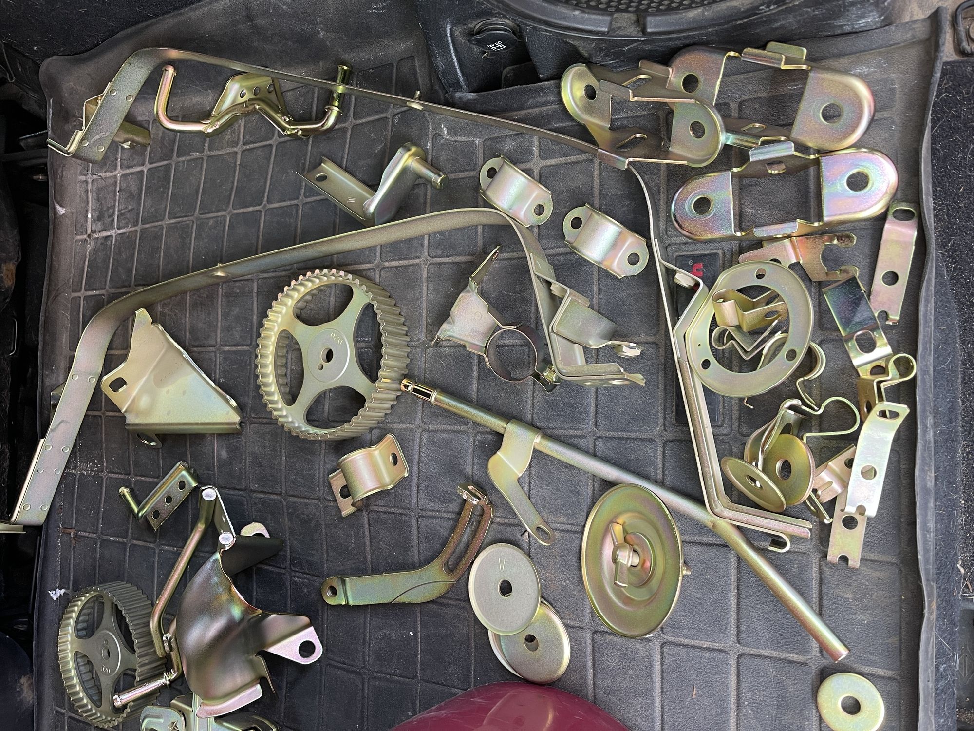

Picked up my second batch of parts from getting plated. Super happy with how this all turned out.

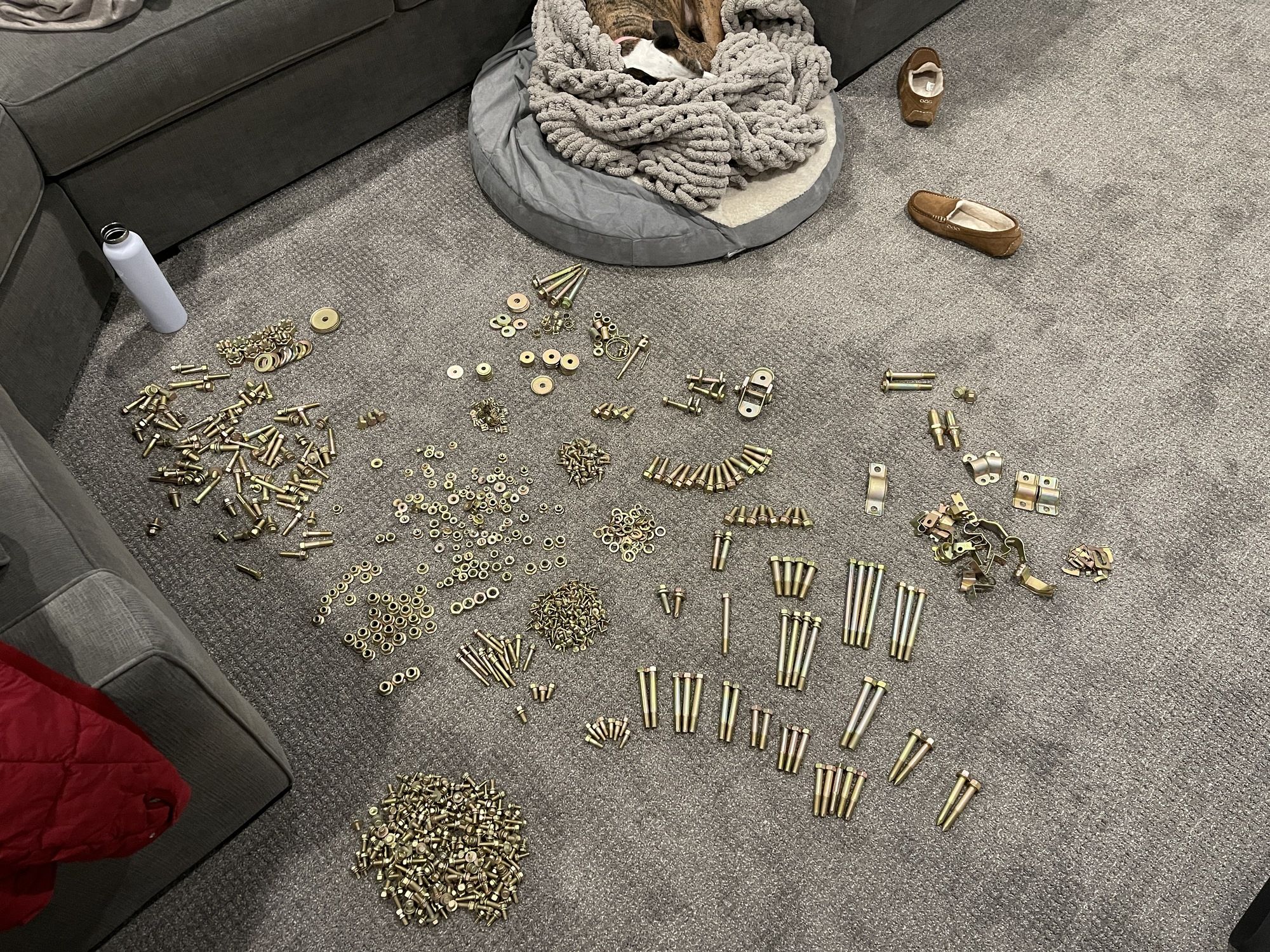

I got so sorting on the floor lastnight. Kind of do a generic sort of bolt versus washer versus screw etc. Then I will start sorting by individual item to have a pile of identical pieces.

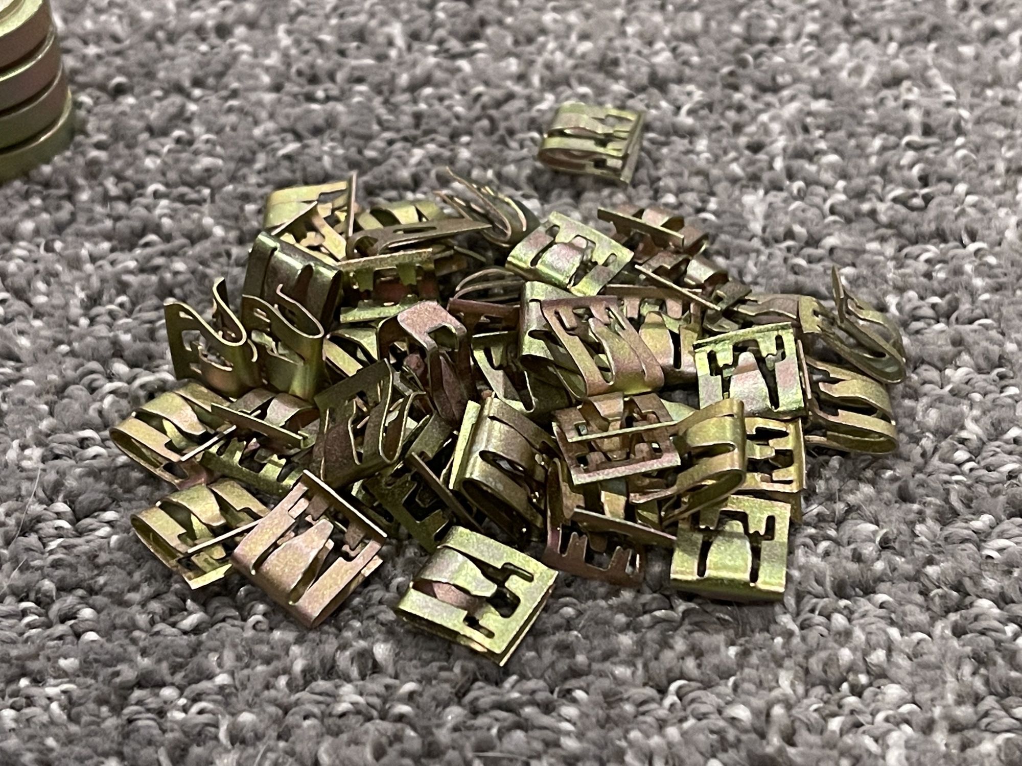

Even did the interior clips LOL

Thats a nice uniform finish. Are they giving them some kind of grit bath to make them all the same and remove all the old excess corrosion?
I know some vapor blast parts before plating and sone use a really strong etch batch before the process.
I had all of the bolds sandblasted prior to getting them plated. I'm not sure if they do any pre treatment though. Believe they just toss them in a big rotating drum to plate. If I would have polished the stuff I would have gotten the super shiny reflected coating, but that's a little insane to do haha.
When we do plating we get a combo wether its blased or not. Its random LOL some new stuff comes out shiney and some dull i much prefer the dull effect myself.
The amount of parts you got done is awesome and looks amazing! I remember doing my dash brackets as they are plain steel from the factory and ma they made such a huge difference
UGH... I thought about pulling all the dash brackets and shifter base and all that crap but I called it quits. Can always do that later on! Just did everything in the engine bay and everything that bolts to the exterior/underbody etc. Didn't really do the interior except for some stuff that I had already removed like the clips/bolts etc.
Yeah the dash and shifter were to me an eye sore, some of mine are seen now as its all stripped inside but it was really bad looking and no holes but i hate rust inside the car as you can always end up smelling it when you know its there LOL, weird mind trick.
The outside ones you done are far more important for sure. Shocmed none were totally bad wnd heads rounded on any of them
