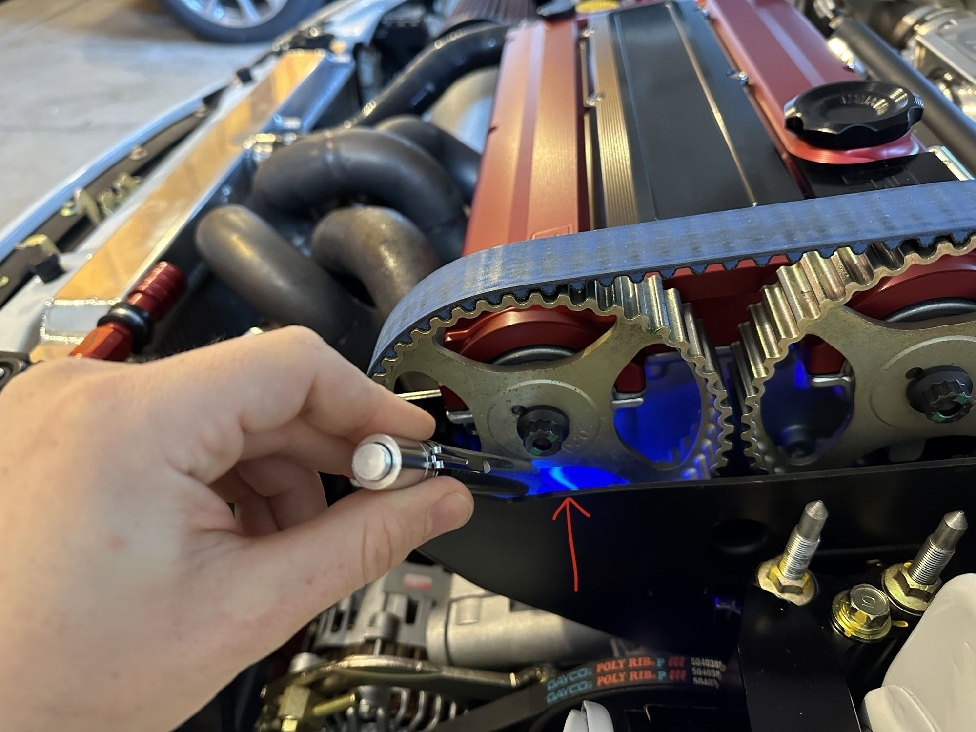

I took the valve cover off and cleaned/ re-did all the RTV. Everything was cleaned with brake cleaner and no oil anywhere. Started it up after 24hours and can see a small trickle coming from below the cam gears. You can see the UV dye stream in this picture.

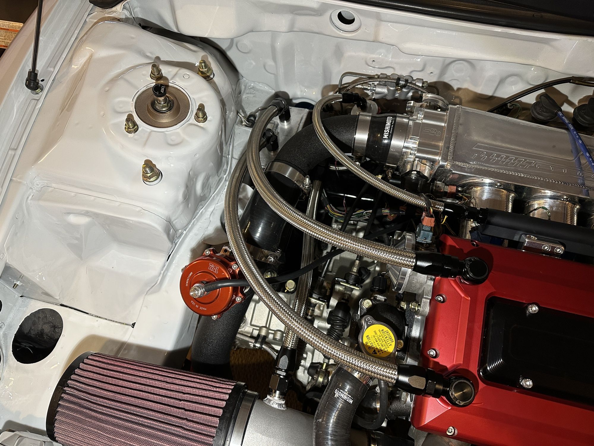

I have new seals on the way, I'll start disassembling her shortly! In the meantime, I wanted to get my catch can setup wrapped up so have everything on the way, should be installed by next weekend. I mocked up the lines here to make sure I wanted to keep the stainless lines / black fittings and I think I like this look the most. Eventually would like all the vaccuum lines to be braided as well to match.

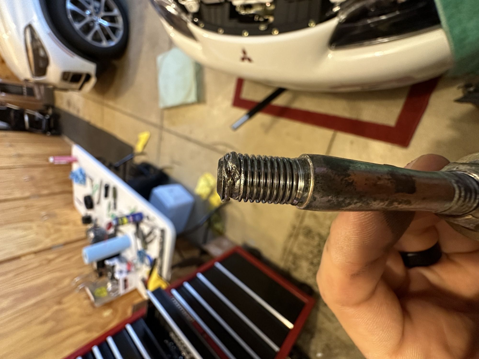

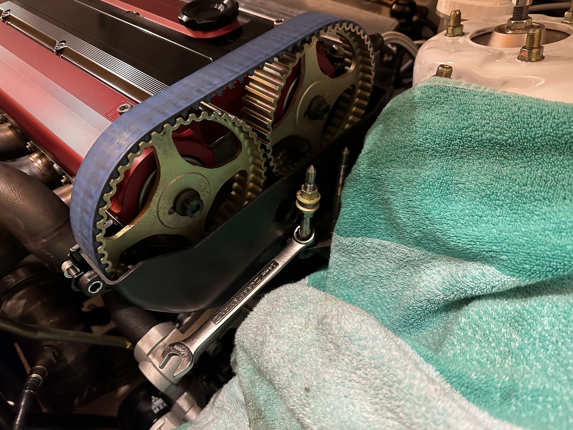

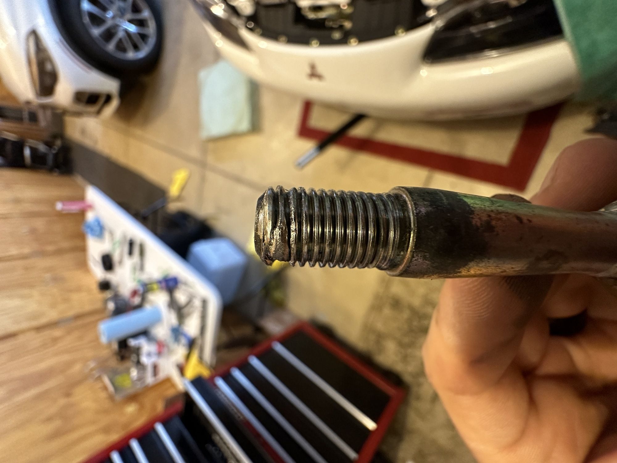

Well I got all the way to the timing cover and ran into the first hiccup lastnight. I do not want to hack this timing cover up to get it over the motor mount studs so I typically remove the studs. Well, the front stud was absolutely not coming out. I had it soaking for a day in penetrate, and had to resort to the fabled triple nut technique. LOL
Untitled by bradydings, on Flickr
Was finally able to get it out after soaking and using a ton of leverage. I cleaned the hole up and ran the tap through it a bunch to make sure the mount was reusable. I've never seen threads this messed up...

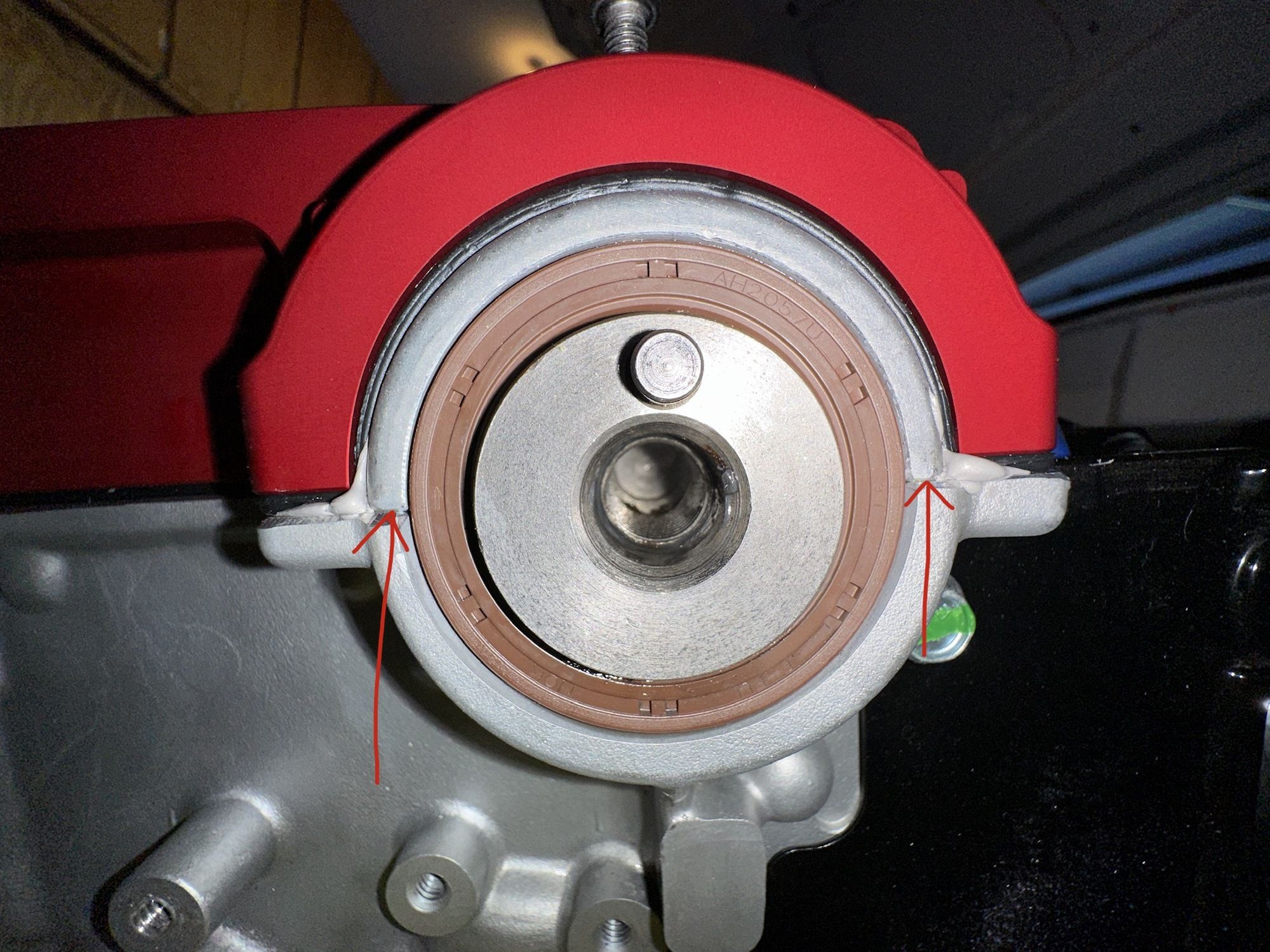

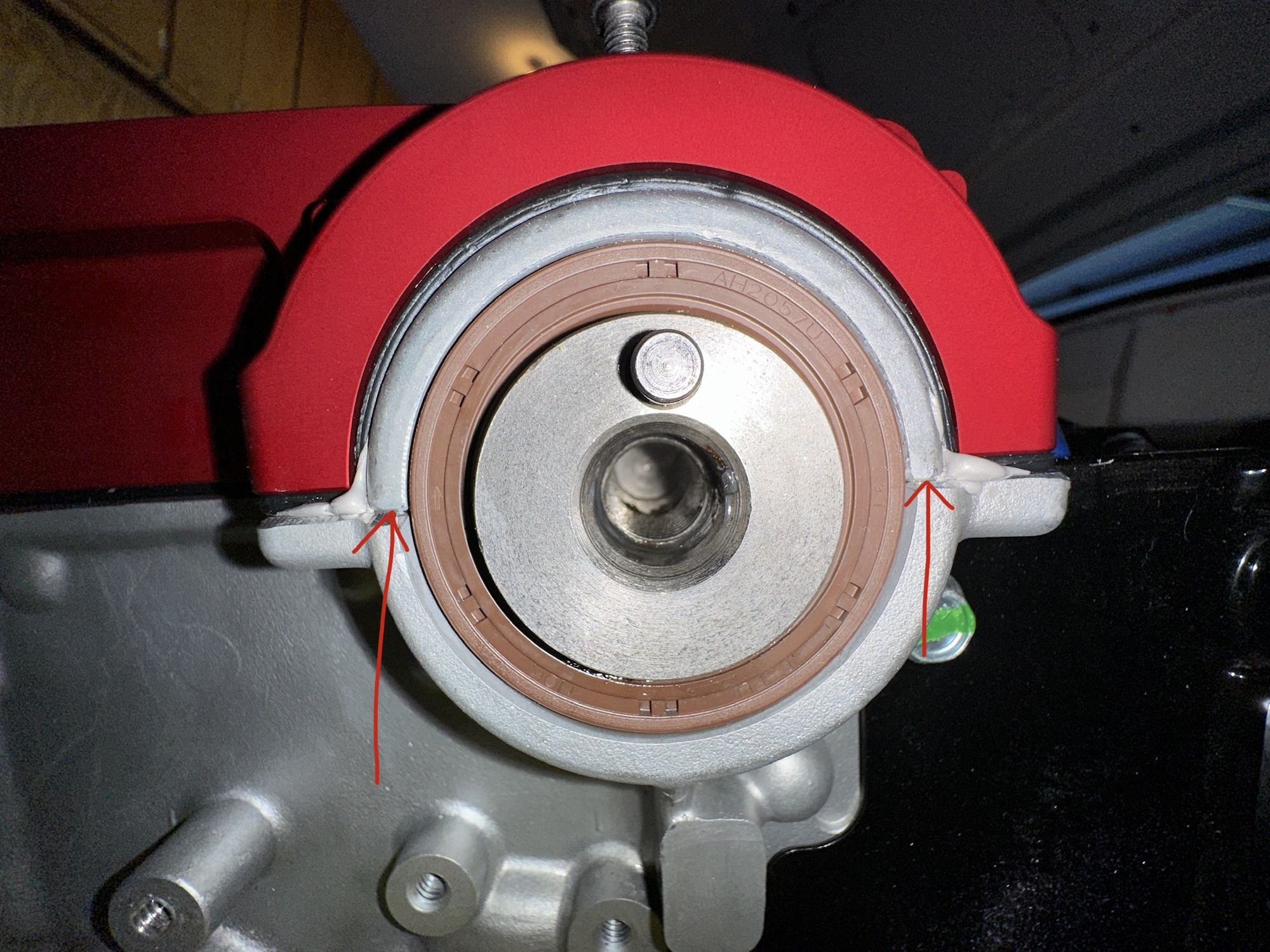

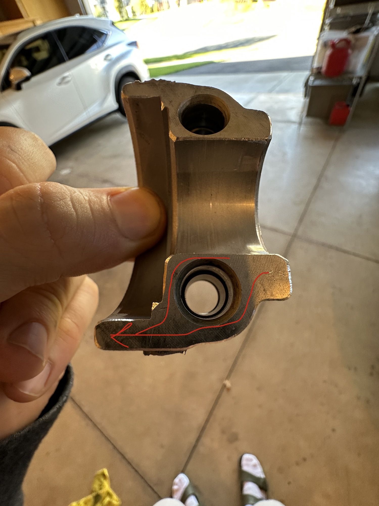

I got everything buttoned up this weekend. New cam seals etc. Why do neither the Chilton or Haynes manuals tell you to RTV under the end cam caps? I've never done this, and I've always had small oil leaks at the timing side and under the CAS. Seems like a no brainer as there is a perfectly clear path that has no gasket or sealant.
I put a tiny bit in those areas on all three end cam caps and hopefully should be good to go!

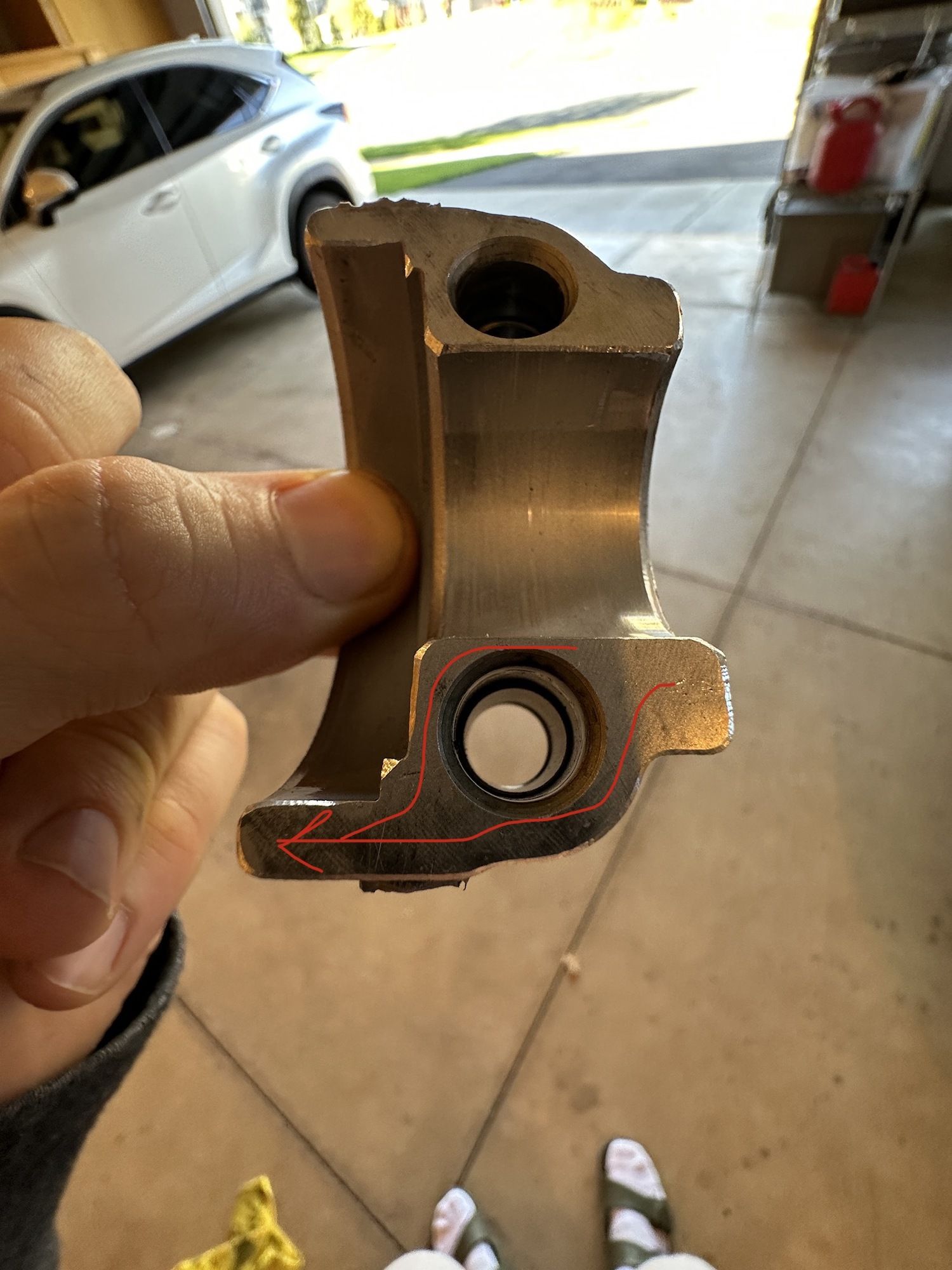

Yo!
View attachment 711068Untitled by bradydings, on Flickr
View attachment 711069Untitled by bradydings, on Flickr
Peace.
I’ve always put a bit of silicon there. Learned early on. I also put a light layer around the half moon on the backside of the head.
Yep, you live and you learn! I figured when I got the head built that they would have done these things... both times... LOL. Fingers crossed we are leak free for once in 15 years!

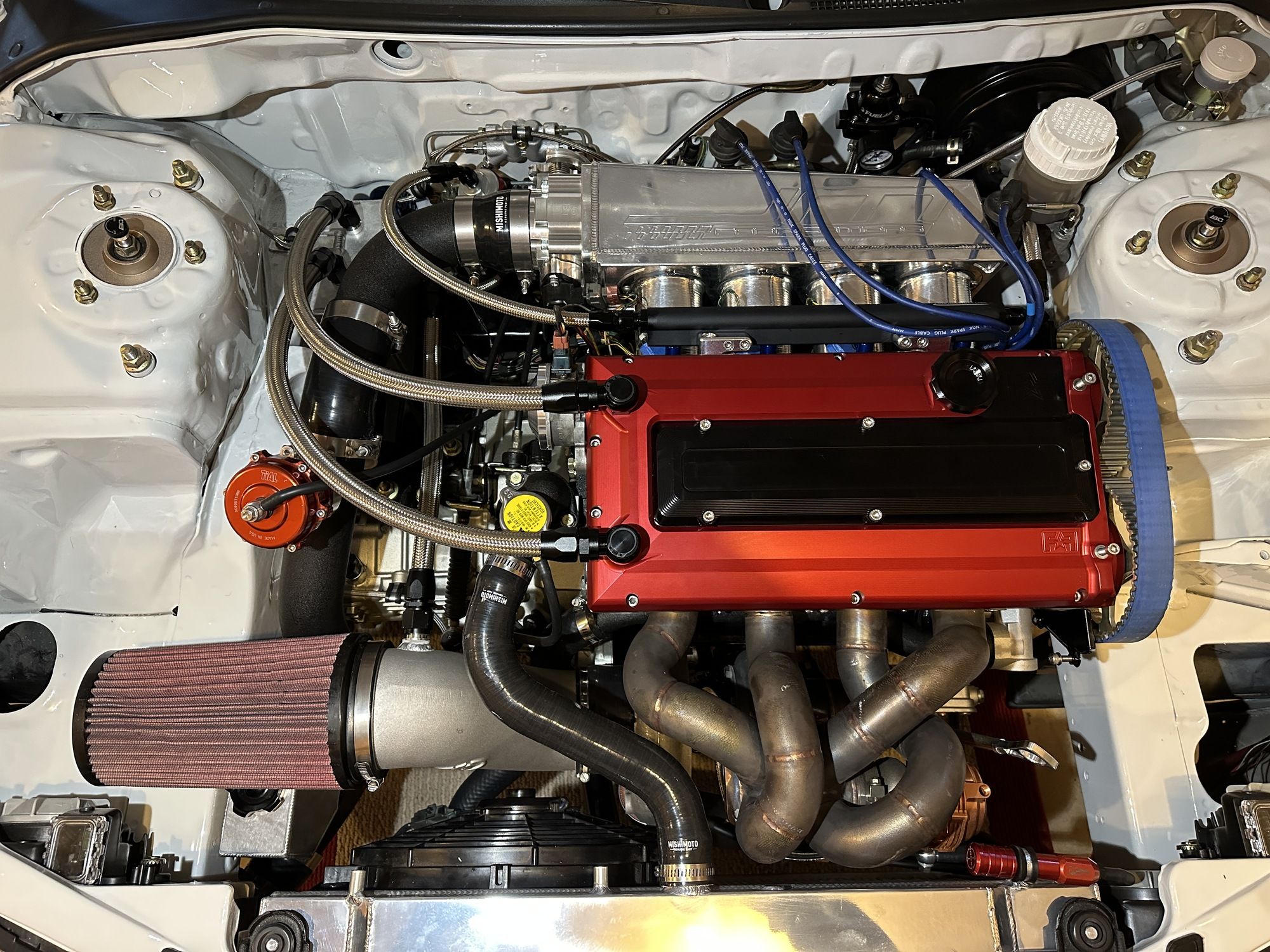

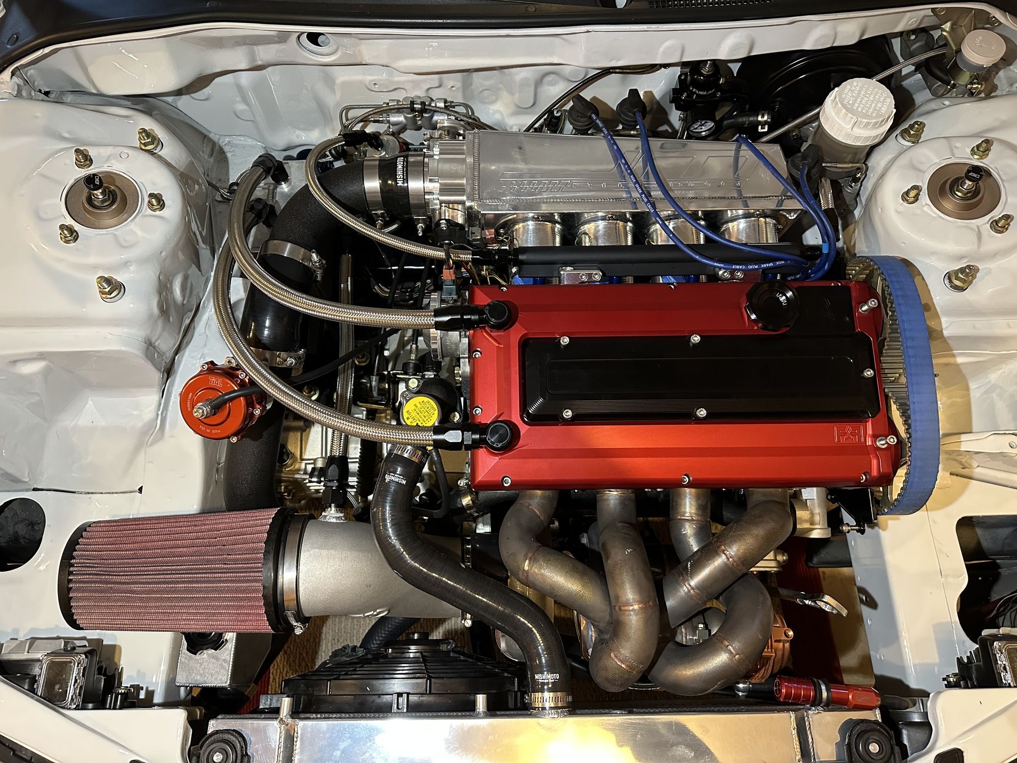

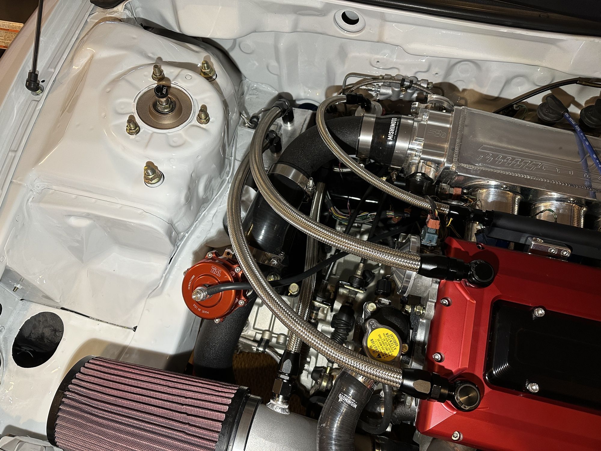

I finally got all my fittings / lines together to install my catch can. Love this location how it is out of the way.

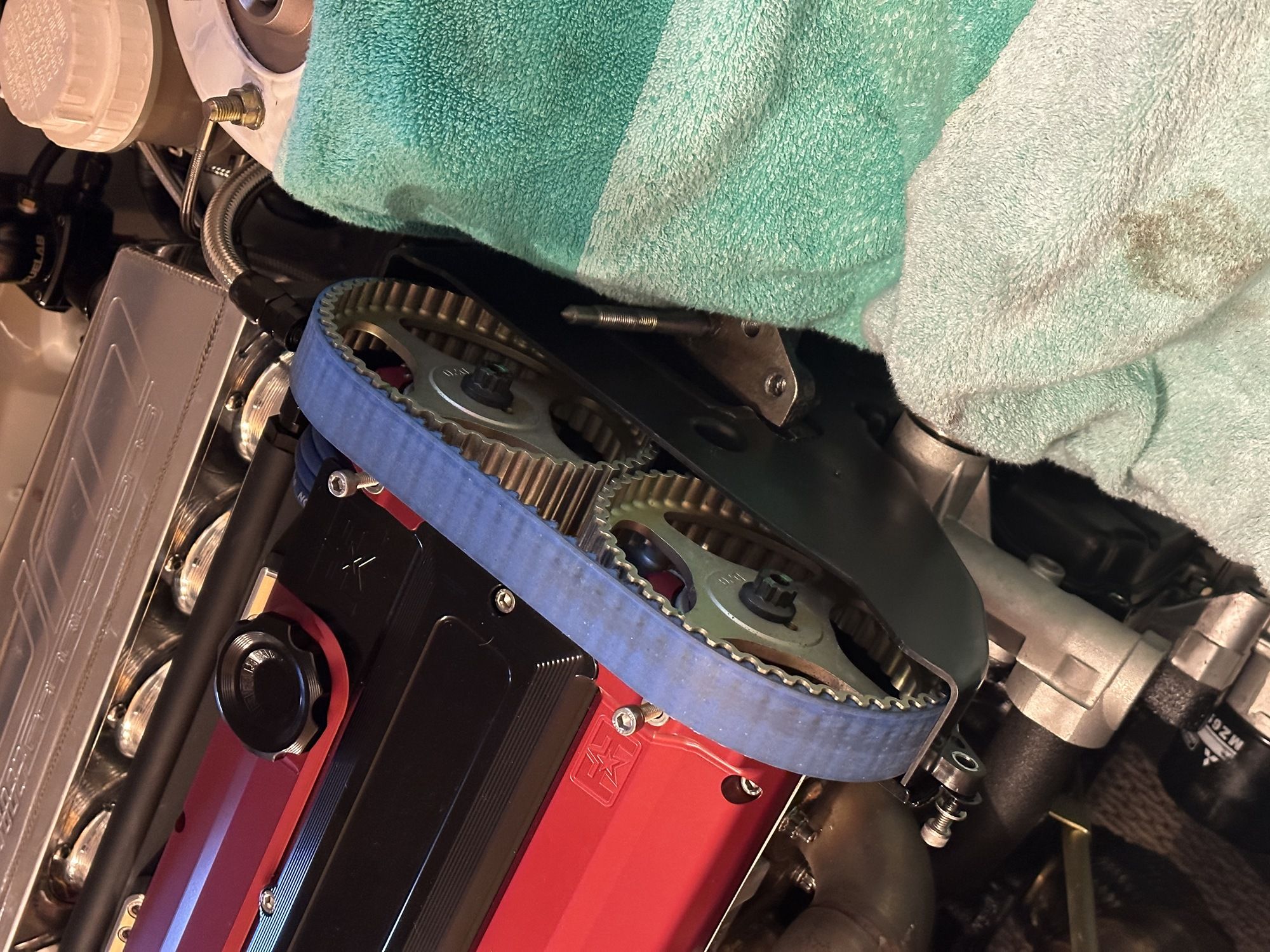

I redid the timing and will have that wrapped up shortly! Just in time for winter LOL
