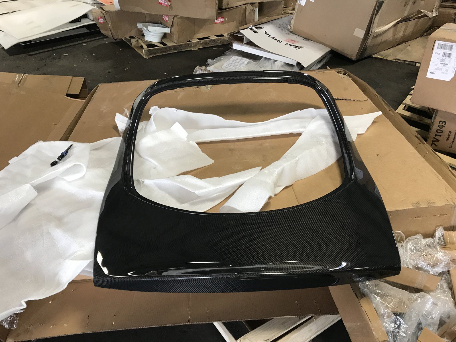

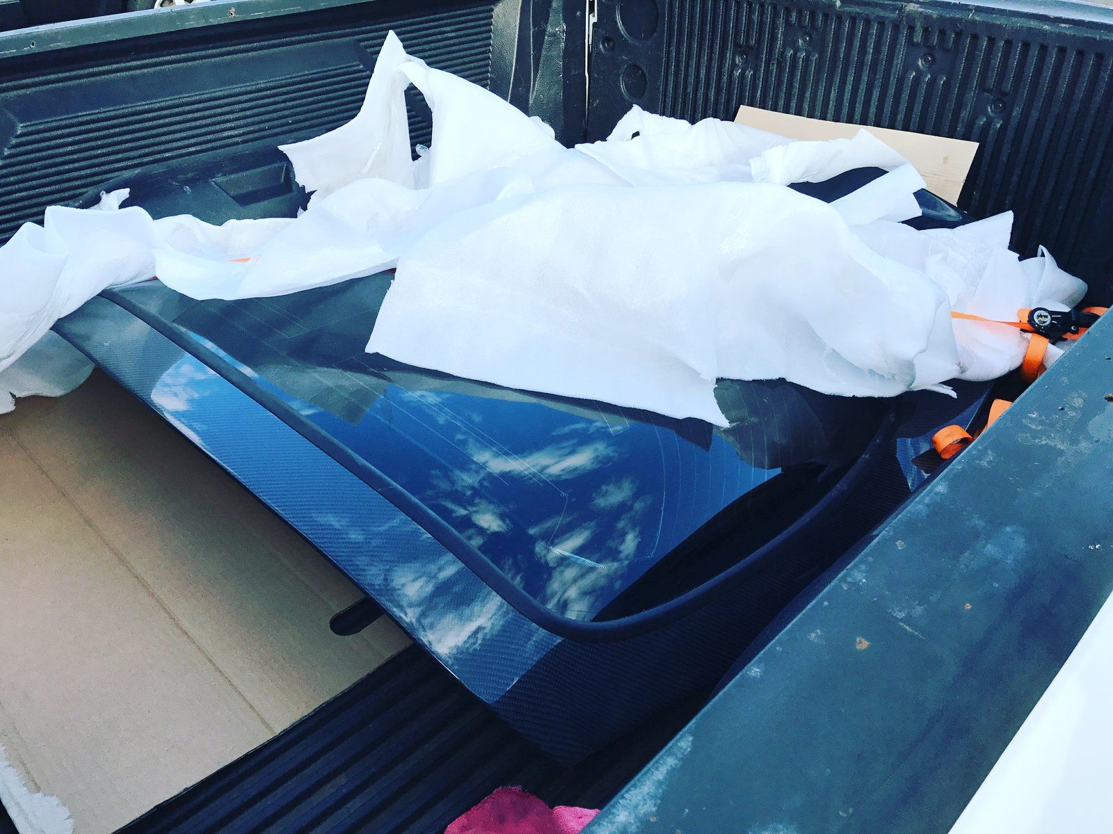

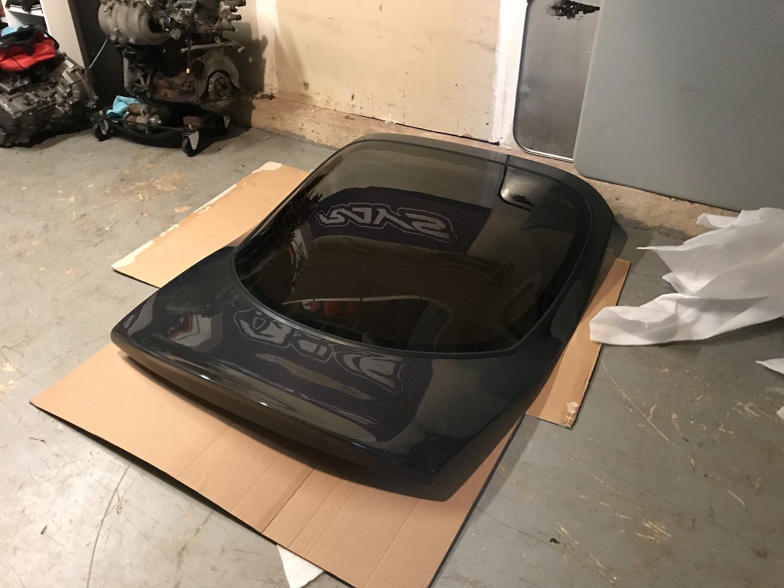

The Carbon Hatch Finally Arrives.. The following info below is going to my be review and dealings with Carbonetics. I paid full price for this item, and in no way am sponsored by CN. In turn this allows me to leave a fair and honest review.
All major interactions, and Info with Sergio at Carbonetics.
1)Initial Order inquiry: I contacted Sergio on Feb 22nd, to get a price quote and estimated lead times on his CSL hatch. Response time was quick and I was quote a price within an hour of sending my message. The price for the hatch was $600.00 and residential Fright shipping w/ insurance was $390.00. Estimated Lead times 12-15 weeks (3-4 months). $300.00 down at the beginning and final payment when the hatch is completed.
Total $990.00
2)Order and deposit: After having him answer a couple small questions On March 1st I paypal'd the $300.00 deposit for my Hatch. From there the waiting game starts.
3)Order updates/completion/Drop off: After making the deposit on March 1st, I would occasionally reach out to Sergio at the beginning and end of every month asking for progress updates and if the current timeframe of 13-15 weeks was still holding. Sergio would usually respond with in 4-8 hours depending. I'm East coast VA and he is west coast Mexico / Cali, so our free times wouldn't always align correctly. March, April, May, all pass by with about the same response that were still on Schedule.
June 22, rolls around and I reach out to Sergio asking him for an update because that week put us at 15 weeks lead time. I received an update that the hatch would ship with the next two weeks. I think "great, my hatch is done and will be shipping soon." After that responses from Sergio became a little spotty because of MOD 2017 being on July 8th. Which I think is understandable since its a huge event a big opportunity to show off his product to a large audience.
Sergio gave me my final balance on July 5th, and I paid that balance in full on July 6th. I was told it would ship with the next two weeks from Monday July 10th. So that means the last week in July ish... On July 11th Sergio responds telling me they are back from MOD, and they are getting the hatch ready for shipment. On July 17th Sergio tells me they are shipping the hatch this week. I'm pumped and super excited, and tell him to supply me with tracking once it leaves. That weekend rolls around then the week, with no update. Then on July 25-26th I message him asking for an update. Sergio responds saying basically saying "Sorry, there was a delay and it will ship out Friday July 28th ." At this time I ask him to send me a picture of my hatch. Which he does, its a video showing a hatch with my name on it all packaged up. So I'm excited, there's my hatch packed up ready to ship after all this time. Honestly he is wearing a lot of hats it seems and I feel this is why updates and delays happen.
July 28th comes. Sergio says it is shipping out, and they are waiting on the carrier to arrive and pick up. No response again from him until Monday Aug 1st. Sergio lets me know that the hatch was picked up and give me the Freight carrier and my Pro #.
After this I check my Tracking on Aug 2nd with no real info posted. Called the carrier and there was a lot of bad information coming from both Uship(Broker) & Clear Lane (Freight carrier), they both were not communicating with each other. I called them multiple times, putting pressure on them to reach out to Carbonetics for pick up. After doing this for two days, I finally got the word that the hatch was picked up on Aug 9th.

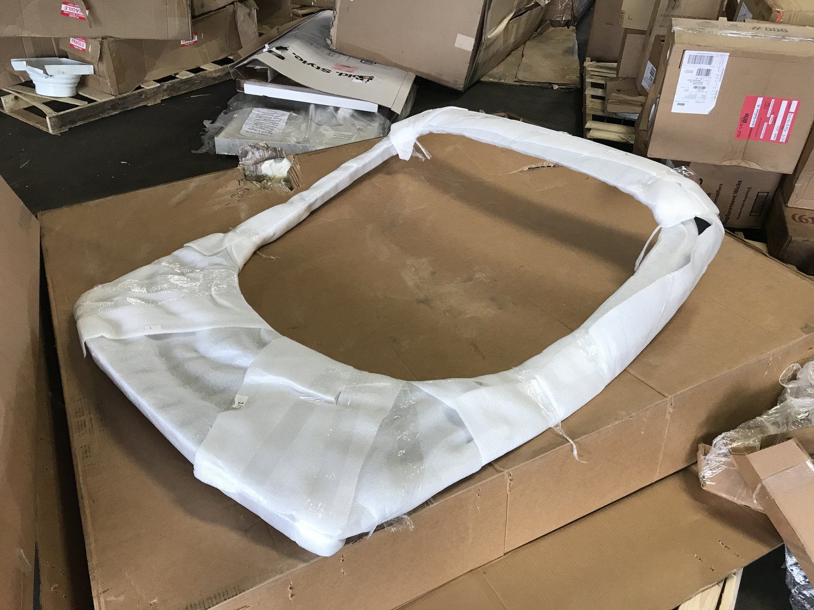

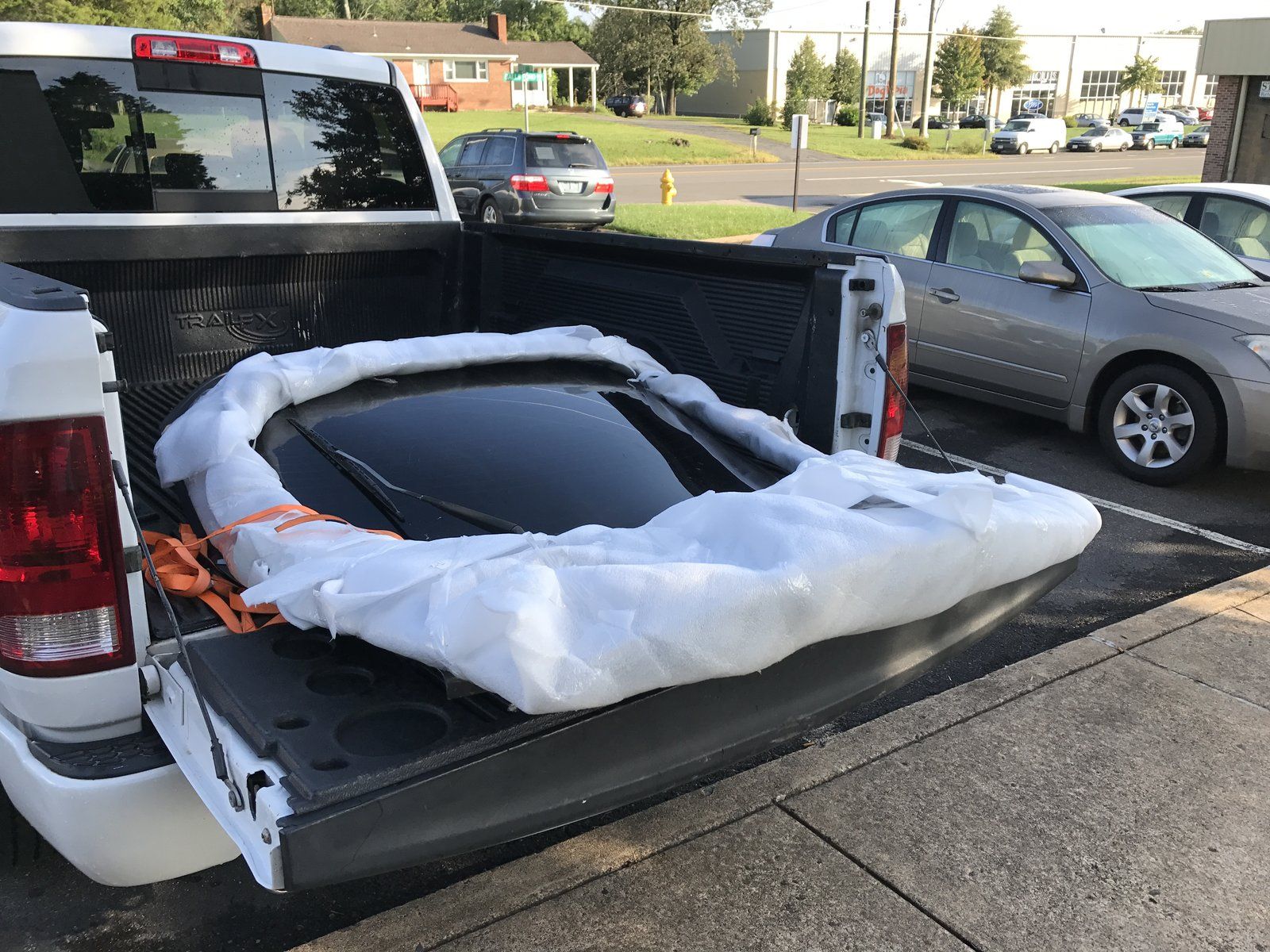

5)Shipment delivery: This took about a week to arrive to Virginia, as I expected. I decided to pick up the hatch from the carrier doc in Stafford city, about 30 mins from me. They wanted to ship it to another location and then schedule a delivery time. And with me going on vacation end of Aug I didn't want to risk missing delivery.
Box was beat to hell, but the hatch was protected inside and made the trip with no issues.
6)Quality inspection: I broke the box down, and unwrapped the hatch right there inside the carrier dock. I inspected the hell out of this hatch. Every inch, every corner, and every lip portion I could. I was gong to make sure nothing was wrong with it before I took delivery.
My Review: The hatch was in perfect condition and looked great. Serigo knows what he is going with carbonfiber. I couldn't find a defect, chip, or scratch in the 15 mins I took to look it over. Its a work of art plain and simple.
7)Installation/Fitment (using OEM glass): TBD installing in September.
8)Final thoughts:
Product Quality: Very Good.
Price Point: Very Fair for what you are getting.
Communication: Needs work.
Fitment: I will revisit this later on.
Lead time: 6 months. Needs to reduce lead times.
Overall Experience: Product wise, I definitely would like more items like the hood and lip kit. But due to long wait times, communication. I am unsure if I would buy direct again. May look for used items. Besides what others have said you will get your product. Just be patient and wait it out.

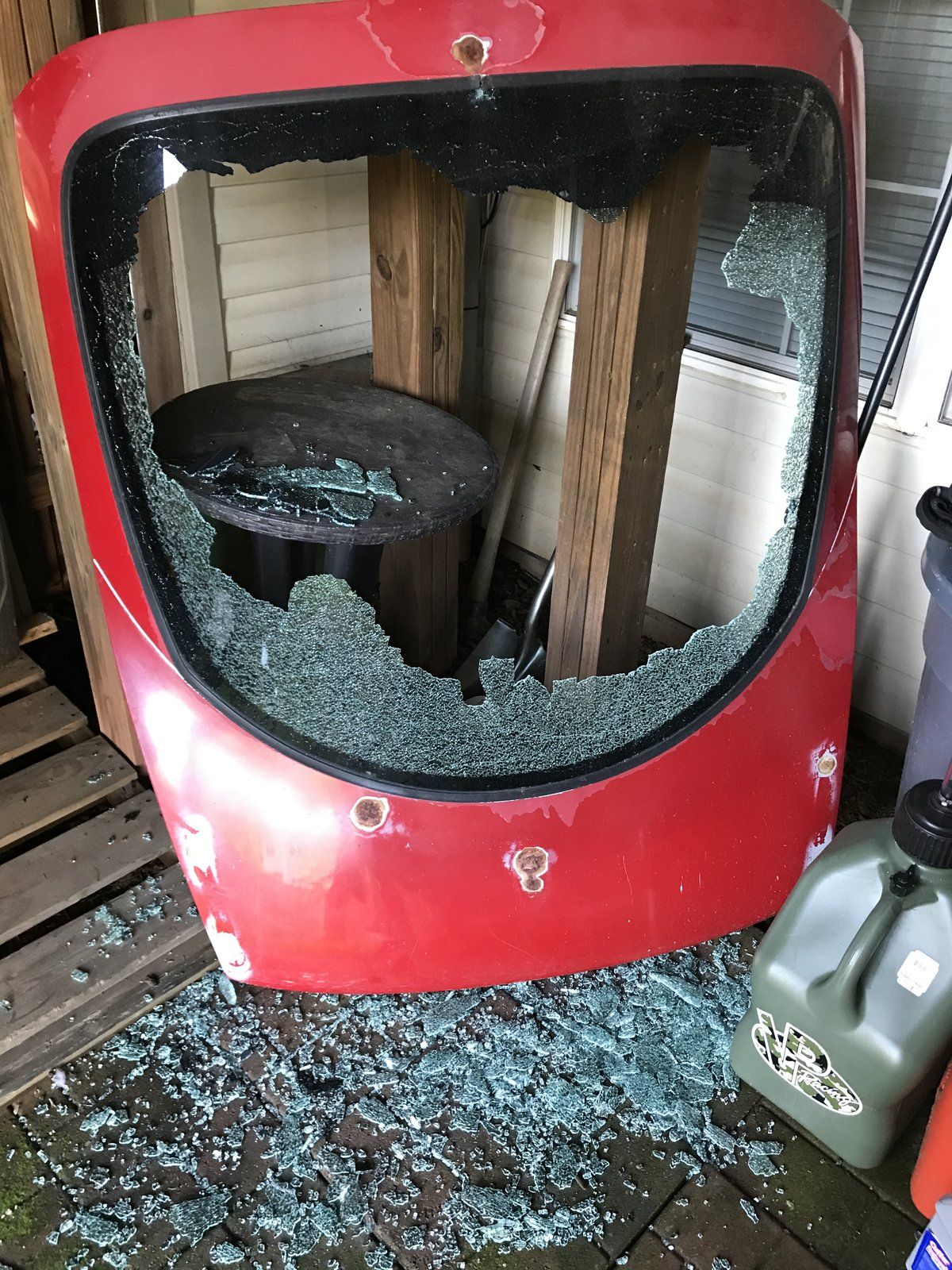

Side note* I tried to pull glass out of the red hatch in the picture below and ended up shattering it instead. I was less then thrilled... Guess I don't know my own strength.

After suffering a small defeat from my first glass removal attempt. I decided to let a shop handle the next attempt... I dropped the carbon hatch, and donner hatch off Friday morning and it was completed that afternoon.
All and all good experience with the glass shop, really not much to say there. Just glad I had a spare hatch.

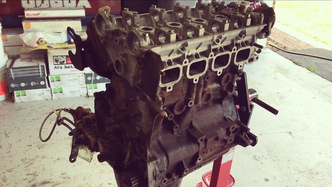

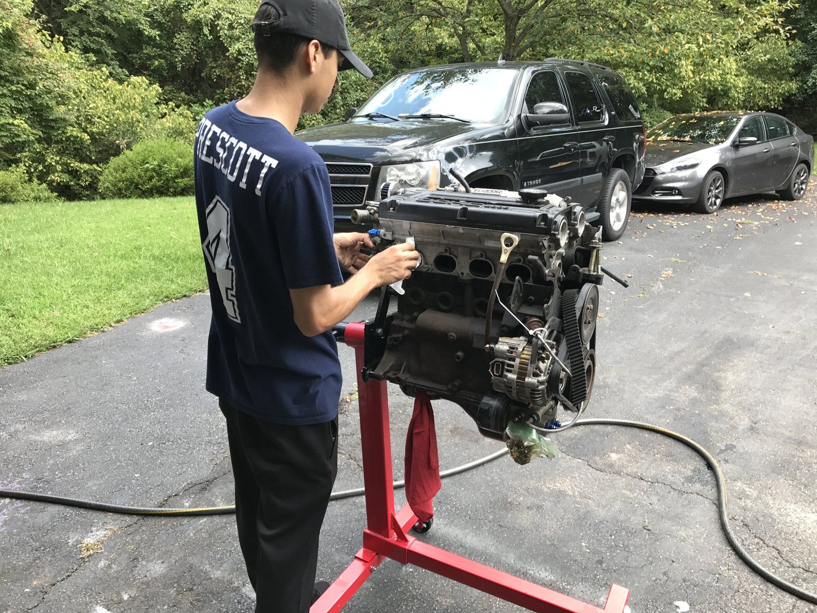

So I have a good buddy of mine named Ray that lives down the street. He owned a EVO X up until early this 2017. Unfortunately there was an "Incident" :rolleyes: with his freshly built HOP longblock that caused it to break a piston completely away from the pin. Due to a lack of help from the shop, and the fact that he just put a lot of time and money into this build. It left him in a jam where he could no longer put more time and money into his evo x. He ended up selling his evo x and all of his parts, and decided to take a break and look for a cheaper turbo car to build. (This is where I step in). I had a 70K Eagle Talon awd chassis just chilling I was looking to sell. Ray decide he rather build a cheaper DSM then a evo and buy a new daily.
So... Ray and I worked out the details, and I sold him the Talon shell and 6 bolt motor to get his project off the ground. We moved the car over to his house a couple weeks ago, but this Saturday we really started tearing into the car. Ray was already pulling interior items for weight. I degressed and pressure washed the engine bay, body, sub frames while Ray degreased, and washed the motor down. Everything cleaned up pretty good. We do need to treat some rust spots on the engine bay though.

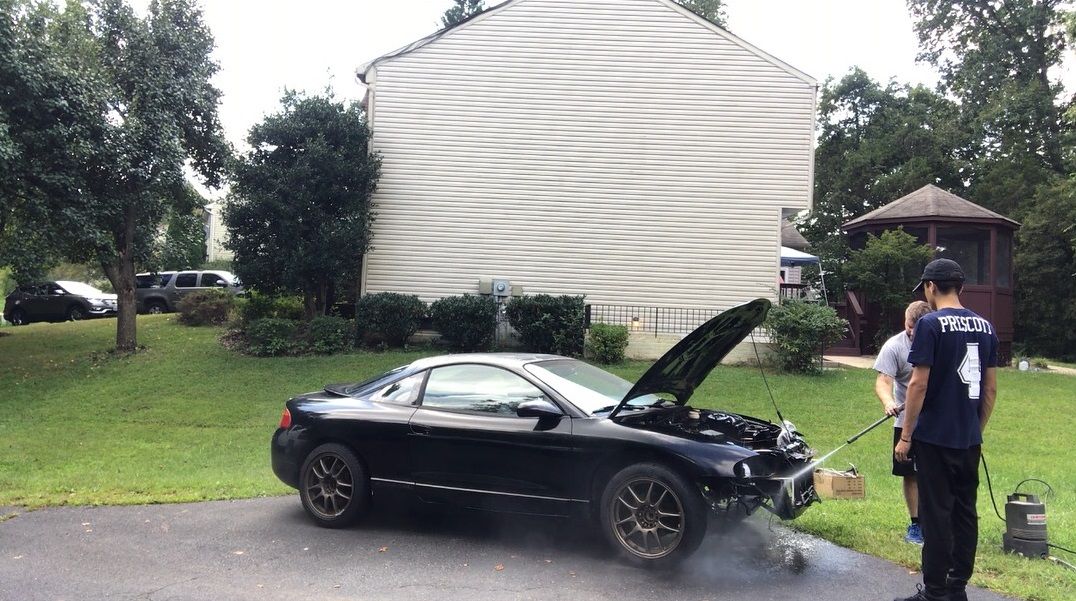

Once we finished drying the motor we took off the valve cover to pull the rockers and threw away the stock lifters. From there we unbolted the intake manifold and tore down the timing side of the motor. Ray is going to do some paint work on the Block, Intake and Valve cover. And I started writing up a list of stuff he will need. Ray will also be dropping off the ALT and Starter to get them checked out. I'm sure they are fine but while its out, why not?
A lot more to come with this build. I will be posting as we get more done.

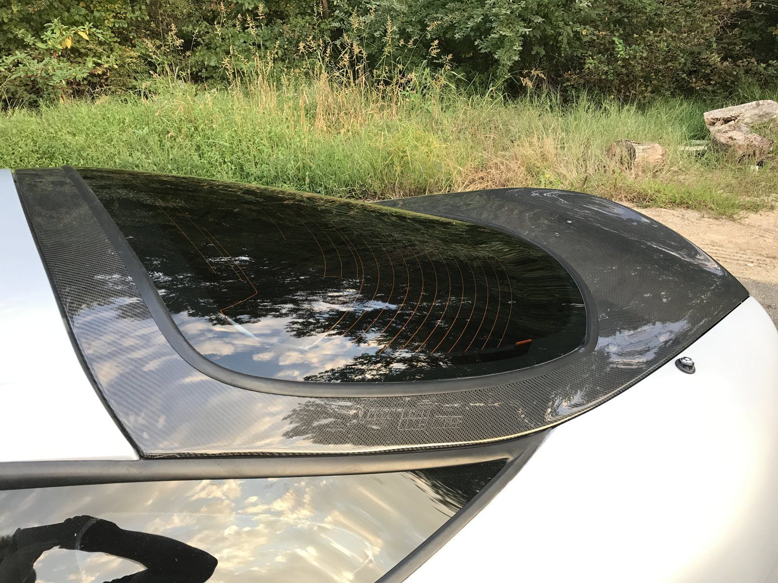

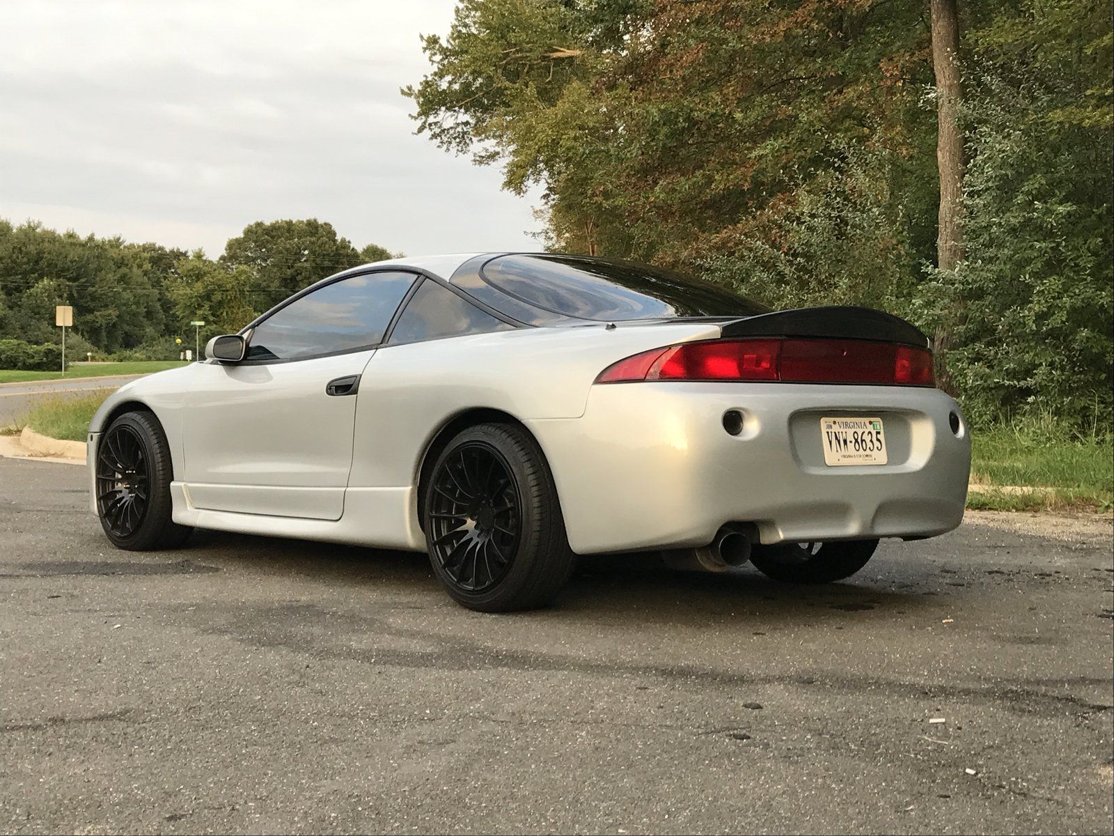

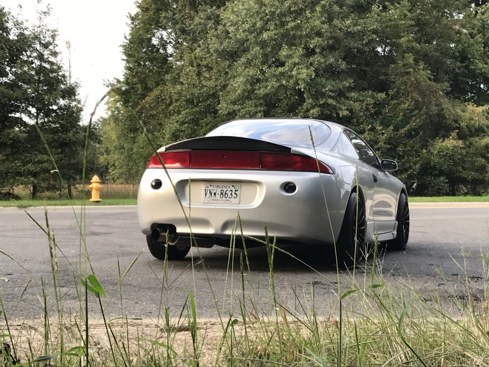

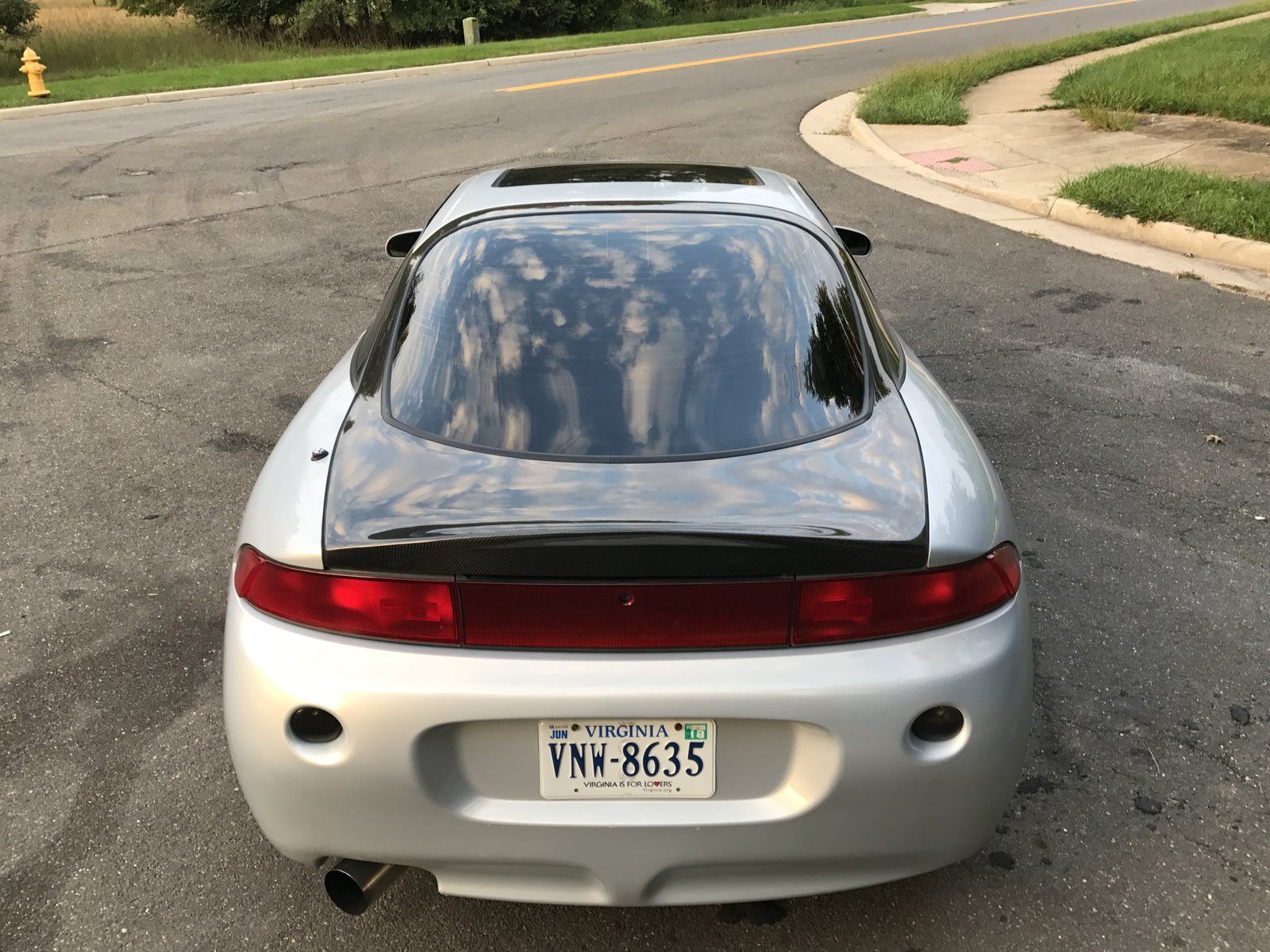

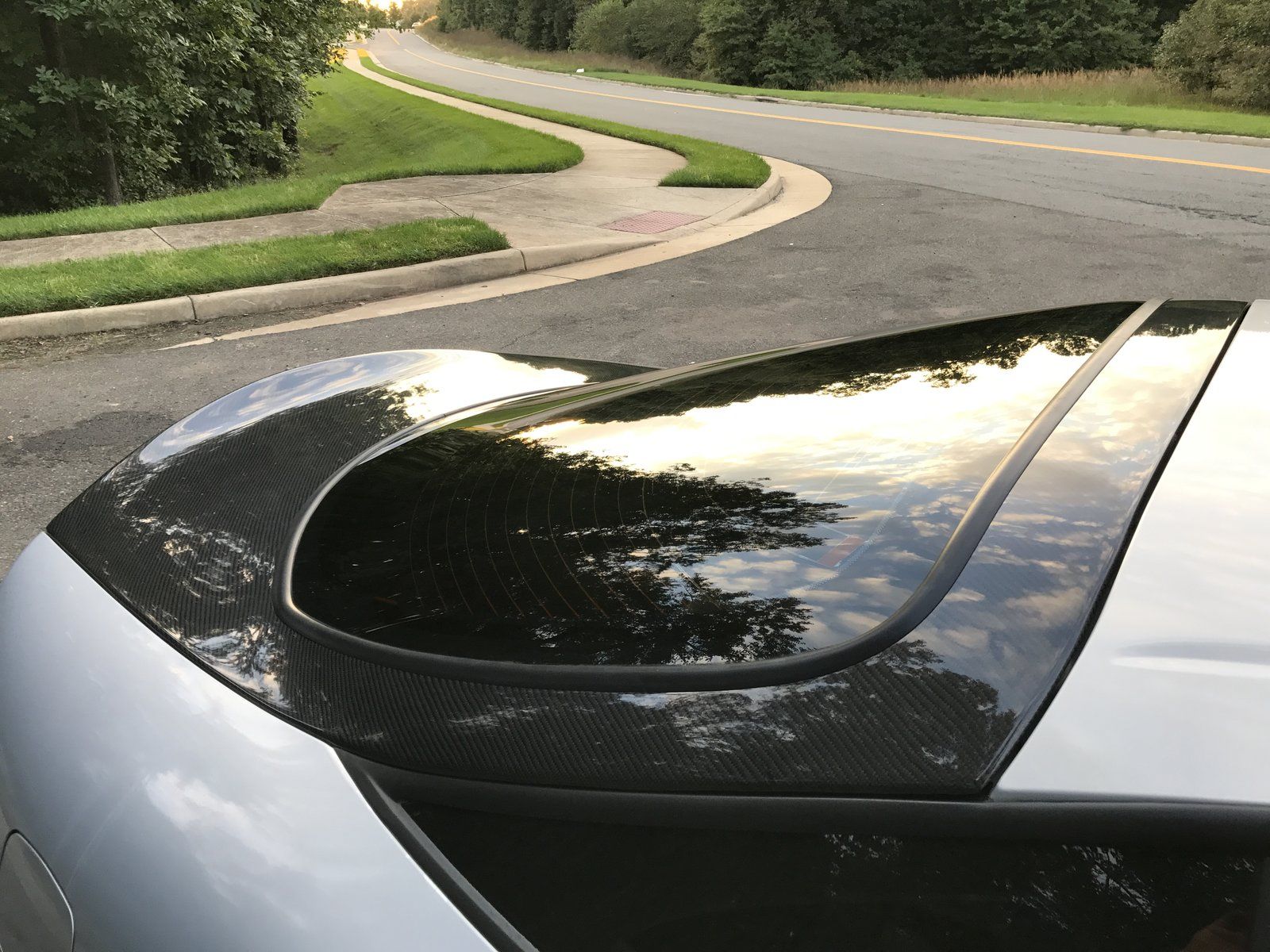

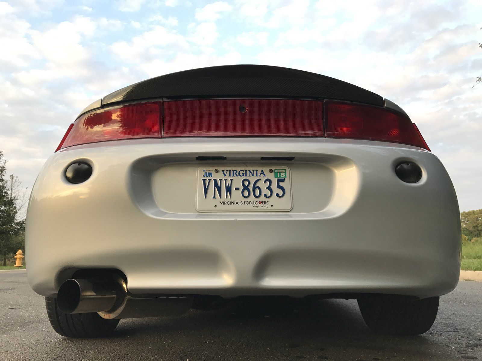

I installed my Carbonetics Hatch!!

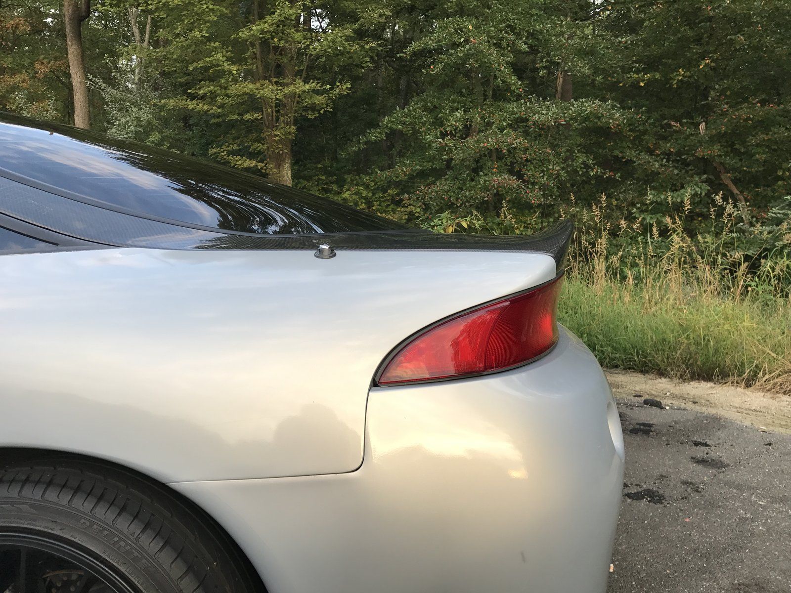

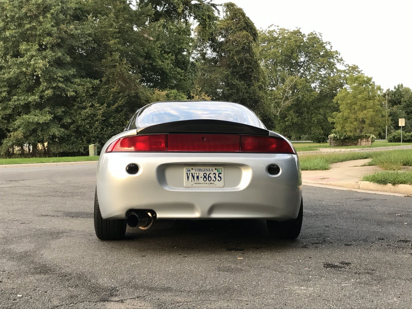

Quick run down on the install. I used OEM DSM glass, and had it transferred into this carbon hatch by a glass company. Install is very straight forward and you can use your oem bolts on the hatch. You will have to transfer your latch into the carbon one.
Fitment was good and the gaps between the body and the hatch are pretty consistent. The right side of the hatch/body is a little tighter, but still fit better then I thought it would and needed little adjustment.
PICS

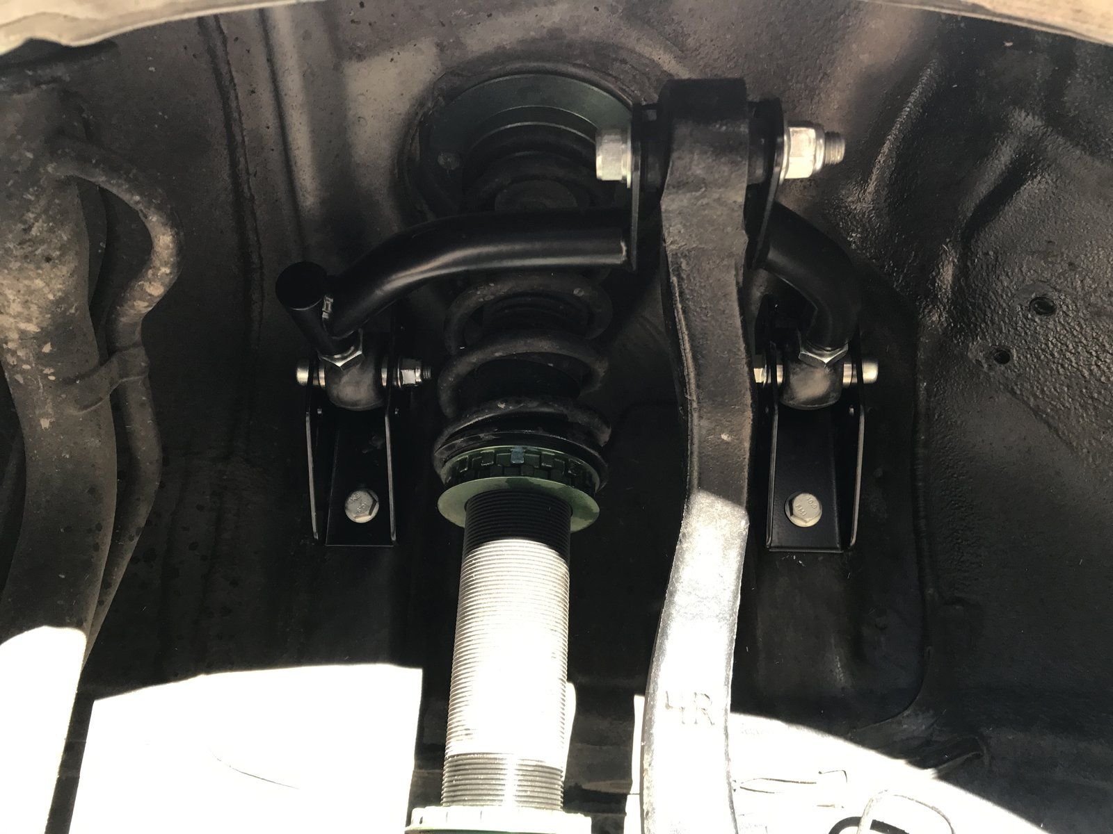

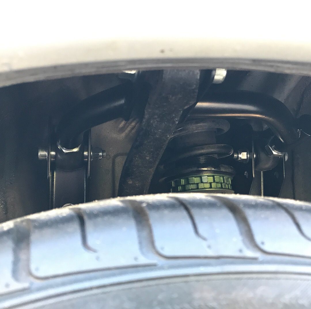

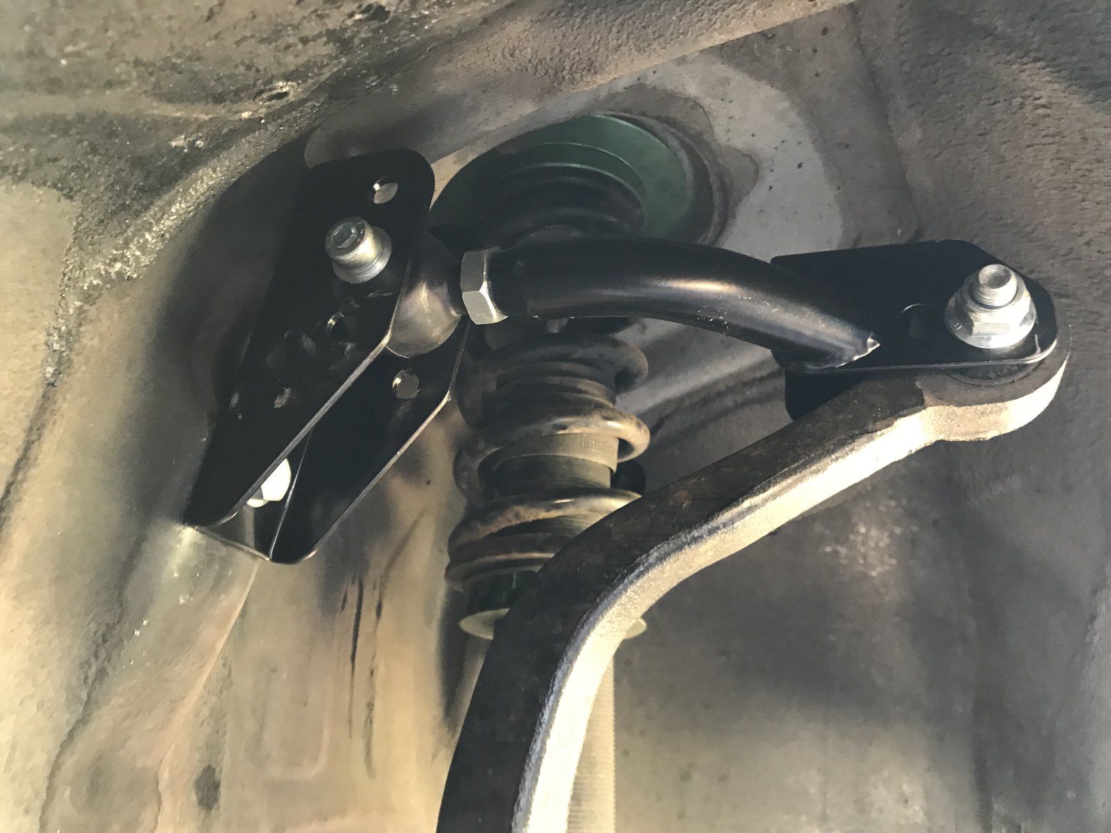

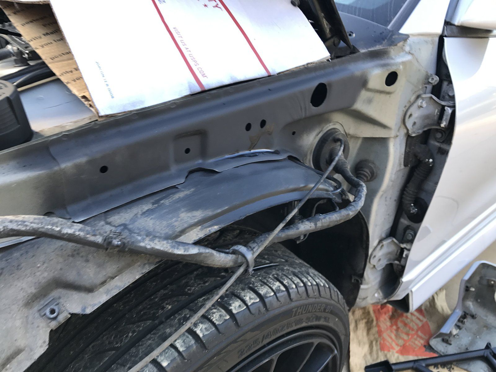

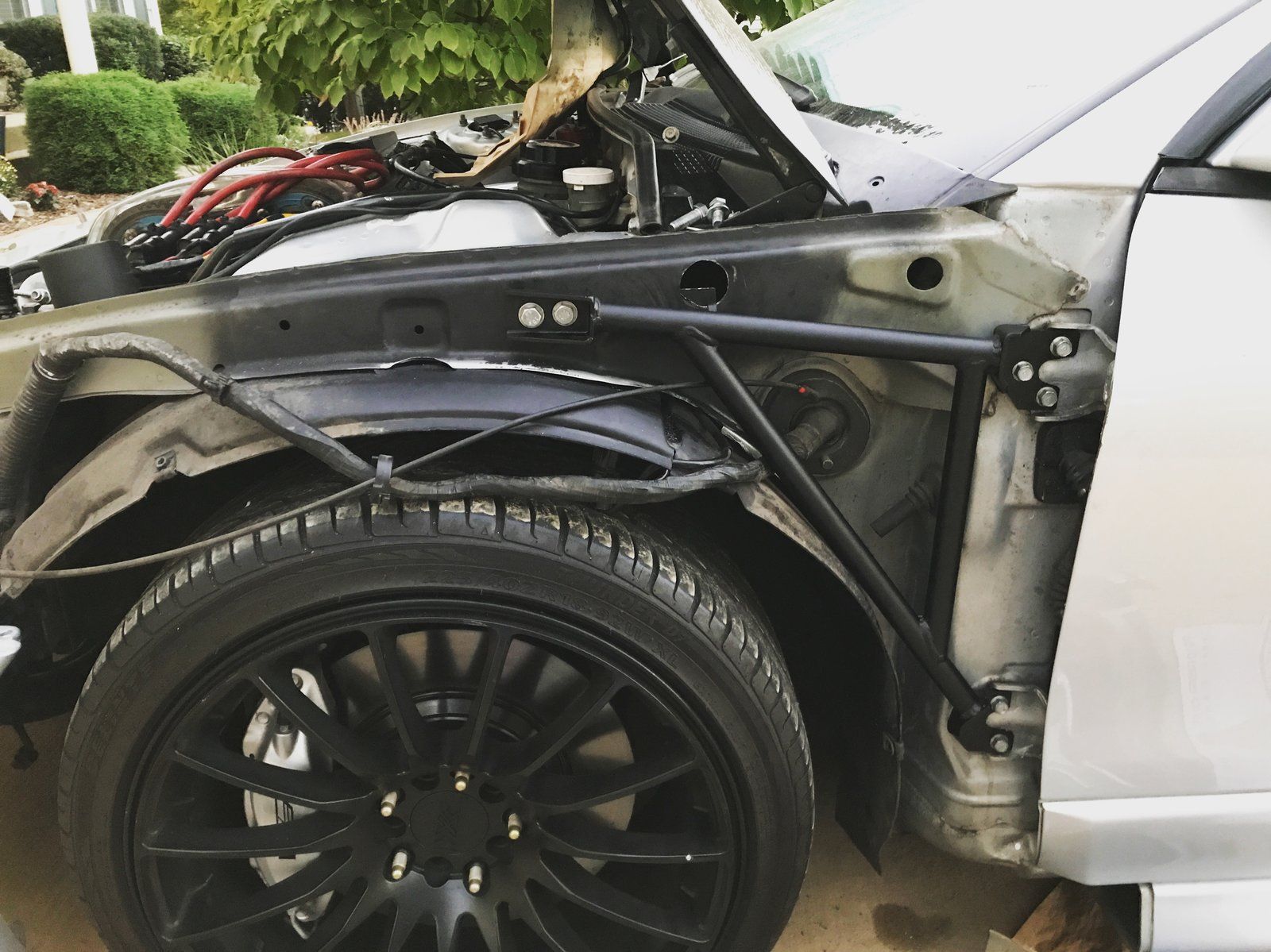

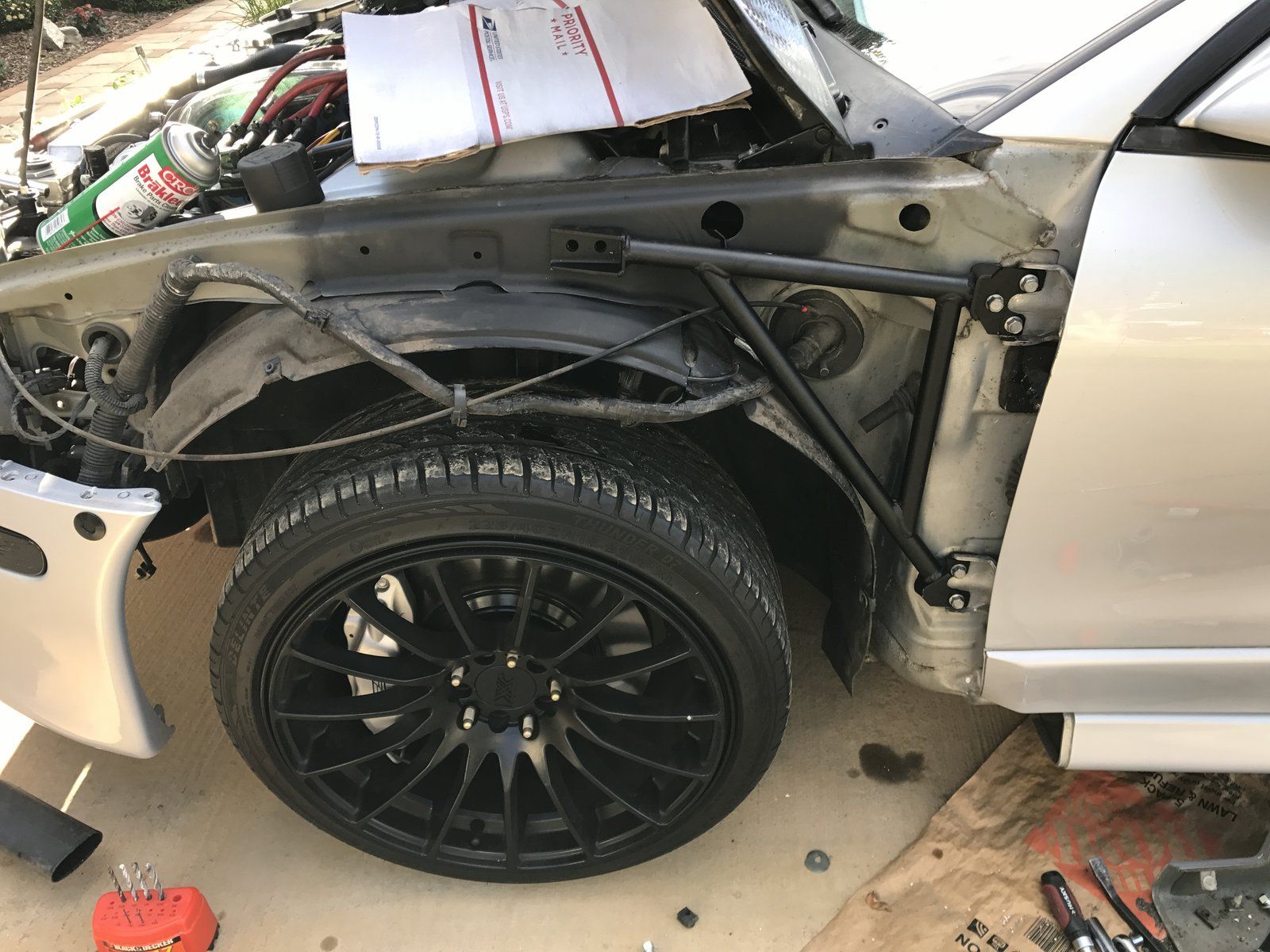

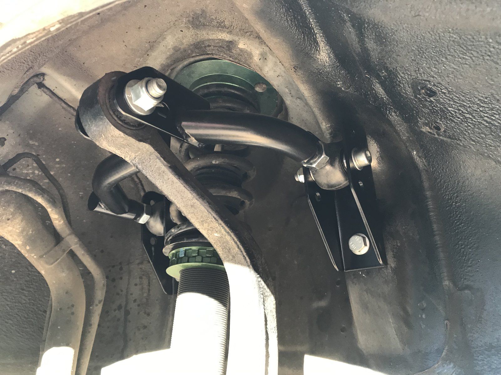

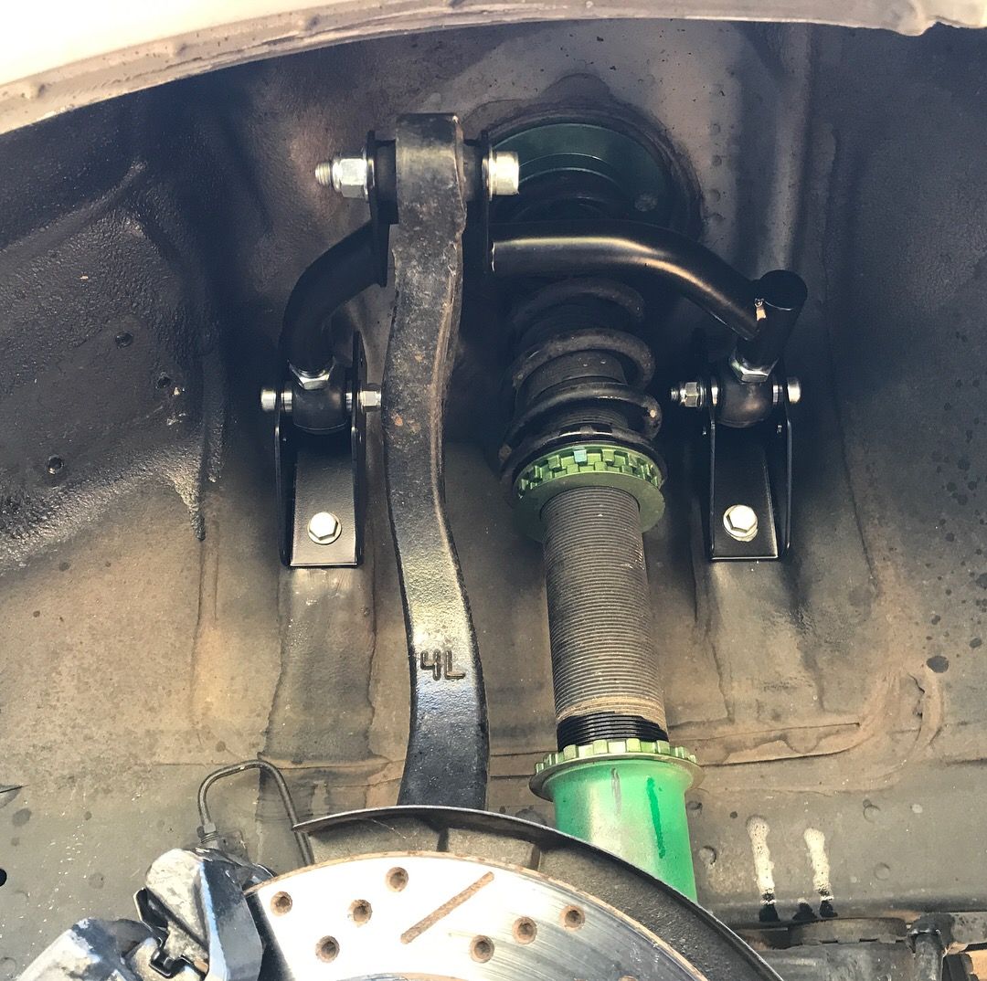

The rest of Saturday I spent installing the Compworks fender braces. Great Product, Quality is top notch, and install is very straight forward. I do recommend having someone help you with holding the door, and aligning holes up. I found the slightest miss alignment will pull on the bolt, and inner bracket. I actually started to mess up the threads on the bracket and bolt. I had to tap and chase them with my die kit, and then continued with the install. Overall the fender braces are easy to install, it just takes time to do this install due to how much fender stuff needs to be removed.

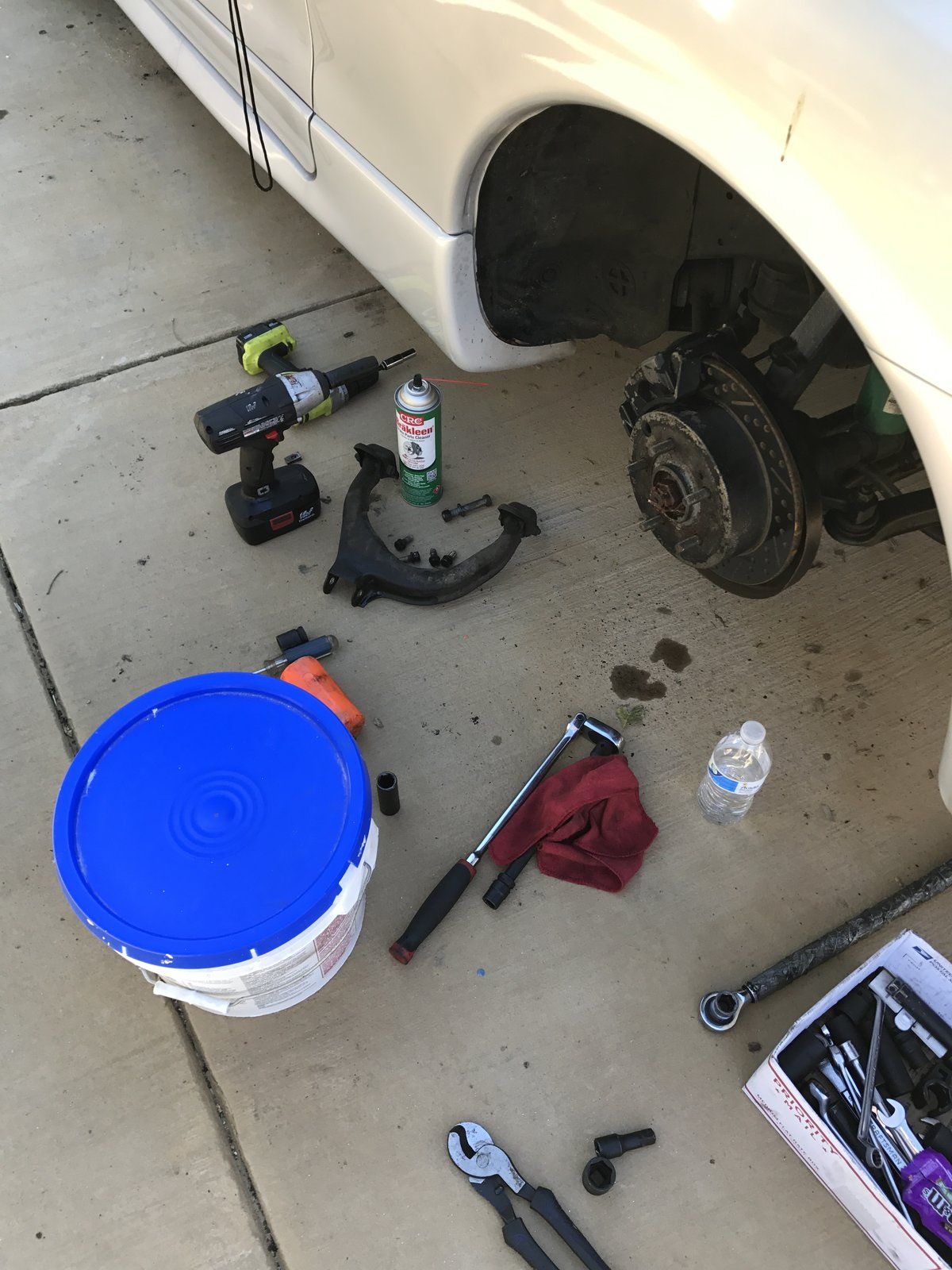

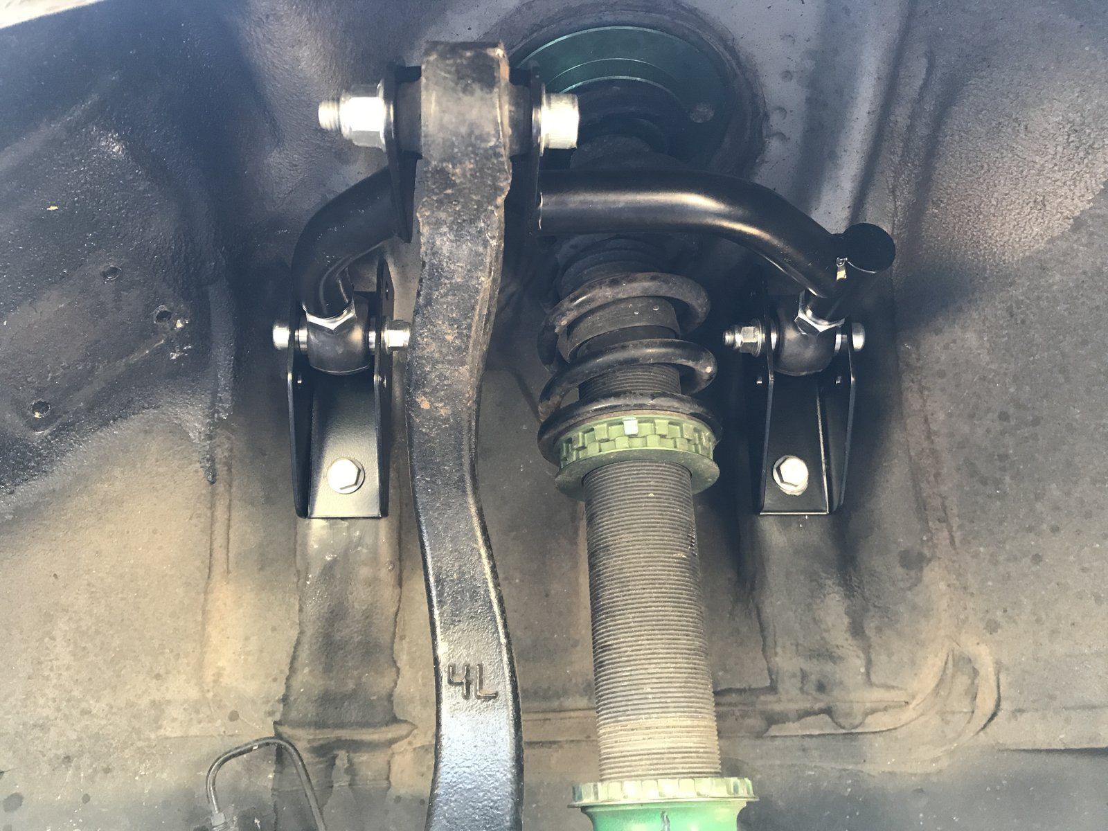

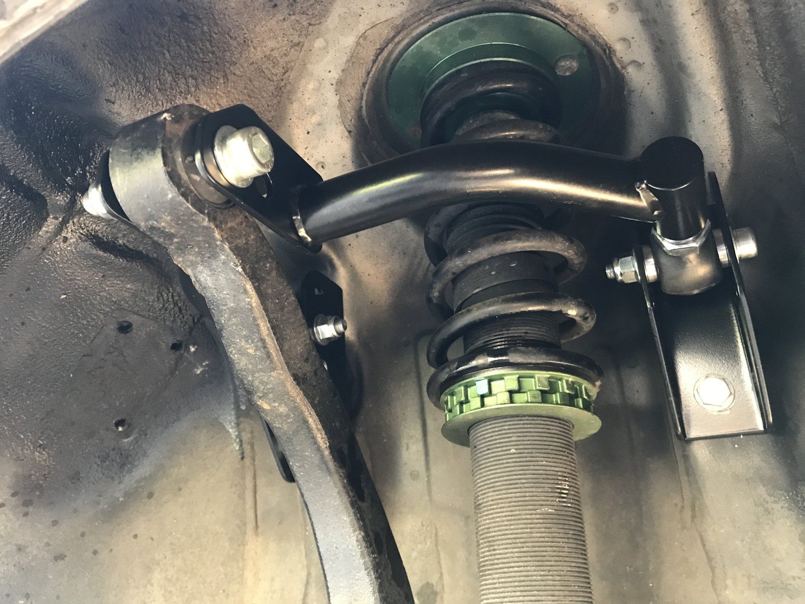

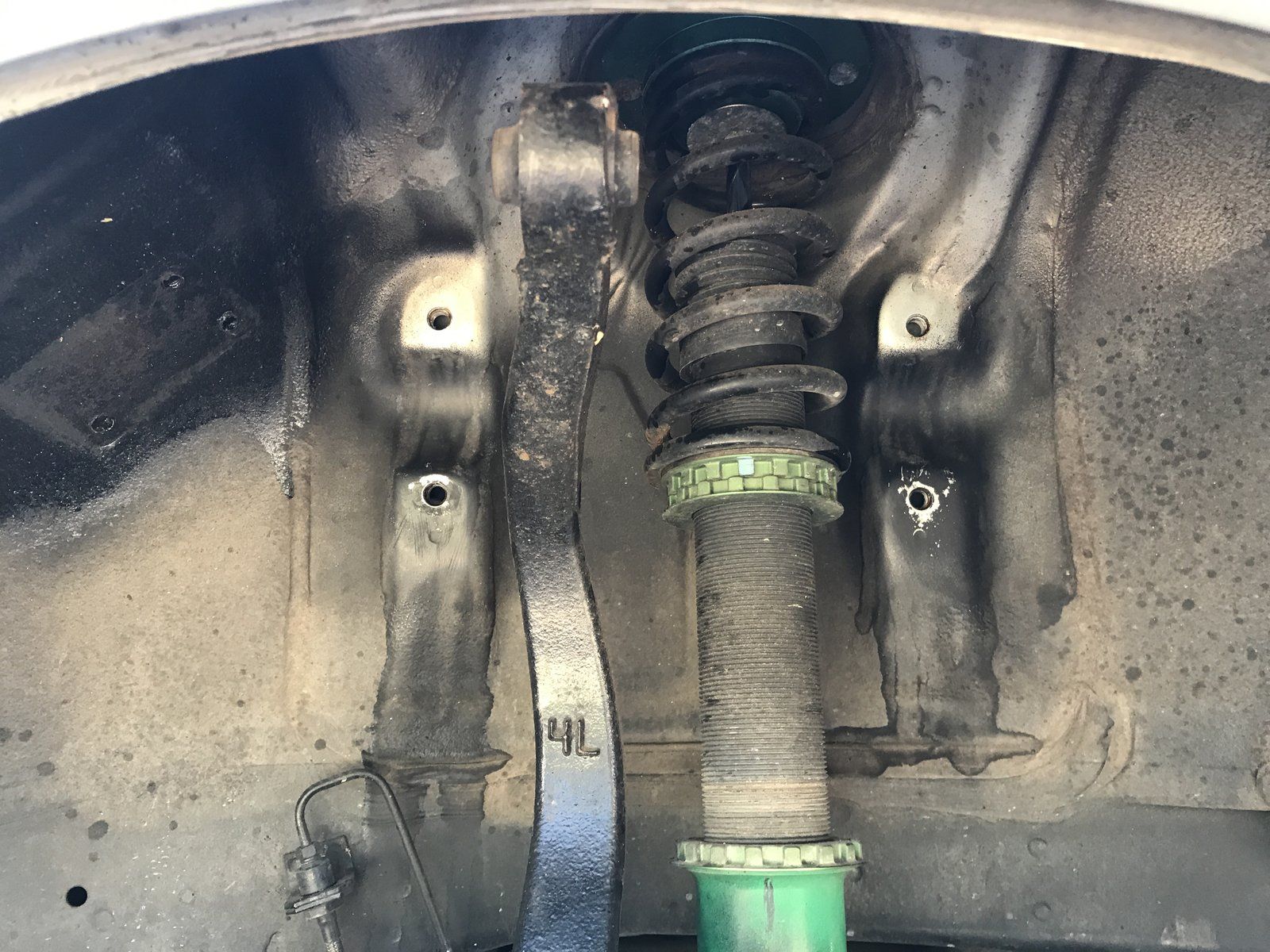

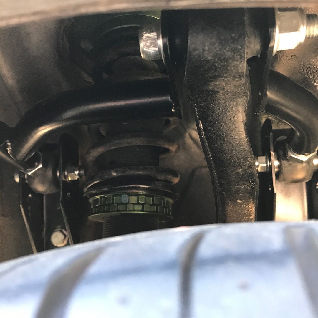

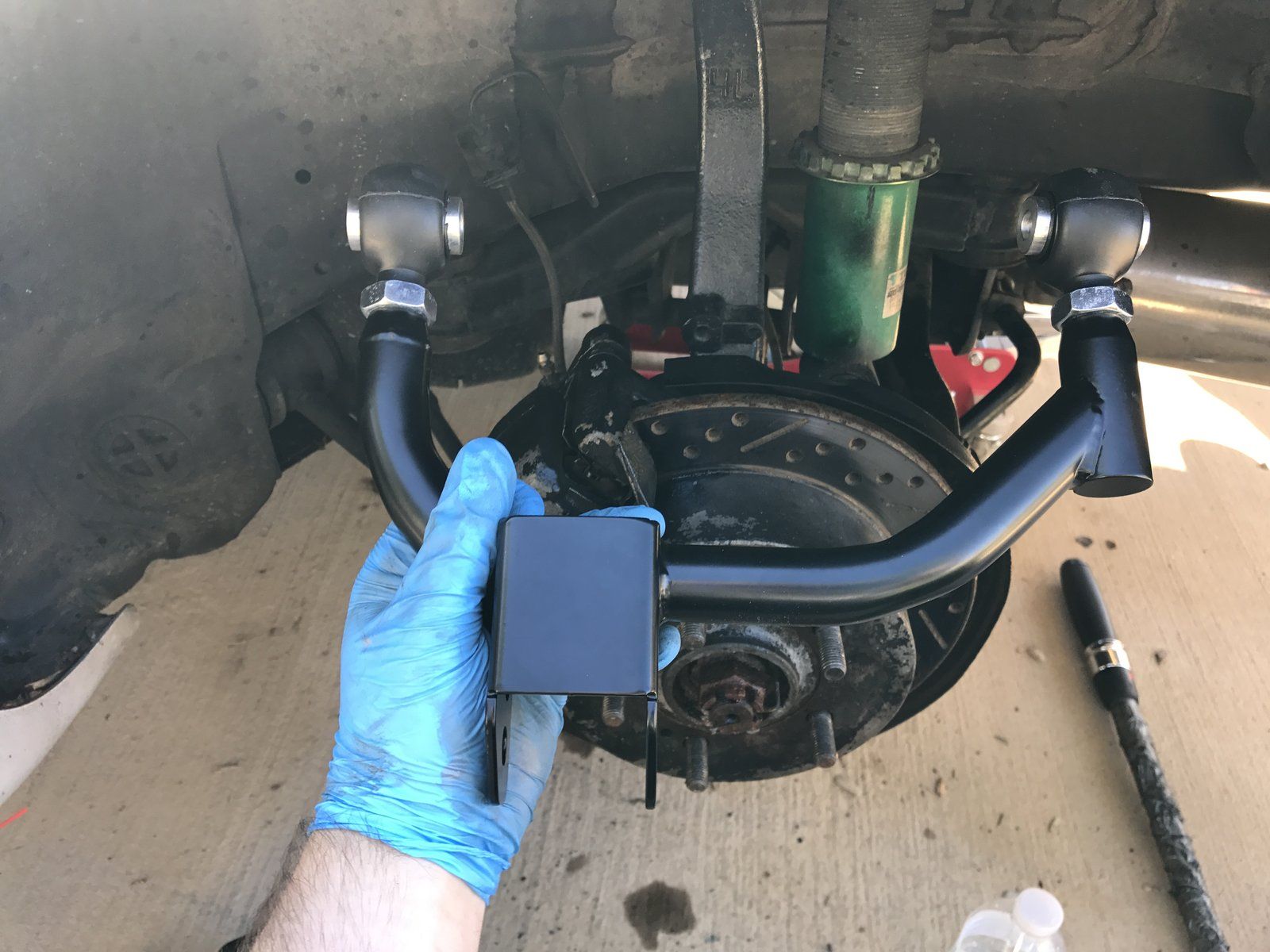

On Sunday I installed my Rear Upper Camber arms. Again a very straight forward process. All of my OEM bolts and nuts came apart without any issues. The weight difference can be seen and felt with these arms. Install was easy and all the supplied hardware is heavy duty and went in with out a hitch. Cant wait to dial all this suspension in.
I will be installing my bump steer and toe kit soon.. Then off to the alignment.

Nothing really new going on the with the car. Iv been focused on other projects. But I was able to drive the car and man what a difference i felt.
The front feels more locked in and responsive to my steering input. The rear feels solid and smooth, and almost as if it is planted more. Looking forward to getting the rest of my parts installed on the car.

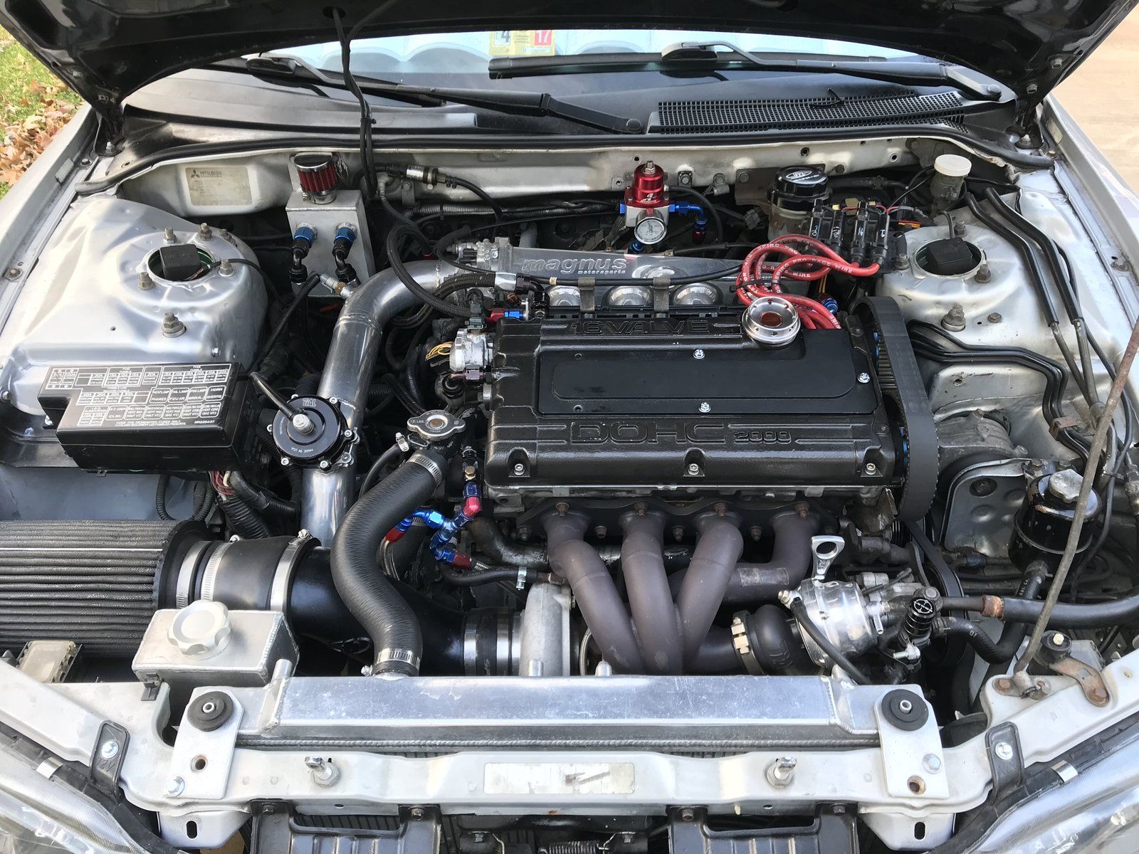

As of now I am also thinking of swapping out my Magnus intake manifold and PTE6262 turbo kit. This turbo kit is so laggy and I want to enjoy Road racing and autox more, then straight line fun.
I plan to swap to CB ported EVO 3 intake manifold & and FP manifold. Turbo I am not to sure about just yet.. Still doing my research.

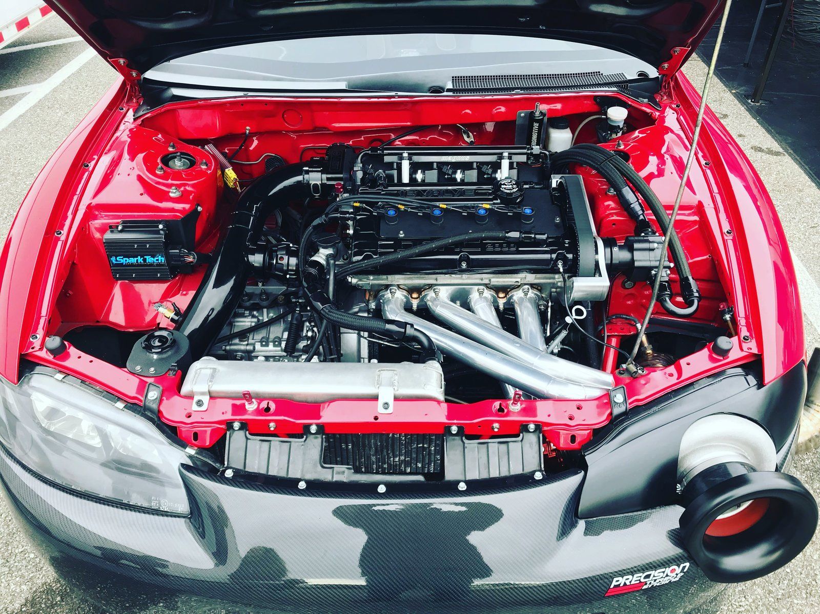

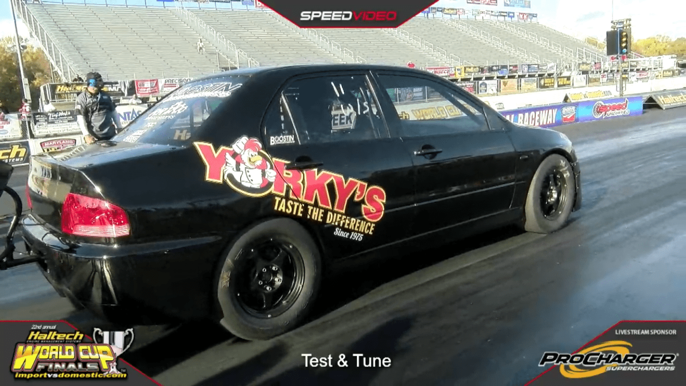

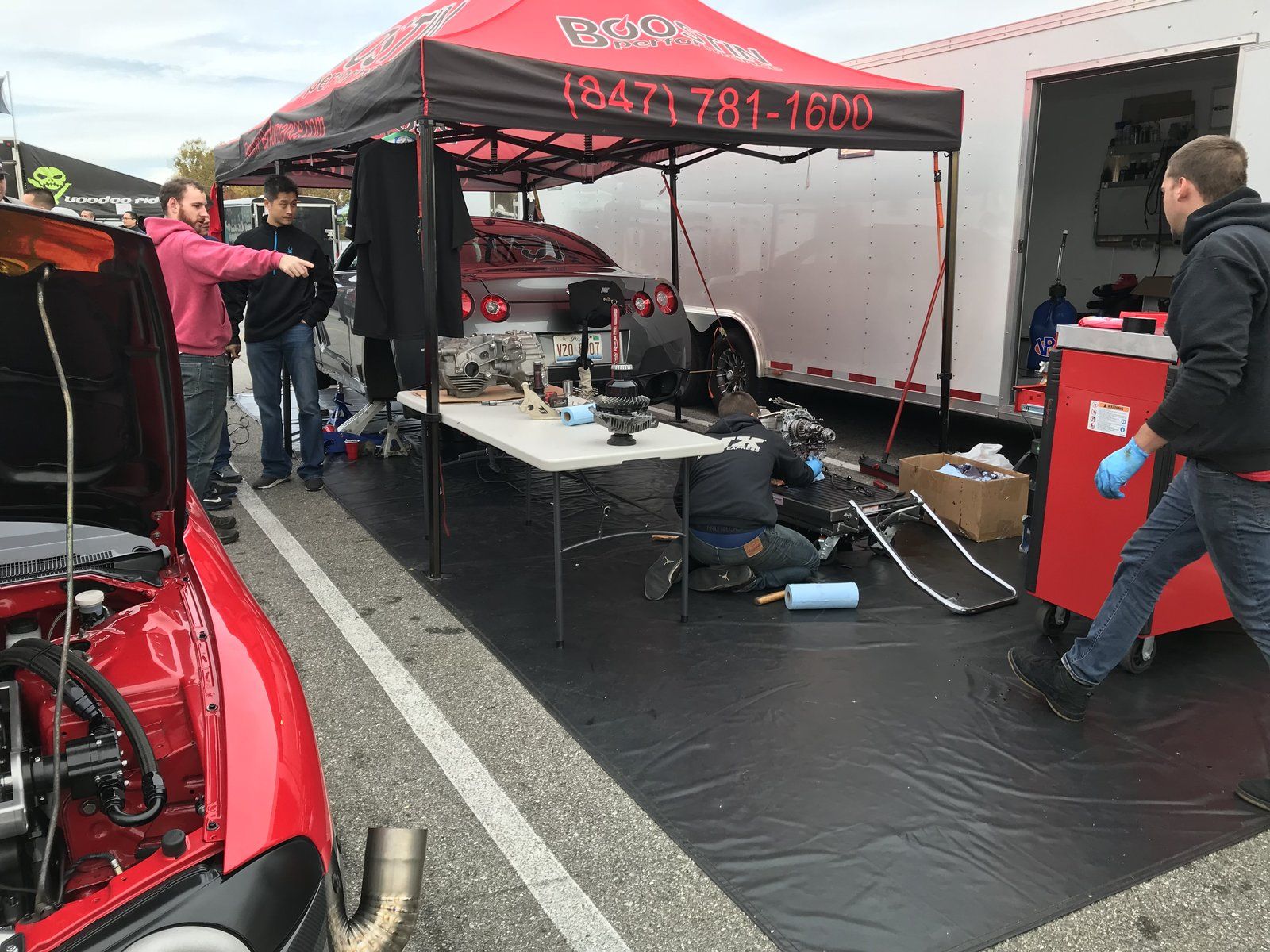

First up Boosting performance EVO 8. This Evo currently trying to win the "7 second bounty" competition. The bounty is essentially a winner takes all comp for the first Evo that can break into the 7 sec field. The prize is a $17k or so payout. Pleas don't quote me, I don't know all of the details but essentially it is a cool way to make the evo guys push the limits of 8/9 chassis.

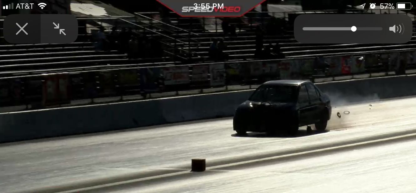

Sadik was pushing the car all weekend, but during test and tune he lost a trans. Check out the gear and clutch material go flying!! He was back up and running the rest of the weekend but was floating around the 8.0 field.
Boostin Performance GTR lost a rear diff at the launch. I'm pretty sure It didn't recover to run again the rest of the weekend. I saw it on jack stands while visiting the boostin tent.

Finally got back on and figured I'd check in to see your review of the hatch. Curious as to why you decided to keep the window trim? Personally, I think it looks much cleaner and modern without. @Limegrntaln pm me on that 99 you're looking for..
Not sure I follow.. Are you talking about the rubber that fills around the glass?
Correct. I had my guy put spacers behind the glass to get it flush with the hatch. Looks much more modern IMO
I kinda follow what your saying but the dsm glass is not a modern design at all. So rubber is fine with me. Also it will stop debris and moister from getting inside. I don't mind it at all.

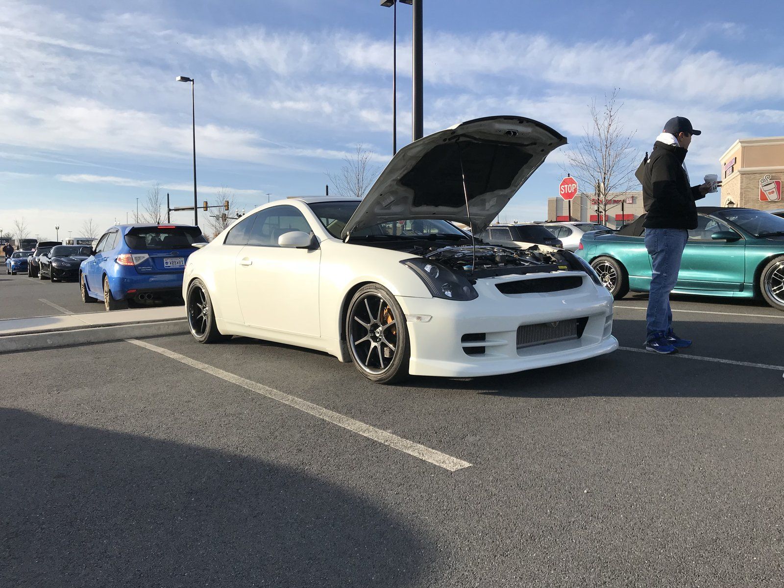

Also took the GSX out to cars and coffee with some friends on Sunday.
Here is an AWD swapped spyder, and TT G35
And the Daily Driver Dream.... one day.

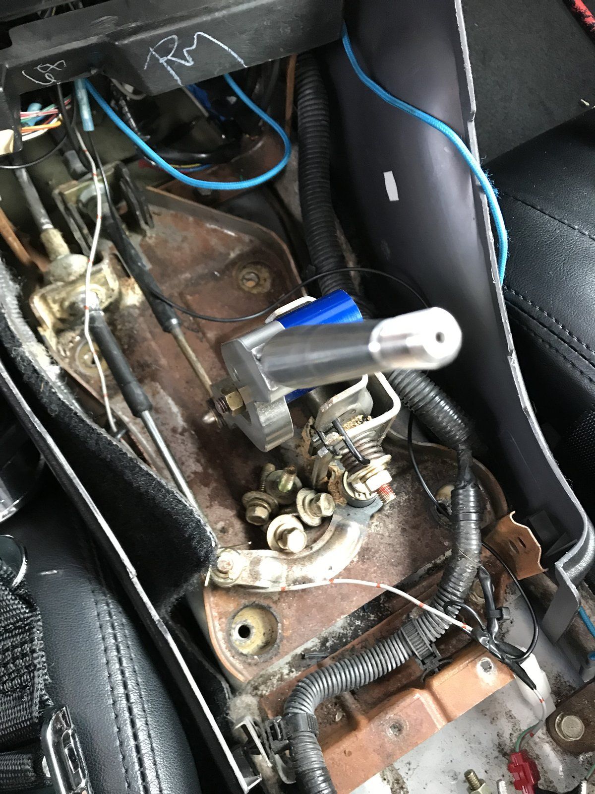

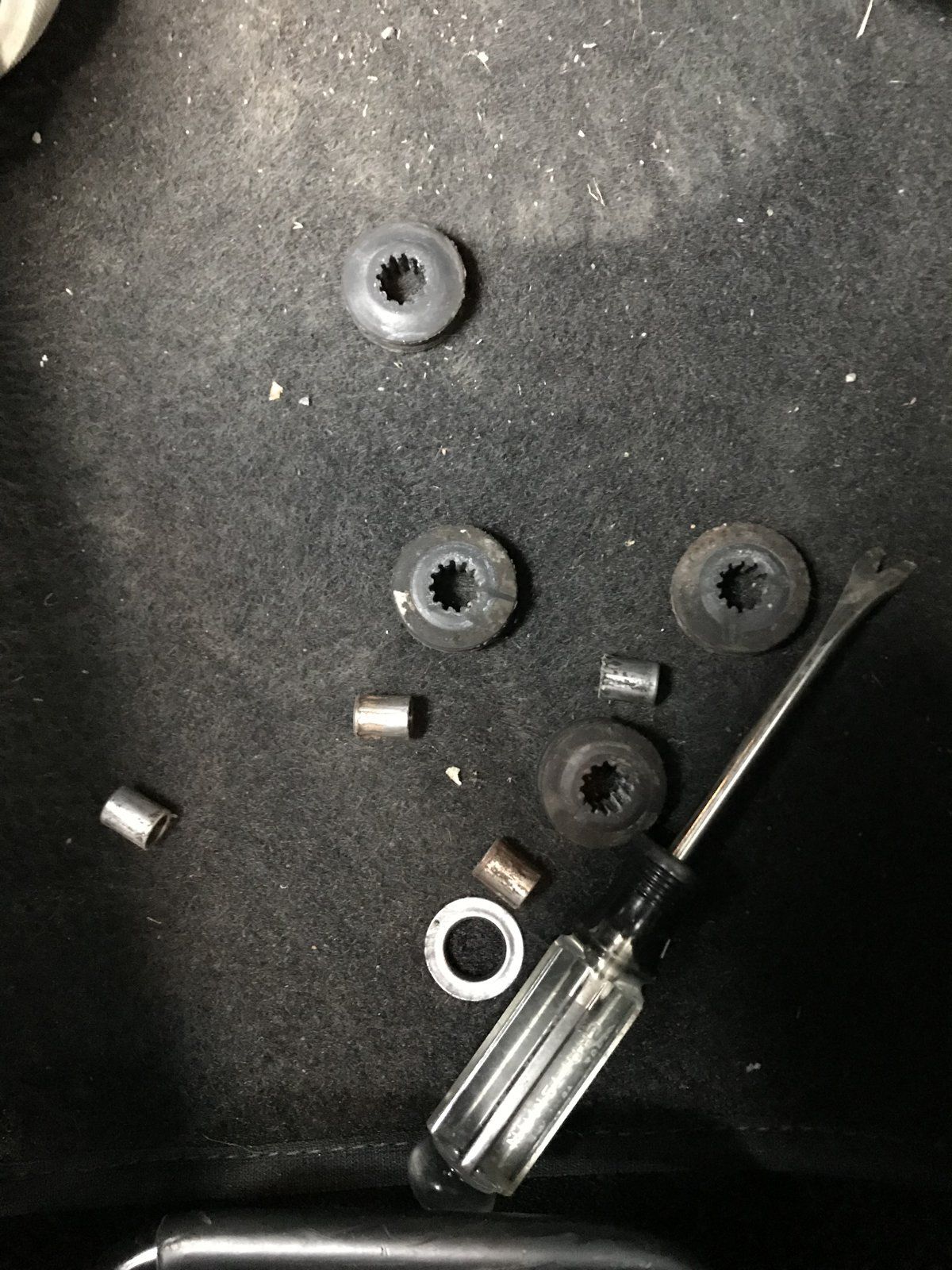

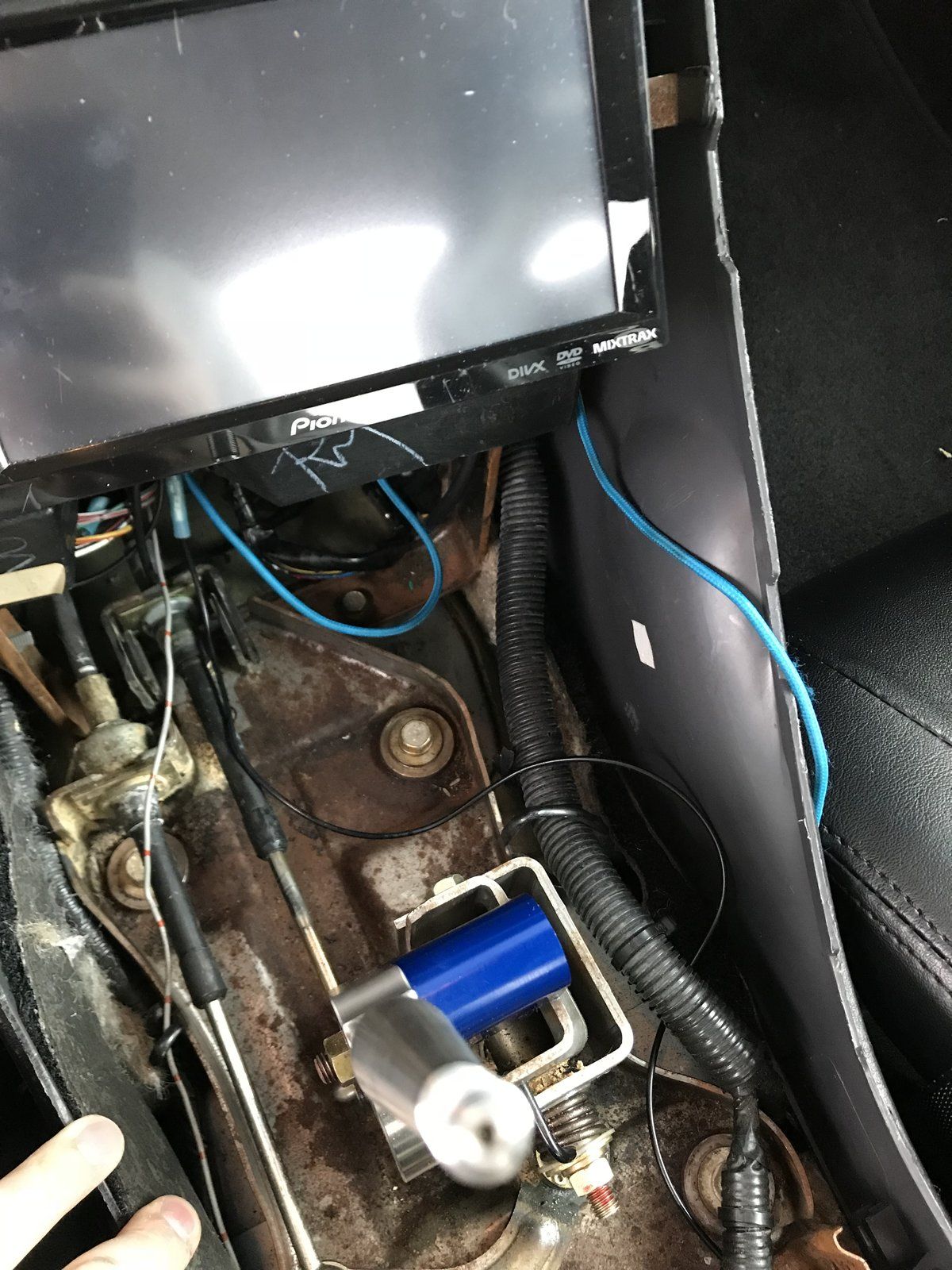

I also Decided to install some solid shifter bash bushing I had sitting for a while now. I was still on the factory rubber bushings if you can believe that.... Feels a lot better matched up with my B&M shifter.

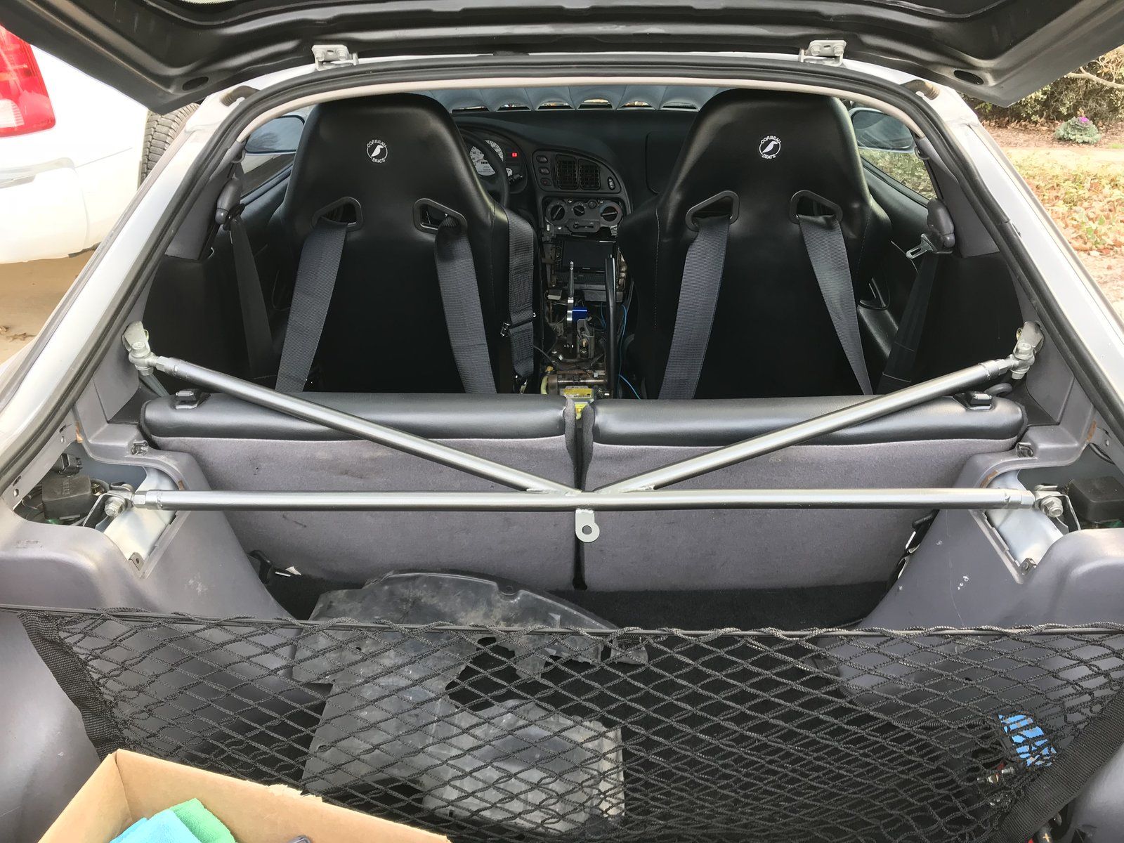

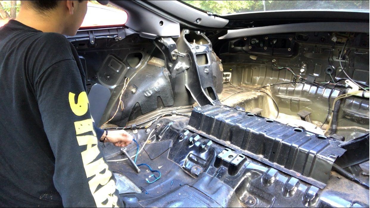

I also decided to add a rear trunk brace I have had sitting for a while. If anyone is wondering.. NO I don't know who makes it or where it came from unfortunately. I pulled it out of a talon I owned for a little bit, and just hung it on my wall for about a year. I think it looks great but it doesn't allow me to fold down my rear seats at all.

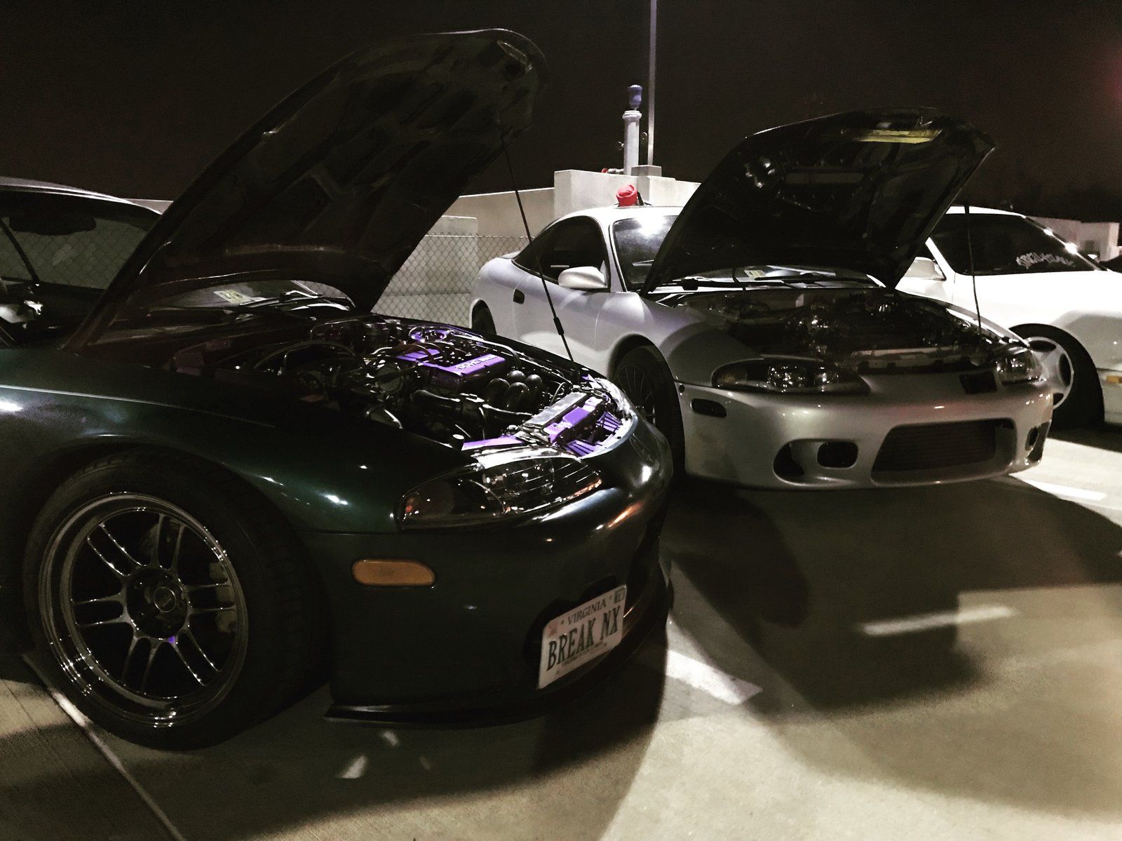

Also my buddy with the AWD Spyder, hit me up Saturday about a car meet that was going on in a rented parking garage. Sounded like fun so we rolled out to Maryland for the night. FIRST off I am really pleased with how the GSX ran and drove. Dave has a awesome tune on it. Put about 150+ miles on the car in stop and go traffic and 35 degree weather. It never missed a beat. I do need an alignment, and tires balanced though..
Both of our cars got a decent amount of attention. We were asked to line up for a quick photo shoot and video footage. Hoping it makes it into the final cut...
