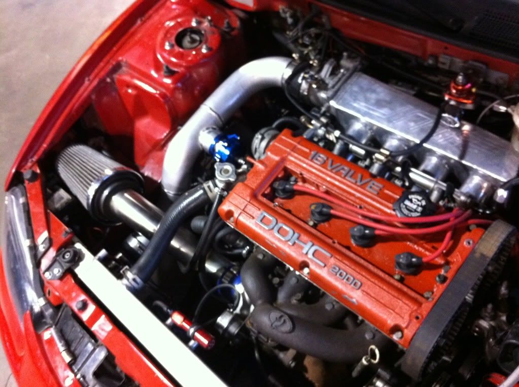

UPDATED
Car:
1998 Mitsubishi Eclipse GSX
86k
6 bolt swap
Turbo/Exhaust
-HX40 7 blade w/ BEP .55 housing
-Punishment racing ext. o2 housing.
-Tial MVS WG
-FP Cast Manifold
-Megan DP
-SRS CB exhaust
Motor
-Stock crank
-CP Pistons
-Eagle Rods
-ARP Mains
-ACL Bearings
-Felpro Permatorque
-ARP Head studs
-GSC Springs/Retainers
-GSC s2 cams
-3g Lifters
Intake
-3' Pina Motorsports Intake
-SBR Intercooler Core
-3' Aluminum Intercooler Pipes
-Q45 Throttle Body
-JMF SMIM
Fuel
-Wally 255
-Fuel Lab AFPR
-FIC 950cc
Engine Man.
-DSMLink V3 (Full)
-AEM Wideband
-AEM Boost
-SD Conv.
Note: I will replace all necessary OEM components to support the build.
I'll add my build list once I have most of it completed.
I look forward to adding to this, and hearing from you guys.

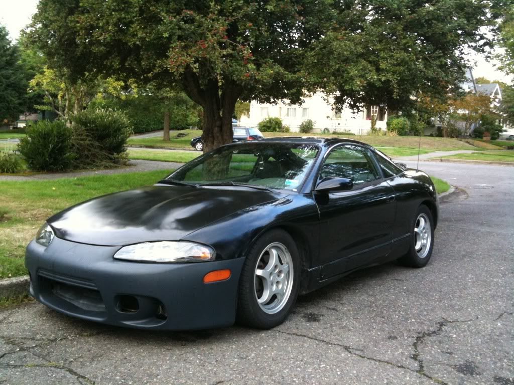

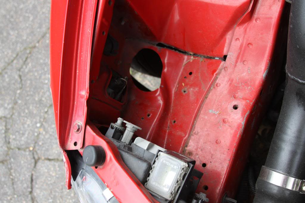

I was on my way home from Salem, I had just taken a final and was running on absolutely no sleep. I had pulled an all nighter and could not wait to get home. I was eager to get home because I was going to be pulling my FP Green off the car and trading it for an HX40 that night. I just had to get home so I could move the car into the garage to work on it. I began to get extremely tired and could feel myself starting to fall asleep driving home. This was in my evo X fortunately, so I was able to pull over and pass out. It turns out that this was the better decision for me, but I'm still kicking myself because of what's to happen. I had pulled over in a gas station in Kalama, WA. About 2 hours from my home in Tacoma, WA. The drive from Salem, OR is about 4 hours with Portland traffic. I pulled over around 10:15 and fell asleep almost immediately. I set my alarm for 12:15. I awoke and started driving.
I drove up to my house a 2:25 to this:
It appeared only to be on the exterior,then I noticed this and really got nervous.
But after talking to Jaxness. She explained a bit about what she did to keep the cars overall estimate under control.
My neighbor had watched the whole thing. And assumed because the guy had left a note that the whole situation was going to be okay. It turns out the guy left a note merely saying "sorry". and now the car is getting prepped to be painted.
The damage is about 2500-2700$ worth of work. Note, this did not total the car which was pleasing. So it does still have a clean title Which after owning it so many years was VERY important to me. With all this said, I do still kick myself. If I had slept a bit less the car would have never been there :ohdamn::ohdamn::ohdamn:
It is what it is, and the car will be fixed.

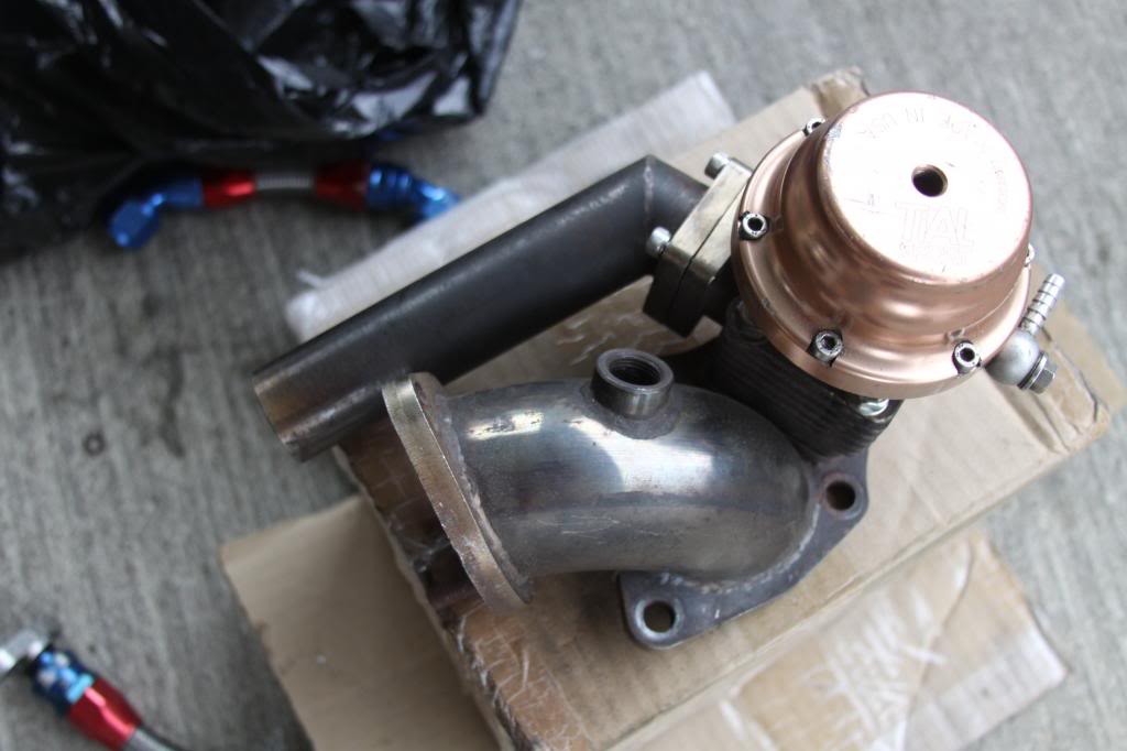

I didn't do much due to the weather. I cleaned up my JMF manifold and coil pack relocation bracket with the Eagle product. It worked wonders!
After calling the body shop and the insurance all day. I got ahold of my buddy with the HX40 and we decided to meet up near Seattle. We chatted for an hour, reminiscing about the older DSM up days up north. Back when I was 14-15 I used to tag along to the events and cruises. Then there were a ton more DSM's and fewer Evo's. Now it seems to be the reverse up here in WA. Very few of us DSMs compared to the Evo community. With that said even the Evo community is fairly small.
I'll stop jibber jabbering and show you guys what Bryan hooked me up with:
Holset "super" 6 blade HX40 with the BEP .55 housing.
The turbo is in nearly perfect condition as it was just rebuilt. I plan to have the o2 housing ceramic coated with my FP Manifold.

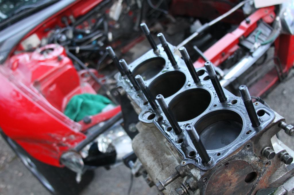

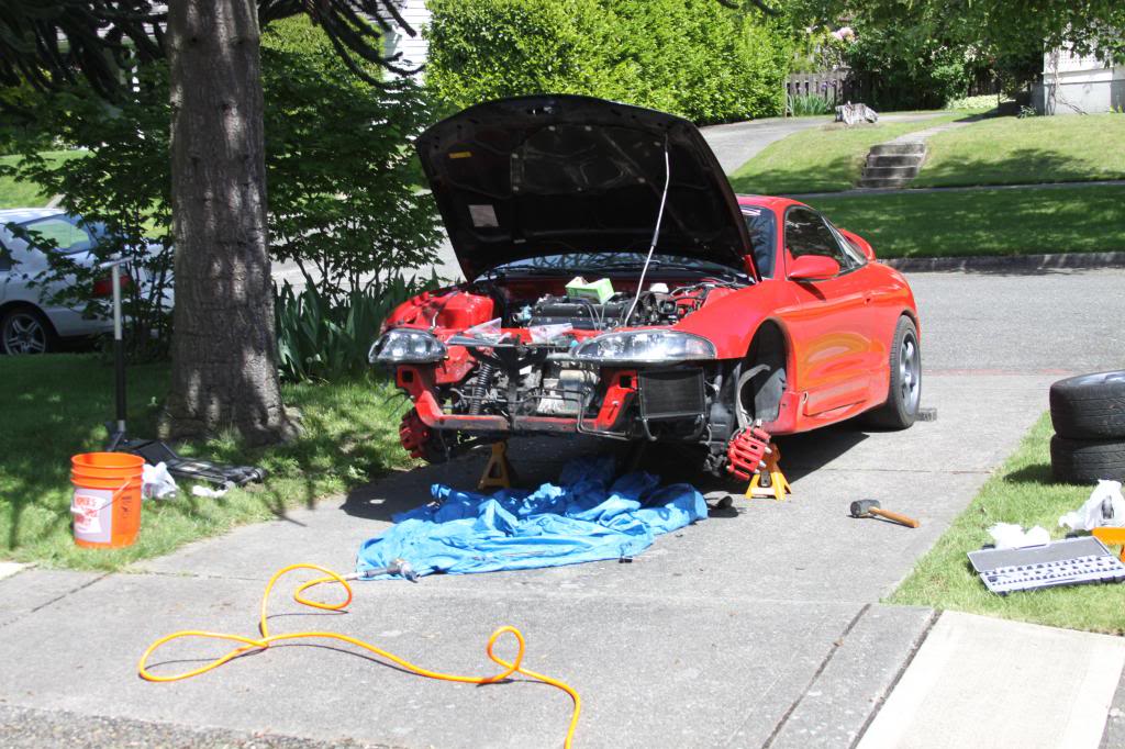

Well, I decided to pull the motor out before the car left for the body shop so I could put the new head gasket, oil pump, water pump, timing tensioner, and belts on. And boy was in for quite the surprise.
Lets get some history on this motor real quick, I covered a bit but we'll go deeper into it.
A long time ago I had motor built with wiseco pistons, eagle rods, and a stock 6 bolt crank. The car ran for about 40 miles then spun multiple bearings. I didn't have a ton of money at this point and my buddy had a motor laying around from years ago (only had about(10k miles). So, I picked it up cheap. I took it to a machine shop, they looked through the motor. Aside from normal wear, the motor was fine.

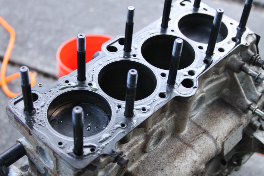

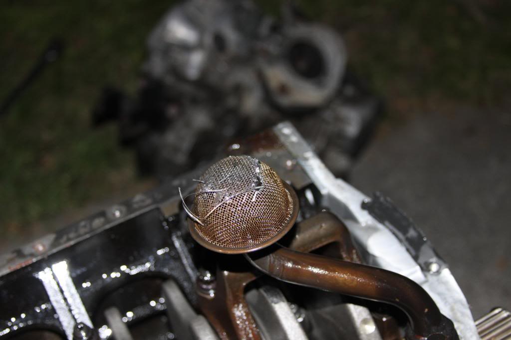

After removing the motor, I decided to reseal the pan.I pulled the pan and immediately found metal shavings laying at the bottom of the pain. Then, on the pick up:
The shavings are from the main bearings only. My assumption is that there was some oil starvation. The rod bearings still look nice and fresh.
Here are some photos of the days work (don't have a place to work yet as i'm still moving home. Hopefully will have a house/garage soon) :
Head gasket looks about done.
Getting the motor ready to come out.
Motor is out!
Boom, ready to go.
Well, that's what I did yesterday.

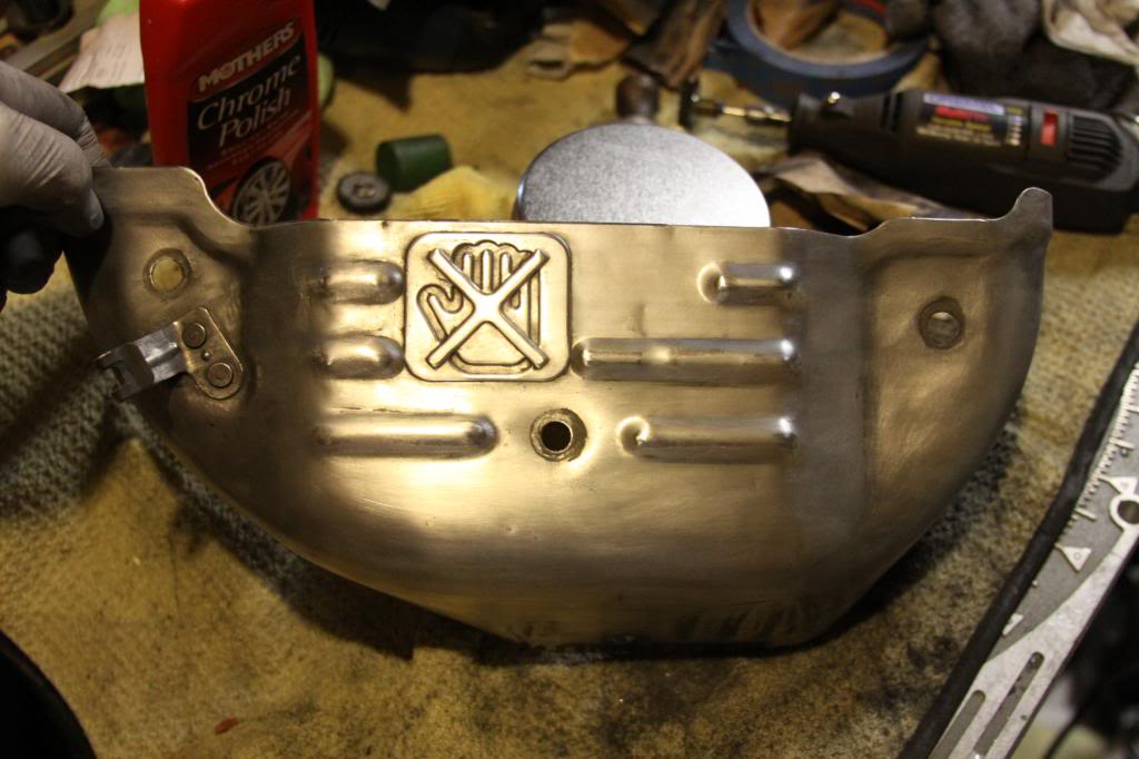

So, I also have been polishing random parts and a friend wanted to hold on to my ARC heat shield off my evo 8. So I decided i'd throw my stock on there. But first I hit it with the dremel. I'm finding that using the dremel for polishing purposes (especially with a larger surface/part) is difficult. For many reasons but specifically it is time consuming and is easy to become uneven and streaky. Still very new to polishing, but it's a fun hobby. But here's some of the polishing i've been doing.
Before:
After:

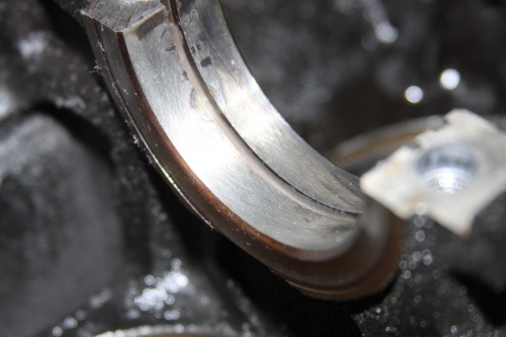

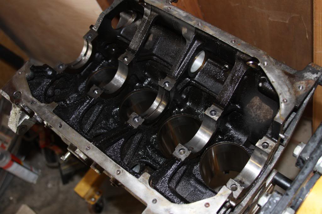

Well, I got the motor to a friends house who had good lighting and indoors. Every last main bearing was toast and especially the thrust bearings. It's apparent that there was movement in the crank. The rods appear to be okay as well as the pistons. I stumbled across this before anything became a complete catastrophe. However, I do need a new crank and block. The clutch side of the thrust bearing was being crammed into the crank and chewed approximately 1/8 of an inch out of the crank. I haven't spent enough time diagnosing what cause movement in the crank but something either wasn't assembled correctly of there was a improper installment of a clutch before I ever owned the motor.
Here is a quick shot of the block bare:
Crank:
Heres where the thrust bearings sit:
Now you can see where the crank was pushed against the thrust. It's apparent this had been happening for a long time. I'm not sure how I never saw metal in my oil. My car never made any bottom end noise, never saw any shavings, and ran relatively normal considering the circumstances it was in.

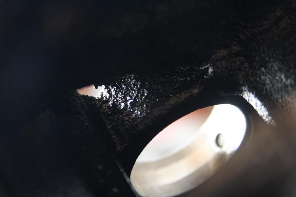

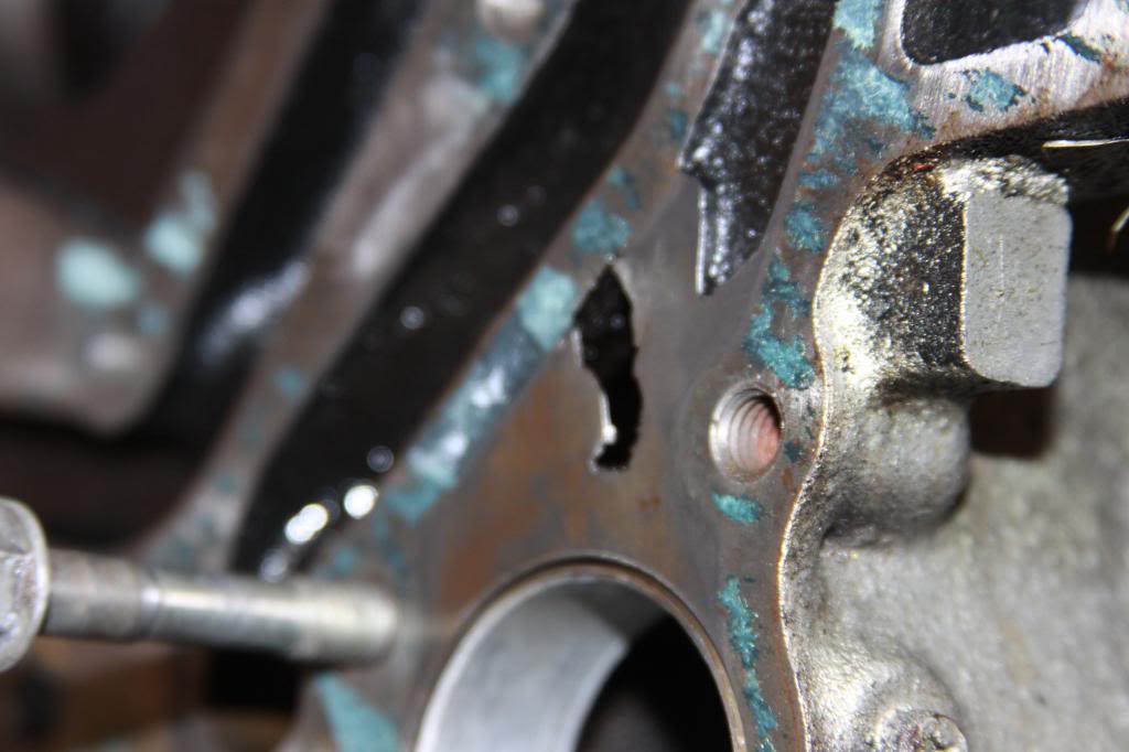

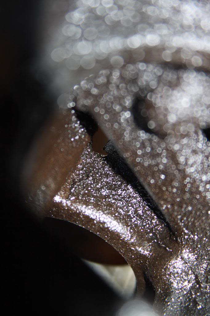

While looking through my block I came across this. I'm not sure if this is normal, as I have never seen it in the multiple 6 or 7 bolts i've ever seen.
Can anybody tell me if this is normal? Not sure really what is going on here. Don't know if this is a thin part in the cast or maybe it's normal and i've never noticed. To me it doesn't look normal... I guess if the front case is covering it and is sealed it may not have a huge effect yet I don't feel comfortable with it.

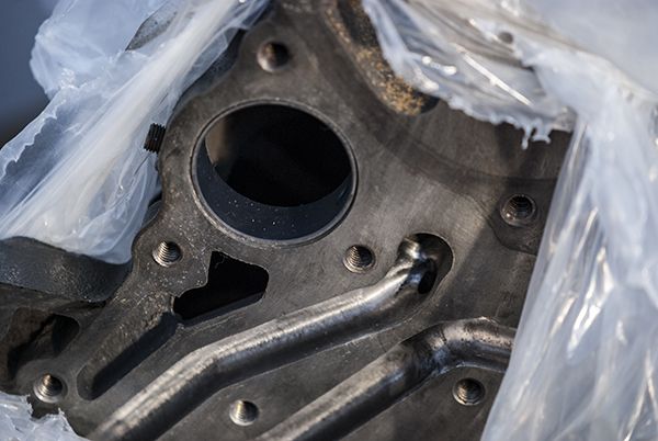

Alright guys got a lot of news.

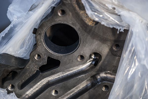

I picked up a blown block from a local guy.
The car had skipped timing and put a valve right into the top of the piston. So It was a perfect advocate for my needs (being a block and a crank). I began to disassemble the bottom end, I couldn't believe what I was seeing. The balance shaft bearings had come COMPLETELY loose and were freely sitting in the oil pan all mangled. Even the more surprising news; rotating assembly was nearly unscathed from this. My assumption is when the car skipped timing something happened with the balance shafts and the motor died before there was any serious damage. After removing the balance shafts and oil pump I noticed that this block also had that same strange hole, this time very different, but a strange casting flaw in the same spot nonetheless.
Anyway, the crank had some high and low areas in it. The thrust has a bit of material gone, but is salvageable. I was first worried about that strange casting hole, but since the oil pump seals that area i'm going to run my old block. I want to run my old block because of the oil squirters. The reasoning behind this is to try and keep my oil pressure down. Also, because i'll be running the car for longer time frames this decision makes the most sense (if anybody else has input please chime in). When I built my 4g64 for my Evo 8 the motor is NA from the factory, so deleting the balance shafts and NOT having oil squirters caused me to have to find a better way to ventilate the crankcase pressure and oil pressure, aside from blow my dipstick out of the block ROFL.
So, as of now the car is at the body shop. Not sure how much longer they'll have it but I'm assuming 2-3 weeks.
As for the motor the machine shop is checking my ring gap (i didnt build this last motor, so not sure how hard I can push these pistons), if they're too tight for my likings i'll buy new rings. They're also checking my rods for any type of egg shaping. They have the crank, and need to cut down the area where the thrust bearing had rubbed the crank as well as cut the rest of the crank. I just ordered a set of ACL H series bearings for the block as well. Hopefully when I get home from New Mexico (June 1). The block will be closer to being finished. So far i'm very please with this machine shop. They've been very upfront and call when there is any type of issue or need to order something.
