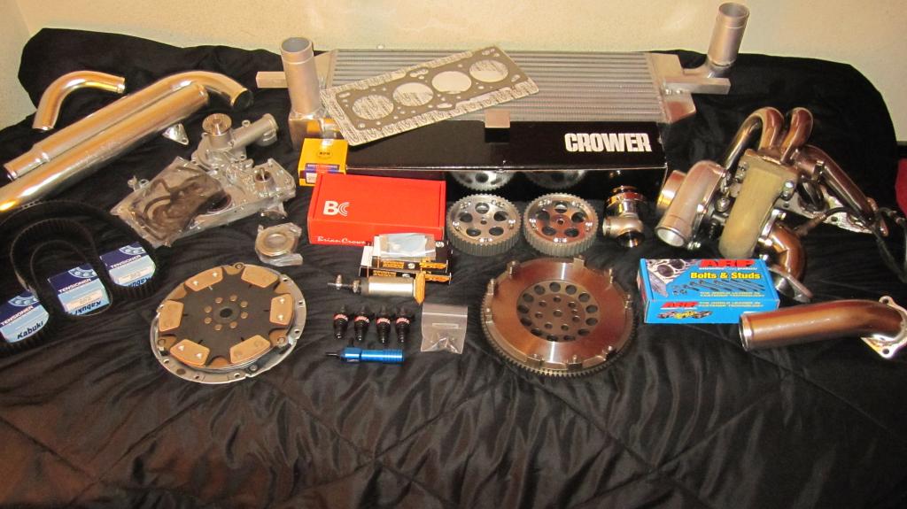

I am excited to put this car together and make it a fun car to drive around and run at the track. Here is a current parts list I have waiting to be put on the car. I have mostly everything other than little odd's and ends.
Brian Crower Single Spring/Titanium Retainers
Crower 280 cams
AEM Cam Gears
2006 Evo 9 Lifters/Rocker arms
ARP Head Studs
Cometic Head Gasket
ACL Race Bearings (Main/Rod/Thrust)
OEM Mitsu Piston Rings
2006 Evo 9 OEM Pistons
2006 Evo 9 OEM Rods
ARP Rod Bolts
2006 Evo 9 OEM Crankshaft
OEM mitsu Oil Pump
GMB Water Pump
OEM Mitsu Timing Belt
OEM Mitsu B/S Belt
NSK Timing Idlers
OEM Timing belt tensioner
New OEM Oil pan
RC Engineering 1200CC Injectors
Deatschwerks 300lph Intank Pump
XTD Extreme PP 6 puck unsprung disc
XTD Chromoly flywheel
GT3582R .63 T3 (Trying to keep the spool quick)
Tial 38mm MVS Wastegate
Hallman Manual boost controller
Ebay T3 Manifold, modifed for tial Vband
Omni 4 Bar Map sensor/GM AIT sensor
Evo 8 ECU on Speed Density via Tephramod v7
3.5" core Bar/Plate Intercooler

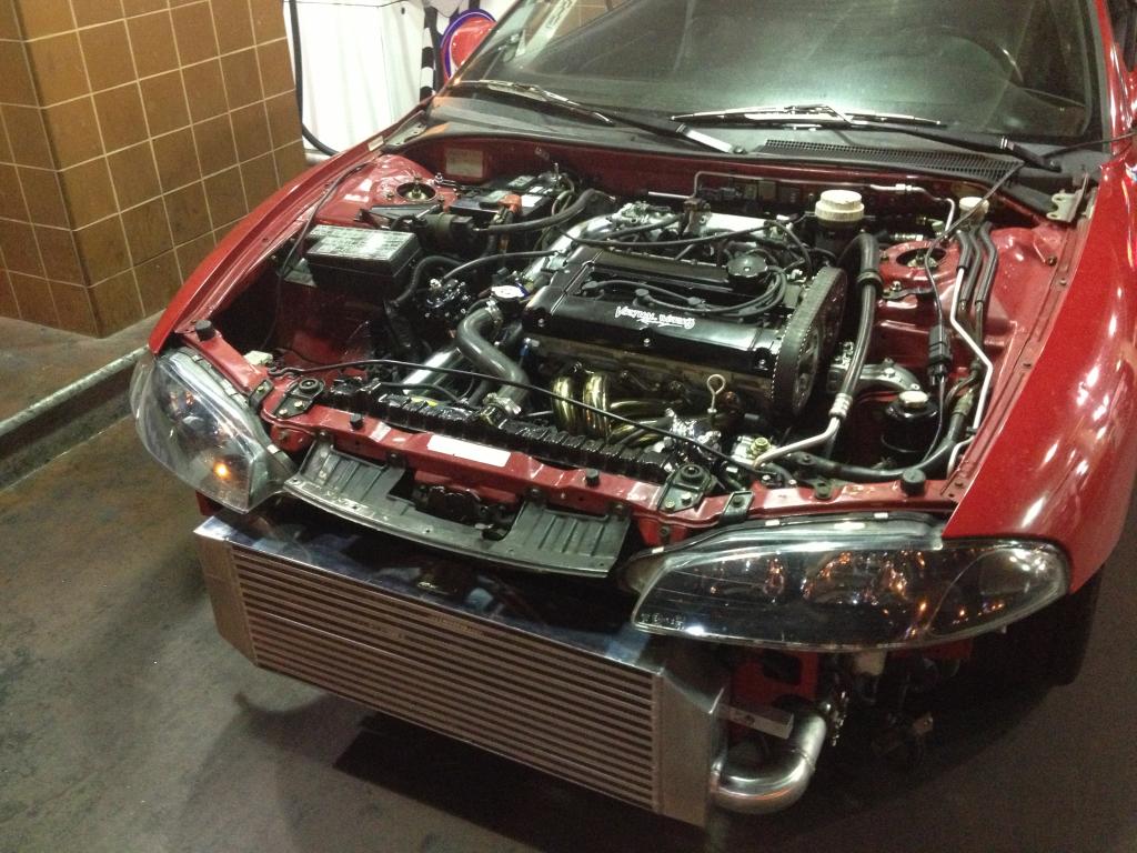

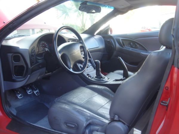

Here are a few pics of the car as it sits, I am planning to start tearing into it next week sometime to get the block and head apart to start the machine work on it.

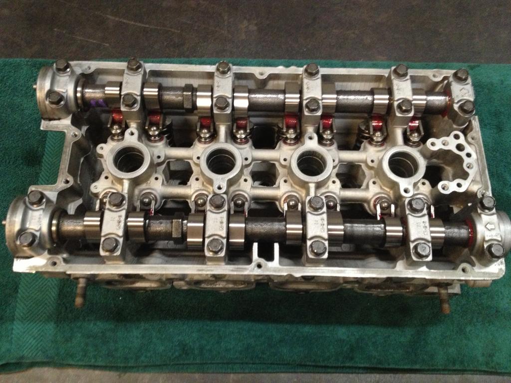

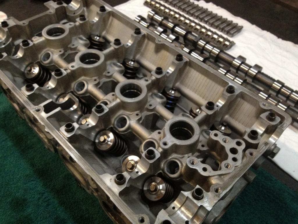

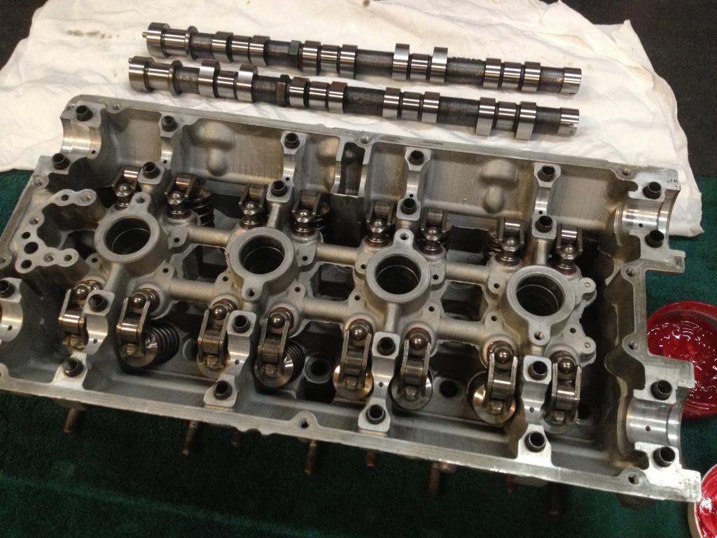

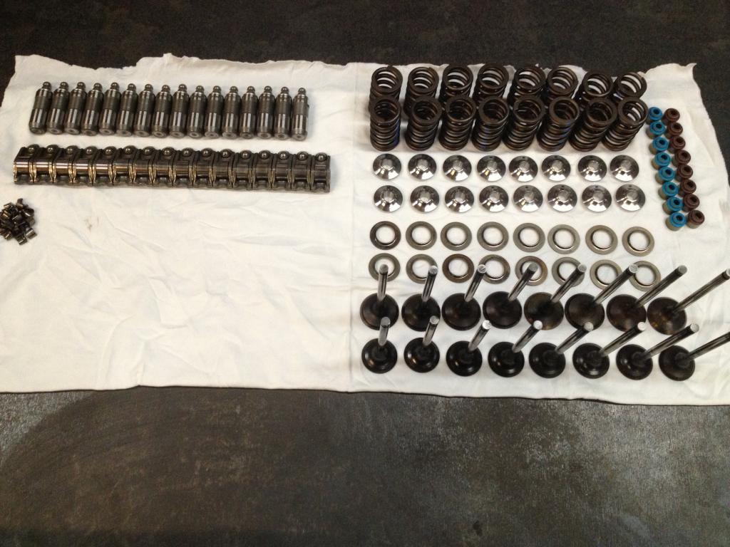

Got some good updates! Got the cyl head and Block back from the machine shop today. Starting with the head I lapped all the valves, cleaned the oil galleys/lifter bores and put the head together. Bled the evo 9 lifters down and installed them along with the evo 9 rocker arms. Put the cams in as well. Cylinder head is all done ready to go!

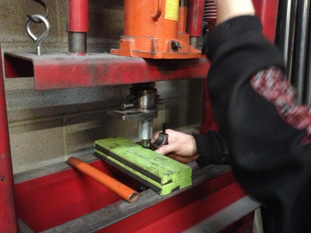

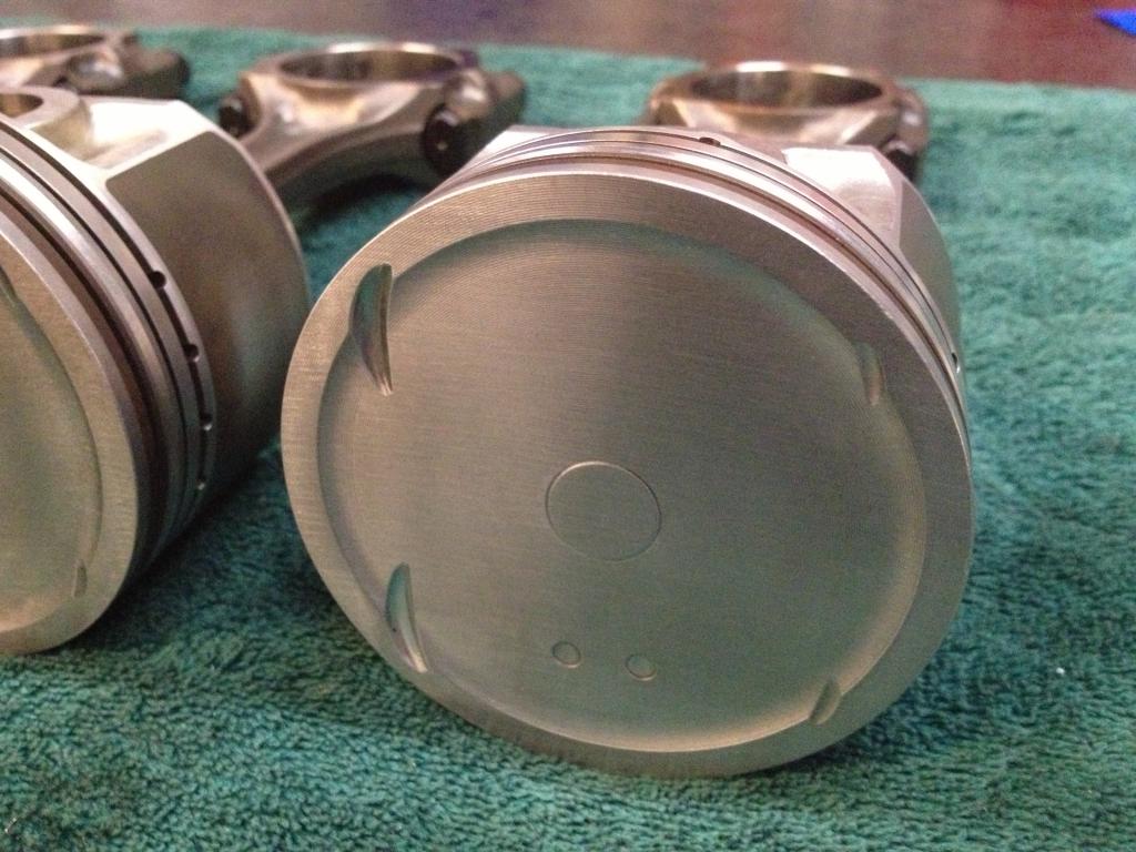

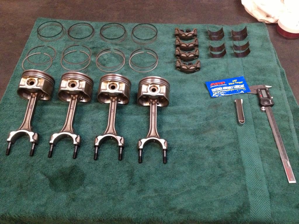

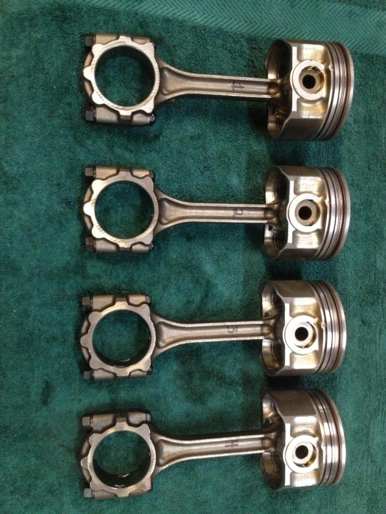

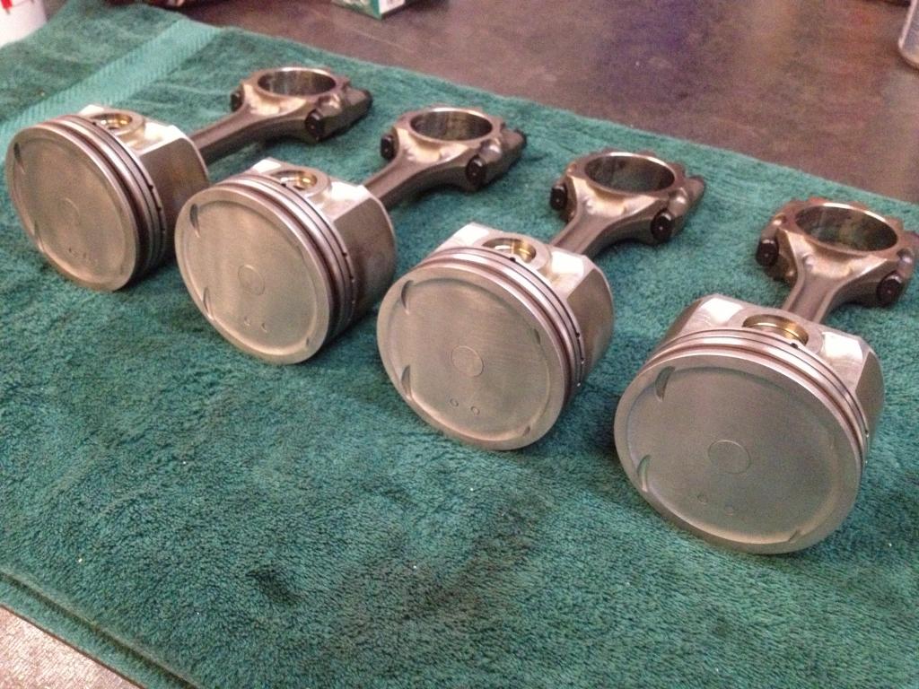

I then machined up a sleeve on the lathe to go over the rod bolts so I could press the new ARP bolts into the evo 9 rods without damaging anything. Got all the rod bolts installed and cleaned the pistons/rods very throughly. Tomorrow I will clean all the oil galley's and start blueprinting all the clearances and get to assembling the block and rotating assembly as well as bolting the head down.

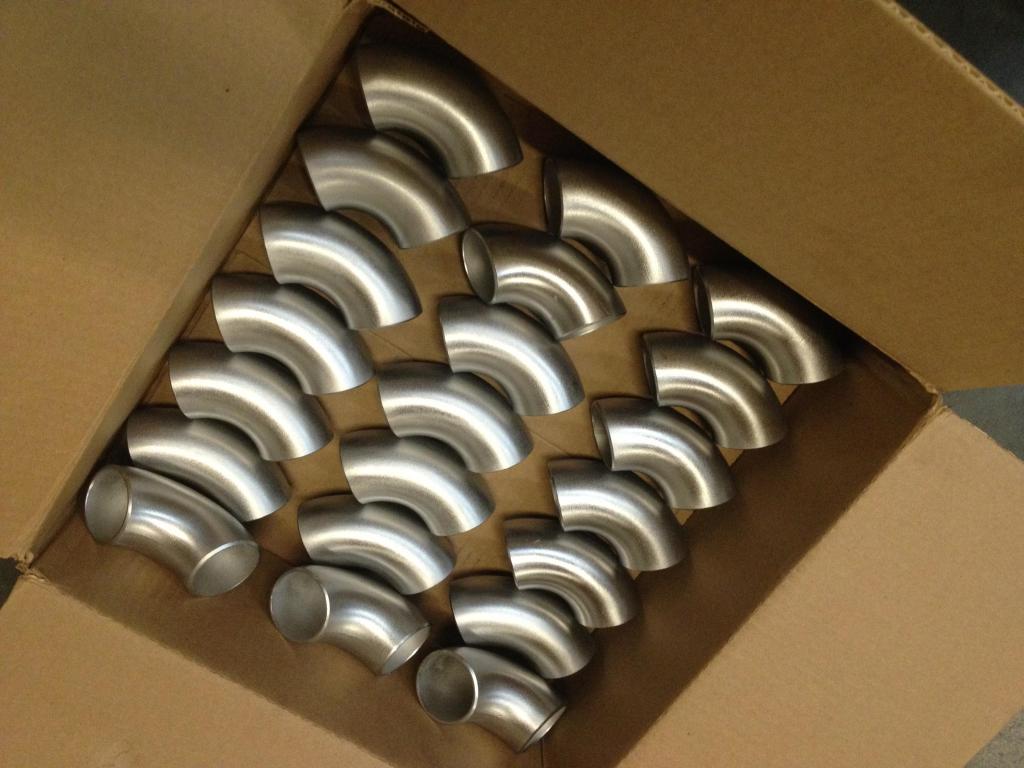

I decided to scrap the ebay manifold so will be building one. I started off by brushing some schedule 10 1 1/2 stainless bends to get them ready for cutting/welding. I ordered a CNC'd head flange and already have the turbo flange cut. Tomorrow we'll cut and weld the collector up and weld it to the turbo flange. I should have the head flange by mid week. And hopefully by then the motor is in the car ready to run.

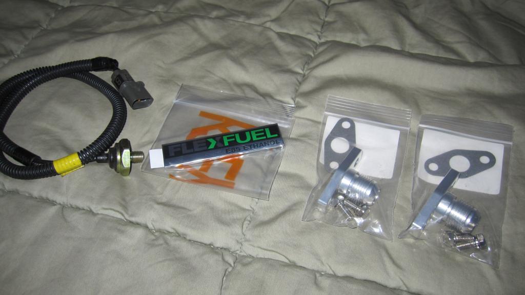

Got a few more little parts in to finish things up. Nice CNC'd turbo drain flanges with A/N fittings, a OEM knock sensor, and a flex fuel badge for shits and giggles.

Cylinder head parts!
Valves, seals, and springs/retainers installed
Evo 9 Lifters bled and installed as well as the rocker arms
Complete cylinder head
Pressing the ARP rod bolts in after removing the stock ones
Evo 9 Pistons and rods with the new ARP bolts installed
Pistons cleaned up like brand new
Stainless elbows ready to be cut/welded

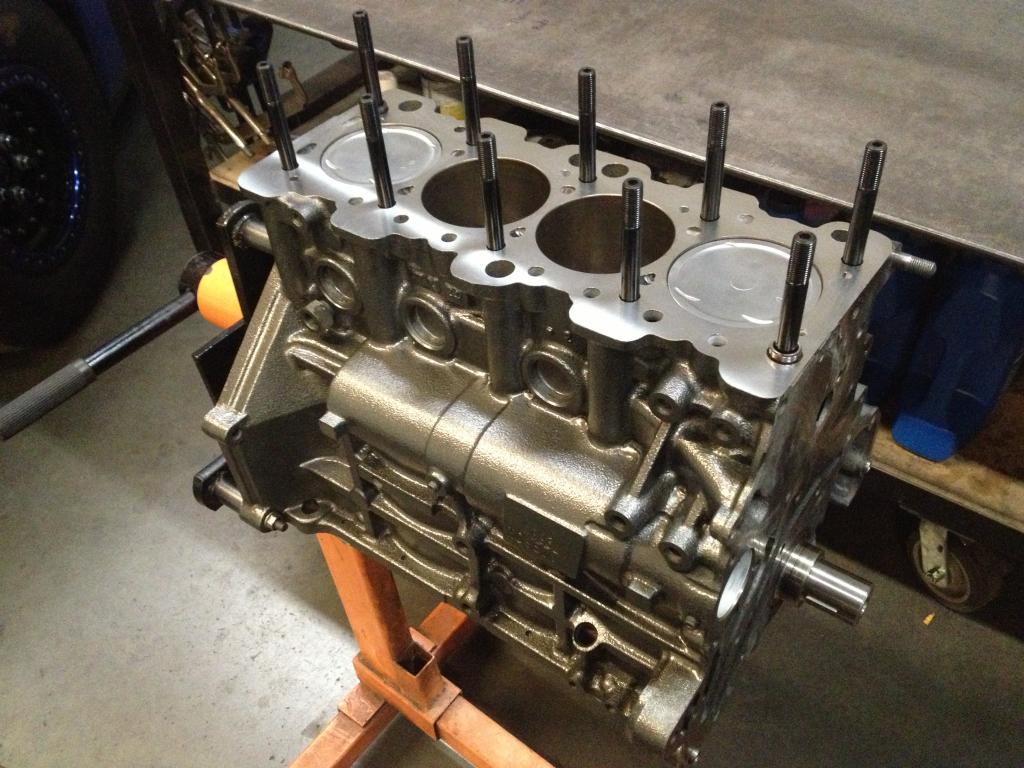

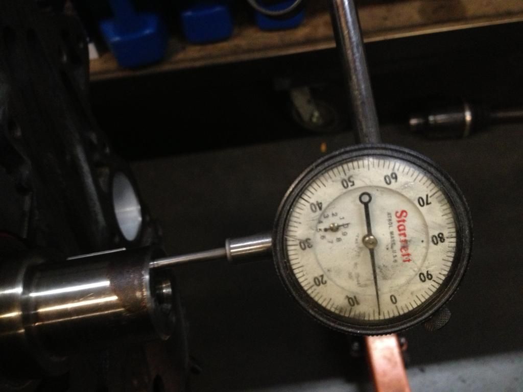

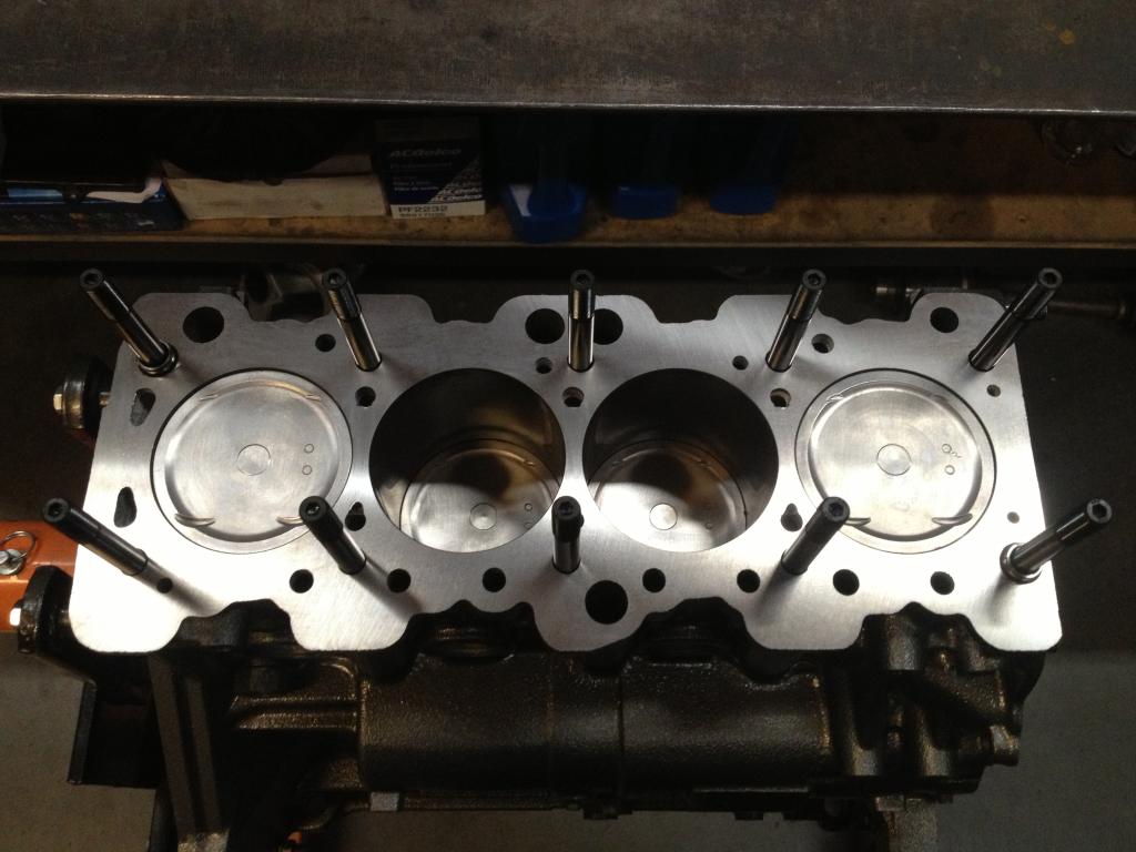

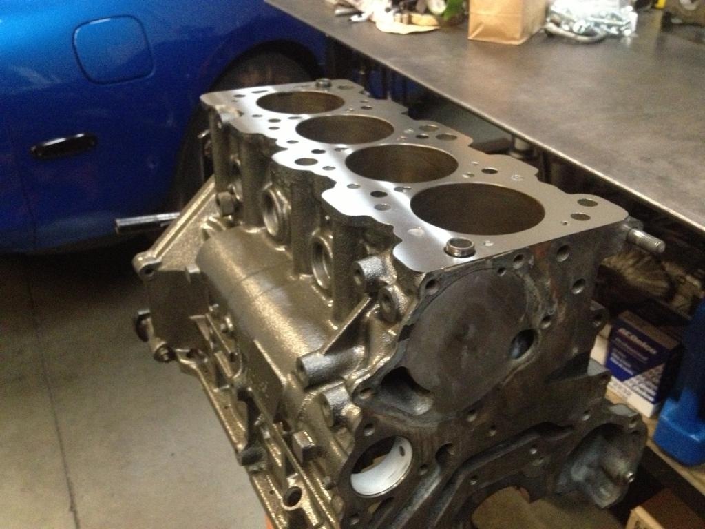

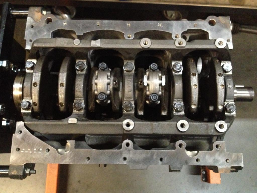

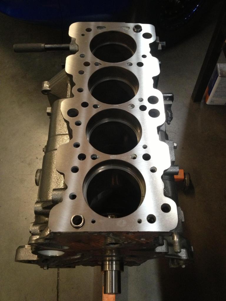

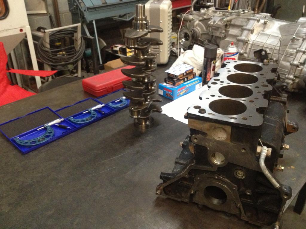

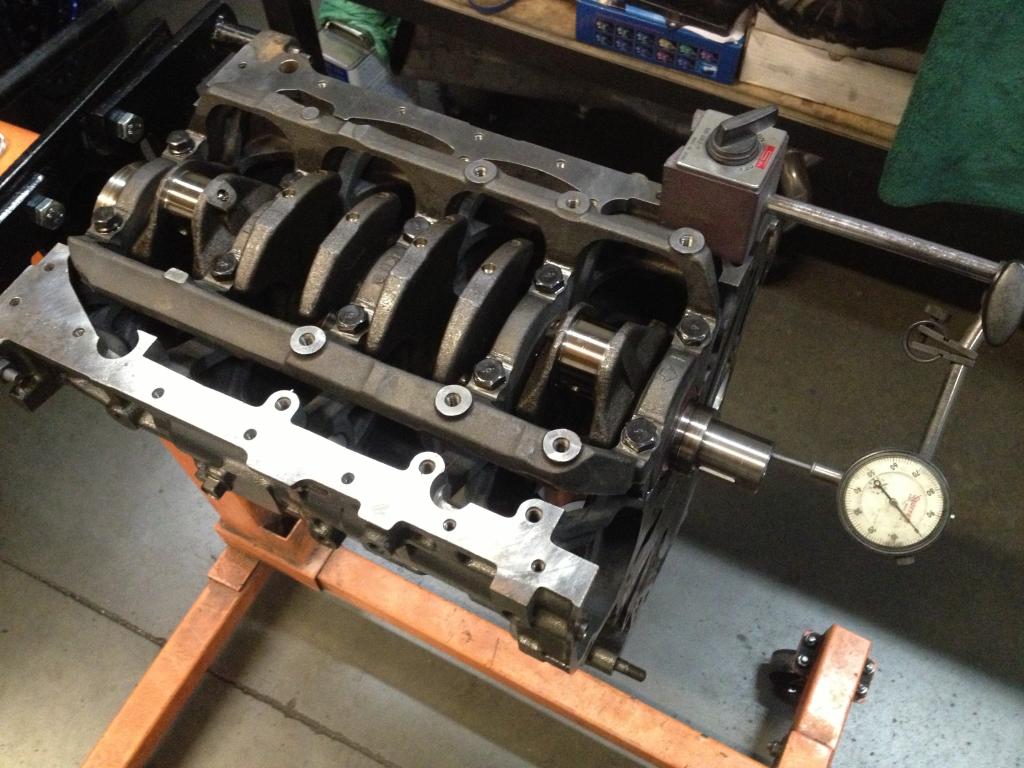

Today finished the block. Starting with cleaning the oil galleys, cylinder walls and main journals then painting the block. Cleaning all the oil passages of the crank came next as well as mic'ing the main and rod journals. I installed the main bearings into the block and torqued down the girdle, Set my dial bore gauge up and starting measuring the clearances. Once all was checked with that I cleaned the journals and bearings one last time and installed the crank and torqued the mains down. Checked the thrust play with the dial indicator then moved on to the rod bearing clearances. Mic'd the rod journals and set my bore gauge up to start measuring the rods, Once all was done I measured the piston skirt and checked the piston to wall clearances again with the bore gauge.

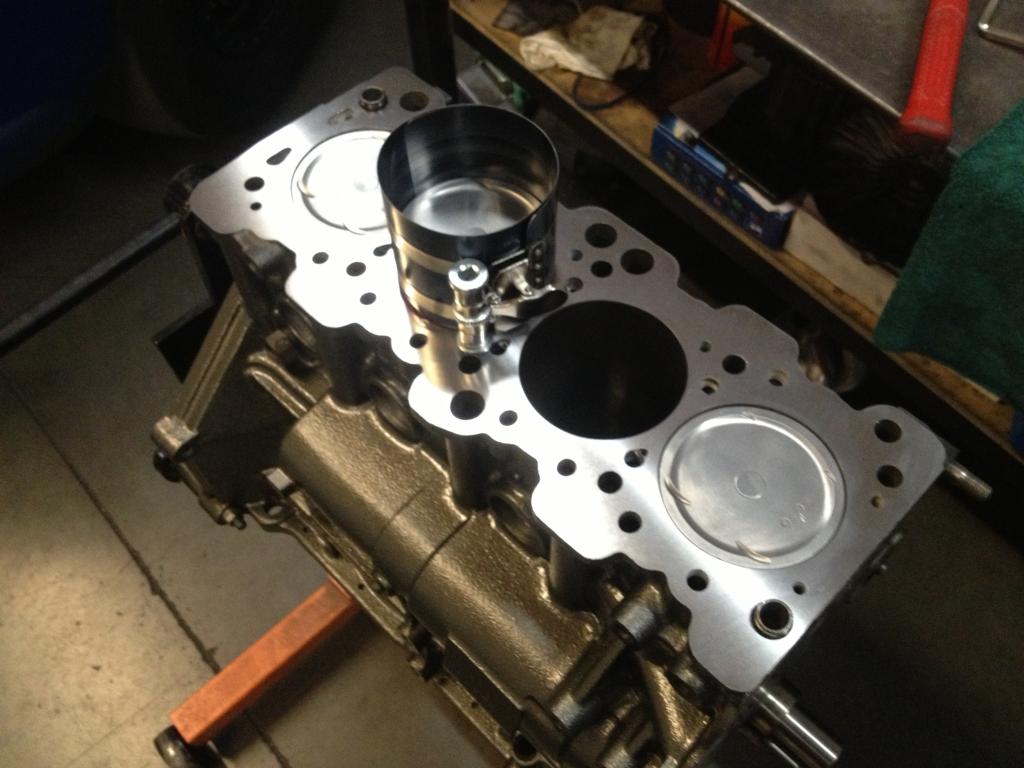

Now that the clearances were good I started gaping the rings to what I wanted them at. All that was left was to put the rings on the pistons and clean the rod bearings, rod journals and cylinder walls one last time and drop it all in. After the rotating assembly was done I installed the ARP studs into the block.

Getting tools cleaned and ready to start the blueprinting process
Block cleaned and painted
Checking the thrust clearance after checking the main's and installing the crank
Rings getting gapped
Pistons, rods, rings, bearings laid out getting a final cleaning before install
Installing pistons after checking the rod clearances and ring end gap
Complete block/rotating assembly

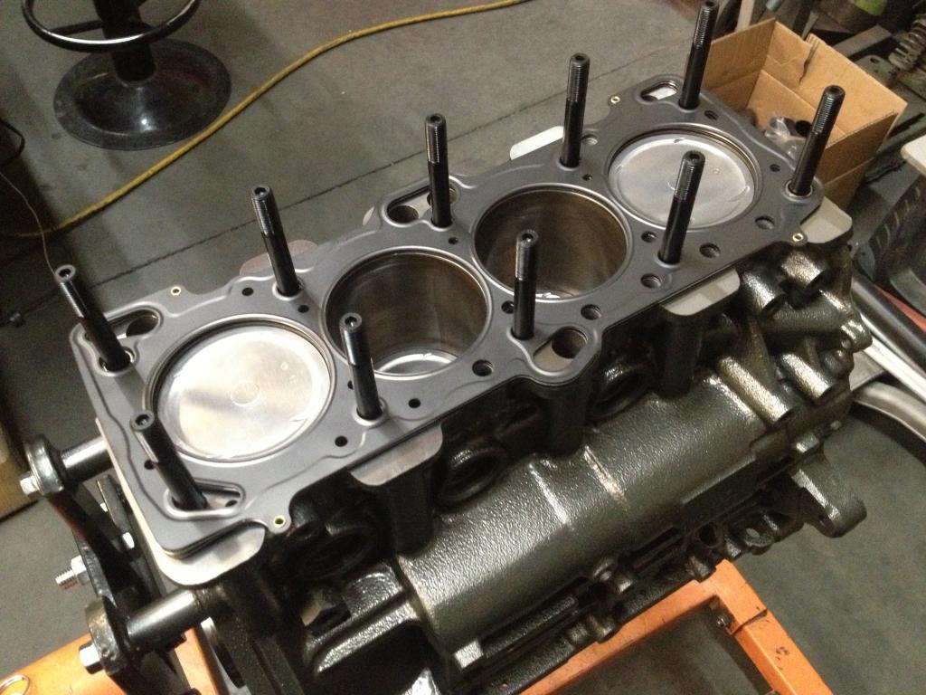

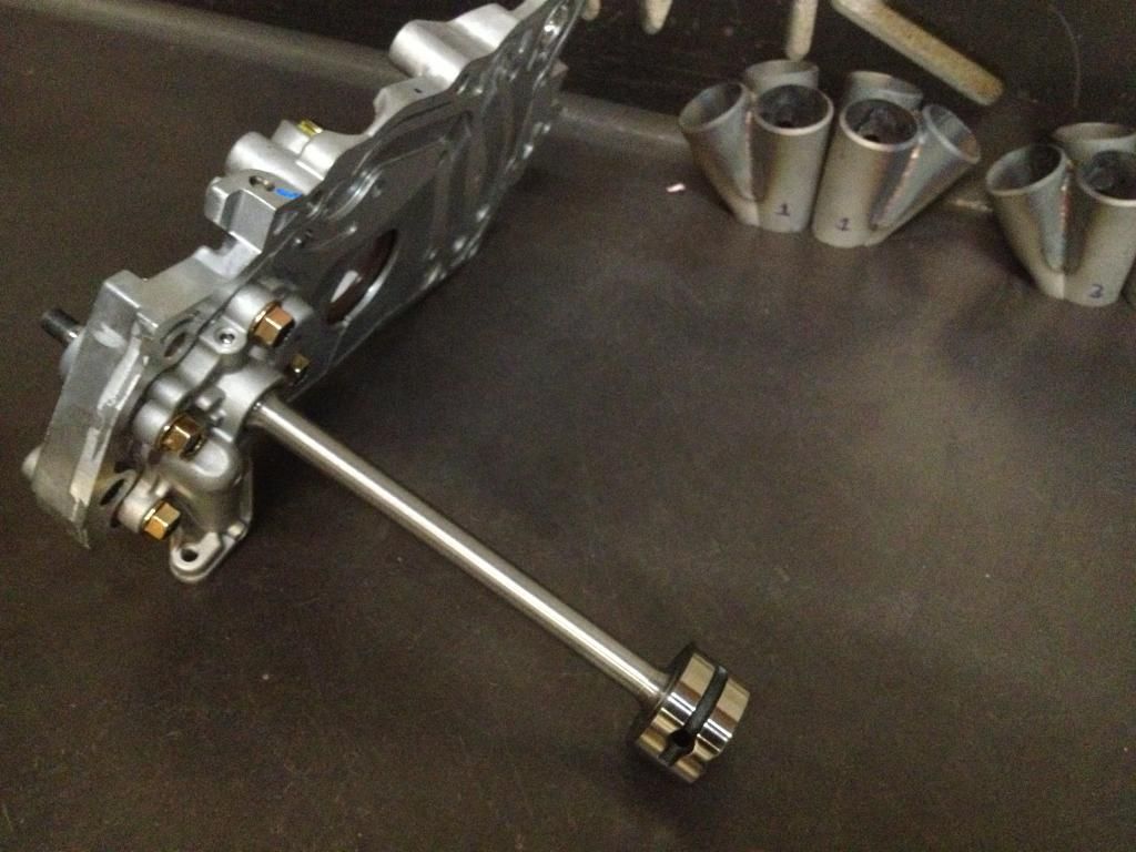

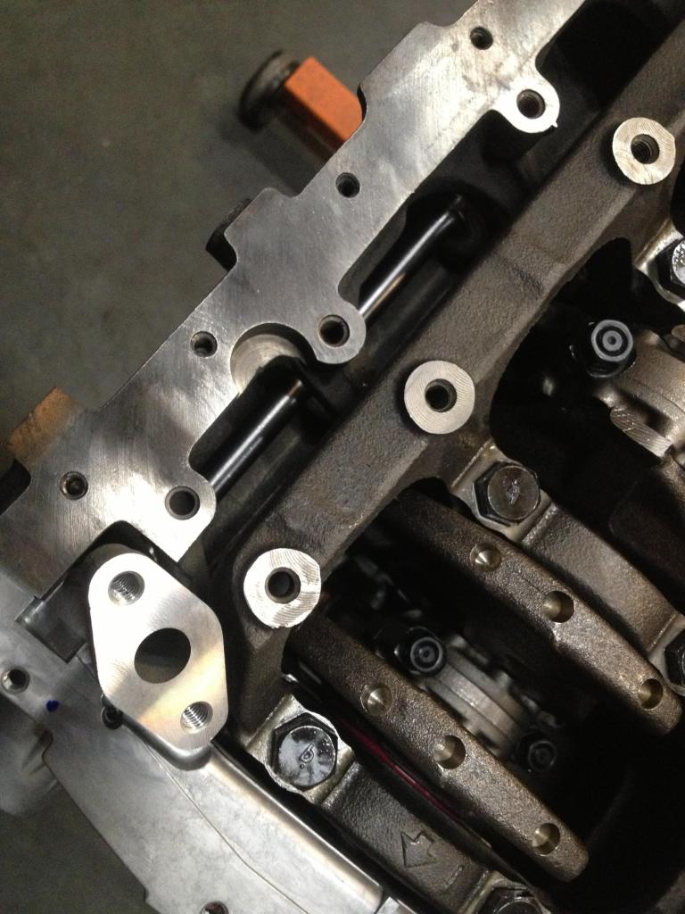

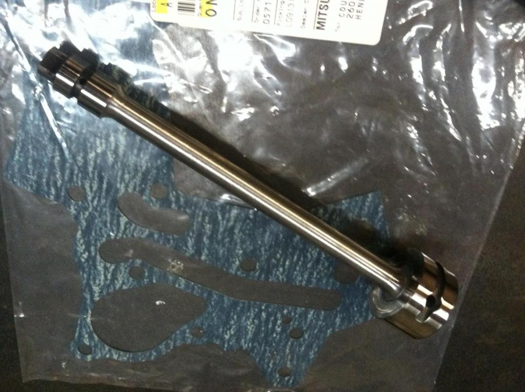

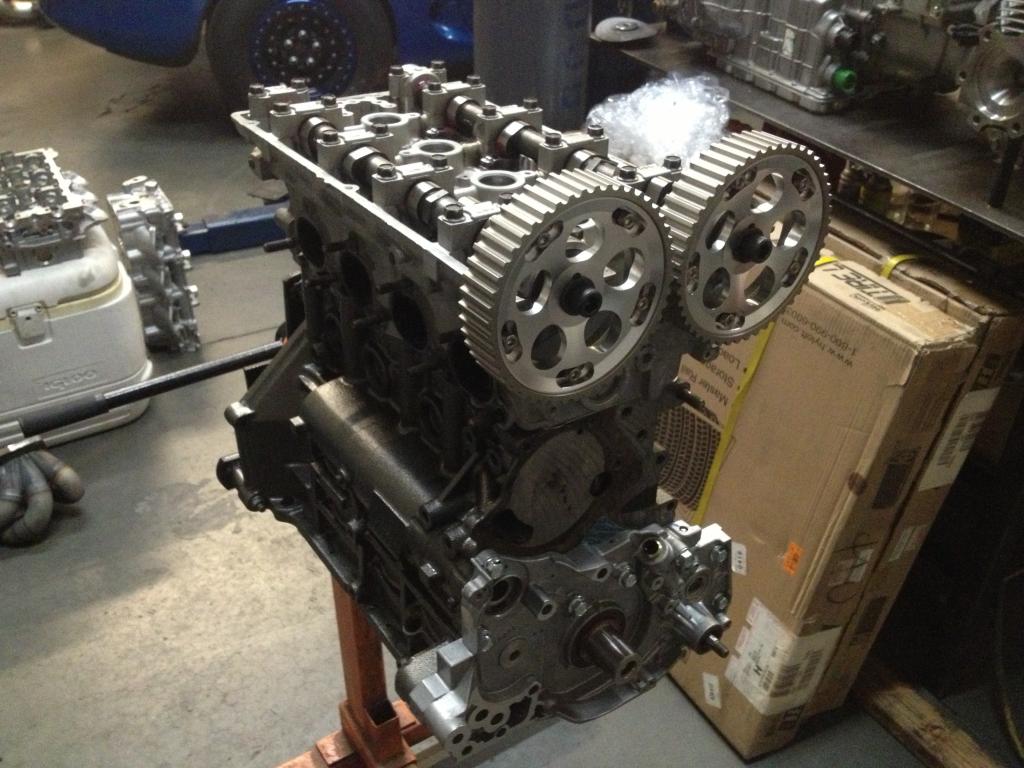

Well today I started off by knocking out the balance shaft bearings and installing them 180 deg rotated to block off the oil feed ports for the rear balance shaft. After that was done I cleaned the block and head surfaces and installed the cometic head gasket and torqued down the head.

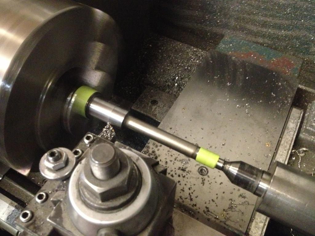

Since I was doing a balance shaft delete I decided to turn down the stock shaft like AMS does to support the oil pump gears rather than have a stub shaft. Got that all done and installed it along with the front cover/oil pump.

Cometic head gasket
Starting the long process of machining the front balance shaft
Done with the front shaft
Installed in the oil pump
Where I ended tonight

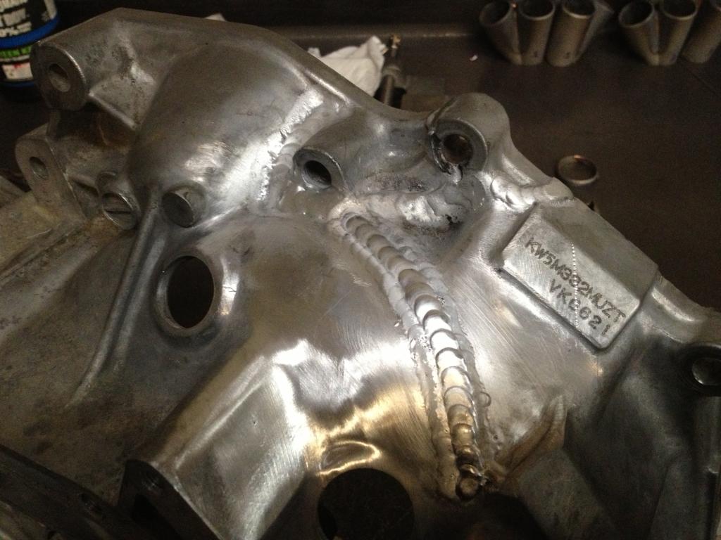

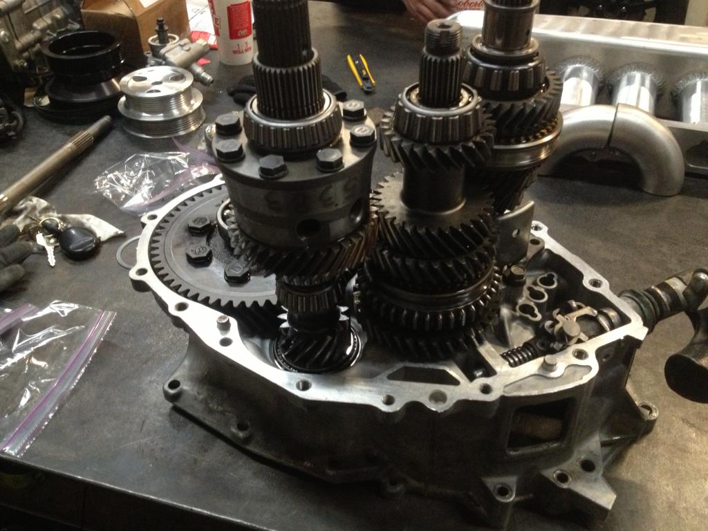

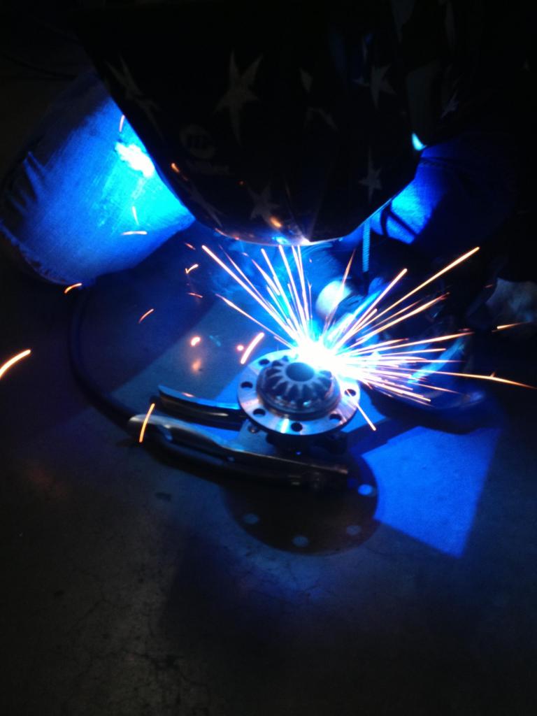

Pulled the trans apart and got the case pieces hot tanked. Welded up the crack on the bellhousing and welded the center diff. Checked over everything and re shimmed the gear stacks. Got the trans all back together.

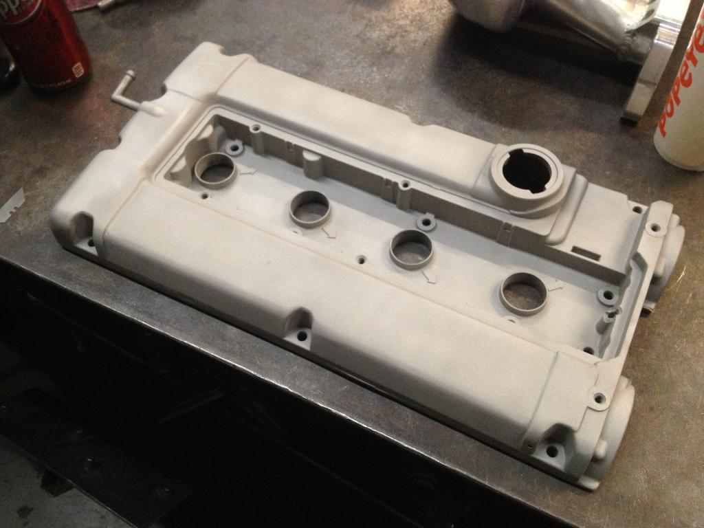

Picked up a Hyundai valve cover and shaved the lettering off, pulled the baffles out then bead blasted the inside and outside. Will be coating it black.

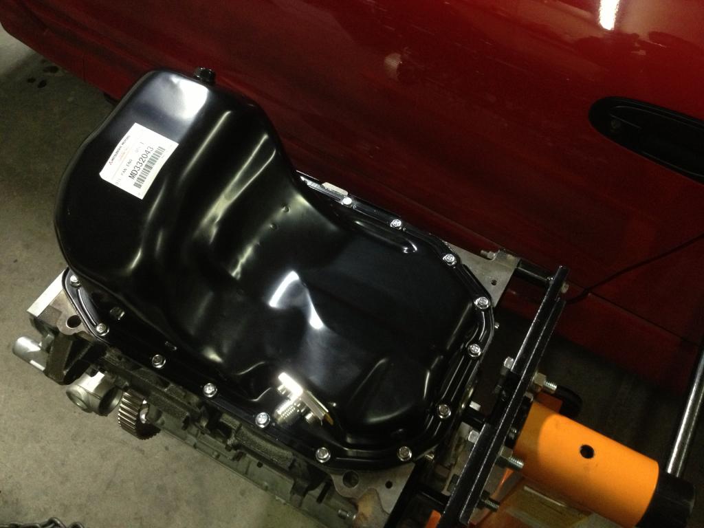

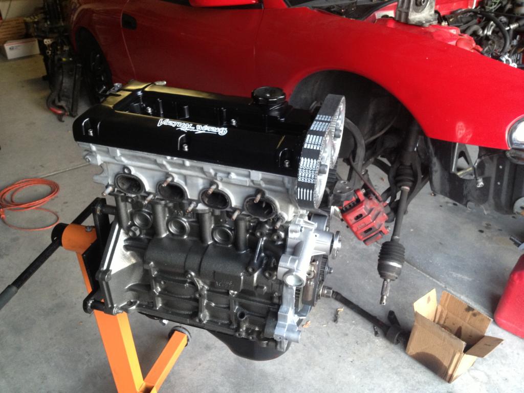

Finished up bolting on the oil pick up and windage trey as well as the rear main seal and oil pan, Also bolted on the turbo drain fitting and cleaned up and installed the cam angle sensor.
New OEM front cover and starter plate should be here today at the dealer then ill start putting the motor in the car!
Trans case welded up
Welding diff
Trans going back together
Shaved valve cover and sand blasted
Oil pan installed

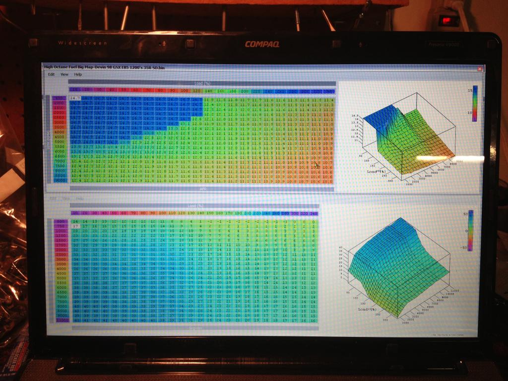

Been super busy, But the car's been tuned and done for a week or so now. Made 524WHP 430TQ at 26psi. Don't know if I maxed the single pump out or the wiring but I need to do a 12 ga wire back to the pump with a relay as it was starting to lean out up top. Hers a few pics and videos. Didn't end up making it to texas sadly due to some other reasons. Next year for sure!
Working on the fuel and timing maps

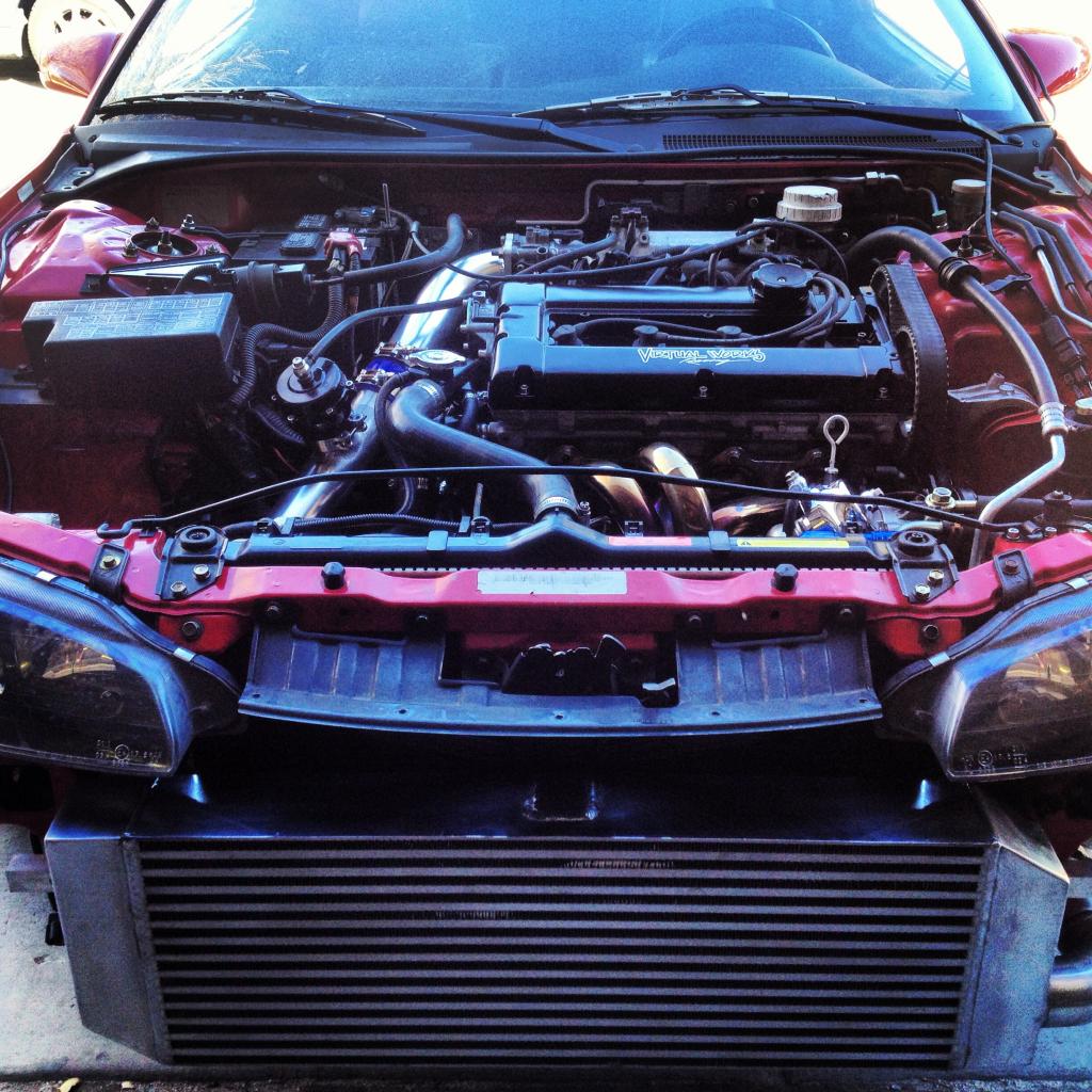

Looking good man. Question about how you mounted your front mount. I have yet to bolt mine up and was debating on how to go about it. Did you just drill and bolt through or tap and tread a bolt?
ty.
There is already threaded nuts welded to the back side of the radiator support, I just centered and leveled it then drilled holes and used a through bolt to thread it into the radiator support.
Thanks guys, Ill have some pics up a little later today, I got the front bumper all cut for the front mount and installed along with the hood. I am doing the fuel pump wiring today and hopefully going to retune it later as well. Ill update with the results!
