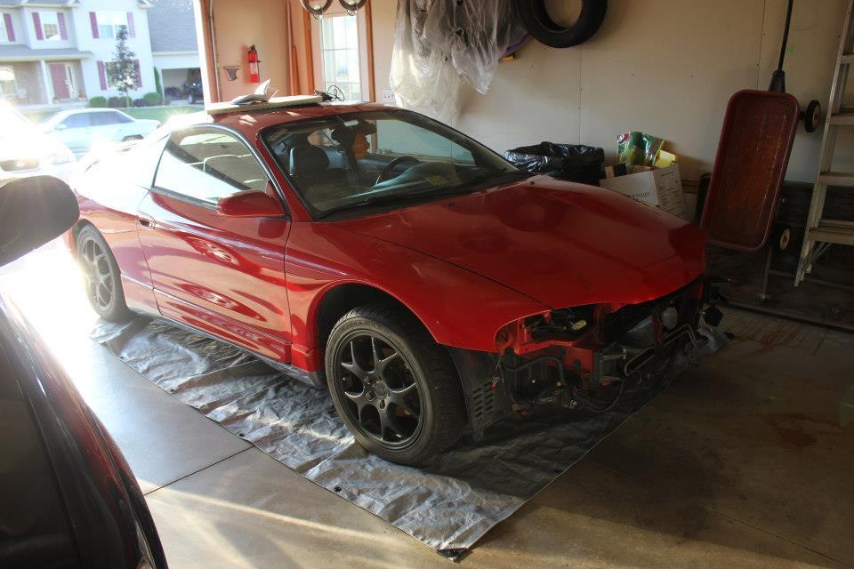

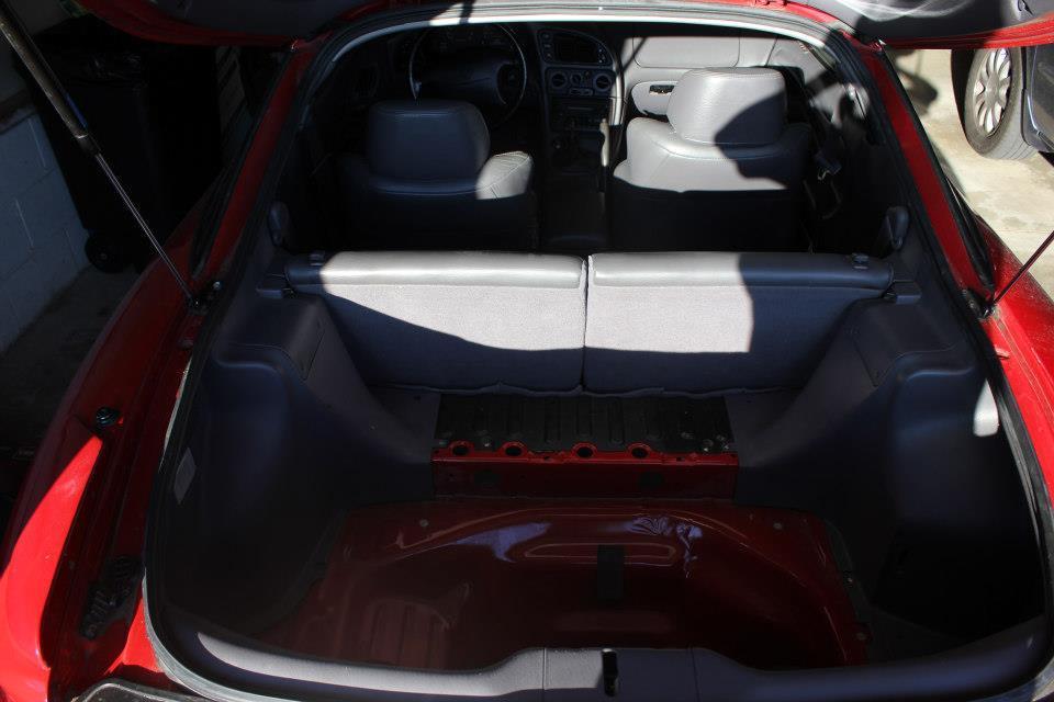

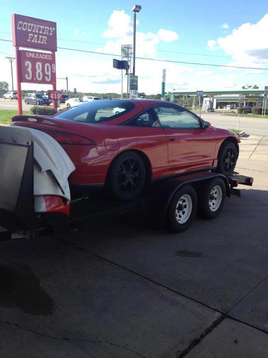

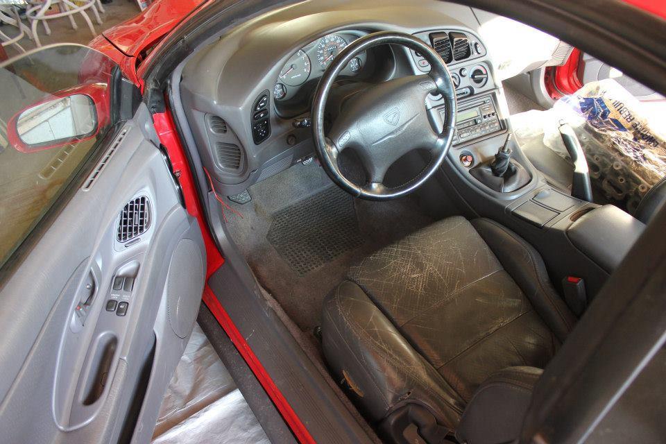

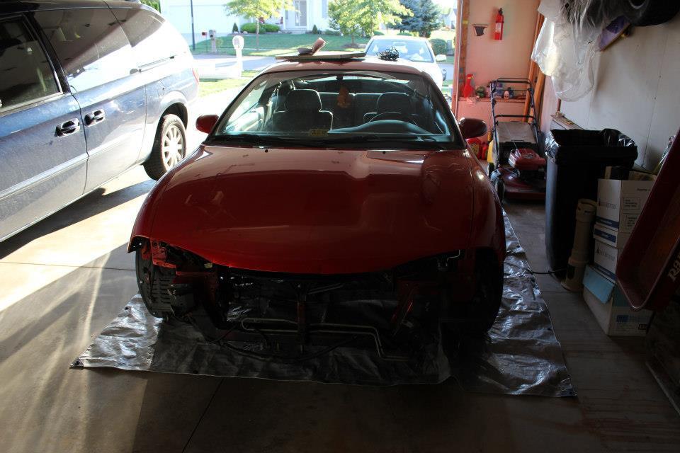

Here are some pics:
I will try and update as we go on with it:D
