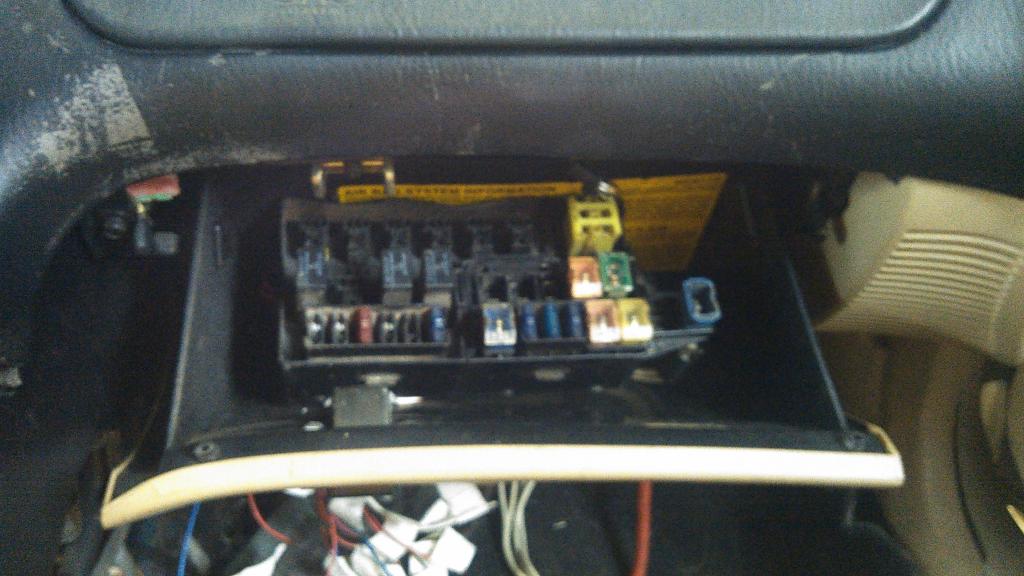

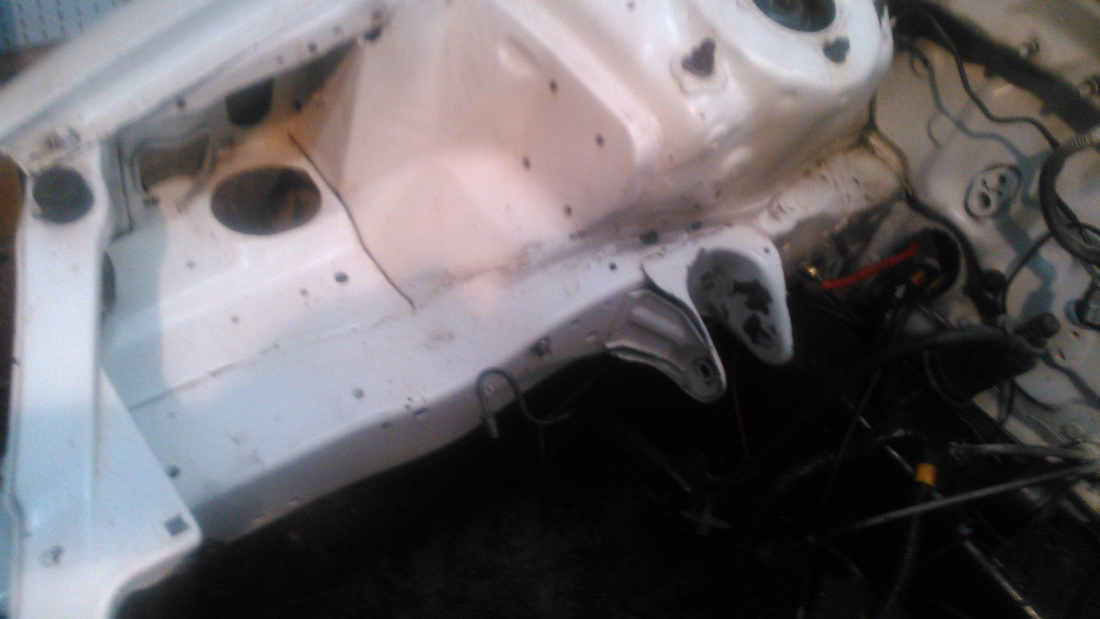

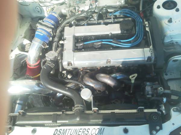

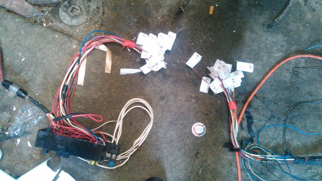

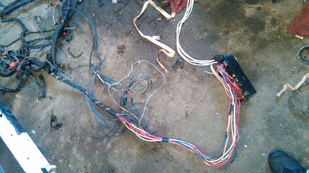

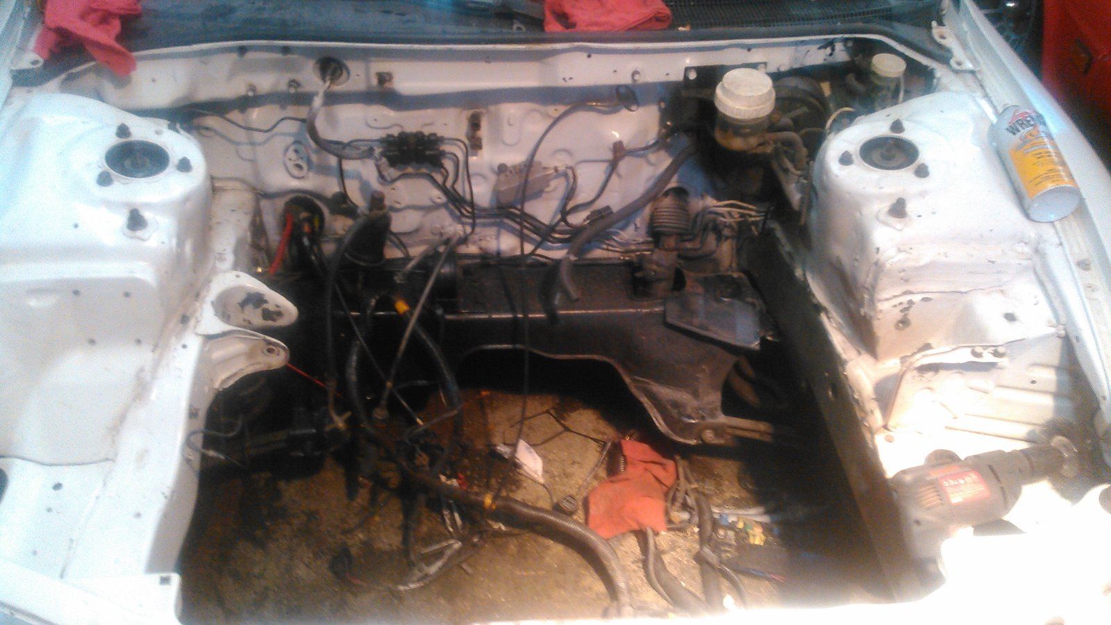

So after one day of setting in my garage I started taking it apart. as my first full build of a car I don't want anything on it that is done wrong.So out came the motor along with the wiring witch was hacked to hell. With my hp goal a full rebuilt of the motor will be needed. So I started on the wiring. I'm moving the fuse box to my glove box for a cleaner bay...also cleaned up the bay and sanded down some surface rust that had started but nothing to bad and for now that's where I'm at. I'll post a few pics of what I started with and where I'm at as well as the upgrades I do.

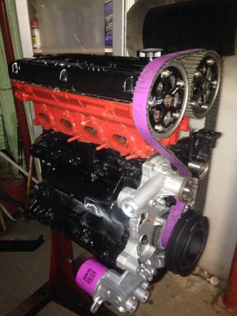

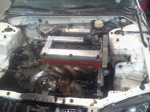

4g64 fully built longblock. 2.4 L block with wiseco pistons 9:1 eagle rods arp main studs and connecting rod bolts. Brand new oil pan and pump. New front cover, all new pulleys, cosmetic racing head gasket, Ferrara valves, Manley springs and retainer kit, freshly machined head pressure checked and milled, 272 comp cams. AEM adjustable can gears, arp cam gear bolts, HKS Kevlar timing belt his oil filter

Ok so here's the update I got the motor mount modifier and the 6bolt setting in the car temporarily. There's a few things need to get then I'll pull it back out one last time but I figured I would list the motor specs
9:1, bored .20 over Wisconsin piston, eagle rods, 4g64 c code block and crank. Cal arc bearings, stainless valves, aem timing gears, 272 comp cams, Arp main bolts, Arp rod bolts, Arp head studs, Arp cam bolts.
