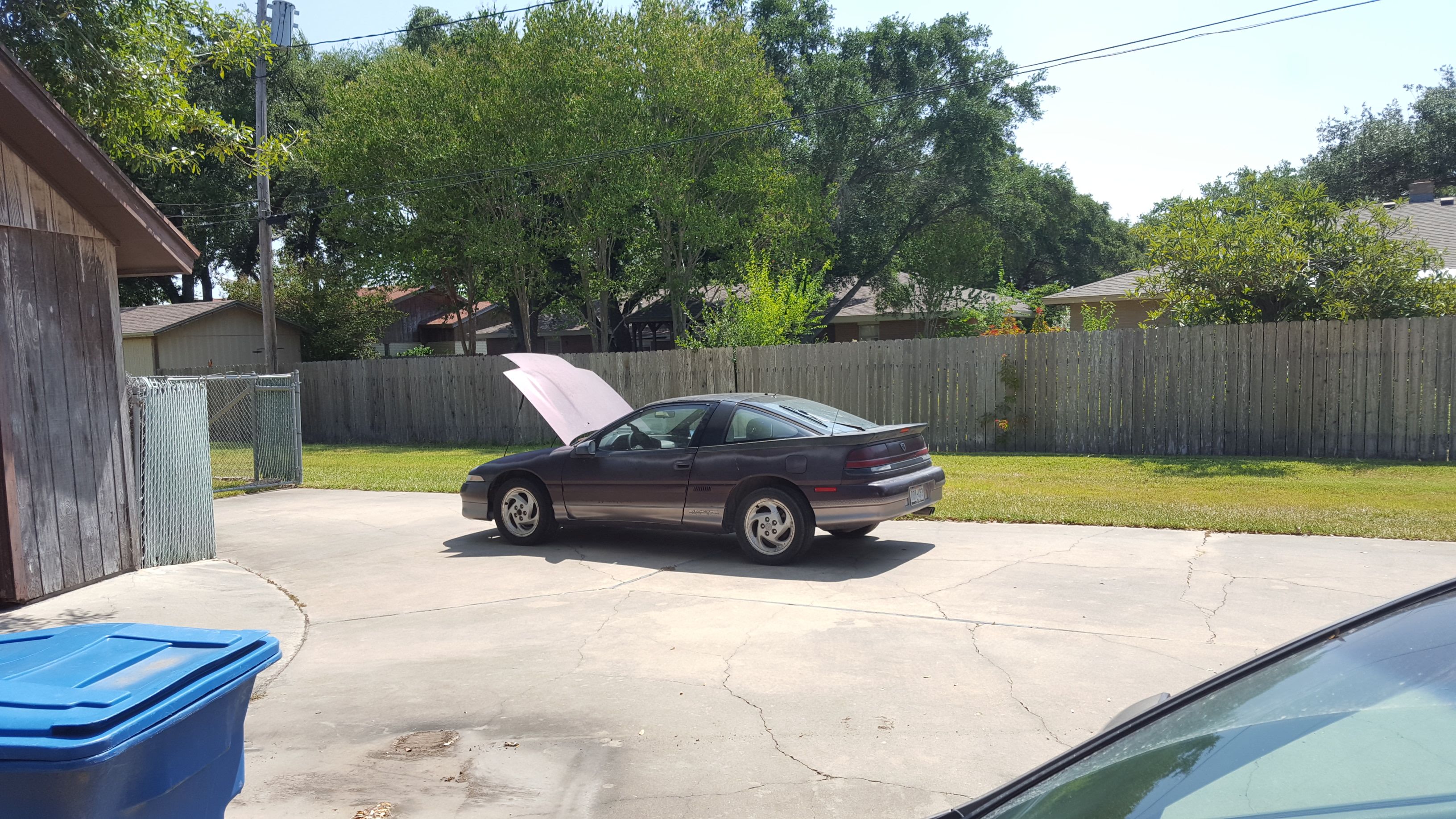

So yeah, this thing had been sitting for a while and she was in pretty bad shape. I spent a solid week with the car and a case of wasp killer trying to evict the previous tenants.
Victory was eventually mine. The car still runs. Old gas, an ancient battery, and a metric ton of wasp carcasses couldn't stop it.. she started without issue and moved out to the back yard into the shade under her own power.
After all these years, all she needed was a nice coolant flush and a new radiator cap. :talon:

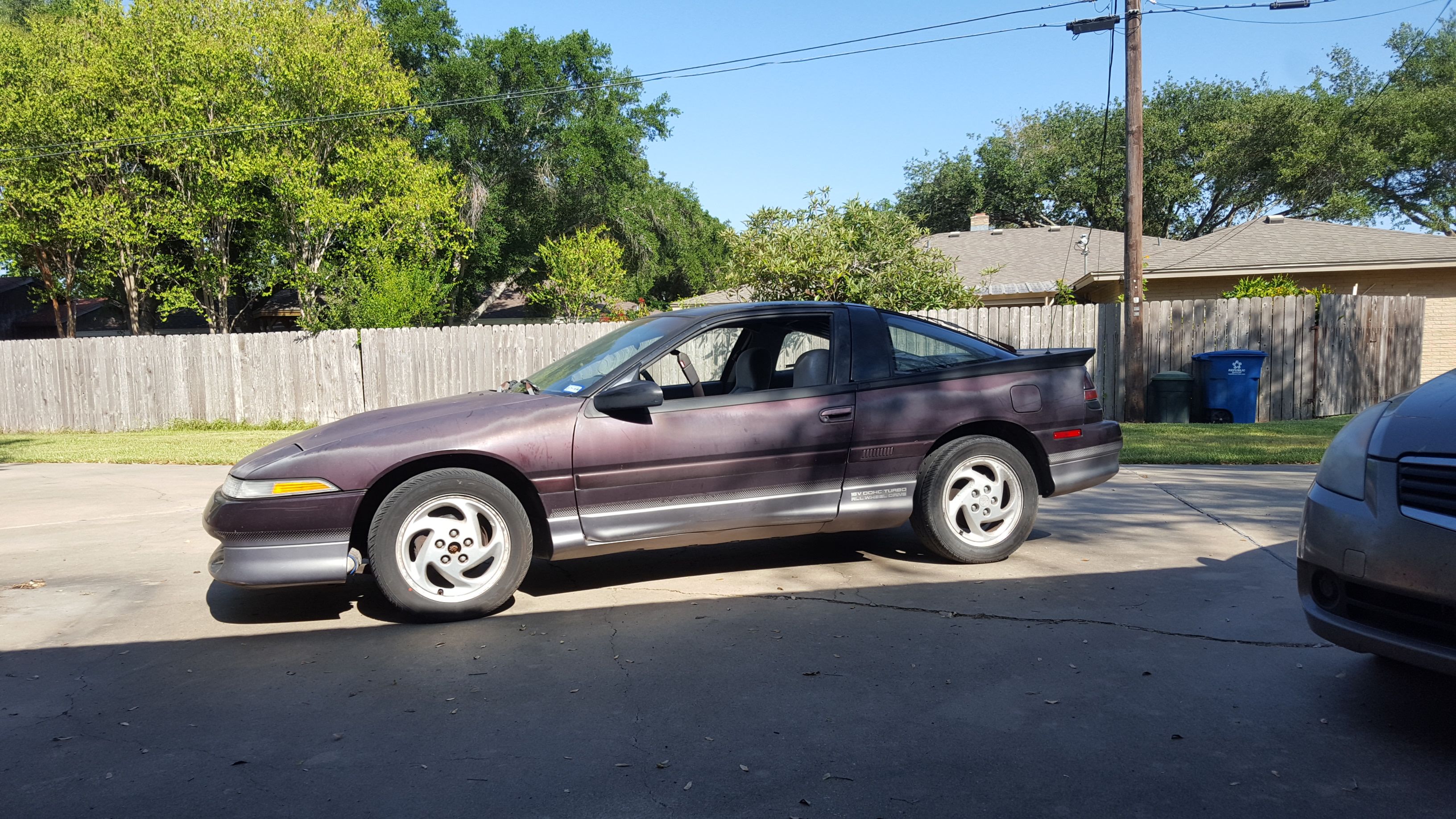

The car ran and drove.. for a few miles.
I was able to take a little shakedown drive for about 15 minutes.. Other than that and a little groaning from a wheel bearing, the car ran great for it's first time out in 5 or 6 years.
I popped the hood as soon as I got back to the house, and I could see that the timing belt was extremely loose.. just flapping around between the cam gears. Perfect.
That was the last day she ran.. A few hours later, my dad flat towed me from his driveway to mine.. about ten miles away. I'm sure he would've done just about anything to get rid of that car and free up some space.
