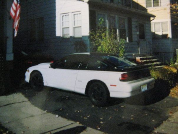

Here are some old pics
Car was 100% street car that ran High 10's and was the FIRST AUTO to do so. Car Had OEM Leather Seats front n back -spare tire - system - nitrous. Looking thru old tapes to find the first 10' second pass

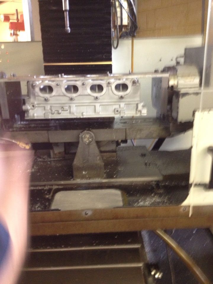

Control Flow Performance Porting

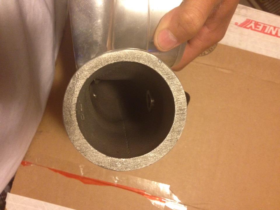

Before

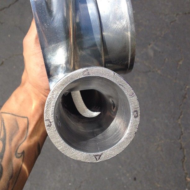

After Sportsman Port Job
All casting flash was removed all the way down to 111.71mm
before left to right was 49.00mm and up and down was 50.00mm
after 51.86mm and 53.25mm
Step from plug was remove from outlet and tap to 1/8 for fitting
Bump from the center of turbo was also remove.
Call around and ask Turbo Shops to do the same thing and its starts at $150.00.00 for the same work.
Turbo was Flowed before and after Audie Flow Quik Machine.
This was just s clean up job and perfect for my setup. Plus I am Happy with it

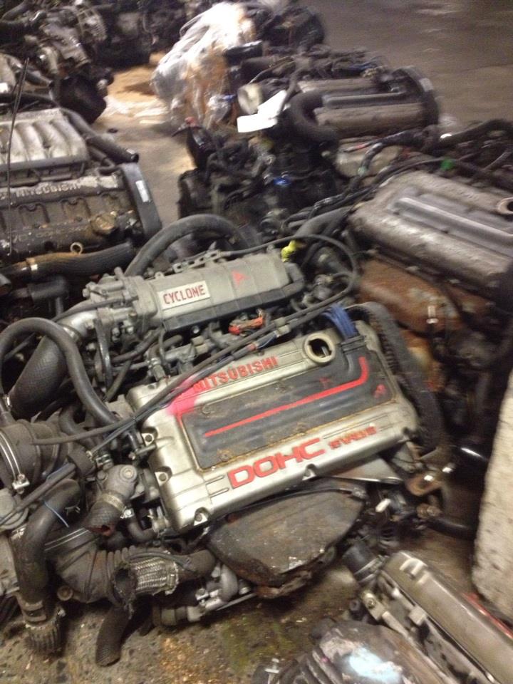

Plans are for the MOTOR
2.0 Liter 6 Bolt - JDM Block and 1.6 DOHC Head

Picked up the Motor

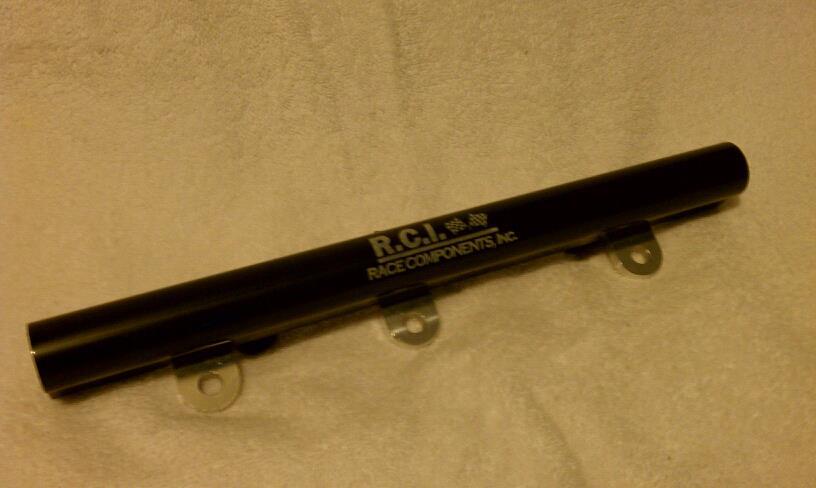

New Fuel Rail is here - Check there website racecomponentsinc.com or MoralesRacing.com

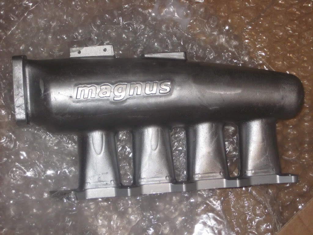

Magnus Intake Manifold with Control Flow Porting to clean it up a bit
You guys can pick it up from here
V3 Cast Aluminum Intake Manifold for 1G DSM and VR4 | Magnus Motorsports

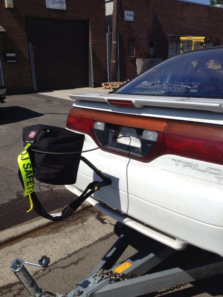

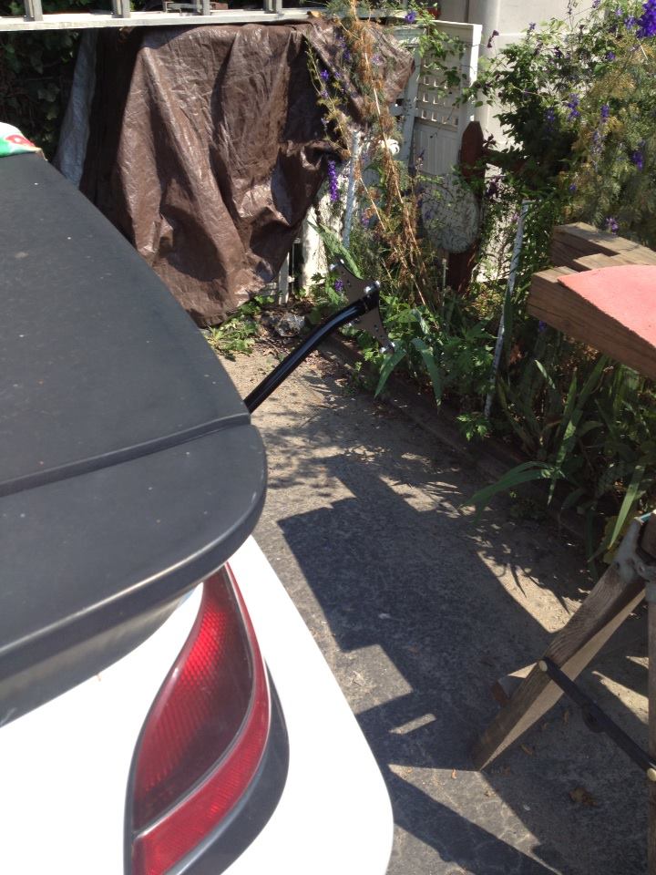

Finished the Chute today and you can pick it up from MoralesRacing.com
Just wanted to say thank you again to Frank the old owner of F.I.C and now of http://www.racecomponentsinc.com/ for everything he has done for this build and for everything over the years.
These is the Chute I help do with Mark from MTK's Race Cars for Franks Car check out his build also on here. but didnt want to copy him so I did it alittle diff. Will post a better pic of mine when I can
