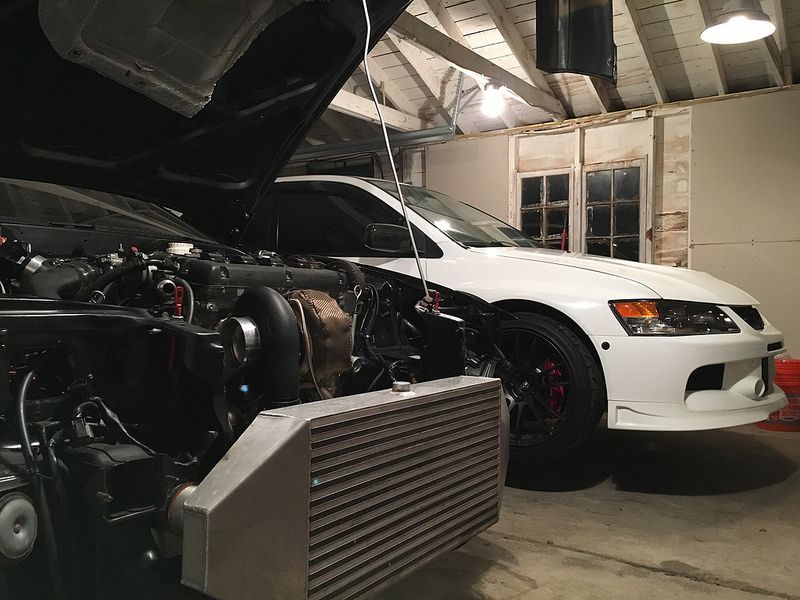

Not too much going on yet. I sold my full 3" exhaust as I am building a side exit. Starting to plan the routing for that now as I wait for the new billet borg warner flange for the turbine outlet to arrive. The flange lets you use 3.5 or 4" tubing.

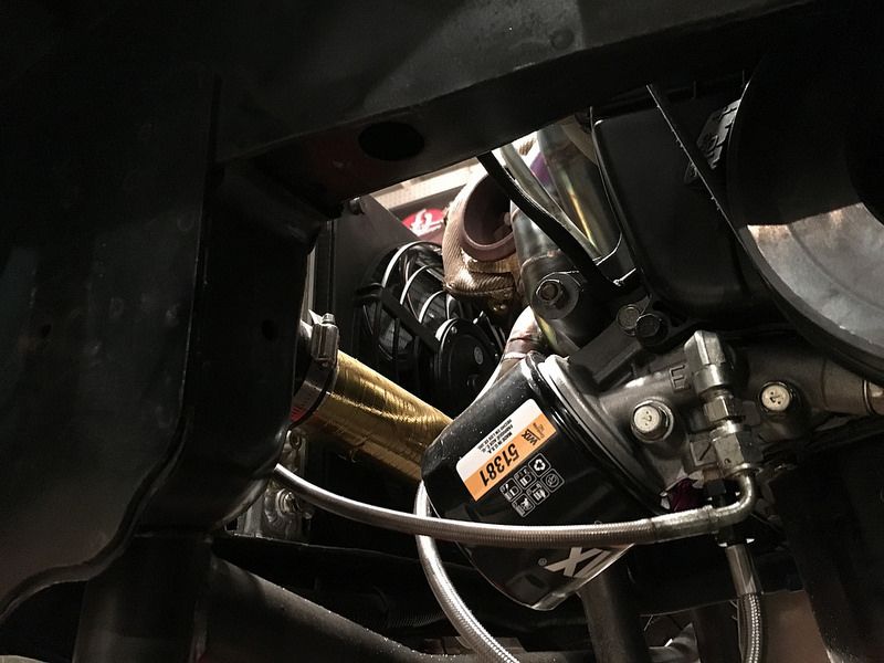

Not much room in here for a 4". 3.5" fits nicely and won't require cutting. Decisions...
Maybe switching back to a regular ofh will help clear so room?
That is also an option, but I plan to avoid doing that. I invested some time into my current OFH to get my oil pressure where I wanted. I think I am going to go with a 4" and cut the rail a bit.

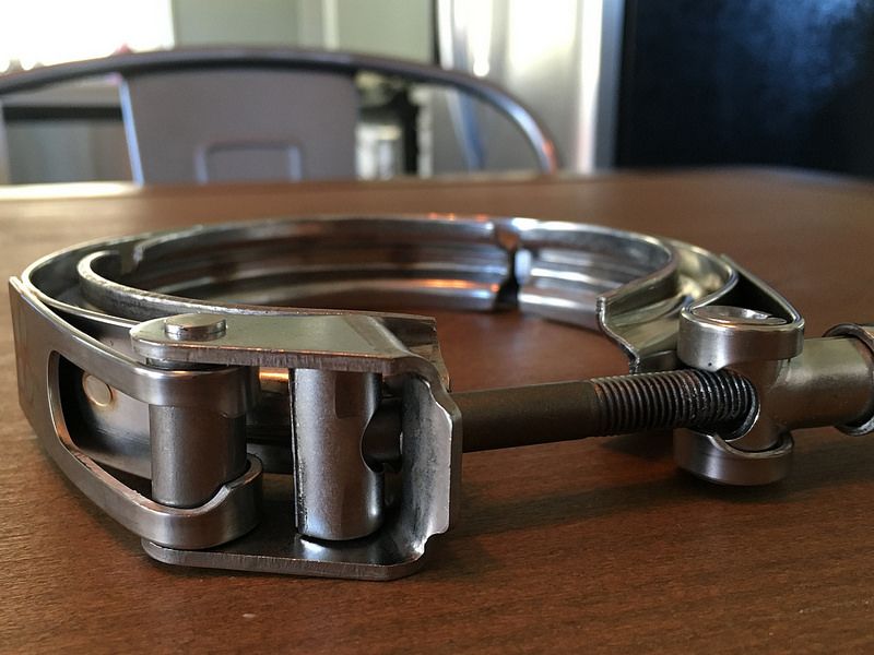

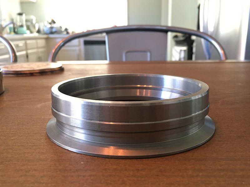

Billet flange arrived for the turbo. The quality of this thing is awesome. It allows a 3.5" or 4.0" tube and includes a beefy quick release vband clamp.

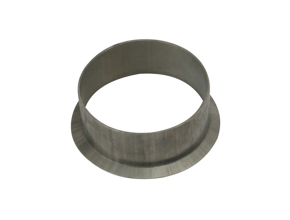

The only other Borg 4.21 Marmon flange I've seen is a cheaper thin piece that I ran before.

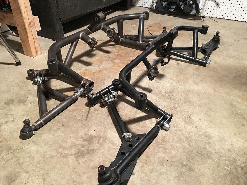

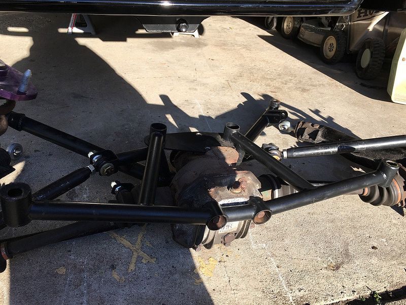

Interested on where you got those Scott.
True Street Fabrication makes them. I received them from a friend who parted out his 1g.
Overall they are pretty nice. They're made from Docol R8. I will be strengthening the front just a tad (photos to come on that).
