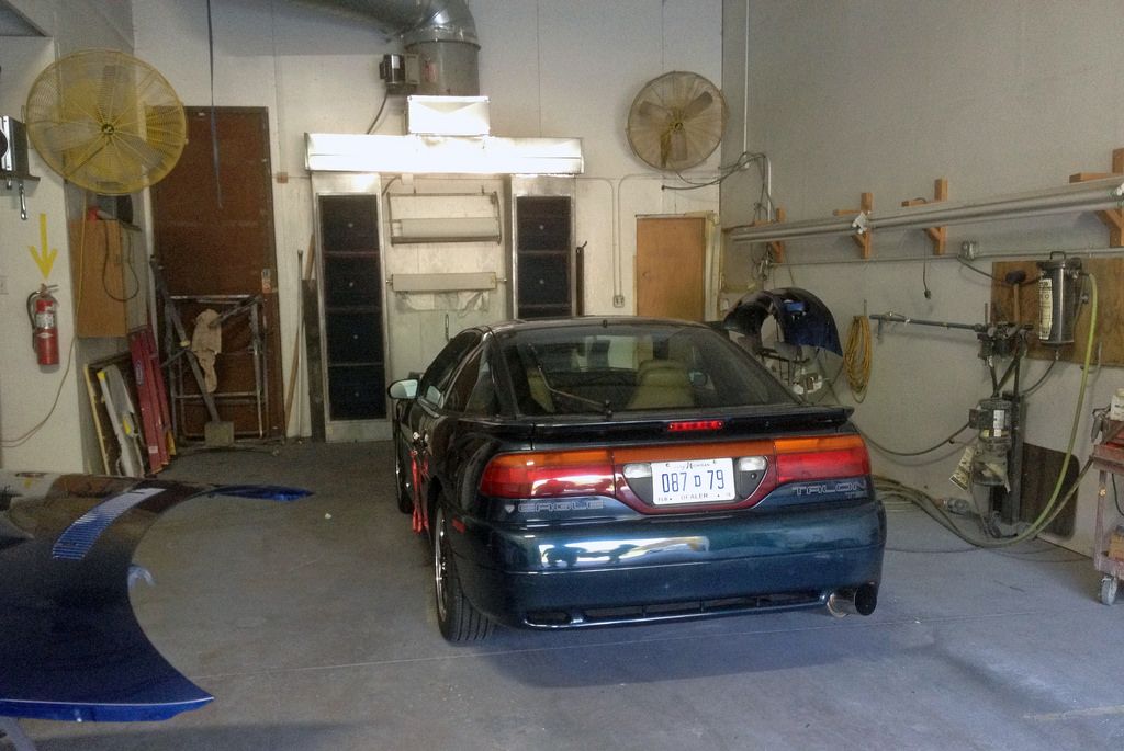

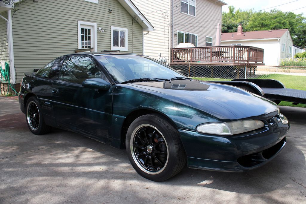

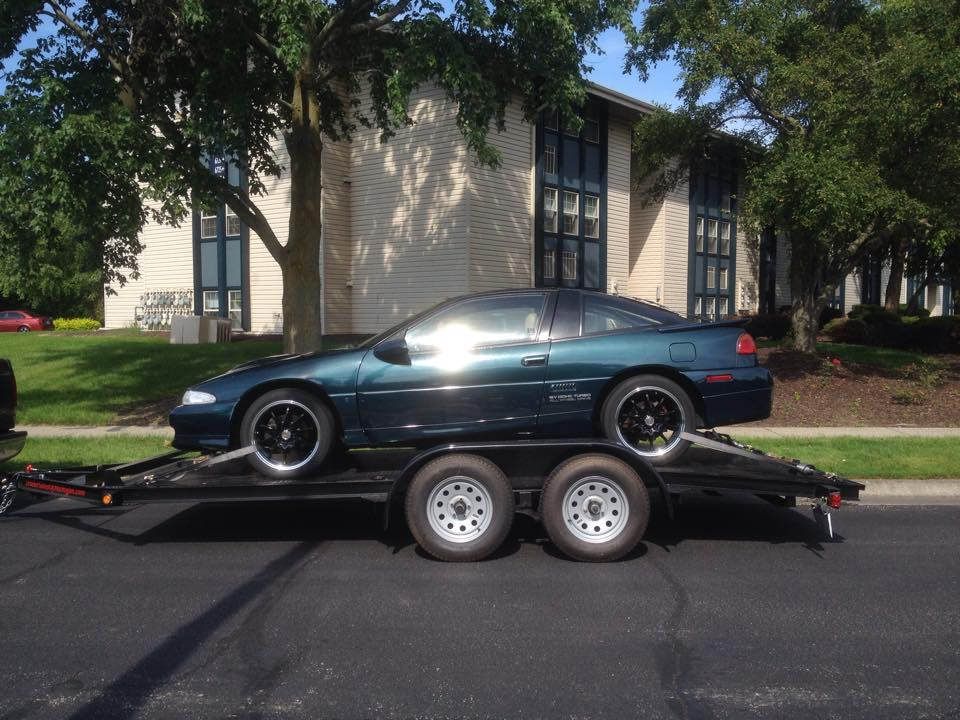

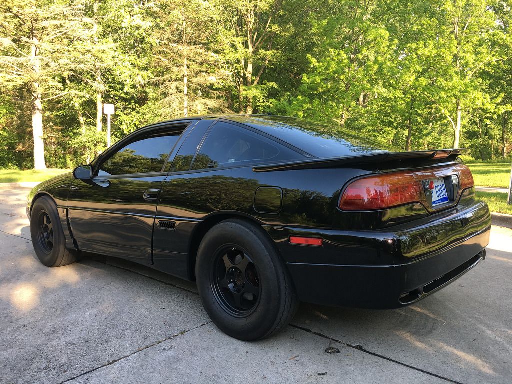

Some photo's I took today of the car as it sits..

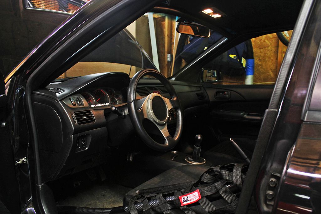

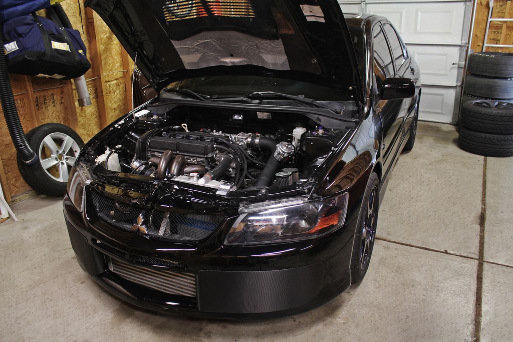

And here's a photo of the Evo. Its a 2.0l with 6262. Car trapped 145mph a few weeks ago, but only saw a 10.1 (suspension issues which are now sorted). I'm racing it in the SE class at this years shootout.

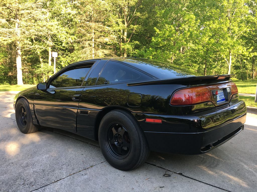

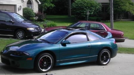

So this is where Austin's car went! Glad to see it's someone who is going to take care of it! It's by far one of the cleanest 1g's to come through our neck of the woods so it will make a great show/street/strip car. Those Drag wheels actually came off of my car, I still have the receipt for them from 2005 LOL
Thanks! The car is definitely in good hands. It's very clean which seems to be hard to come by now.
And that's crazy! Do you know what they specs are on them? I'm too lazy to pull them off and check LOL. I'm not sure if I am going to keep them or not. I may sell them for a 2nd set of 15x7 slipstreams for the street and wrap them in radials.
Ya I know they are 17x7 but not sure on the offset. They are still made and can be seen on Discount Tire's website or Drag's. I'll see if I can find a picture of them on my gsx LOL

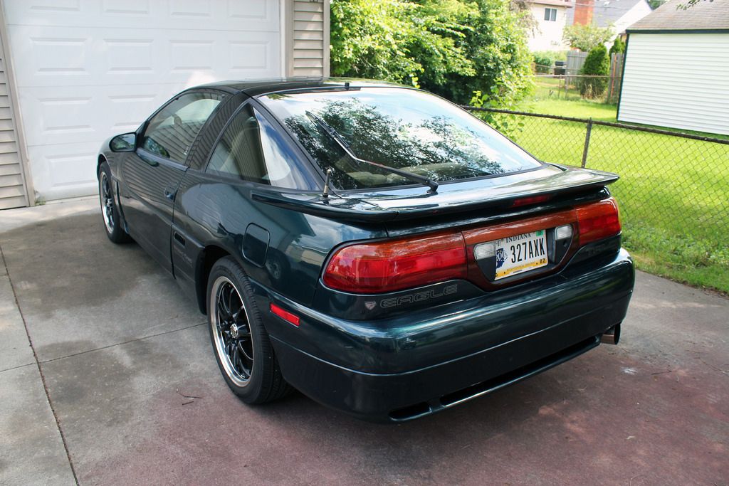

Here's a pic from the day I got my car
Looking good! And thanks for the specs.

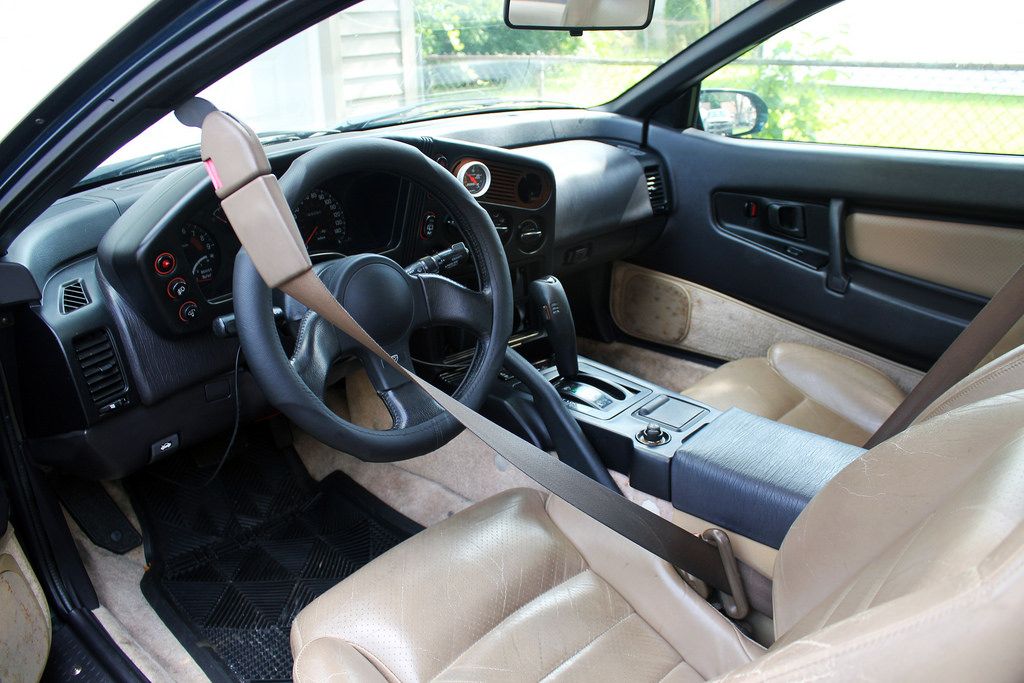

Definitely going to be going fast with class. Interior will stay 100%. I'm going to be switching out the factory seats for kirkey's with black cover's probably to save weight. If not i'll at least be on the look out for the black checkered seat combo (not a huge fan of tan).
How do the padded covers for the kirkeys feel? We had Kirkeys in a friend's Talon with the "covers" that weren't padded at all, more like a thin piece of cloth, and it sucked to sit in for more than a pass or two. Single digits though, definitely some compromise has to be made for sure. I'd rather be safe than comfortable, if I had to choose.

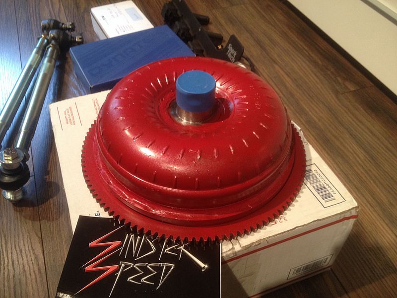

Sinister Speed 8" Core 2 "Spoolinator"

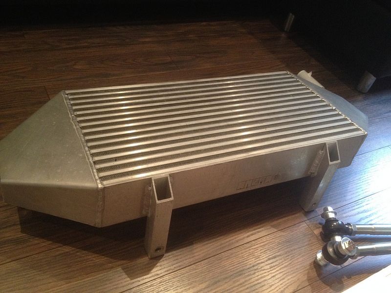

4" Garett Core FMIC off Deric Dupey's car.
Lots of other stuff including the Jay toe eliminator kit, maximal rear control arms, boostx rear subframe & mustache bushings, bullfab front cross member, etc.
The Forced Four Shiftbox plus arrived yesterday. I've decided on using buttons on a steering wheel for up/down shifts, then the optional TCU package to switch back to the TCU with a toggle switch for non/full pressure auto shifts when street driving.
I have also decided to order Jeff Bush's t-case brace along with the aluminum transmission pan he offers. The pan will help with trans temps quite a bit.

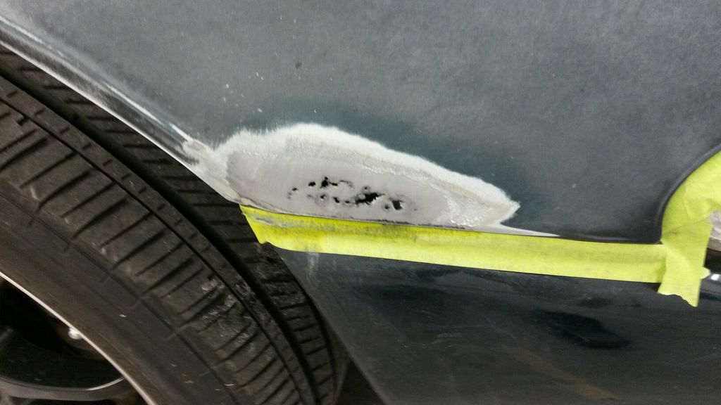

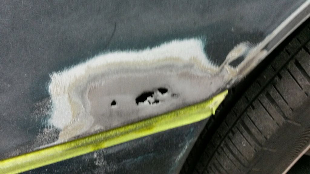

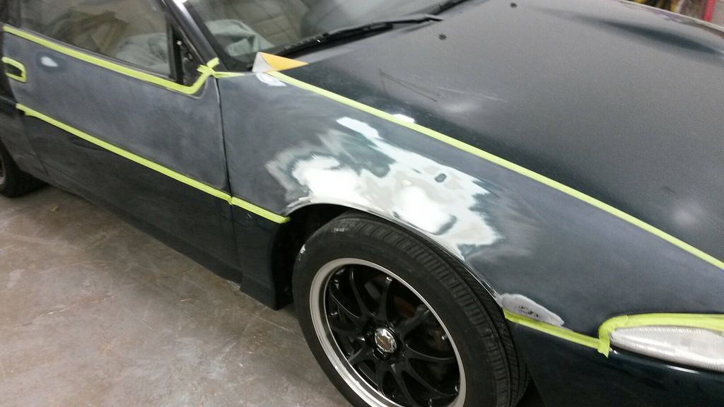

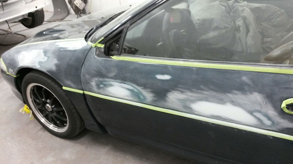

Yep that's a common rust spot. It's double pannel there so the salt and stuff sits that and rots from the inside out. I'd be checking the fender bottoms too.
Yeah, I figured we would find some rust there. We are patching the bottom and the side shown in pictures.

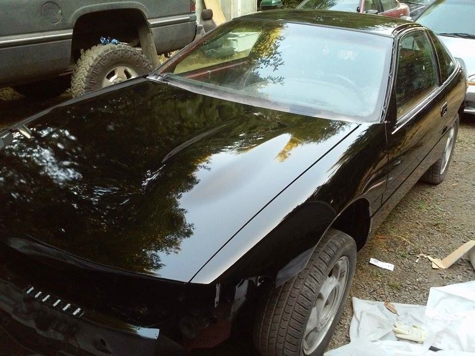

Just painted mine Ppg black. It looks amazing you will love it. I have a few pictures of it
That's sweet! Looks good in the 1 picture you attached. Any more completed pictures?
