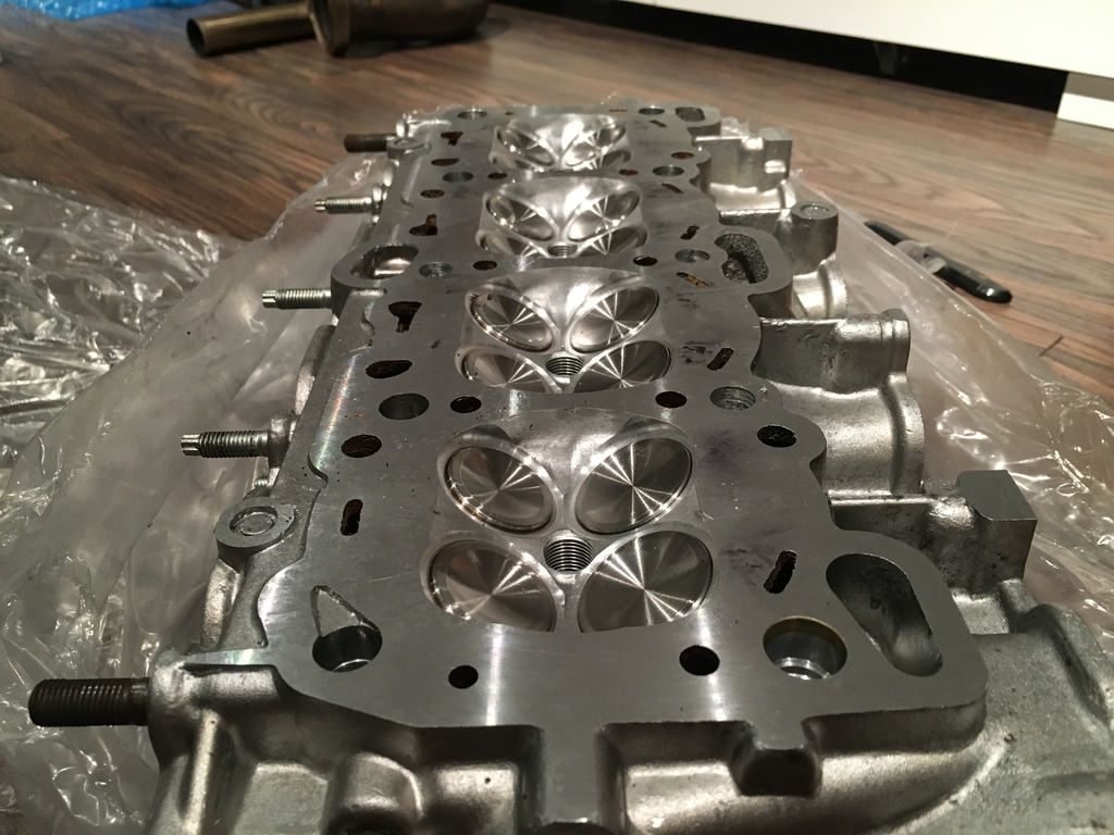

Curt Brown 2g cylinder head

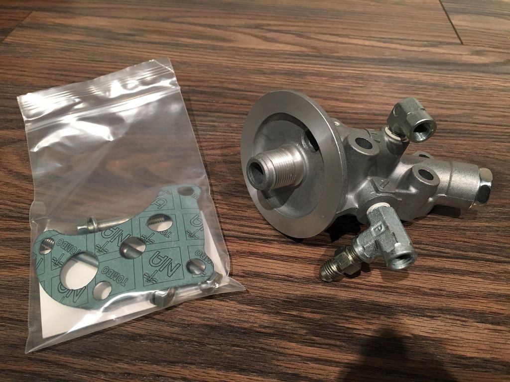

...and a forward facing filter housing with outlets for my turbo feed line, oil pressure gauge, and oil pressure dummy switch.

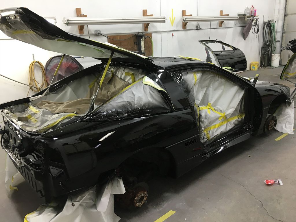

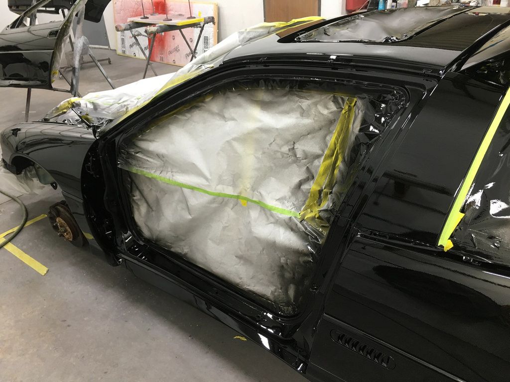

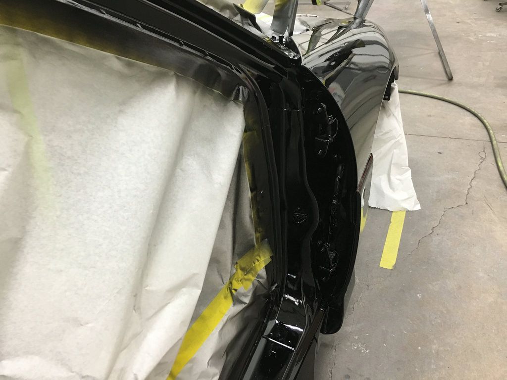

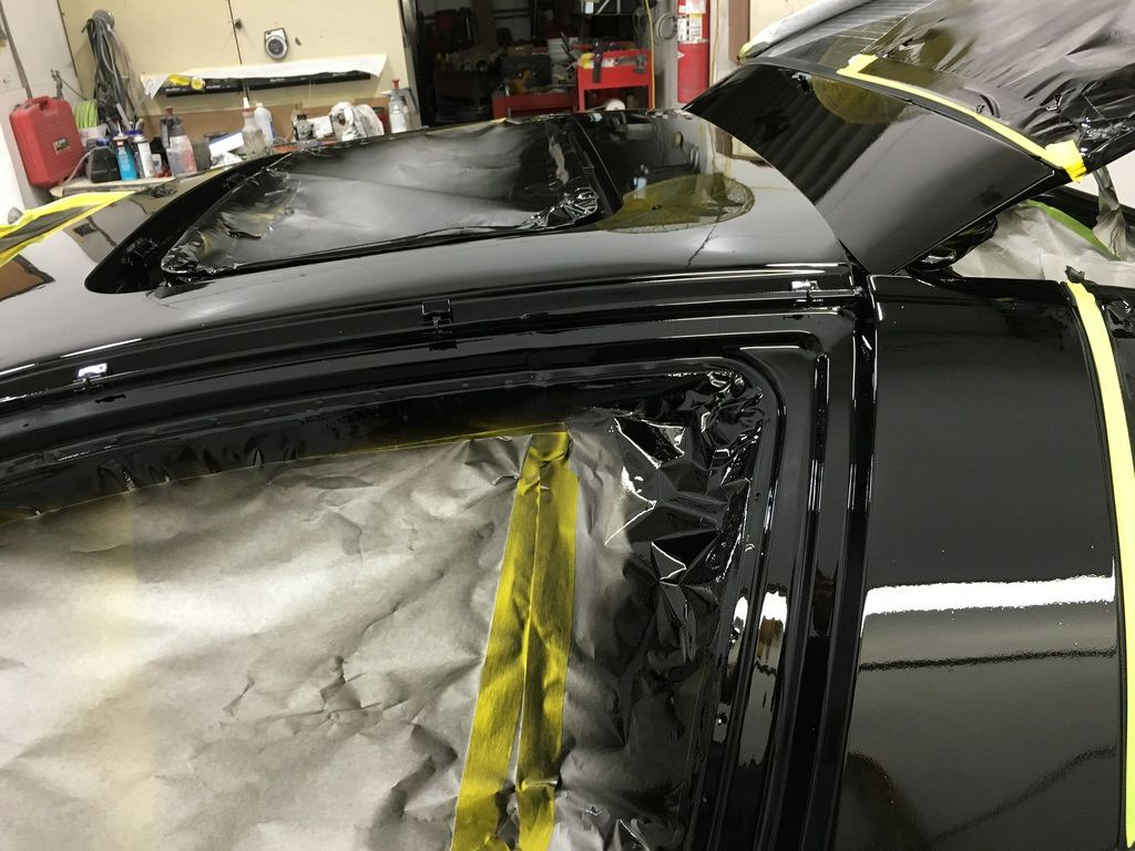

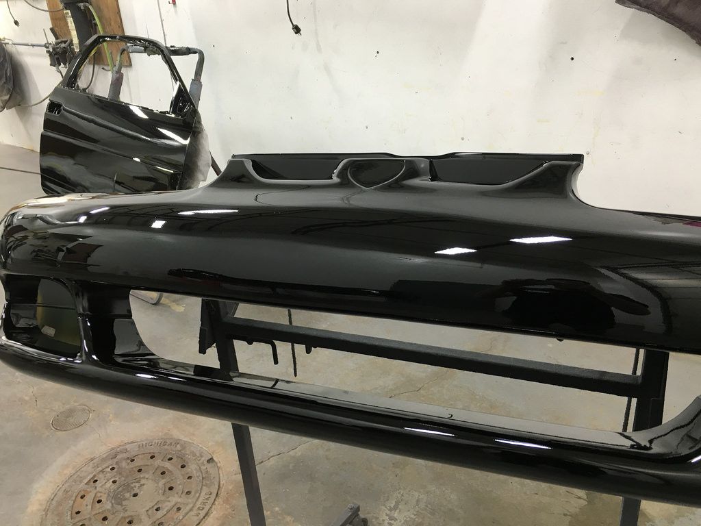

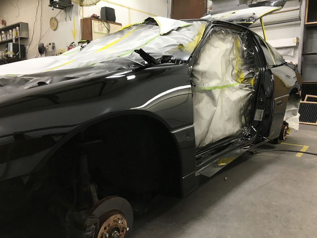

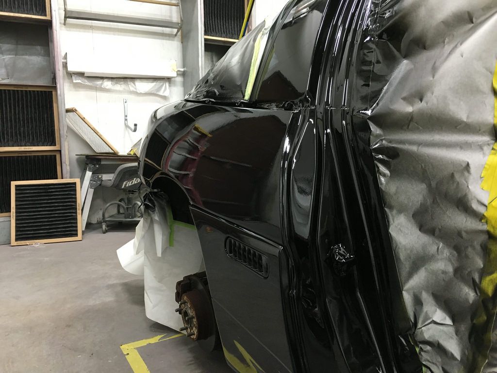

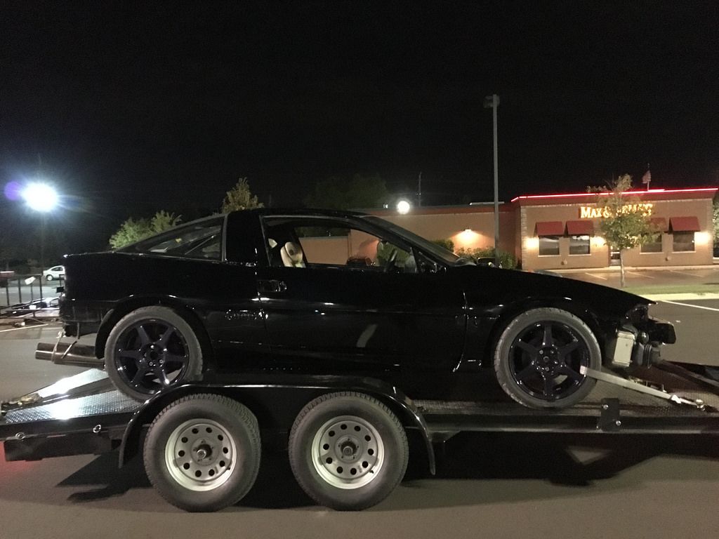

Paint is all finished. This is the result before a little wet sanding that will get done tomorrow to clean up any little issues. It looks absolutely stunning.
This is the darkest black you can possibly paint a car. There are zero colors mixed in it. The clear also has some black in it (notice the vin tag in the door jam which got cleared over).
Car comes home Tuesday.

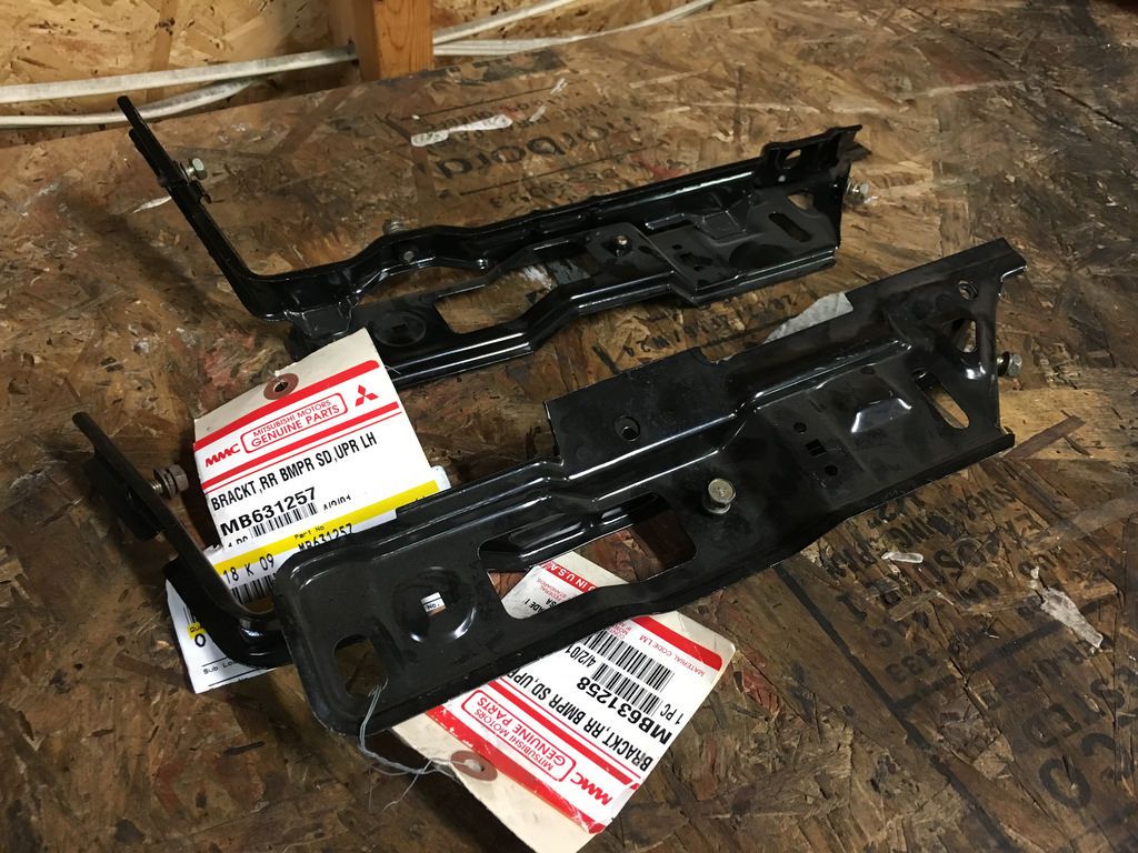

Had to get new OEM rear bumper brackets. Aside from every bolt breaking, they also disintegrated when took them off the bumper LOL.
I really can't get over how much better she looks now! I'm not too surprised about those brackets, I think every 1g probably needs them. Ha
I figured it's normal seeing as the rest of the car was pretty solid haha.
Thanks man. Countless hours of prep work to get it nice. Can't wait to get it back home and get started on things!

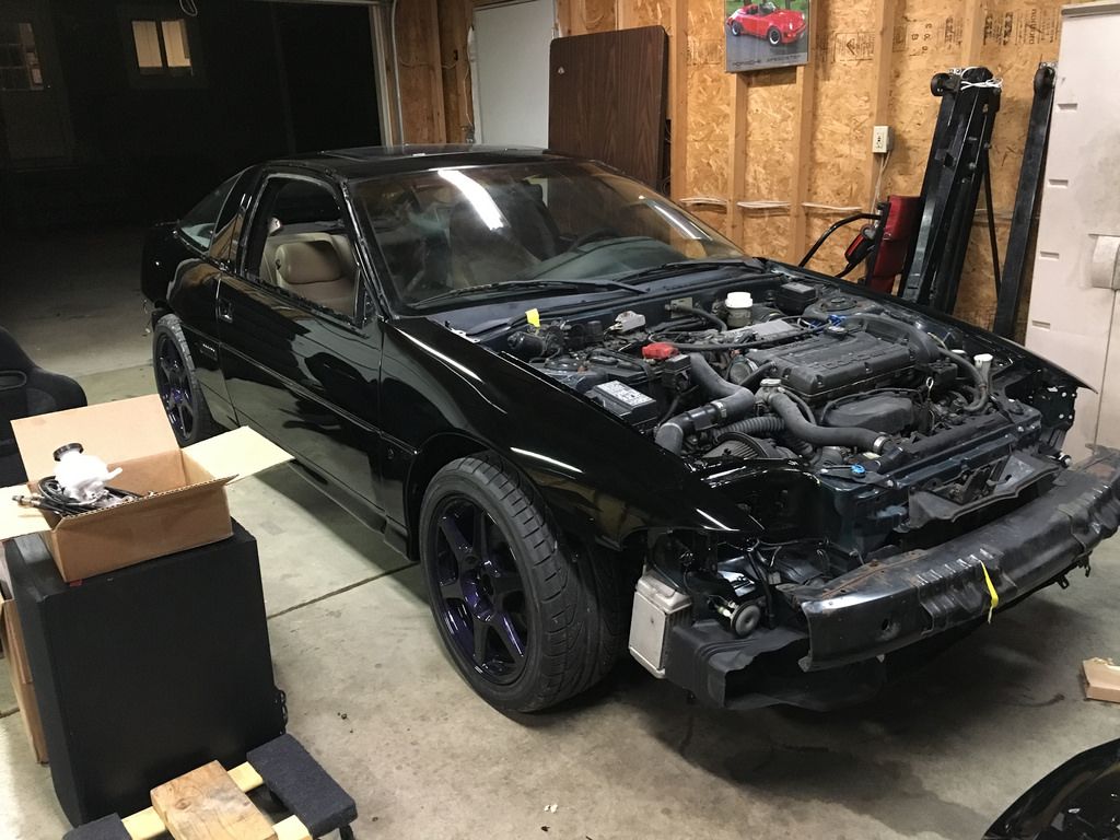

Brought the car home last night and finally in the garage to get some work done. I have 9 days off starting tomorrow so i'm hoping to get a lot accomplished.
Things i'm hoping to get done:
Clean the garage
Get the rear sub frame and rear suspension stuff all done
Remove motor and get the block stripped down
Trim paint the engine bay
?Build the trans/get diff out for welding

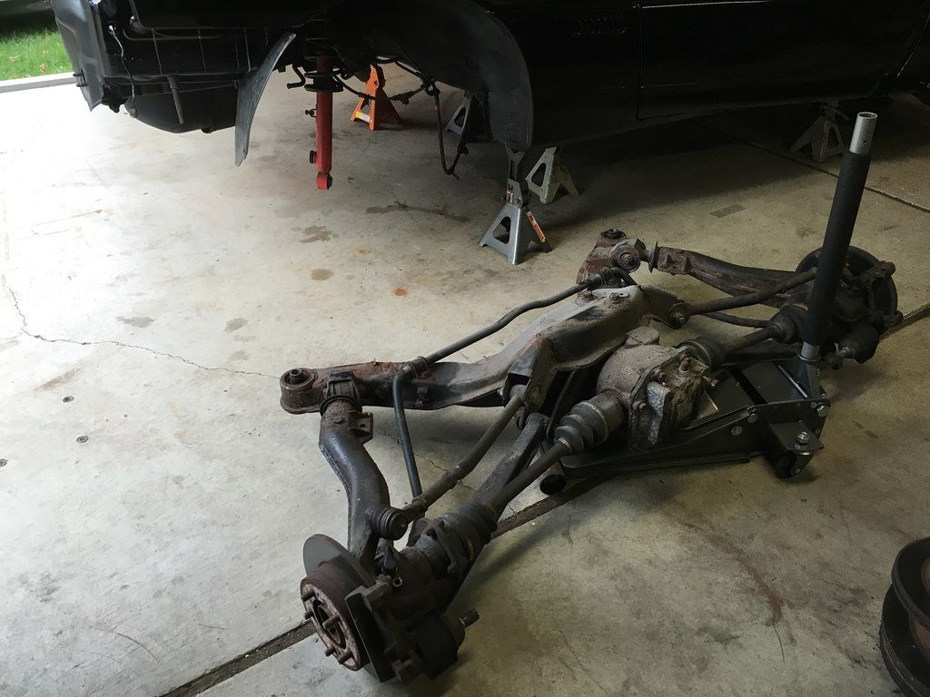

Subframe out

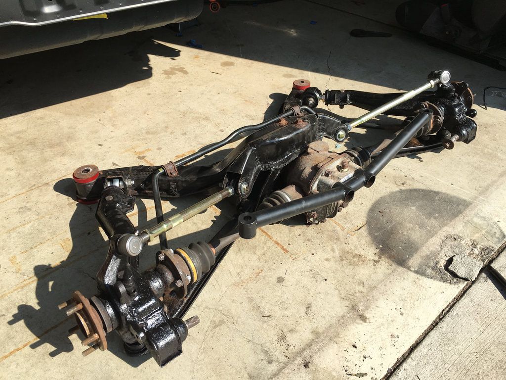

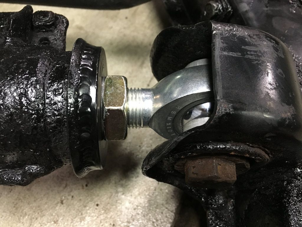

Jay racing toe eliminator, maximal control arms, boostx subframe bushings, bullfab rear mustache bar, cleaned & painted. Took a lot longer than I expected LOL.

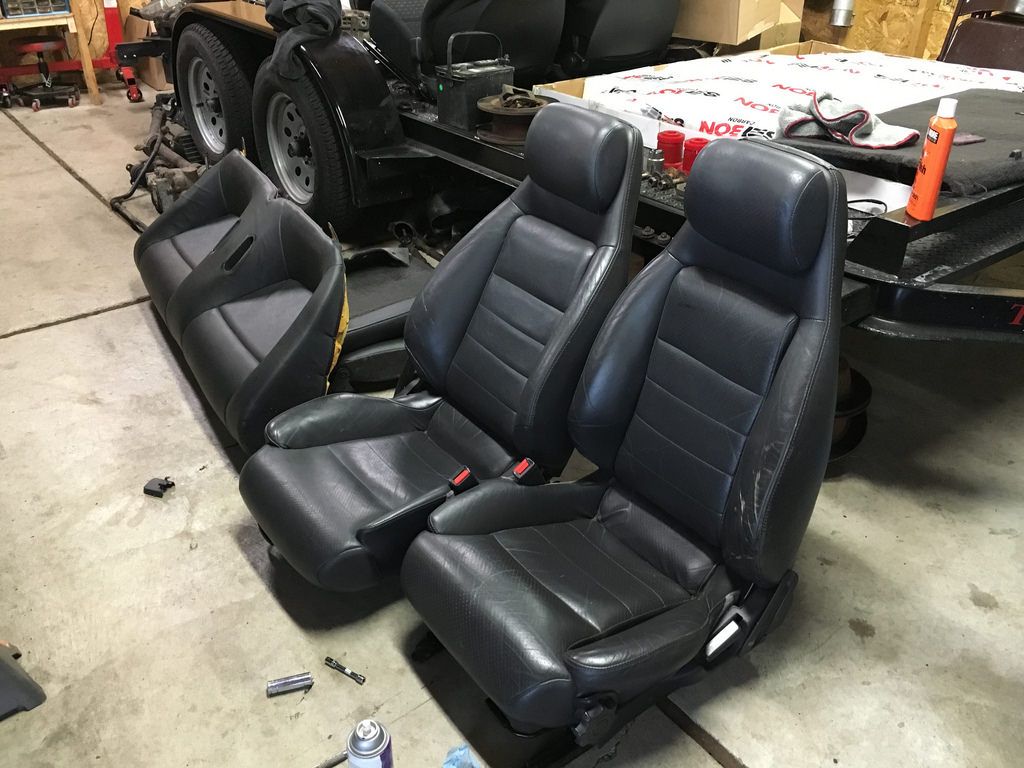

I also got a set of black leather front/rear seats in a trade. I'm most likely going to run kirkeys in the front, so i'll at least keep the rears.

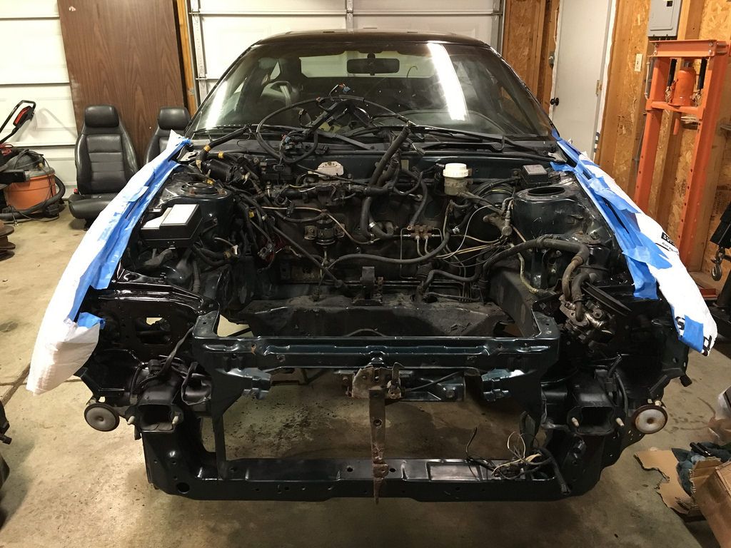

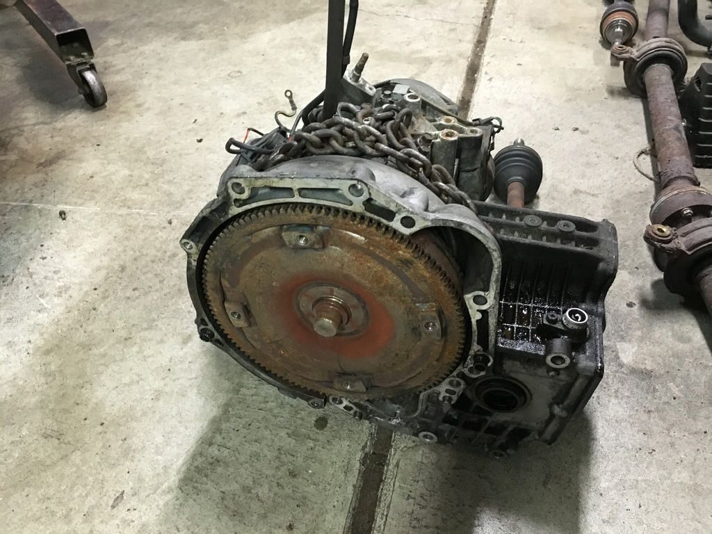

Took the trans out first. Couldn't get the damn passenger axle to pop out. Tried the hose clamp around the cup trick as wel but no dice.
I normally would have just removed the trans & motor together... however I wanted to see how it was just removing the trans should I need to remove it for whatever reason at a later date.

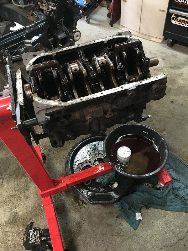

Tomorrow the motor comes out to strip the block bare for building.
