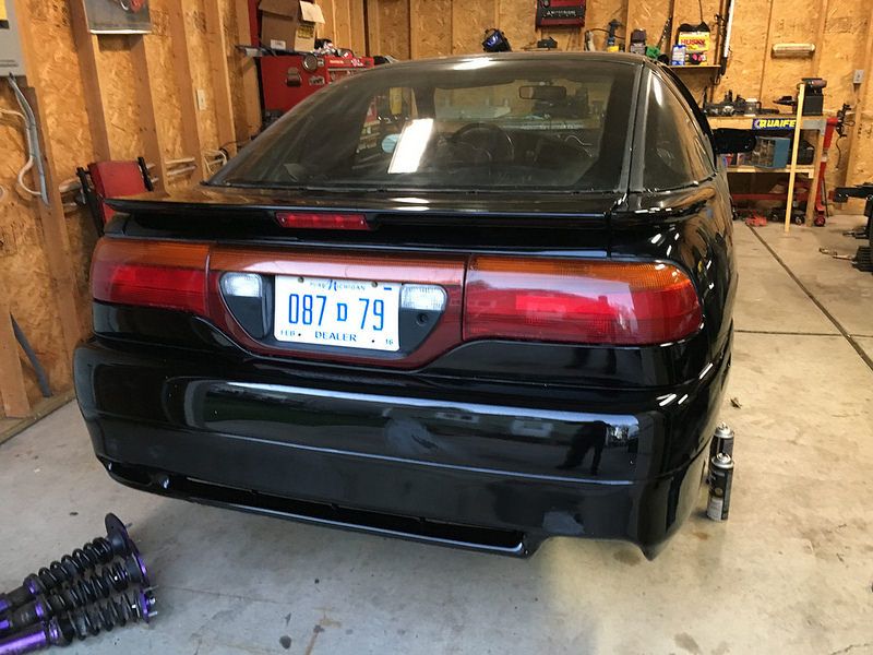

Sweet mother, where did you get those crystal clear lights and corners?! I've been looking for a set for years! I'm so jealous! :hellyeah:
Someone had a picture of their car with a set installed on one of the DSM classifieds on Facebook. I offered to buy them and surely enough they were mine :D! Got to think outside the box for these things as I've never seen a set listed for sale.

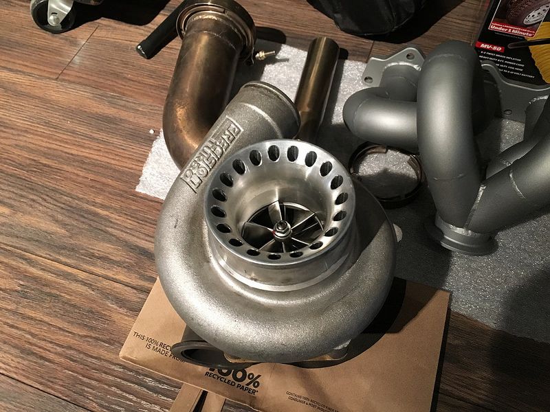

Decided to skip going with a bolt on turbo to free up some extra cash.
I picked up a ball bearing PTE 6262 with vband in/out .82 housing to use. The hot parts kit was originally off David Buschurs white auto 1g.
With that parts collection I would be too!
I want to get into that 62mm class too, but we will see the bigger turbos are proving to be a good deal.
This is the largest I can run with my converter for use without nitrous which is why I chose a 62mm. I had this same turbo on my Evo for 4 years and it held up well (journal bearing and T3 though).
