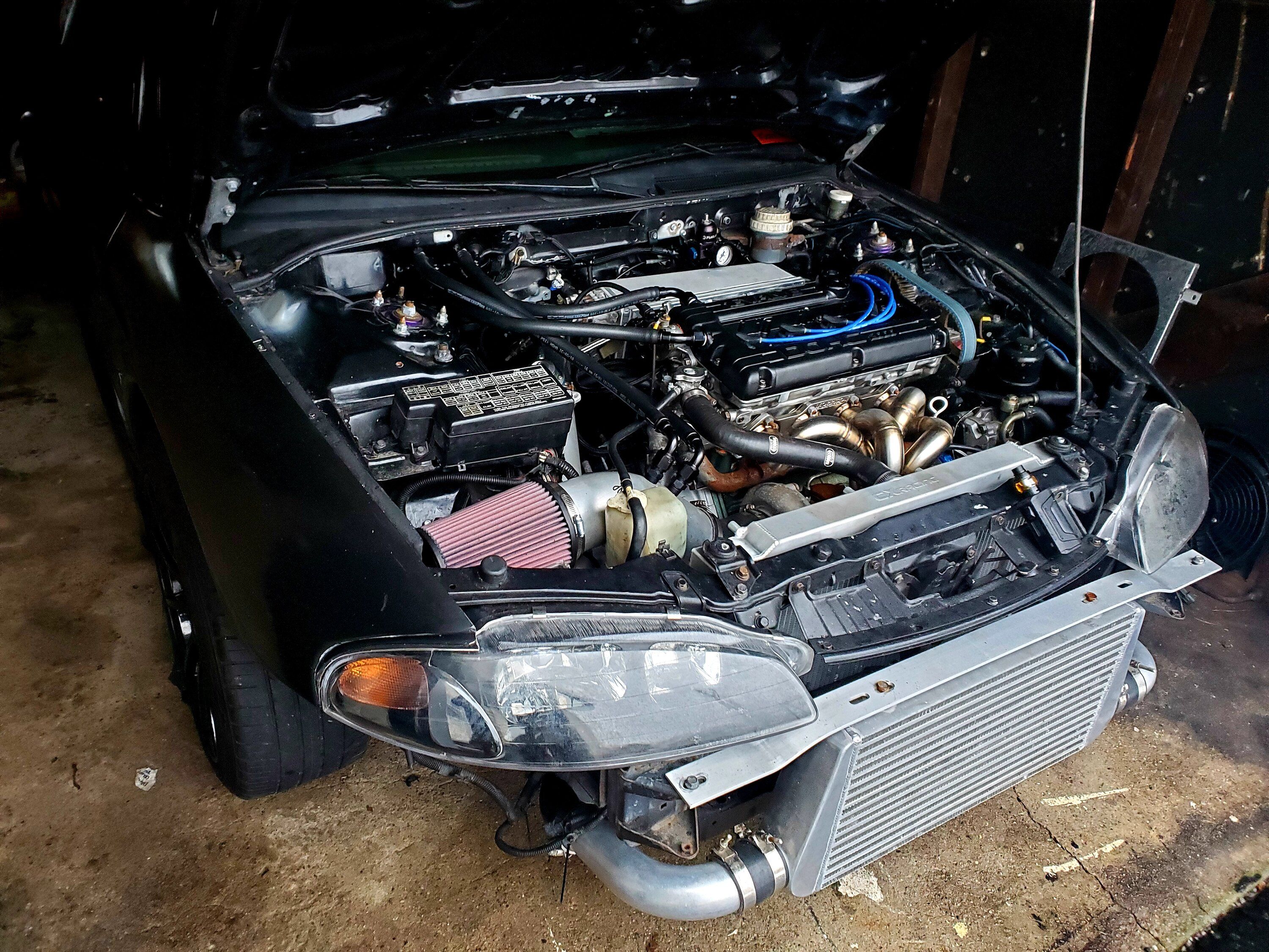

Junk yard find. What started as something to tinker on, has encompassed every second of free time i have.

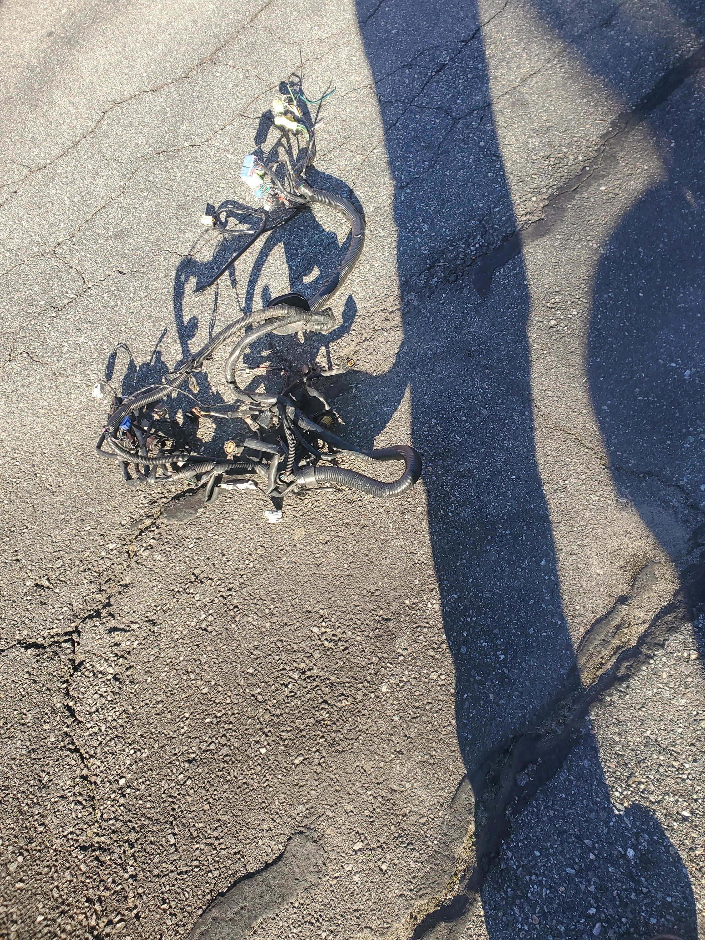

Not really, I have been working on a new engine harness here and there but nothing crazy. I went to continue diagnosing about 2 weeks ago and when I went to turn the key, popped the alternator fuse. Chased the wire and my charging wire was shot. Bought a new charging wire aswell as a 97 galant 90 amp alternator since that needs to be done anyway. Run a new charging wire, Battery cable, and extend my fuel pump rewire back to a kill switch on the rear bumper.

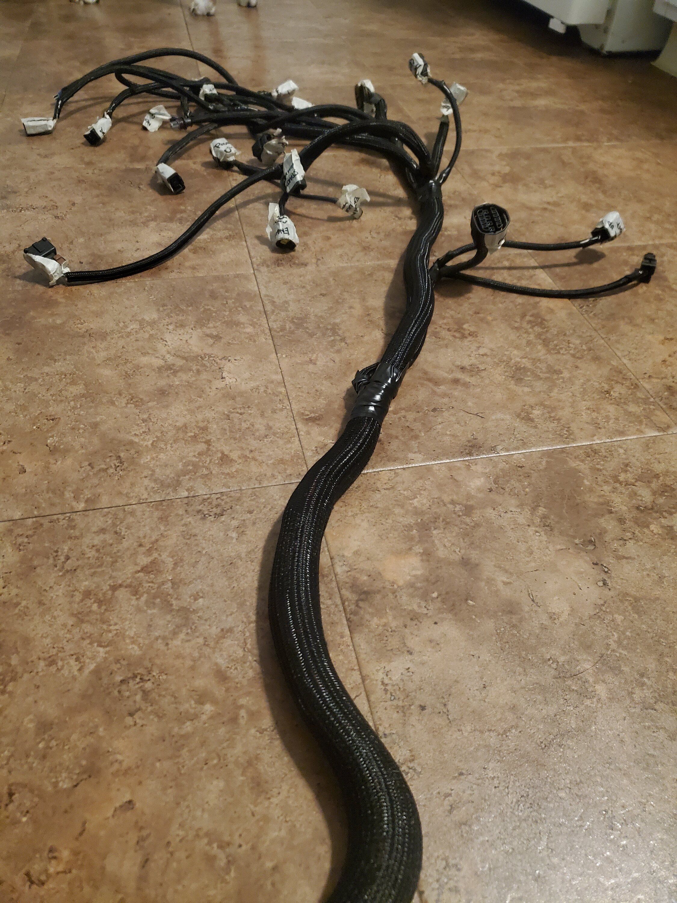

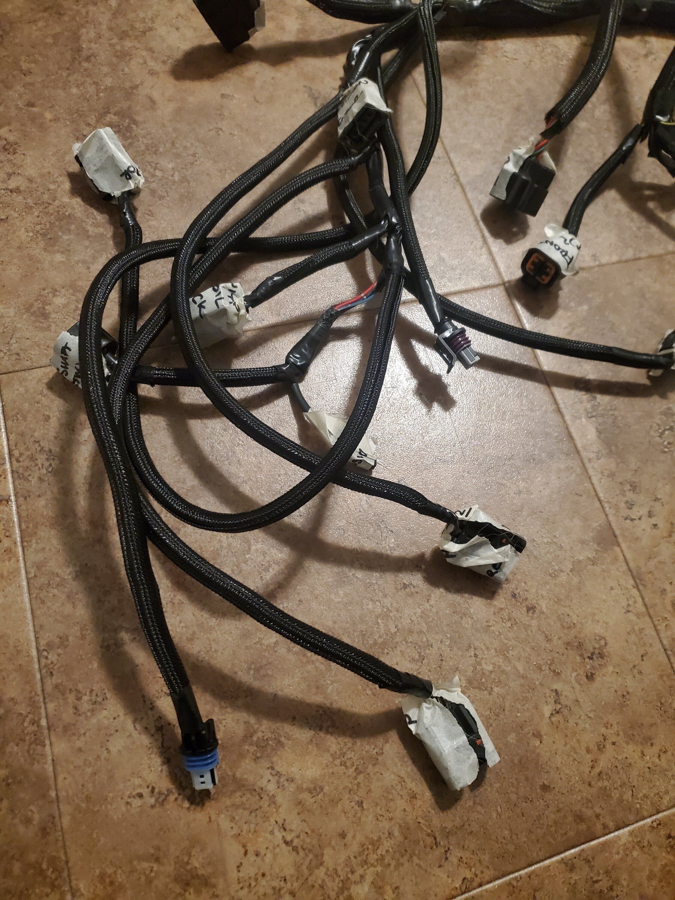

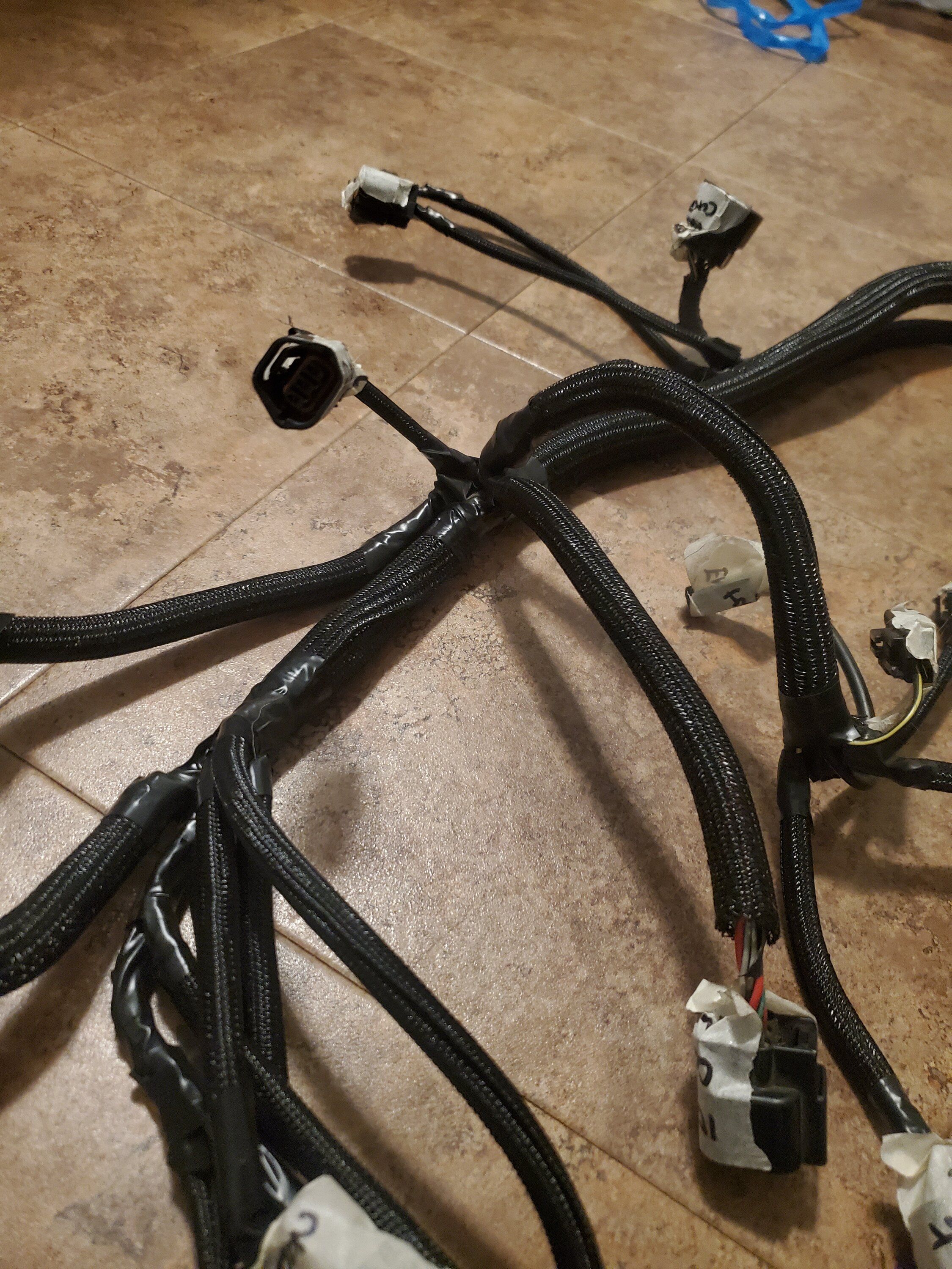

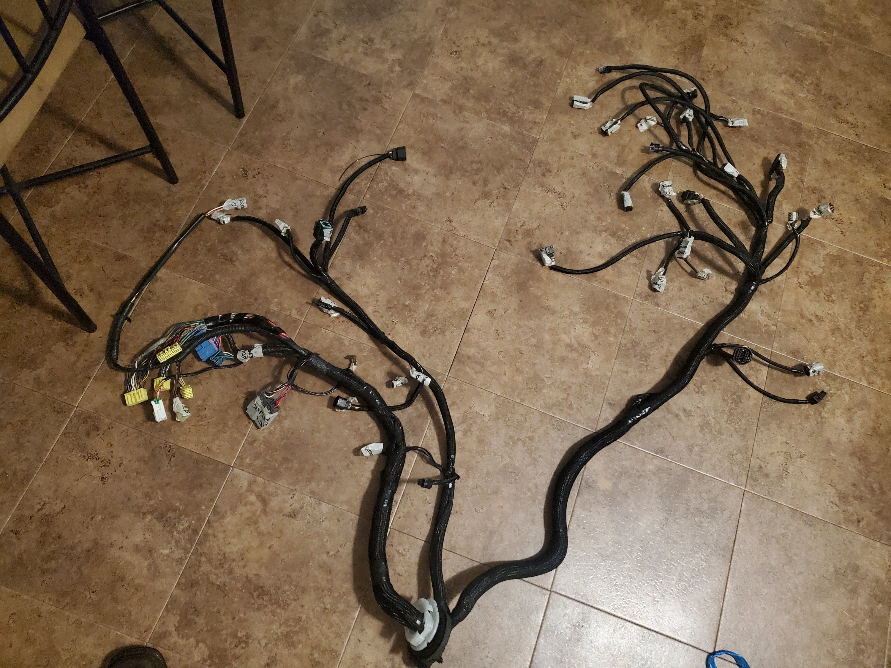

With the electrical issues I left off on I have decided to go through an engine harness that I picked up from a local and rebuild it. I can do that at home so I'm sure that will be done relatively quick in comparison to work on the car (snow).
Tomorrow I will be placing an order with OHM Racing for several connectors, some looming, and a bit of wire. I will also be getting a few pigtails and a decent crimp tool since I don't have one other than a generic autopart store one.

Everything checked out on the harness. Tested everything I knew how and im convinced it is good to go. Its still really cold outside so I'm relatively at a stand still but the fuse box and chassis harness are next. Then clean injectors, fuel tank, and change my inline fuel filter. Then try to start again. Im also going to test a few relays for good measure.
New alternator and jays racing relocation kit are in. Still need to extend the wiring but damn was that difficult to put in.... also pulled out the old wiring harness. New one will be going in this weekend. Checked the ecu to verify that that wasn't my issue and it looks fine to me.
