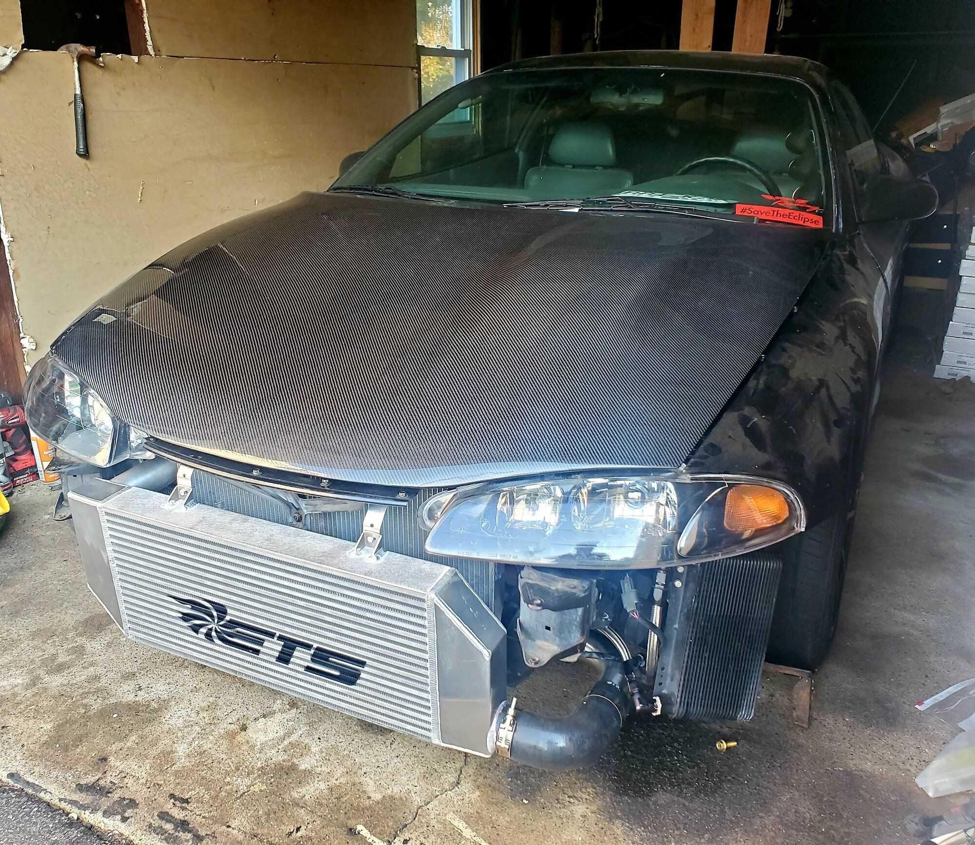

So I reached out to STM and they quickly got me a gasket and biss screw oring out the door. It will be here this afternoon. Tomorrow I am installing those and wrapping up some little things. Then putting body panels back on.
Well it runs. Has a really high idle I have to deal with. Biss screw doesn't bring it down much so I more than likely have a stuck tb, too tight a cable, or a boost leak after the tb. I'll figure that out tomorrow.

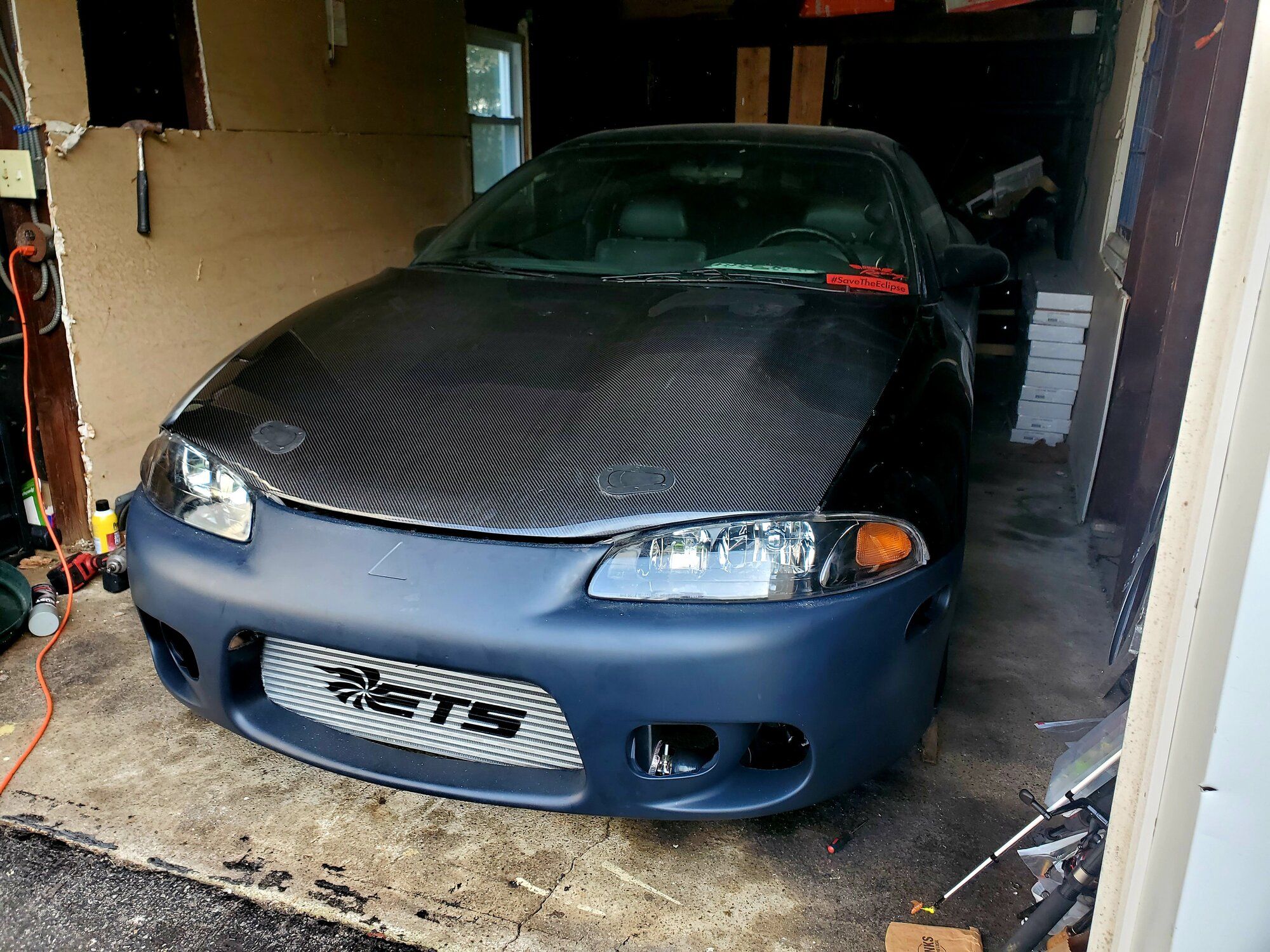

Body is mostly back together. I need to install hood pins and the bumper. Other than that, almost dyno time.
