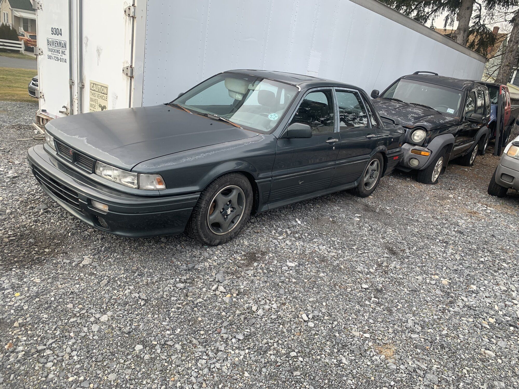

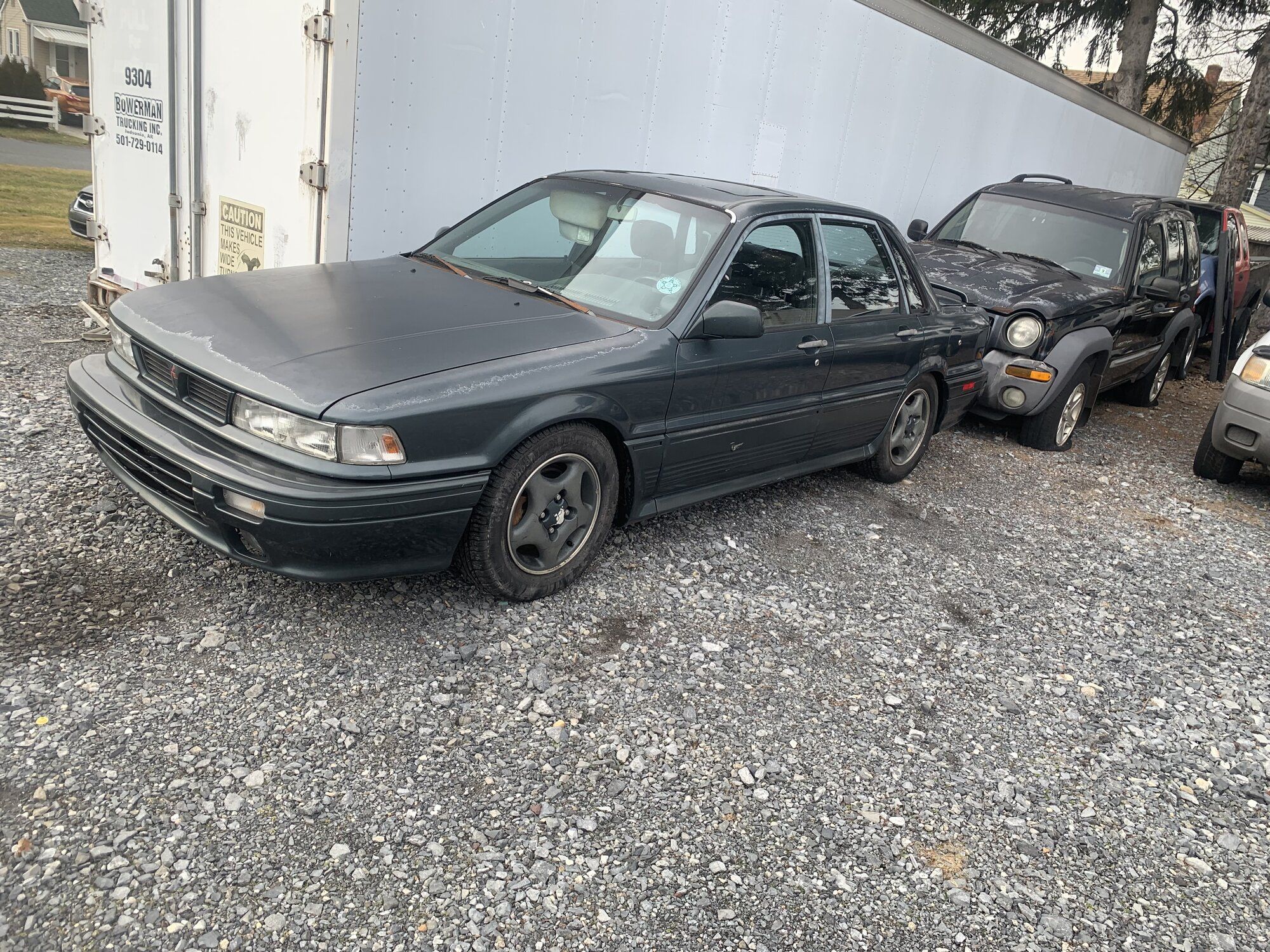

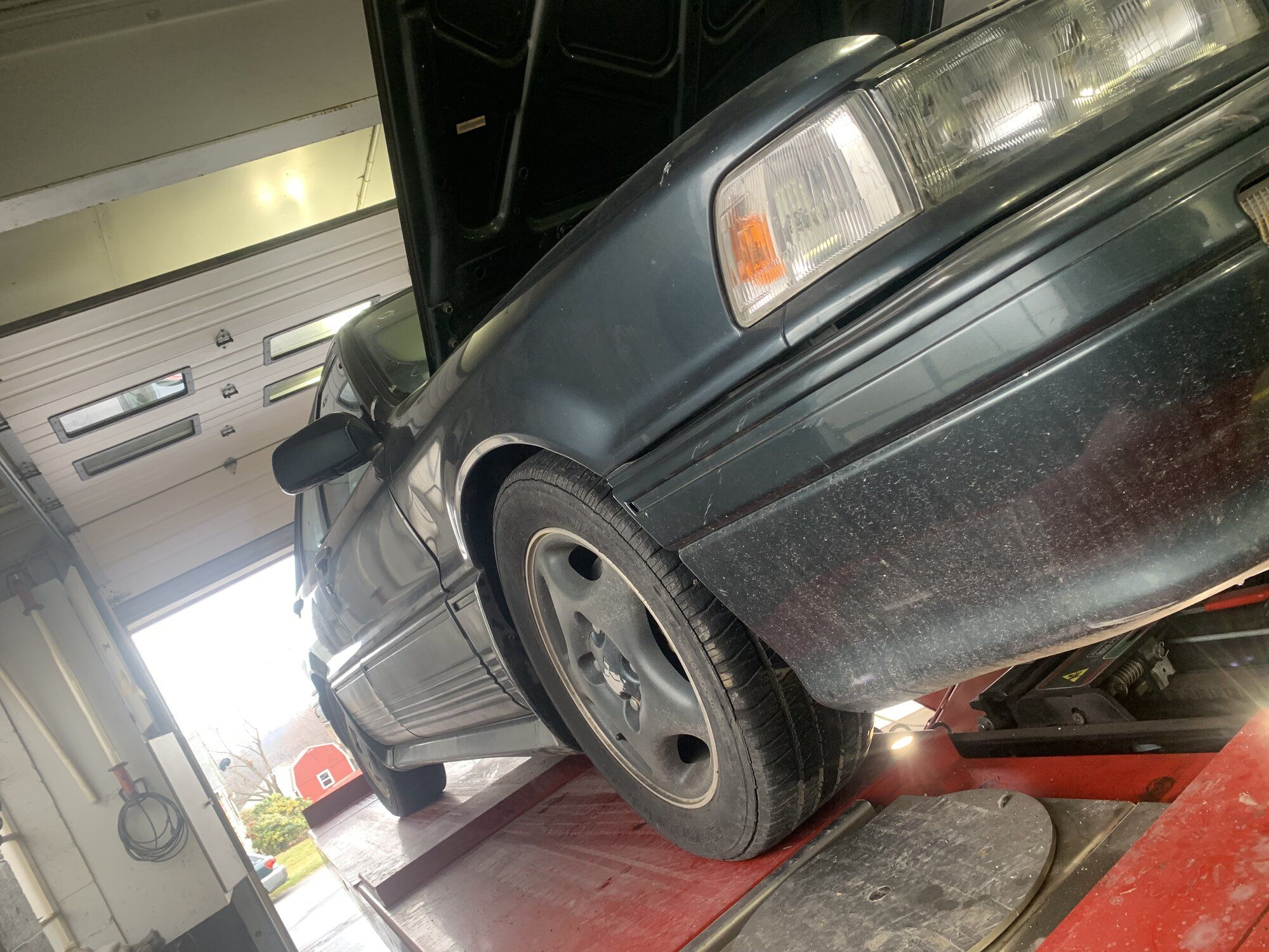

22/1000 Galant VR-4 saved from junkyard.
Got it car in shop today. Put some tires on it quick I had laying around.
Change oil in car and filter.

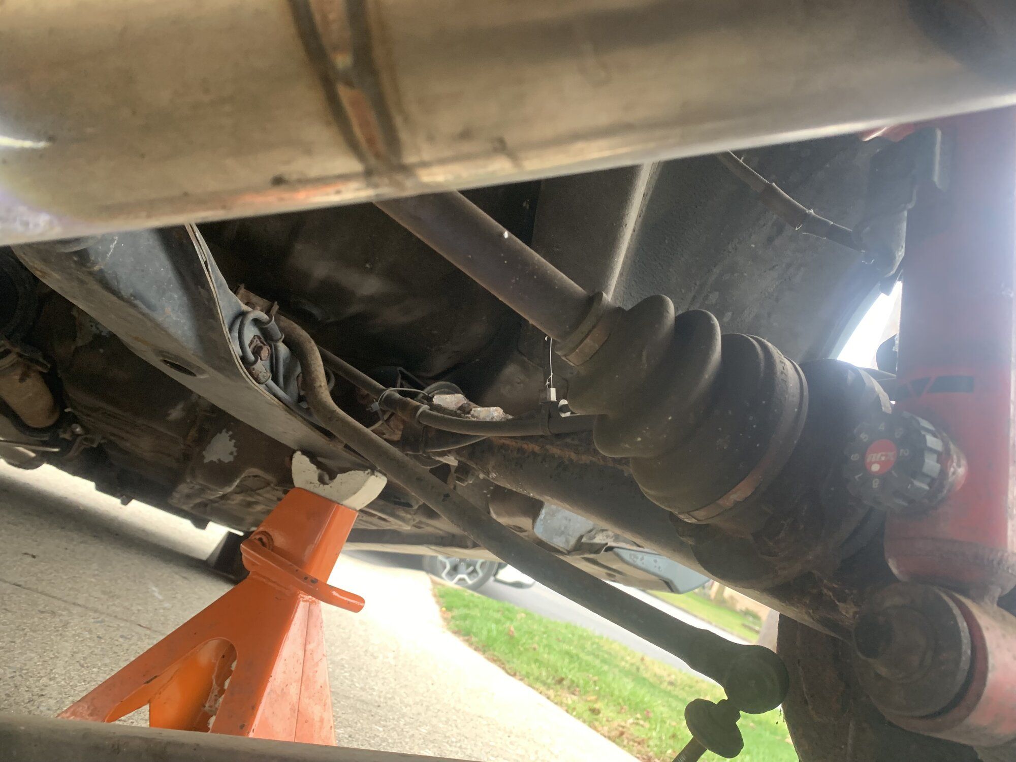

Also found out car has 4 bolt rear in it. No rear p/s anymore.
Subframe and all looked to have been powder coated at some point black looked good.

Car drove okay for moving it around. Took it around block once just to go through gears in it.

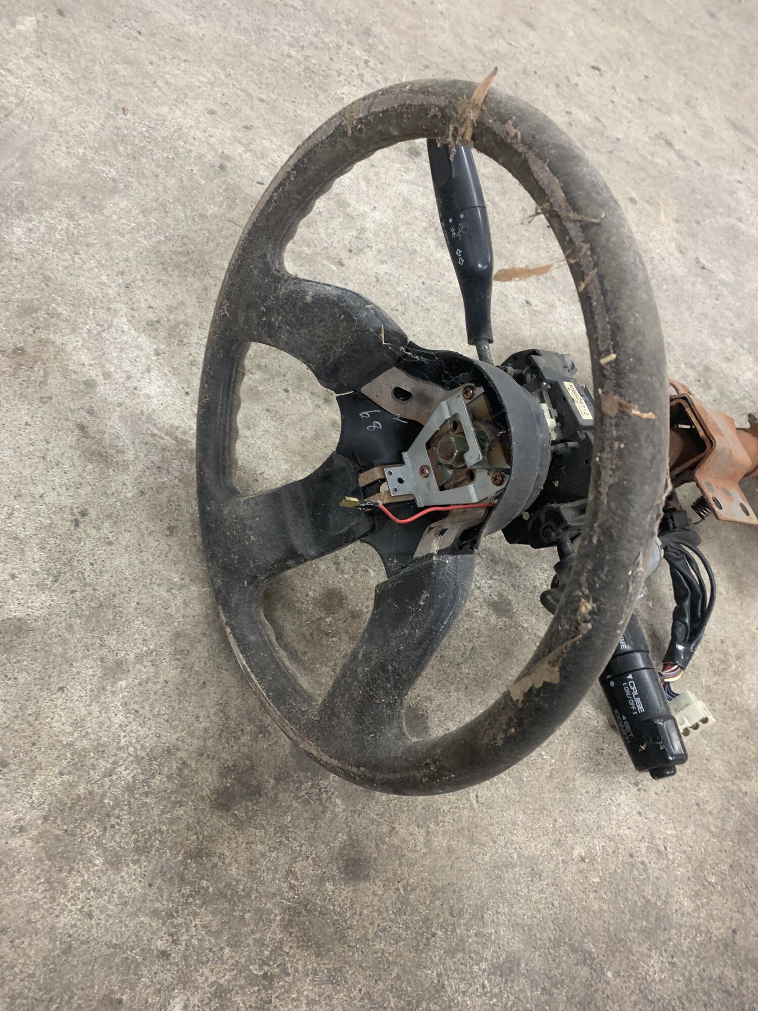

Then on hunt to find interior for car and steering column for it since they broke it

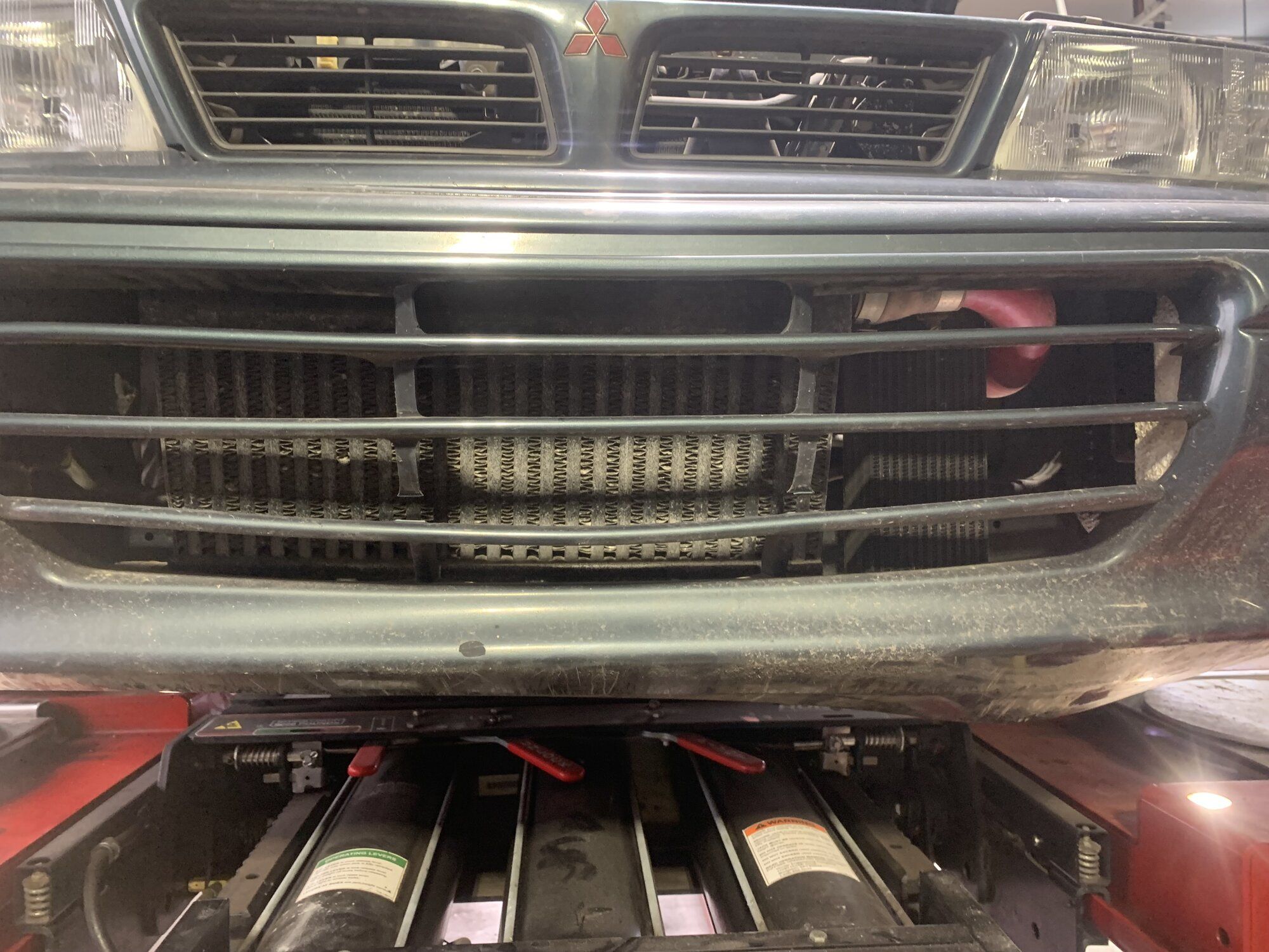

I'm so intrigued by these cars. How do the stock intercoolers work on these cars? Does this one have A/C or do you even plan to run A/C?

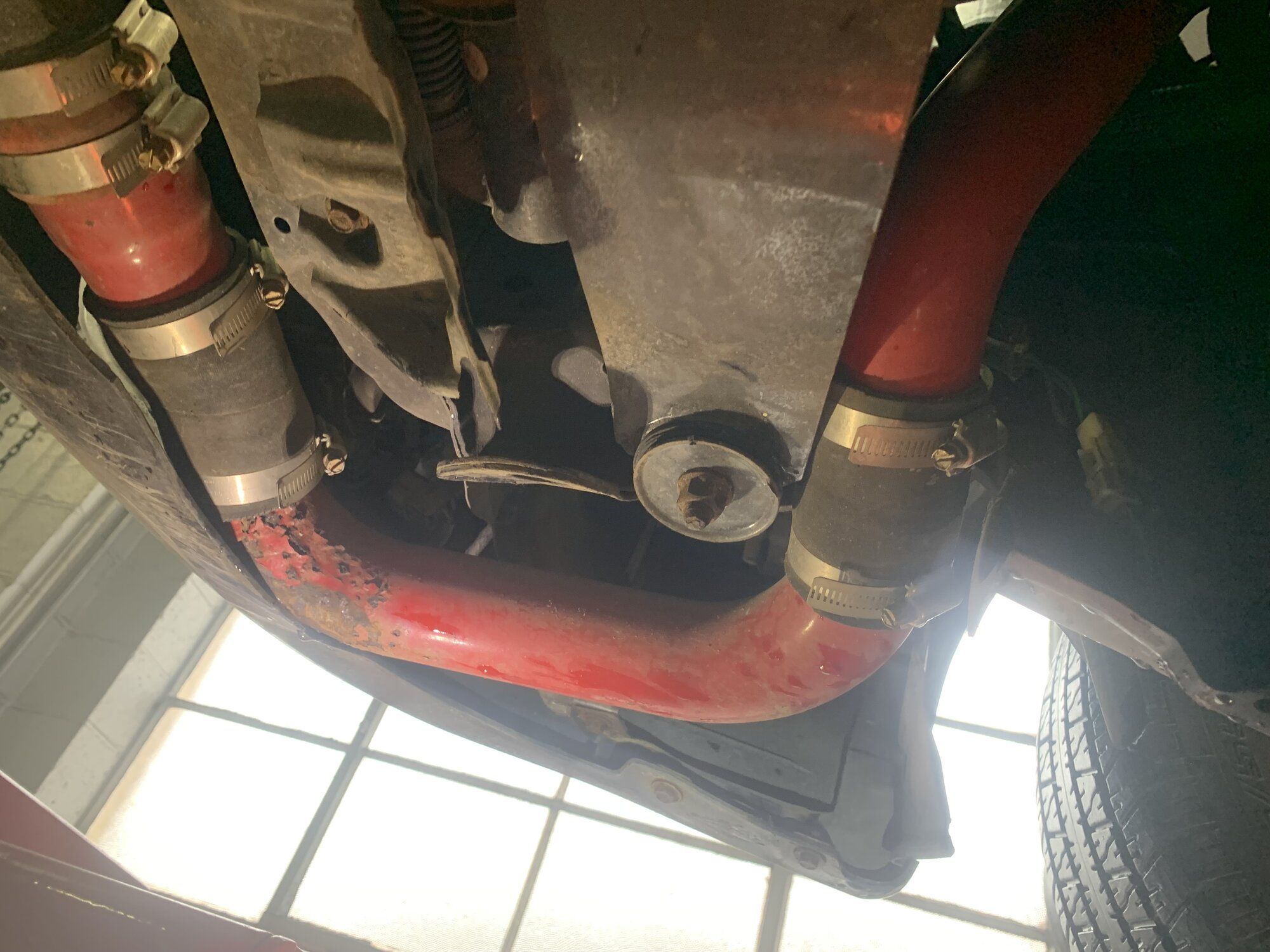

It actually has And old road race engineering intercooler setup on it and all.

It was at impound lot. Guess who ever owned never came back for it. And it sat this guys impound lot for from what I was told ten years.
Guy couldn’t find title for it. So he was going to junk shell. And just pull motor and trans sell it like that.
I have guy working on getting me title for it in the state of pa.

It actually has and old road race engineering intercooler setup and piping from them on car.
It's just a regular tiny intercooler but it's front mounted. Leaves the 14B and goes to the drivers side, forward through a cutout between the radiator and headlight, 90 into the intercooler, 90 down and under the passenger headlight to where a 1G intercooler is then the rest of the piping is similar to a 1G. But the stock MAF is in the "middle" of the engine bay with the battery right behind the passenger headlight so a little different.

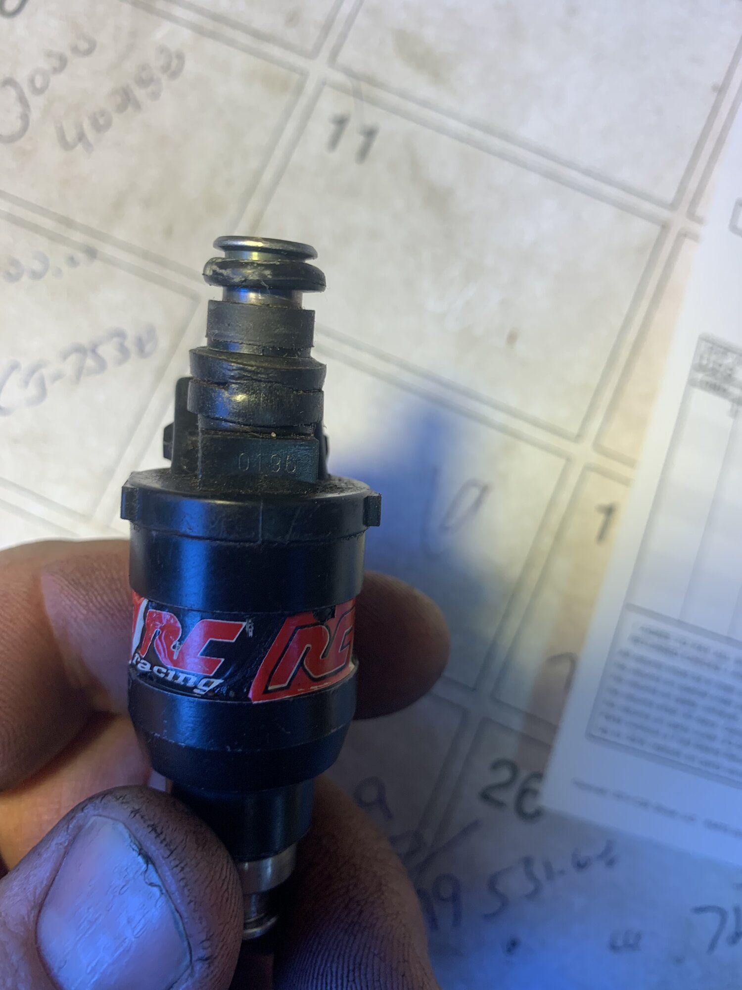

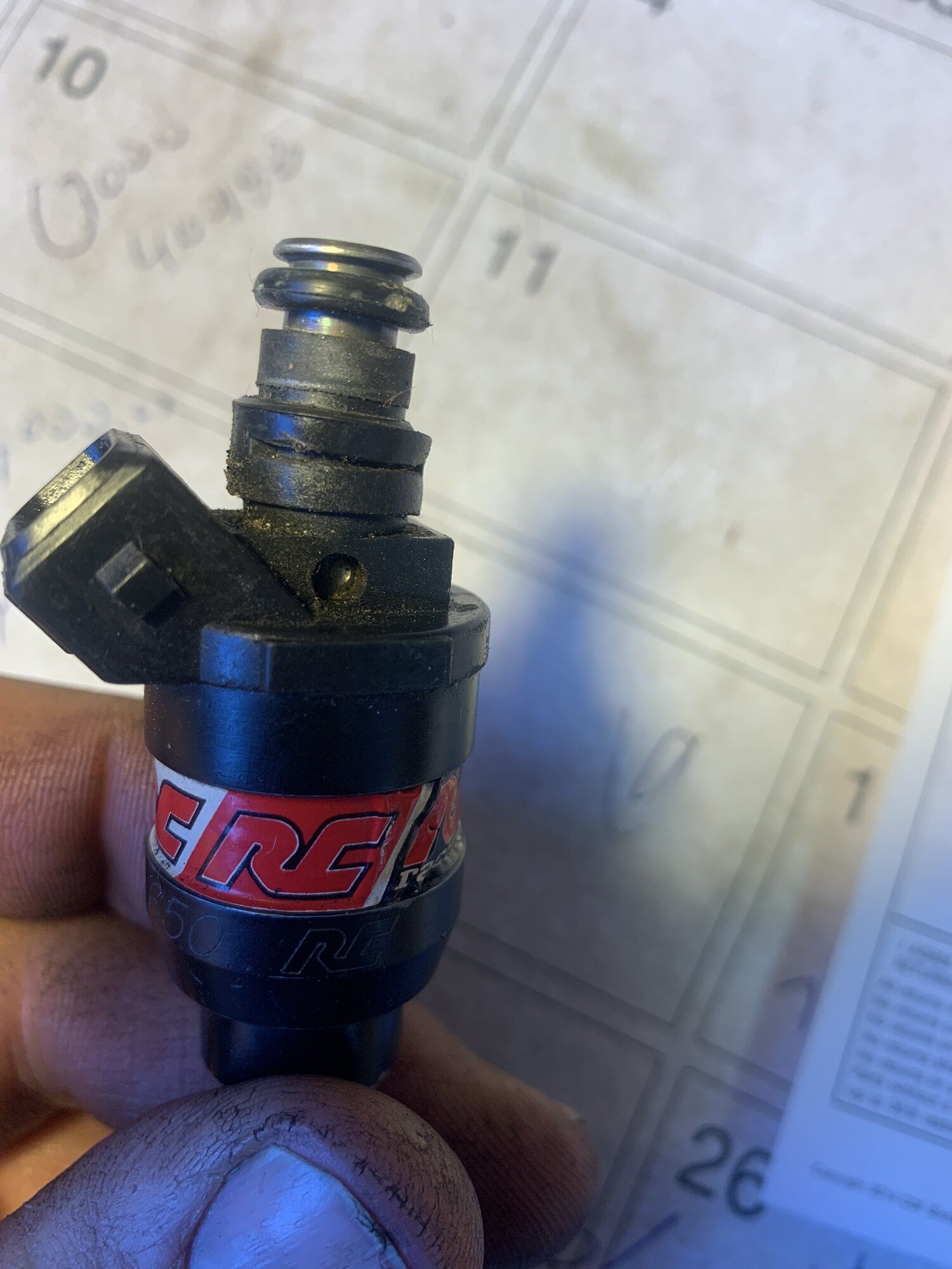

I removed my injectors the other day. To get them cleaned and checked. But when I got them out they were all bent up top a little. Like installed wrong at some point or whatever they were in before caused it. Now I don’t know what to do. I look for new injectors or some decent used ones to get cleaned up

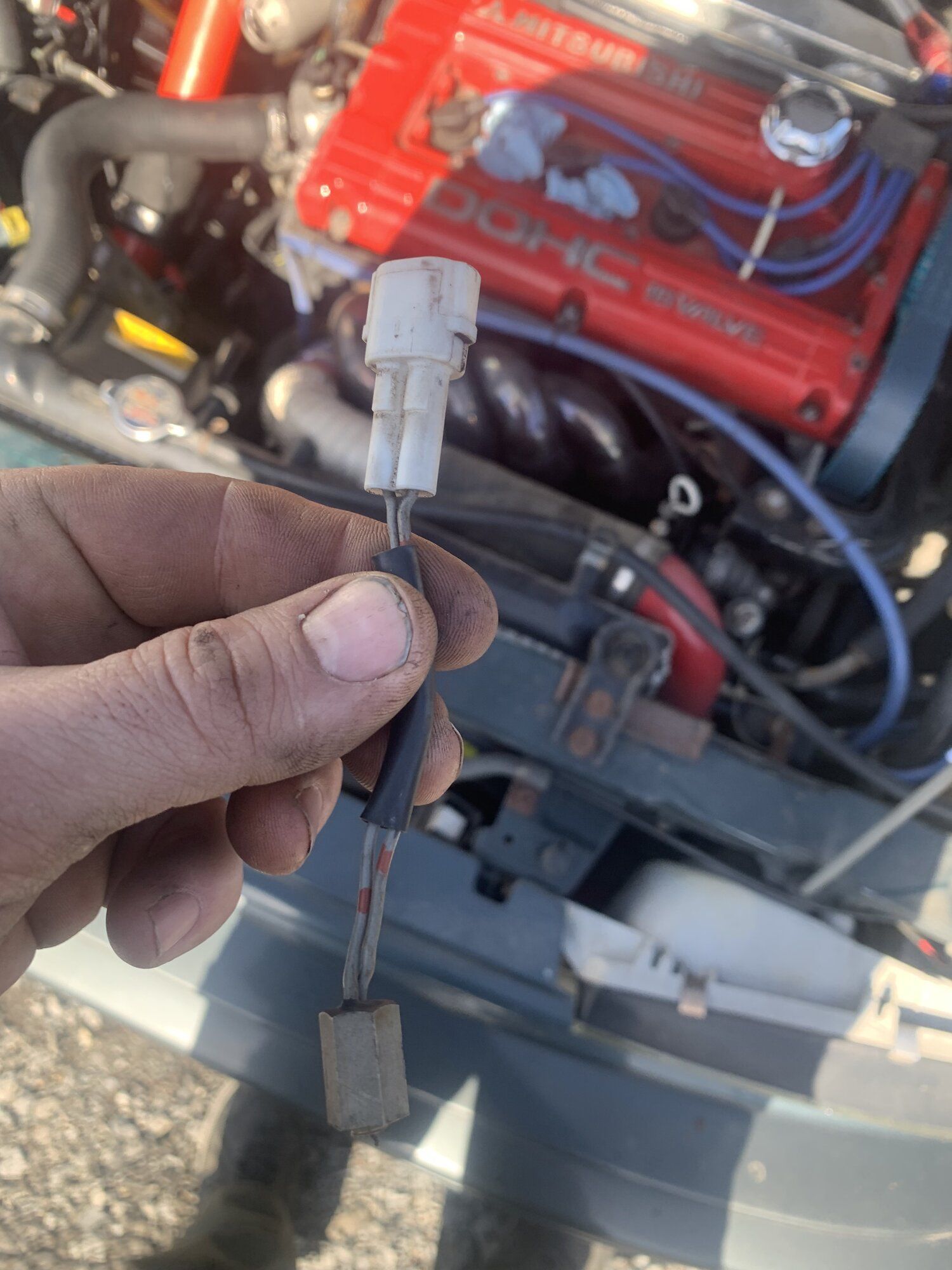

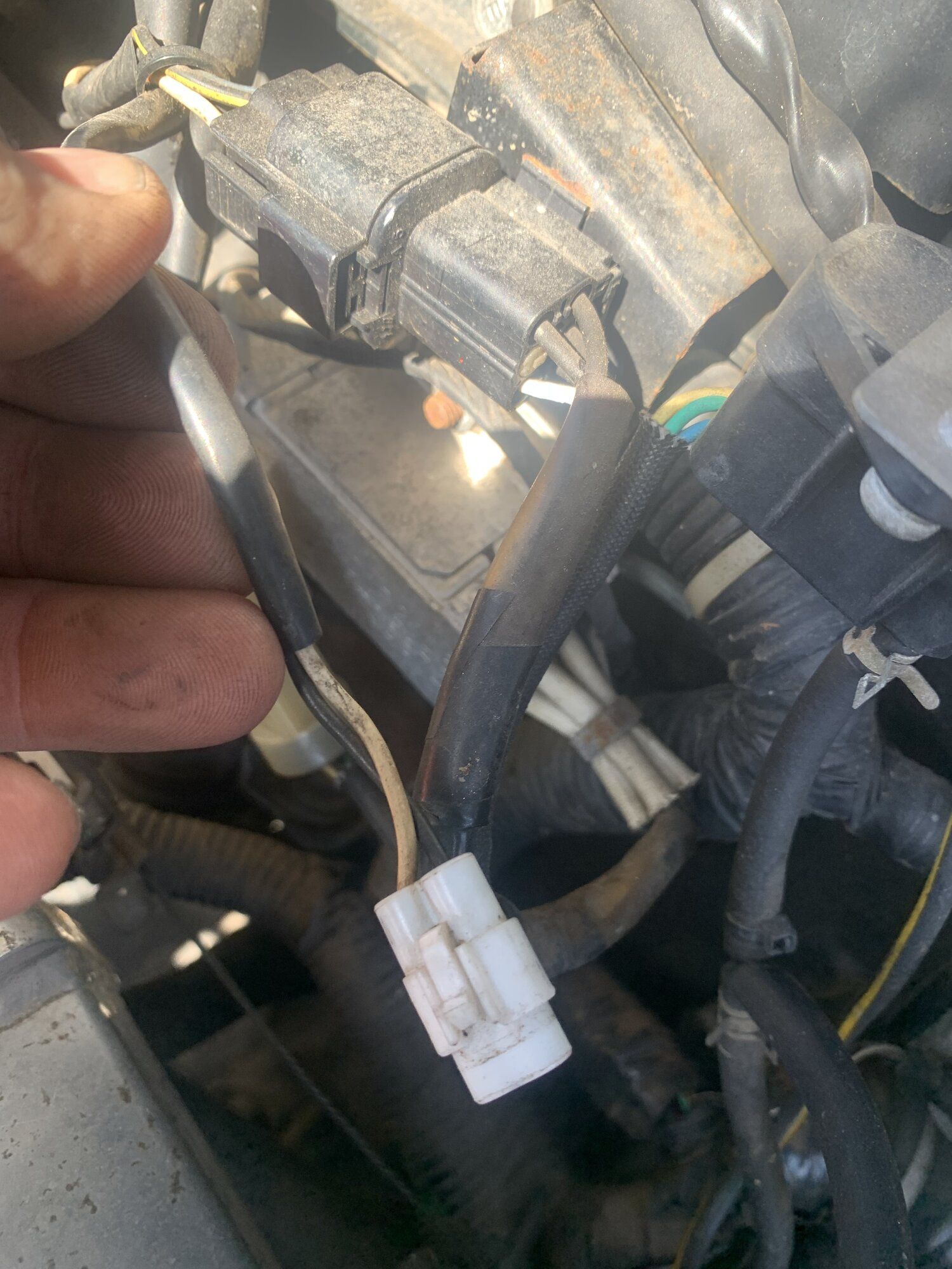

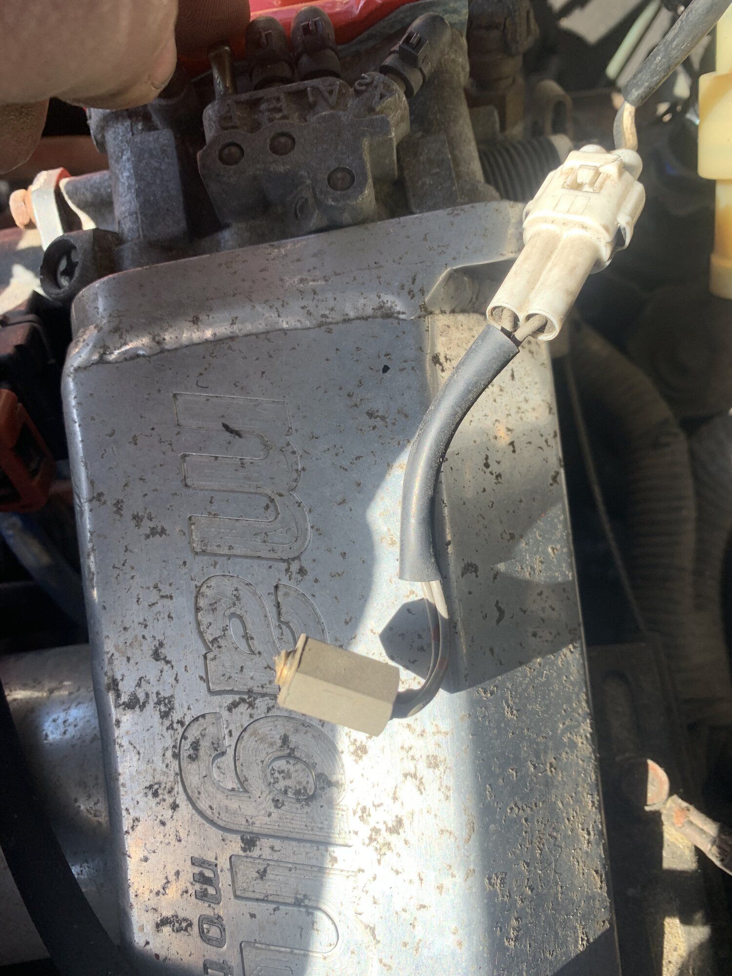

But found this Layin in engine bad. Not sure what it is or what it goes to.
Found spot on upper intercooler where it might go for I guess old school air temp sensor. Mabe part of hks vein pressure ssystem.

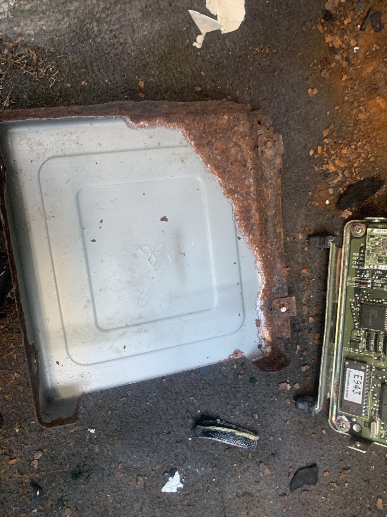

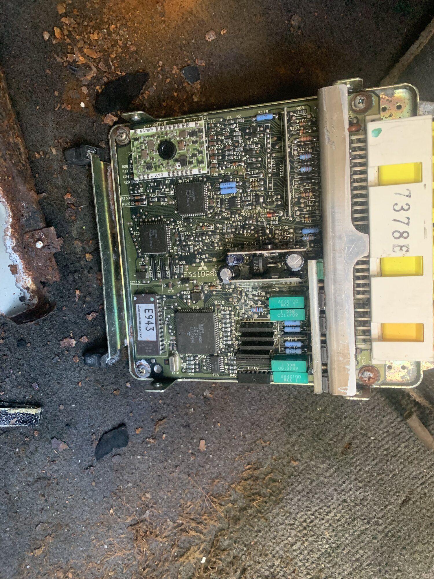

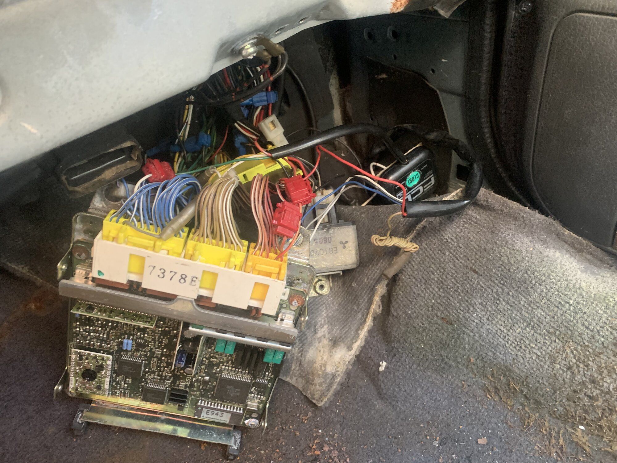

My ecu don’t look in the best shape
Theirs 2 EPROMs in car.
I got some figuring out to do.

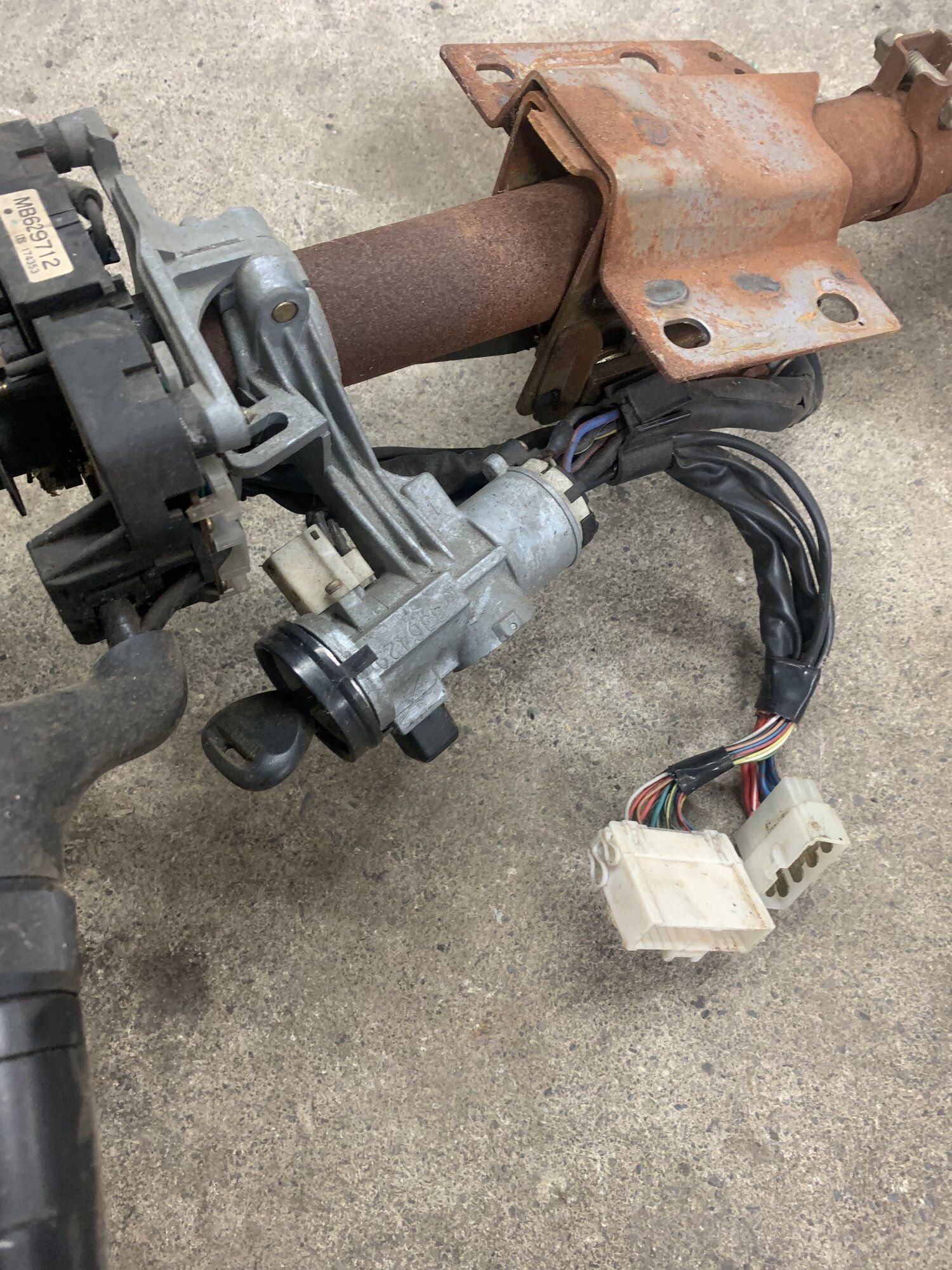

Last night I made trip to @DSSA compound.

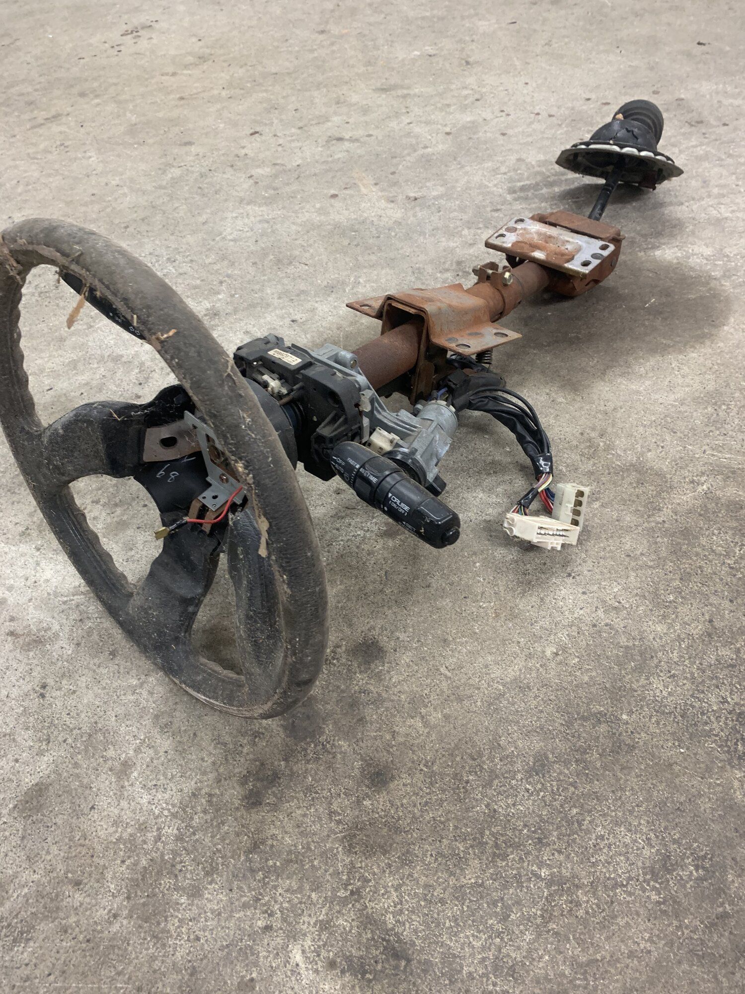

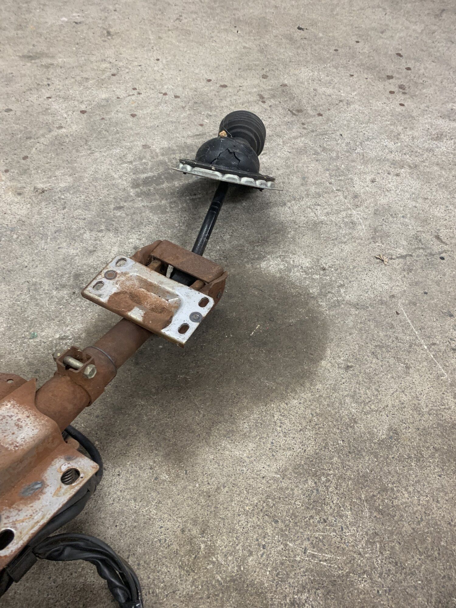

To pick me up complete steering column for the galant with key.
And got driver side lower dash panel for it also.
Man do’s Josh have some nice Mitsubishi laying around the shop.
Now on Sunday I’ll get this installed in the galant. And drive it 2 miles from my work to my house with dealer tag on it. So I can start working on it at night in my garage at home.

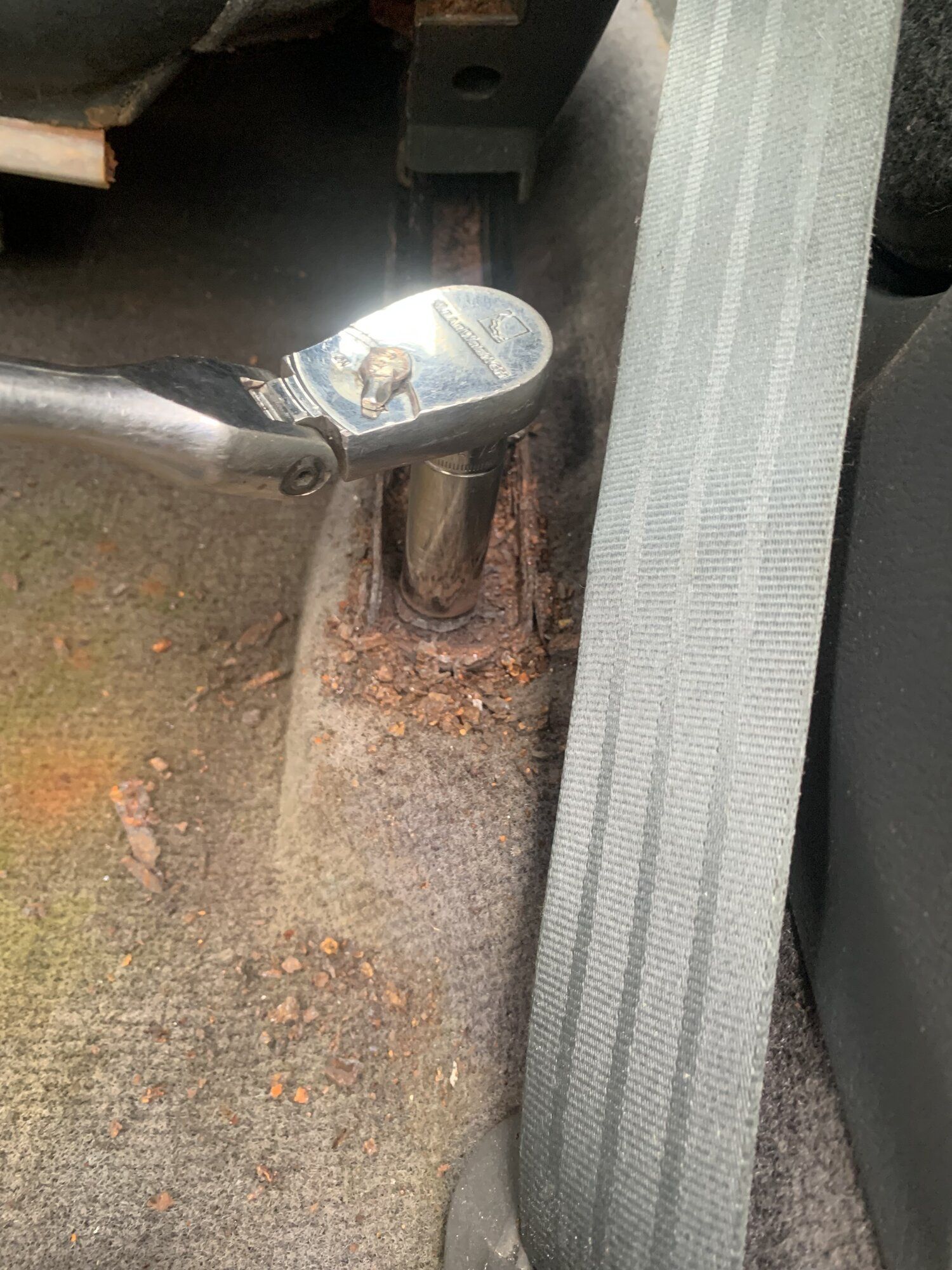

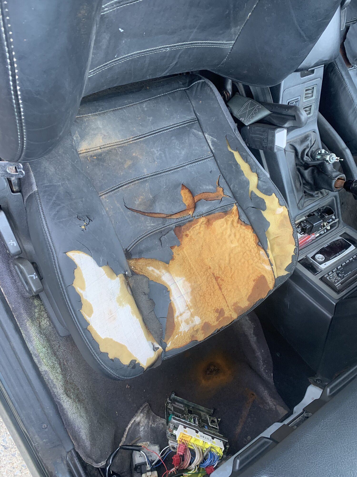

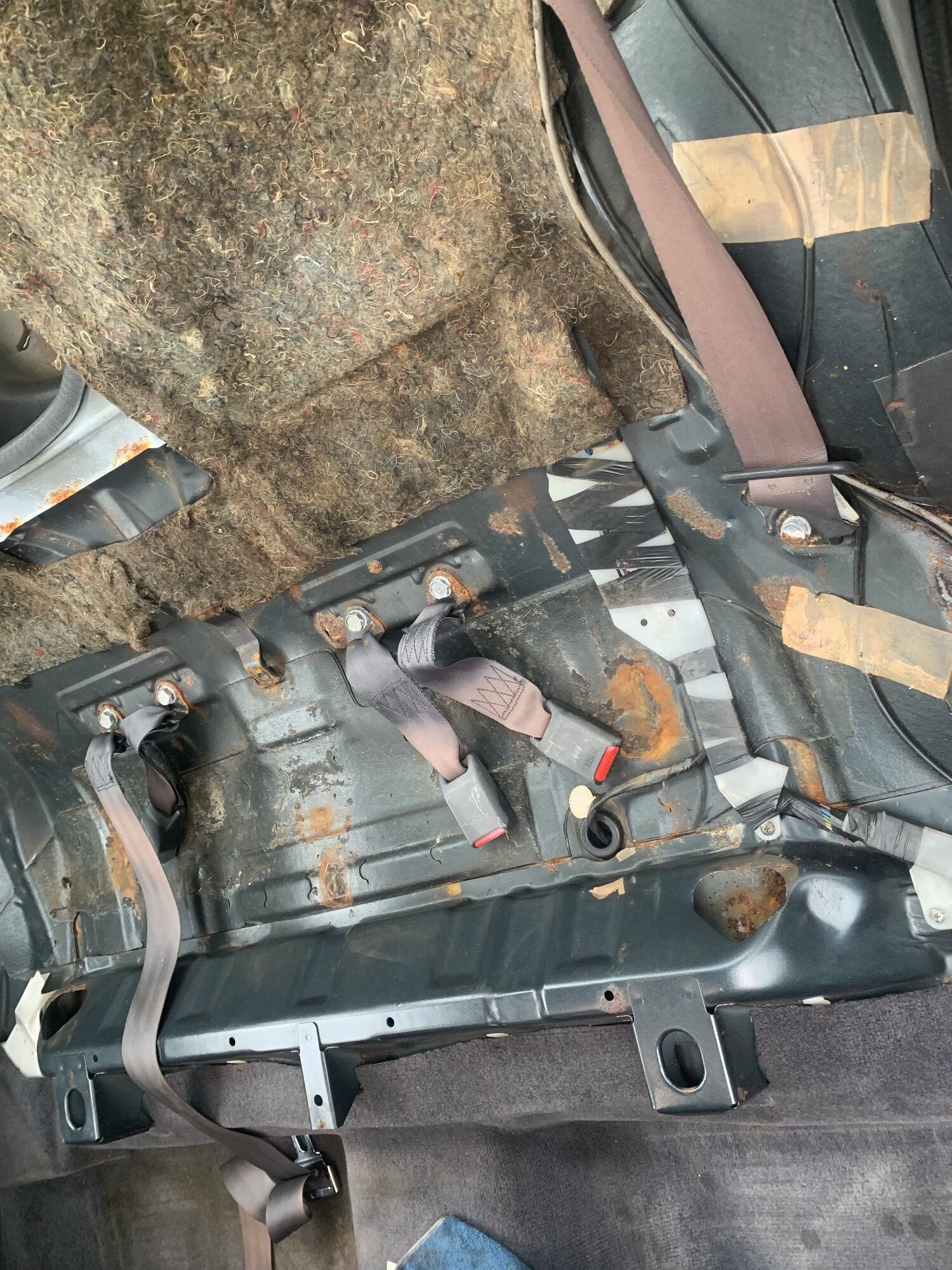

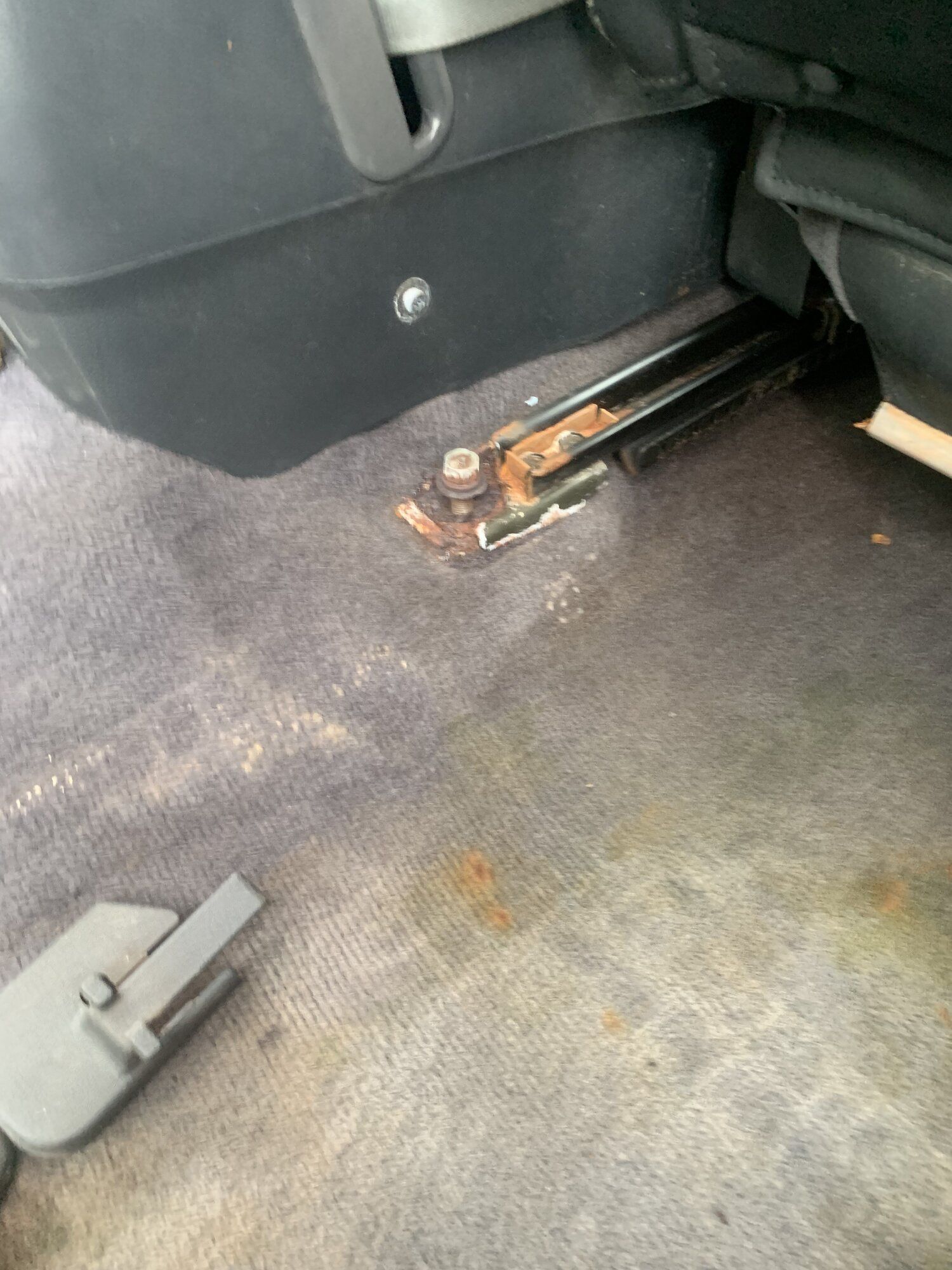

Started taking seats out of car.

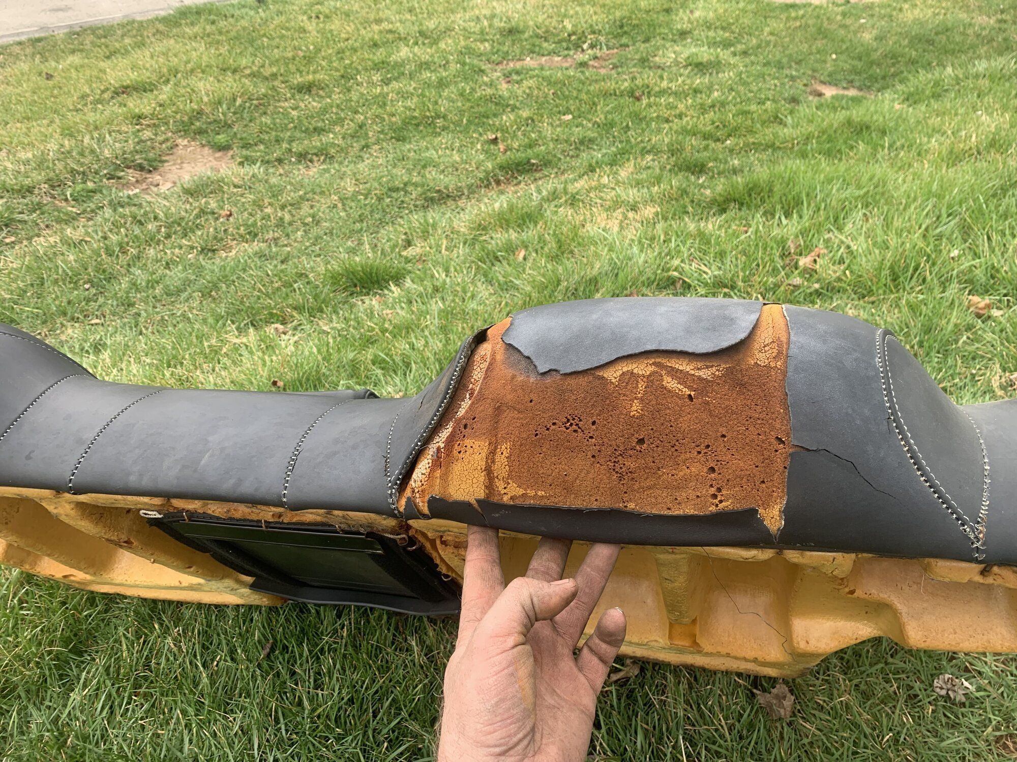

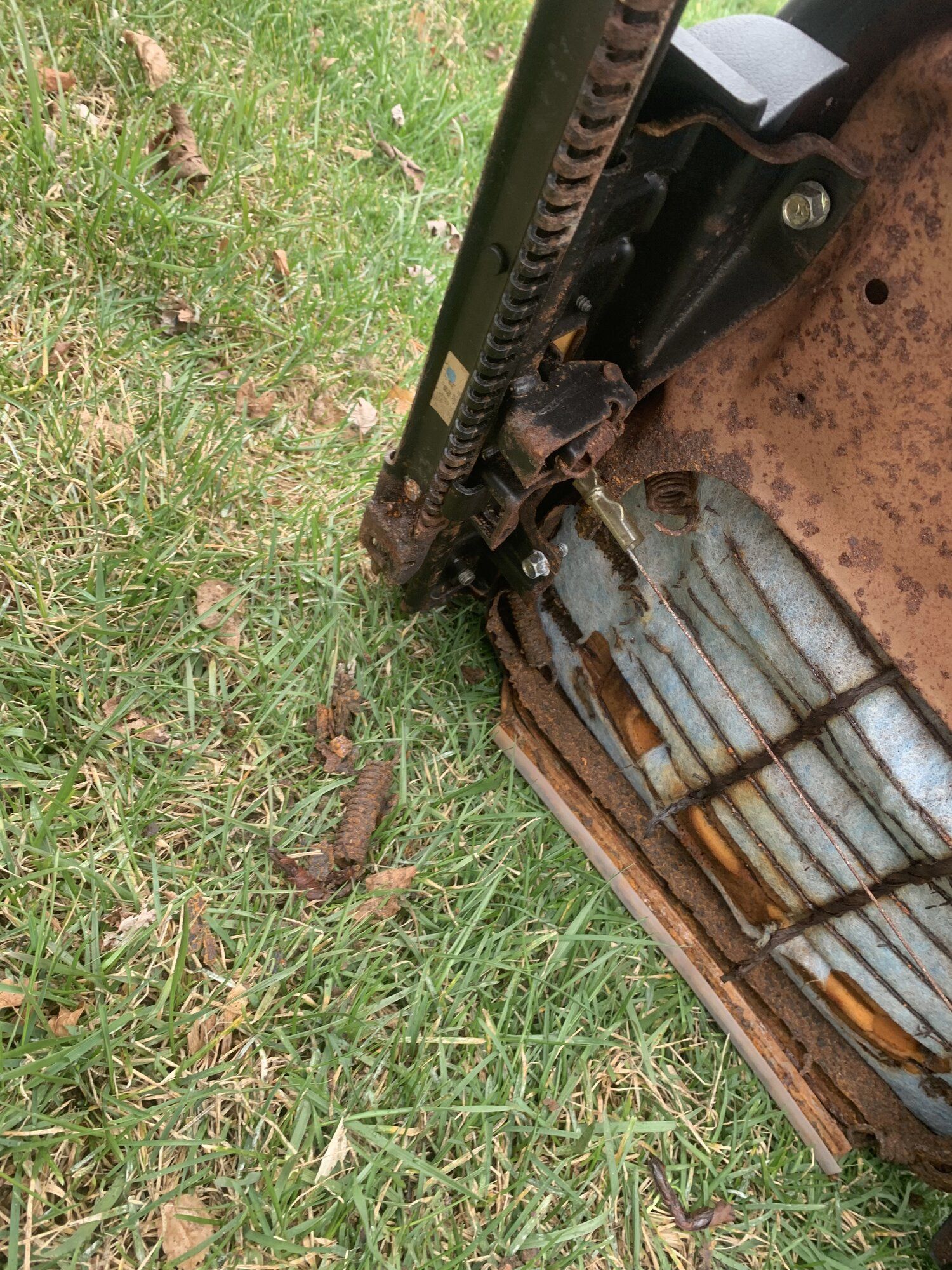

Passenger seat is rotted badly.

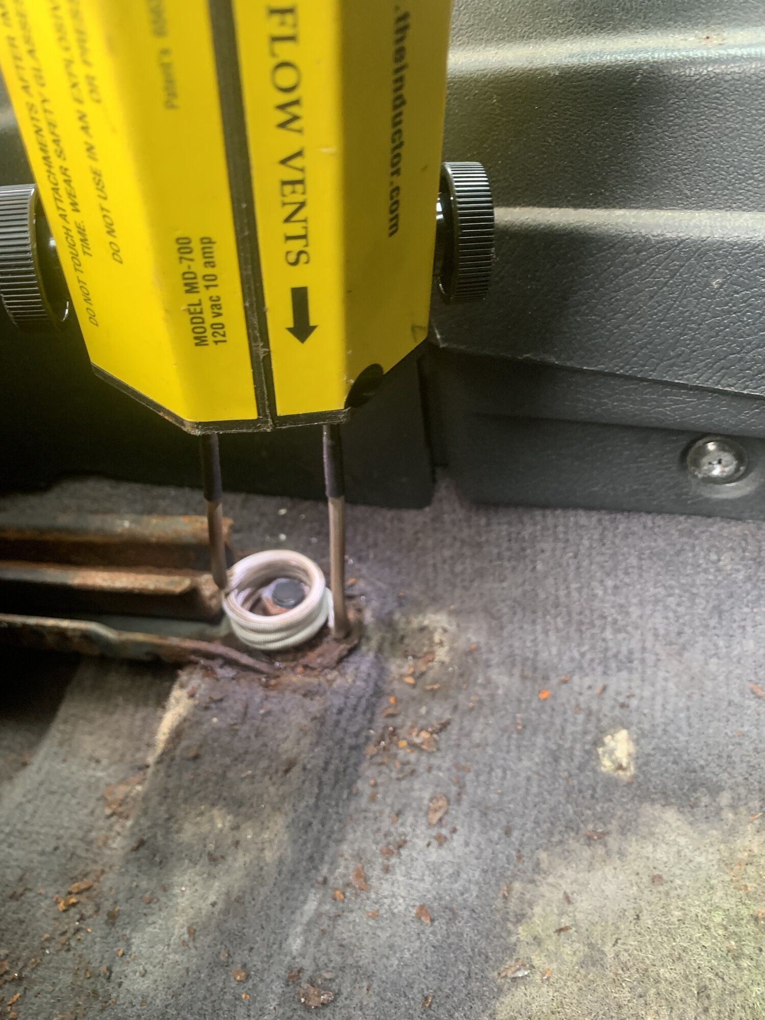

Had to heat all the bolts with my mini inductor. To get them to come free.
Rear back seat kept falling apart when I touched it.

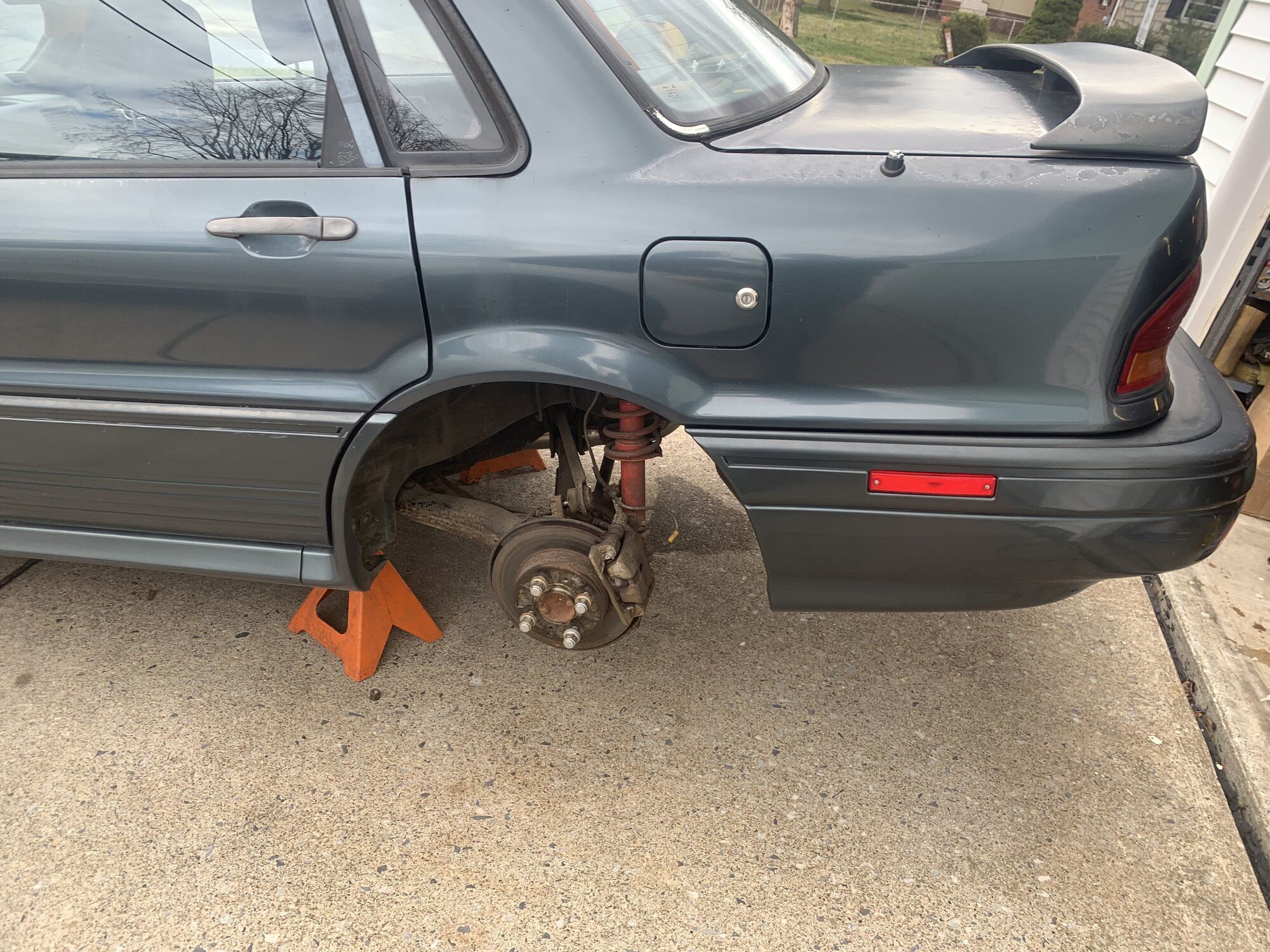

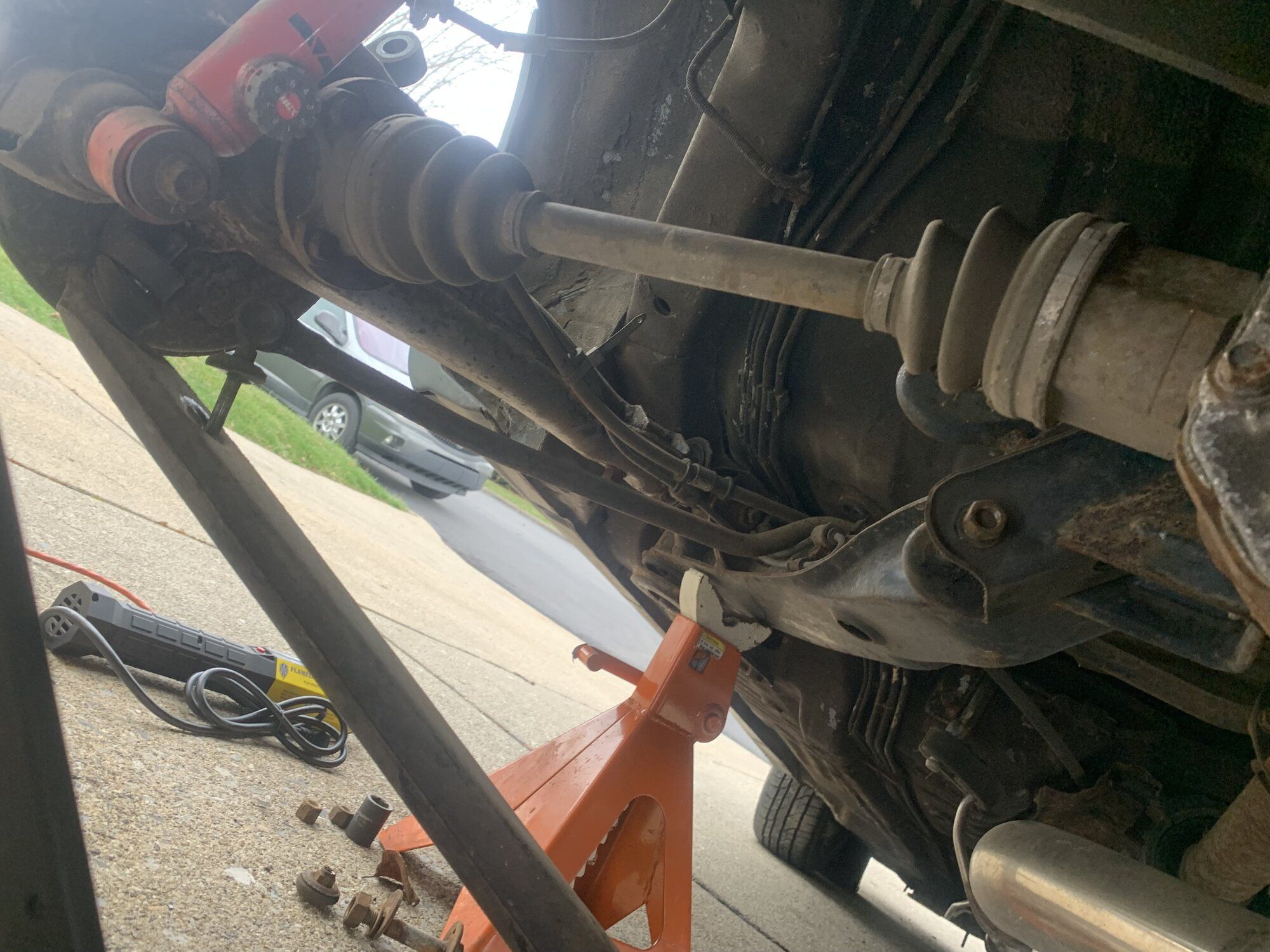

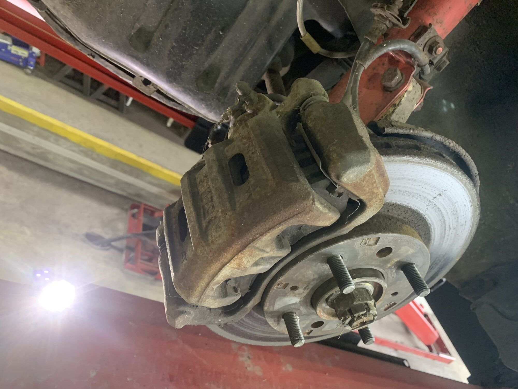

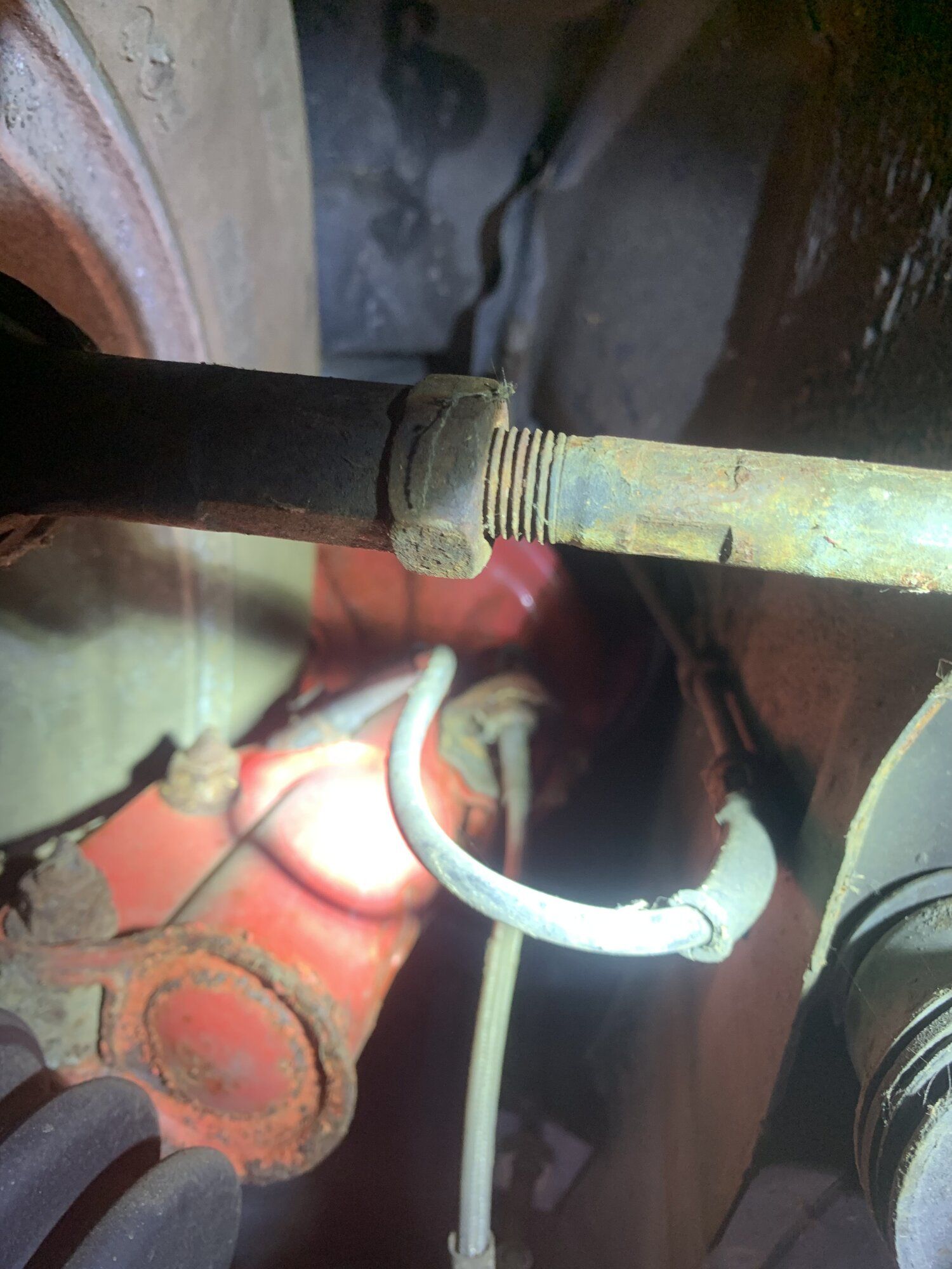

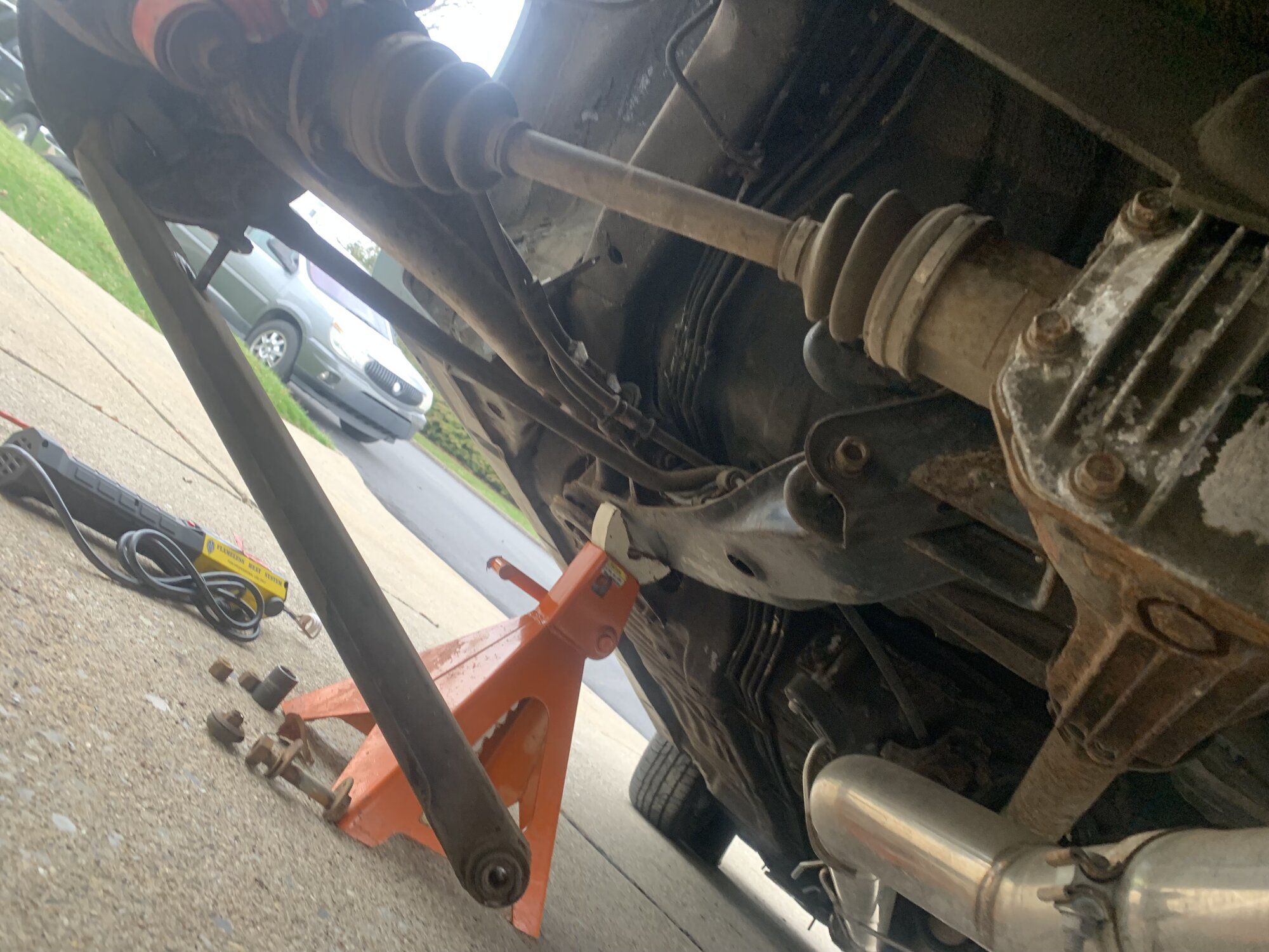

Also got rear arms torn out today to install
New bushings and to add something special to them that got sent to me for rear trailing arms.
Just got source some ball joints for them still.
Surprisingly ever bolt underneath came out easily.
I can't believe the seats are rotted like that. I don't think I've ever seen anything like in my life. I guess that what happens when a car is shut up outside for years at a time.
If you can find one, there are a bunch of guys who swap EVO interiors into the Galant. I've never done it, but it seems pretty straight forward. Eventually that what my son wants to do with his.
