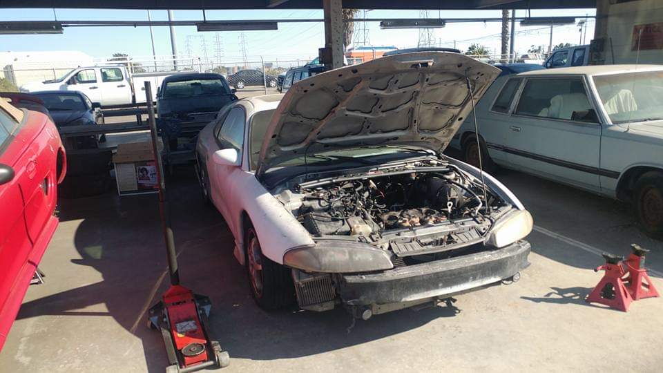

I was introduced to this car in Chula Vista, CA in early 2016. I was looking for a door handle for my truck in a local junkyard and ended up striking a deal for this car for 200 bucks. Towed it home and had the intention of getting it running and selling. Obviously that didnt happen.
When I started I had zero automotive experience. I knew how to change my oil or a tire but I didnt know how to bleed brakes or really anything more complex than that.

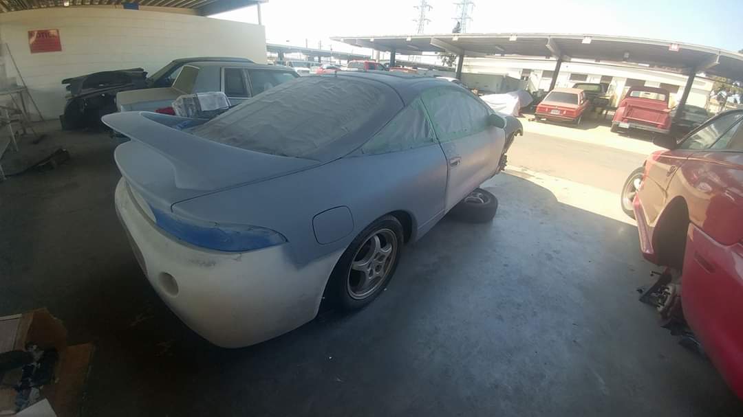

The car was in rough shape. It was at a pick a part yard and had very little left to it. Zero interior besides a dash and front seats, half an engine, and rat droppings EVERYWHERE.

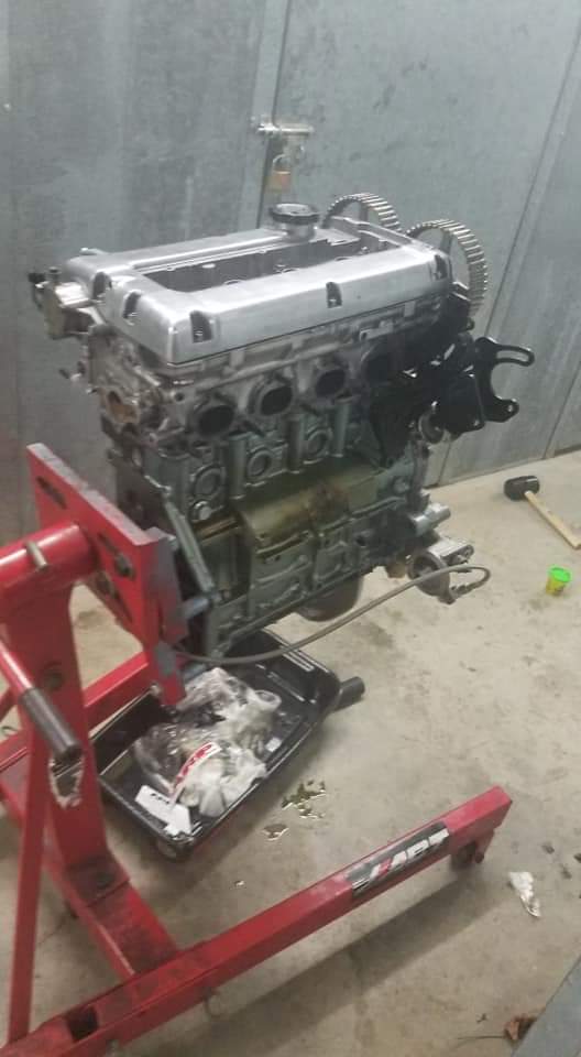

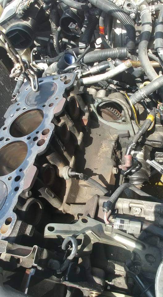

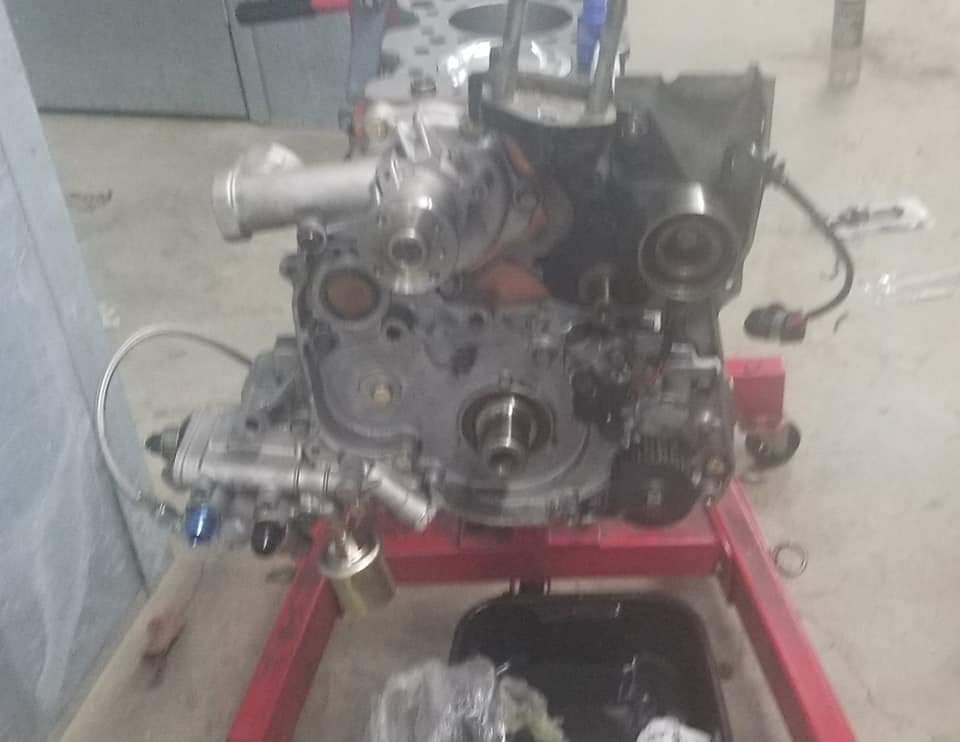

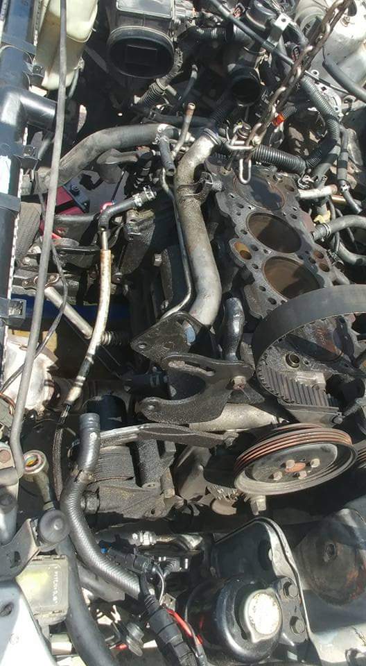

This is the point in which I started looking into pulling the motor. Some part if me thought it was smart to yank the motor from the top and leave the transmission in. This ended up breaking alot of stuff but that was mostly because I didnt really know what I was doing. I borrowed John's engine stand and I remember struggling to get it on the stand and I remember putting a tire and stacking foam under it just in case the bolts gave way and the motor fell. Realistly this wouldnt happen but I didnt know any better.
John came to help right around this time and we disassembled the motor. This ended up being a big mistake as I had to figure out on my own later where everything went. It was a breeze and there was nothing crazy that I could see but I remember john telling me that he thought that it was a blown headgasket that sent the car to the junk yard.

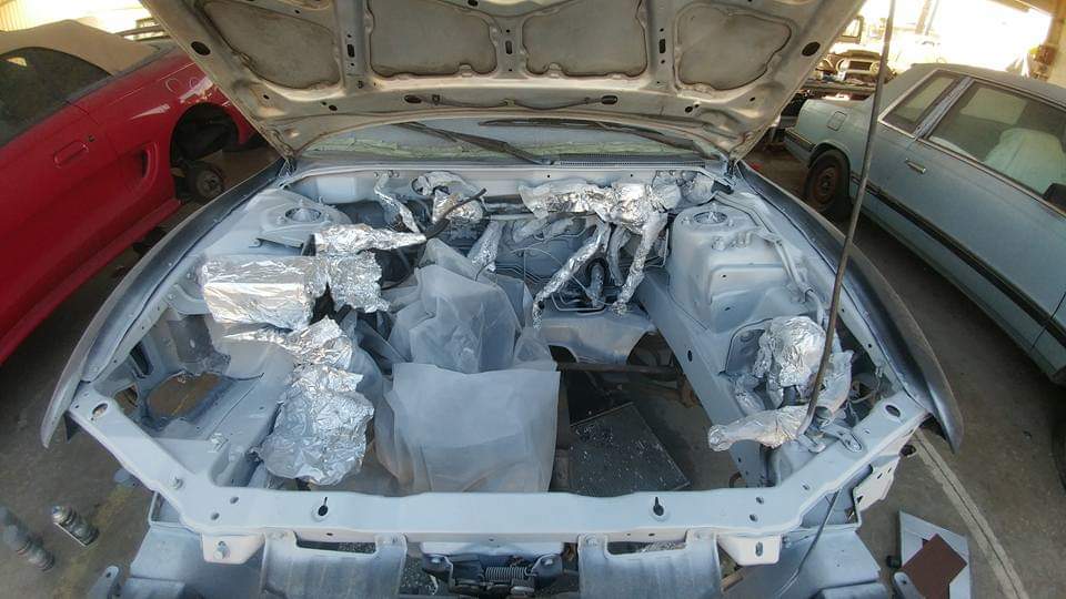

At this point I had read a million posts about maintenance parts and I started to replace most of the suspension components. I also started working on the exterior. This is where I made the biggest mistake that I could have made at this point.

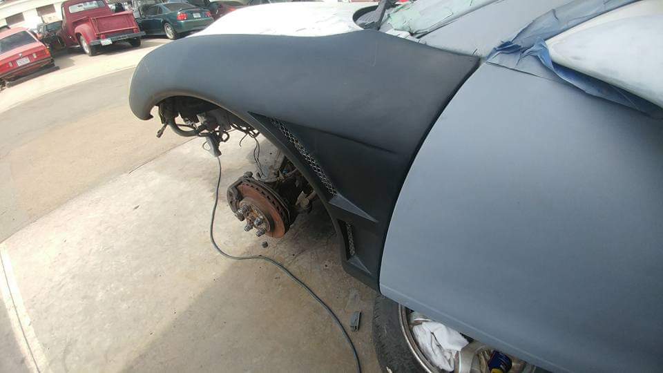

I started to sand all the platidip off the car. But I didnt hand sand. It was too slow and I was an idiot. I broke out a palm sander and to this day the paint is still wavy due to this. Not only that but I was using rustoleum to paint it and I was outside. Quality paint is on the current to do list.
Paint happened over the course of months. It took alot if time but it still was done prior to rebuilding the motor. Alot was going on at work at this time so I would just sand down the car and paint over and over a section at a time over the course of a few months.

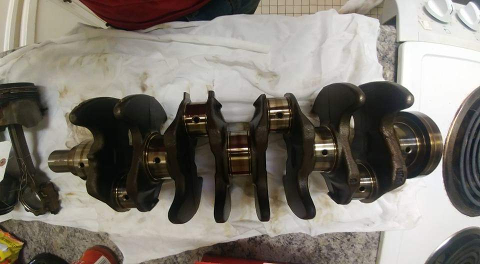

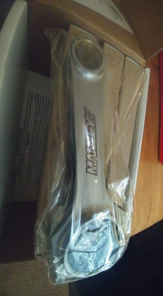

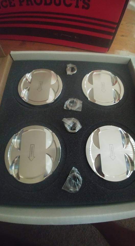

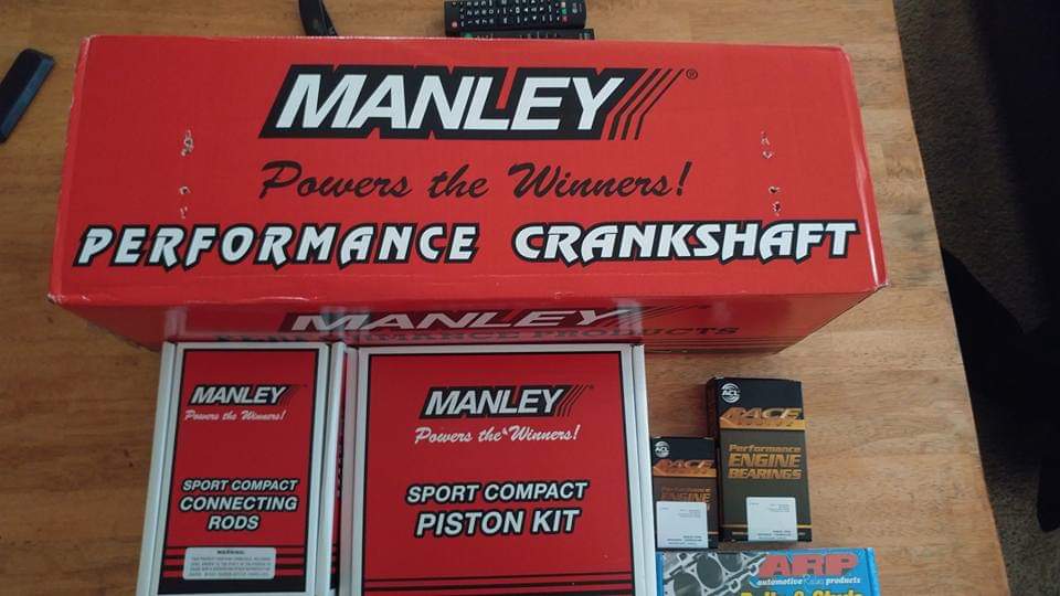

One thing I didnt go cheap was though was engine parts. I was convinced, and am still convinced, that crank walk was BS so I chose to keep the 7 bolt.
I chose a local machine shop and took the factory crank in to get magnifuxed and it failed so I bought a manley 7 bolt crank, manley hbeam rods, and Manley forged 9:1 pistons. With the help of endless hours of jaffro youtube videos and a factory service manual, I rebuilt the bottom end. It took and entire day. My perfectionist came out and for good reason. The rotation assembly and all the machine work was the most expensive thing I had ever bought in my life.

Paint got wrapped up. Looked bad up close but I was satisfied for now. I call it my 20 foot paintjob. Looks darn good from 20 foot away.

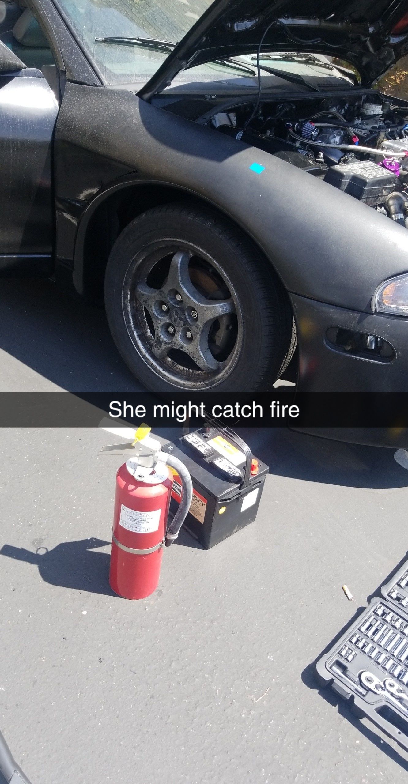

Believe it or not, at this point in time I was thousands of dollar in and I hadn't even connected the car to a battery yet. Relocated the battery to the back around this time and connected it to power.
Honestly this was the most exciting part of the entire build. This point to me was more exciting that first start. I hadn't touched most of the electronics and I didnt know what would happen since the csr had sat for so long. I had several friends with garden hoses and a fire extinguisher there just in case.

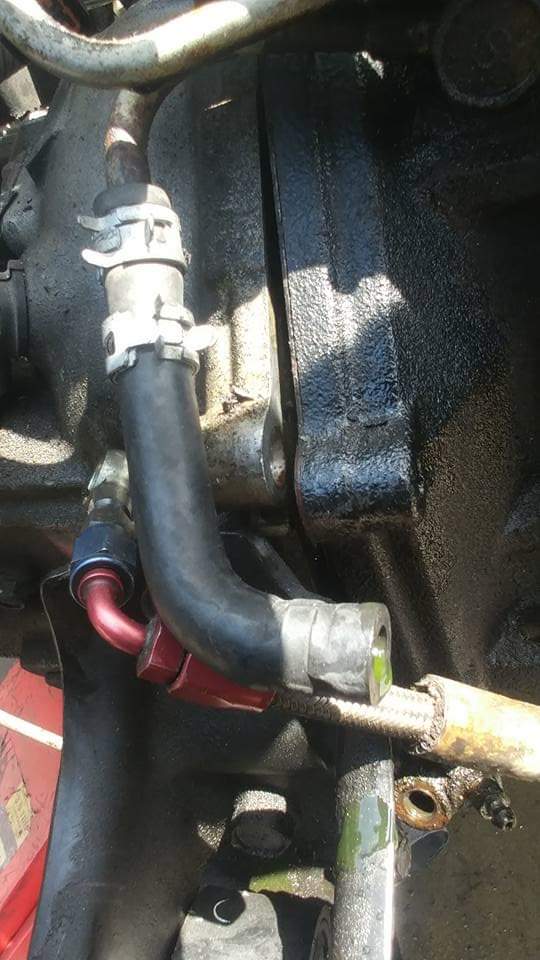

I had removed the balance shafts during the build and my oil pressure was very high. I didnt really do anything about it. I had done the head port mod and kinda just let it be. But I didn't restrict my oil feed and I blew the seals out on the hx35. Turbo went out for a rebuild and I did research and restricted it as I saw fit. Problem solved. But that wasnt just it.
I kept burning oil. I didn't know why. And fast too but only during pulls. I couldnt figure it out. In reality i knew what had happened but i didnt want to accept it. Also around this time i had smoked out a used southbend clutch i had picked up last minute and upgraded to a competition clutch 6 puck sprung. Keep in mind, the clutch had always felt weird but I thought it was normal. I had never driven one of these that were in perfect condition so I had nothing to compare it to. But we will get to that later.
Cutch got replaced and I was convinced the head gasket had blown. It was MLS but anything can happen. The self tuning.i had done probably caused it from predetonation or something. I dont know.

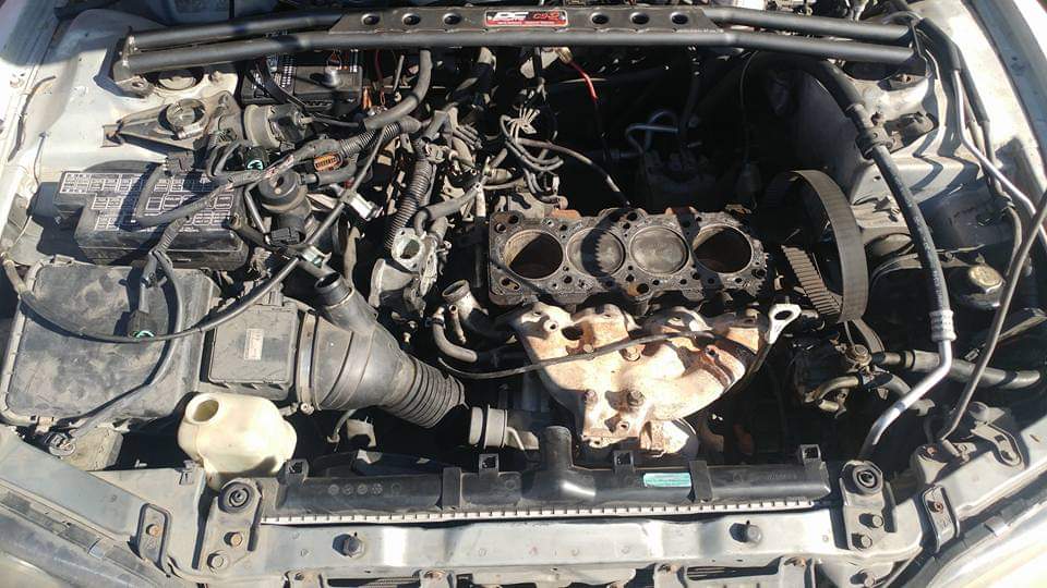

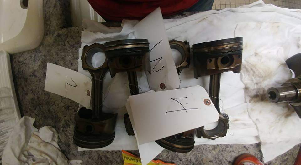

I pulled off the head. The first thing I noticed is I could physically see a gap between every piston and the wall when it was at the bottom of the cylinder. This is when the rookie mistakes from literally years before came up to haunt me. I hadn't bored out the cylinders like I should have and they were egg shaped at the bottom. I hadn't measured piston to wall clearance ether. This was a very bad day. Money wasted on stupid mistakes that shouldn't have happened.

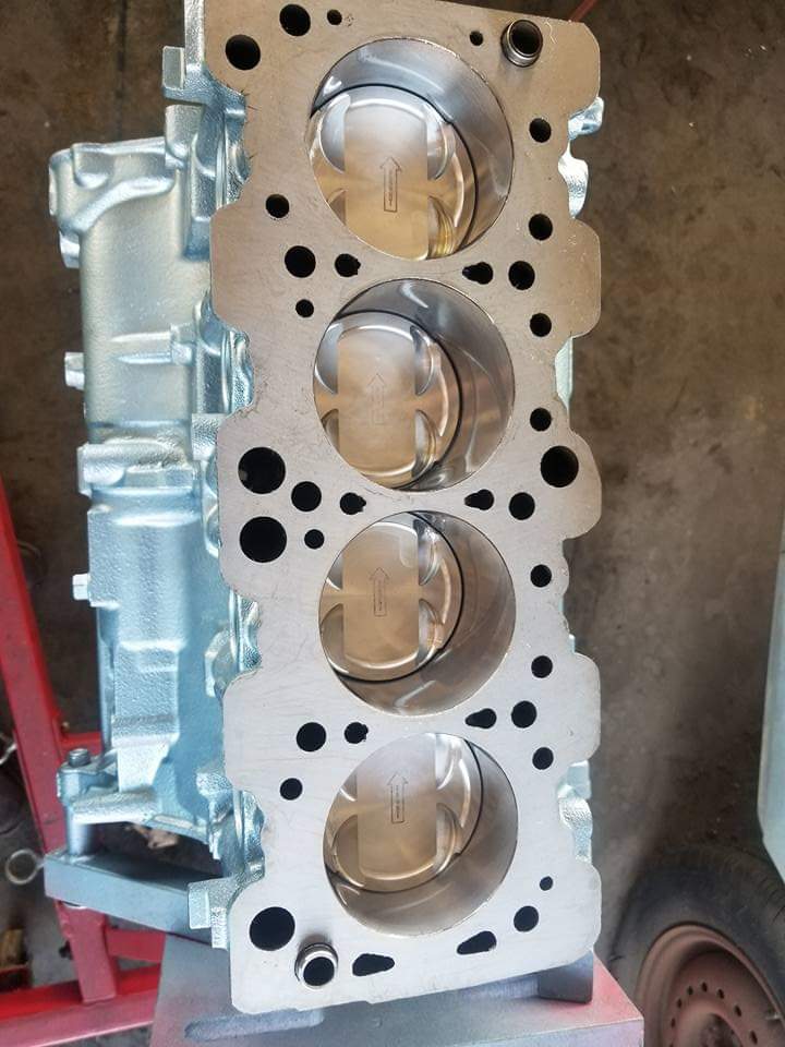

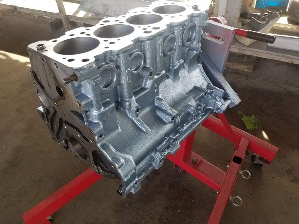

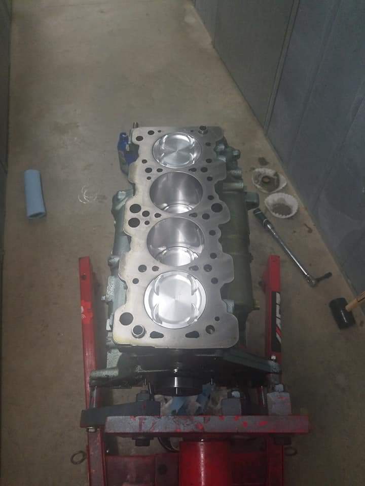

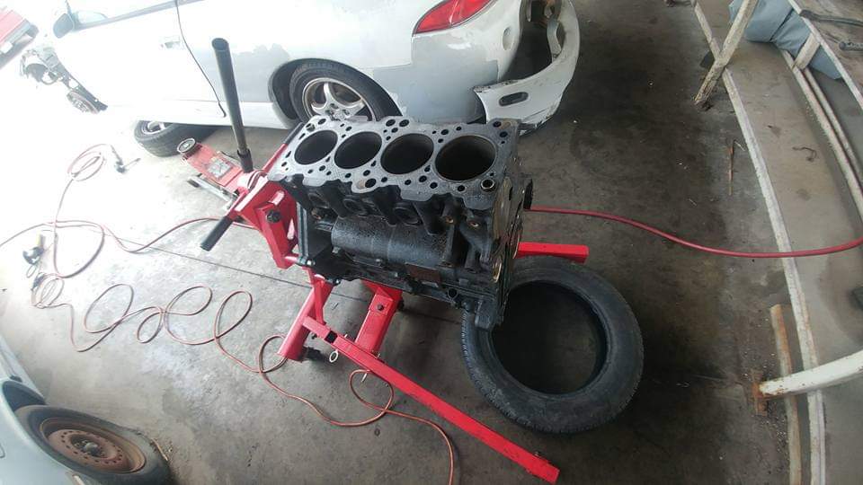

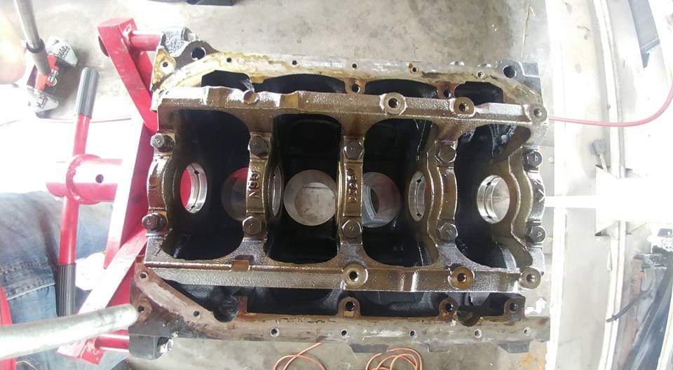

December 2018 and january of 2019 I spent rebuilding the motor for a second time. All my machine work was done at a local place called Larry's Auto Machine in Groton, CT. Unlike the place in San Diego that I went for the first build, these guys knew exactly what I was doing and exactly what motor this was.
This place opened my eyes to automotive machining. The San Diego place was oldschool. Very large machines and in comparison, not very precise. I didn't know any better than to question their ways and if I did, I wouldnt have gone there.

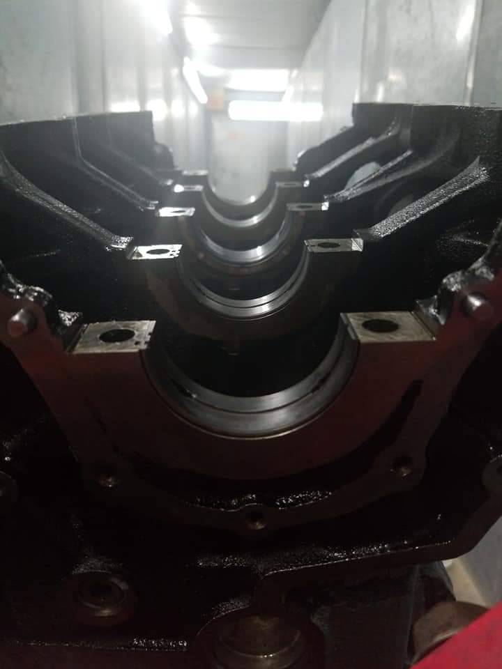

But Larry's was something else. They blew me away. I didn't have to explain anything at all. They were asking me questions that I didnt know. Things i didnt expect to be asked. Everythong they had was CNC. I was so ecstatic by this place that I went back multiple times just to watch everything be done. I infact, called off of work to watch my block and head get machined. They assembled the head for me and I choose to assemble the block and the rest of the motor.

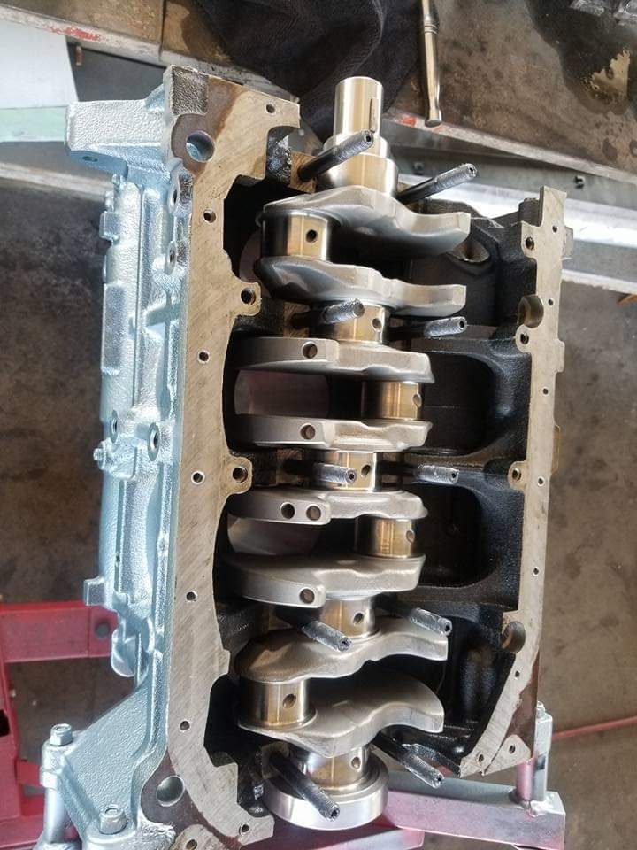

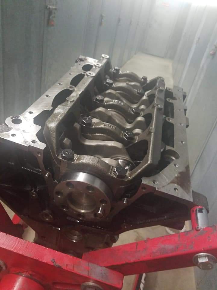

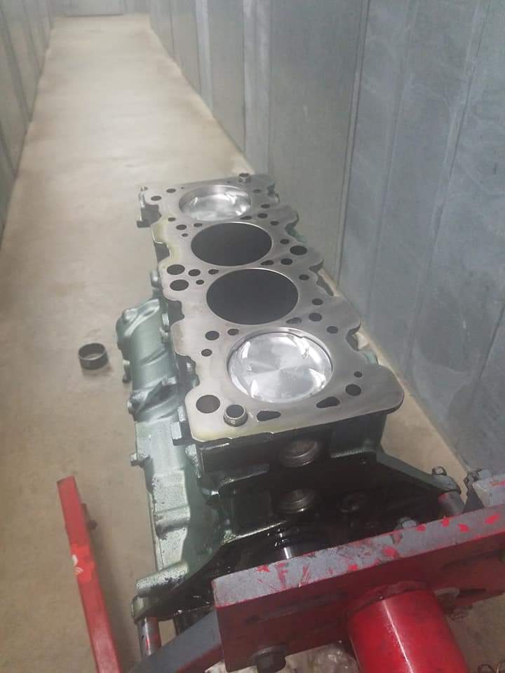

I had the block decked, a line bore done on the main caps, and the cylinders bored .20 over.
I spent the next day gapping rings. Another thing that I didnt really pay attention to on the first build but at this point I fully understood the importance of it and spent an entire day making sure it was perfect.
The next few days after that was checking and double checking measurements. I did all over this at this point in 2nd floor apartment kitchen.
After I was confident with my measurements I took my block to a local storage unit and rented a unit to assemble to motor in. I was alot more clean this time around and even more meticulous than before. I also had been investing in several tools to help me that I didnt buy before hand. Example being a tapered ring compressor. I will never use the crank band one again. I brought the engine to short block on Christmas morning while I drank egg nog and there was 2 foot of snow on the ground.

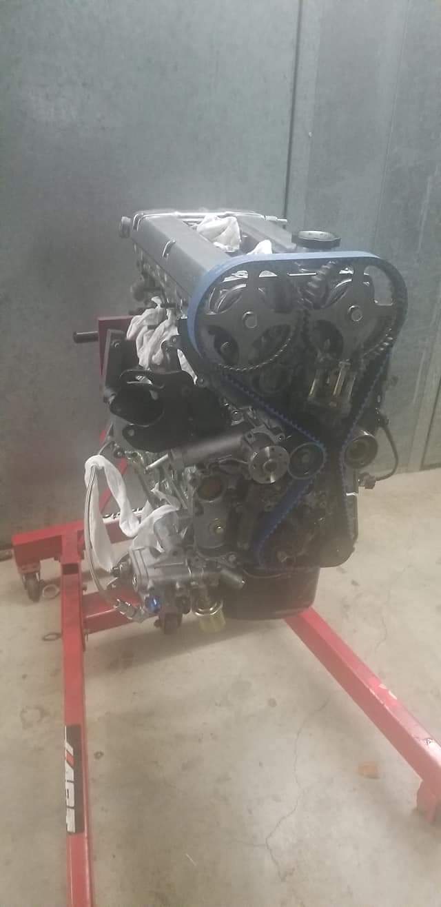

I spent new years eve verifying valve clearance. I had finished assembly just in time to watch the fireworks at midnight.
The vast majority of the motor was the same parts I had from the first build. The only big thing that changed was the timing belt and components, and I used manley sport compact forged 8.5:1 .20 overbore pistons
