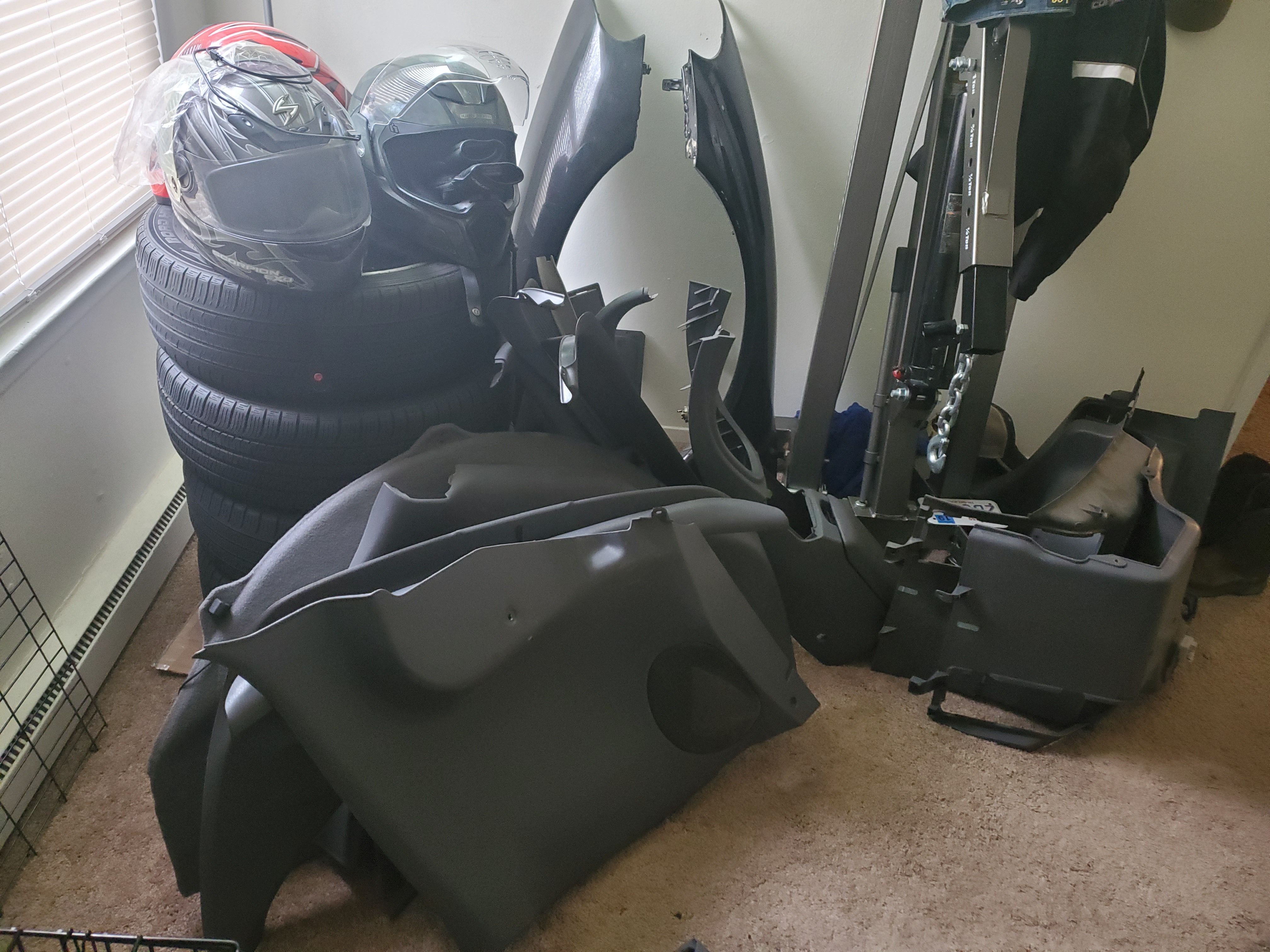

I got the interior. 250 for everything beside the dash and front seats. Even has OEM floor mats. It is in PERFECT condition. If the guy said he had never sat in the car before, I would have believed him. Ordered sound deadening today, sounding rubber, and some foam to make the interior a bit more pleasant. Finally getting warmer. Snow has melted. Season is beginning.

That's awesome, can't wait to see some pics when you get it all installed.

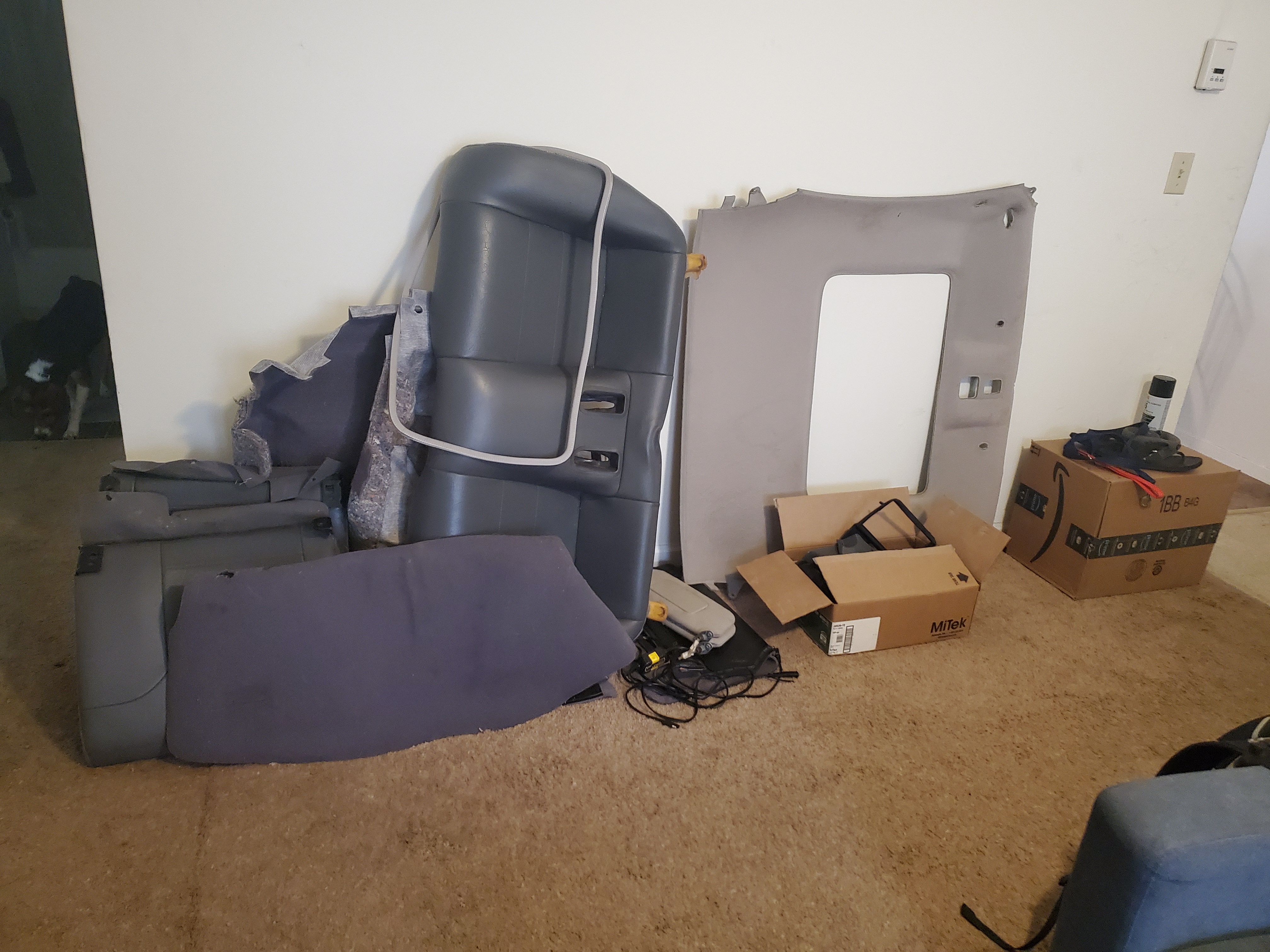

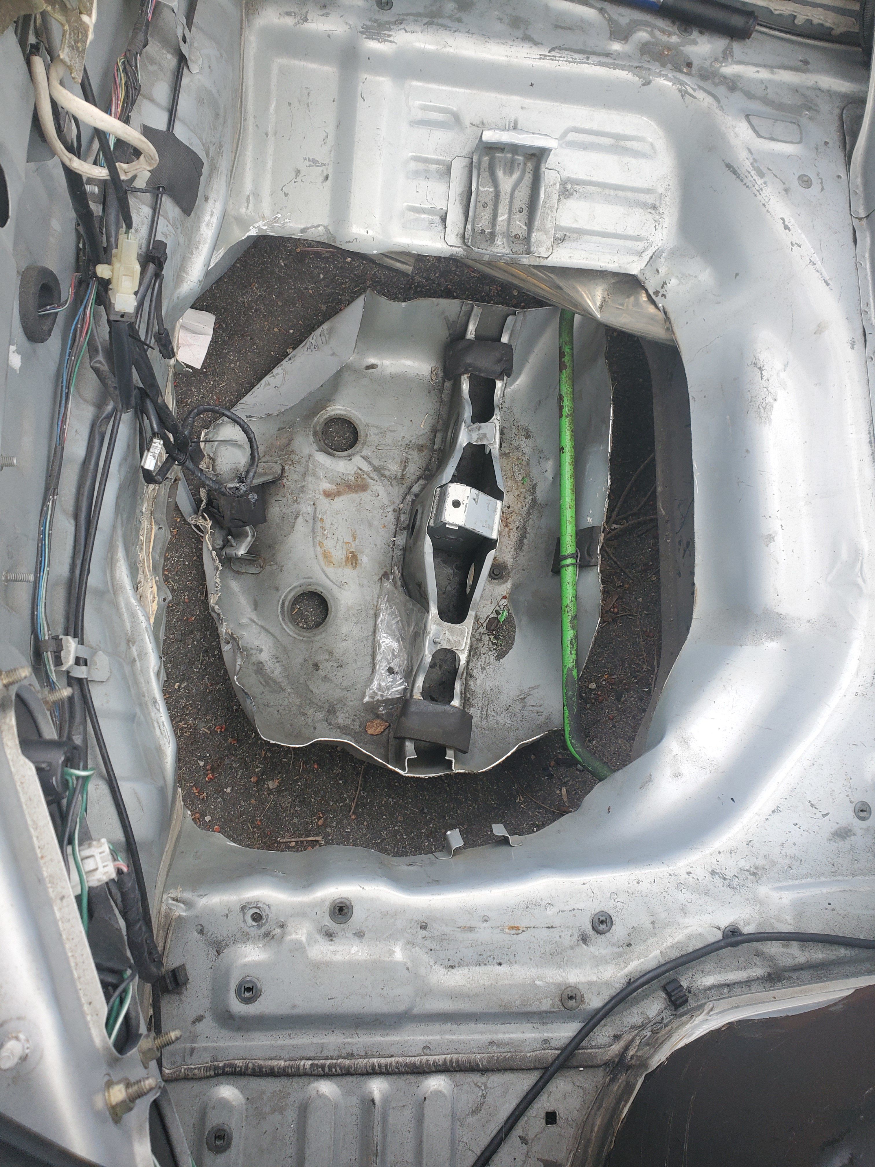

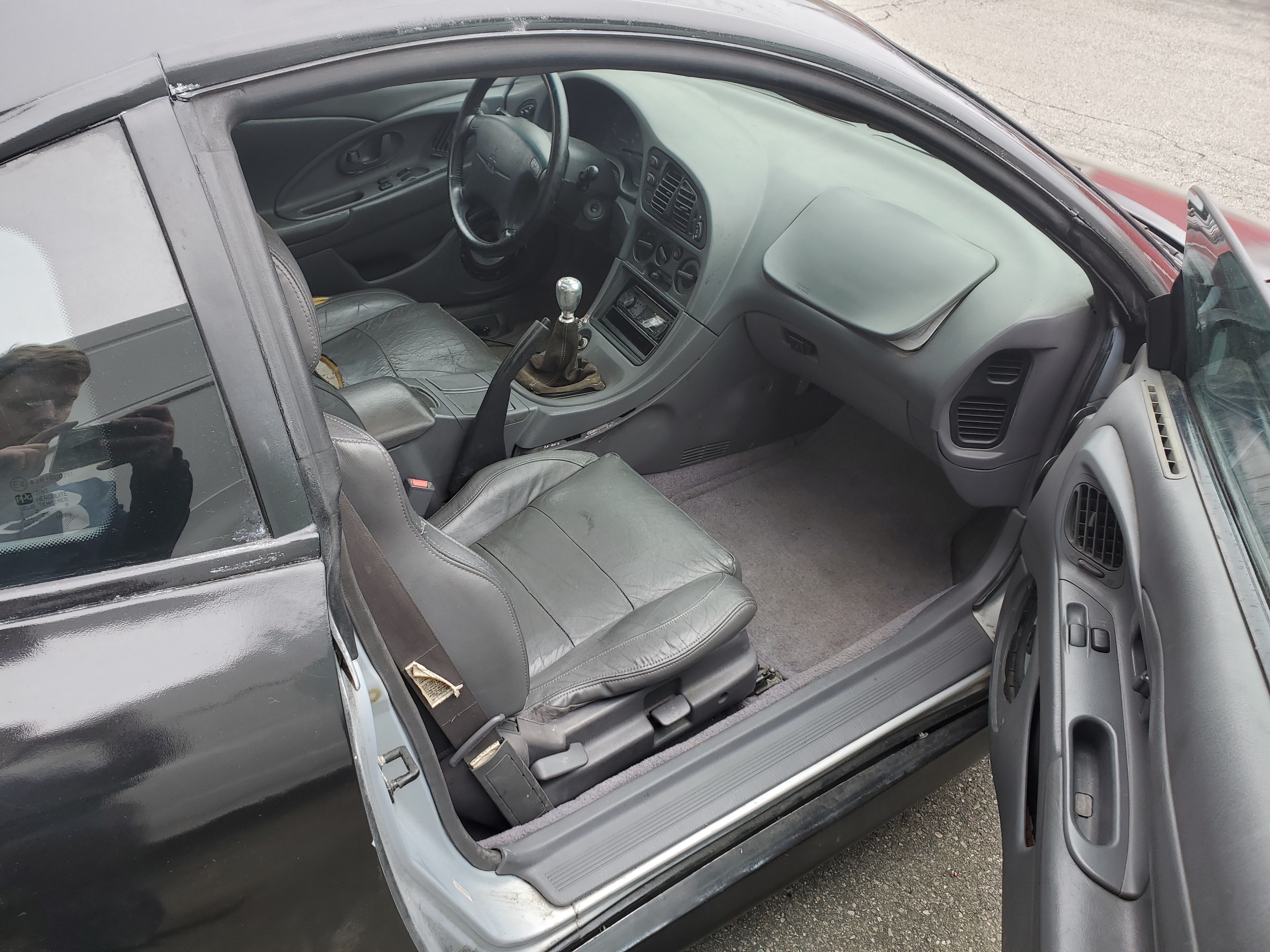

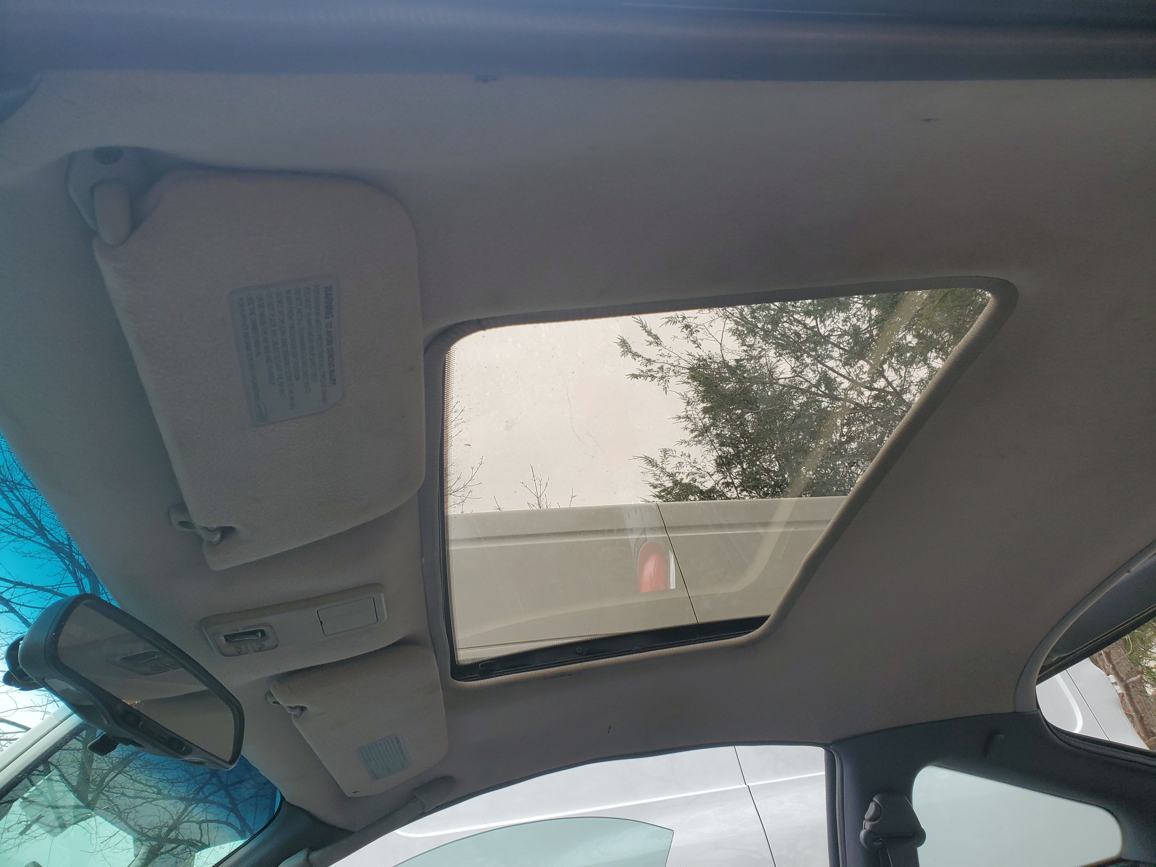

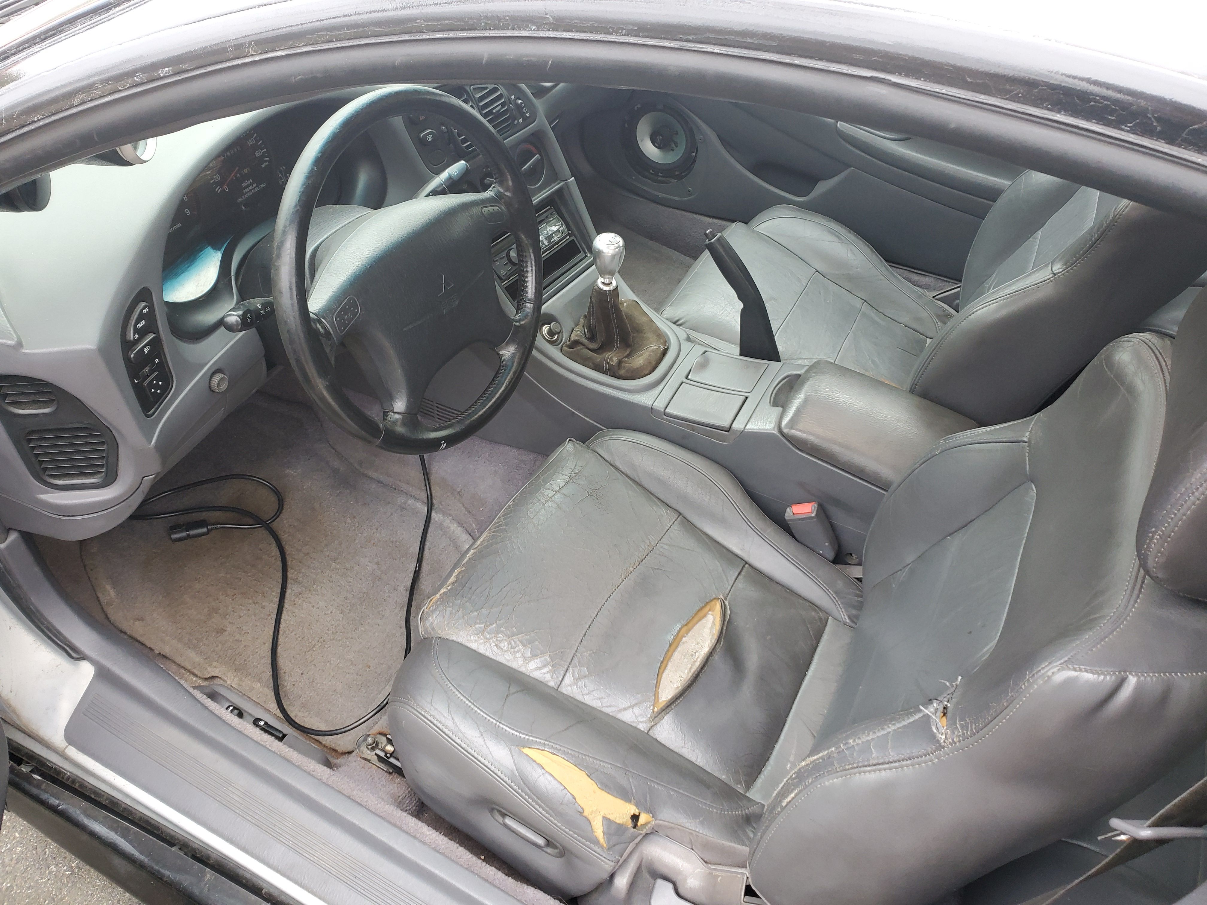

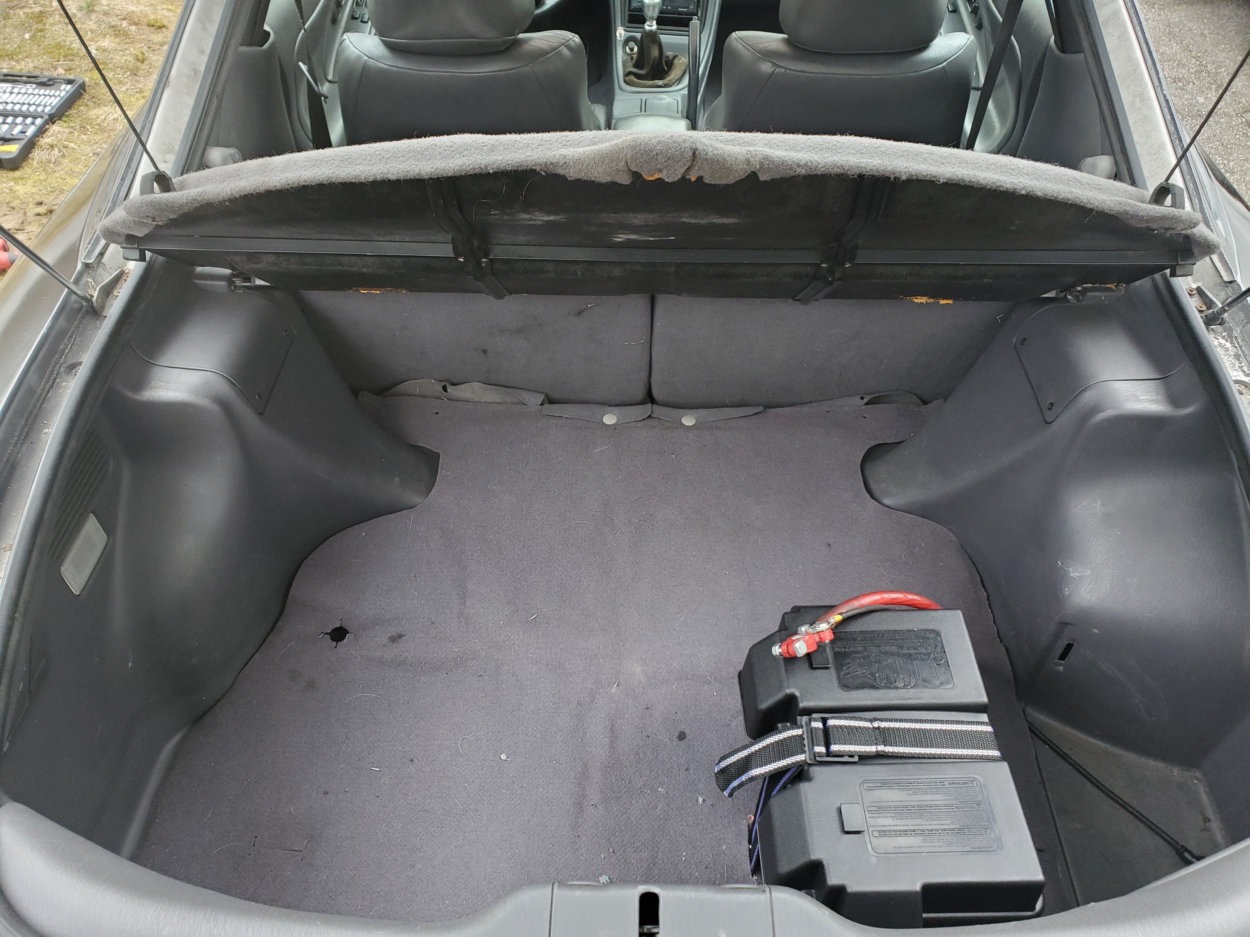

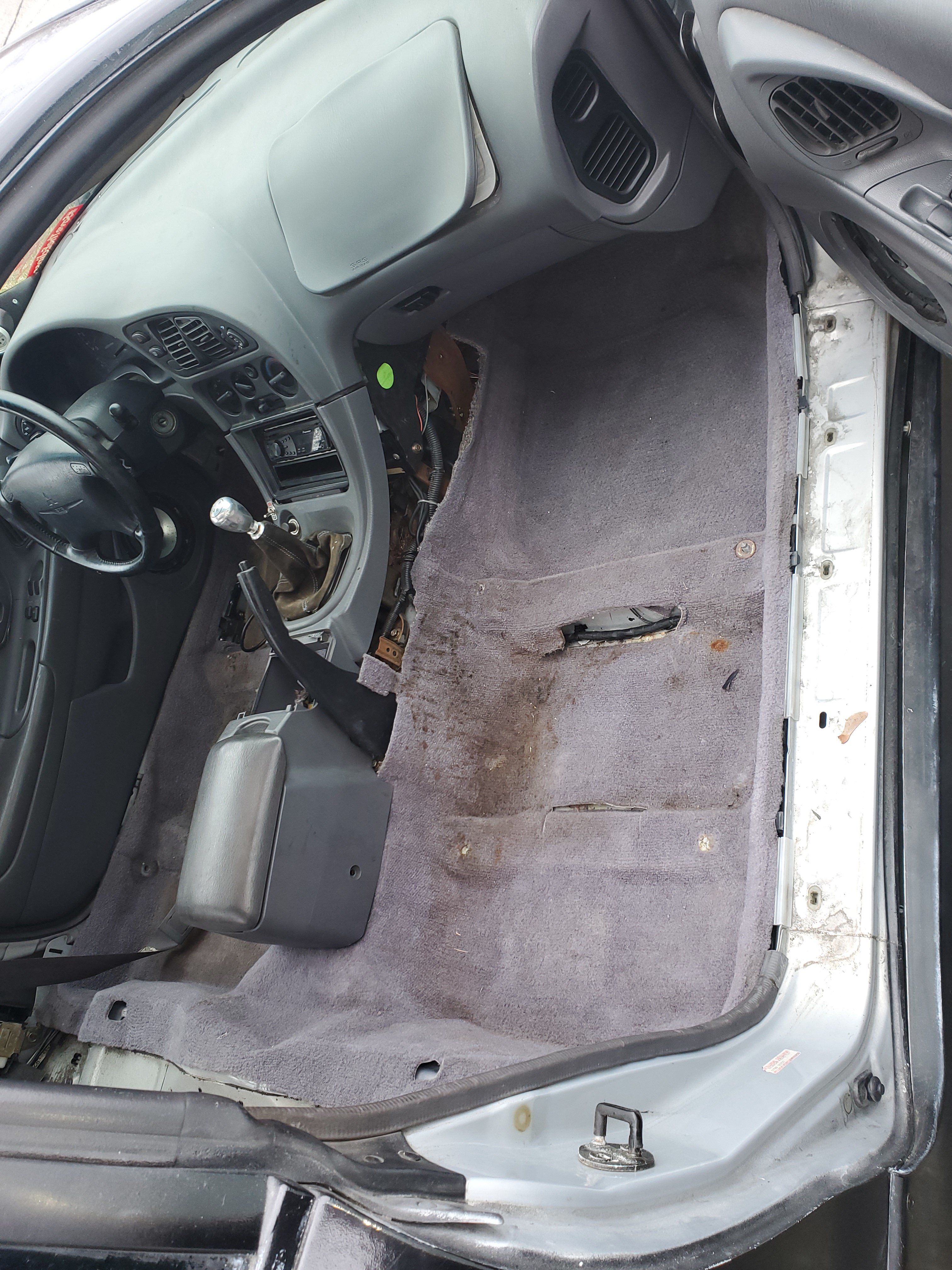

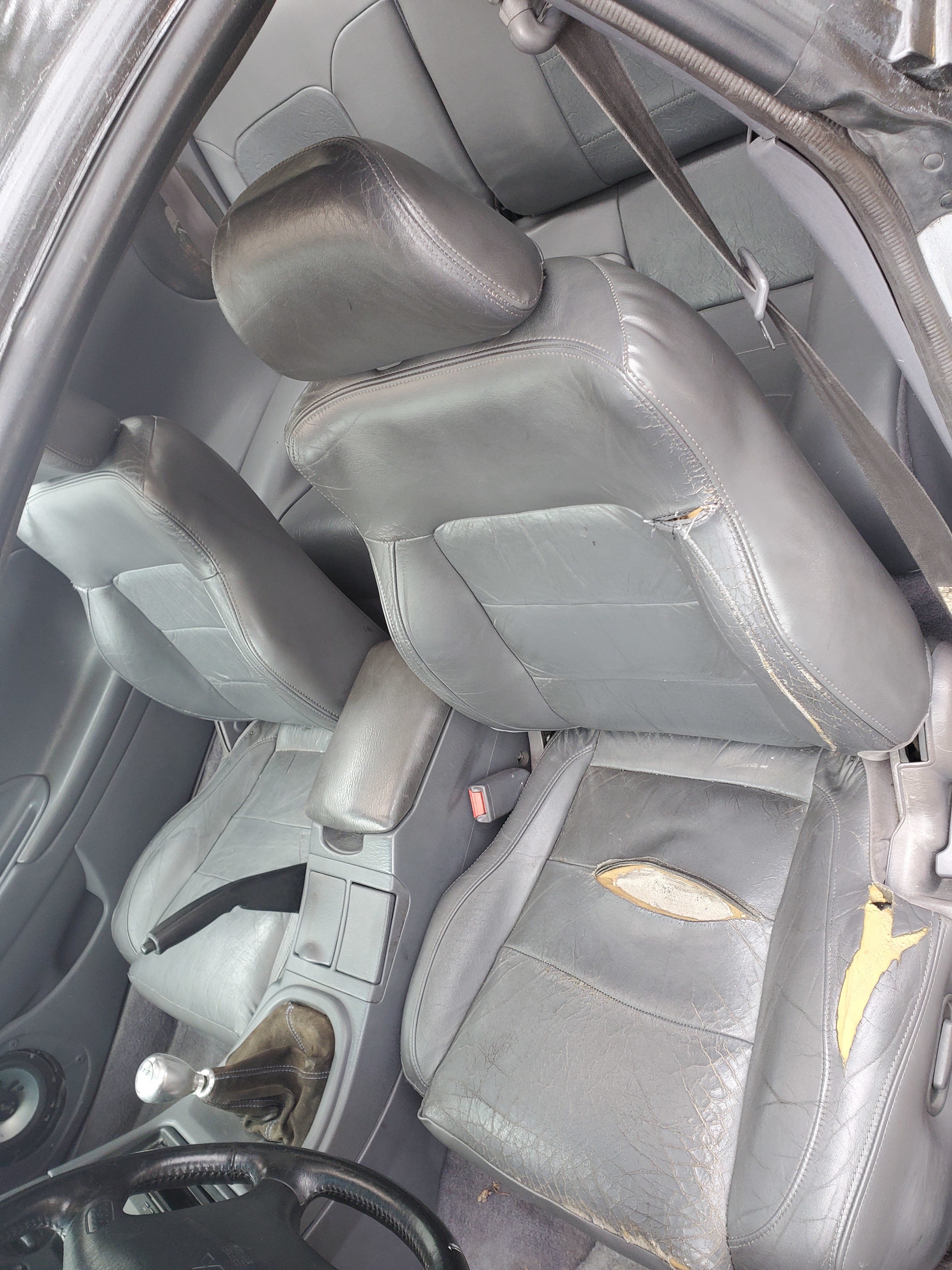

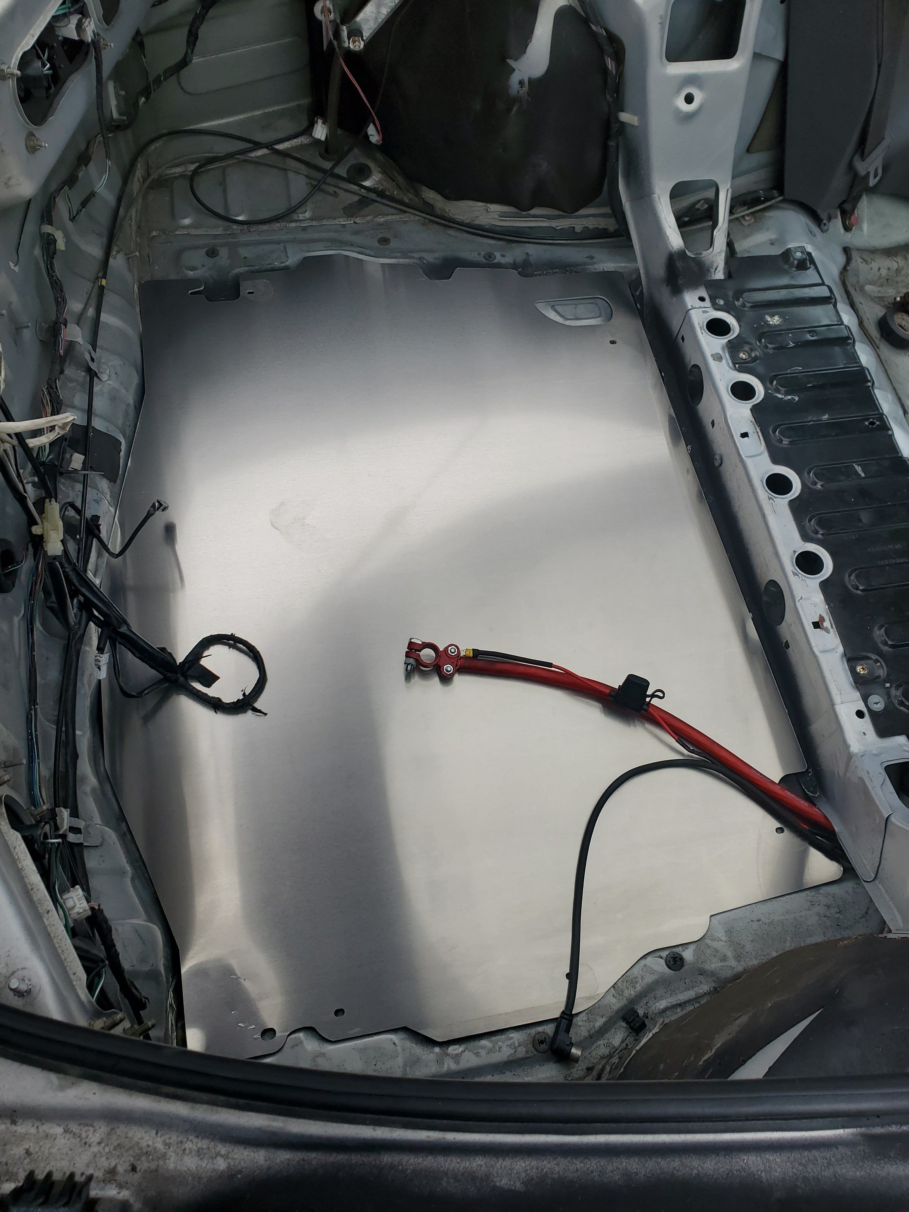

FINALLY a nice day. Interior is in. Spare tire delete panel is in. Shout out to Archer Fab and a local for the panel and the interior. Panel was a bit of a pain to get in. Very tight. but built with percision in mind and you can totally tell. Craftmanship is outstanding.
Interior was a breese. First time I have ever seen a headliner in my car. Same with rear seats and the truck lid thing. Still need to find a good grey airbag and clips for the rear seat. Today was a very productive day. Many many more parts waiting to be put on. Stay tuned.
