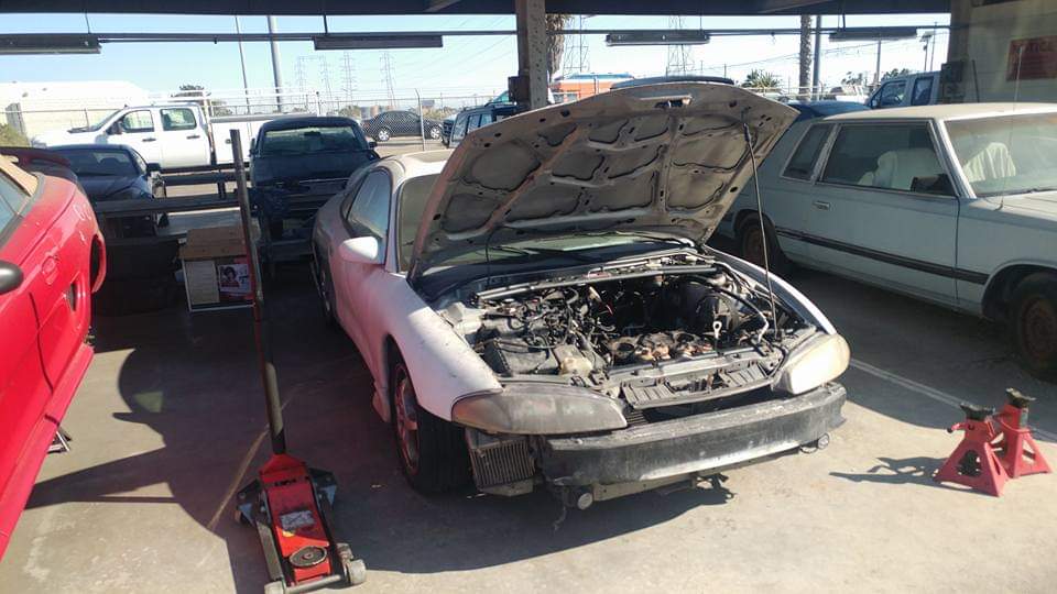

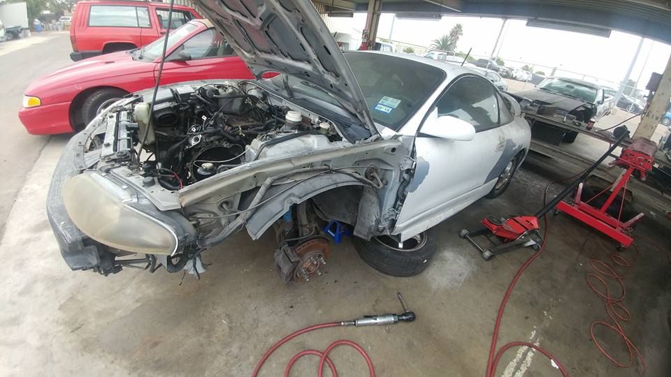

Junk yard find. What started as something to tinker on, has encompassed every second of free time i have.

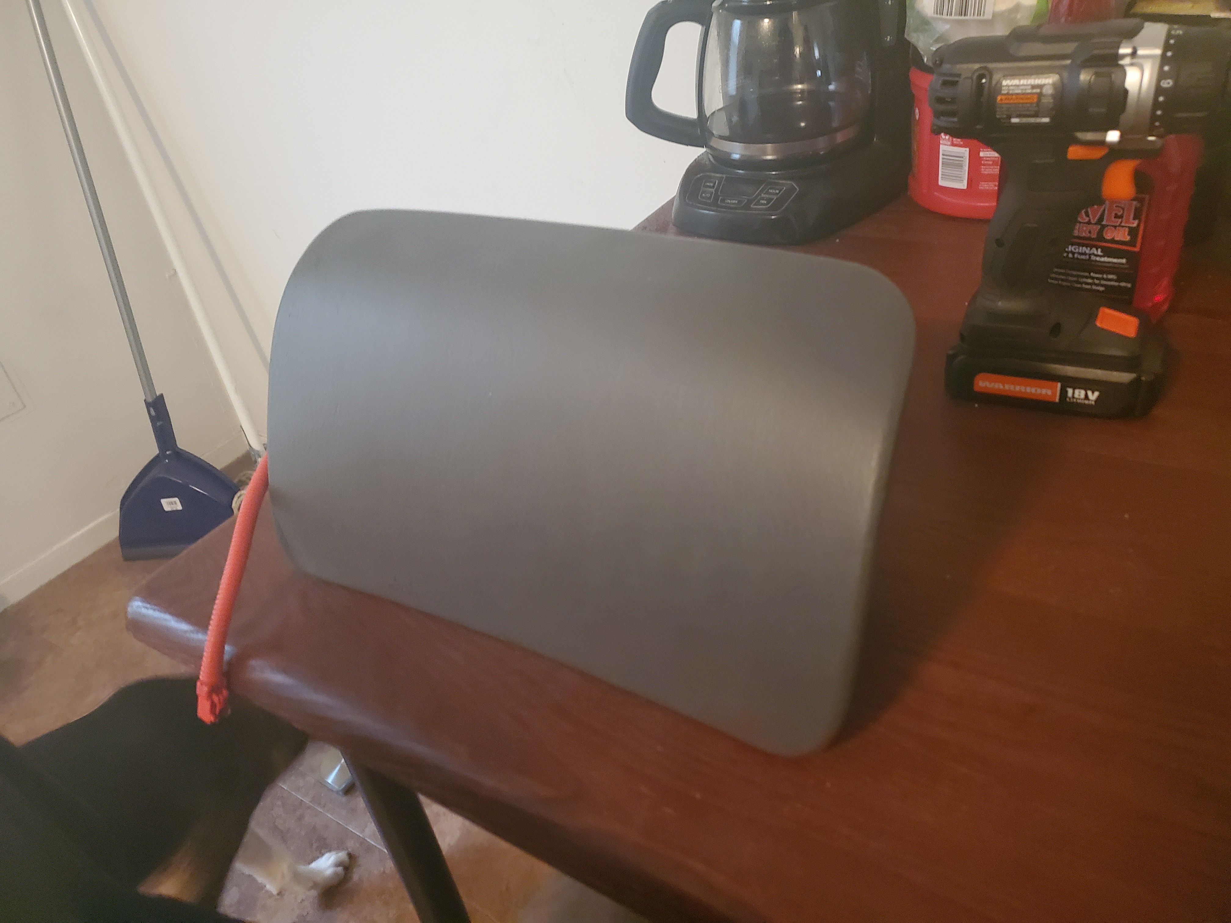

Just bought a passenger airbag from ThunderChild today. That will solve the pealing airbag issue in my car. Also got a few catch cans and some random little things I needed. Now i think all there is left to do is wait. I got a message from Morrison fab saying they were a little behind schedule but will be starting mine soon. That is the last thing I need before I tear through the engine bay again.

Did some work last weekend. The new airbag went in. It doesnt want to sit inside the dash inlay for it for some reason. But I will cross that bridge some other day. Interior wise I still have to get an oem shift boot and knob and a couple clips and then my interior will be next to perfect. I have also had a problem with my drivers side window since I got the car. It literally shakes. Like it's off the track but I know it isnt. I've never really gotten into it but figured I will now.

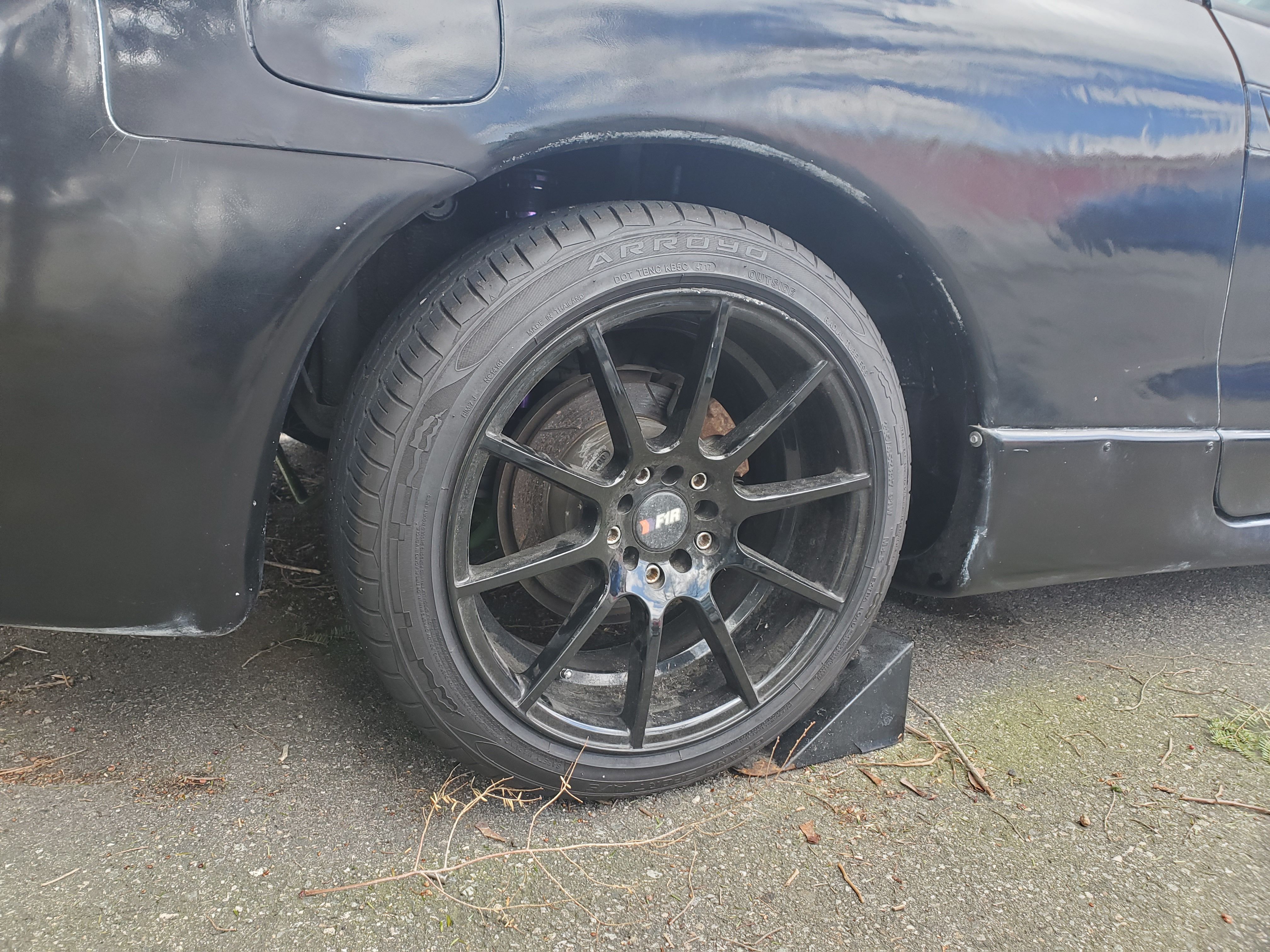

Placed an order for new tires yesterday. Honestly I am always one to buy used tires so this is my first new set ever. Believe it or not. After some good research i decided on 235/45ZR17 General G-Max RS tires. Those should be in soon and once they are put on my wheels I will adjust my coilovers to be a bit lower. Get rid of some of that wheel gap.

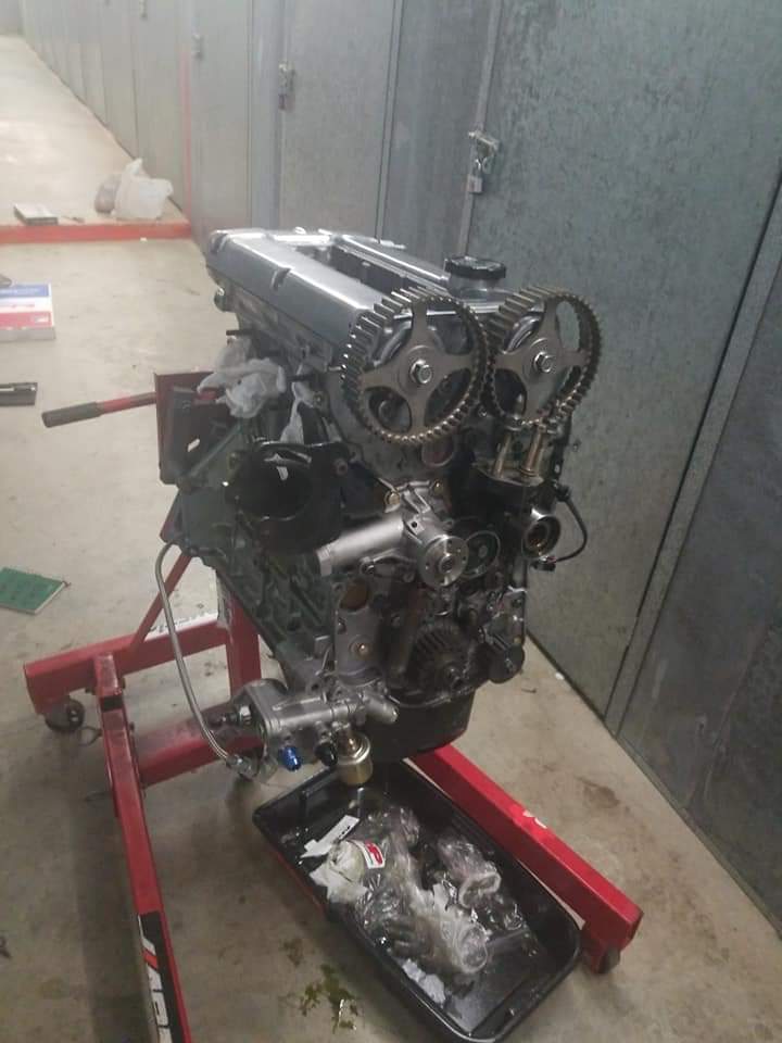

other other other updates: what I am actually doing now is pulling my transmission. Seriously my least favorite thing to do :banghead: I'm pretty sure somewhere along the line I bent my 1-2 shift fork as I have to muscle my car into 1st. Even when the car is off. Also I know my reverse syncros are going bad as I grind slightly going in reverse.
Now before anyone comments :aha: that sounds alot like a dragging clutch. That's what I thought too. I promise you that it is not. Not being able to get in 1st with the car off was a giveaway to me.
Anywho, I'm going to have it out tomorrow as I'm now being rained on and I will be giving RRT a phone call Tuesday for a rebuild. I wanted to do it myself but I know I will take my time and we are already pretty deep in the season.
Once I get that back, the install of everything will be in full swing. The thing that will probably take the longest is the fuel lines. I will probably be up and running 3 weeks or so after I get back the transmission. Then I will be going back to RRT for a dyno tune.
so as yall can see I defjnatly messed something up. 90 percent sure a 1/2 shift fork broke but could be something else. Last week I yanked my transmission and brought it to Raif at RRT Motorsports to get rebuilt. I am also getting LSD put in since I intend on staying front wheel drive.

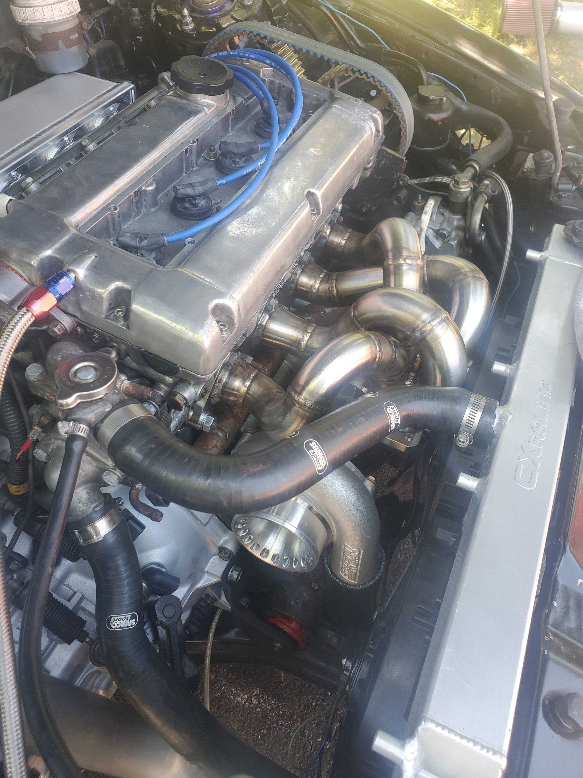

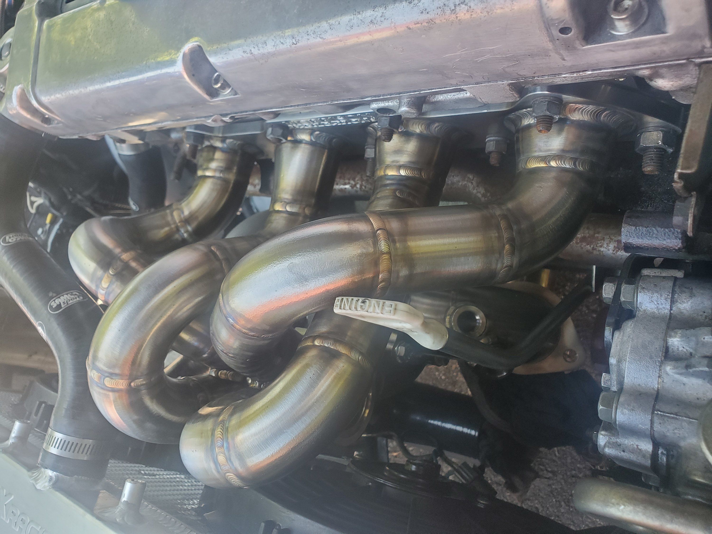

I have also gotten my JMF intake manifold in and have since installed it. Coil pack relocation and injectors also got out in.

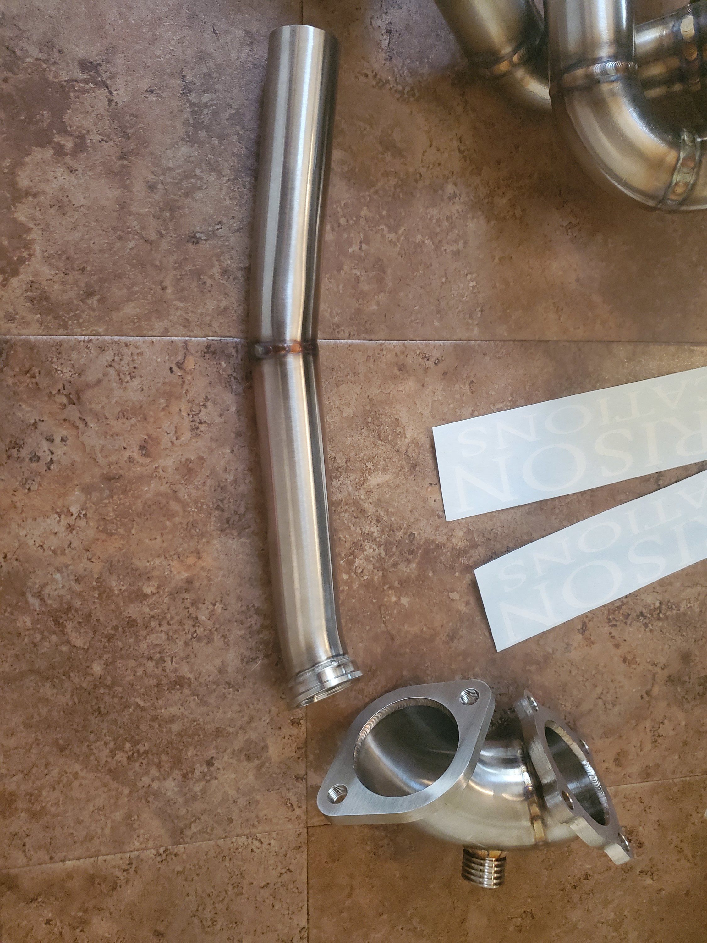

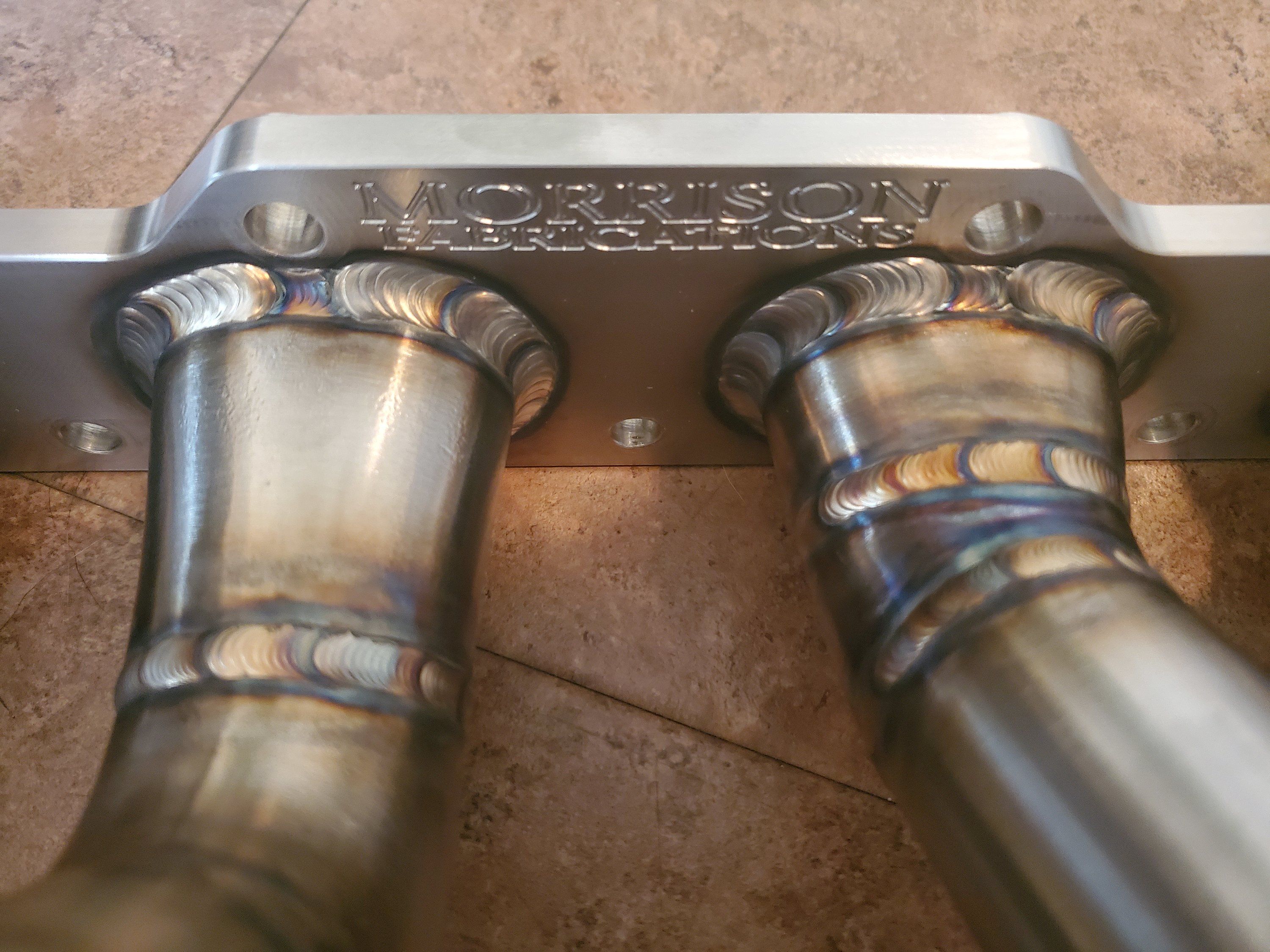

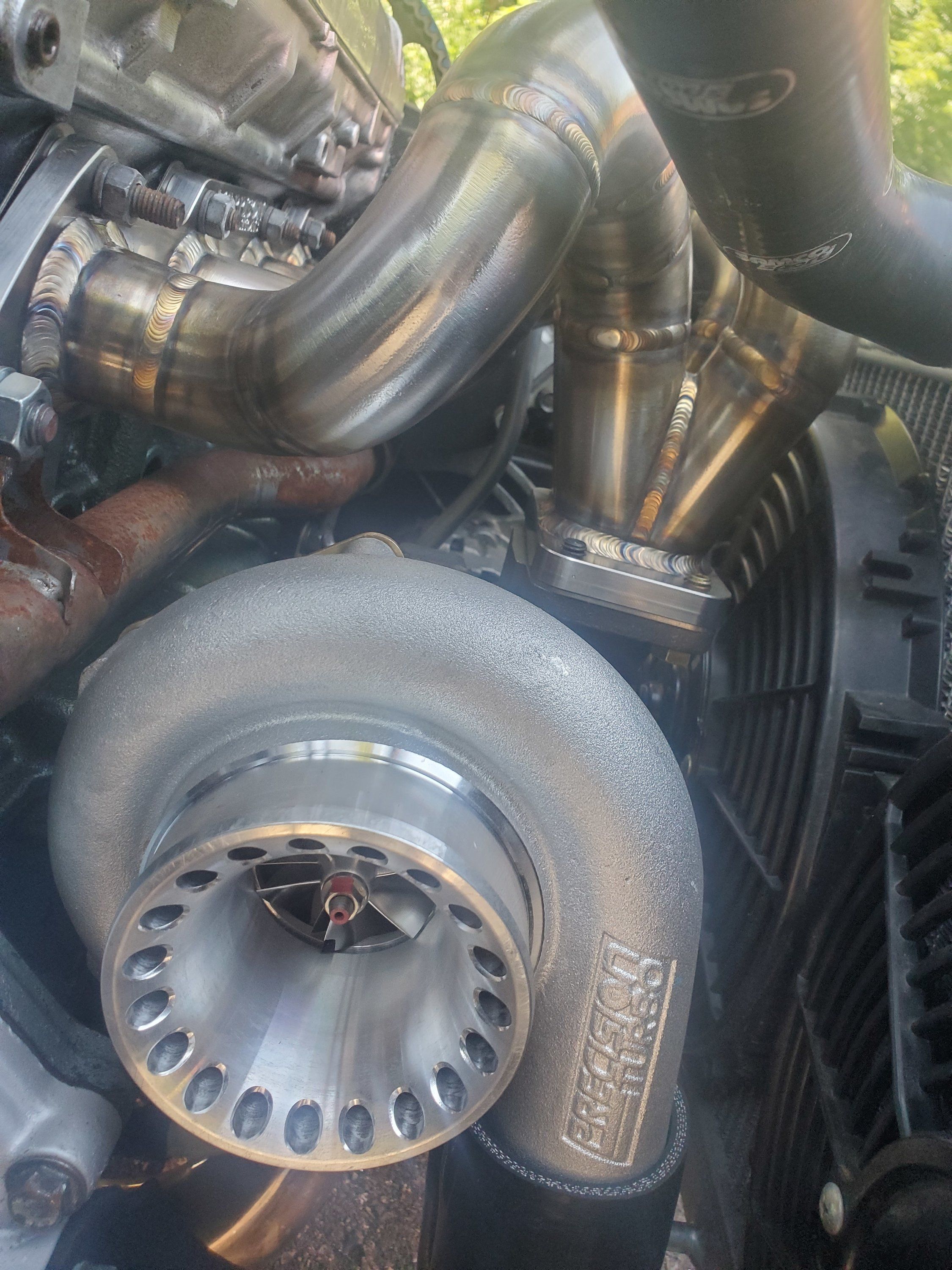

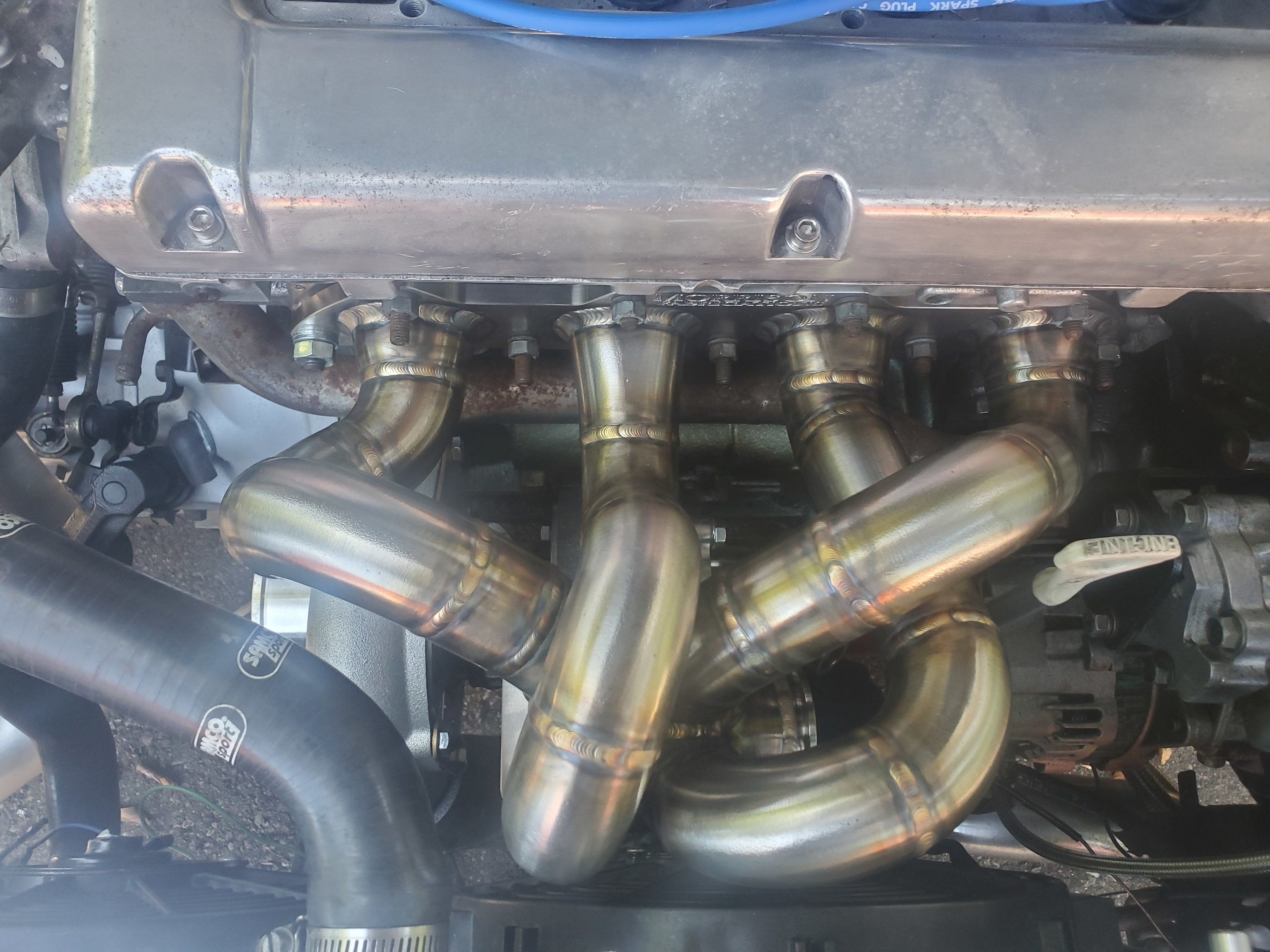

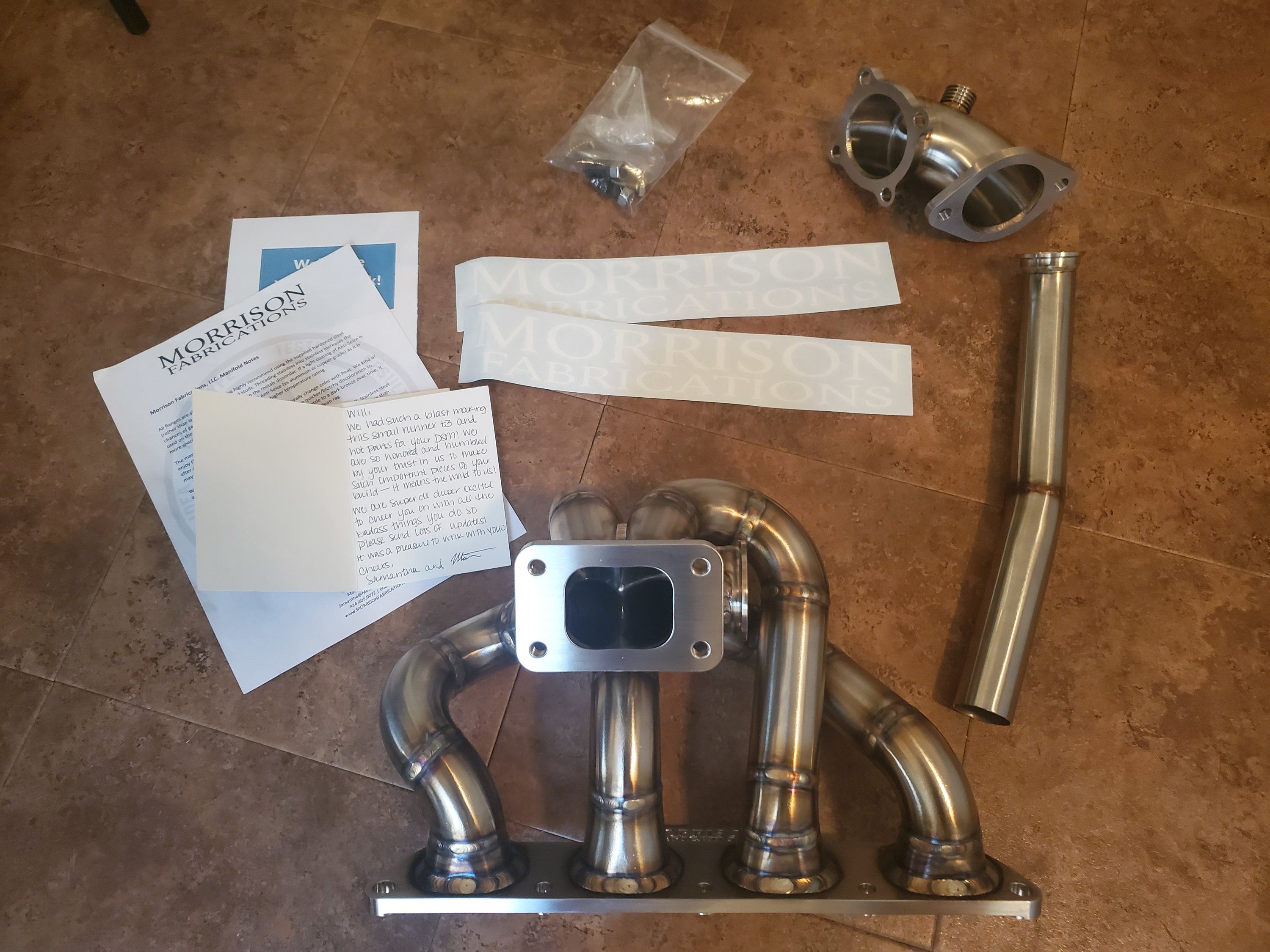

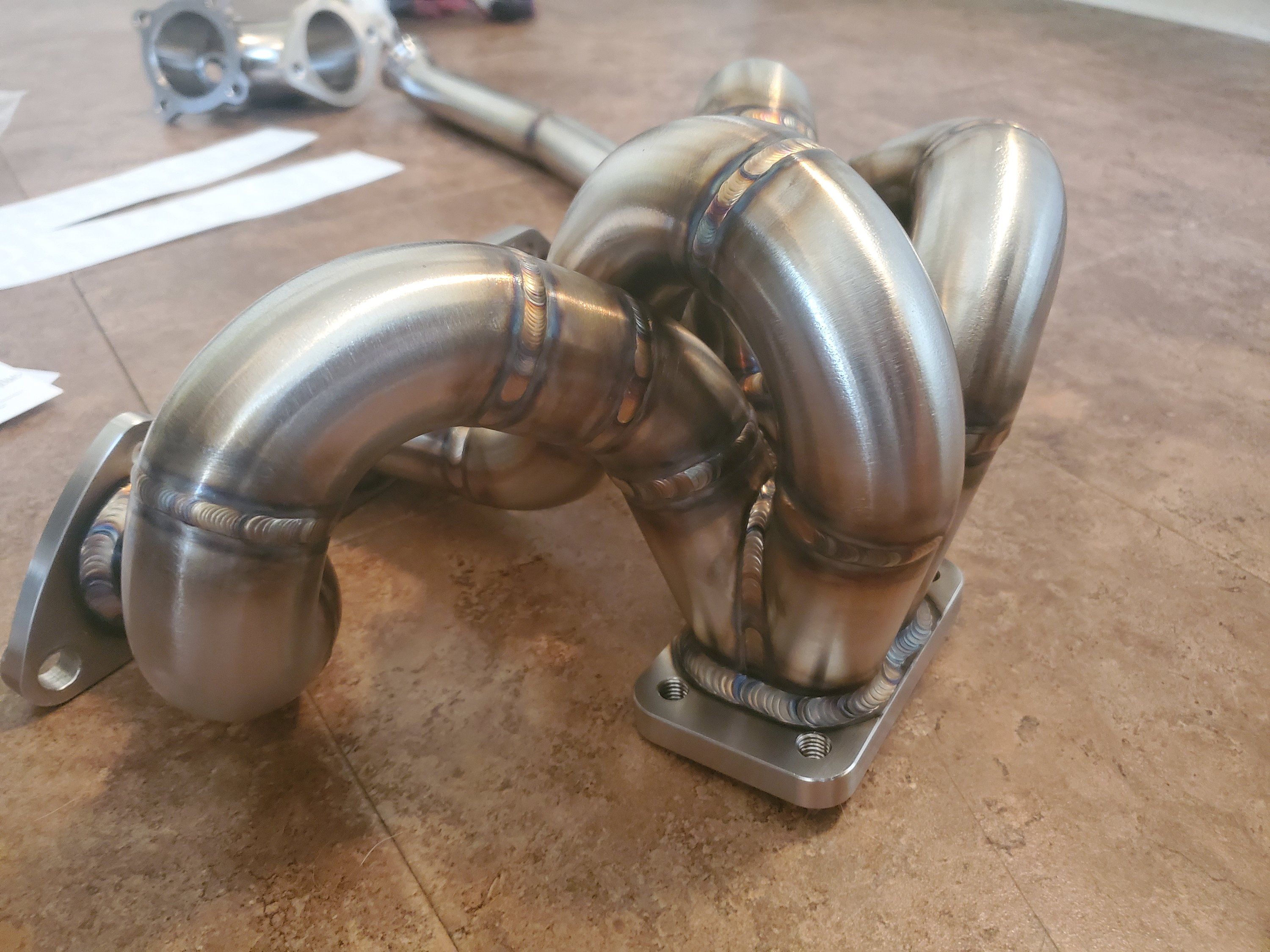

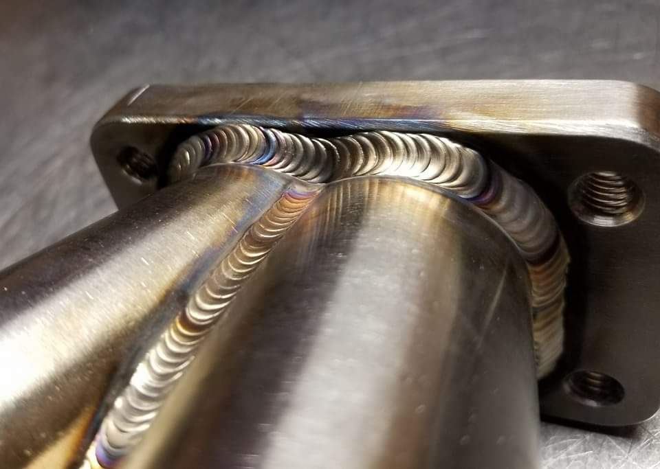

That is a piece of art. Are there welds on the mating side of the flange? Also, how were the threaded insert holes that hold the first runner sections filled? Were the inserts left in then welded over? Or were they removed and holes welded/blended all the way through?
