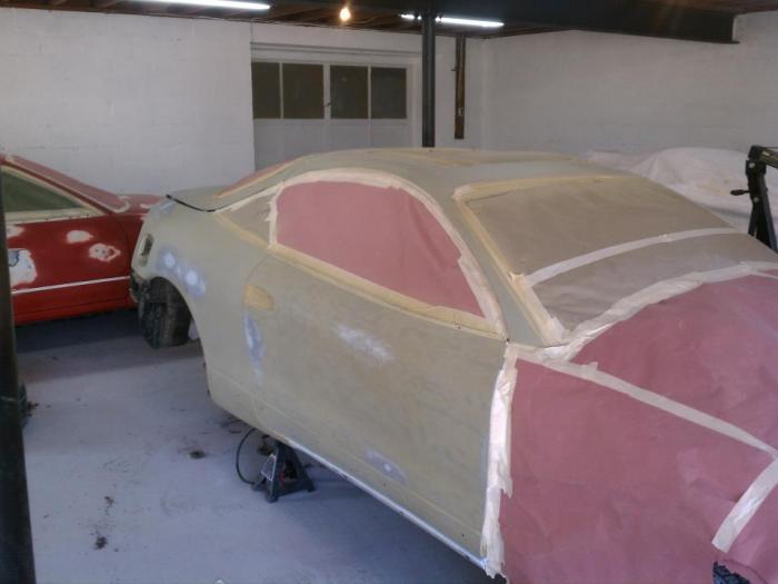

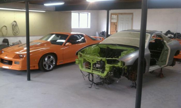

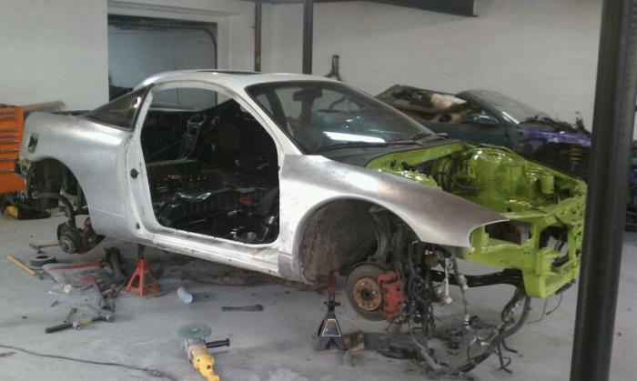

GSX down to bare metal in both pics. Also a shot of my Camaro I built same way as I am doing this one in background.

I'm assuming you're going with green paint, or was the engine bay like that when you bought it?

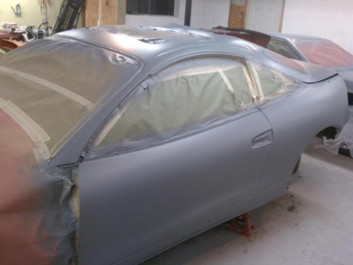

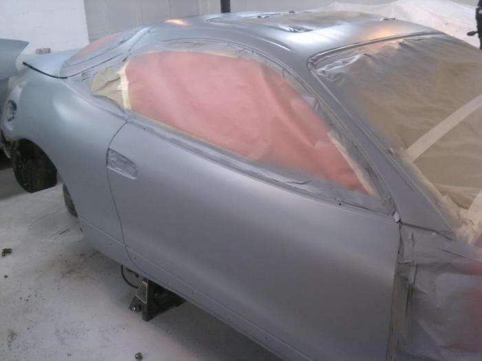

1st picture in this set I have etch primed the car using all Dupont paint products. The body work was then done and 2nd and 3rd pictures show the Dupont primer filler 3 coats mixed 4:1
(cant stand this auto merging reply posts but understand why its done.. this is in response to iTSaTSI) Green paint in the engine bay and roll cage.. Exterior is being sprayed Cosmos Black, a black pearl from the BMW.. Having green on the exterior would be ripping a page straight out from the fast and furious

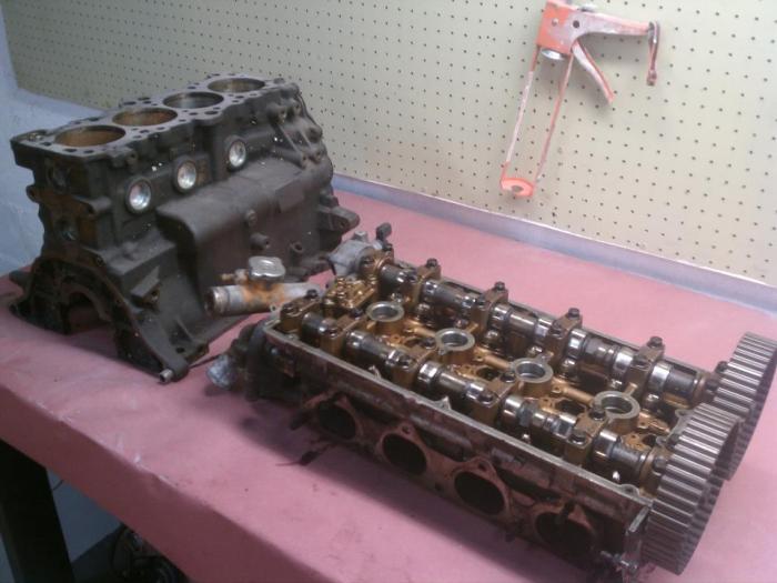

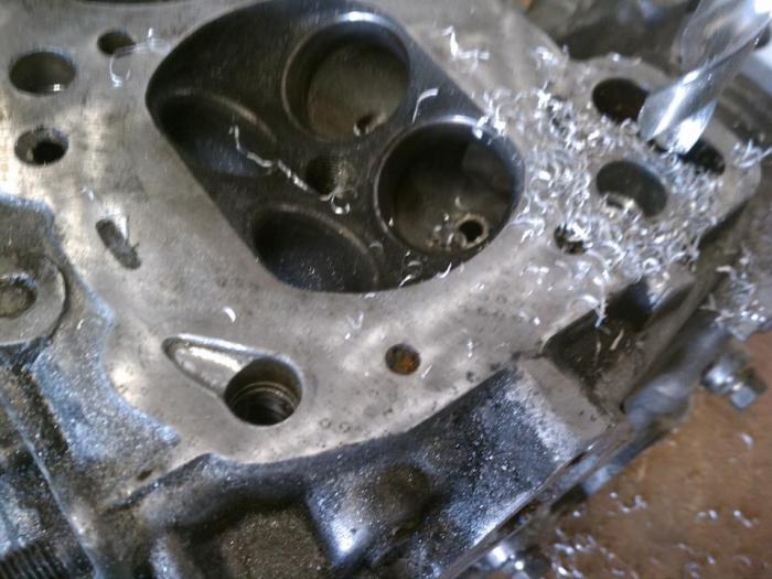

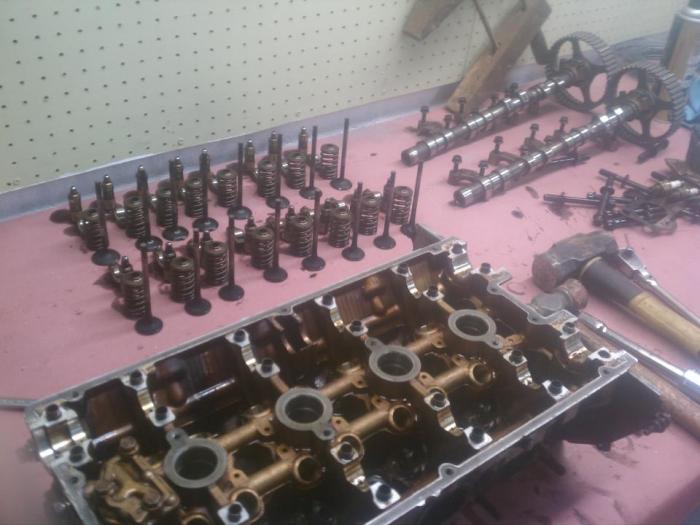

Followed by 4th, 5th and 6th pic is the beginning stage of the engine build (6th picture should have been put in 4th place since its an older pic, made a mistake). Its a 6 bolt block and 7 bolt head. 2nd pic is drilling the 11mm stud holes to 12mm to fit block and dremel bottom left oil journal to allow better lubrication to head. This is still an obvious argument whether or not this actually prevents the lifter tick and actually improving oil flow but I did it, makes sense to me as there is a large channel the oil flows through around that stud. Doesnt hurt anything by taking a little aluminum out of this spot.
Head and block ready for machine shop cleaning and decking
