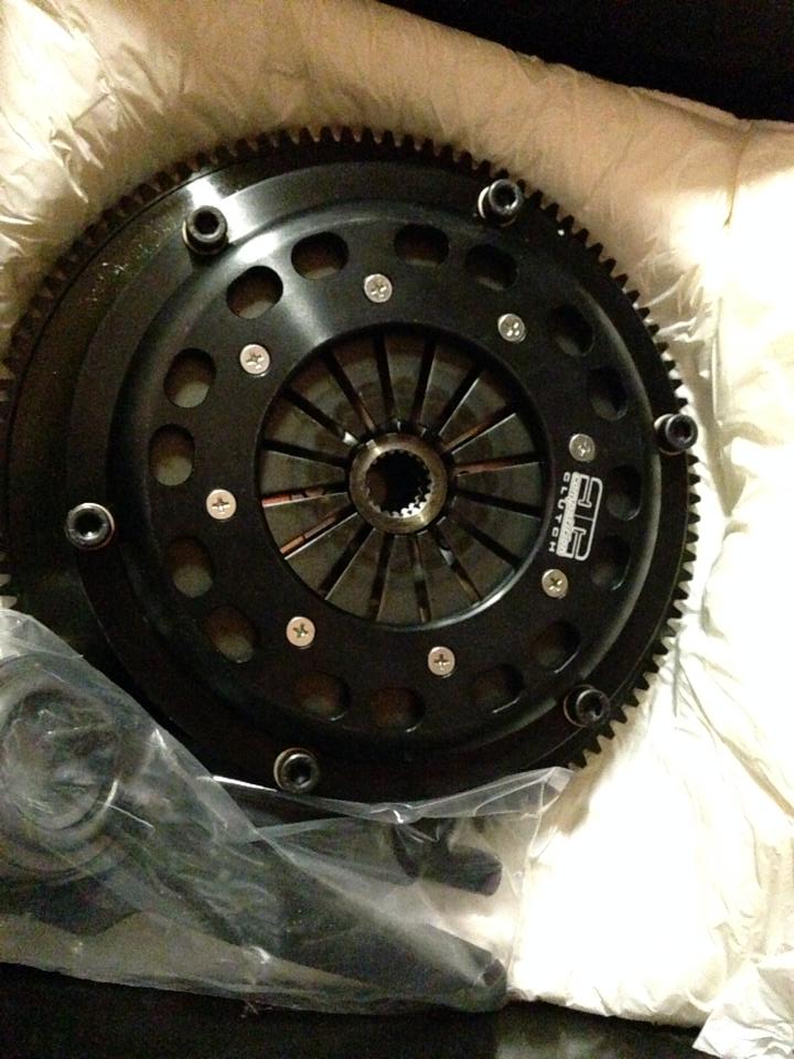

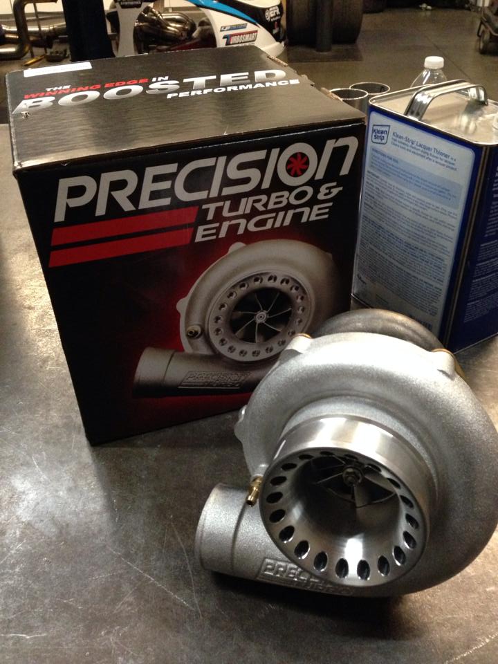

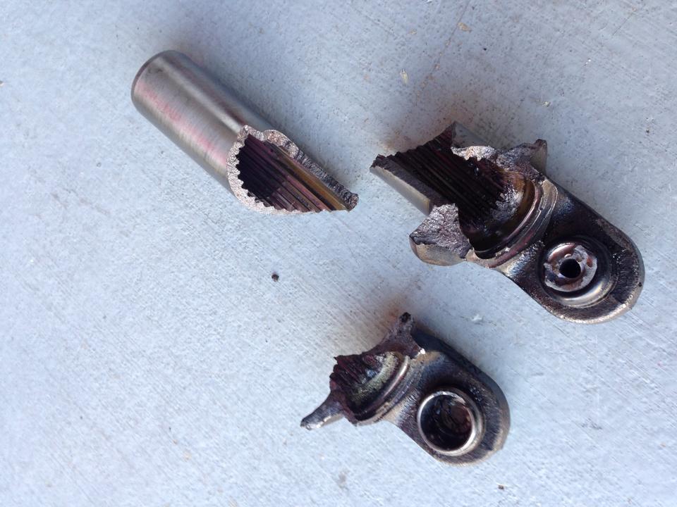

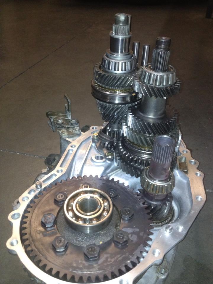

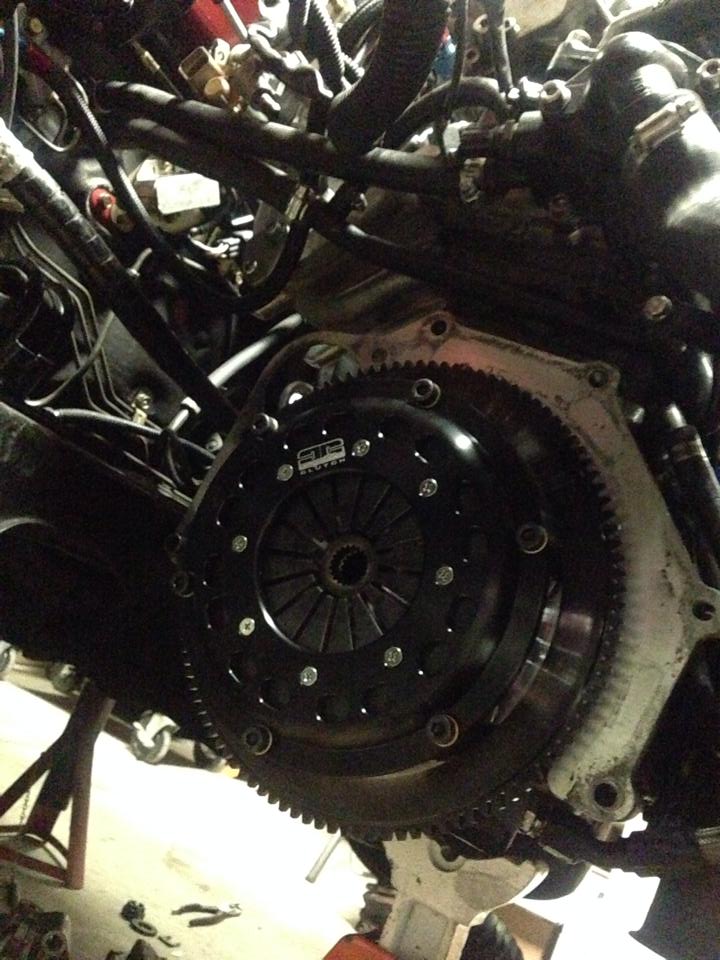

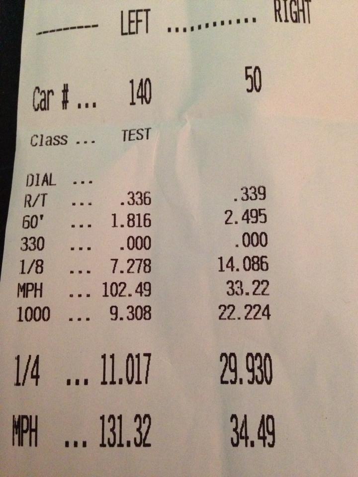

Been kinda out of the forums for a while. Lots of new updates. I ended up breaking all the teeth off 4th gear so picked up a new trans and rebuilt it/welded the center diff. At that time I hated my single disc so picked up a competition clutch extreme duty twin disc. I also put in ID2000's and a bigger fuel pump. I also picked up a DBB Precision 6266 V band turbo which im still waiting on building a manifold for. Car currently making 590whp on 28lbs and made 660 on 34lbs. Still on the same cast wheel JB 3582R. I took the car out to the track at IFO and went 11.0 @ 132 on 28lbs of boost. Pissed that I didnt crack a 10 sec pass I put hoosier drag radials on and took it out a week later. First pass broke the driveshaft yoke.
