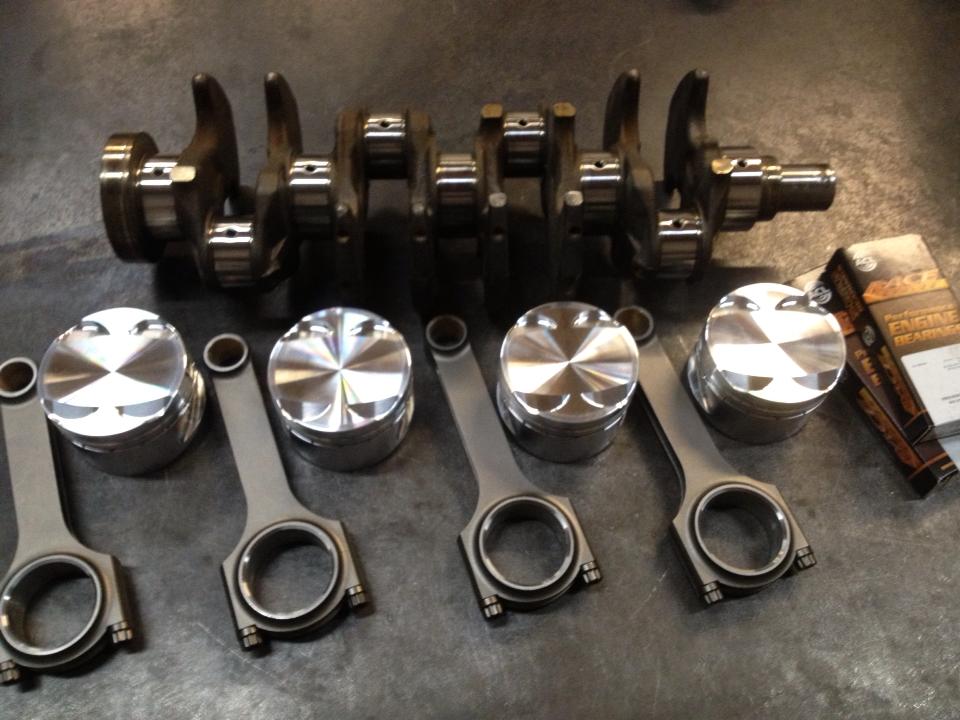

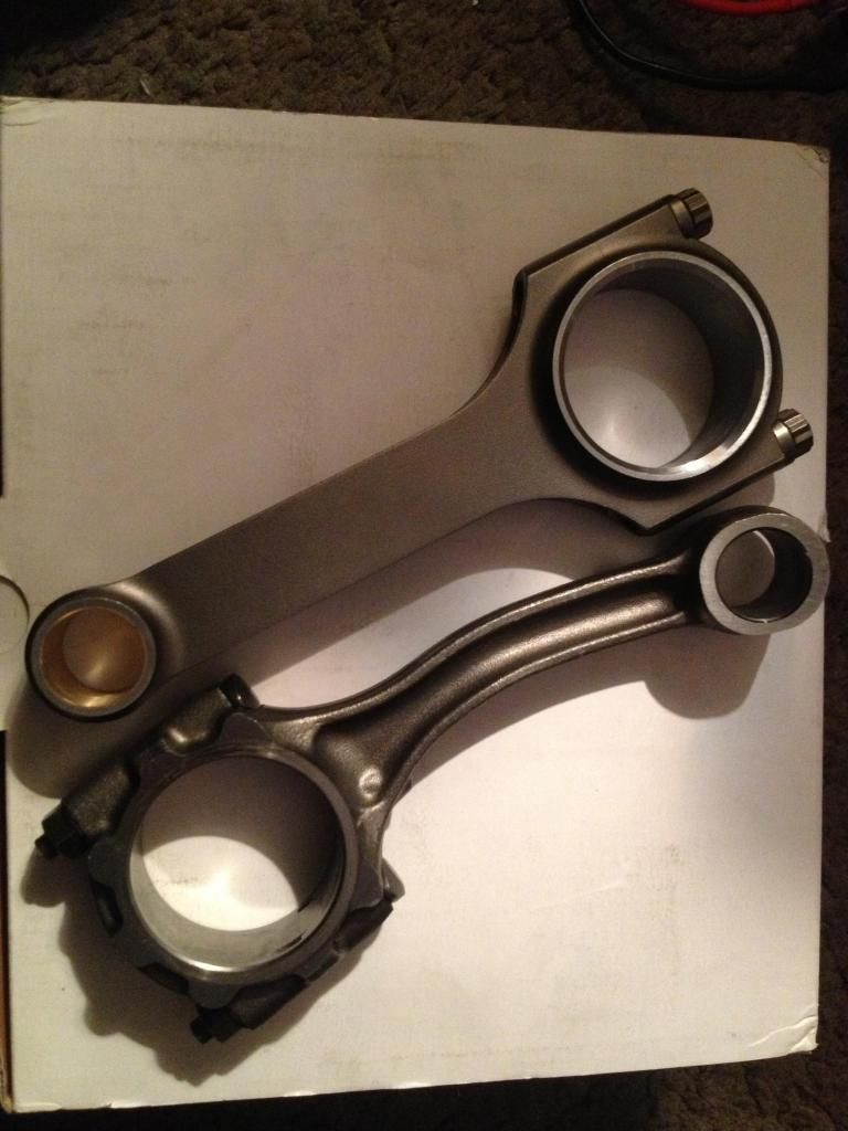

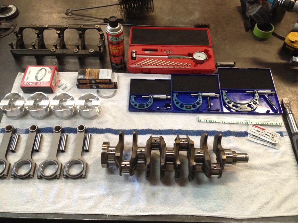

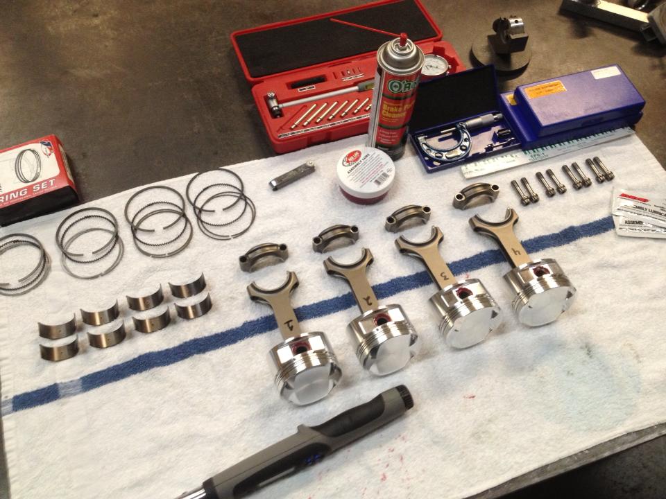

Little bit of an update considering its been a while. Took it to the track and went 11.5x @ 128 on street tires with a 1.9x 60ft. Clutch dont like the power launching it with the slicks on it, Tried that ended up trapping the same but the ET ended up being 11.6x a couple of times. Turned the boost up to 30-31lbs and retuned made 561WHP 457TQ. Brought it back out to the track and ended up bending a couple of rods. Pulled it all apart and ordered some new parts. Got a good deal on some Scat H beams, and ordered up a set of custom JE pistons. Block will be back from the machine shop today so will start assembly right away.

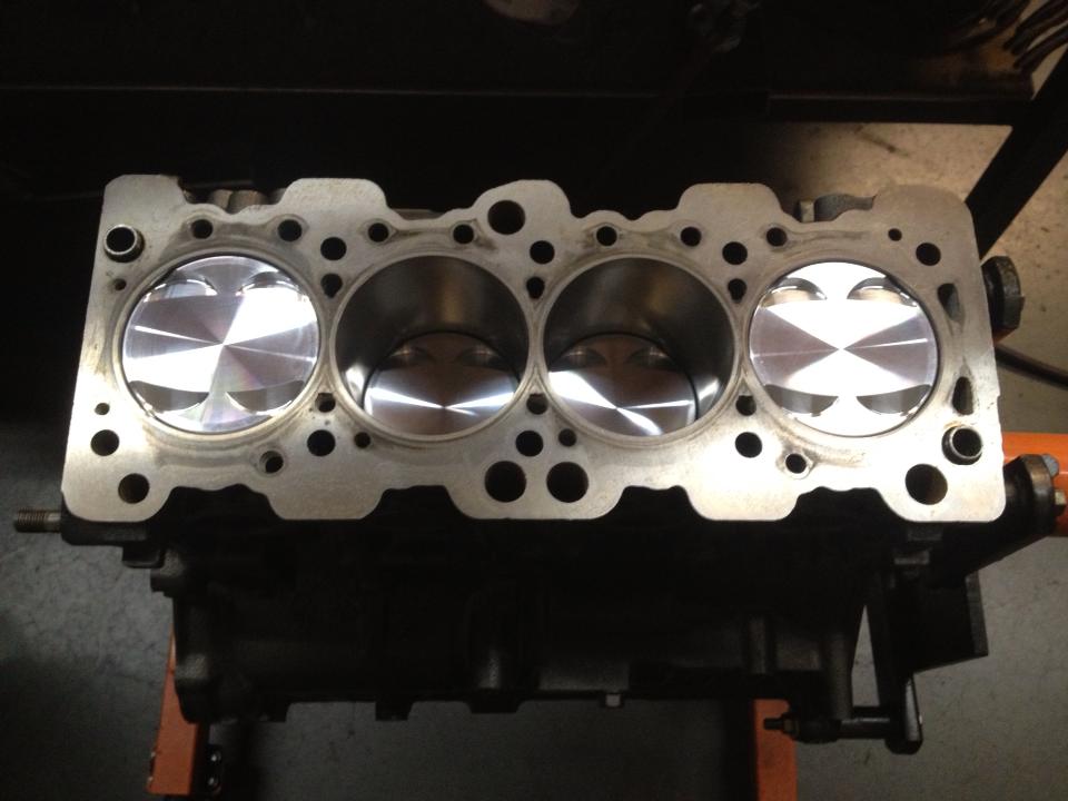

Crank all polished, plugs pulled and oil galley's cleaned.

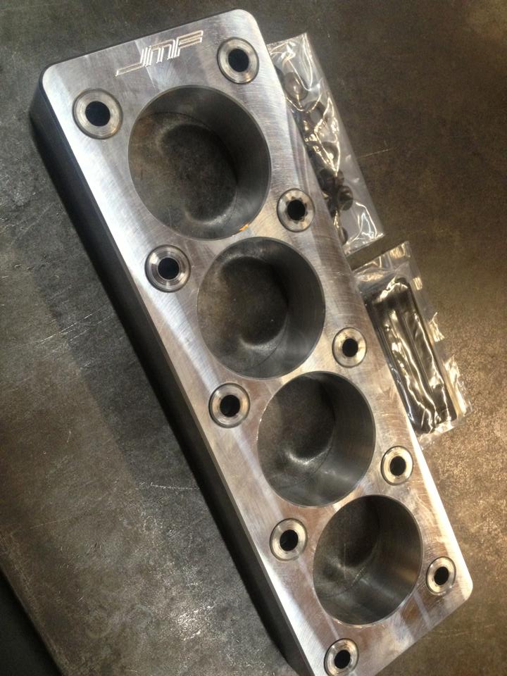

Torque plate for the block! Only way to do it right!

The block is a 99 split thrust 7 bolt with a 2006 evo 9 Crankshaft. Its the block that has been in the car since I rebuilt it the first time with evo pistons and rods.

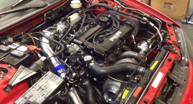

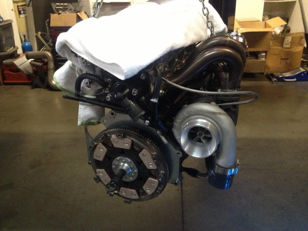

Its all in and running. Alternator took a dump so replacing that today.
Its got a 67mm 37R on it now too..
Should be tuning it maybe tonight as well. Will update later

Dang, that's a tight fit! You are using the 2.0L 4g63, right? (not a 2.3L stroker etc) This thing should have some serious punch!
Yes it is a 2.0L with a 5.906 rod length.

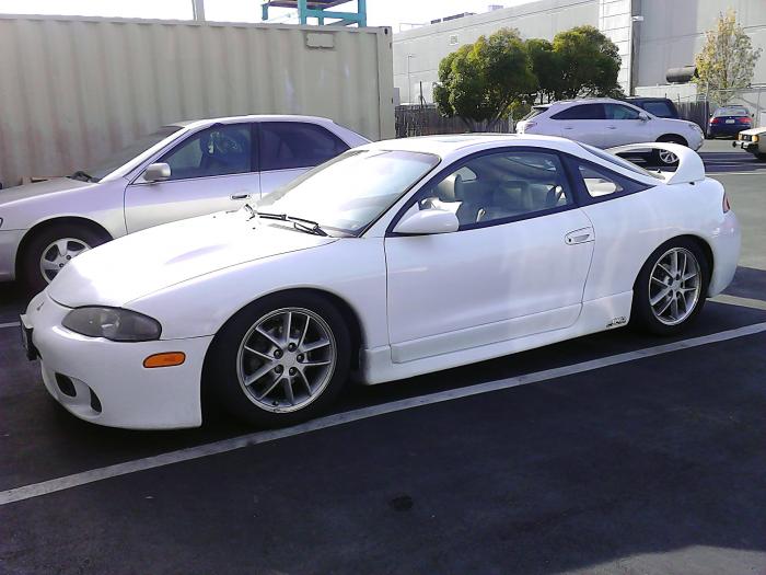

Hi devin, thats a nice gsx engine build and that car is a beast., im new to the dsm scene and recently bought a white clean gsx. Im currently stuck at stage 1 for the moment cause of payments but will get there shortly. Im here in the bay area bought originally from vegas. Used to do alot of drag races out at industrial back in the days but currently need more mods and technical know how on my car. Im planning to take a vegas vacation on july 20 thru 29 and get some car work done there.

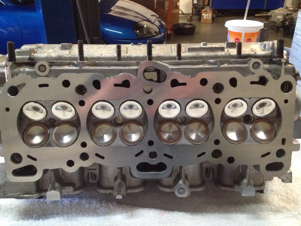

Excellent thread and build Devin! Great motivation and proper "show how", very excited to see what's next. I also have a question, after you bent a rod and rebuilt the engine, did you resurface your cylinder head? I didn't catch if you did or not. Thanks and good luck!
