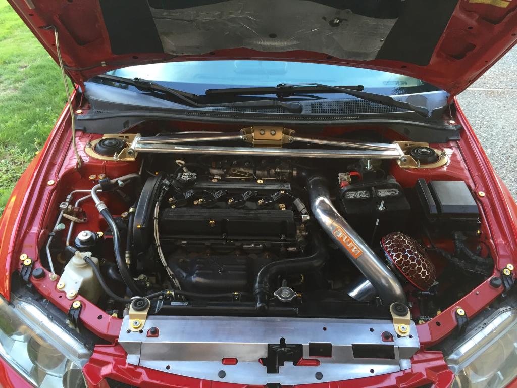

During the summer I did a few things to my 8, did a JDM rear end and touched up the bay a bit. Love having a stealthy engine bay that packs a decent punch ;)

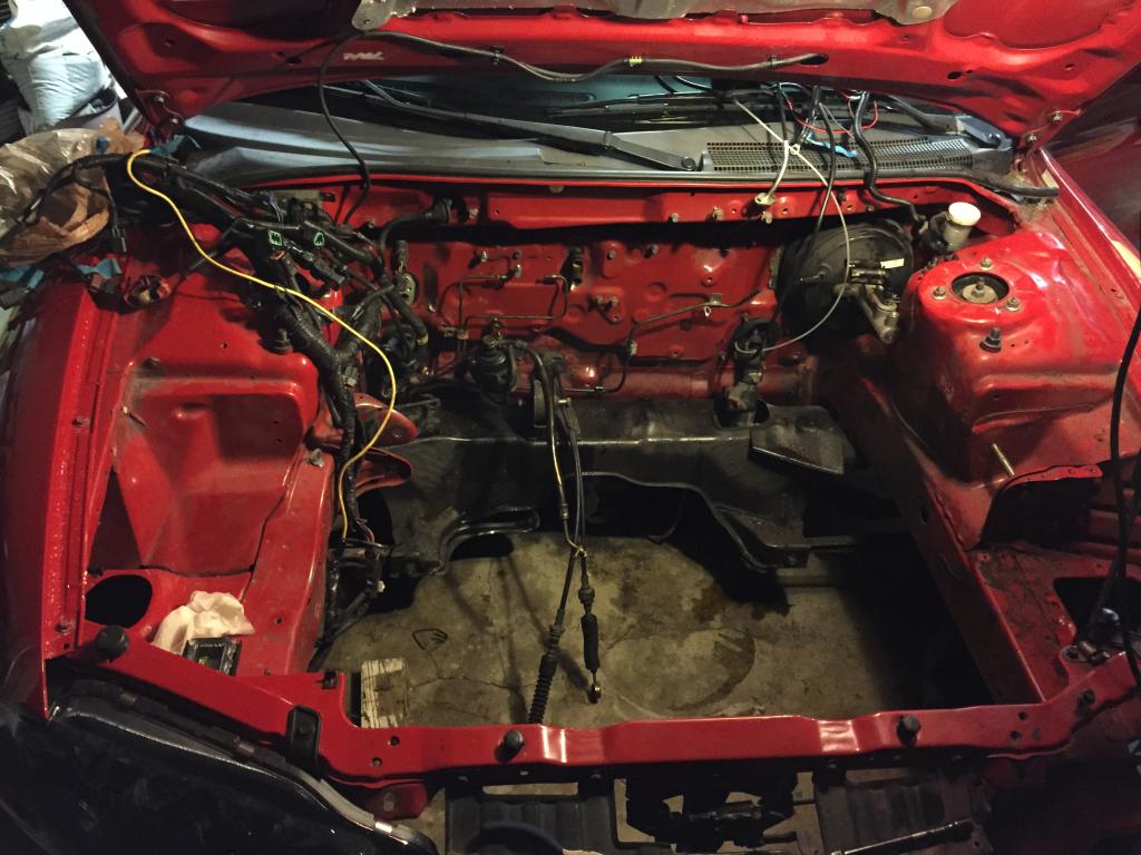

Removed insulation on fire wall
Removed Power Steering
Removed ABS (which has been bad for 4 years)
Removed factory clutch line

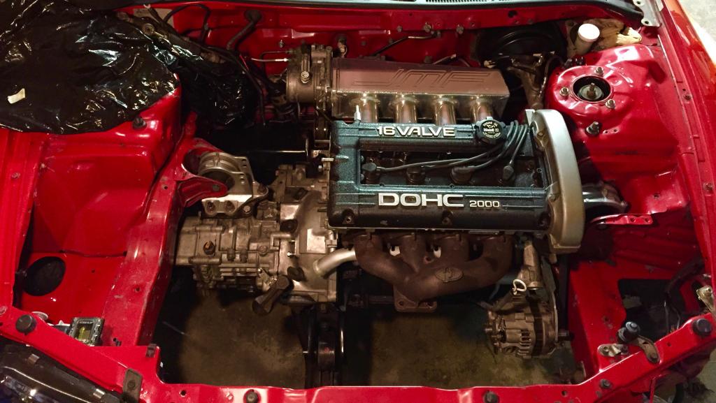

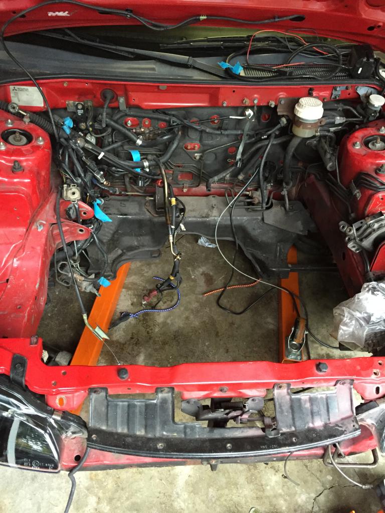

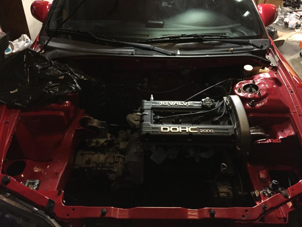

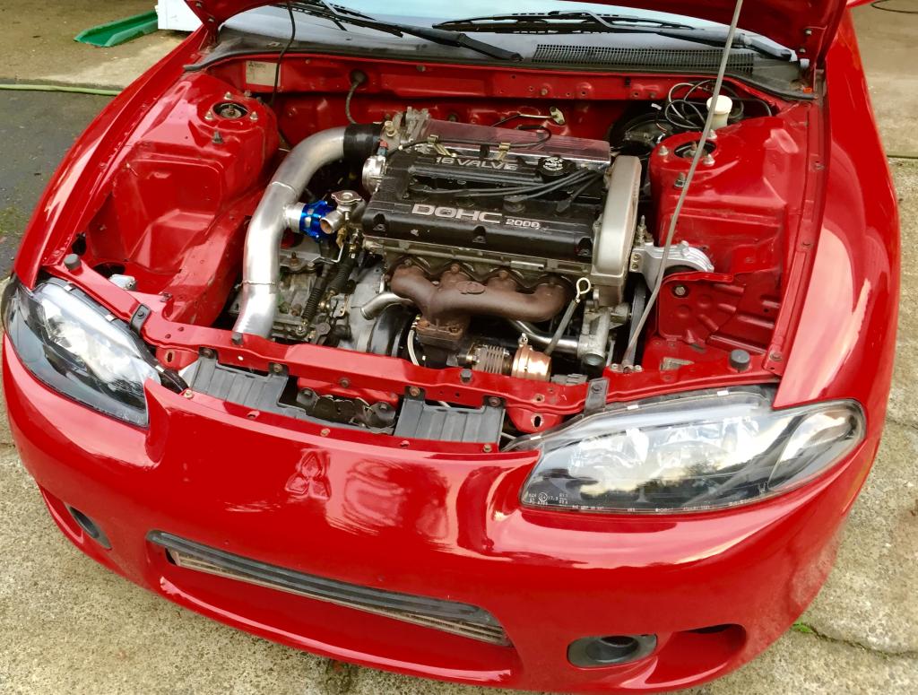

As for the rest of the build, I got a great deal on a running 6 bolt motor and a head. So I ordered up a head gasket and got to work on the bay. Here are some pictures.
Heres the before:
This picture is after removing:
Power Steering
ABS Lines
Insulation
Brake Fluid Reservoir
Factory Clutchline
And a few more things

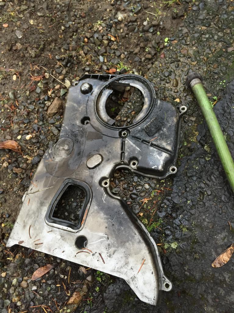

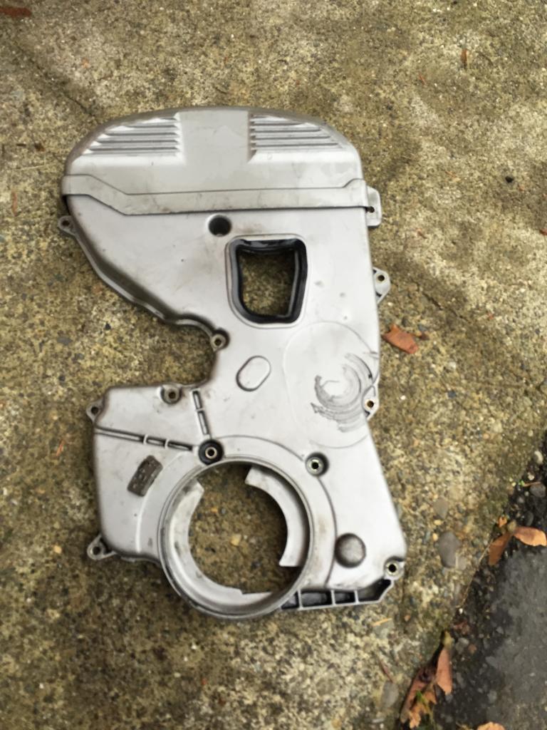

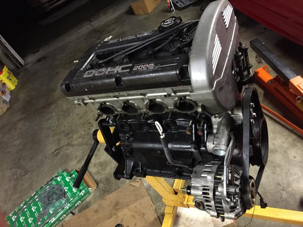

Well, I started a bit more last week. The car sat for awhile while I was waiting on the head gasket. After some downtime and studying I had a little time to get to the garage. I timed the motor and then did a a quick cleaning on my timing cover.
All clean!
Because this is a 6 bolt swap, I took my time shaving away at the timing cover
. Last time I got fed up and cut it apart like there was no tomorrow. Doing so prevented my from being able to run an upper cover. So this time around I decided to really take my time and make sure it was done with an upper cover in mind. (PS. had I had a 2g cover, I would have used that.)

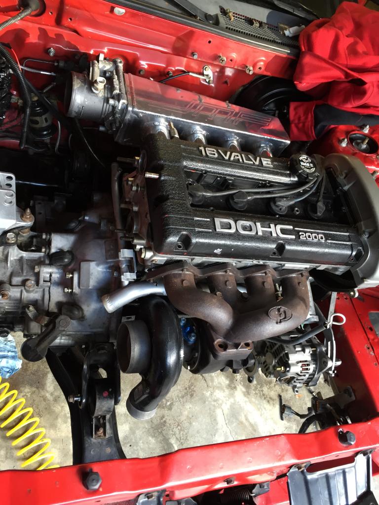

Installed the cover and got my alternator in. I then broke out the loctite and installed the flywheel and clutch. Then got my transmission bolted up to the motor. I really wanted to get the tranny cleaned up better. I was really wanting to try out the aluma blast product, but due to time constraints and the likeliness of pulling this motor again soon; I cleaned it the best I could with brake cleaner, purple power, simple green, and an assortment of brushes.

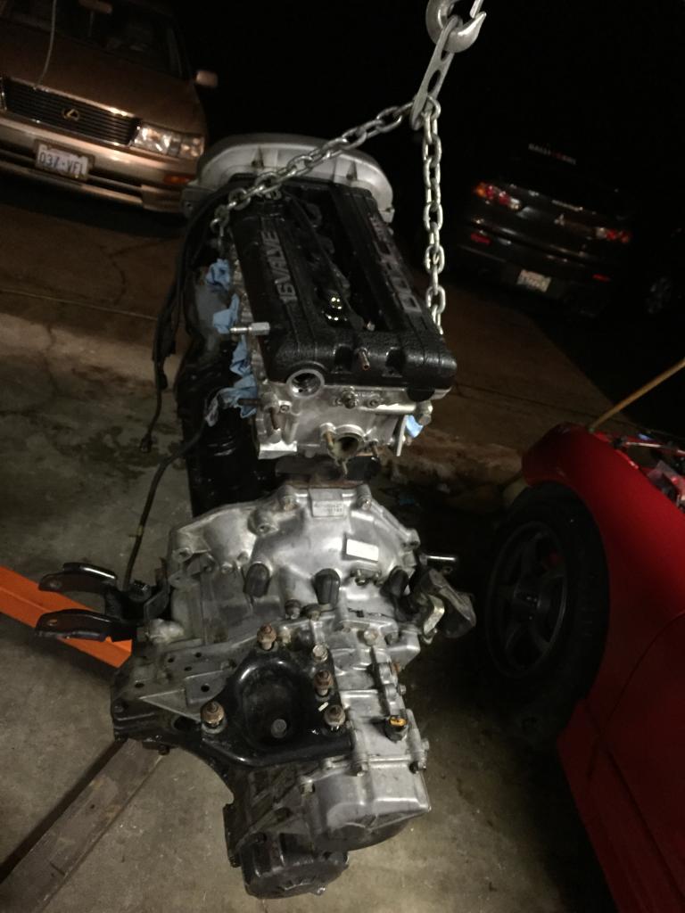

After doing so, I assembled the engine hoist and got to work.
After about 20 minutes and borrowing a hand from my old man, we had it in and bolted up.

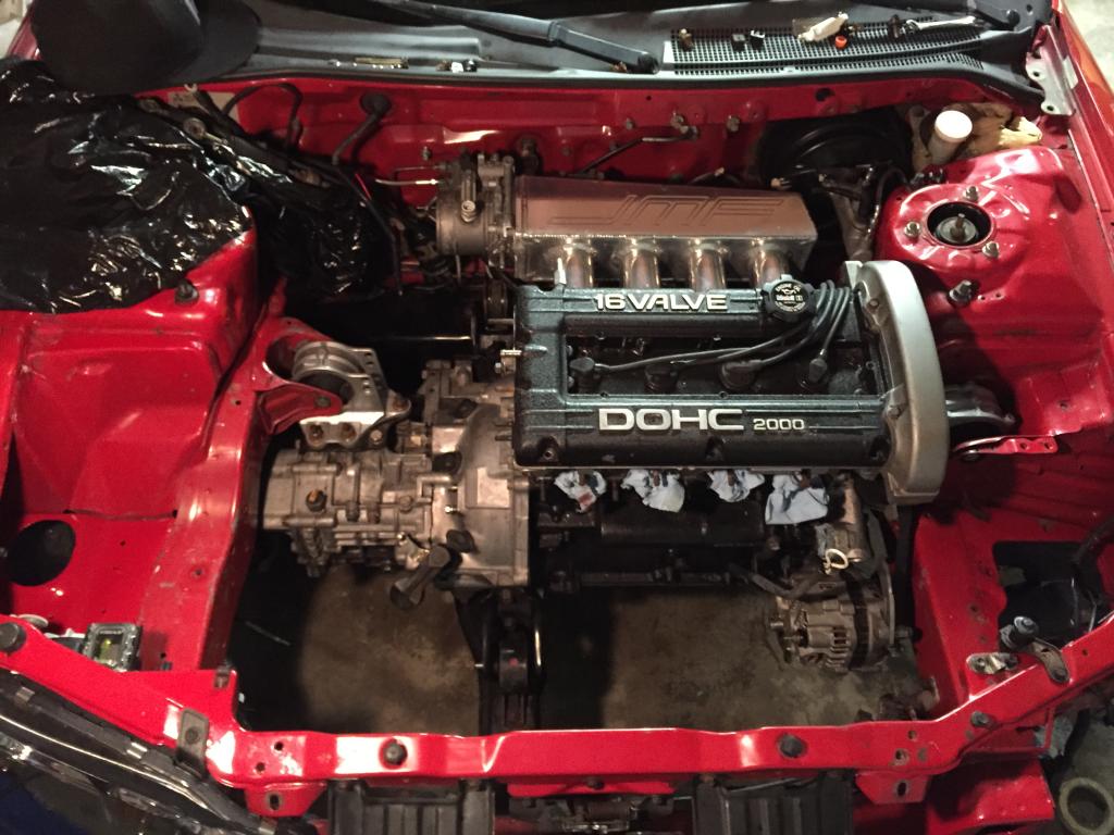

After getting the motor in, I wanted to relocate things on my fire wall so that way they are hidden. So I got my intake manifold in, JMF coil pack relocation in, and ac bracket mounted. Then went to work.
Threw the FP manifold on to see how it would look, then regretted it seeing how much the ceramic coat that was already on it before purchasing sucks.
After this I did a few small things, bolted up the transfer case, ran some wire for my alarm, and put the axles back in. I then began to run into more issues while mounting the turbo. Aside from not having proper exhaust hardware OEM o2 housing bolts or new turbo bolts; my water pipe was in the way. Generally i've seen people bash them in, shave off metal, or run spacers. Well, maybe I should have researched; but by the way a 1g TURBO water pipe will not work. The welded fitting for the turbo coolant line WILL make you want to shoot a unicorn. So, currently i'm searching for a 1g NA water pipe.
but here is where I stopped this week.

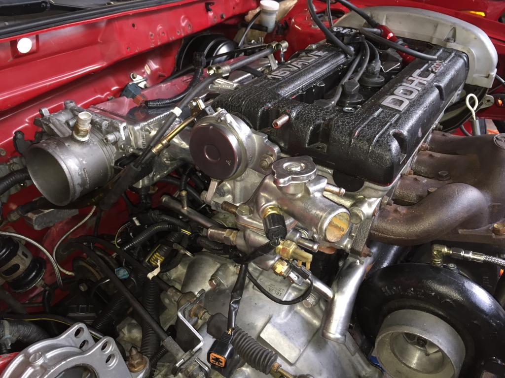

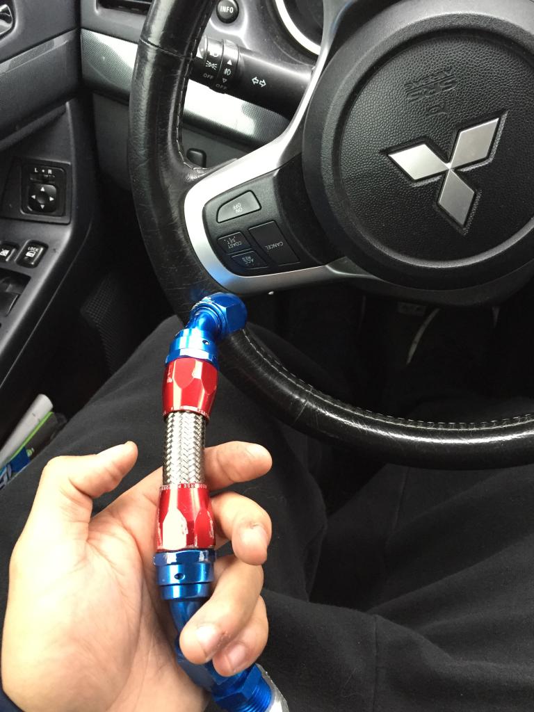

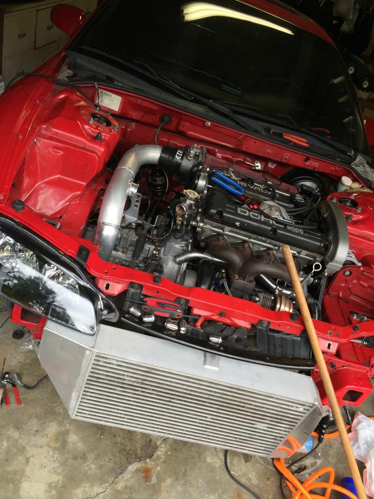

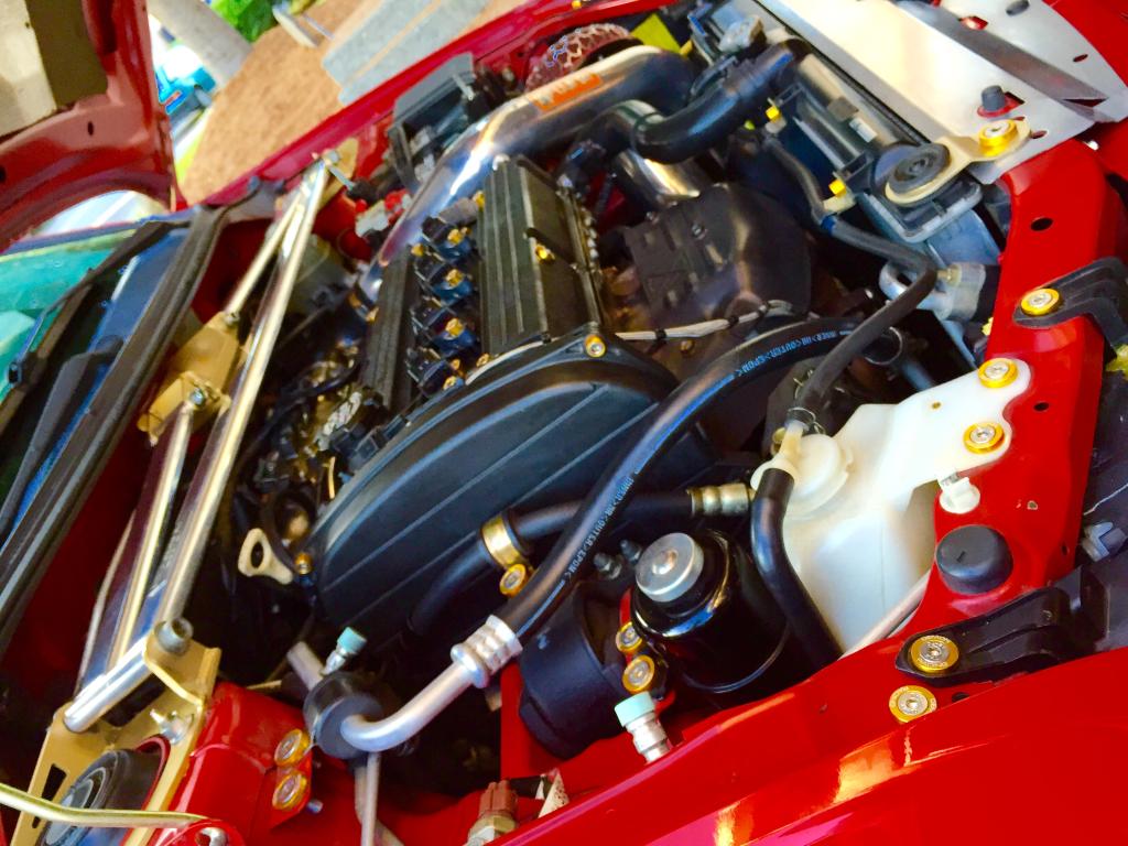

..Yes, that's the entire list! Whoop! So, I have a few things left before filling fluids. I picked up an adapter for the 12AN Oil return line. Which is now installed nicely. I then installed the oil feed with a t fitting for oil pressure which I will still need to get a restricter (which is likely due to having BSE kit and not OFH port). If anybody has some insight to shed, please do so. Here is a few pictures of the progress:
I'm hiding most of my wiring under the intake manifold. My goal is to tuck my spare harness so none of the unused crap is ziptied back.
Most expensive, smallest, stupid line ever. But at least it's pretty!

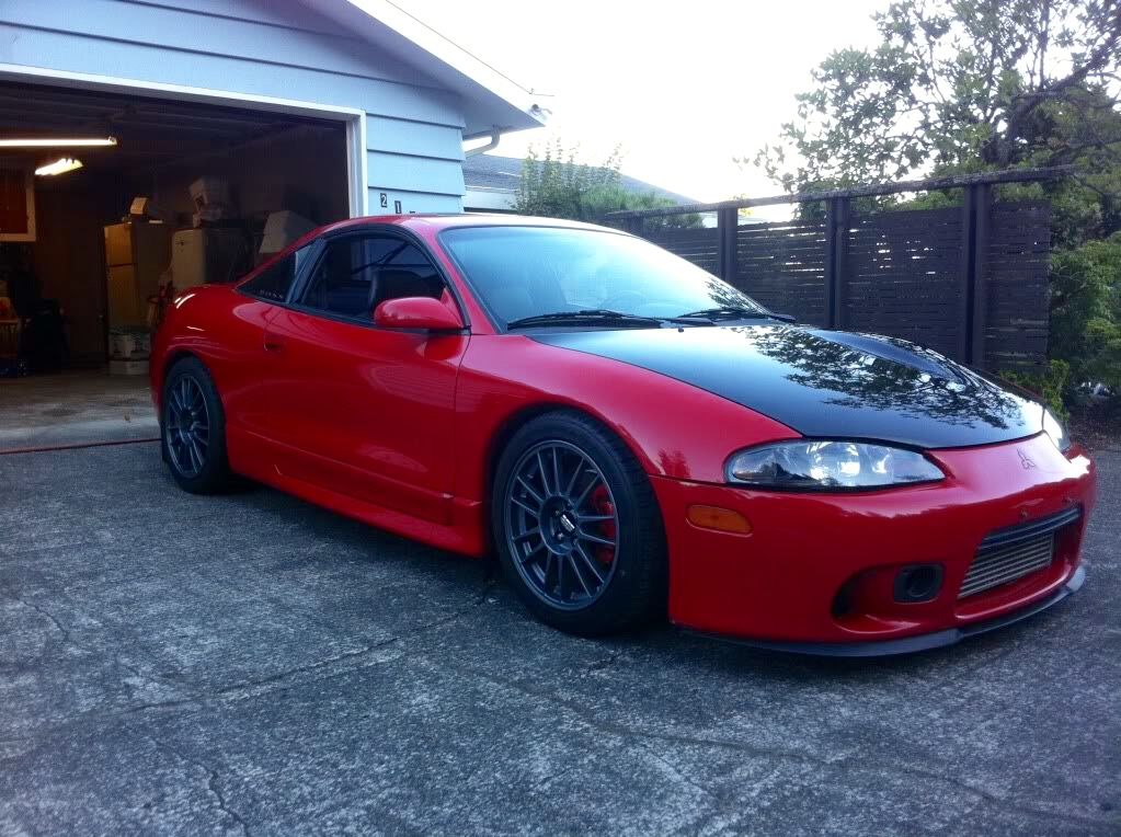

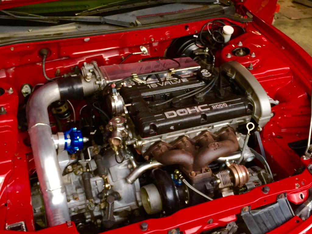

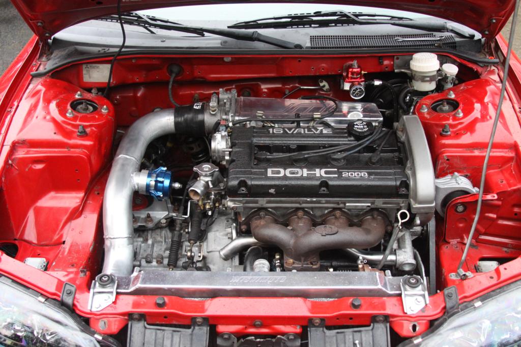

Well, I grabbed the camera and shot a few photos.
PS: I know my hood isn't closing properly. I relocated my brake fluid reservoir and I need to adjust it down because it's not clearing the hood; which I feared but went with it anyway.
I managed to get the car running. It's doing well. Responding to throttle.
Have a slight tune on it so far. Only issue i'm running into is the heater core hoses stopping the q45 from opening all the way.
Hope to have some more pictures and videos for you guys.
