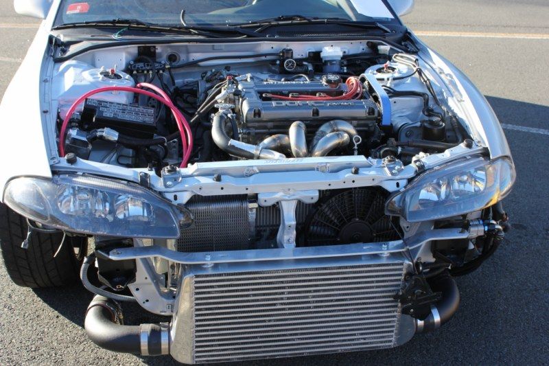

-Page 1-13 After 4 years of building my 97 GSX, I made 510hp on 93pump using a PTE6262 running a 2.3L stroker motor, on a DynoDynamics Dyno. Drove it a bunch, and broke T-case's and other parts.

-Page 14-15 Cont.. Fast forward to March 2016. I was made aware that my old GSX was for sale. Talked to the owner, and I tried to buy it back. Unfortunately that deal fell through, and someone offered him more $$$. New owner of the GSX is in Southern VA. Great guy, I am happy the car ended up with someone like him. Then it hit me, I did miss the DSM community some. I Jumped back on Tuners, got up-to-date on all the changes. Uploaded a lot of missing pictures from when i started this thread. And now I am on the Hunt for a new Build. Looking for a 99 GSX with Black interior. Looking to build a Street, Drag, Roll Race Car.
It is a great time to own a DSM. Records are being broken, New parts and turbo tech is available. Making more power is much easier. Plus some new AERO options that weren't available back in 2012.

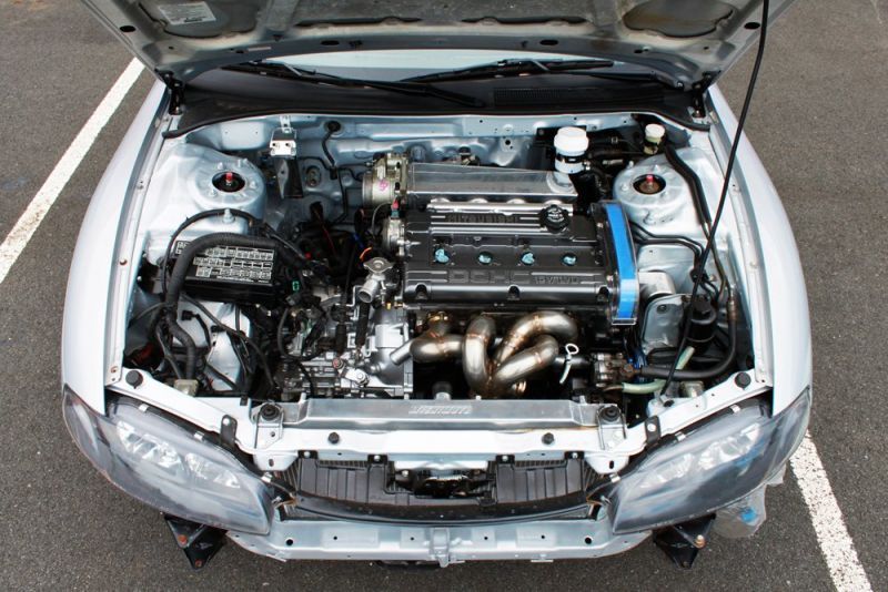

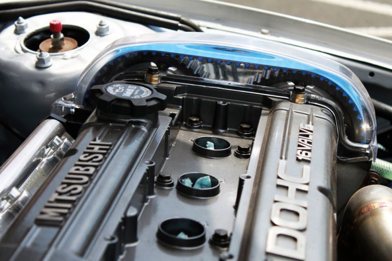

1.Fully Built 6 Bolt motor 2.3L
2.Updating interior (repainting, cleaning, and refreshing panels, and metal pieces. Black carpet,Micro Sued black headliner)
3.Weight Reduction/ Roll Bar, Harness
4.Battery relocation to the truck
5.Engine bay resprayed OEM silver
Color Scheme: Black, Gunmetal, OEM silver
Block: Fully balanced (6Bolt head and block)
-Wiseco 1400 HD .20 Over stroker Pistons 9.1:0
-Maperformance Ultimate DutyBillet Steel Rods (cryotreated)
-ARP Headstuds
-ARP Main Studs
-Felpro MLS Headgasket
-ACL Race Bearings
-Kiggly Girdle
-Manley 100mm crank
-BSEK
-OEM oil pan, oil pump, water pump
Head:
-FP4 Cams
-Fibanza cam gears
-Kiggly HLA oil Pressure Regulator
- Supertech Valves 1mm over
- Supertech Valve Guides 1mm over
-Supertech Beehive Springs & Retainers

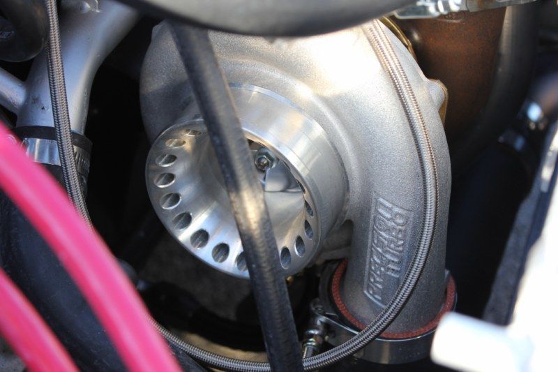

Turbo:
-PTE 6262 T3 .82 AR, FID Vband Manifold customer downpipe.
- JM Fabrications Race SMIM
-Turbosmart wasgate, BOV
-CSRacing 4" Core Customer piping wrinkle black powder coat
-Customer 3" exhaust
Drivetrain:
-Quarter Master Twin Clutch W/ Map flywheel and Fork
-OEM Trans, T-Case, Stock rear diff
-B&M short shifter
- STM shifter plate bushing
-STM cable bushings
-Solid Subframe bushings.
-Avid Motor mounts
Suspension:
-KYB struts and Eibach spring
-Front and Rear sway bars.
Fuel system:
-Walbro 255 pump
-Magnus -10An Rail
-FIC Blue Max 1250cc injectors
-Fuel lab FPR
-93 octane
Interior
-sparco torino seats
-AEM gauges
-HKS turbo timer
Tuning: DSM link

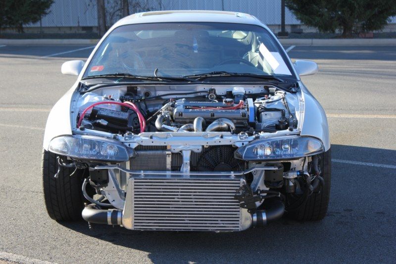

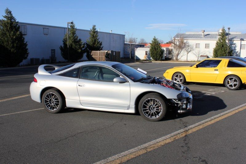

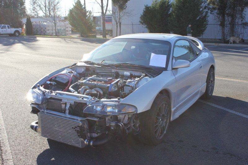

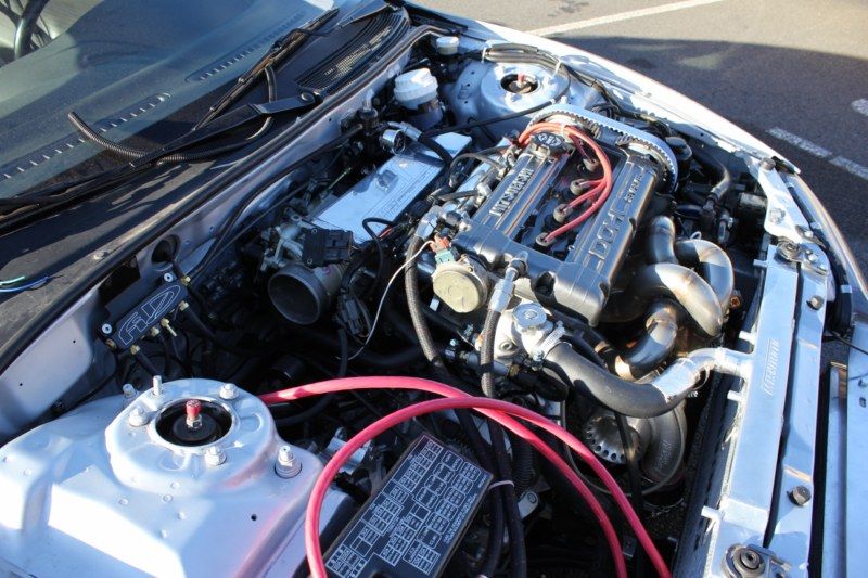

well here she is
97 gsx shell
-silver/grey full interior/power everything/sun roof
-Bear big break kit
-AVD 17'Rims
-suspension upgrade
-Let the Build begin****

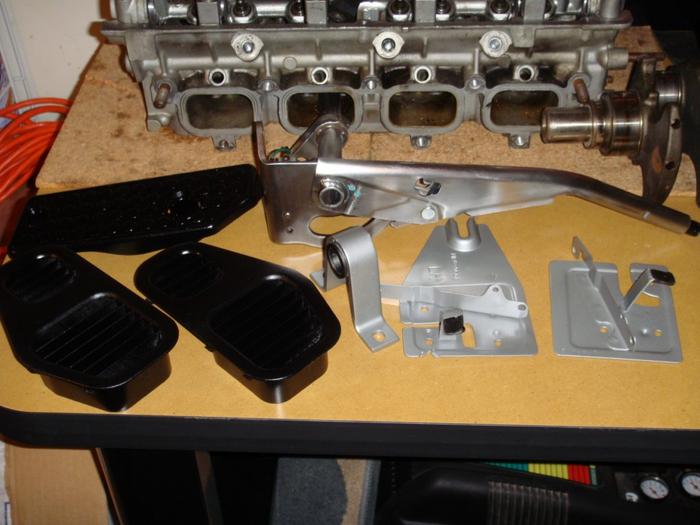

Hey guys thought i give you an update haven't had much time to work on the bullet; but what i have gotten done i'm happy with :)

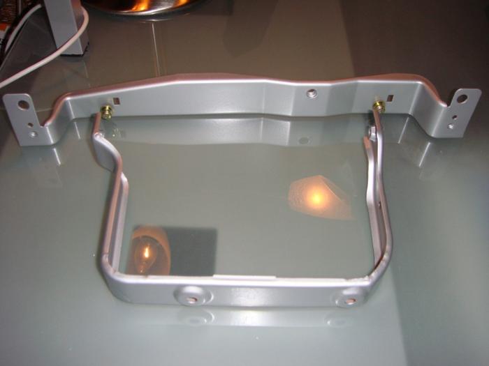

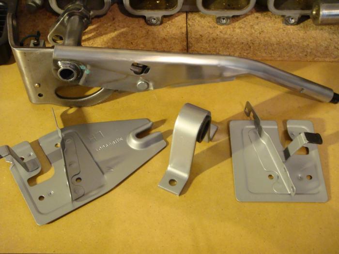

a lot of the interior metal pieces were rusted and i couldn't stand it so i sanded them down and re sprayed them.:thumb:
also i have refresh a couple of my interior plastic pieces thanks to DSM_PWR DIY write up in his build..:D

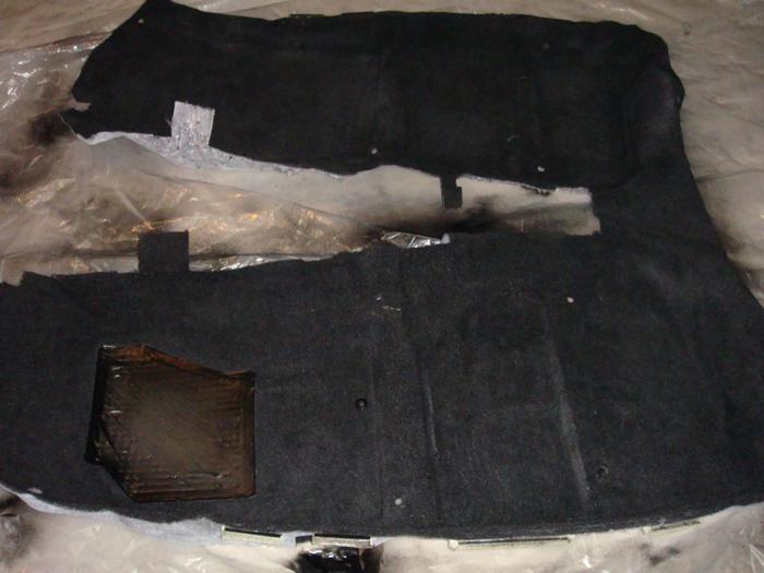

4.cleaning my carpet and respraying it black.. DSM_PWR that zep high traffic works amazing

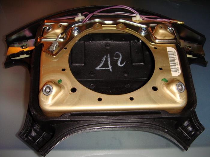

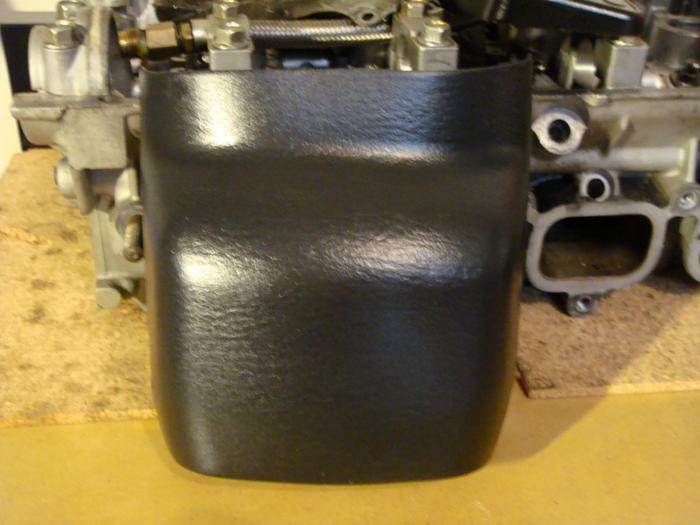

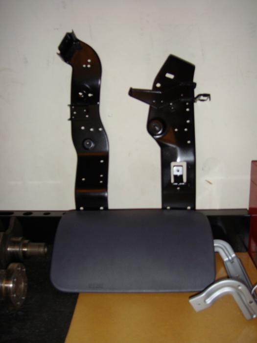

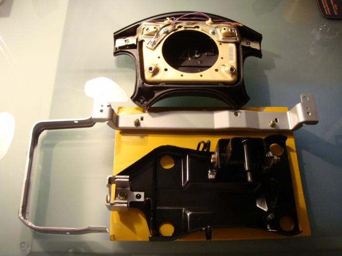

Thought i give you guys an update on my interior refreshing project...
1. Driver side airbag removed

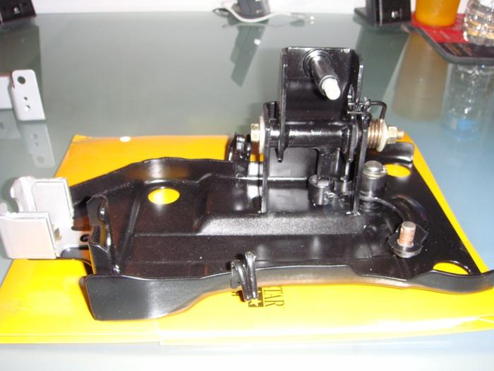

2. Shift plate resprayed black
3.two other random interior pieces that were fairly rusted
:) let me know what you think

update as of 11/9/09
1passenger air bag delet,
2. pillars behind radio cleaned and repsrayed black
3.random interior piece resprayed silver

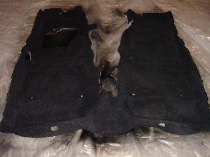

Idk about spray painting carpet. It definitely won't be a natural carpet feel anymore.
i had the same thought, and when it drys its a lil rough but i just took a clean dust pan brush and wiped the carpet down. now its almost as smooth as it was before i painted it..
plus i rarely ever bend down and feel my carpet..LOL

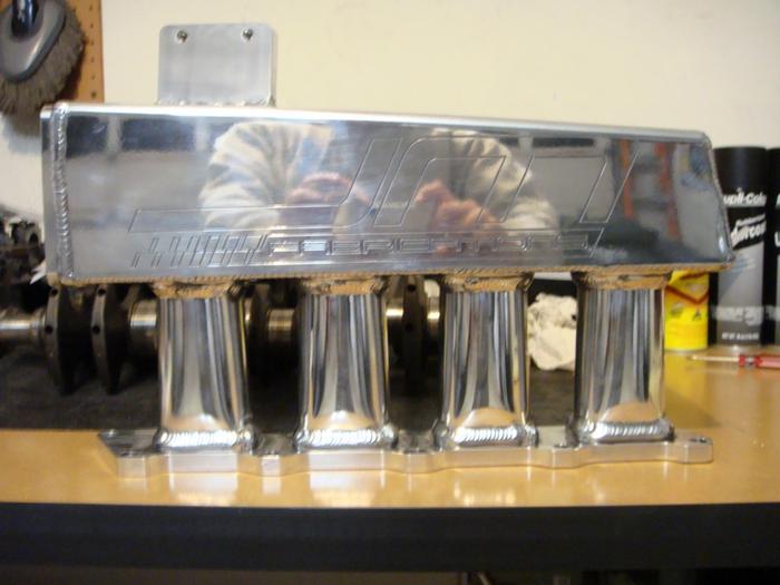

Christmas came early guys, and girls
just made my big purchase for the winter..
- JMF RACE SMIM from JNZ tuning, after talking with the guys couldnt be happier with my purchase

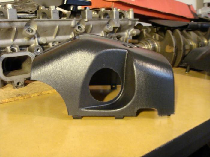

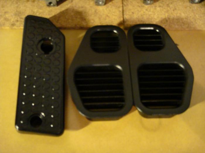

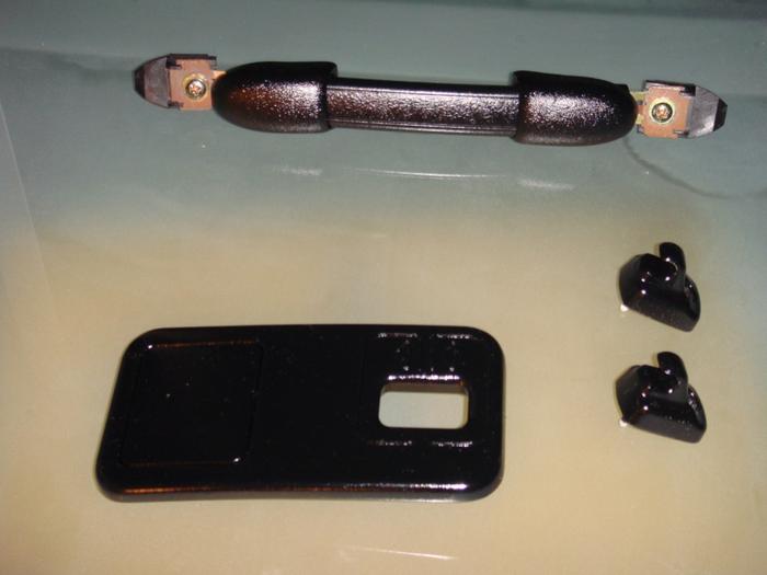

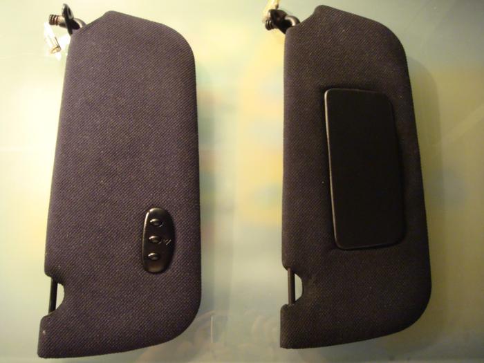

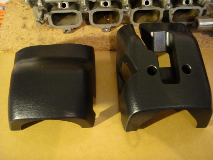

*interior updates*
well my theme for the interior is mostly black, and while redoing my headliner i found out that some of the oem interior pieces only come in grey.. ect the oh shit handle bar, visor clips, and sunroof plate....... :hmm:
well that's not going to work for me, so i decided to respray some of the interior pieces black.:thumb
-i think they came out well let me know what you think??

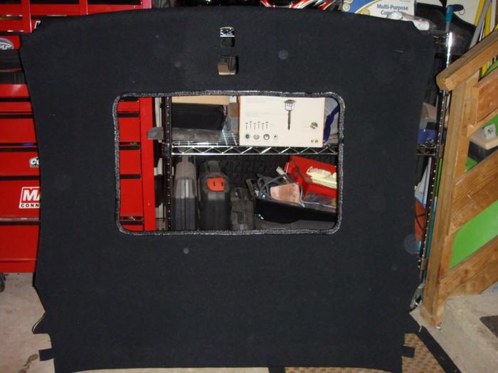

as far as the headliner i ended up not going with the micro suede since i couldnt justify paying the price, or find any with enough backing on it to give me a clean install.. so instead i had my headliner, and visor's done in knitted black material.
its the same stuff used in the 2010 Acura MDX, and TLX's enjoy the pics :)
