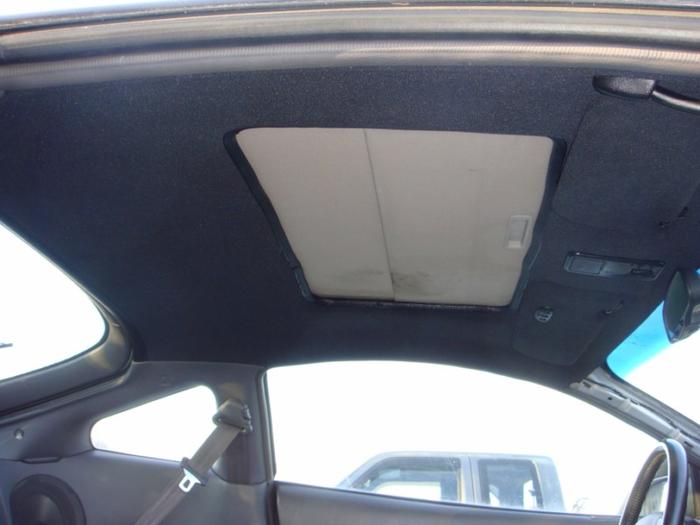

headliner and carpet,

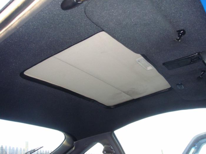

- the headliner and visors are back in

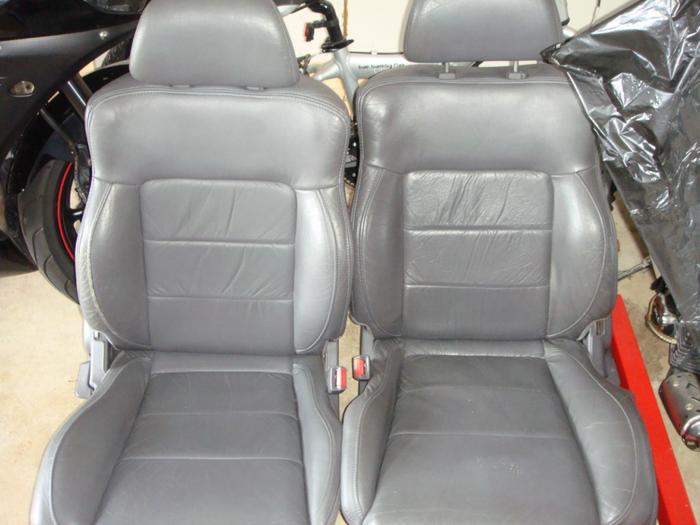

here is my attempt to clean my oem seats.. the seat on the left is the one that has been detailed, the one on the right is next on the chopping block..:thumb:
Drew
What do you mean by detailing? Stains, rips? Is it just me or did you get rid of the wrinkled center section on the backrest?
well first we cleaned the seat with goo be gone to get rid of all the surface grim, then was wash the seat with water to cancel out the chemicals we just put on it.. after that it was my uncles turn, he used this cream chemical residue.
and what that chemical does is make the leather on the seat tighten up, to remove wrinkles and lines plus gives the seats a smooth leather finish like new.. hope that explains any questions

-Finally got the headliner 100% back in, with the side panels

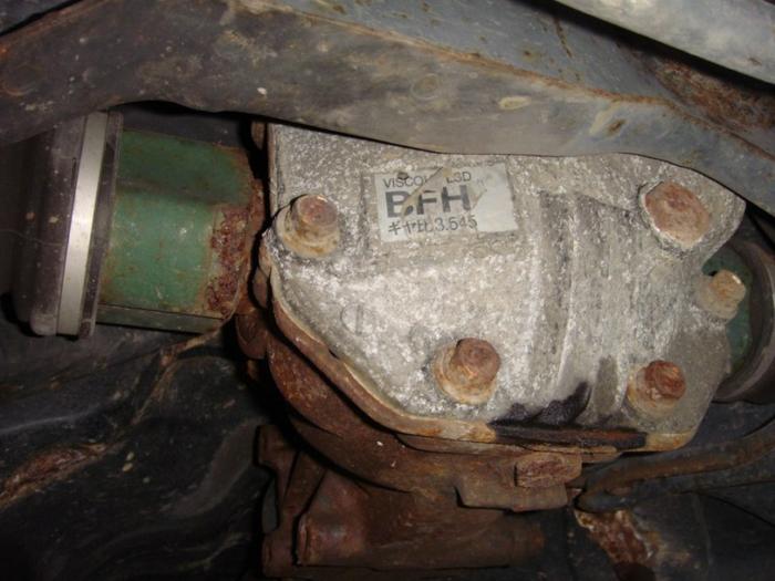

-got under the car and saw i have a vicous lsd :) is this a standard on all gsx's or was it and option???

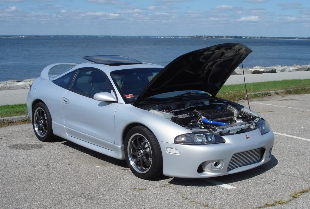

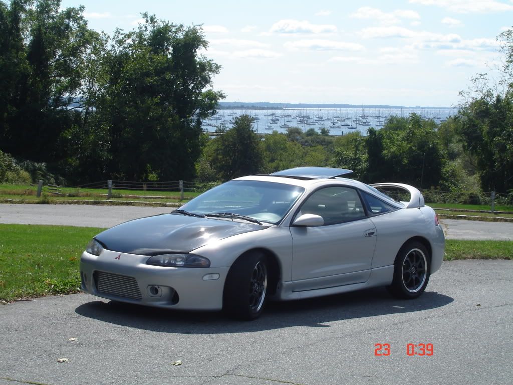

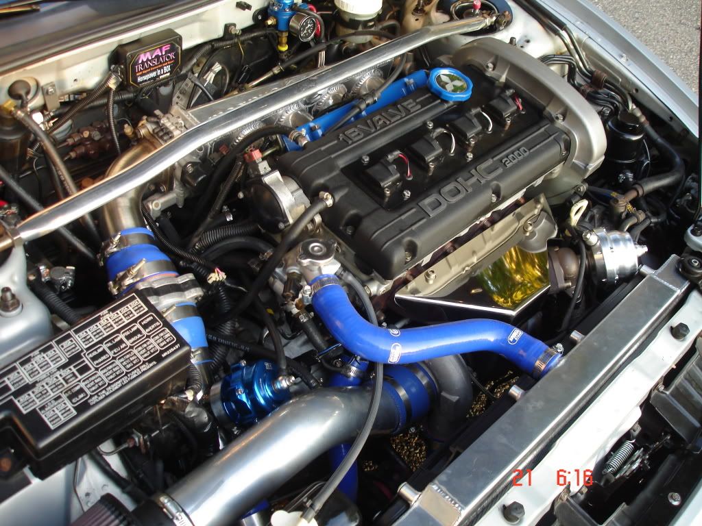

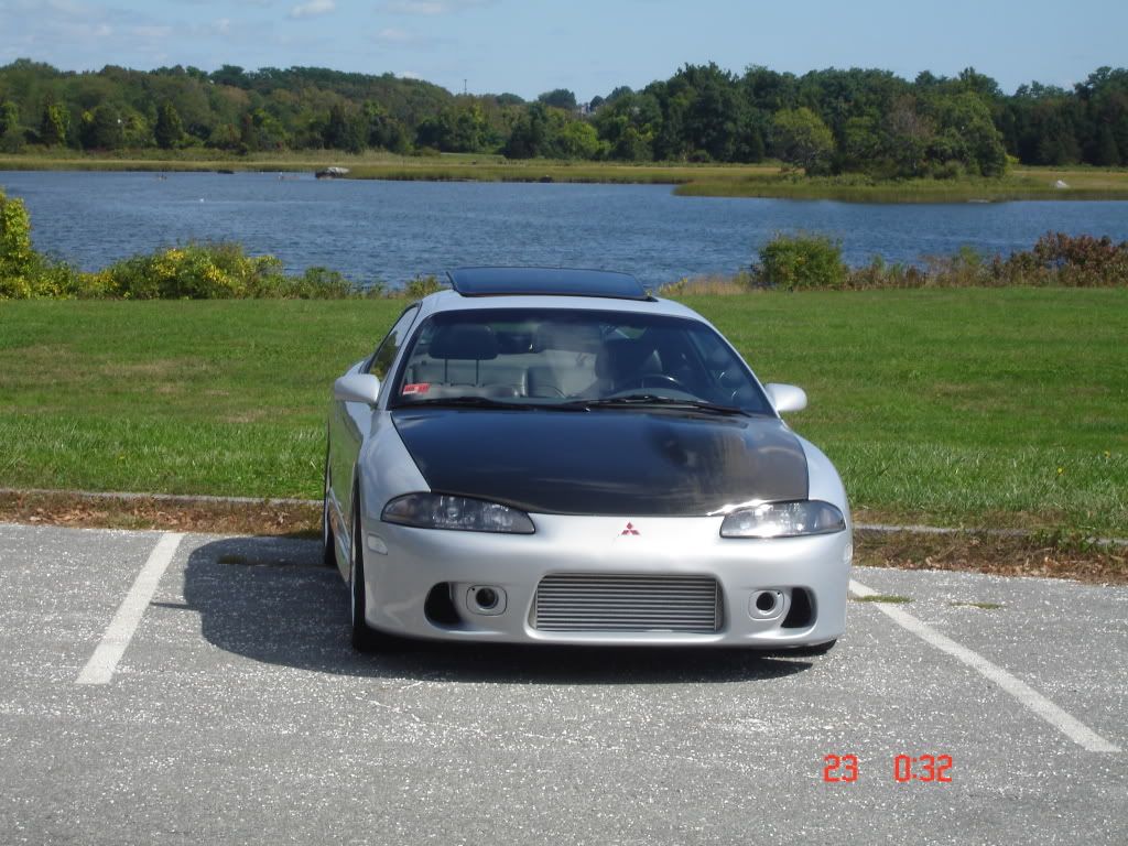

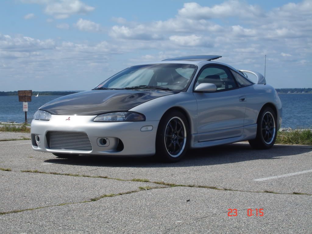

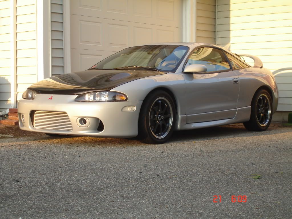

The build is looking great so far. I really like how the head liner and the seats came out! Keep up the great work. The trunk also came out very well. I like you goals for the build, however the only thing I would change is keeping it a 2.0. Here are some pics of the car when I had it, I am posting them up to keep you motivated and setting your expectations high, good luck! Let me know if you need anything
PS, I miss it!!!!
You're one lucky man. I know Brad personally and he was meticulous with that car! It was absolutely perfect. I'm glad it seems like he sold it to someone that will do it right. Good luck with it Andrew.
