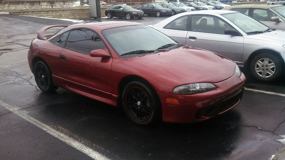

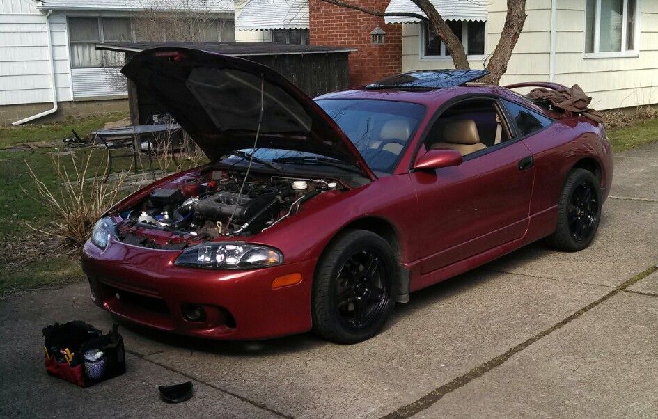

Redid the wheels all black. No more red pin stripe.
Spark Plugs in.
Minor engine bay clean up.
Current Wheels = 17x7.5 with 245/40's +40

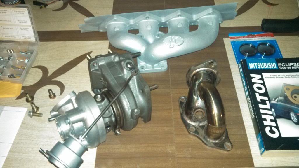

The parts are piling up!
Big thanks to Justin (99ECLIPSEGSXDSM) for helping me with getting her ready.
- FP Manifold
- Megan O2 Housing
- VC Gasket
- MBC
- PCV Valve
- Rebuilt 14b Turbo
- EM Gaskets
- Tubro/O2 Gaskets
- Oil Feed Line

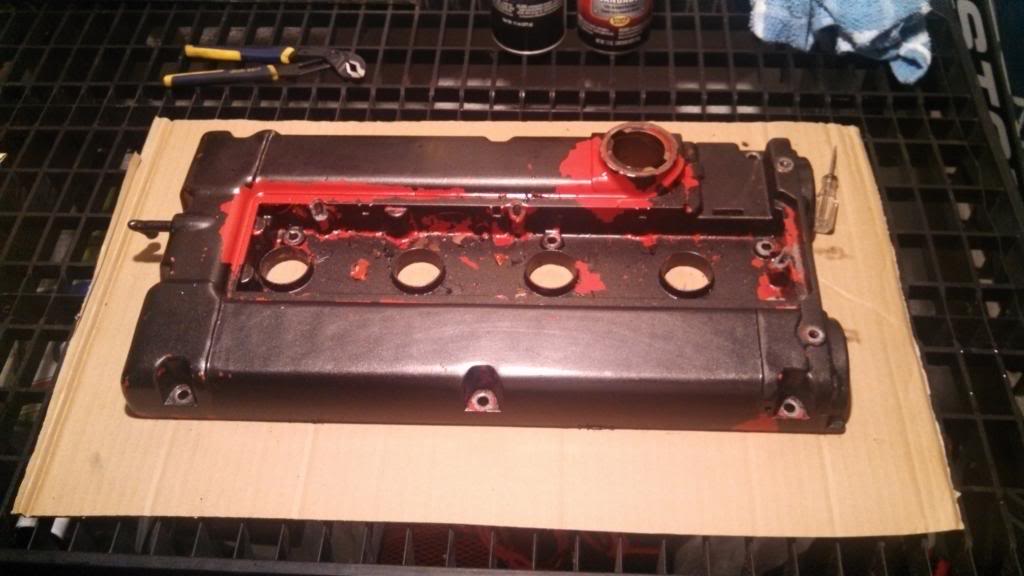

- Shaved VC (will be custom painted)
- New Upper Rad. Hose

Had a big weekend!
Huge thanks to Justin (99ECLIPSEGSXDSM) for all the help/tools/insight/extra hands.

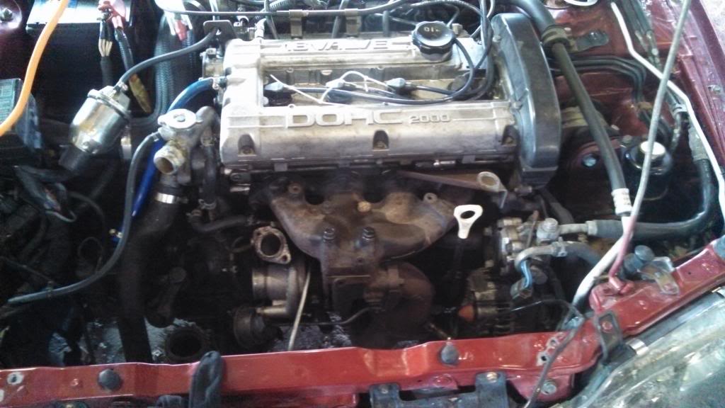

Starting the tear down, it was obvious the PO didnt know and or maybe care about doing things the right way or using the correct parts. He used the wrong sized bolts, had misc. missing washers and gaskets. The oil feed line was about 2 feet longer than it needed to be. Justin and I where very surprised as to how easy everything came off though. :thumb:
We removed:
- Radiator & Upper/Lower Hose
- Intake
- Lower IC piping
- Oil Lines
Old 13g Turbo setup is now out!

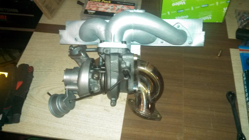

Almost done! Started to button her up.
http://i1259.photobucket.com/albums...B23213E-1533-0000028777FF293E_zps63534799.jpg
Boom! Installed.
Rebuilt 14b Turbo, FP Manifold, Megan O2 Housing. :hellyeah:
http://i1259.photobucket.com/albums...EA7FF26-1533-000002875CCEED43_zps759f3af0.jpg
Justin was expecting 1 leak upon start up and driving, I was expecting 2 leaks. All went great and she dripped maybe two or three drops of coolant! Tightened the lower hose and she has been dry ever since.

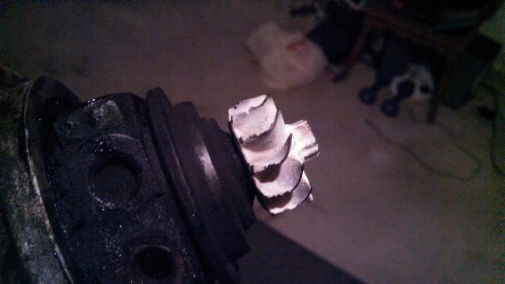

The next day I decided to rip apart the old setup. Found some interesting things!
NO WONDER I wasn't making any boost! :confused: Guess ive been running N/A AWD for a while. LOL
Needless to say, the car is a whole new animal. Going from a cracked/leaky 2g manifold with a blown/ruined 13g to a FP manifold and a rebuild 14b, has been night and day! But dyno says at least 50hp :p Boost is made easy, I can actually hear my turbo spool up and my BOV. Car runs awesome!

What the hell....there's no turbine heat shield on that 13G. Wonder where it went? :confused:
Probably down and out the exhaust. Along with the rest of the small metal chunks. On the old O2 sensor I pulled out. You could scratchs and nicks. Probably from metal hitting it on the way out.
I pulled it apart and was like....WTF...no wonder, after all the boost leak tests, gasket checks, etc....I still couldn't build boost. It all made sense.
