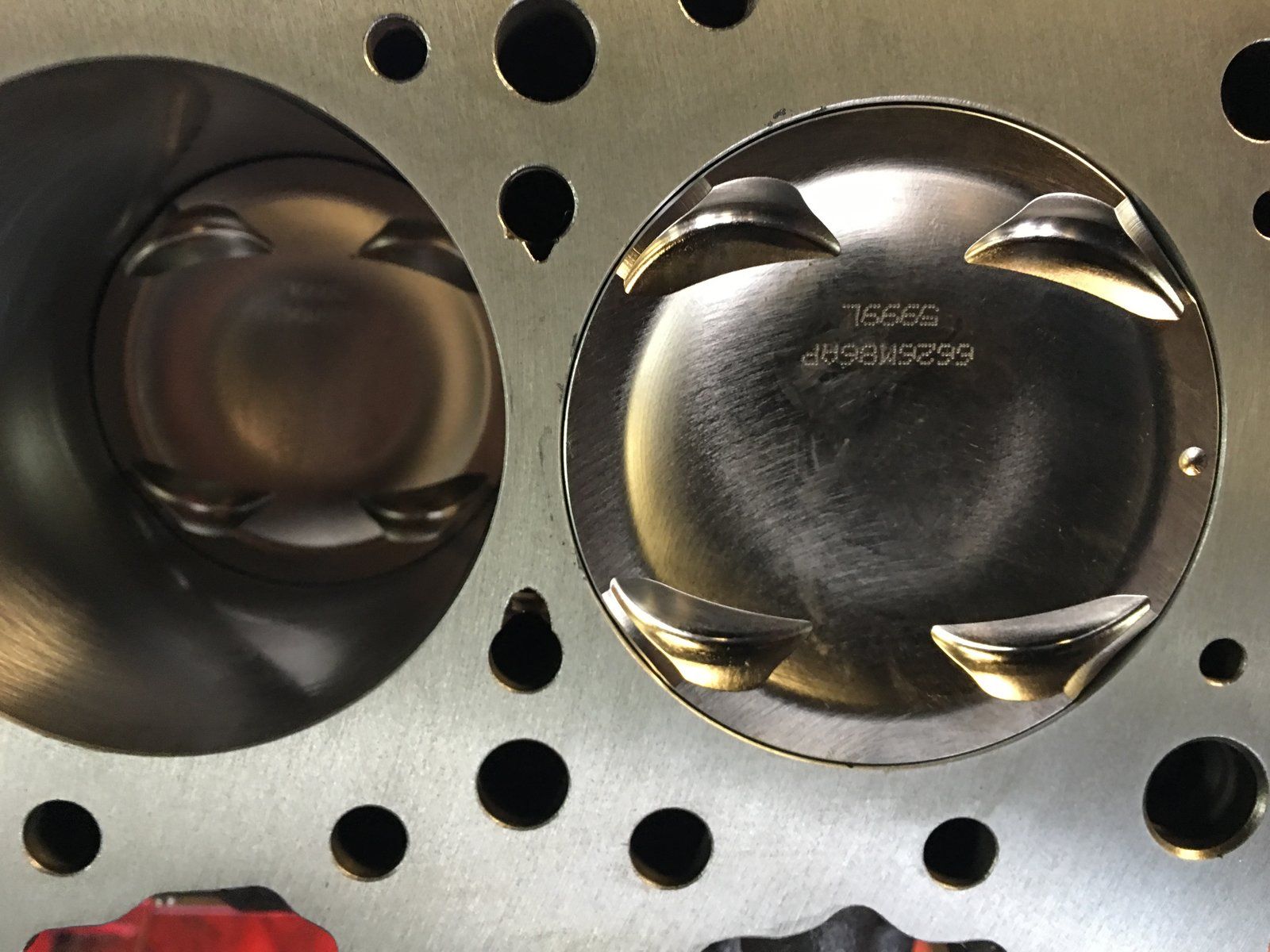

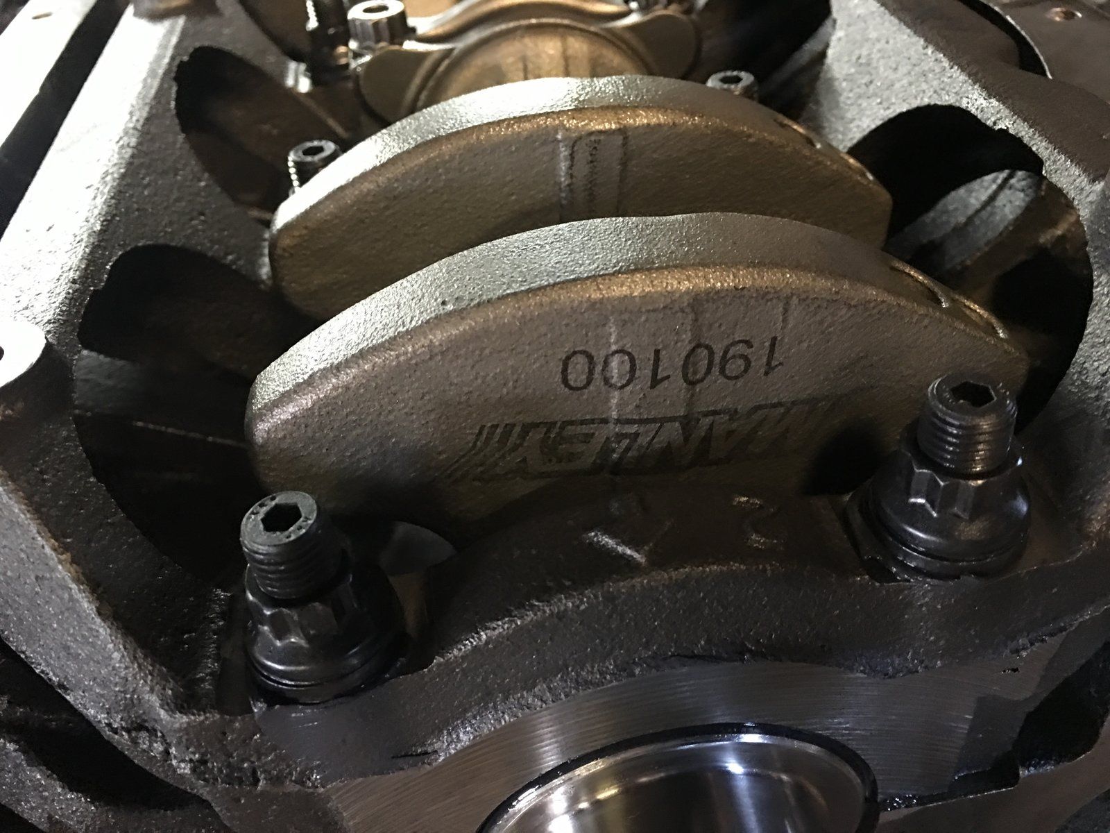

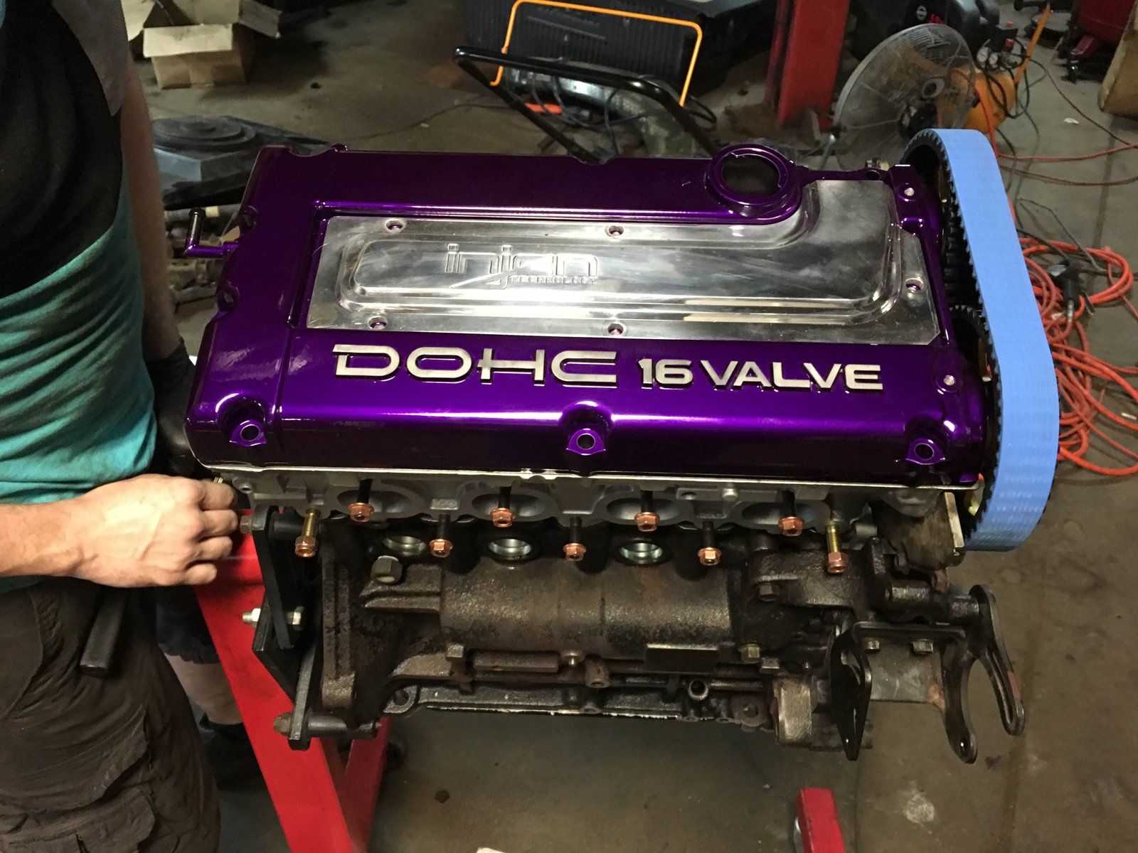

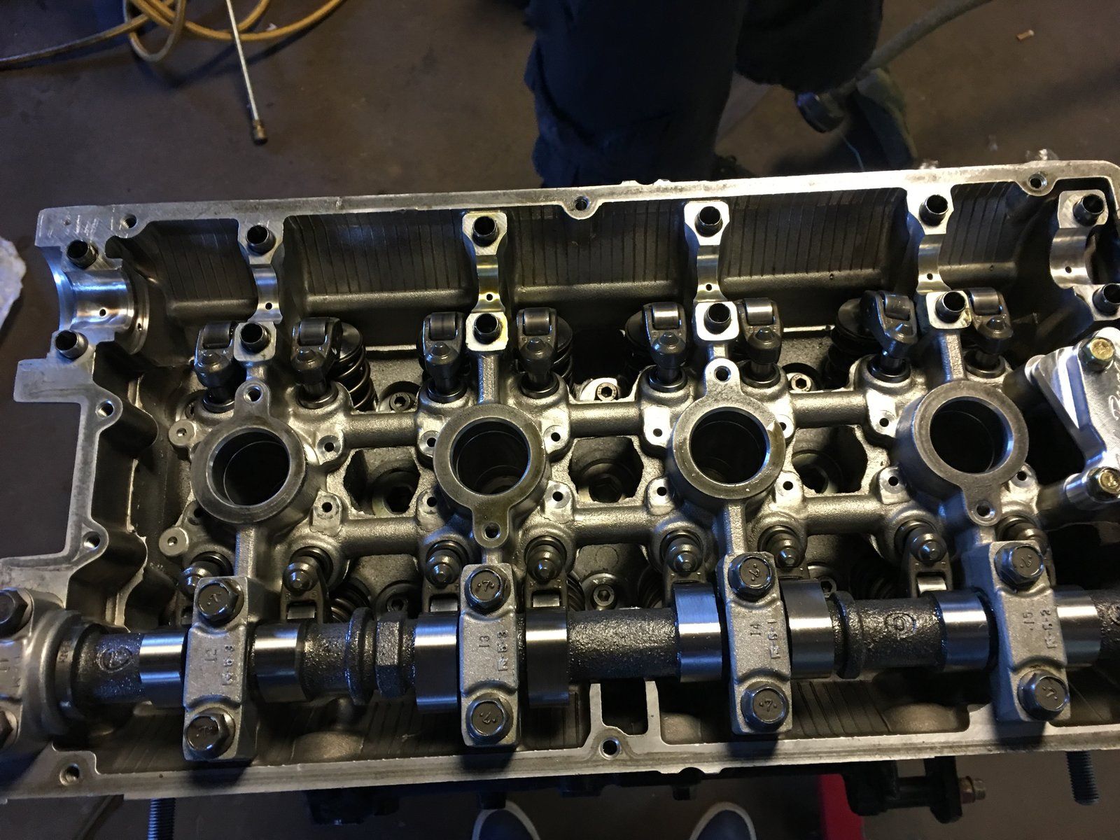

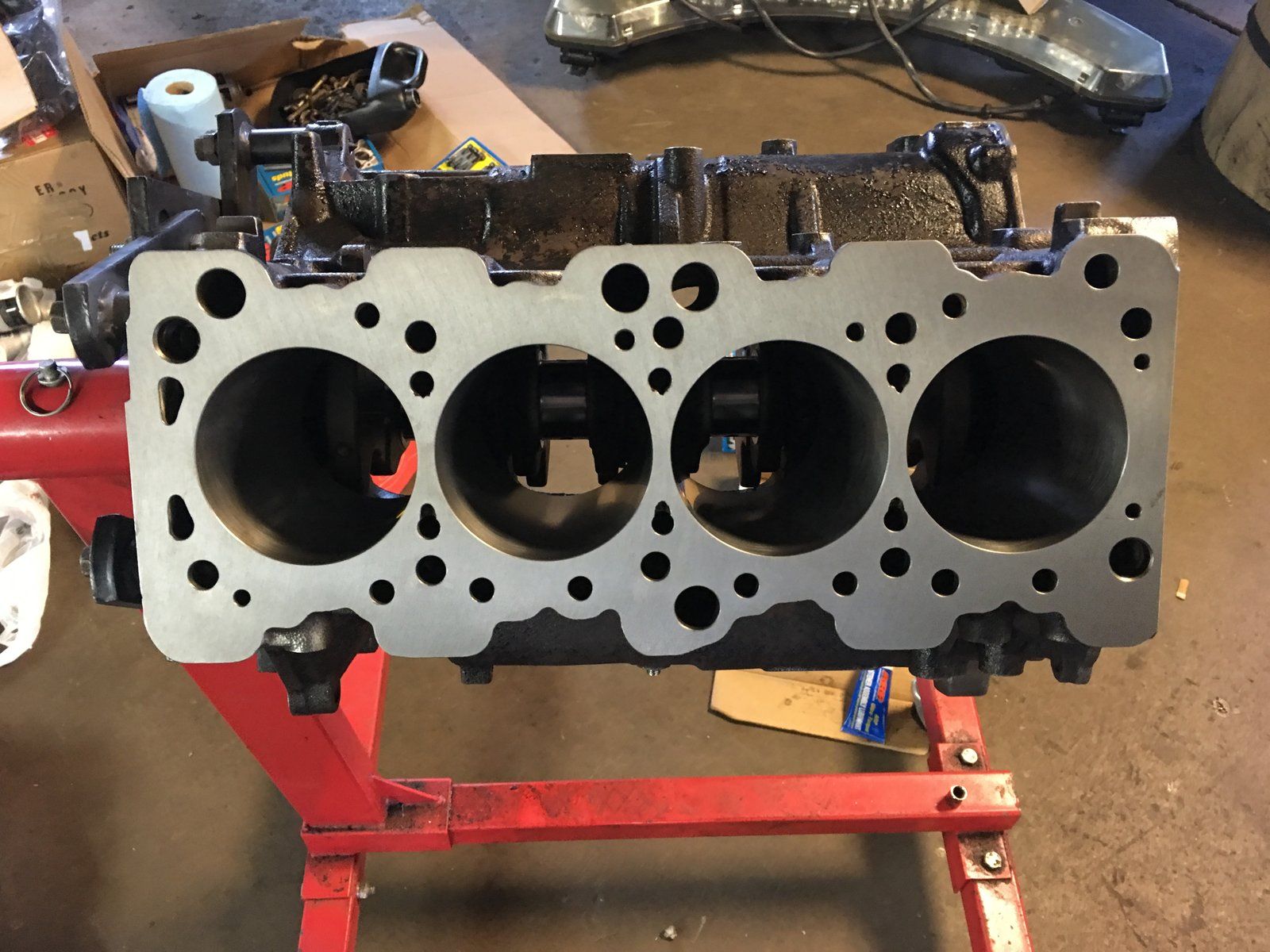

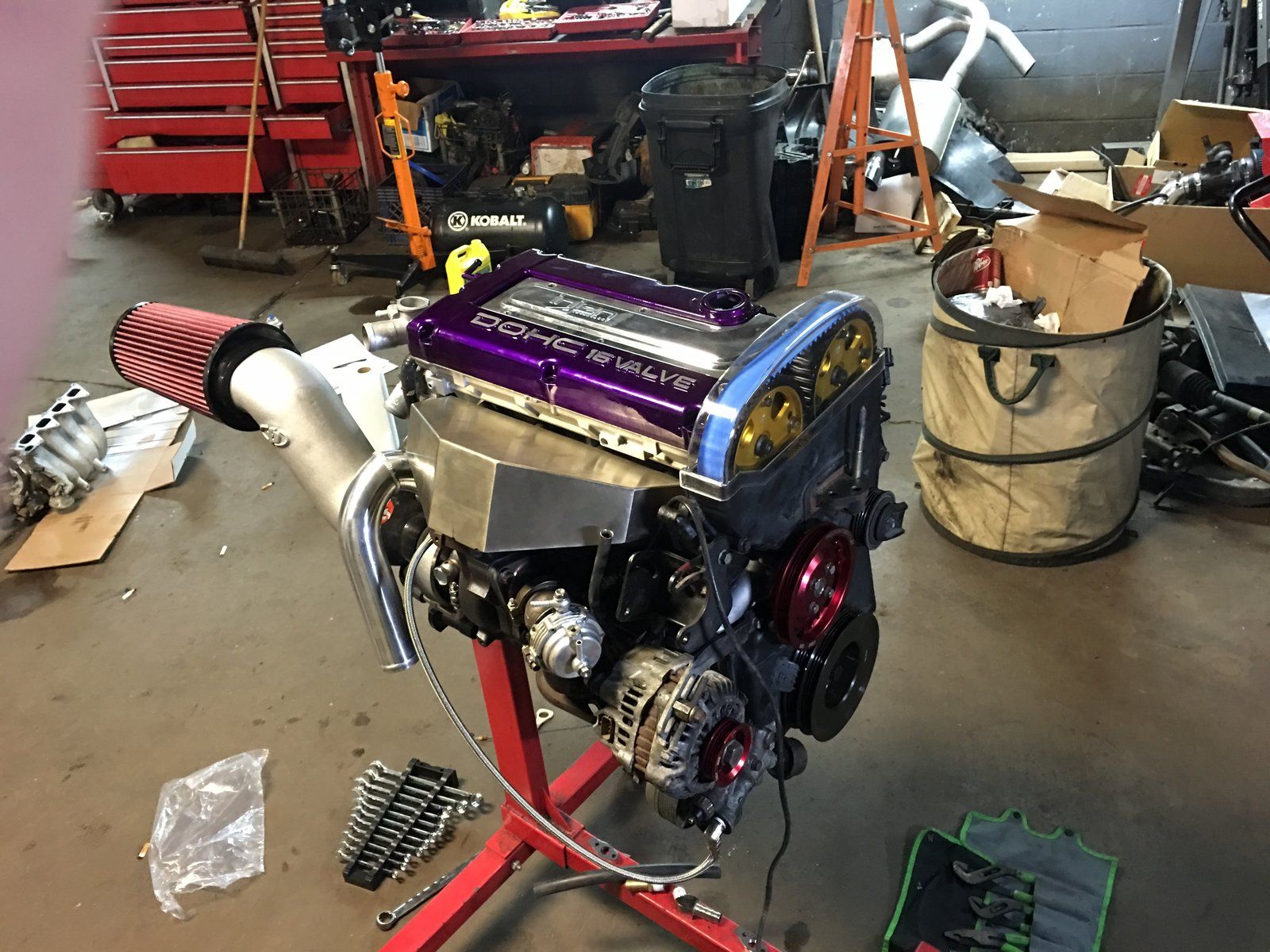

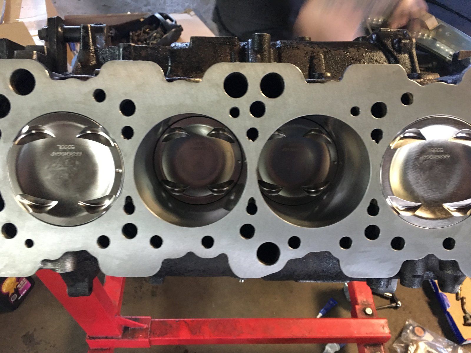

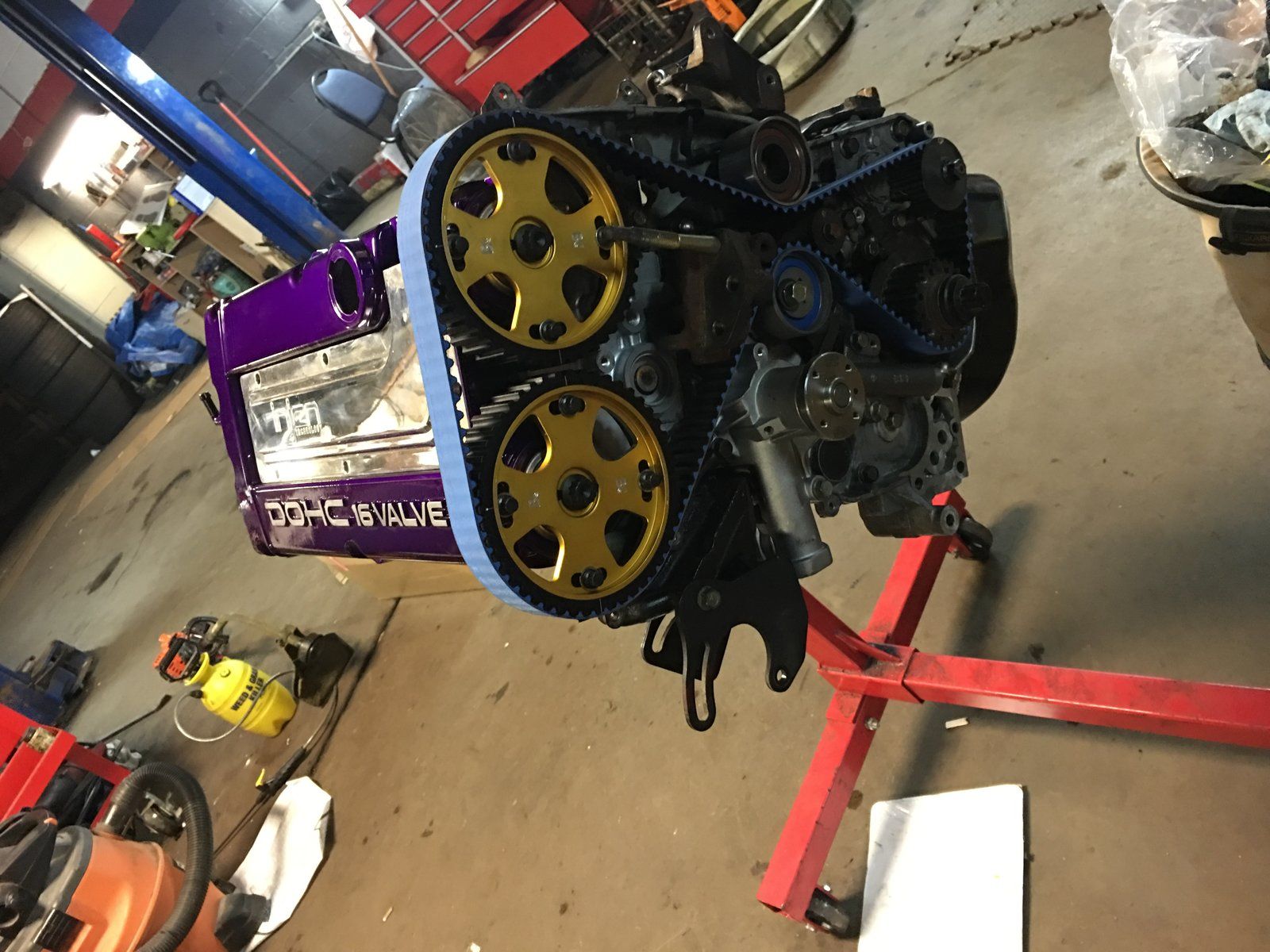

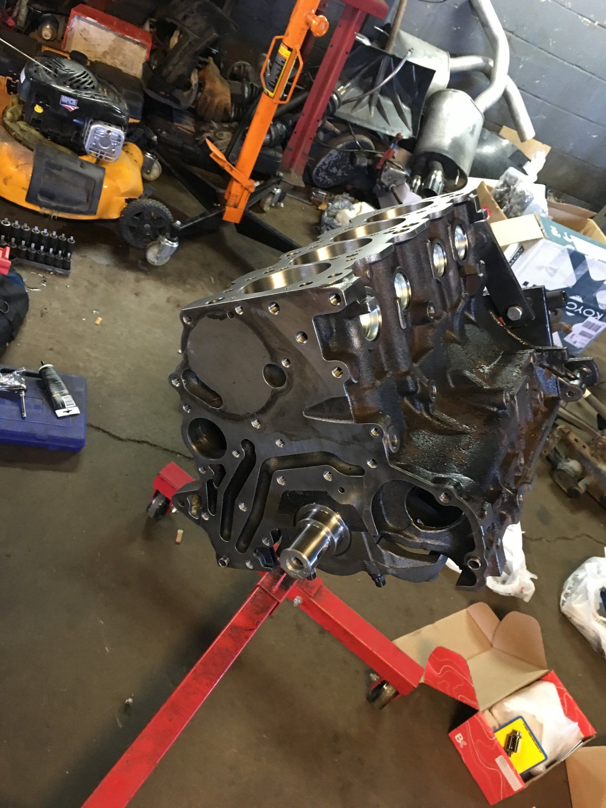

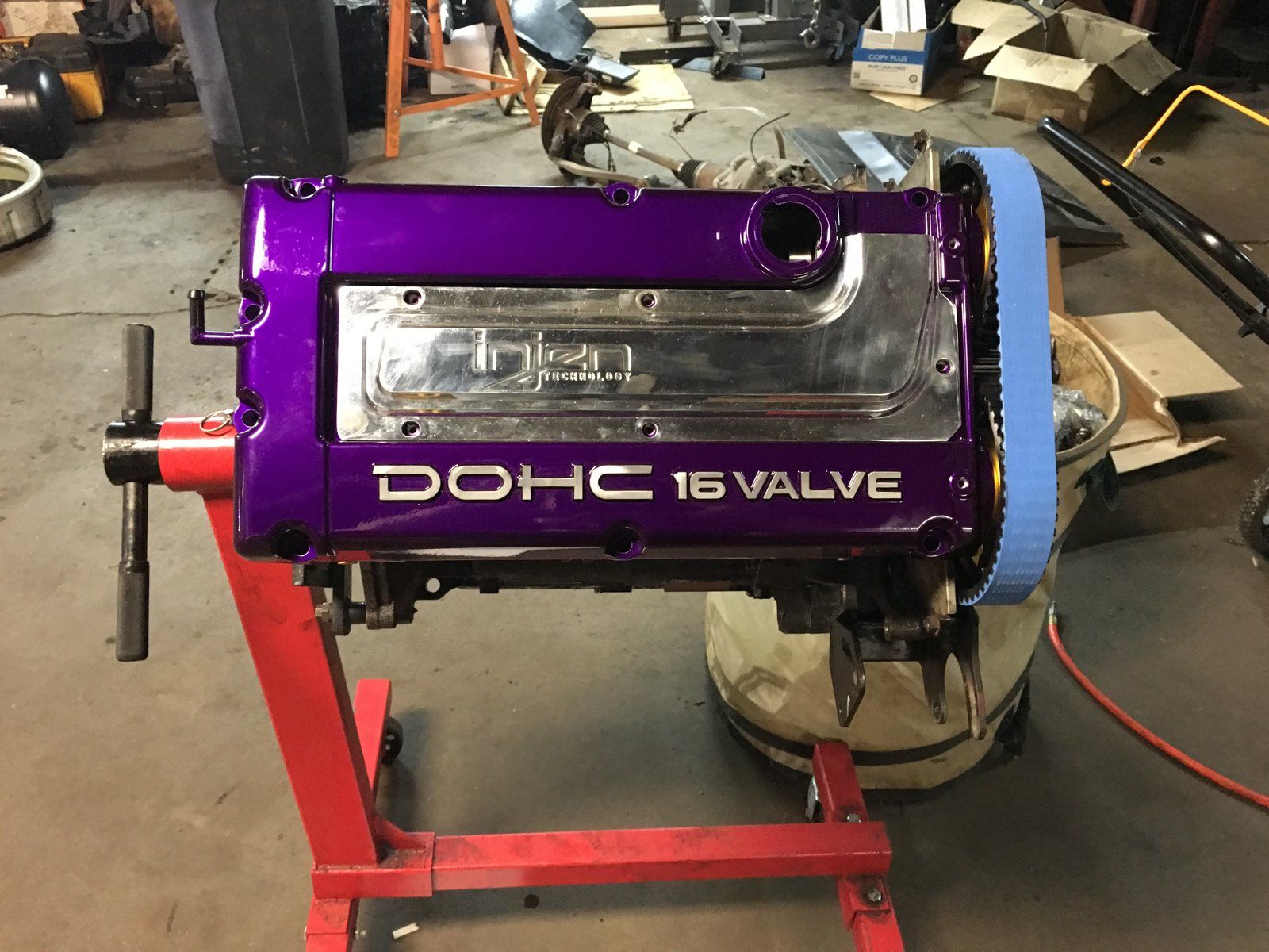

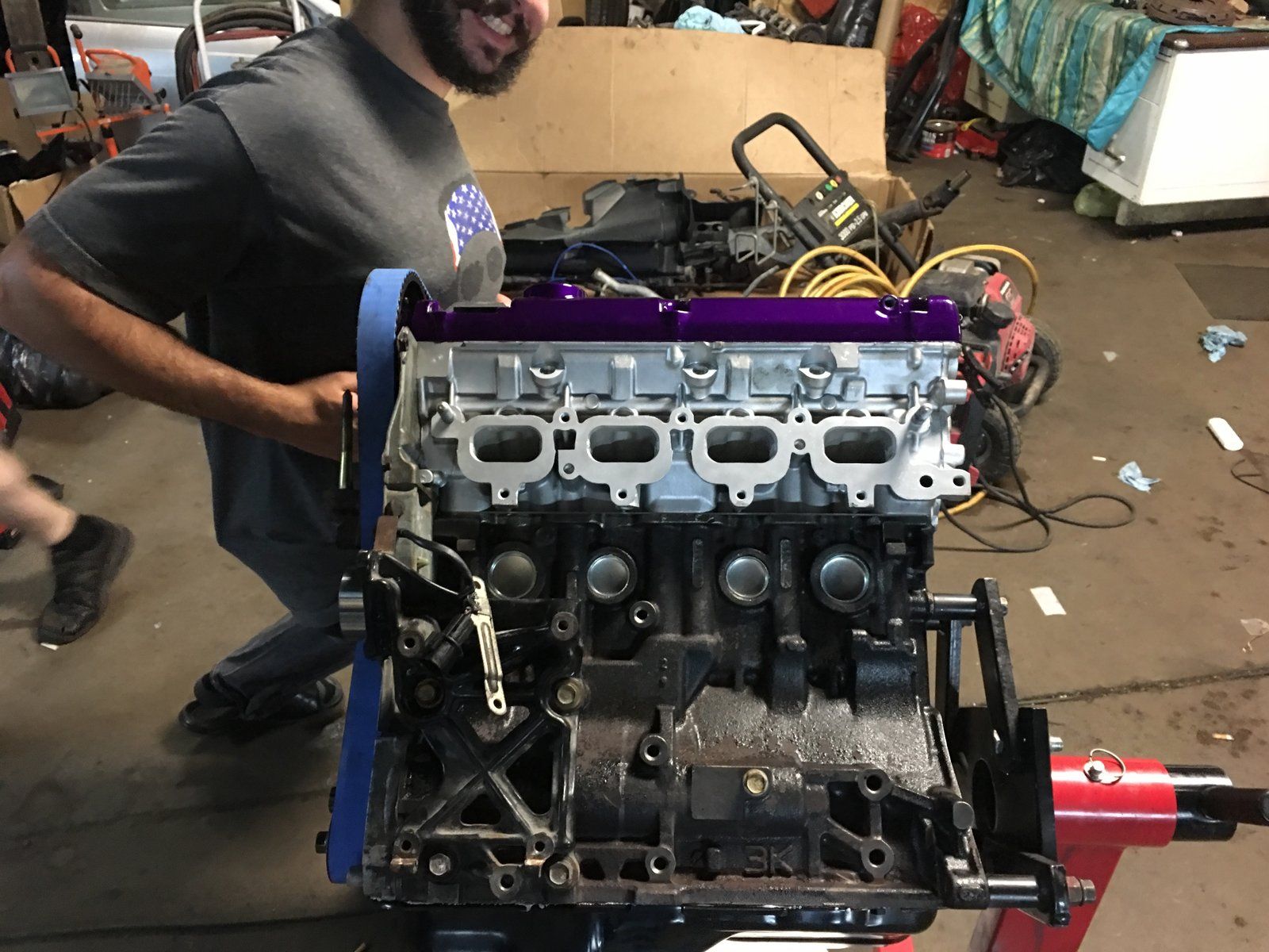

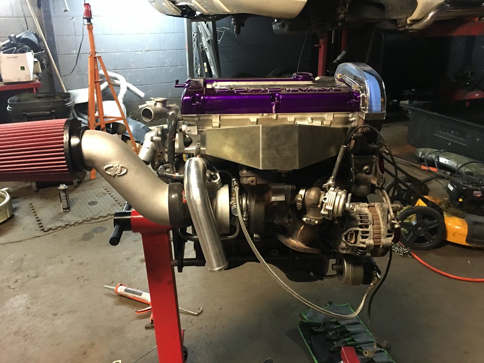

Here's my build I just started assembling the motor

- forced performance 68hta turbo
- punishment racing o2 housing with tial 38mm mvs recirculating wastegate. And springs
- forced performance exhaust manifold
- Extreme psi cover for fp manifold
- apexi n1 catback exhaust
- apexi n1 down pipe
-ngk spark plugs and wires and injen cover
- injen intake used with new filter
Forced performance intake and filter.
- punishment racing intercooler

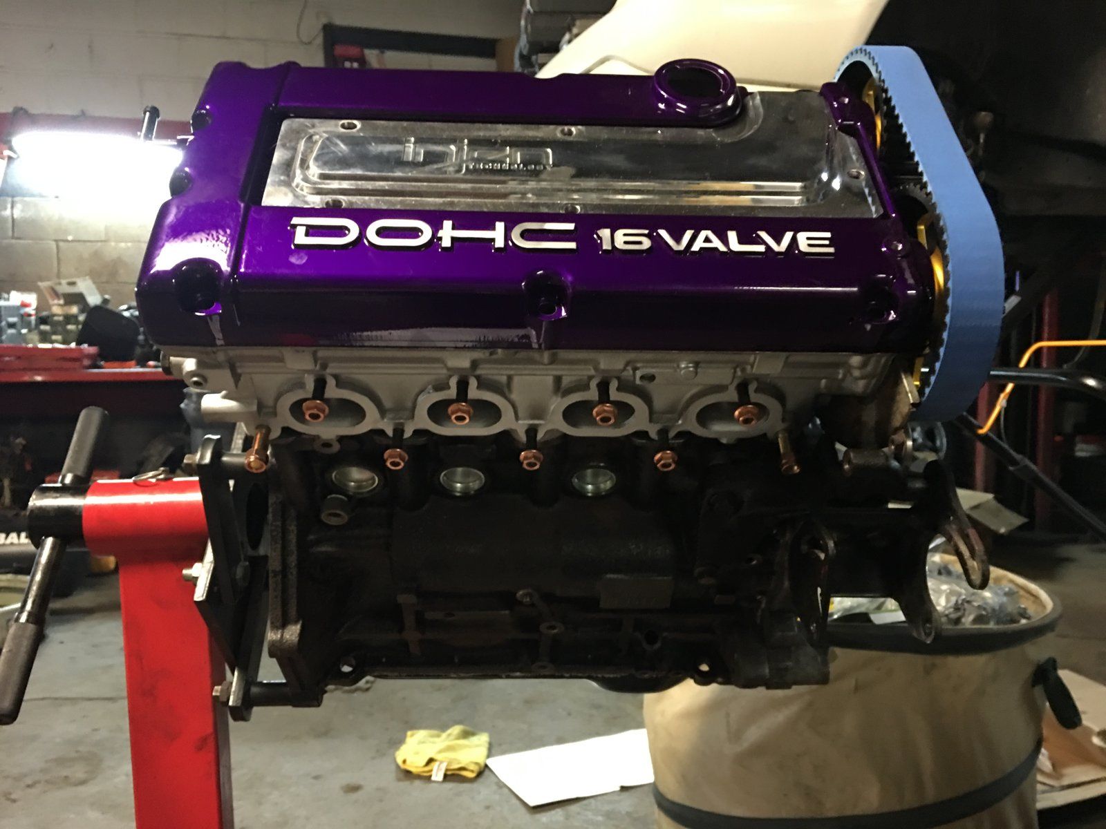

- illusion purple brand new valve cover

Head built
-Kiggly racing hla
-ferrea dual spring kit valve
-ferrea 6000 series valves +1 mm.
-ferrea valves guides, seals, and locks
-Topline 3G revised lifters
-Belts accessory gates.
-Kelford 272/272 cams
-Brian crower cam gears with arp bolts
-clear cam gear cover
-Topline complete engine gaskets
-Freeze plugs

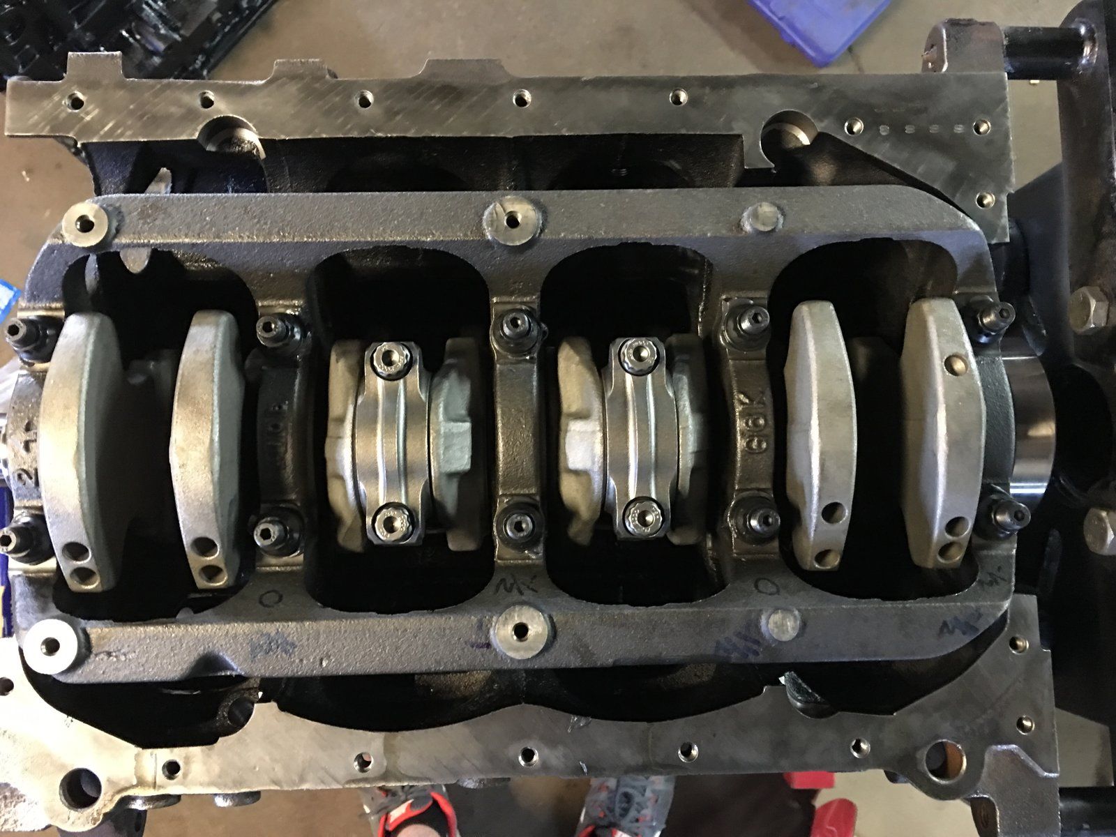

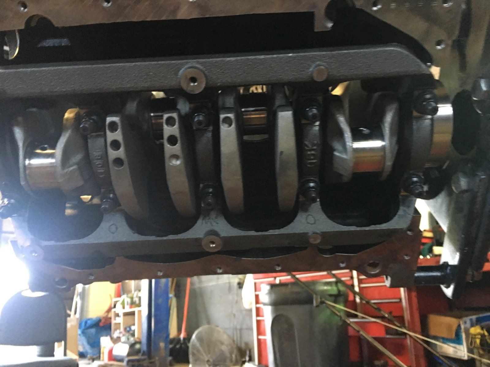

Block built
-balance shaft eliminator kit
- acl rod and main bearings.
-arp main studs
-Manley crankshaft race series 88mm

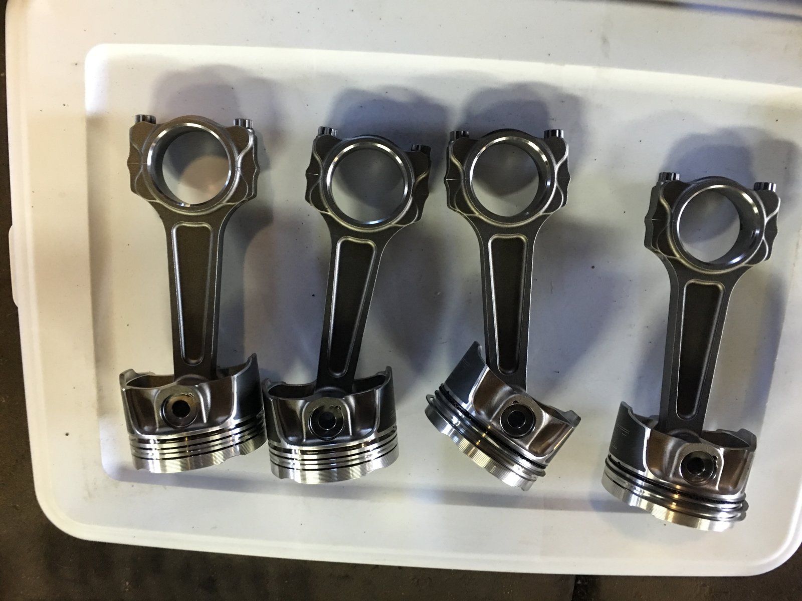

-Manley turbo tuff I beam steel rods

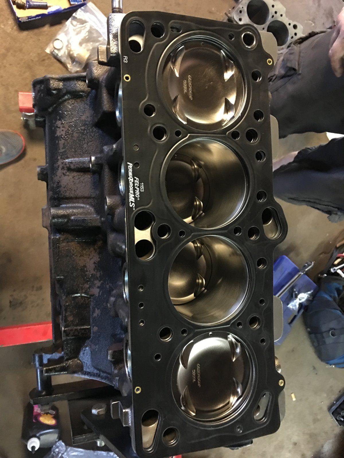

-weisco 1400hd pistons .040 over 8.5:1 8.6:1
-felpro mls head gasket.
