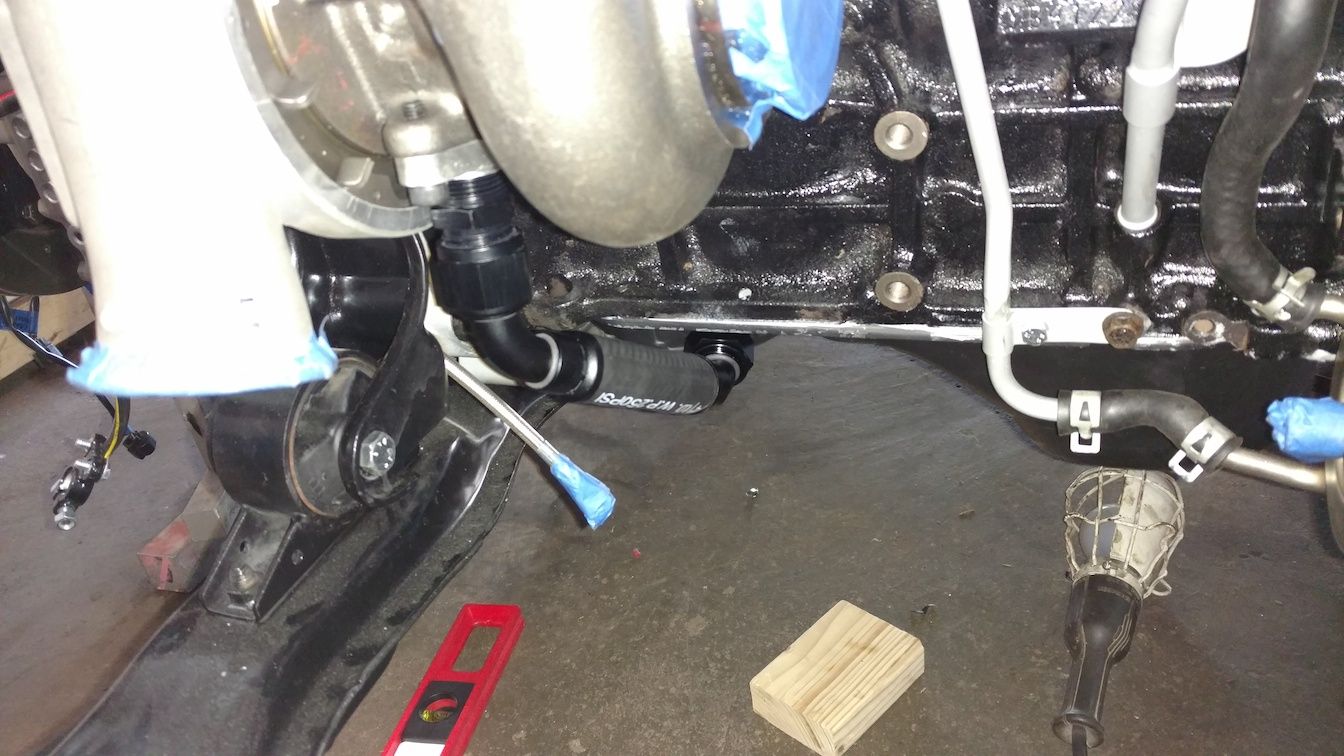

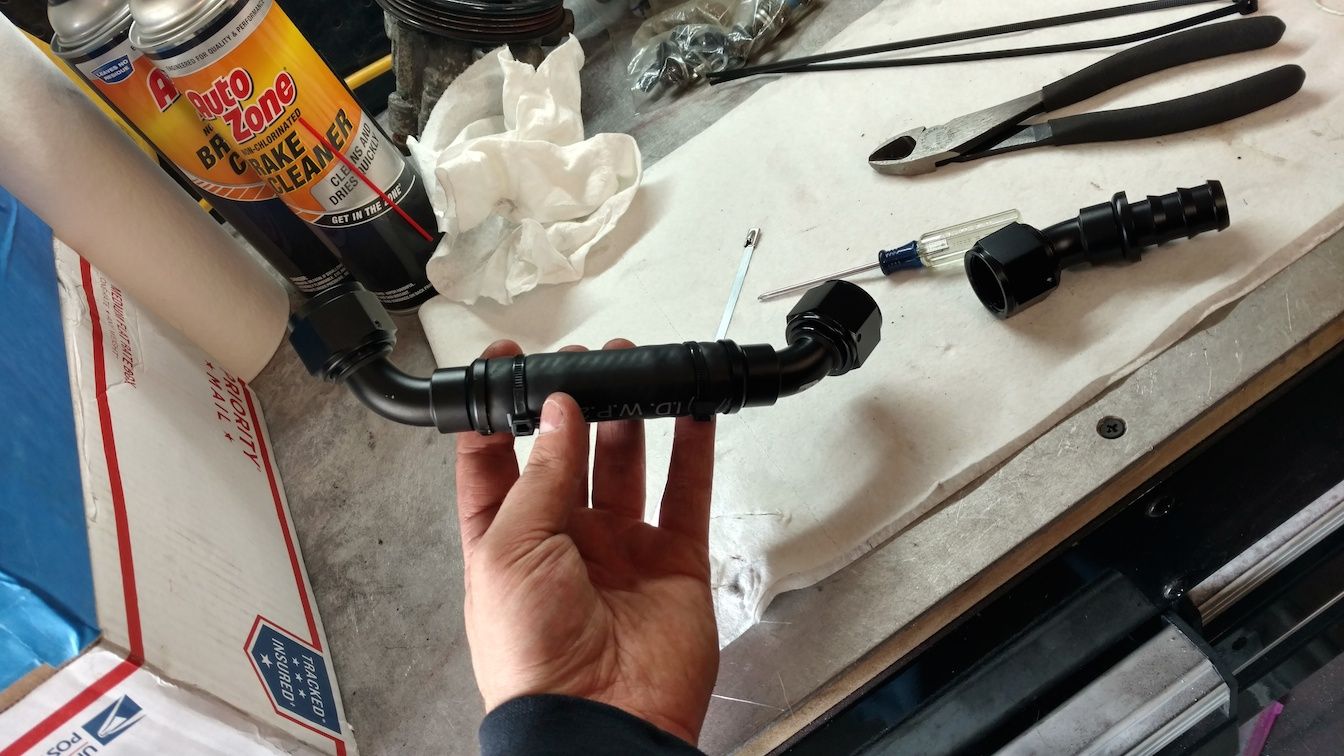

With the motor back in the car it was time to address pluming my turbo oil feed and return lines to the Holset. I ran my feed line from the stock 2g dsm oil filter housing. The turbo drain line consisted of the -12an line I created going into the -12 an bung I welded to the oil pan in the earlier sections of this build.
-12 an line created
Mocked up and clocked the center cartridge so it drains the oil at the right angle

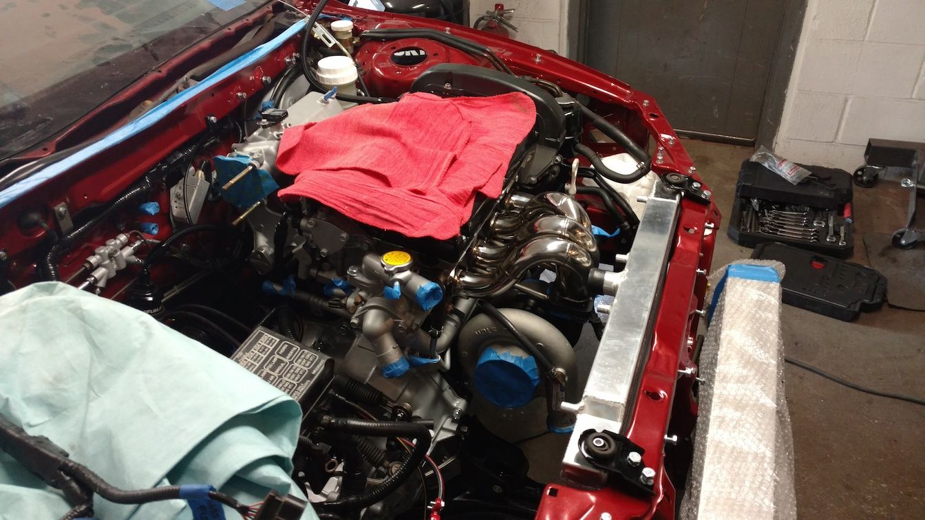

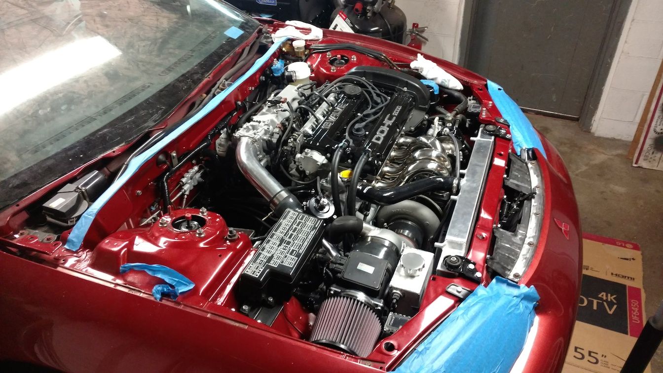

Engine Bay coming along

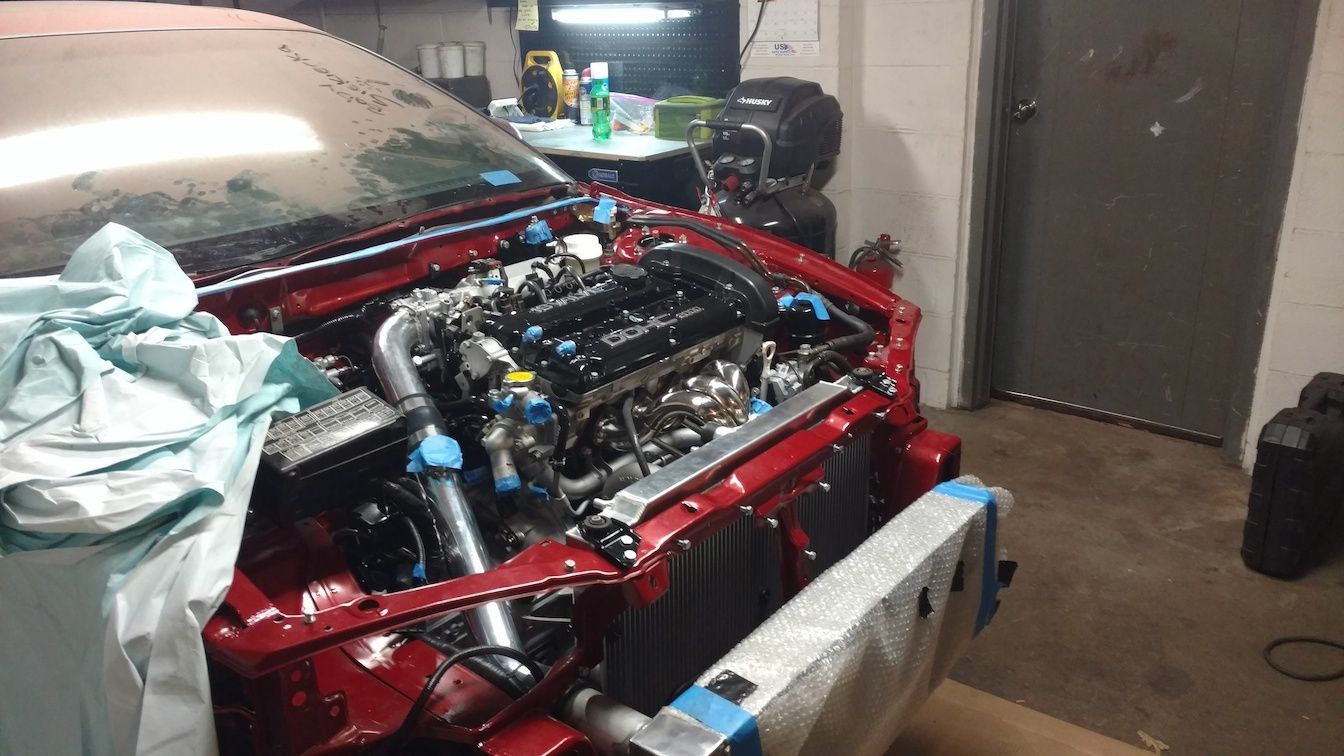

Checking the clearance from the turbo setup to the radiator. Fits just as i thought...NOT. A little tight but it clears. I can only run a single fan on the drivers side. At this stage i was contemplating whether to run a fan setup in front of the radiator to keep temps down. I also went ahead a bolted up the massive intercooler.

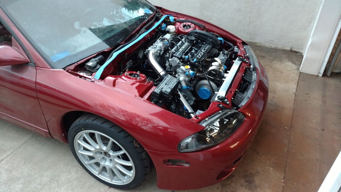

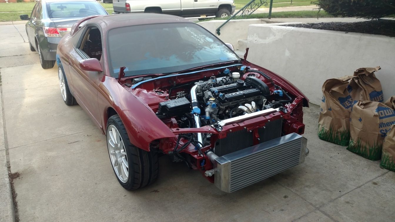

Now with the Turbo in and ready to go i went ahead and installed my intercooler setup.
Finally the vehicle was back on the ground after 4 months.
Got the fenders also bolted up. Now its finally looking like a 2g.

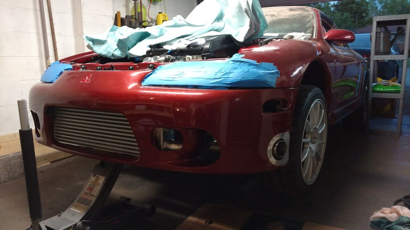

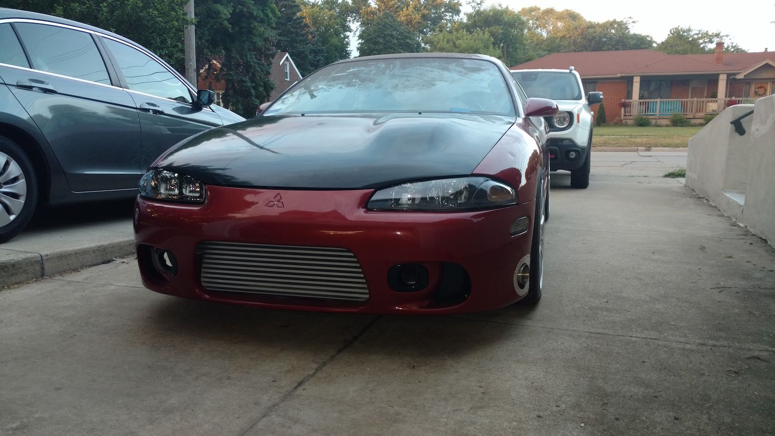

Now with the fenders on i went ahead and mocked up the front bumper. Man was there a lot of cutting and trimming to be able to clear that intercooler. But it was all worth it in the end. Also decided to buy brand new headlights instead of reconditioning the old ones. Cant wait to start driving the car to get rid of that horrible wheel well gap from being on jackstands for the longest time.

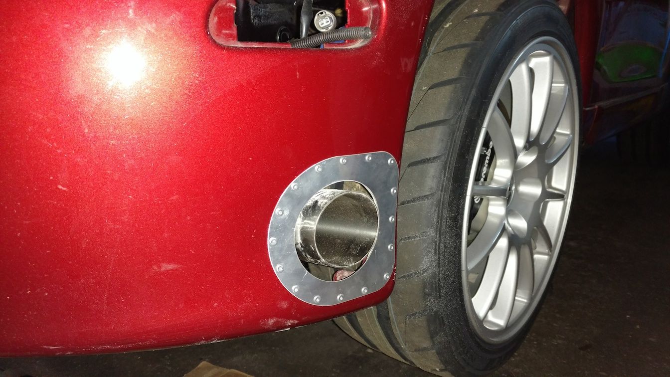

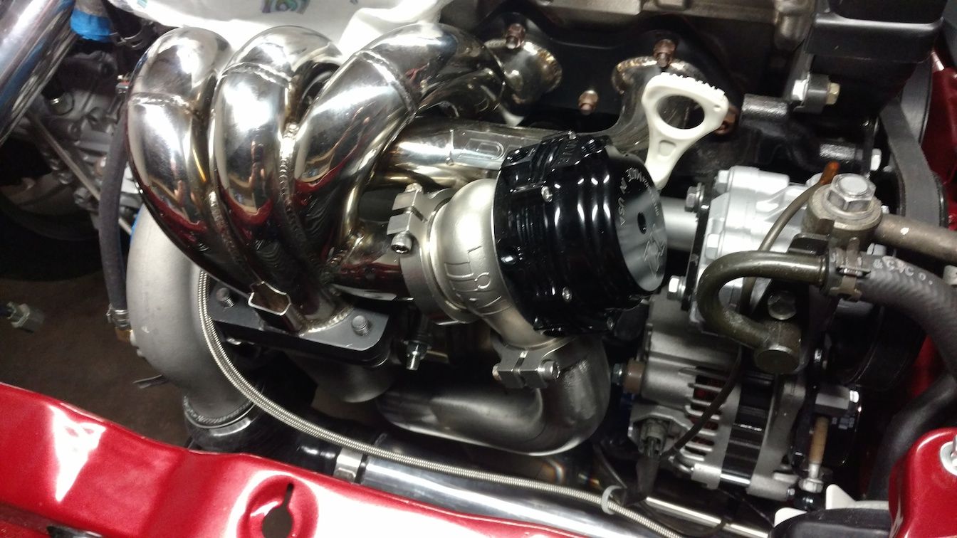

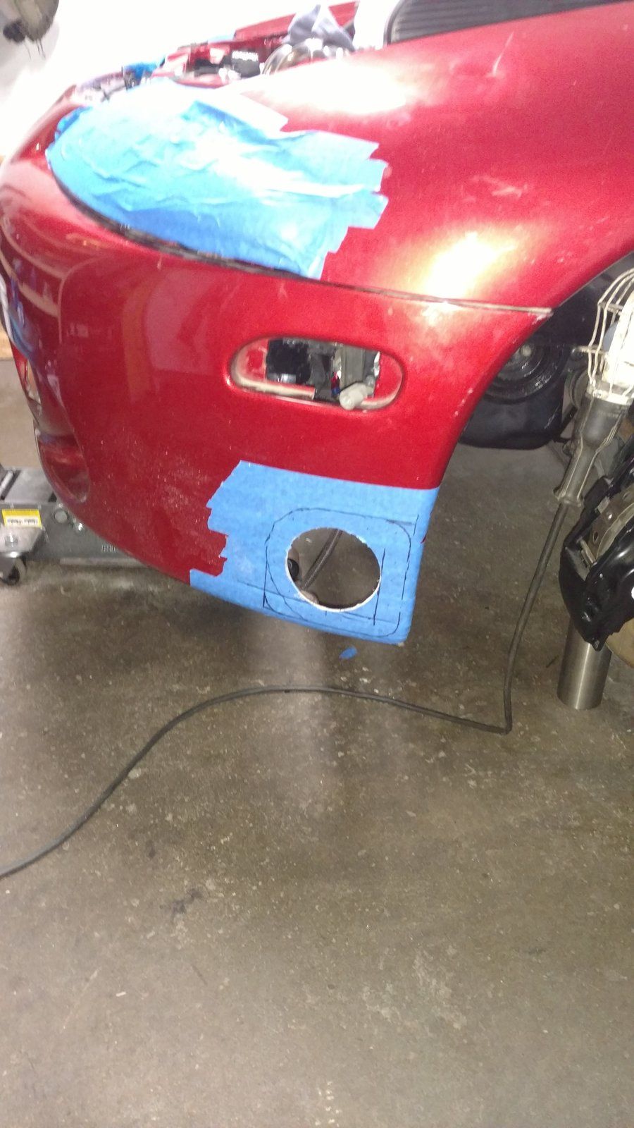

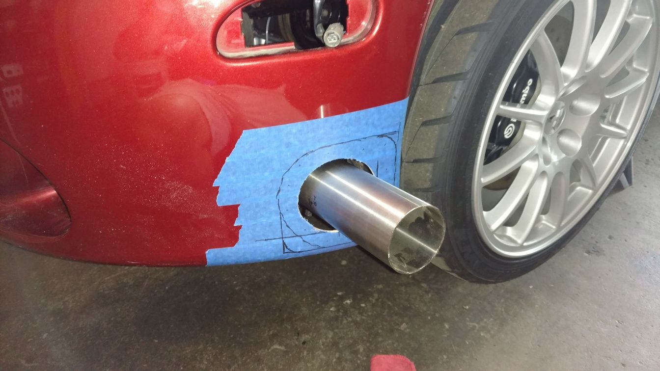

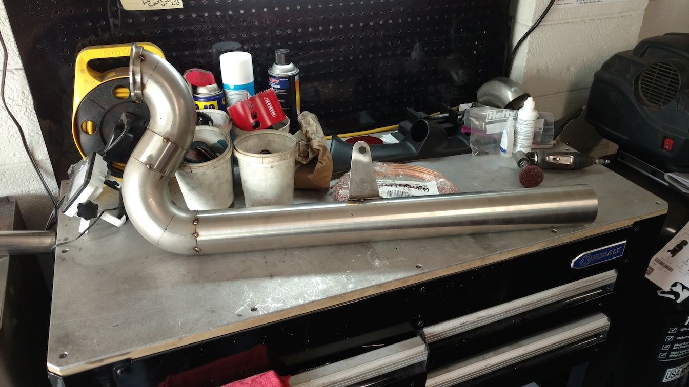

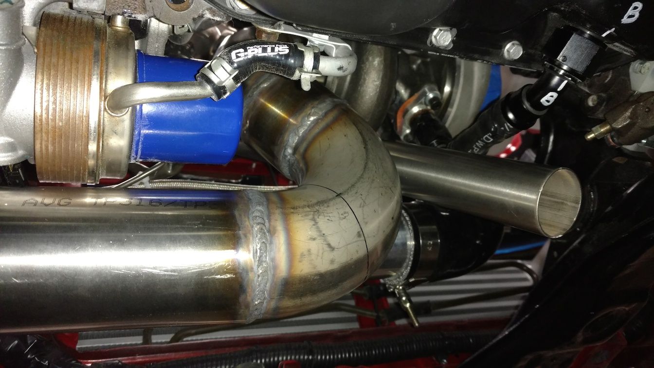

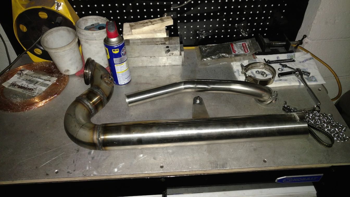

After finishing fitting the bumper to the car and trimming it to fit properly i went ahead and started my exhaust. Now the plan was to create a full 3'' stainless exhaust to the back. But plans change fairly quickly around my house and i decided to do a side exit exhaust and a waste gate dump. First i went ahead and bought some 3'' stainless steel donuts as well as some 1.75'' stainless for the dump tube. My good buddy Dan brought over some 3'' stainless straight pipe he was going to use for his exhaust but decided to let me use it instead. Besides its not like i need that much straight section.
First thing was to get the bumper cut so we can see where we were going to have the exhaust exit.
Next we just mocked up the pipe to see how much room we had and what bends to make. Sorry for not documenting this better.
Cut up the donut and made the bends where we needed them as well as dumped the waste gate under the oil pan.
Final Product. Cut out a bracket so that way i could use an exhaust hanger to keep the pipe from just hanging off the hotside. I also went ahead and wrapped the exhaust to semi keep the temps down. Sorry again for not having a picture of it wrapped.
My dad is the man when it come to doing me favors. He went ahead and cut out a bumper plate to give the car a fresh look and to keep my bumper from melting. God i love the look of the car so much better now.

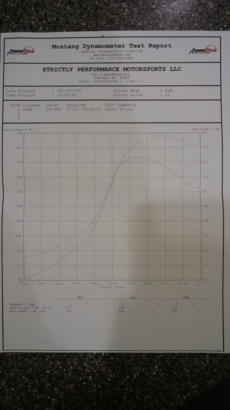

I couldn’t wait to work on the car. But over the course of time I was super swamped with work. I was working over 70 hrs a week and the eclipse stood still. I decided that I wanted to enjoy the car and get it finished before my birthday. I figured I made great progress with the car and my goal of getting the car done and motor fired up within 6 months was complete. Now I just needed to drive and tune the car but had no time. I gave my buddy Allen @ Strictly Performance Motorsports a call and he took care of me. A couple of issue came up with the car such as a bad power transistor and that I needed to do speed density but other then buttoning a couple of loose ends Allen and his crew took care of me. The car put down 444 HP / 388 TQ on 93 octane @ 25 psi on their mustang dyno. Not too shabby on pump gas.

Dyno sheet to go with it? Very nice!
Thanks. Yes I have the dyno sheet as well. Will have to scan it and uploaded it to the build later on today.

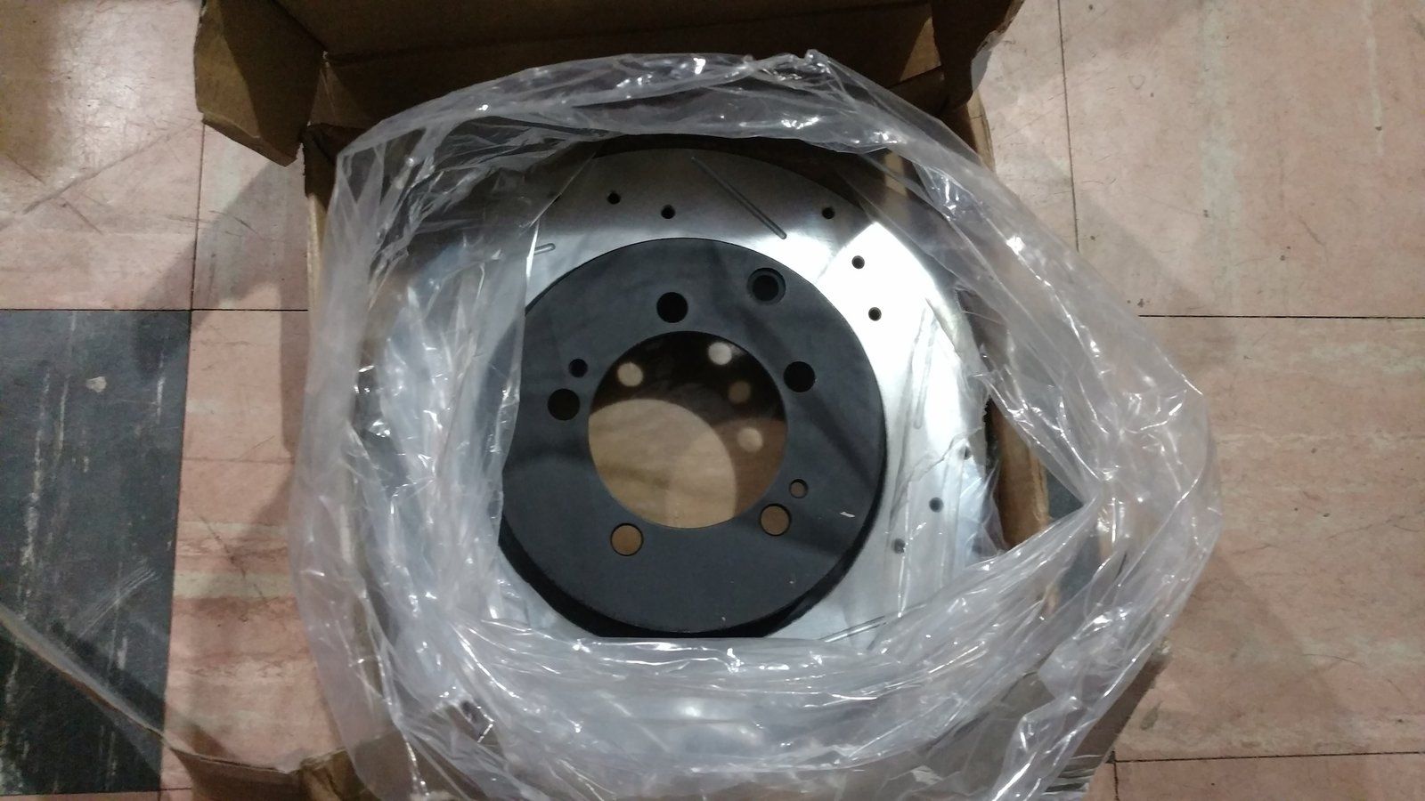

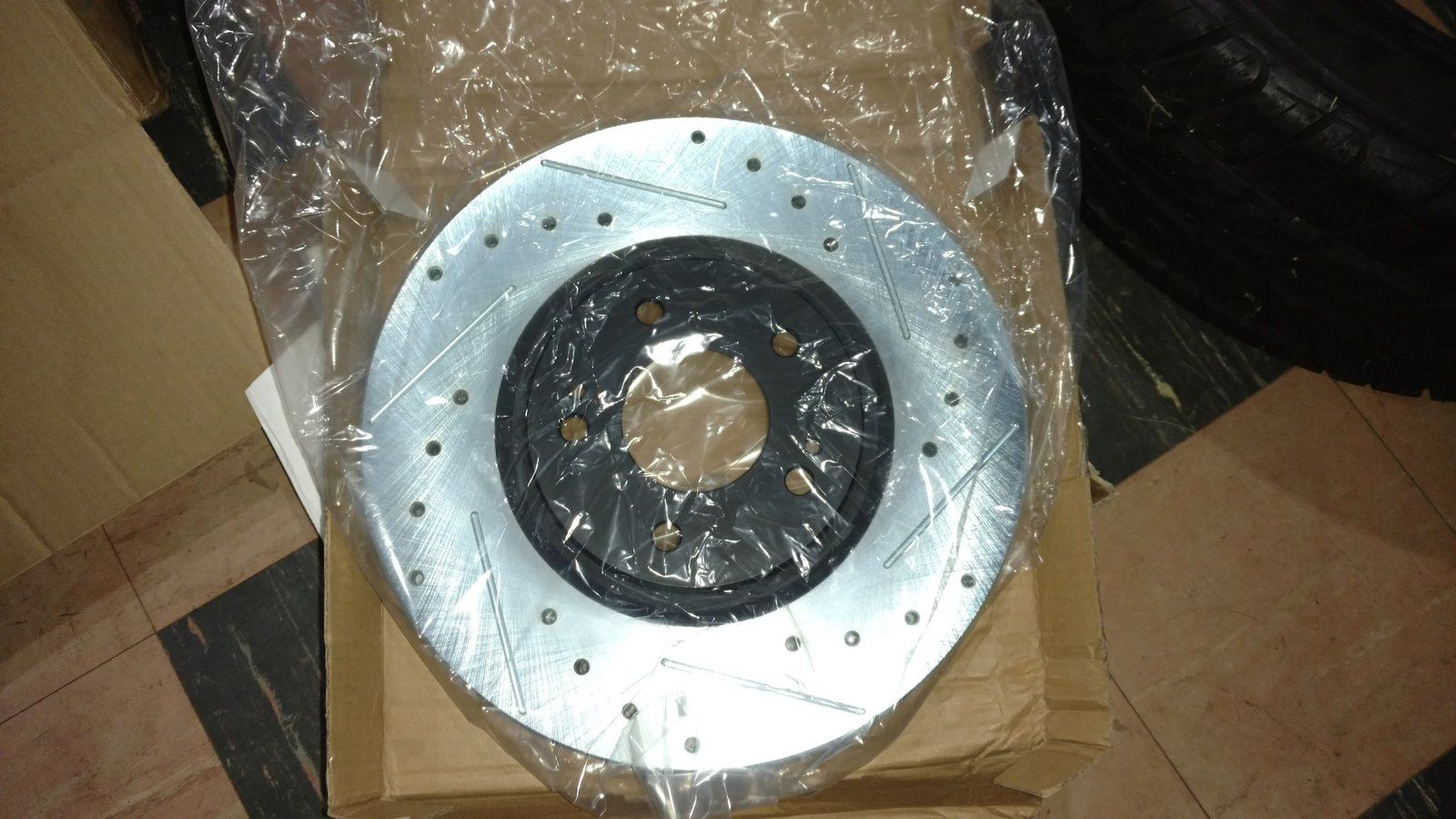

Hey guys. Its been a while since i last posted. Been super busy with work and barely any time to mess with the DSM's. I was able to get a few things done. Have been enjoying the red and white gsx as much as i could this summer. Completed oil changes on both cars. I finally received my cross drilled and slotted brake rotors for the red gsx. Took about a month to get here but not like i had any time to work on the cars. Still have to respray the hood on the red gsx and I'm thinking about possibly putting a cage in the car.

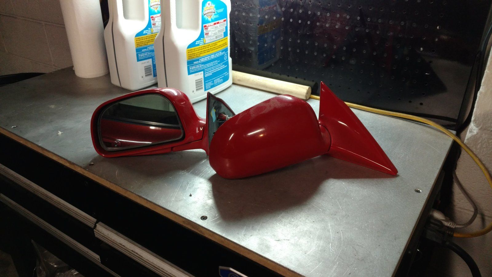

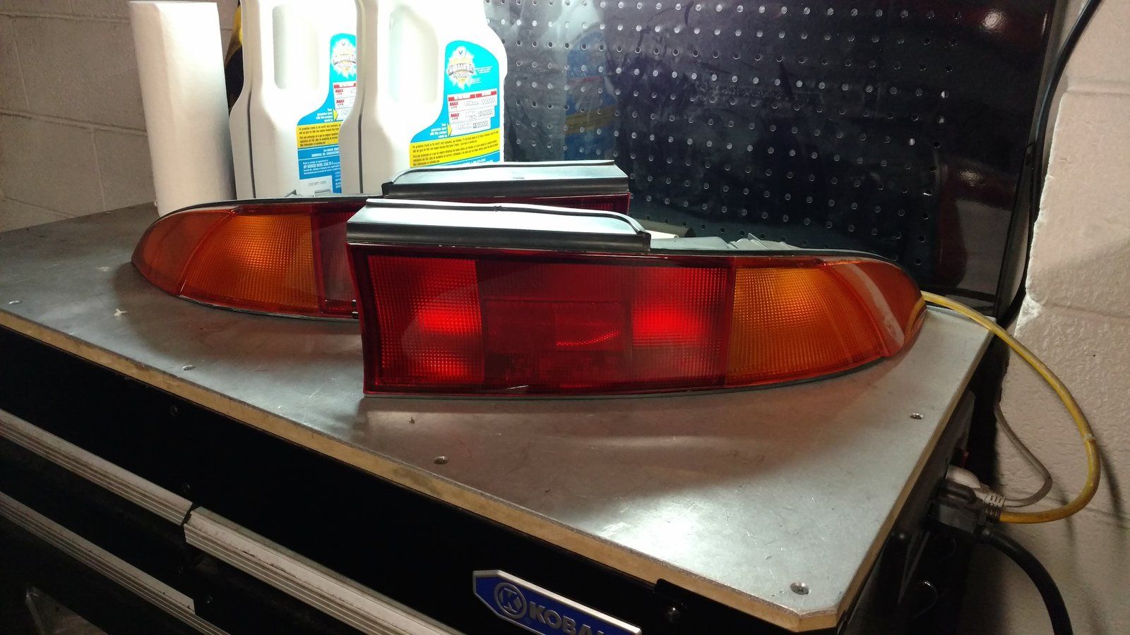

On a side note. I stopped by my parents house a couple of days ago to finally get the rest of my dsm parts out of there. I was surprised with what i found. A pair of 2g DSM EDM taillights and EDM mirrors. I thought i got rid of these years ago!!! Now the only problem I'm having is which dsm to put them on. LOL

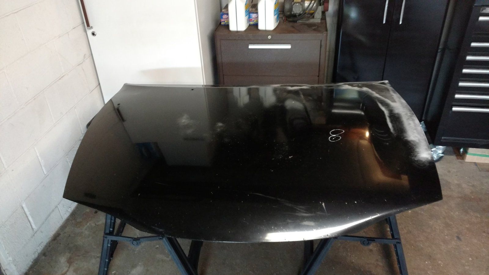

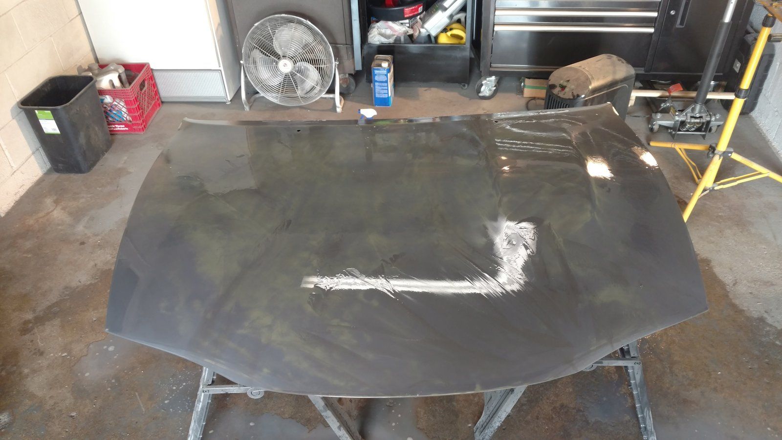

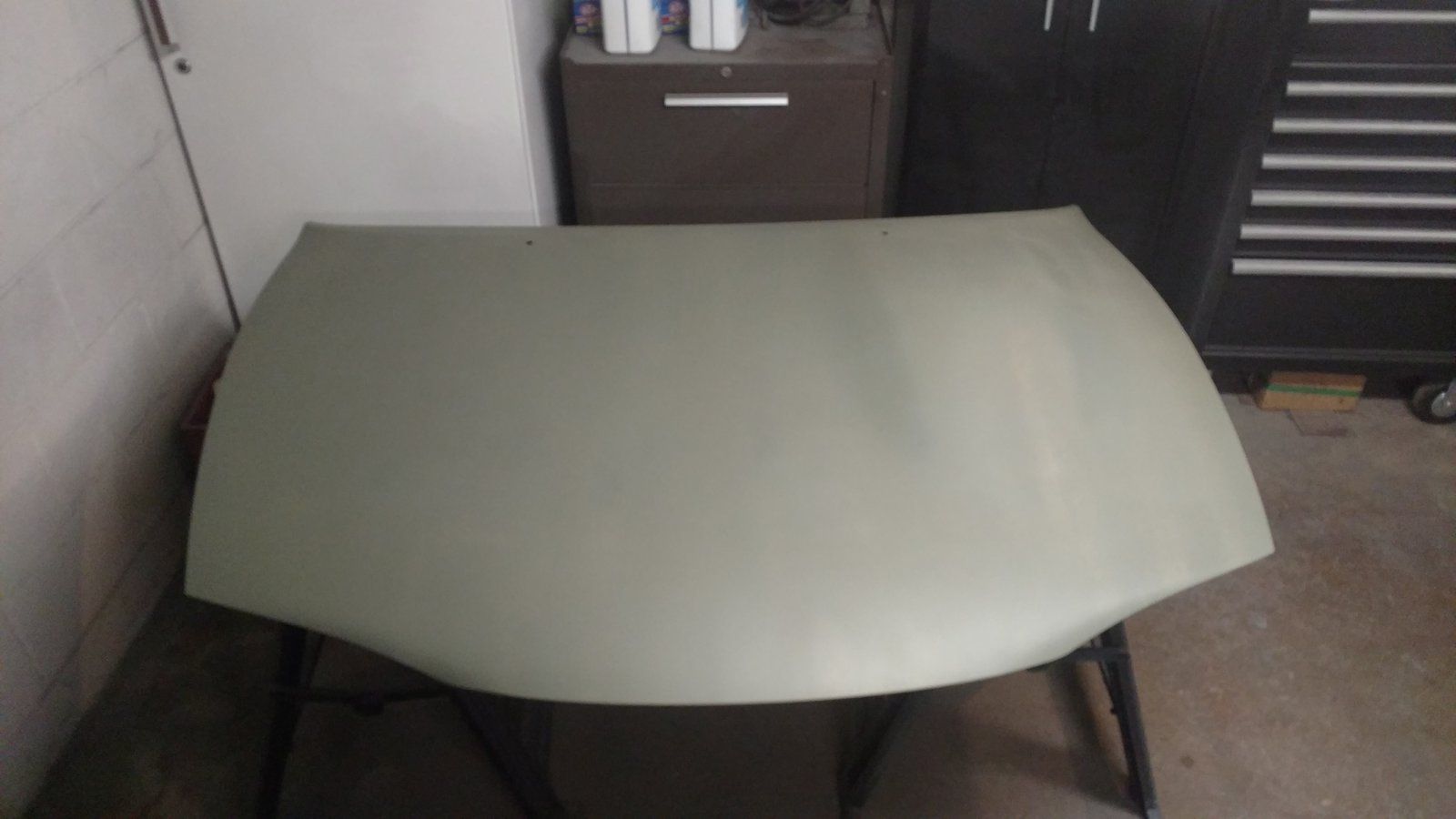

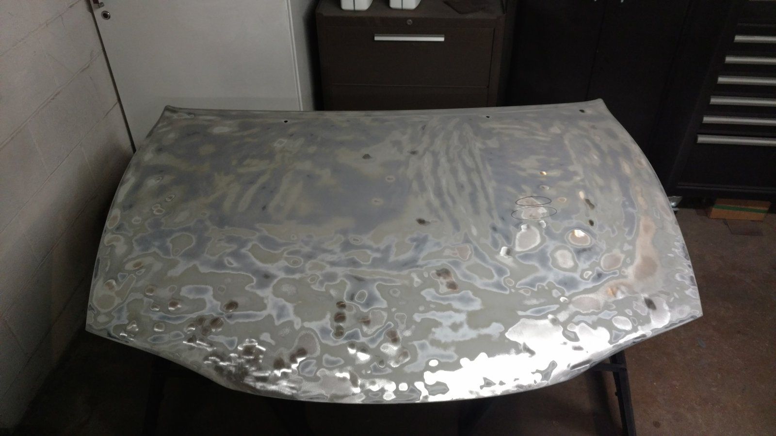

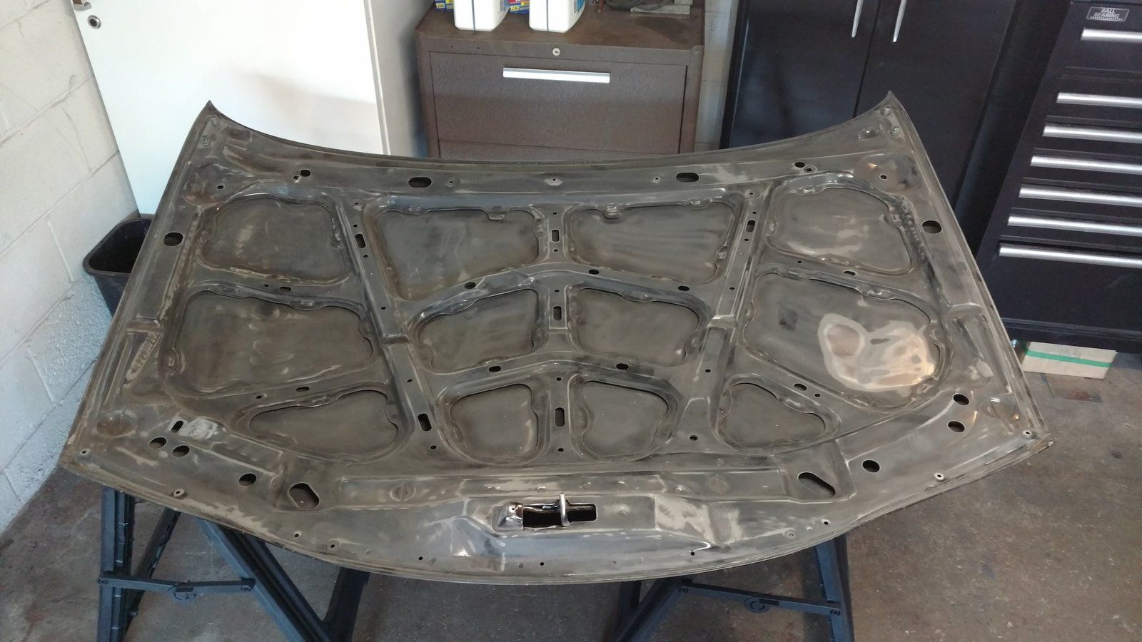

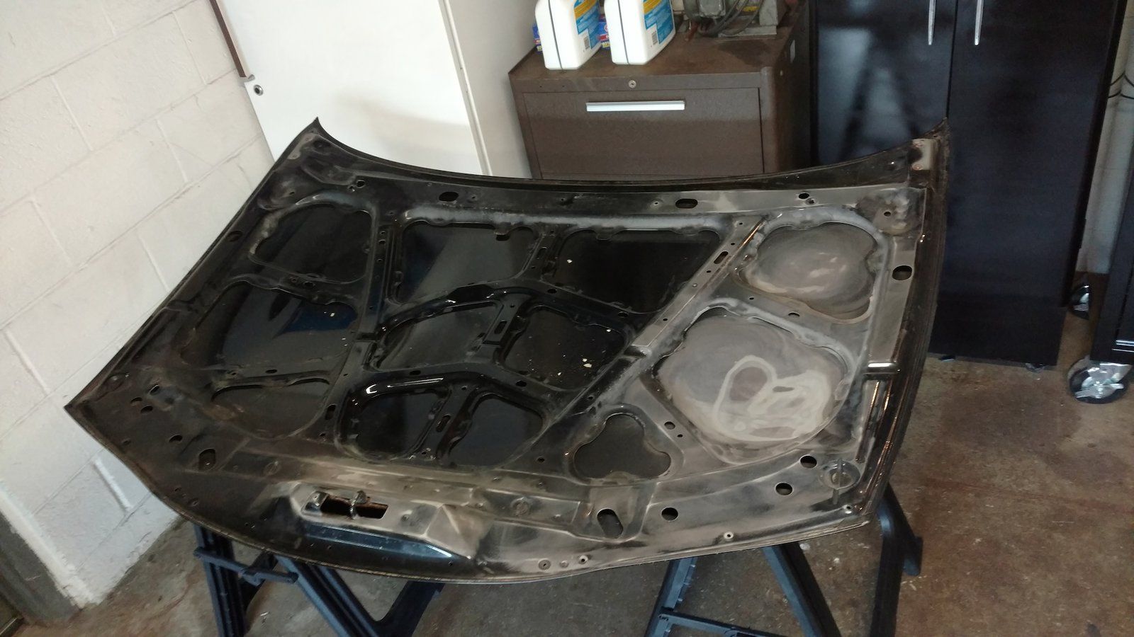

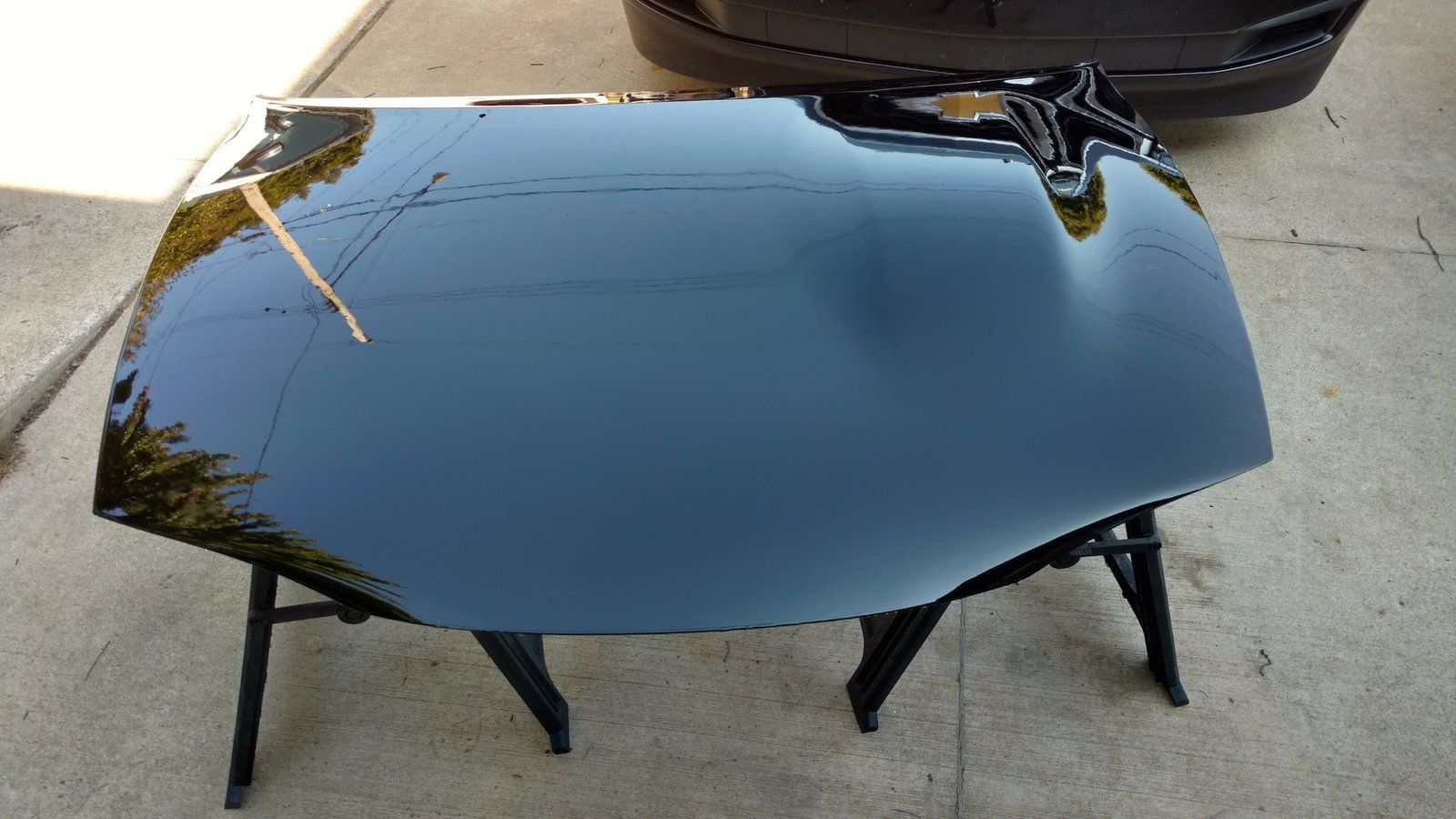

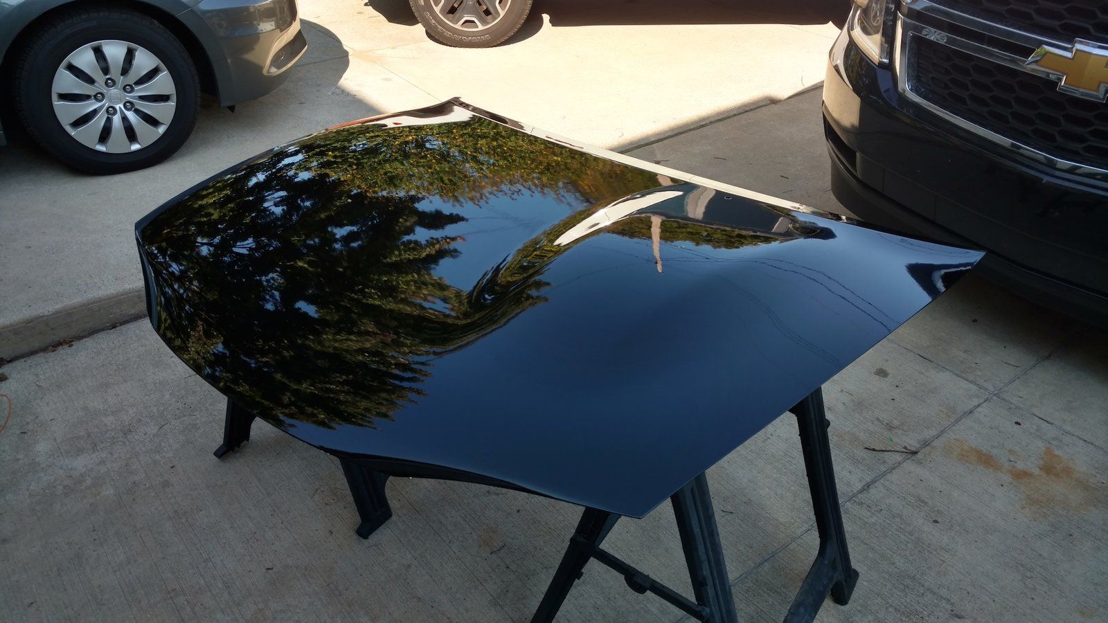

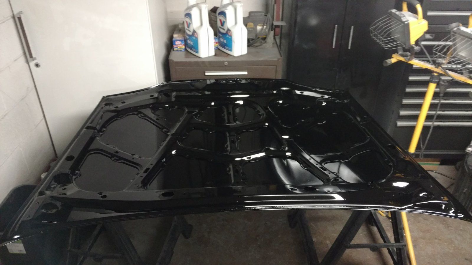

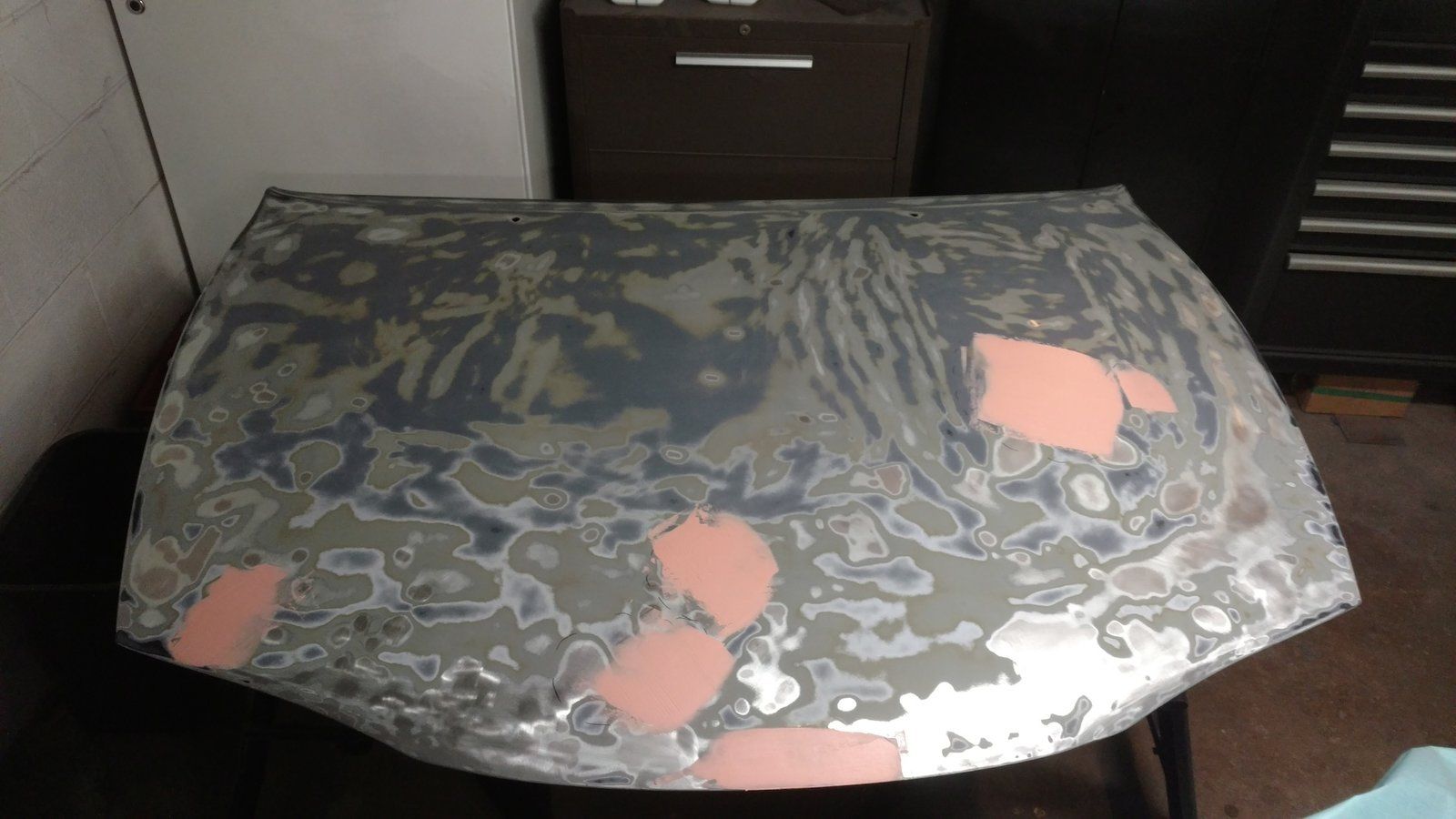

Been a while since i got to do anything on the cars as usual. But since i had a long weekend ahead i figured i would go ahead and respray the hood on the red 2g. It was a good junkyard find but i hated seeing the clear coat fade and the dings in the hood.Time to do some prep work and paint it up. Decided to stick with black as the base color. Really like how it offsets the red on the car.
Before/During:

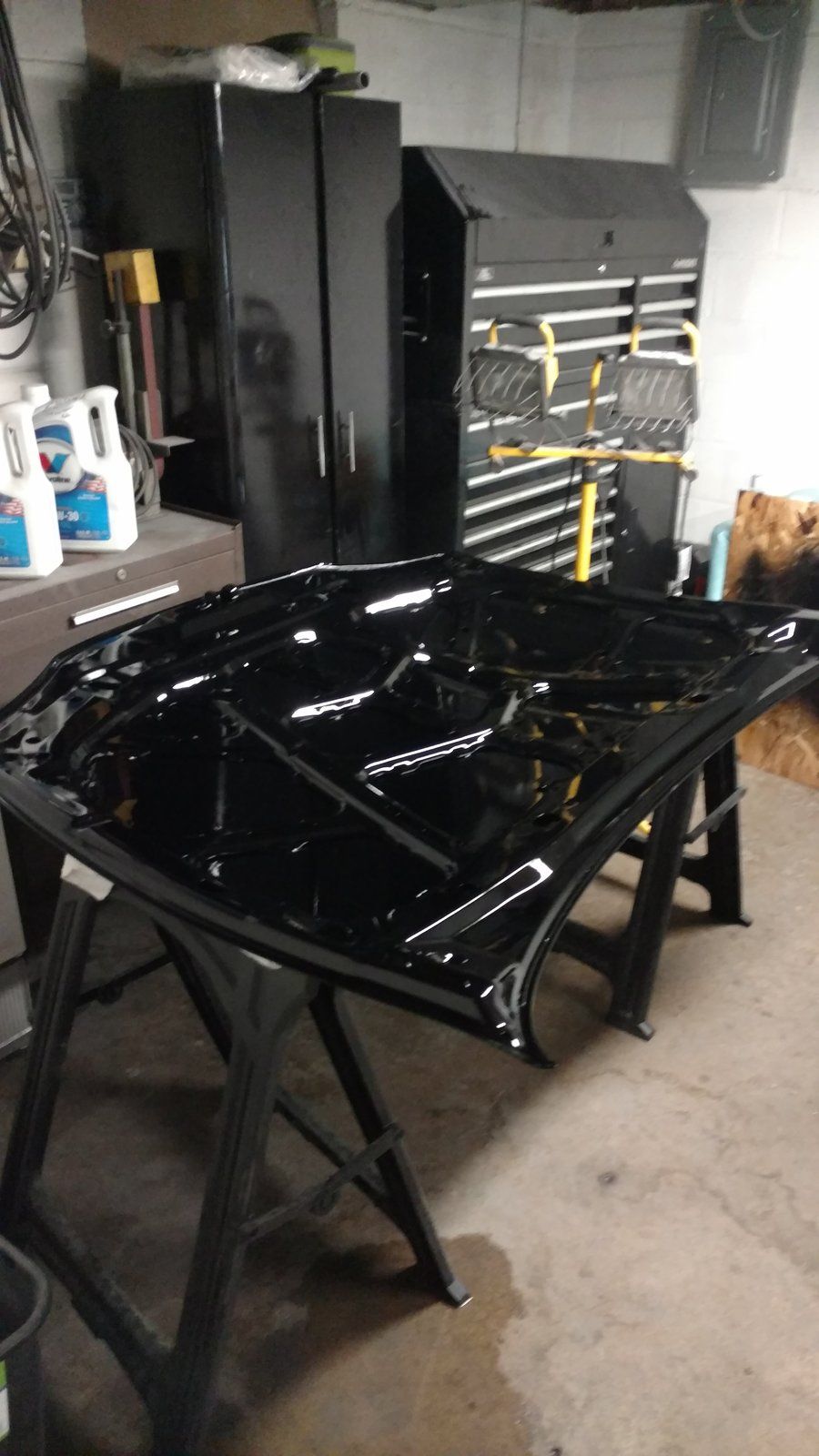

Final Product:
View attachment 472954 View attachment 472955
Overall not too bad for having limited space and time. Paint job came out great. Unfortunately there is a little bit of dust particles in the paint since i wasn't in a dust free environment. Going to let the paint cure for a couple of days then going to wetland it and try to get the small particles out then polish the whole hood. But overall I'm happy with the final product.
