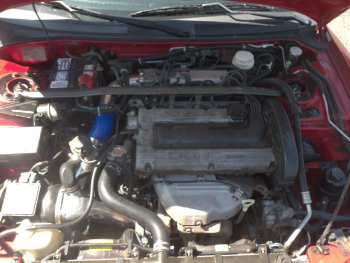

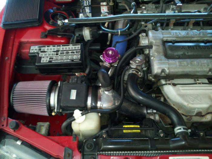

The first bit of modding I did to the car included an Injen intake pipe with a K&N filter, 3" downpipe and catback, and a boost gauge. I was pretty impressed with how these few mods woke the car up. I wanted to lower the car just a tad so I bought some Eibach Pro-kit springs. After those bolt on parts I ended up buying a tactrix 2.0 openport so I could flash my ecu. All I did was a 5000 rpm 2 step for launching.

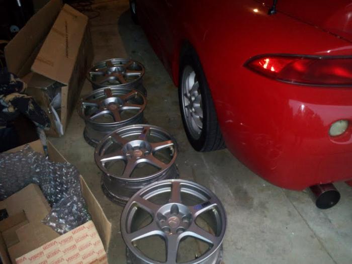

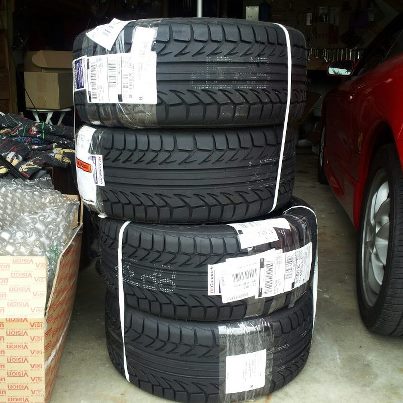

Picked up a set of evo 8 Enkei wheels and bought a set of BFG tires from Tire Rack for the wheels. These really set the car off in my opinion.
Here are a few pics of the car after I did the mods listed above. The car was a little dirty at the time of the pictures, but it still looks pretty good.

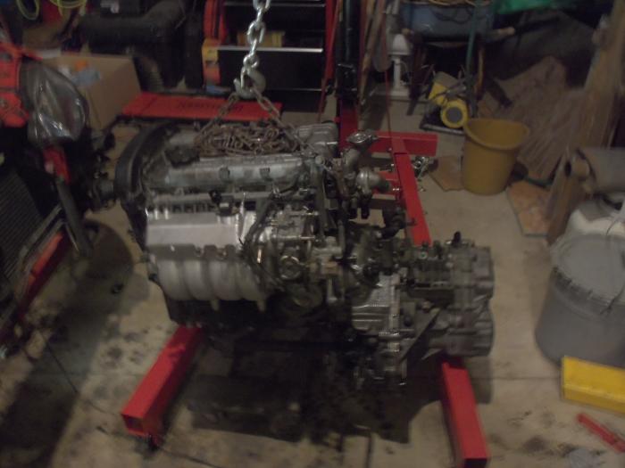

The first day I started taking parts off to pull the motor and transmission together. I spent about 3 hours the first day and 6 hours the next day working on getting the motor out. I figured working by myself for 9 hours was pretty good time for getting the motor and transmission out of the engine bay, especially since it was my first engine pull (I've watched/slightly helped my dad on a Focus in the past). I stripped the parts off the motor and started to clean a lot of the grease caked parts while I did some research on which parts to buy for my build.
Once I had the motor taken apart and some of the parts cleaned up, I decided to take apart my engine bay for some fresh paint. There was a tiny rust bubble that had just started along the seam where the strut tower meets the motor mount location on the drivers side. I ground down the metal with my Dremel and a grinding disc and found clean metal pretty quickly. There was also some paint starting to lift back by the clutch master cylinder. My guess would be somebody spilled brake fluid all over and didn't clean up. I finished prepping the rest of the bay for paint and then sprayed it with a few coats of r87 and followed up with a coat of clear. It turned out great, and now my engine bay paint looks better than the exterior. That will get worked on when it gets warm outside again.

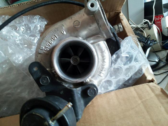

MHI evo III 16g

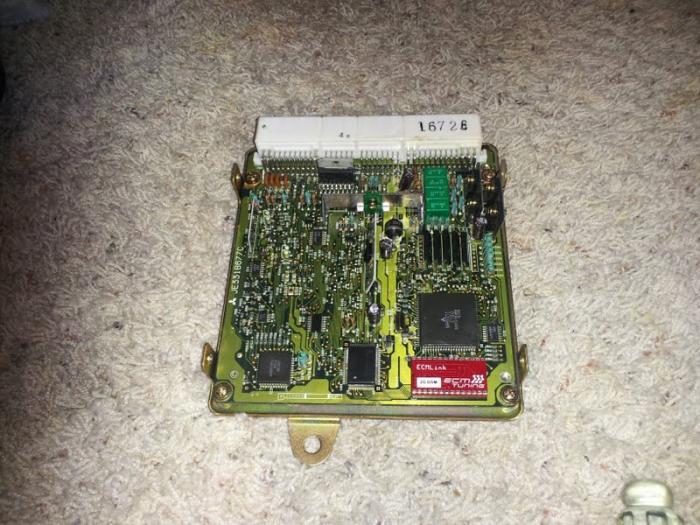

Found myself a great deal on ecmlink v3 full with an eprom right before christmas!

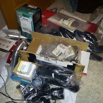

This is the current state of my bedroom. FP manifold, fp2 cams, timing belt kit, couplers, wideband, water pump, arp head studs, and the list goes on.

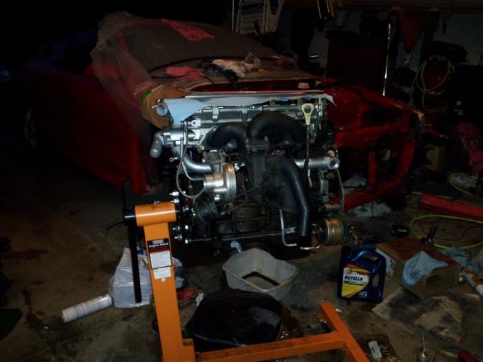

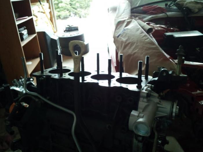

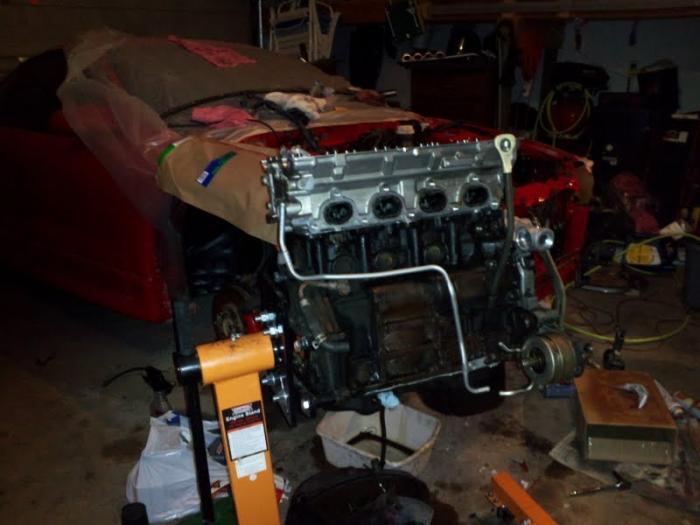

It has been a bit since I've updated my build thread. I've been busy with the car and haven't taken a whole lot of pictures. The current state of the engine is pretty much complete. I'm waiting on an oil return line gasket so I can fill it with oil and prime the engine before I put the timing belt on. Everything has gone pretty smoothly so far and I can't get the thought of driving it out of my head.
I decided to clean up my transmission and paint it with some cast aluminum color engine paint. It turned out good for the little time I have invested in it and it was totally worth doing because it was pretty gross looking before.
I decided to buy a factory service manual off of ebay because it was so cheap and I wanted a hard copy to have out in the garage. Best 25 dollars I've spent in a long long time.
Here are a few pictures I took of the engine accumulating parts. ( don't mind the mess in the background )
