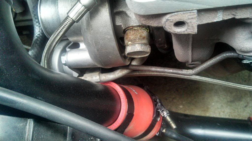

For some reason I cannot remember the other pending code, but one was for the waste gate actuator. I thought that was odd. I popped the hood only to find that the radiator fan was pushing the J-Pipe, which was pushing the turbo water line, which was pushing the on the actuator arm, pressing it against the turbo housing. SOOOOO it was like one big samwhich in their. Being as it was hot as balls out I really couldn't do anything about it, till I got home.

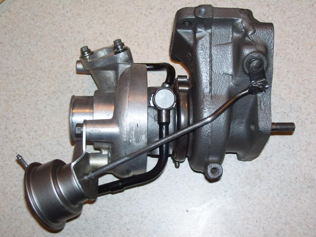

Here's is a picture of the sandwich pinch I mentioned. I think/thought this was why the car was having boosting issues. With the bucking and spiking.
As you can see, the J-Pipe was pushing on the water line which pinned the wastegate arm against the turbo
NOW the carnage.

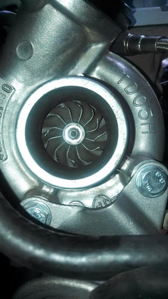

I pulled of my intake pipe, took a look...and got upset. :(
I then noticed small rubber chunks inside my intake. Hmmmm...
It seams that the turbo decided to eat the small black coupler sleeve for lunch.
I immediately removed all the intercooler and piping to clean it out. The amount of small black rubber chunks that fell out, makes me sick to my stomach.
This was a rebuilt unit by JusMX141. it was running great and had maybe 1500 miles on it. :(
Just not in a good mood about it.

Having the turbo killed really makes me upset, but i'm WAY more worried about what could have gotten into the motor.
My plans are to clean all the piping, bolt everything back on, pull the VC to have a look see, do a compression test, then run some seafoam and change the oil.
Depending on results, ill go from there on.

I'd look into running that front coolant line under/behind the actuator which is more-traditional....the way you have it there is pretty hokey.

As for the coolant line, I'm going to be changing it. The hard pipe puts it in that spot, so for the time being, ill bend it back around if I can. Or leave it and deal with the bigger issues first.
