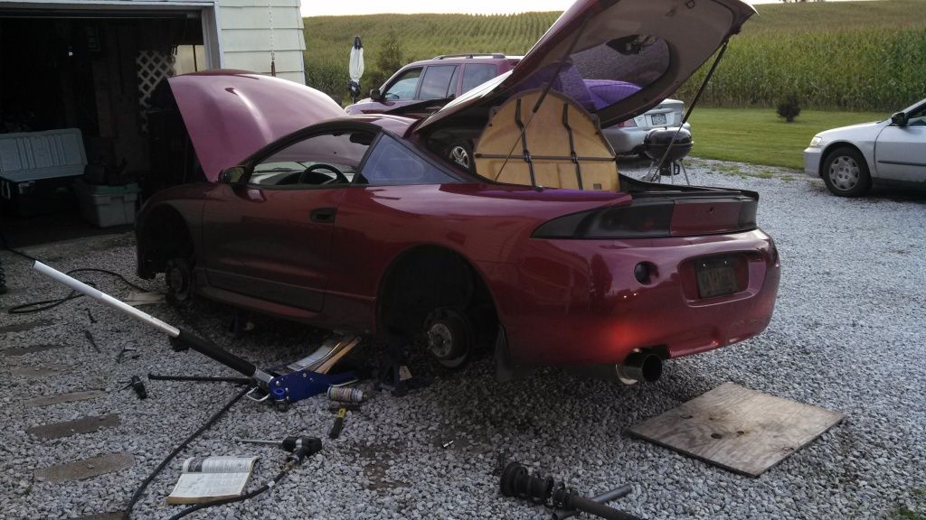

Tomorrow, my buddy Justin (99ECLIPSEGSXDSM) and I are going to get my coilovers installed! Very VERY pumped about this. Cannot wait to have a nice aggressive, sexy dropped 2g.
I also order all the components to do my timing belt. Gates belts, pullies, water pump, etc.
Once this is all done, I hope to hit the last few AX events for this season.
UPDATE: 9/10/2013
Coil Overs are on!! :rocks:
And at stock height the car feels AWESOME! :hellyeah:
No to take some time and dial in my drop, then an alignment.

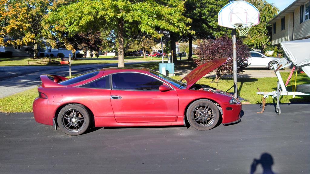

Wanted to get some updated pictures of the car with the coilovers/drop.
She needs a good wash.
I will be switching over to 17x9s at some point as well. The current wheels are a tad to narrow for the 245 tires. I get a lot of sidewall flex during AX.

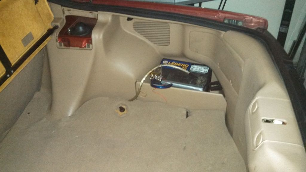

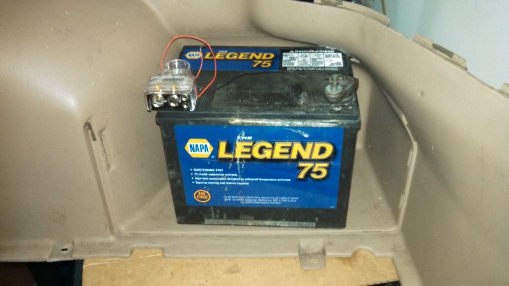

Also finished up my Battery Relocation last night.

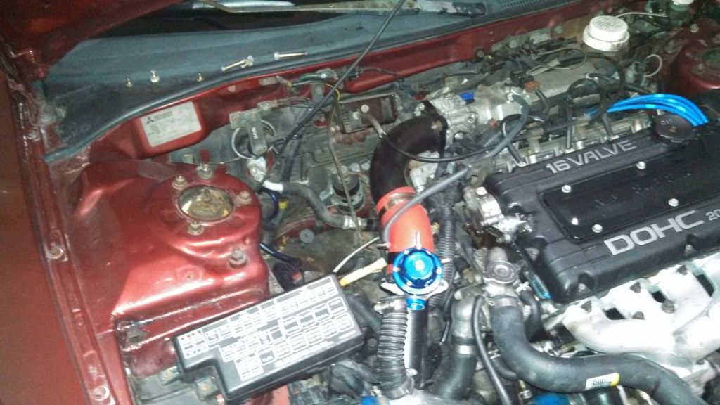

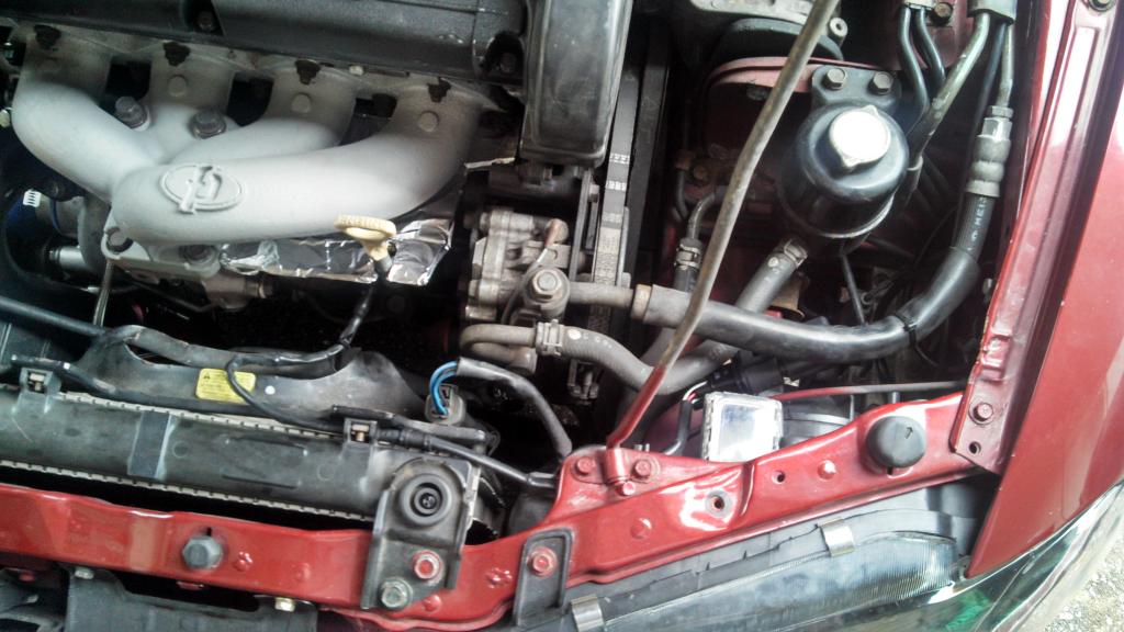

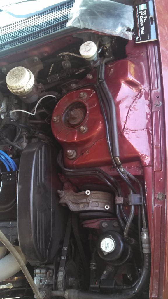

I removed the battery tray, support, charcoal canister, and finally got around to do doing the STM EGR blockoff plate. Cleared up a lot of vacuum line and made for so much more room.
I also got my new Valve Cover on with a new gasket. I did the metal half moon seal and some RTV Blue to help with my oil leak problem. Its been a huge PITA trying to stop that stupid seal from leaking.
NGK wires are also in now. Im hoping this cures my hesitation problem during my AutoX runs.

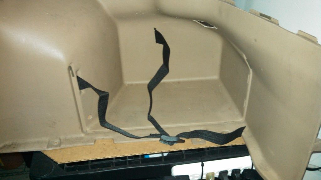

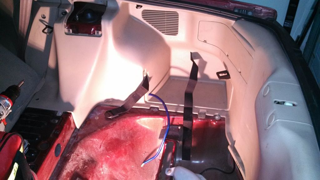

Battery moved to trunk. I cut out a small square in the corner so the battery would sit flush inside the pocket.
I then made a slice to run the battery tie down strap. This wraps around the battery and pull is tight into the pocket.
Drilled a hole for the Positive line and installed the trunk panel.
I still need to tweak a few things. I want to run the lines so they are not as visible and I'm going to hook up my voltmeter. But this gives you an idea.

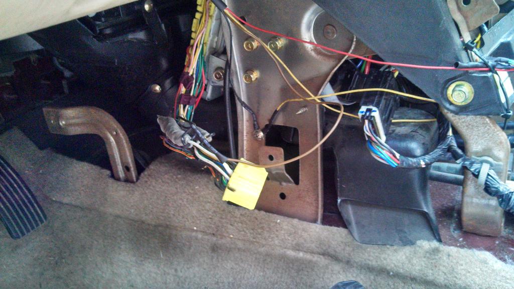

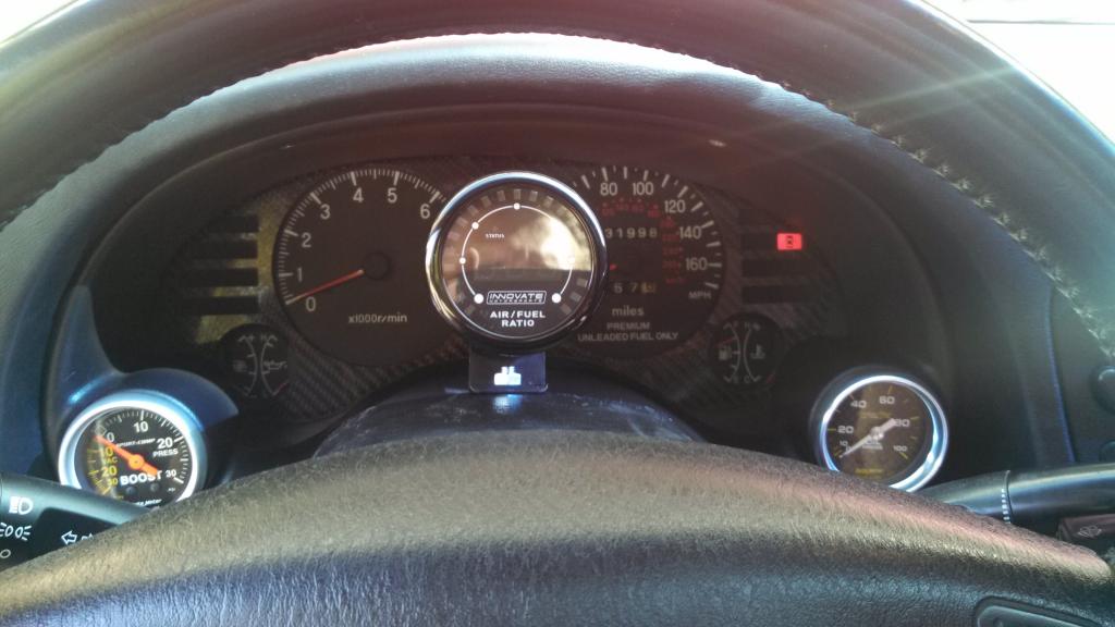

I mounted and ran wiring for the MTX-L gauge and the Oil Pressure gauge.
Boost on the Left, Wideband in the center, Oil Pressure on the right.
MTX-L Wideband installed in the front O2 spot. I made a custom heat shield for it. Works very well.

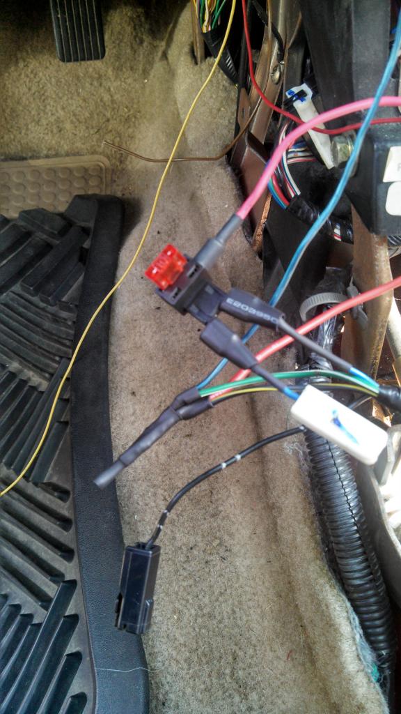

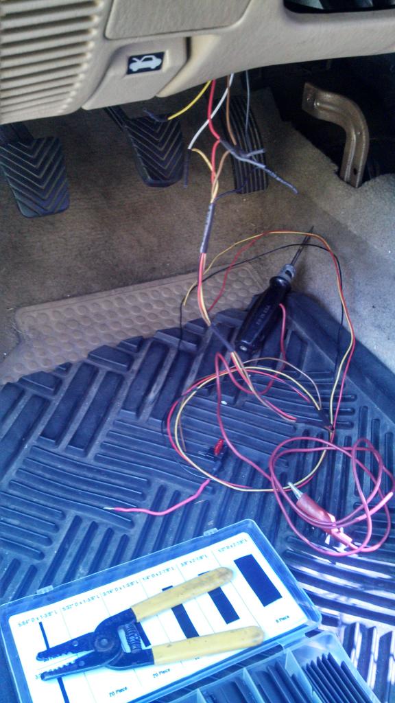

Ran the MTX-L cable.
I then made a longer wiring harness for the gauge. I bought a real cheap Heat Shrink tubing kit for wiring at harbor freight. This stuff worked AWESOME! I def recommend it for any wiring.
All the wires installed.
Spliced the Brown wire in to simulate narrow band.
Up and running!

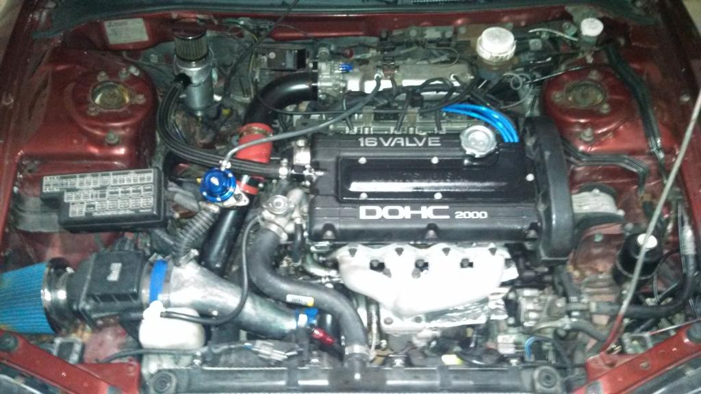

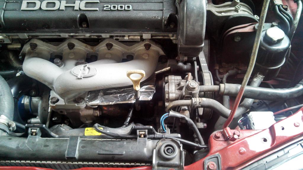

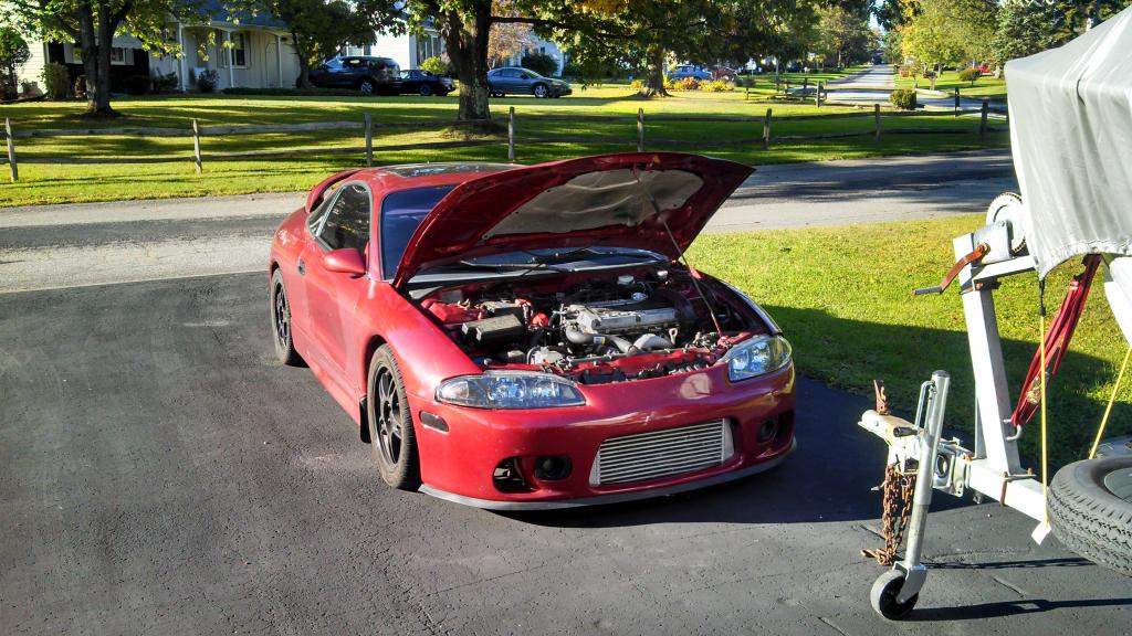

Latest picture of the engine bay.
I still need to clean everything up a bit. Still a plethora of color, hopefully it will be more universal in the near future.

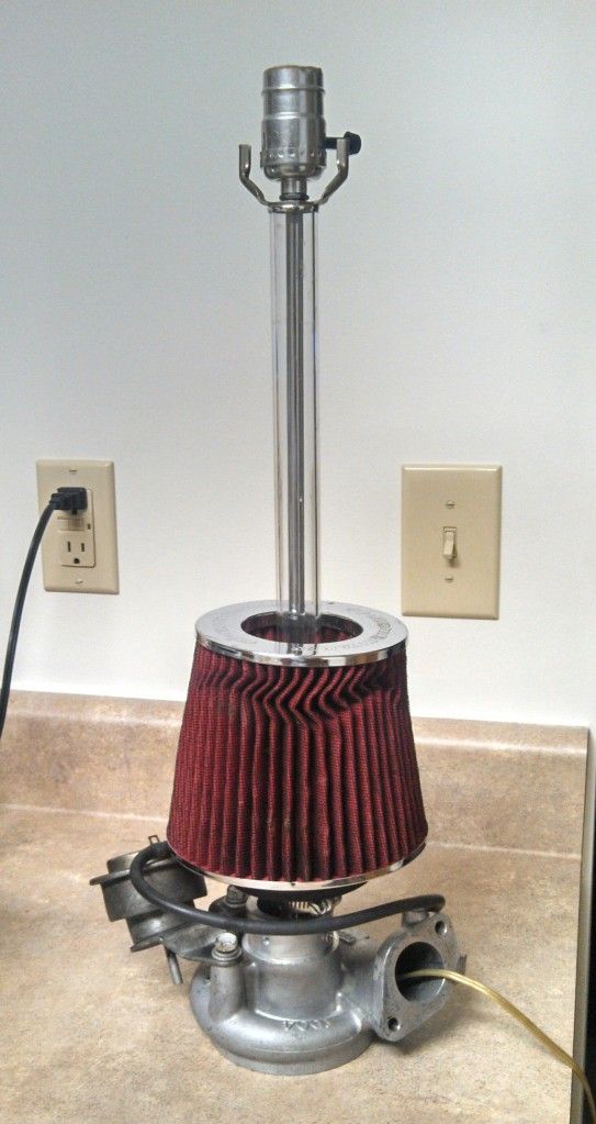

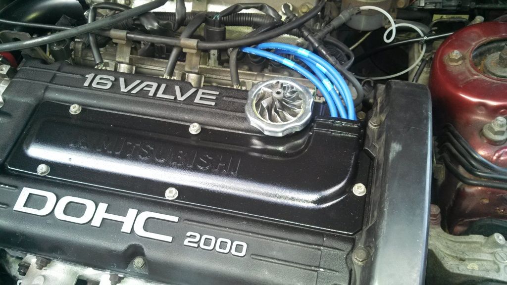

Had my old 13g wheel laying around and decided to us it for something unique.
If your wondering were the 13g turbo went...I give you turbo Lamp. #becauserace...lamp?

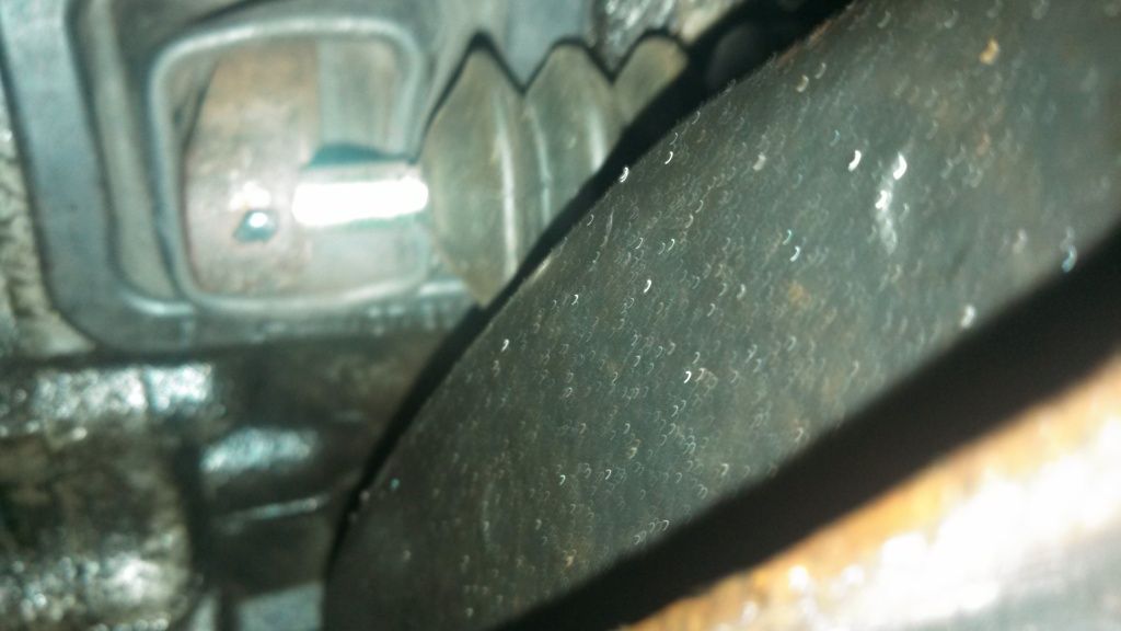

Back to reality. I had been battling a clutch issue since I bought the car. Full thread here:
http://www.dsmtuners.com/forums/drivetrain-tech/458677-possible-clutch-fork-problem.html
Turns out I never actually looked at my clutch fork position. Stupid me right?
Sooo....yeah.
