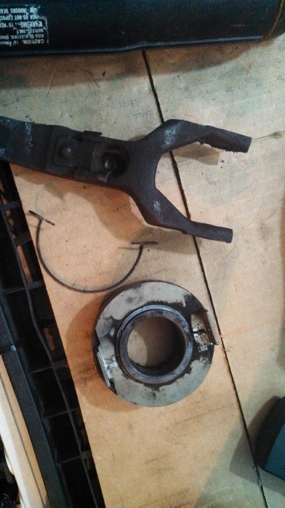

Here's a picture of the TOB and fork that I pulled out. The fork had a broken clip and the TOB is not an OEM unit. You can see the cracking.

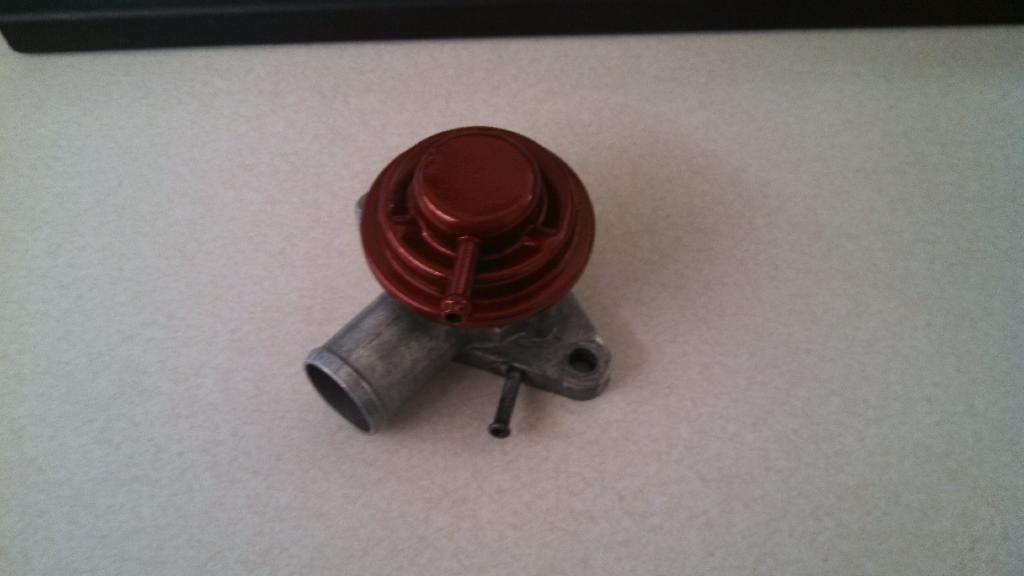

I also took some time and cleaned up and painted my modded 1g BOV. Sprayed the top to match the car color. I also stripped my IC piping. It was painted black, but is now back to its aluminum color.

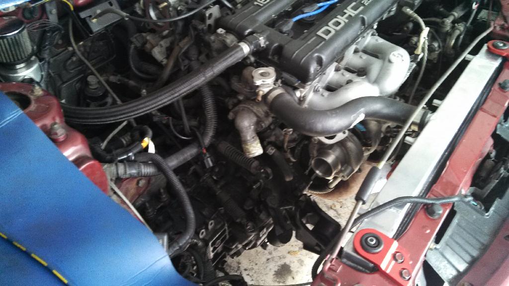

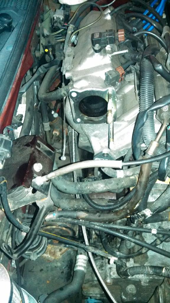

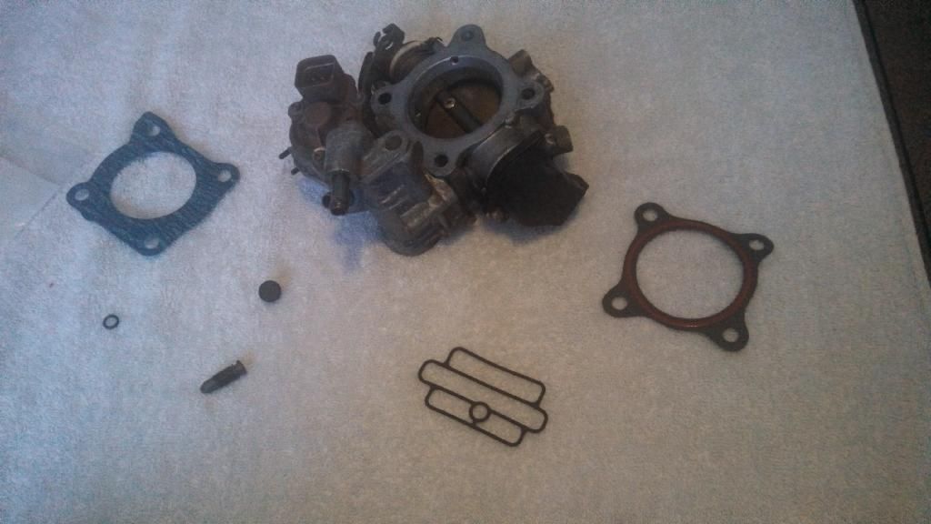

Now that the tranny is back in, I wanted to get some other things done. I removed the Throttle Body for a good cleaning, new gaskets and a new BISS screw & o-ring.

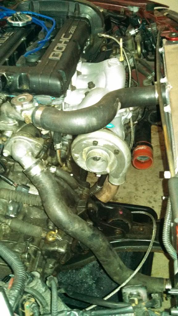

And......After some grinding and text fitting, the 20g is in!!! This should be fun.
Once the trottle body was all done, I put some of the IC piping back in. As well as the coolant overflow tank, and the radiator fan. Still a plethora of colors, which will be changed once she is running good and tuned.

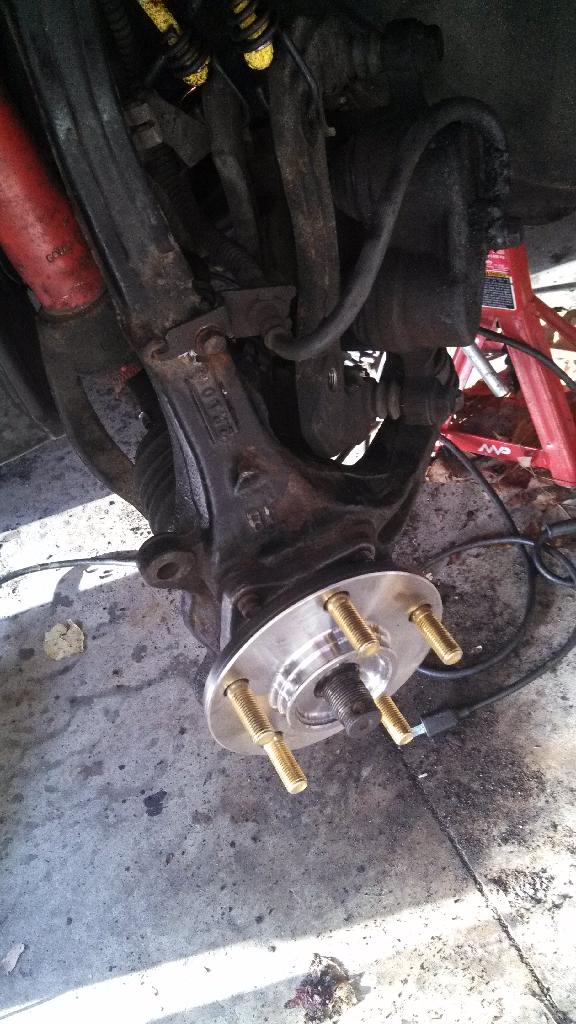

With some help from Justin (99ECLIPSEGSXDSM) and my buddy Matt, we busted the old axle and hub out! Nothing like a little ingenuity and a cut off wheel.
So we got the old out. Cleaned everything up, I have the new axle in, haven't yet bolted up the hub though, just ran out of time, and I wanted to watch Top Gear.

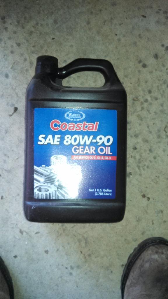

Also, I have ordered/received my Redline MT90 fluid. However, I am worried about a possible leak at the driver side axle seal. I have some new/unused, just older, gear fluid from my GT4. I was wondering if I could fill her up with that, check for leaks, fix, then drain and use my good MT90 stuff. I just hate to waste it if there is a leak.
You should know that while the older gear fluid is in the tranny it will NOT be driven, only started and idled and moved through the gears.

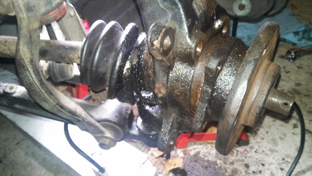

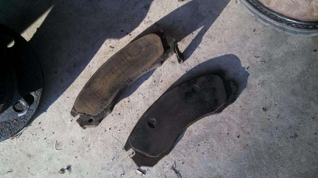

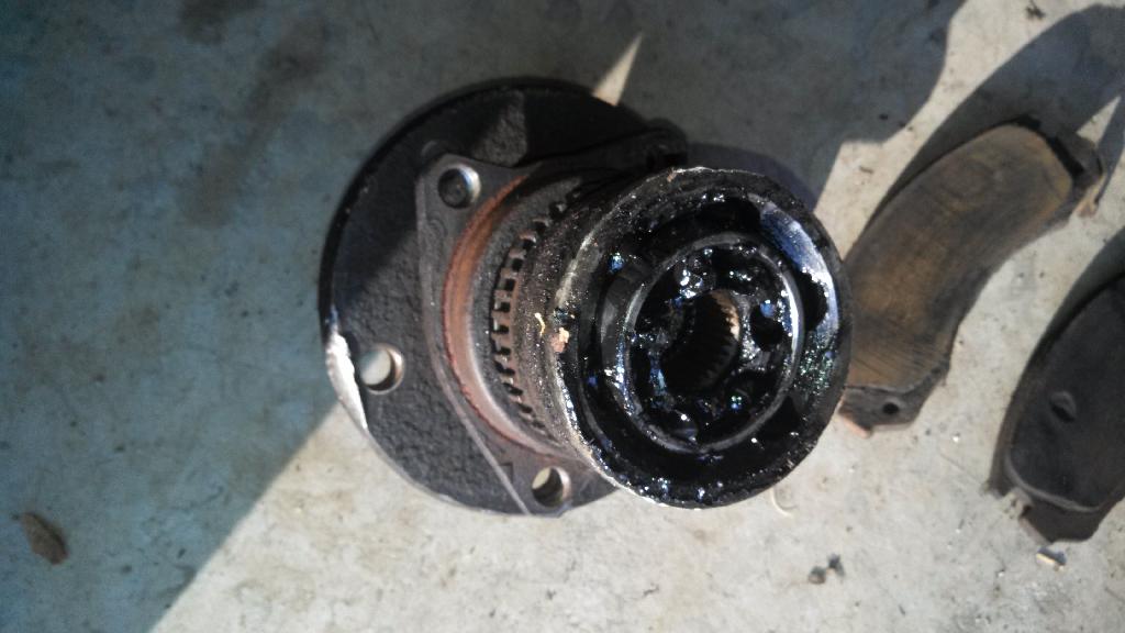

Badly worn our brake pads on the driver side. The rotor has a lot of life left.
The old hub/axle assembly. Finally out and trashed.
The new hottness!
In my previous post, I mentioned have some unused/new gear oil. I wanted to fill my tranny with this, check for leaks, and kinda use it as a flush.
Any thoughts?

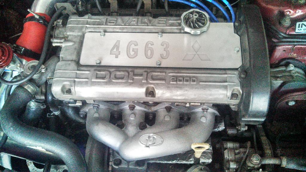

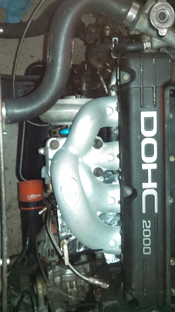

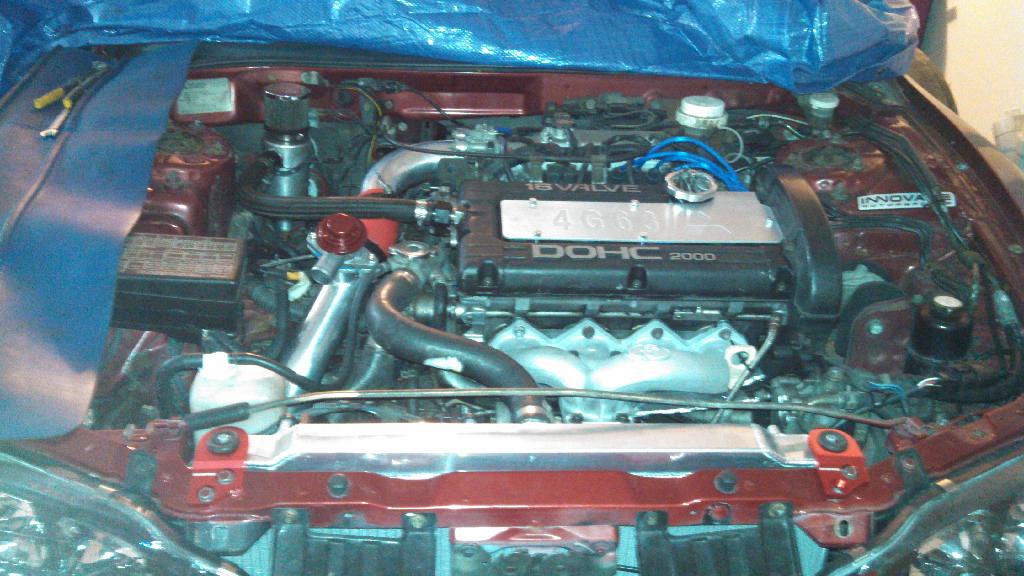

I removed my Valve Cover and -12an line Setup - opted for a brushed VC. I'm going to clean it up a bit more. I plan on selling the old setup to fund some more parts I need to finish her up.
I also started a fuse box relocation. Nothing crazy, just want to make more room for an air box. Also removed the cruise control line. Haven't done the non-cruise cable install yet.
Pictures aren't the greatest, and she needs a really good engine bay cleaning.

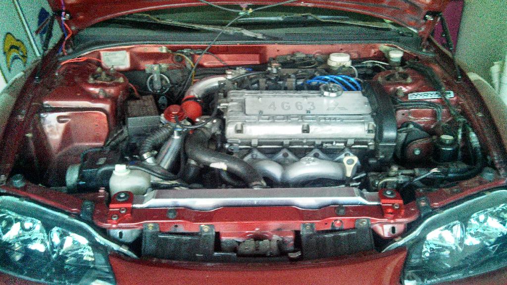

After work Friday I put some wrenching time in. I got the exhaust bolted back up, the non-cruise throttle cable installed, the carrier bearing bolted in, and the turbo oil return line gasketed and installed.
Fiance snapped a pic.

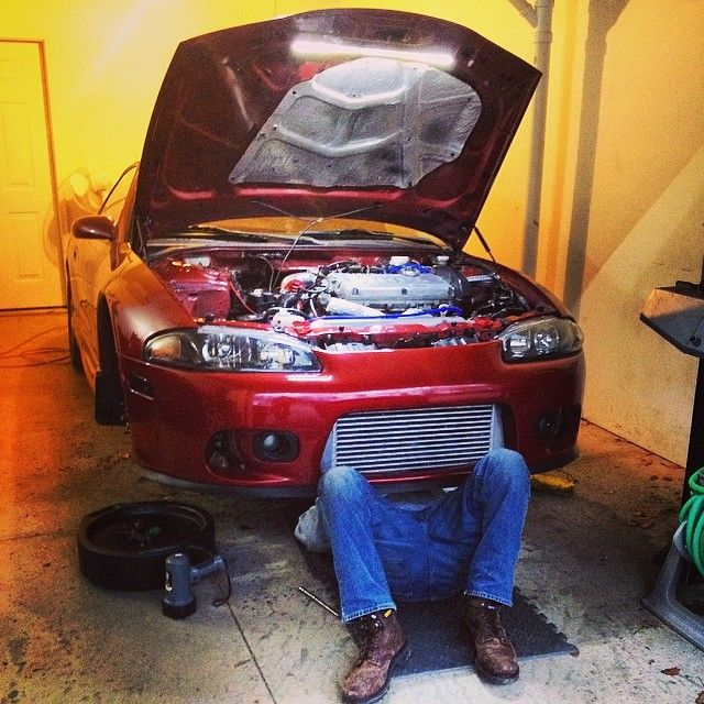

Nice build. That light bar fixed to your hood?
Thanks man!
It is actually. I work for an LED company, grabbed some spare LED strips and mounted up a engine bay light. Actually works REALLY well. I was having trouble finding a good way to light up the whole bay when working. I used to hang a shop light, but it would get in the way and not always shine where needed.
I have the wiring run through the hood, its not the cleanest look, but it does the job and they are barely seen when off. I have it wired into the fuse box currently.
At some point I plan on using the stock hood open indicator as the light switch. :thumb:

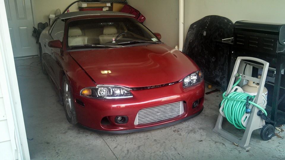

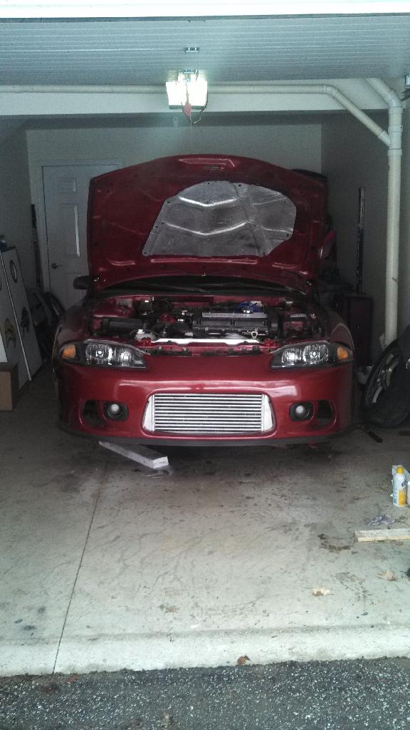

Here she is, no longer jack stand balling!
Weekend plans consist of pulling her out of the garage and letting her run for a while. I want to monitor for leaks and what not.
