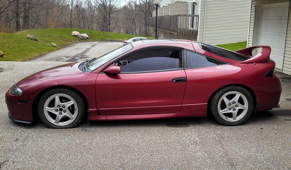

HAd the weekend to myself while the girl was doing her bachelorette thing. I buttoned up a few things, started her up and pulled her out of the garage under her own power!
I then let her run for a solid 45 minutes or so. No leaks, no over heating, fans turned on, no stalling, etc. Sounded great!

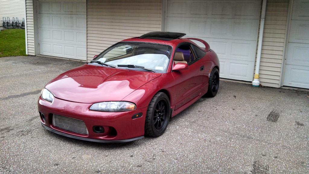

I did end up finding some wheels! 17x9 +35 for my Star Specs. I should be getting those early this week and getting them on the car. As you can see my roller wheels, the fronts, don't hold air. So pulling out and backing her in was harder than I thought with 2 flat wheels. Almost like trying to move the car with a partially pulled ebrake. But ill know more once I have my good wheels on her.
On a lighter note, I do happen to really like the way the Avenger wheels look on the car.

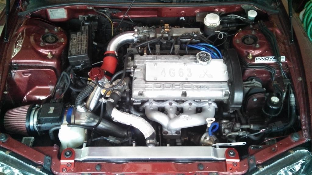

I fixed my boost leaks! Ended up having a pretty good one at a injector seal. I took out my stockers and installed my new FIC-750s. Tightened everything up, did another BLT and everything is good. Just have a very minor leak the the TB shaft.
Here is an updated engine bay picture. Its not the cleanest looking and I still have a number of different colors, but she works and works well.

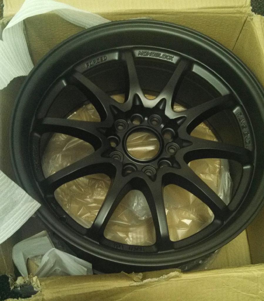

I also ended up having my wheels delivered yesterday!
They were on sale and I couldn't pass up the price, 17x9 with a +35 offset is exactly what I was looking for. My meaty 255 tires are being mounted today/tomorrow and ill be throwing them on the car by the weekend.
Volk CN28N 17x9 with +35 offset
I wish they were real. These are replica's, copies, and dang good ones at that.
I will be getting more pictures up soon. The setup looks exactly how I pictured it. Glad I waited to find the right wheels.

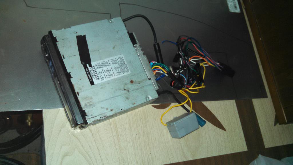

Also, got around to putting my new head unit in. Hated the old single din unit.
UPDATE: 6/5/2014
New head unit is in. And its WAY better than my last one.

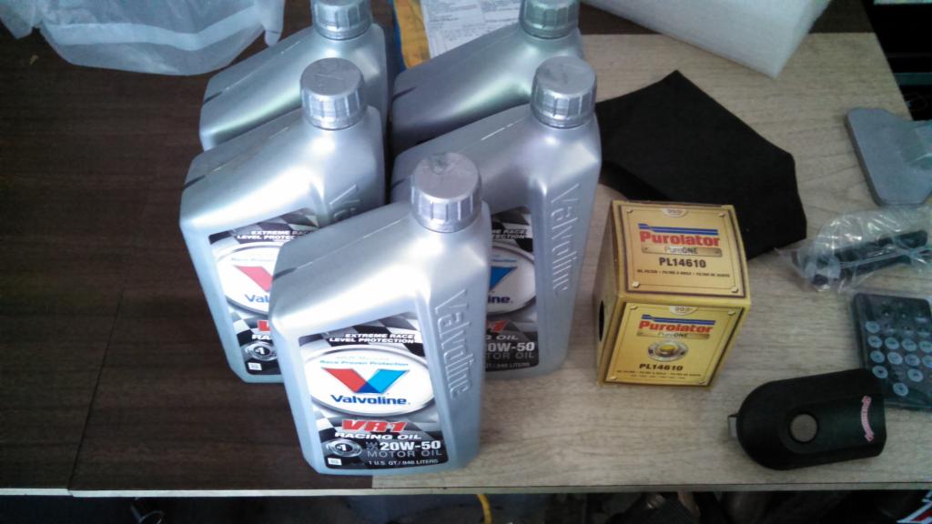

Latest small issues would be my dipstick blowing out and my higher oil pressure. At WOT im seeing around 115psi of oil pressure. Between 60 and 80psi cruising and 25 at idle. I think this is due to the VR1 20w-50 oil im using.
I'm getting a new dipstick and a new PCV after work today to see if that helps. The stock dipstick handle actually broke, due to heat over time, so it needed replacing anyway.
Now, to clean up this damn oil that sprayed all over.
STM makes a dipstick and tube with a spring to keep that from happening also I'm curious as to what you believe is proper oil pressure because I'm seeing 15-18 at idle, 50-60 at cruising and 80-90ish at WOT so I'm just curious if you know proper oil pressure because i want to know if mine is good i thought it was low but maybe its right on. as for your oil pressure it may be higher if you don't have the relief valve in the oil filter housing ported. btw loving the car its beautiful!!!
Forcing the dipstick to stay put with a spring is a band aid fix to a bigger issue IMO.
From what ive read, 100+ oil PSI is to much. At WOT im seeing at least 115+, which has me concerned,a s that kind of pressure will blown turbo seals, gaskets, etc.
I do not have my OFH ported, although it looks like I may have to rip everything apart to do so.
I think my issue is the oil weight im using. I switched to 20w-50 and then had these problems. Before the switch, I didn't have any issue what so ever. I may just bite the bullet and switch back.
Thanks man! I love how she has turned out so far.
your right that is simply a bandaid and I'm running 10-30w so i bet that will make a big difference.
I actually swtiched to Royal Purple 10w-30 and have not seen my oil pressures drop.
I installed a new PCV and I am venting my VC breather.
I did one good pull and the dip stick did not pop out, but my preasures did go high.
