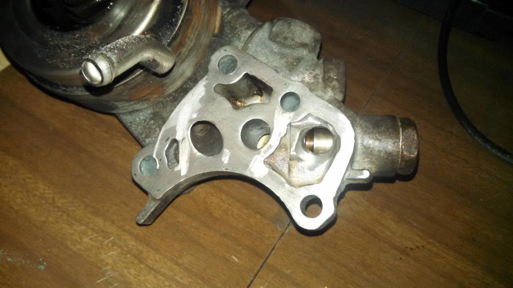

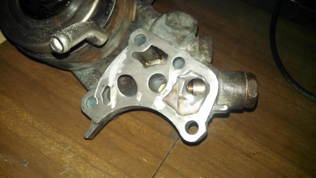

I had been slowely working on some things with the car, but its been a busy holiday season. I ended up getting my OFH ported to help with my high oil pressure. After bolting it back onto the car, it seems to be working really well. Cold idle stays at 75, warm idle at 15, neutral revs bump up to 35-45. Before they would shoot way up, so im very pleased at the moment. I ended up having to get a new alternator and belt. Just buttoned the car up this evening and will be going for a drive tomorrow.

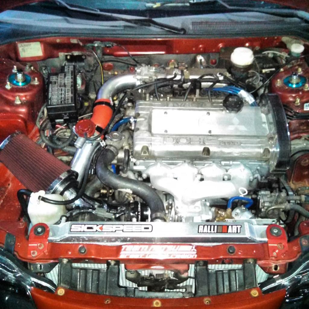

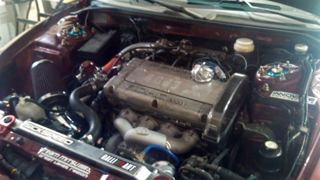

Now that I have the car running and driving GREAT. Ive decided to focus not only on the interior and changing a few things, but also finally giving the engine bay some time. As of right now its just a plethora of color. Red, Blue, Chrome, Black, etc.
So I pulled apart almost everything in the engine bay and prepped for a color change.

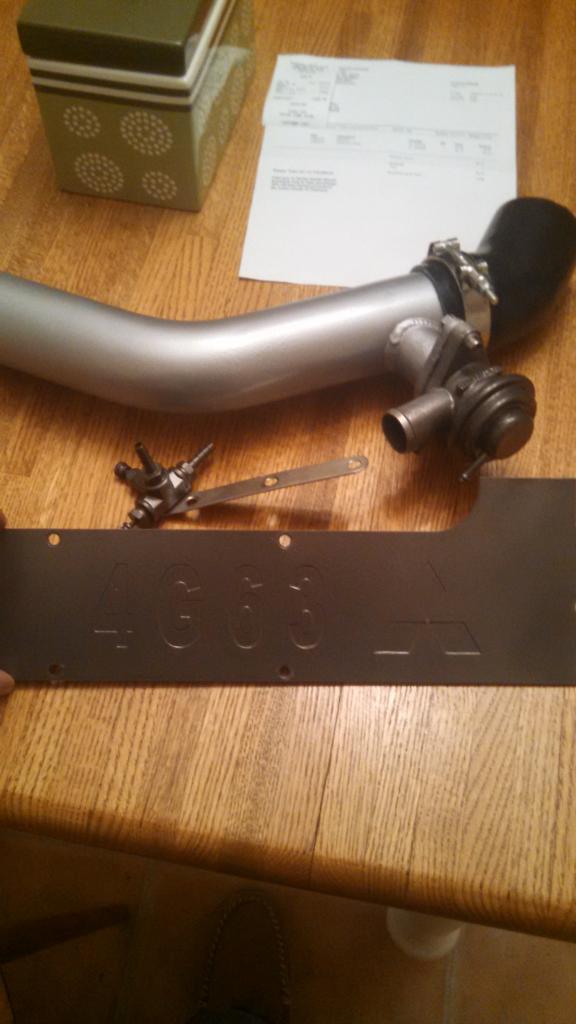

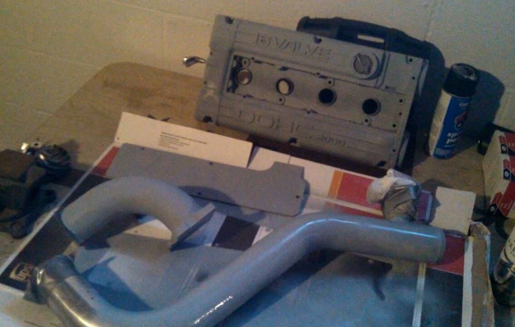

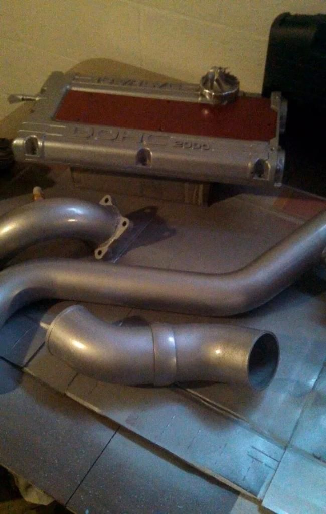

I've decided to do the piping Wrinkle Gunmetal as well as the Valve Cover and the intake pipe to the turbo. I'm going to leave the BOV top Cayenne Red Pearl (CPR). I think I will do the spark plug cover CRP as well. I had thought about painting my custom Oil Cap but I may leave that until the end, just to see how everything comes together. The red coupler will be getting replaced with a black one and I will be using nice new t-bolt clamps. The blue VC breather line will be black and I will be replacing the vacuum lines from the MBC with black ones as well.
UPDATE: 1/19/15

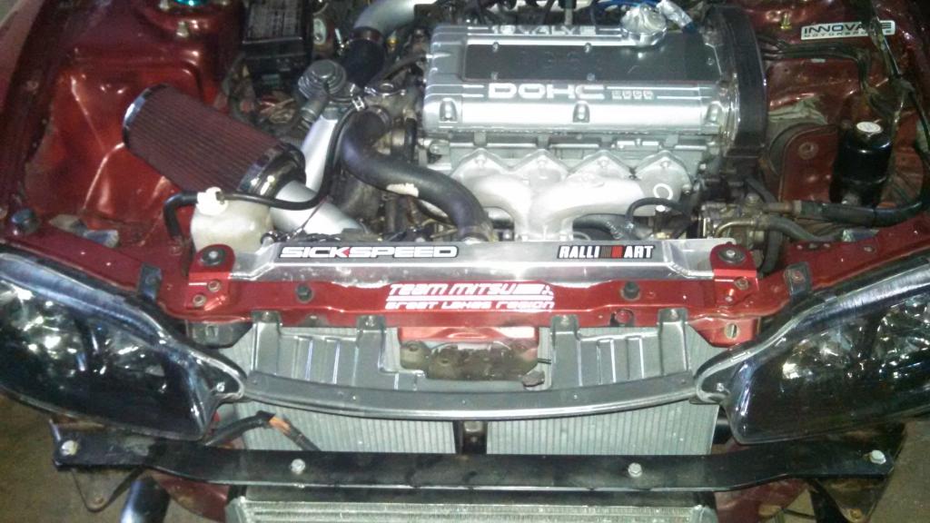

Finished painting up my pipes, VC and spark Plug Cover. Its didn't exactly turn out the way I had hoped, but I do like the coloring. I'm waiting on a new black coupler, then everything will go back together.

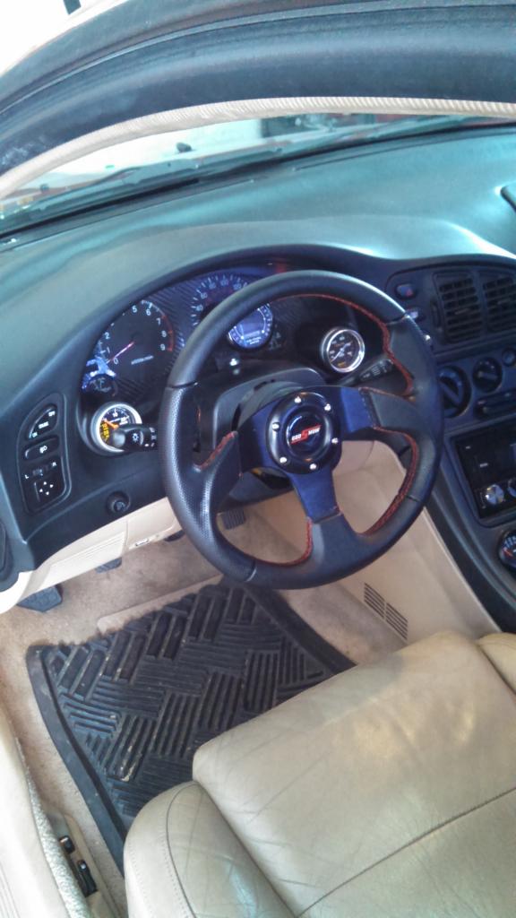

Also got around to installing my new steering wheel. I really like how this feels and after removing the old stuff, I found about 15lbs in weight reduction, which was nice. Everything is nice and solid.

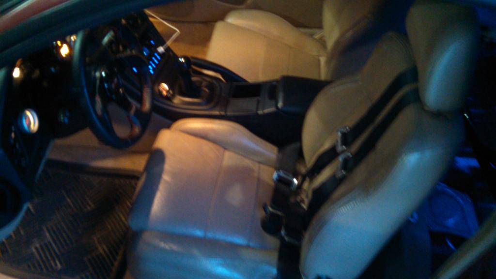

In an effort to keep with my off season plans, I put in some good time yesterday with some things. I ended up installing my 4pt harness. After removing all of the old seat belts and hardware, the weight reduction alone was worth it. The new harness is mounted to the factory seat belt locations. I have yet to take the car out for a drive, but after sitting down and strapping in, i'm VERY excited about the upcoming race season. The harness does such a great job of holding me in place. This will easily give me a little more of an edge on race days as my mind wont be thinking about stabilizing my body during hard cornering.
I also got around to installing my newly painted VC, Piping, and Spark Plug Cover. I REALLY like the hammered gun metal color. What i'm not happy with is the the spark plug cover color and the BOV color. I'm going to change those and steer away from trying to match the body color. I'm thinking of doing a flat black of some sort to help break up all the gun metal. And yes, I will be changing the red coupler. I have a black one on its way to me now.

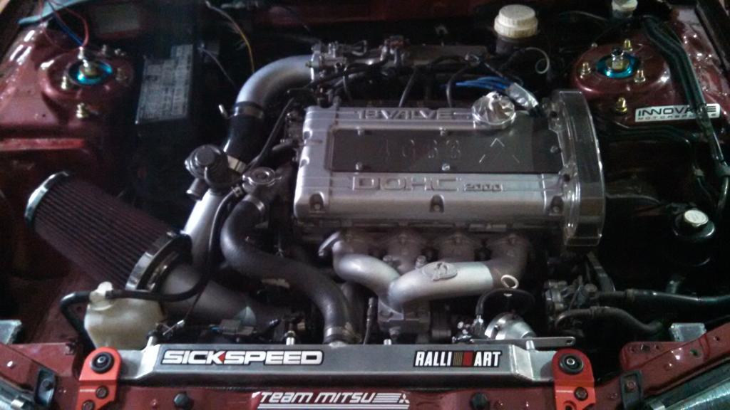

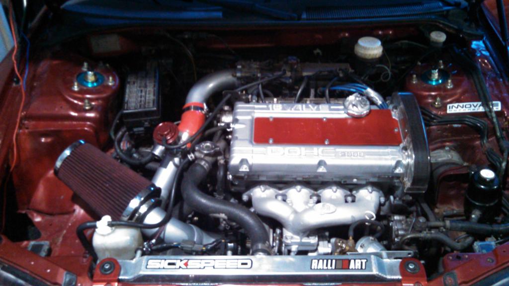

Well the under hood transformation is complete!! I ended up changing the color matching stuff to a darker metallic gun metal. I painted the spark plug cover, 1g BOV top and my Lower Shores MBC. Also finally got a black coupler!
The picture does not do it justice! Horrible garage lighting at them moment. But you get the idea.

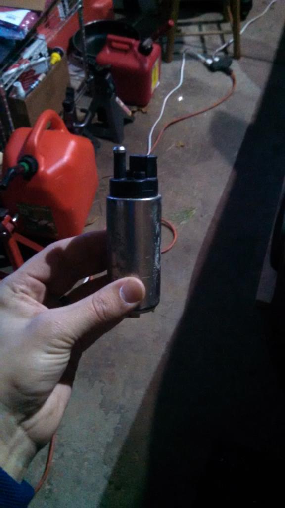

Also picked up a used 255 pump. Traded an unused Turbo XS MBC for it.

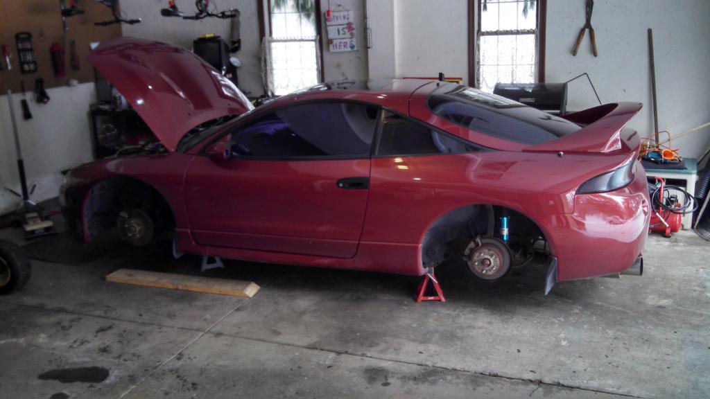

I had the car running for a bit yesterday. Like to make sure she stays happy. Since the car is up on jack with no wheels, I opened the garage up maybe a 20 inches, put a fan right after the exhaust and angled the blades. Shot all the exhaust right out! Worked way to well for what it was. The nice thing, the motor ended up heating the garage up a bit. :thumb:

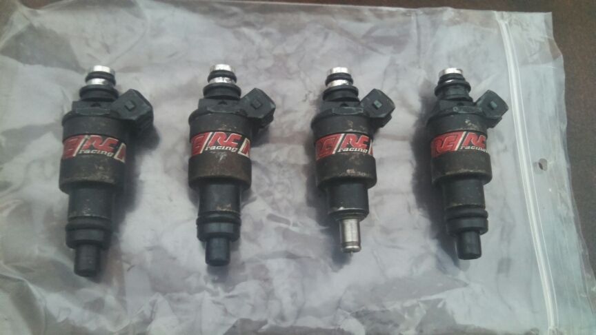

Some of you may have been thinking, why is he going to a 255 when his current setup is stout and perfect. Well, i've made the choice to go E85. Its VERY easy to get in my new state and the 20g on E85 will be a lot of fun! However, my 750cc injectors probably wouldn't work to well. I ended up picking up some RC 1100cc injectors! Got them for a really good price too! Going to clean them up, get some new seals and get ready to make the switch.

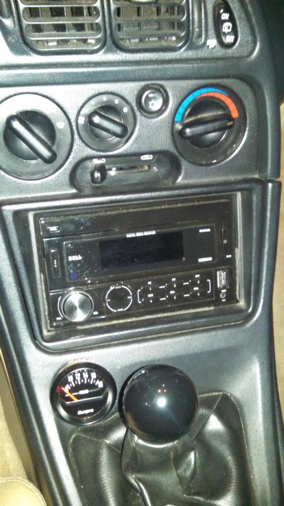

Nice color and the IC pipe look better. In the past update, you post a new head unit BOSS. Dou you have pictures once installed? How it fits?
UPDATE: 2/6/2015
I decided to paint the front bumper support/hood latch piece. The black paint was crap, it was rusty, and looked bad. I threw some left over dark metallic gun metal on it. Looks great.
I cannot wait until spring. These crap garage pictures just aren't doing it for me.

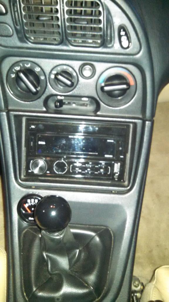

Nice color and the IC pipe look better. In the past update, you post a new head unit BOSS. Do you have pictures once installed? How it fits?
Here are some pictures man. It fits very well and takes up all the space. I like it a lot. Its a nice cheap option for a double din unit. I only use AUX anyway.

So the RC injectors I bought used where no good. Two of them worked great, the other 2, would not fire correctly. After some diagnosing I pulled them out, installed my FIC 750s and she is back to perfect.
The 255 pump is in!! Yay! Feels good to have enough pump for w/e ill be throwing at her.
