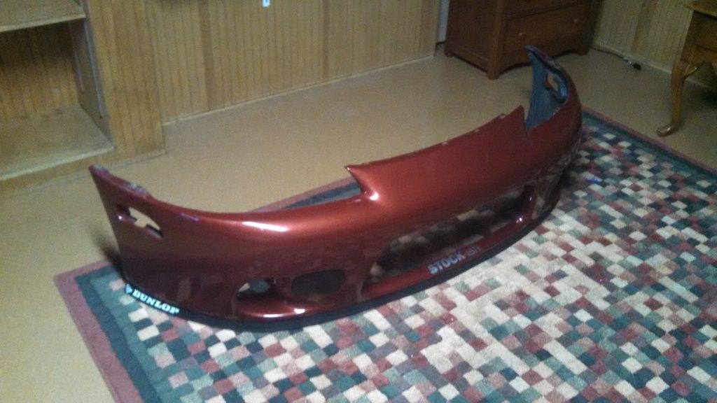

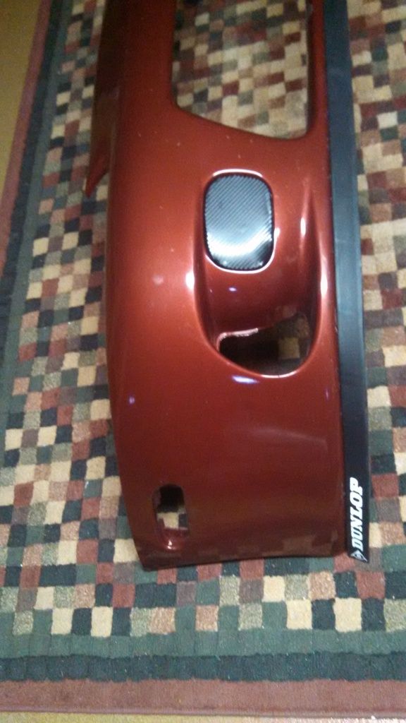

Now I had thought about removing my bumper lip as its only screwed in, but I figured id see if anyone in my local DSM community had a 2ga/2gb crap bumper laying around.
So I hit the FB groups and asked around.

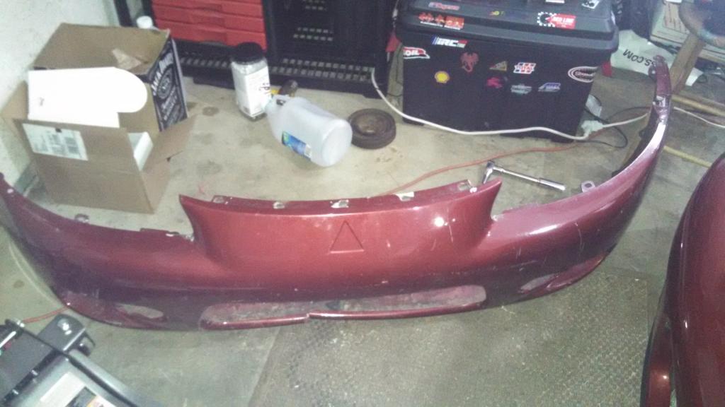

Ended up finding some 1G Talon 16s with some really nice tires and a trashed 2GB bumper for a steal! GET THIS, the bumper is Cayenne Red Pearl!

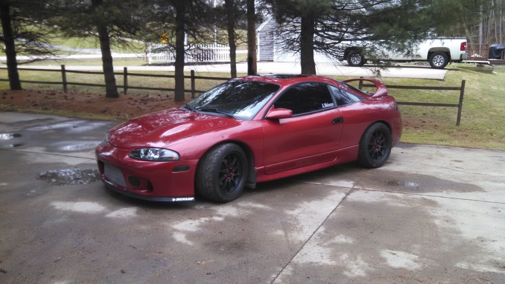

UPDATE: 2/27/2015

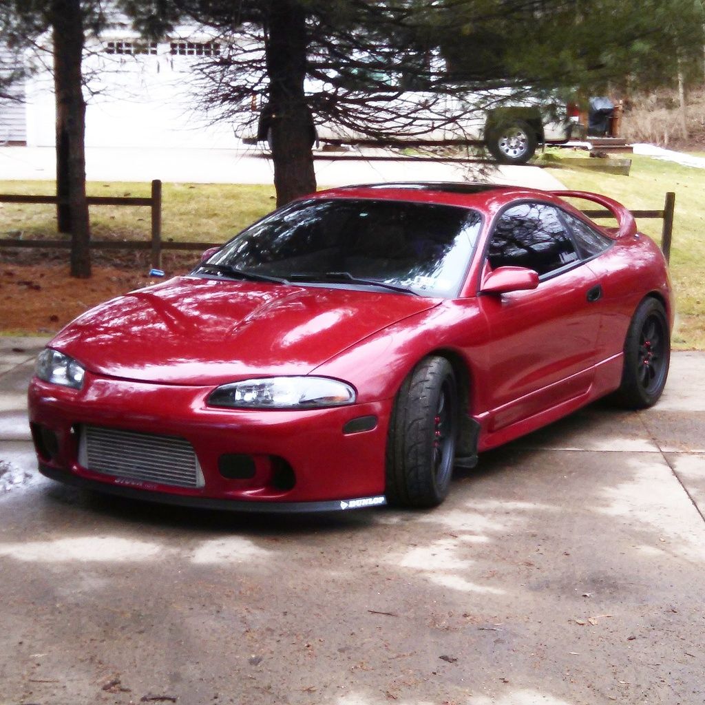

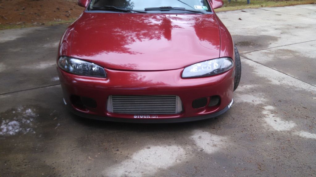

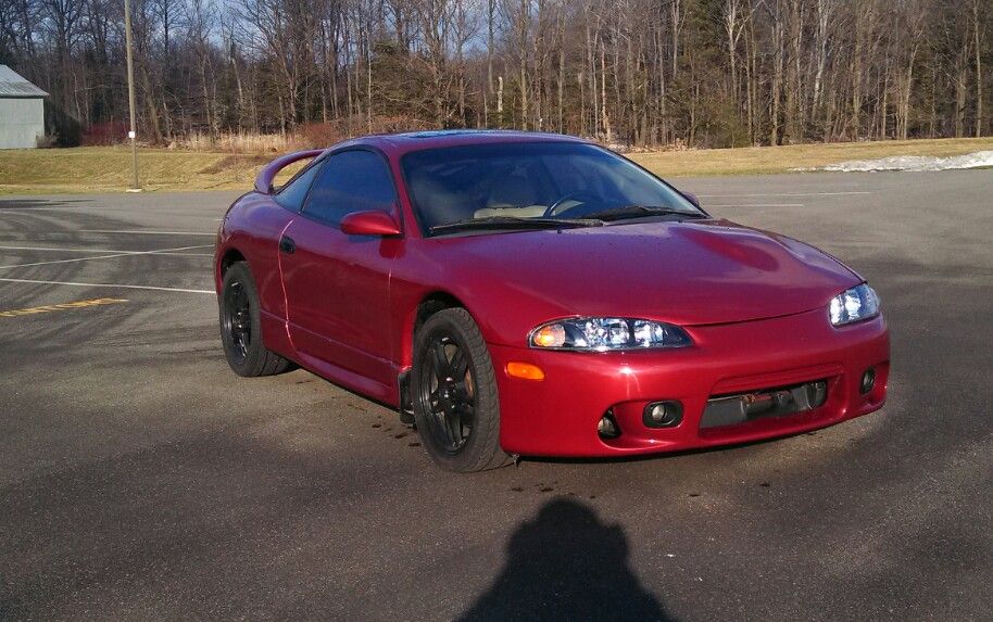

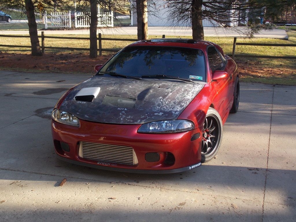

Had the car out yesterday to make sure she was running all top notch. Here is what she looks like in full winter mode.

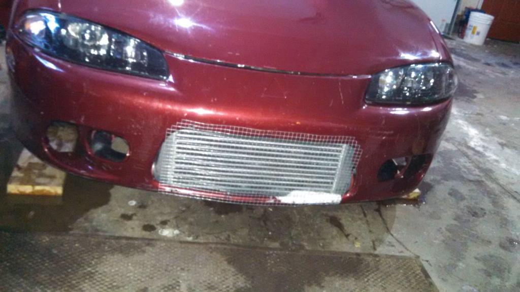

Added some mesh to keep any big things from hitting the intercooler.
Could help but have a little fun as well. :thumb: :eclipse:

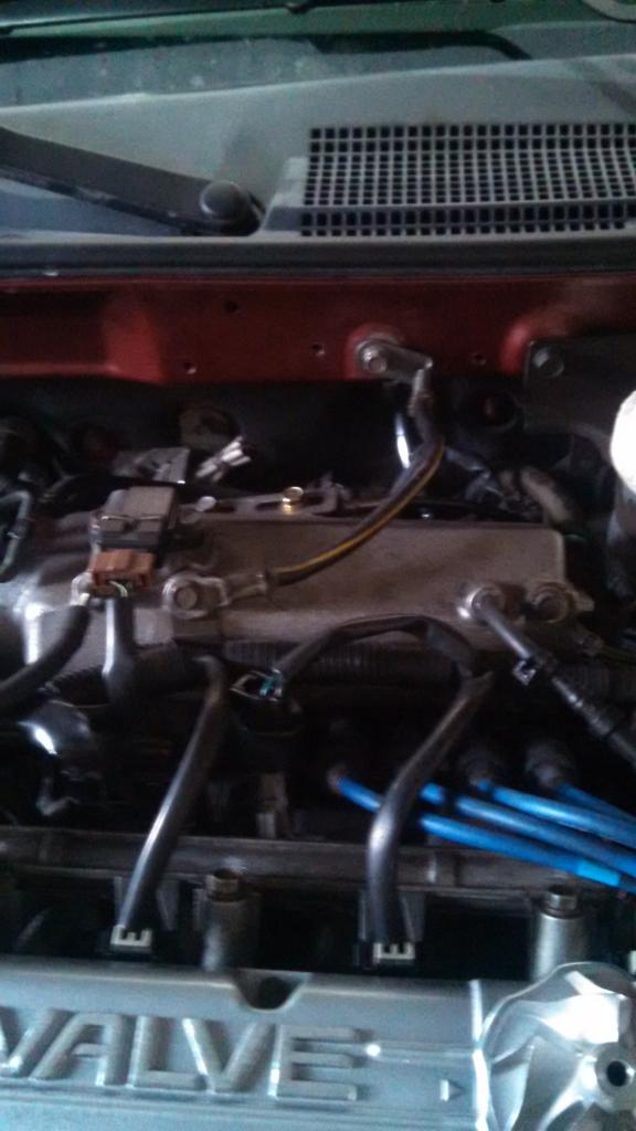

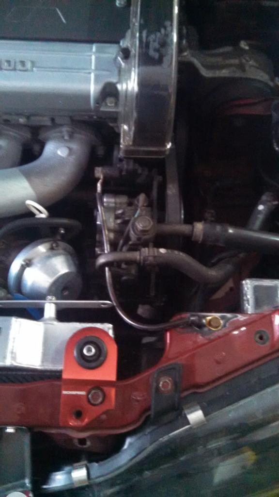

Got around to some tinkering today. Over the past 2 months or so, since putting in my new (used) alternator, I noticed that my voltage drops horrible if I have my head lights on and come to a stop. The belt/alt will start squealing like a pig until I give it throttle to shut it up. When it does this, my volt gauge shows 11ish volts. Normally it stays in the 13.5 volt area.
After some searching, I figured id give a few things a try. A lot of people mensioned making sure you had proper grounds. I unplugged the battery, removed the ground point, re-sanded the connection to make sure it was good. I then added 2 more large wire ground cables from the motor to the body.
First one went from the IM to the body, here.
Second one went from the motor to the body, here.
Upon start up, the car was closer to 14 volts. I let her warm up and them added more load to see how she would handle it. Everything seemed to be working great, up until the fan kicked on for the coolant. Between that, the radio and lights on in full, she fell back down and started her usual squeal. Now this is at idle, so im assuming while cruising things will be better, but I have yet to try that out.

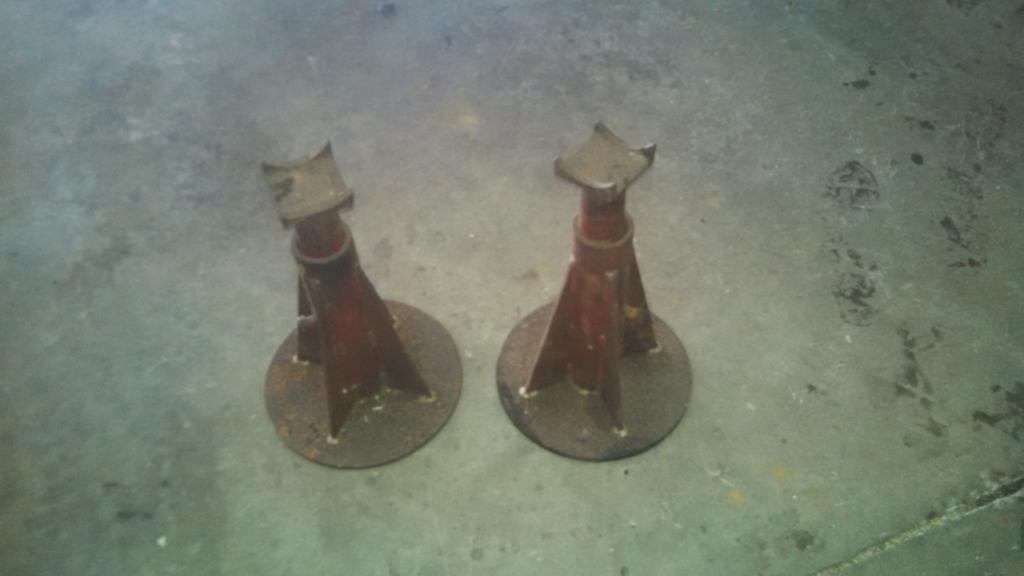

On a different note. My wifes uncle is moving out of his house. After he had everything gone, he said I had free reign to whatever was left. Got to take home A LOT of legit stuff for the house, garage, etc. My favorite find so far was this! These jack stands were made by my wifes grandpa way back in the day! He is a welder/metal worker/wood worker/etc.
I'm going to have them sand blasted, then ill repaint them and use them. They are super heavy duty and weight about 25lbs each. Pretty pumped about these staying in the family.
Where do you have the sense wire hooked up to? I'm thinking it's in the stock location, if so you may want move it. There is a good discussion on the Saturn alternator mod and someone found where that wire was reading voltage from made all the difference. I'll dig it up later.
The aftermarket gauge is hooked up to the ash try light at the moment.
I have been contemplating the Saturn Alt upgrade, or going to a 4th gen Galant alt. Once i'm back on my feet with work, ill be making the switch for sure. When my alt died, I was in a tough spot and picked up a used working 2g unit for cheap from Miller Import Parts.

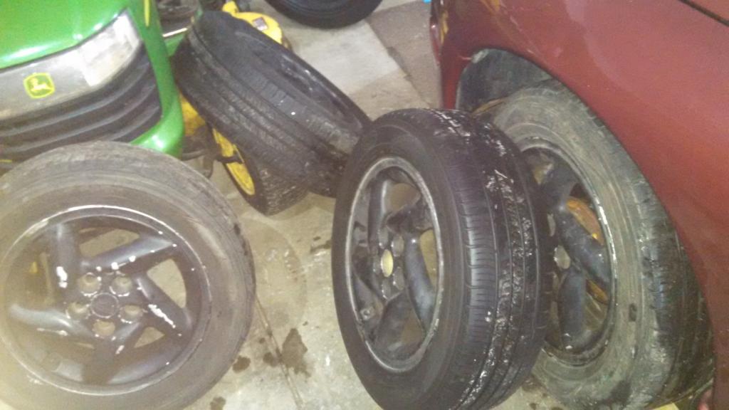

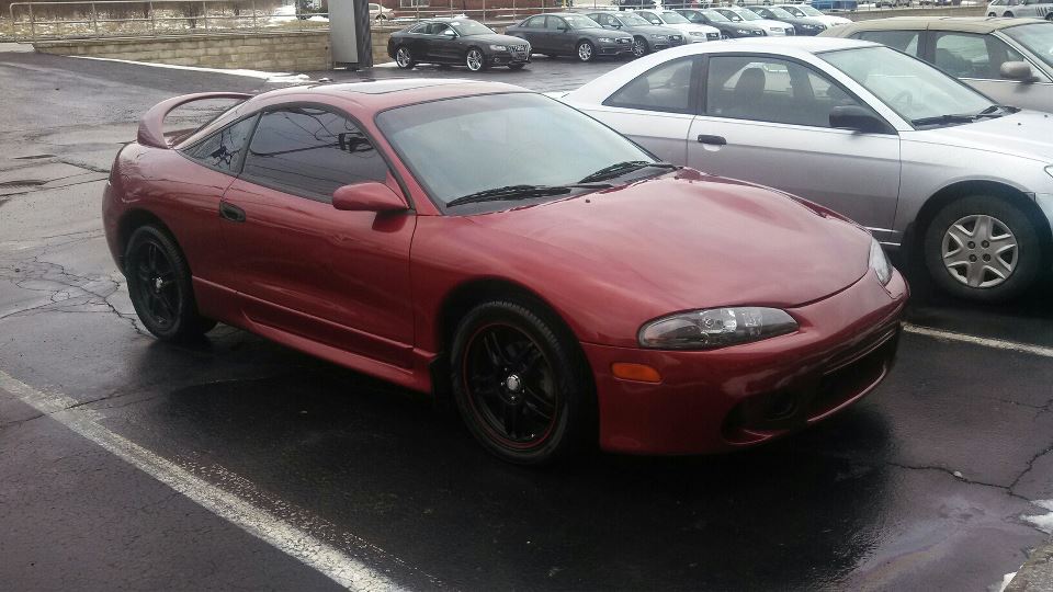

Alright, so Spring is right around the corner and Wendy will be returning to full Spring/Summer Race mode, which means back to my AX wheel setup and the nice front bumper. In an effort to save some more weight this year, I removed my fog lights and covered the bezels in a carbon fiber. Should look really good when I get it back on the car.
You can also see the garden liner lip I made.

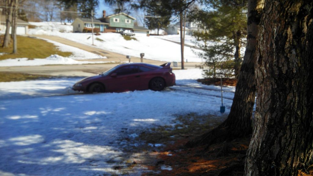

Was being a bit of a hoon in the driveway, ended up beaching her halfway in the yard and half way on the driveway. After a few hours and a quick tug from a truck, she was free. But REALLY muddy. Going for a second bath later today. All my fault.

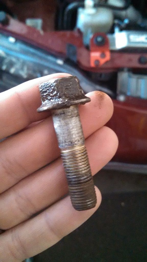

I've been dealing with a really annoying "clunk" from the driver side rear wheel over a hard or quick bump. My initial thought was the coilover. I pulled it off, inspected it and found no issues. I then pulled off the other rear side. Adjusted both sides a little more, added some preload to the springs. I then SWITCHED them, to see if the sound stayed with that coilover or stayed on that side of the car. After a drive, I found out that the coilover switch didn't change the noise. Its still driver side rear. I HATE it. It sounds so "junky". My next course of action is going to be happening today. I'm going to check the entire rear out for anything that looks worn or bad.

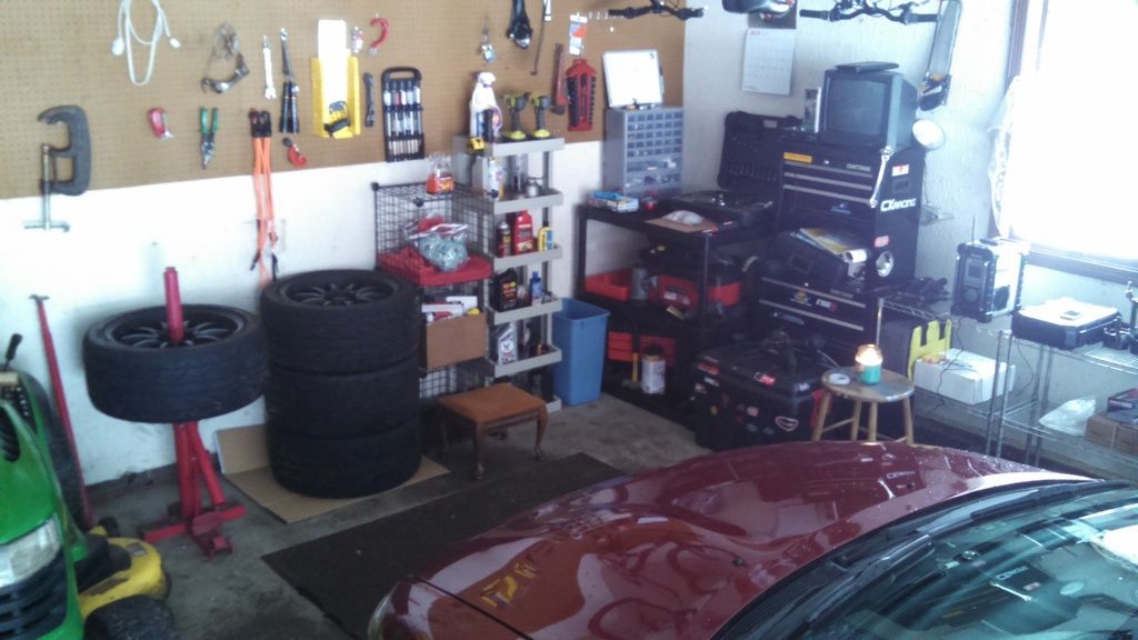

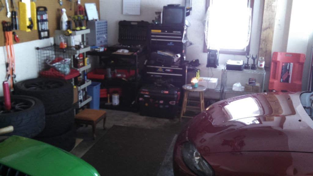

Last but not least, I reorganized my entire side of the garage again. Really cleaned some things up. Once spring is in full swing, ill be building a nice work bench and doing a lot more organization for the rest of it.

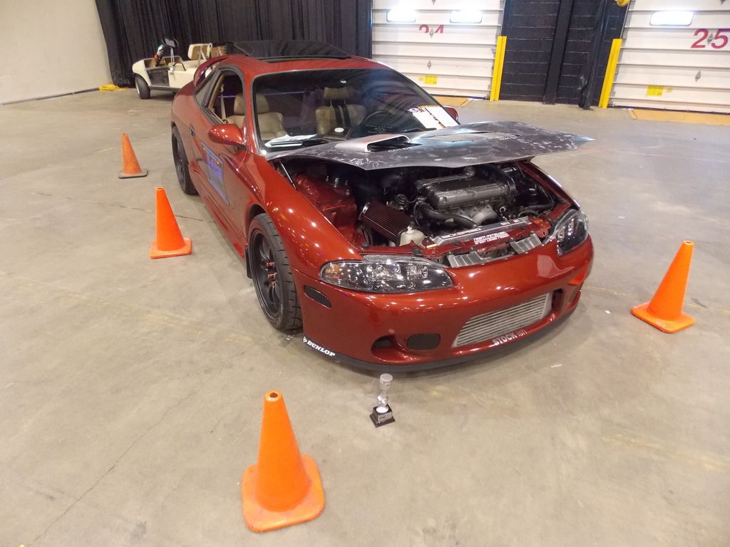

Secondly, I did my first big car show. The Piston Power Autorama! I had never done a huge car show before. And by huge, I mean this thing was gigantic. Cars, trucks, planes, and bikes filled over one million square feet at Clevelands IX Center for the show. I was asked to join the Team Mitsubishi Great Lakes Region (GLR) group display. I had my Dad drive in from NY to attend the show with me, not telling him I was exhibiting. Was great to surprise him like this, as we had always done this when I was younger.
As your obviously thinking, my car is far from a show car. Especially compared to the many cars in the Team Mitsubishi GLR Group with custom paint, audio, video, body parts, etc. So I decided to represent the racing side of the equation and changed Wendy into full race trim. My SCCA Autocross magnets, stripped interior, my custom race hood, and I finished it off with my SCCA recognition on the dash from last season. I even put some cones around the car for that AX theme.
Anyway....the judges came around before the show started and classed all the vehicles. I was classes as a "Production Road Racer". Which I thought was perfect and very fitting.
Now I was already very happy about the judges understanding my theme and all of the positive feedback about the car from people attending the show, so when the awards ceremony came around on Sunday, I was DUMBFOUNDED when they called my name! I took 2nd place in Production Road Racer!!

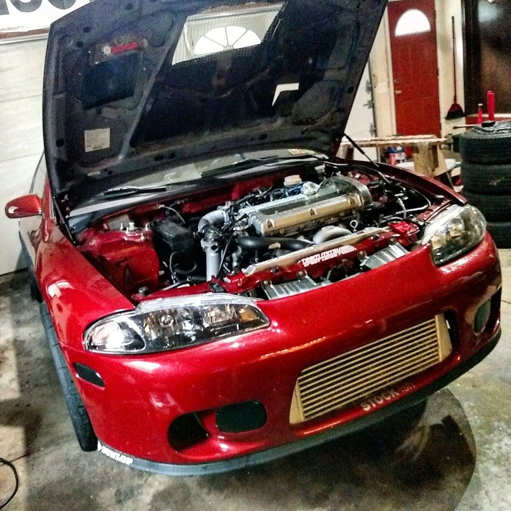

Now that I have a new DD. Wendy will be getting taken apart for some much needed maintenance, upgrades and pre-race season prep!
Im very excited for this season. Having Tammy gives me the opportunity to push Wendy harder and further on course, knowing I have a tow vehicle at home if needed.

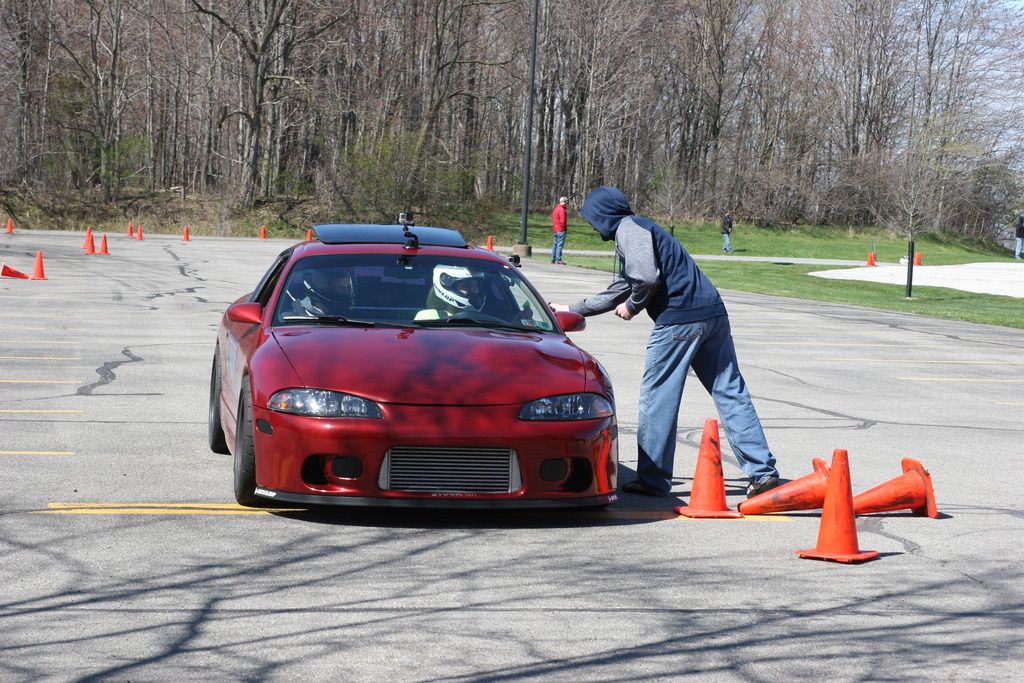

Yesterday was my new SCCA regions Test & Tune event at Lakeland Community College. 76 Cars showed up and one F-Mod racer, to brush the dust off and try out new settings for the season.
After 3 runs, I had the fastest time of the day! By the end of the event, each car got 5 runs total and I came in second for the day with a time of 46.900, which I ran twice. I was bested by a well built/modded BMW 1 series. Which I’m not upset about after seeing the car up close.
I had a lot of people asking me questions, no one could believe a Eclipse GSX was doing what it was doing. My buddy Justin came down from Erie to hangout and ride along since his car is still under construction, waiting on some back ordered parts.

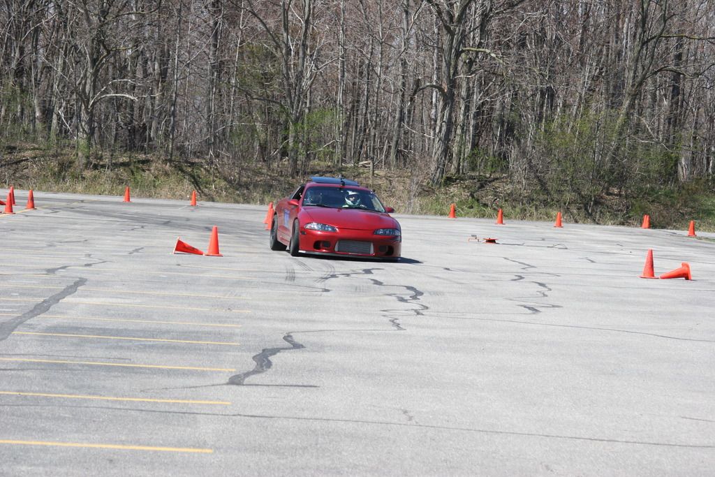

Well, I traveled to my old SCCA Region for their season opener this past weekend.

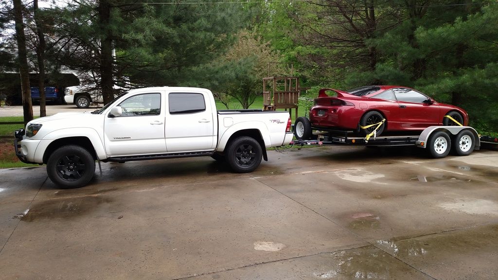

Check out my race rig!!
Got a couple pictures from the event.
Here's my 12+ hour race day, confined to an 8 minute video.
Quick video of my fast hands save.

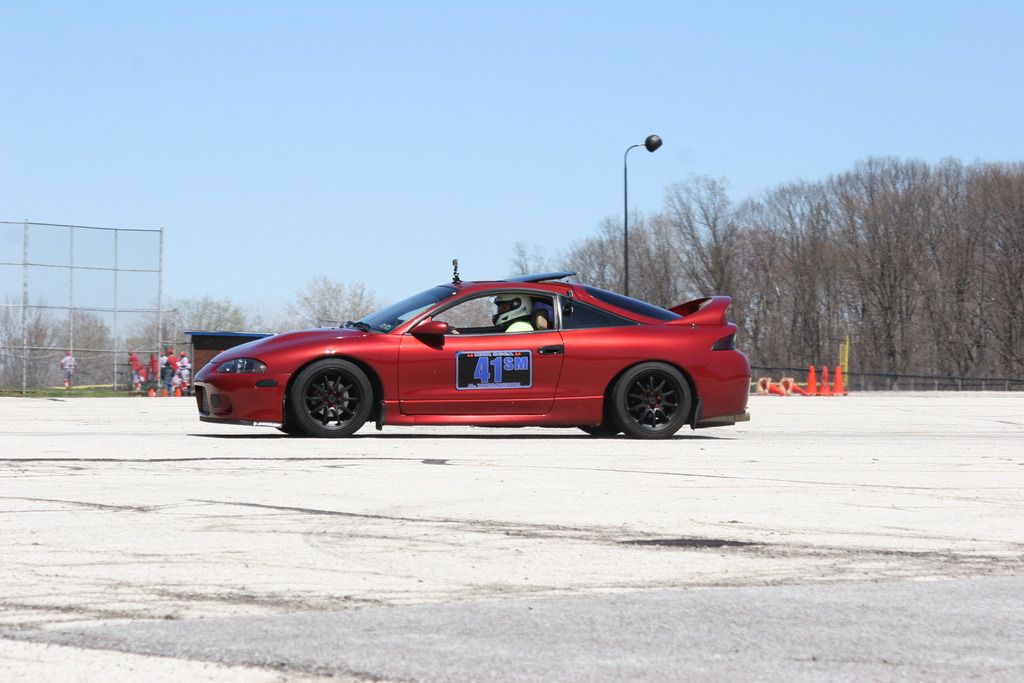

All in all, we have 13 runs total. The course was set up to be very fast and very short, as were had been worried about weather for the day. This would allow us to get as many runs as possible before the rains came. FORTUNATELY, we had NO rain and it was a beautiful day. Which is why we were allowed so many runs.
At the end of the day, I placed 3rd in SM, behind an ASP EvoX and a fully built 550+hp STI built for road course.
Overall I had the 3rd fastest time of the day. My fastest run was at 25.873 seconds. Only 4 cars broke into the 25 second range. Myself, the built STi, a race prepped 89 Civic Si and a 350Z.

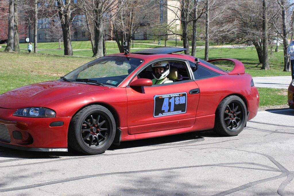

This past weekend I traveled back to my old region for their 2nd points event. I chaired this event and designed the course. Which was liked by all.
This season, the SM Street Tire class is becoming SUPER competative! We had 11 entires and the time difference between the 1st place car and the 7th place car was 0.70 of a second. & cars all fell in that range. Some were as close as 0.015 of a second!
I ended up taking 6th in SM with a best clean time of 49.5xx. My first run of the day was a 49.0xx but I had a single cone penalty.
Unfortunately I could not find the speed again and run that 49.0 or faster.

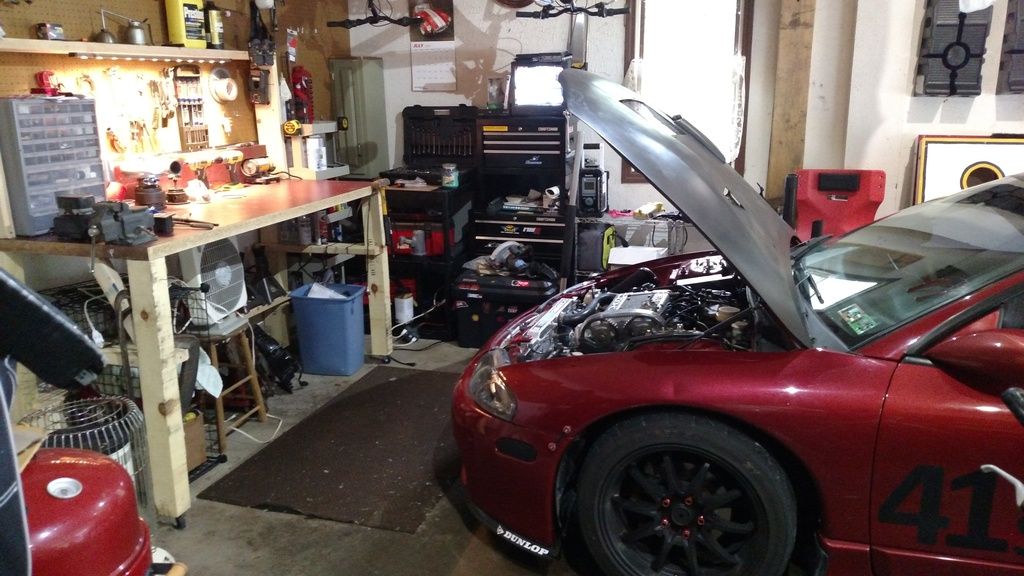

Really enjoying my make shift work bench! I put this together out of an old solid door a few weeks back. INstalled an LED light bar I had laying around. Made an upper shelf, mounted a power strip and some small things. Bench works great. Also set up and old 13 inche TV with a DVD player. Whenever im in the garage, I have either a ShootOut video playing or one of the Fast N Furious movies. haha.
