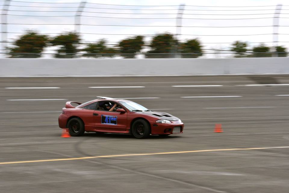

Only got one good picture of Wendy in action.

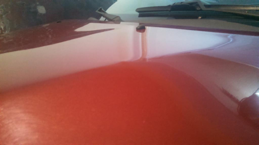

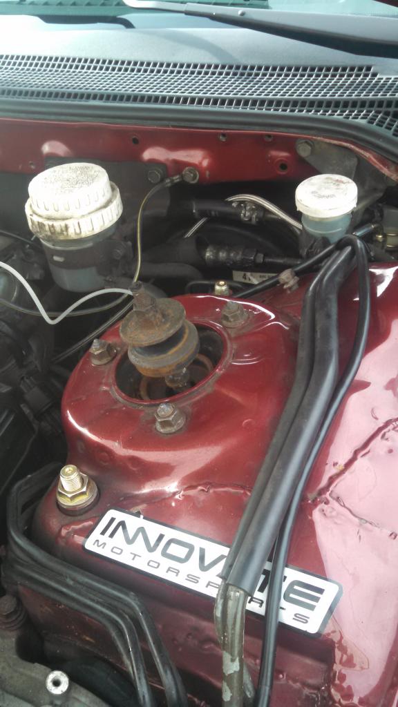

I blew the front strut right through the mounting top plate. It stopped when it hit my hood. :(
Hard to tell in this picture, but there is a nice little pimple in the hood now. :sosad:

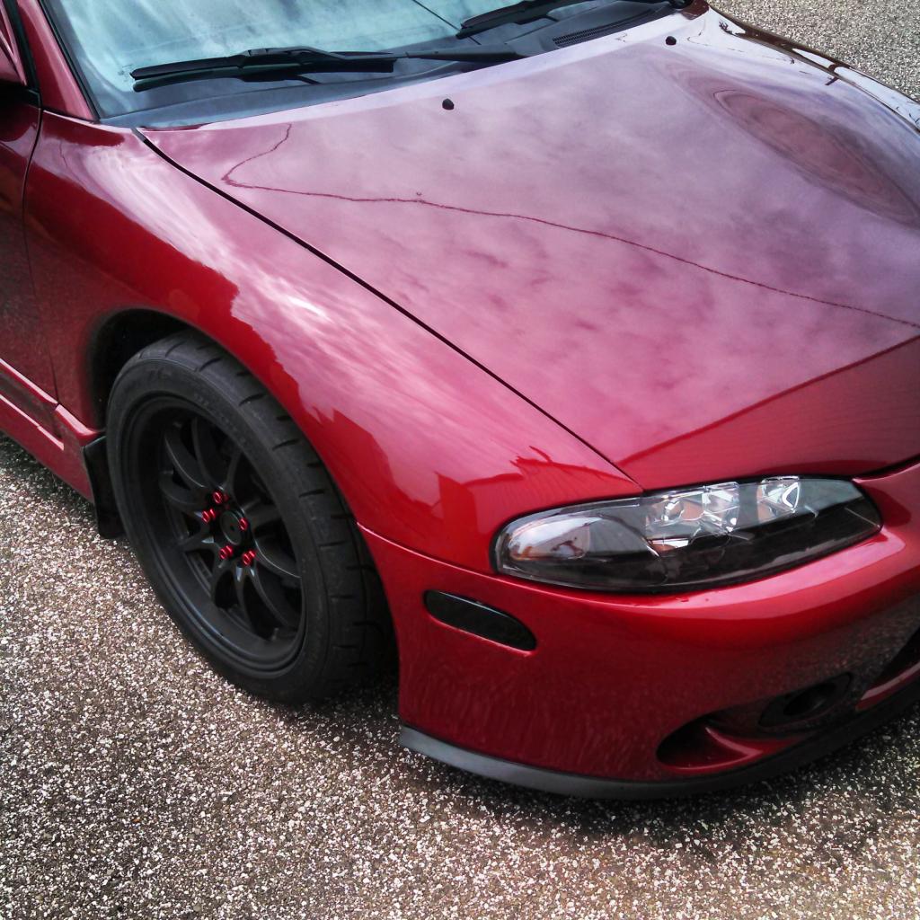

We have been having some awesome thunderstorms lately. So I snapped a ncie instragram picture yesterday. For some reason, I love the way this sky reflects off the hood.
Instagram: aa_wolo

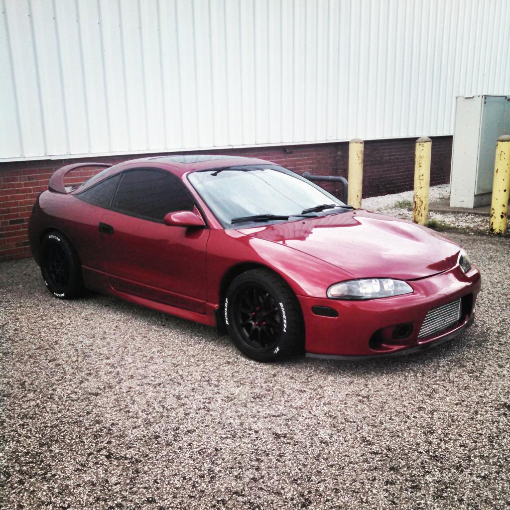

This is how Wendy looks currently!

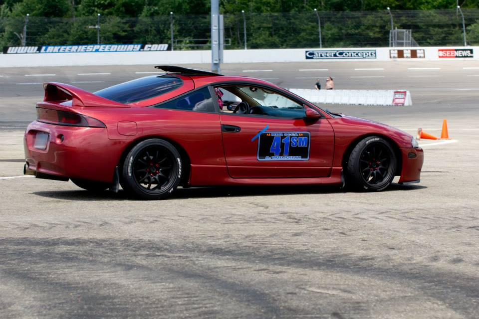

Had our regions 3rd AutoCross event this past Sunday. Had a LARGE groupd of cars show up and we had amazing weather. Was a great day.
My best run of the day was a 47.0. Only had time to get this picture. My buddy Justin next to me. DSMs took 1st, 2nd, and 3rd in SM again this event.

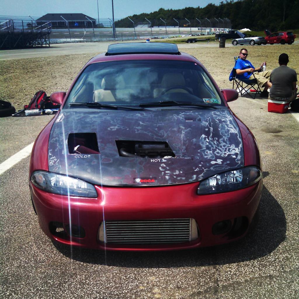

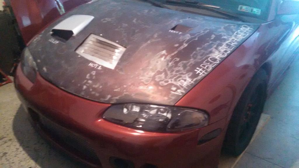

DSC08299r_2_zpsff7ac680.jpg[DOUBLEPOST=1410543232][/DOUBLEPOST]Also wanted to add that I made a "Custom Race Hood" for AX and track events.
Yes, its rough and some may say ugly. But I did it all by hand with a angle grinder.
BEST PART, it dropped my intake temps over 20 degrees! Which on our our hot 80+ days worked perfectly to keep the car running smooth and knock free.
Let me know what you think.

The final product with the scoop!

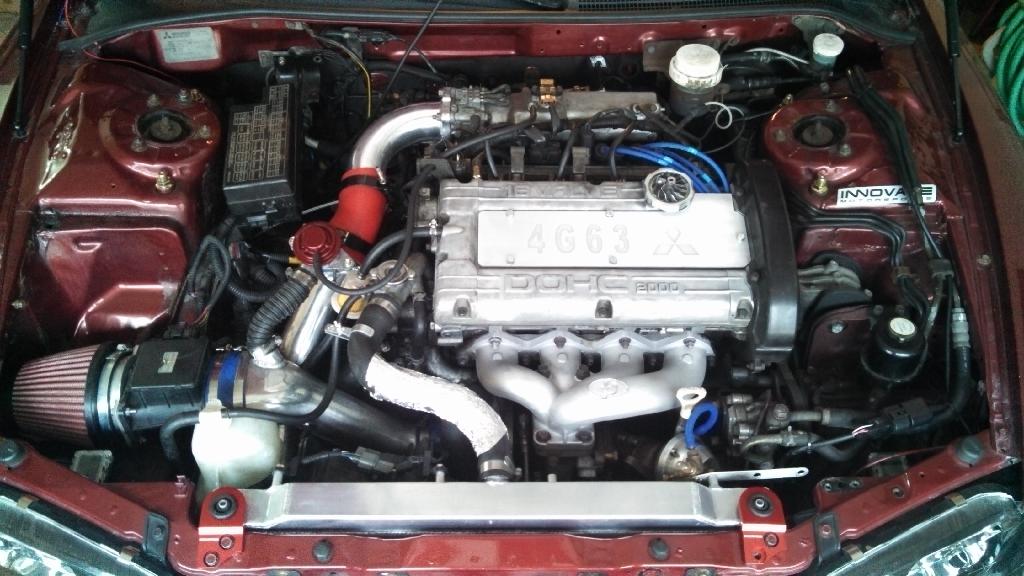

I fixed my boost leaks! Ended up having a pretty good one at a injector seal. I took out my stockers and installed my new FIC-750s. Tightened everything up, did another BLT and everything is good. Just have a very minor leak the the TB shaft.
Here is an updated engine bay picture. Its not the cleanest looking and I still have a number of different colors, but she works and works well.

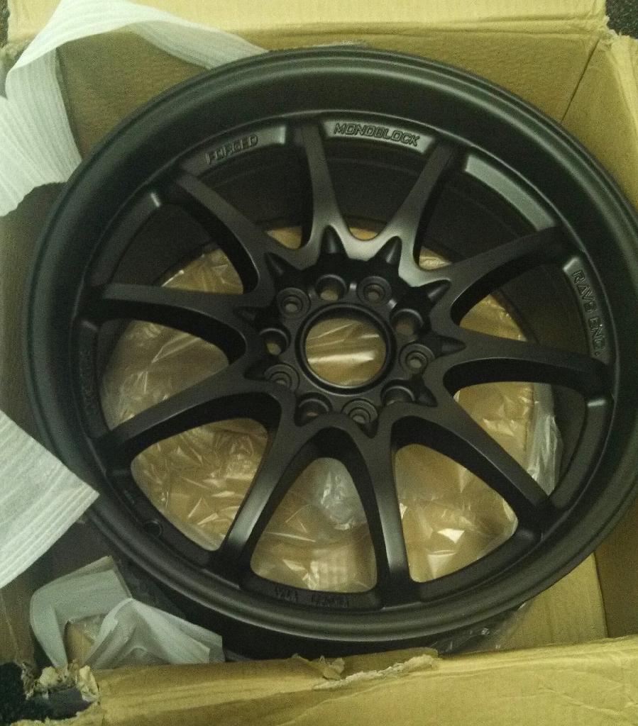

I also ended up having my wheels delivered yesterday!
They were on sale and I couldn't pass up the price, 17x9 with a +35 offset is exactly what I was looking for. My meaty 255 tires are being mounted today/tomorrow and ill be throwing them on the car by the weekend.
