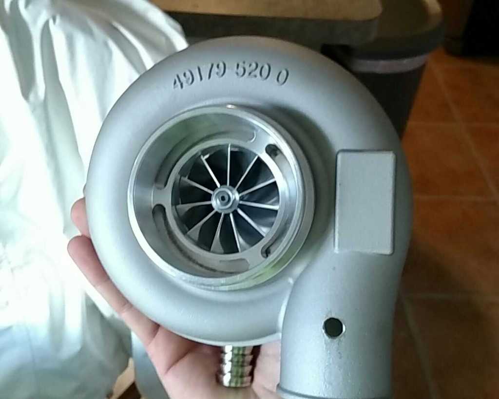

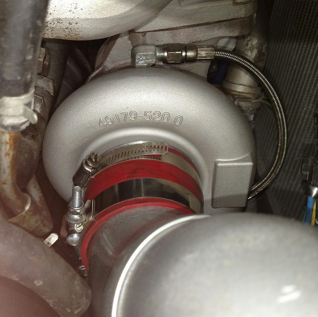

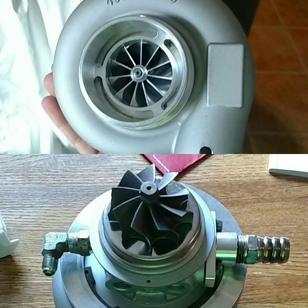

The billet rebuilt 20g is in! And god does she look beautiful!
- 11-Blade Billet Wheel
- 9-Blade TD05h Exhaust Turbine
- 3” Anti-Surge Compressor Housing

I need to address a few small issues and then I’ll be taking her out for some runs and some tuning time.
I have all of my data logs from the previous cast wheels, so I hope to do a direct comparison between spool characteristics, boost build up, etc.

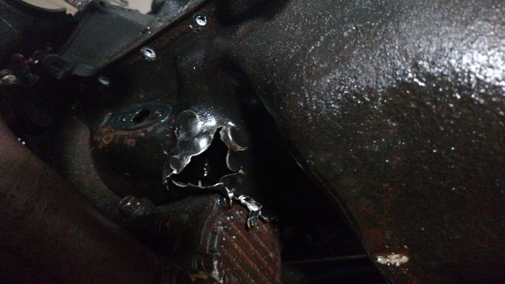

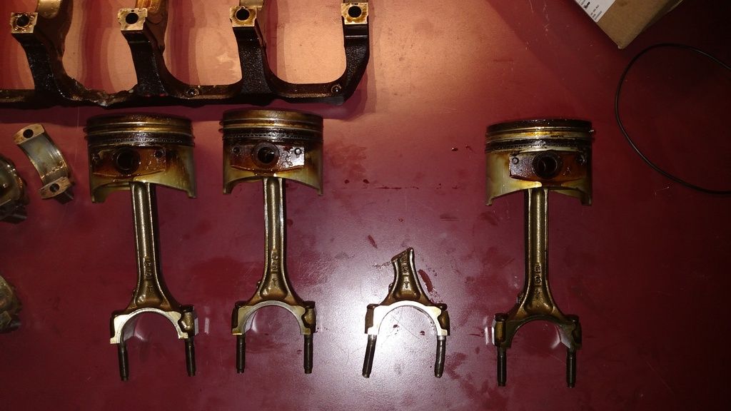

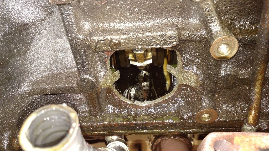

It is with a heavy heart that I bring this news to those of you following my build. Against my better judgement, I took Wendy out last night. I had not driven her in some time and just wanted to feel the power.
In a nut shell, the bottom end has let go. I have no one to blame but myself. Hindsight is 20/20…I should have left her in the garage, I should have turned the boost down in the 20 degree weather, etc. I was logging my trip, turns out, before she went boom, AFR was at 13.7, 28psi through the new billet turbo, and timing was at 20 degrees. This was 70% throttle. Seconds later, explosion, shrapnel, smoke, smell, death…
I will get some more pictures today. But for now, I’m trying to think over my options and I’m hoping the damage was only done to the bottom end.
Here’s to a long winter….
IMG_20151122_210750937_zpsu7svhzmi.jpg[/URL
[URL=http://s285.photobucket.com/user/awolo/media/Mobile%20Uploads/IMG_20151122_211938757_zpsjo1xpsp2.jpg.html]IMG_20151122_211938757_zpsjo1xpsp2.jpg

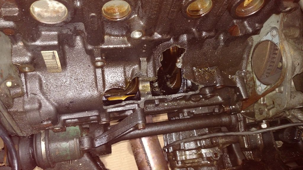

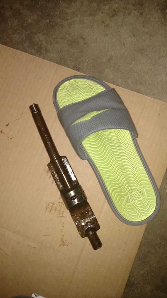

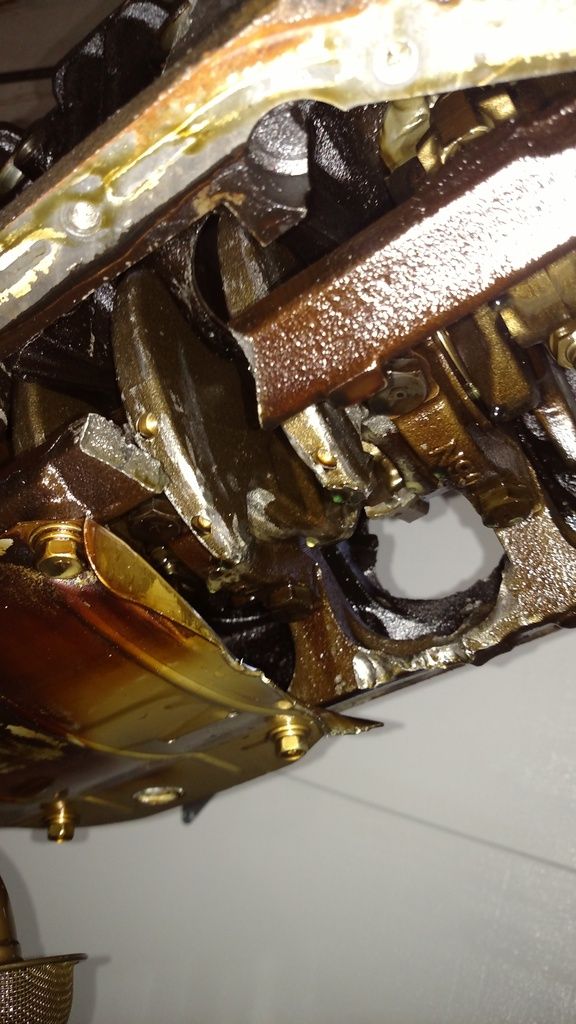

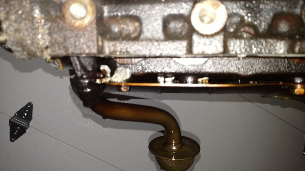

On to the “problem”. Check these out. The balance shaft was sitting outside the back of the motor. I just reached down and pulled it out. Not sure what to think on this one….
IMG_20151124_171817170_zpsy96p5kfd.jpg[/URL
I wear a size 12.
[URL=http://s285.photobucket.com/user/awolo/media/Mobile%20Uploads/IMG_20151124_173337253_zpsucwm5sw5.jpg.html]IMG_20151124_173337253_zpsucwm5sw5.jpg

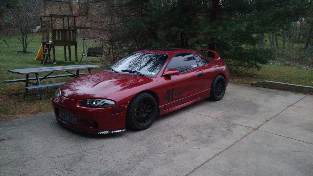

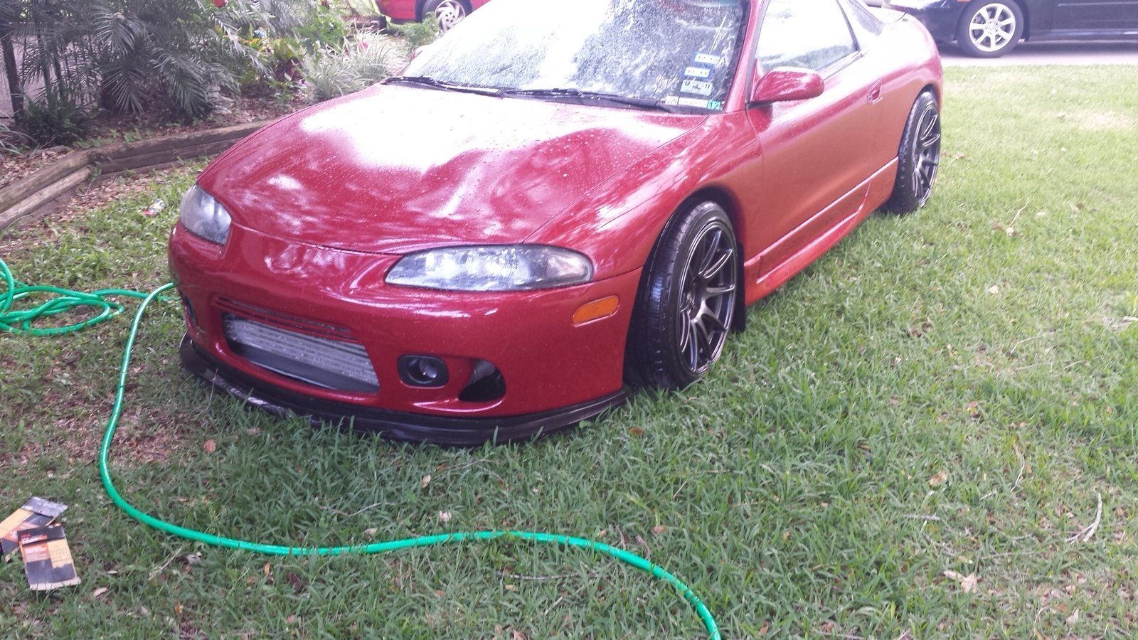

At least she still looks good…
IMG_20151123_171433769_zpszjioliun.jpg[/URL]

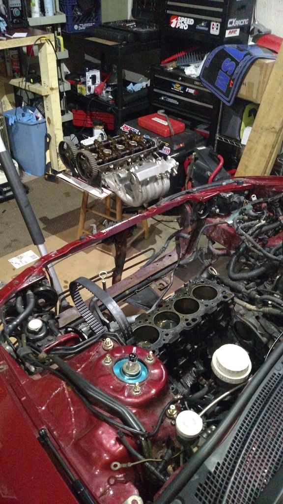

UPDATE: 12/11/2015

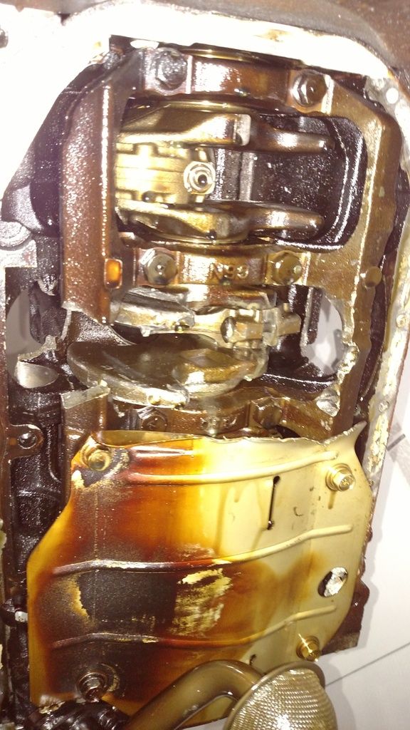

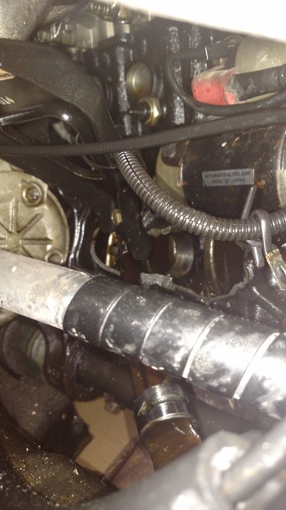

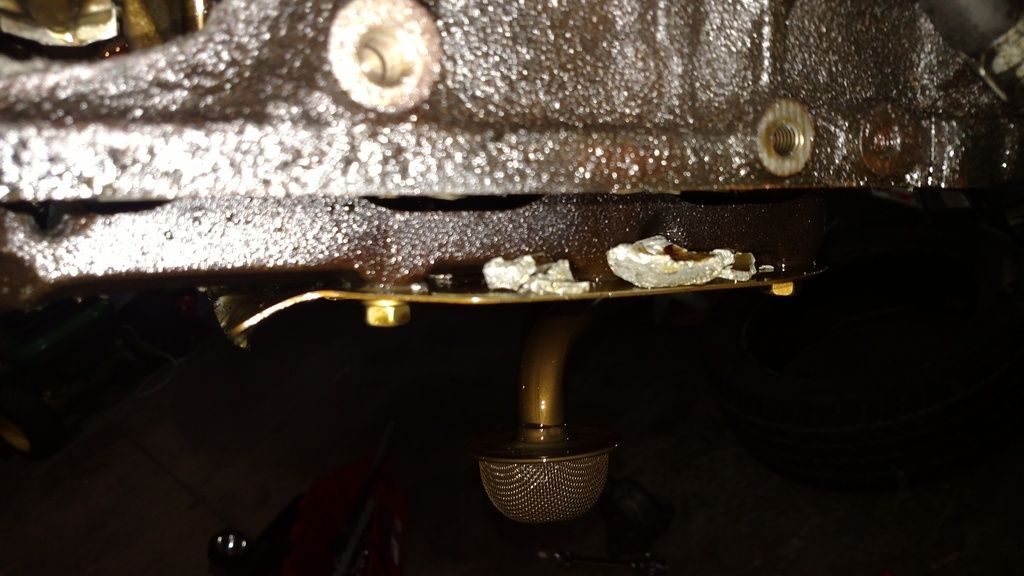

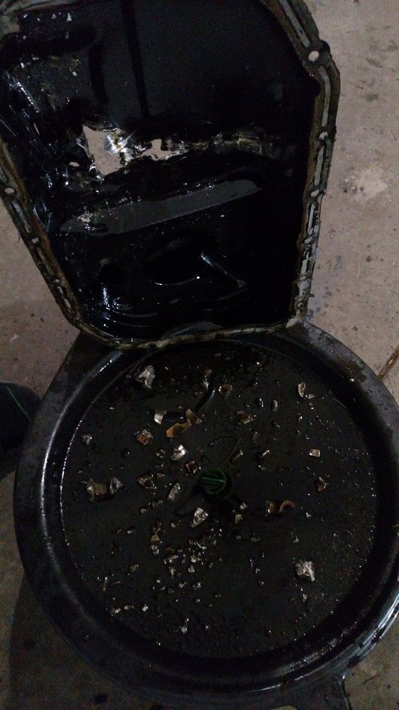

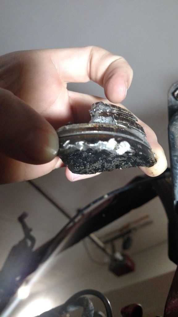

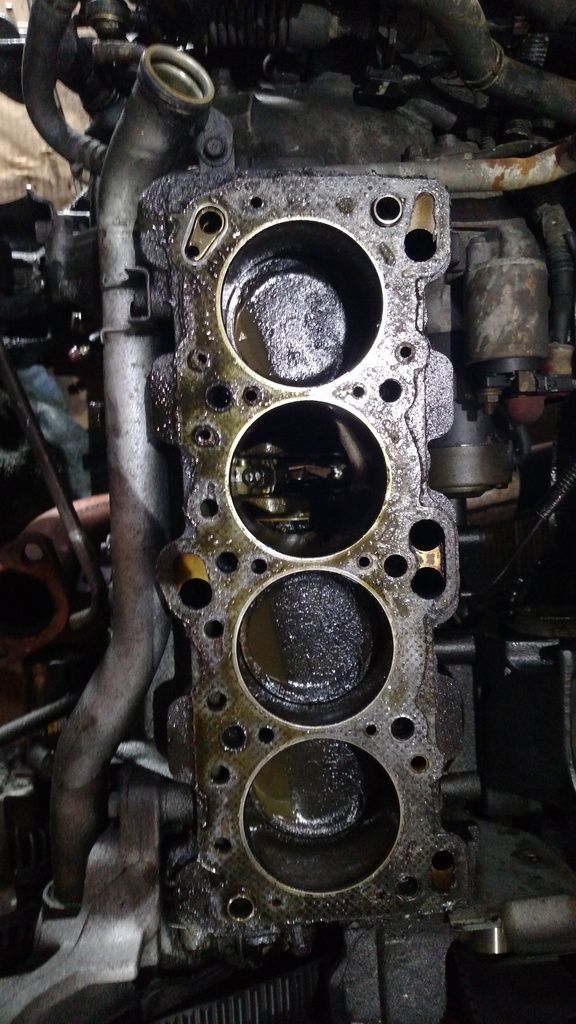

Getting closer and closer to pulling everything out of the bay. Trying to get the T-Case off, looks like the pan is…well….look for yourself.
Found my piston!
I’ve been hitting the pan with a heavy hammer to bend it back up so I can get the T-Case off. Every time I hit it, chunks and pieces of the block, piston, cradle fall out.
