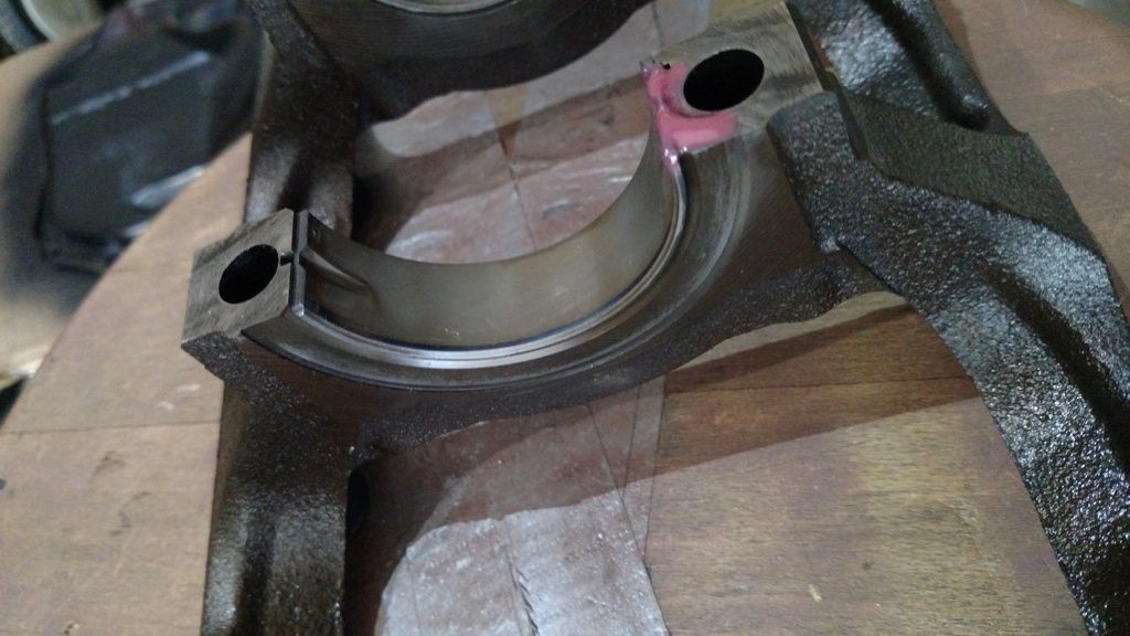

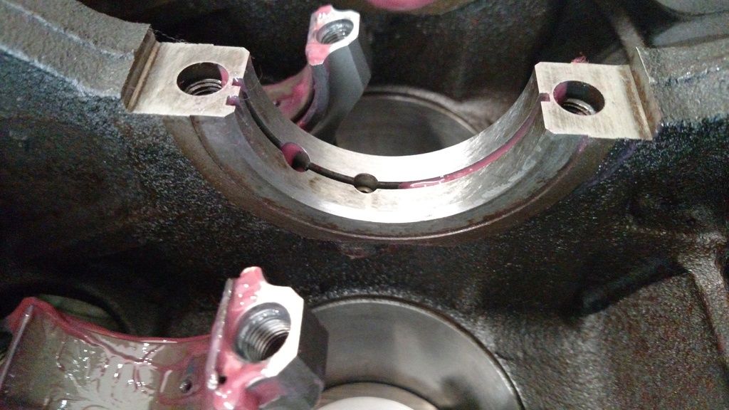

Right now, my biggest issue is thrust bearings/washers. Here’s what’s going on. My bearing set didn’t come with any thrust washers or thrust bearings, which is an oversight on my part I believe.
Now…I’ve been reading all morning and I’m more confused and very worried. On Saturday when I started the build, the had to remove the main thrust bearing from my girdle, this was the SINGLE piece bearing and it was on the GIRDLE. Doesn’t the thrust bearing go on the engine side?
When I disassembled the block, memory tells me that it had the thrust washers, 3-piece bearing, on the engine side.
But everything I’m reading says its either one or the other? So I’m confused as to why it had both? Or my memory is reminding me of the original motor I tore down, or the 4g64 (but idk is n/t 4g64s had a split thrust?)
And to make things worse, I ordered ACL Main bearings for a 97-99, but I know think this block is an earlier 97, based on the single thrust piece bearing I pulled off the girdle. And I was told I cant used 97-99 main bearings in a 95-early 97 block…

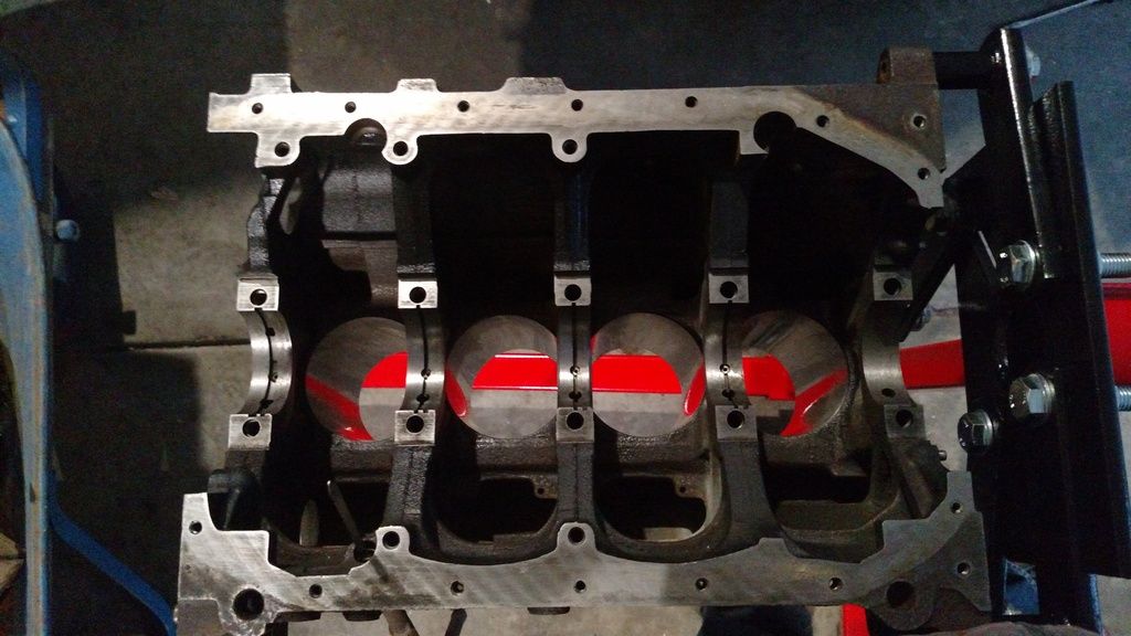

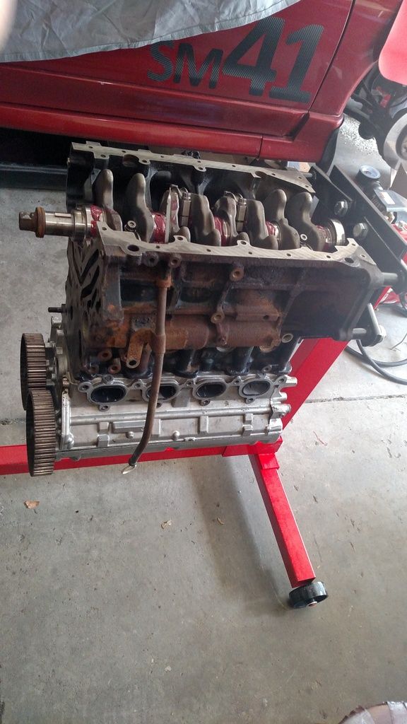

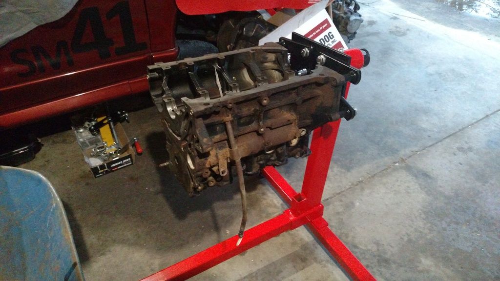

Well, I tore the block back doen to make sure I got the answers I needed.
Girdle
Block
Looks like I do indeed have a early 7-Bolt block

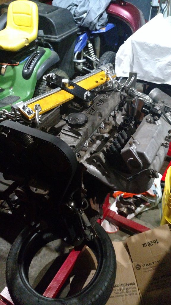

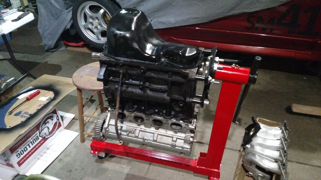

Okay, so I got the correct bearings and I decided to do a BSE as well. Those parts came in yesterday. I have torn the block back down to nothing, besides the head studs. I plan on doing a complete clean and get it all ready for round 2 of the assembly.

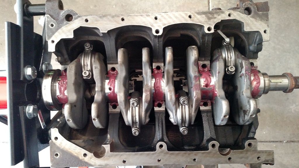

I woke up early on Mothers day to finish gapping my new set of rings and to get the pistons/rods installed before the family came over. So the rotating assembly was complete, and then I started rotating it…
After checking everything, re-torqueing, swearing, crying, beers, talk with DSM people, internet searching, more beer….it turns out I have a piston slap problem. Watch for yourself.
Hear that noise?
This is that noise…

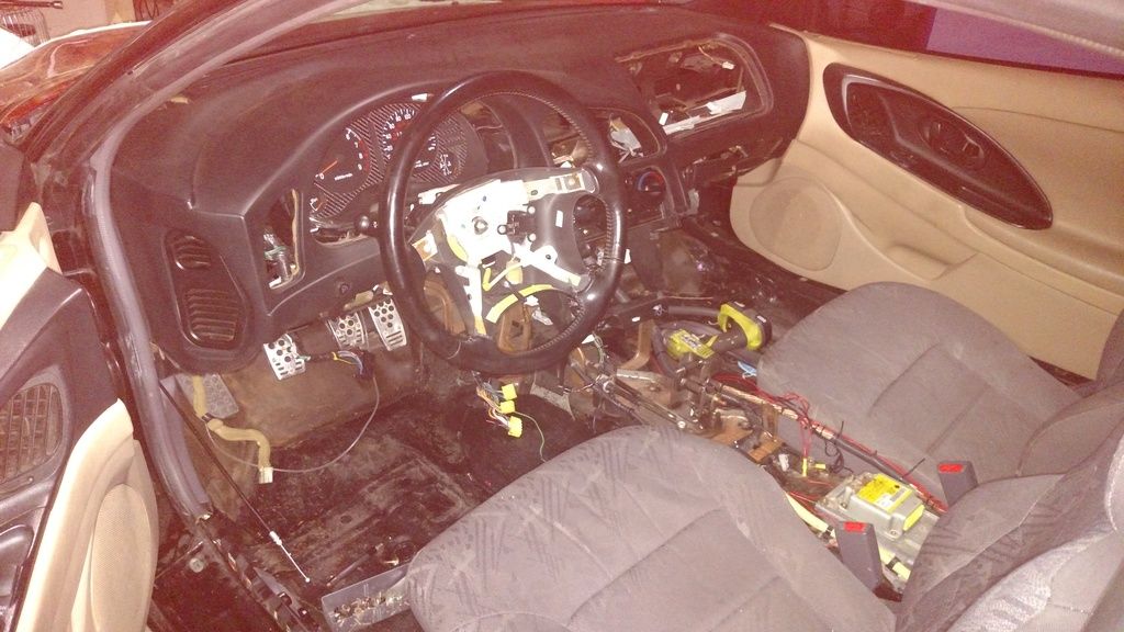

Wendy and I have parted ways over the weekend. Between my motor woahs and being made a very good offer on her shell and AWD parts, it just seemed like the smart choice. I spent about 14 hours stripping her of everything I wanted, which was quite a bit actually, and got her ready for her new owner. I’ve kept everything I feel necessary and have started to sell off parts that aren’t essential to a new build.

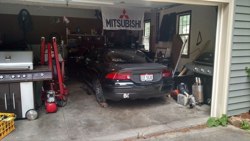

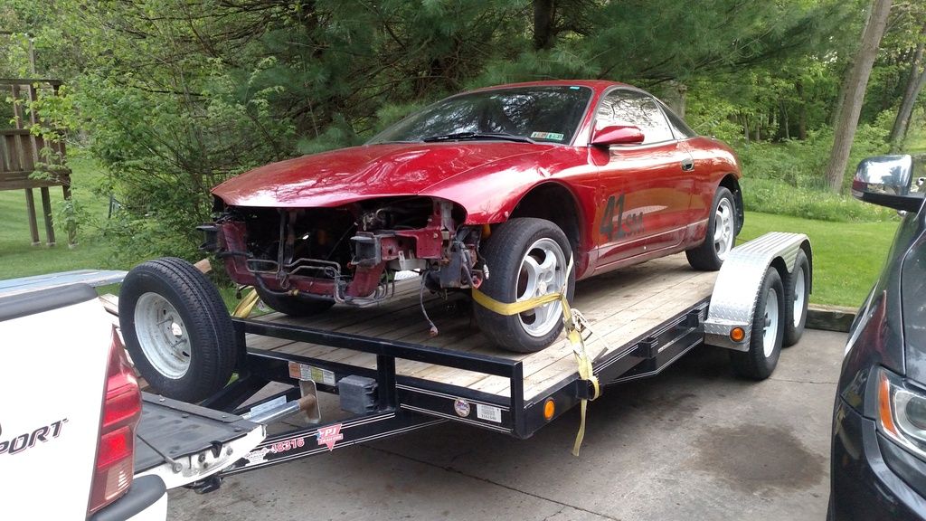

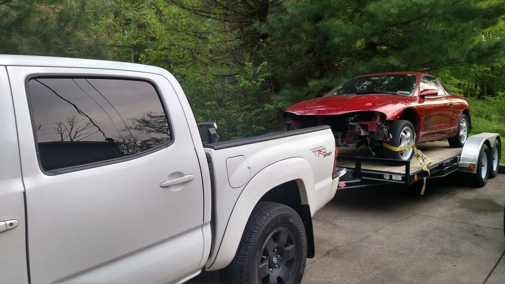

Well, here she is! I picked up the shell a few weeks back and have been slowly organizing everything and trying to come up with a game plan for the build. So far, my goal to build a running, driving, racing car for the ShootOut. As you’ll see the in the photos below, I have a lot of work ahead of me.
Loaded up!
In the garage.

I picked up a running 7-Bolt to drop into the car. I’ll do the water pump and all the timing of course.

Basically, yes. Looking back through my build, you will notice Wendys shell was getting very rusty in some bad spots. Besides the strut towers, the passenger fender had a softball sized hold in the top, at the back. The driver side motor mount back plate was almost gone and the rear uni-body where the subframe mounts are were not in the best shape.
Soooo....I was made an offer on the shell with the AWD parts for a Spyder swap. I took the $, knowing about this Talon for sale for at a GREAT price with a TON of parts to go with it.
Not to mention, this black AWD shell is completely rust free! And has a large amount of work done to it. Now as you can see, it needs a lot of work still, but the positives outwhey the negatives. And with everything from Wendy, I have everything I need to assemble this DSM.
