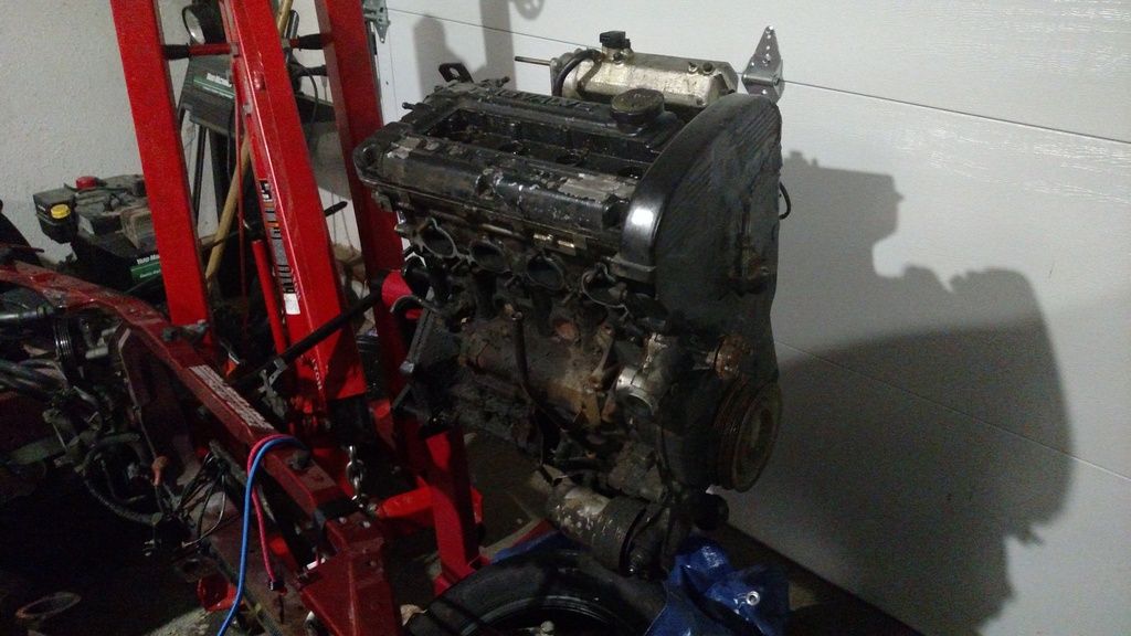

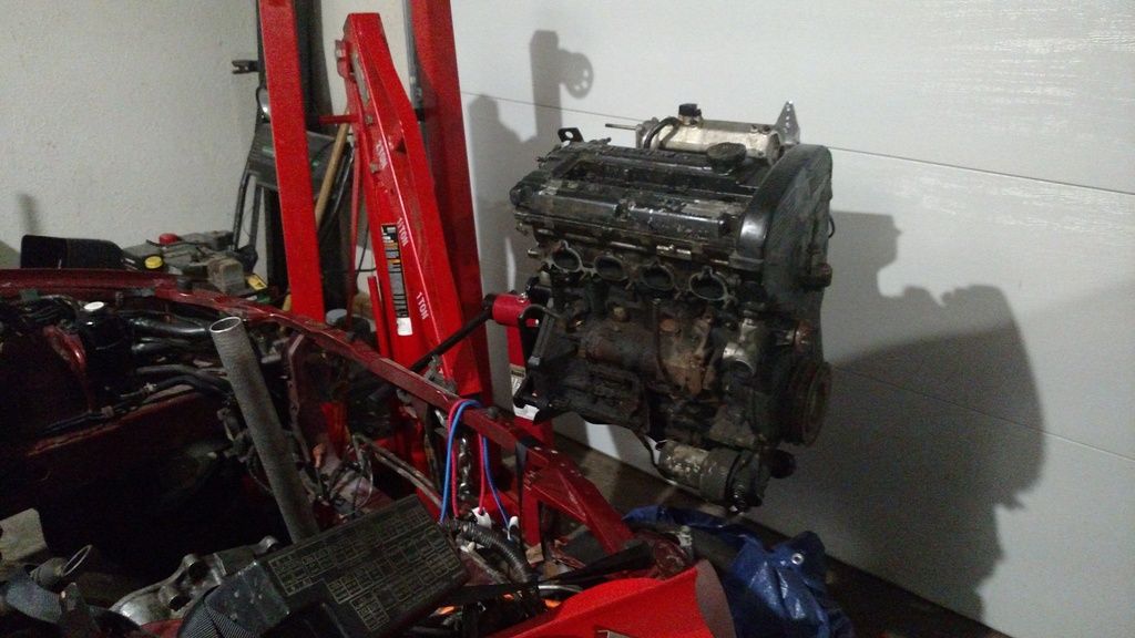

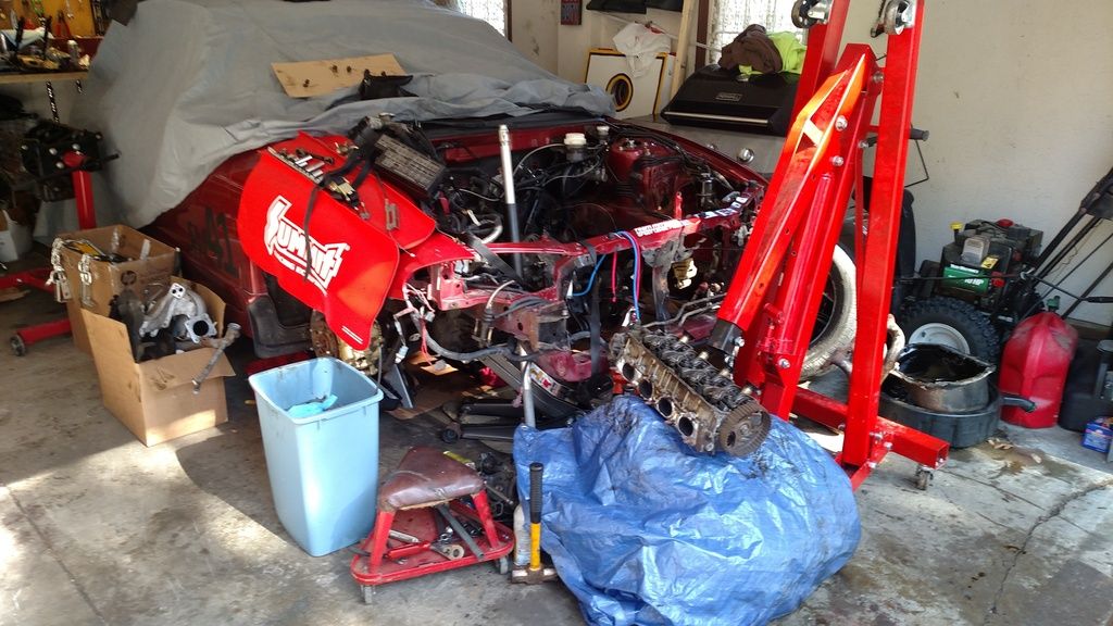

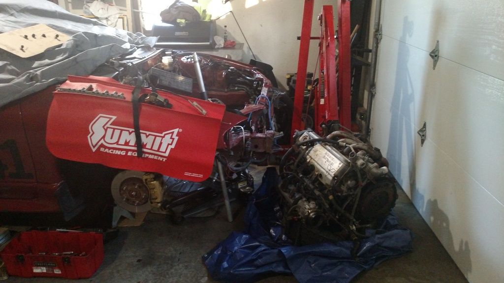

Now that the holidays have died down, the build can move forward. I have picked up the used motor I bought and have it in my garage. I have begun to start tearing it down, having only removed the easy stuff to be sold to help recoup and buy some new parts.
As of right now, I think ill need to get a new clutch, Ill have to get some pictures up soon. It just doesnt look to be in good shape after 2 AX seasons. However, it always held, so im not sure.
Im DEF going to have to get a new Fly-Wheel. Stock one looks really bad. Ill grab pictures soon.

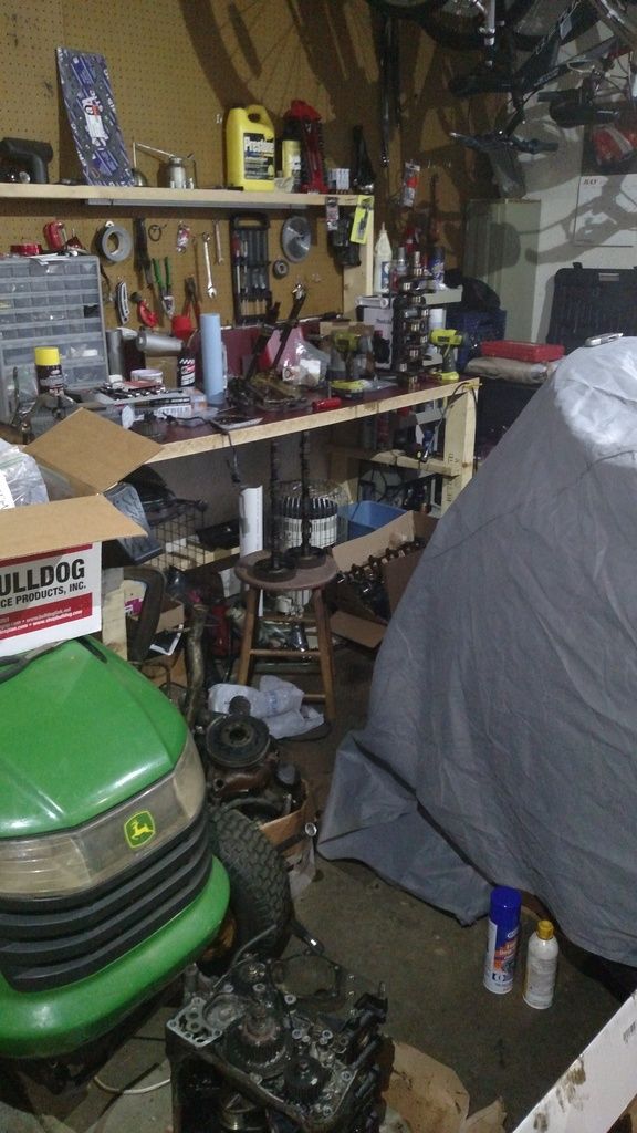

I need to take some time and get my garage organized before I really get into the build. I hate having stuff all over the place. I plan on picking up some storage totes to help keep things organized.

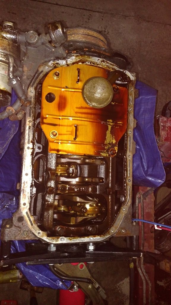

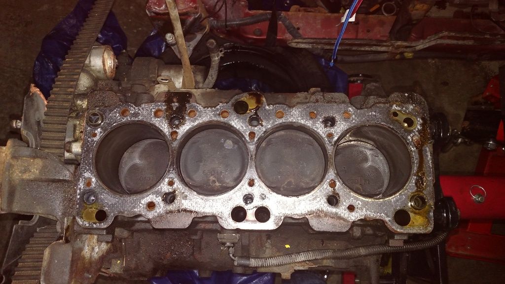

Got the motor tore down a bit more last night. Was surprised to find ARP head studs and an intact HG when I pulled the VC & head.

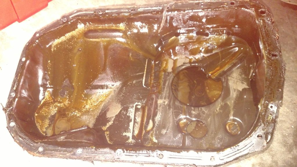

I dropped the pan as well. LOTS of small metal shavings. My bad for the horrible pictures.
And the bottom end as I left it. Im having a very hard time getting the crank pully to slide off. Going to work on it more tonight.

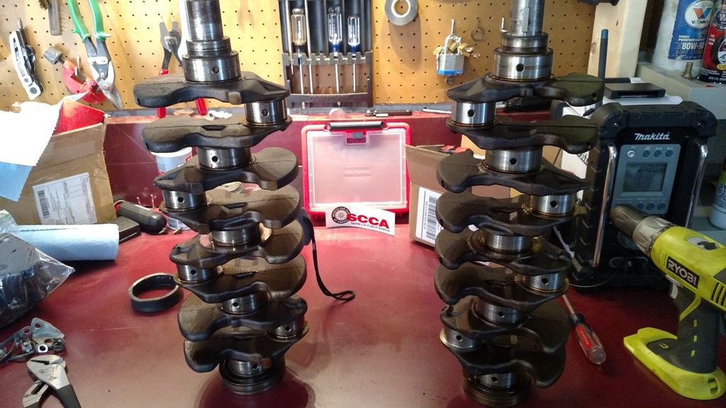

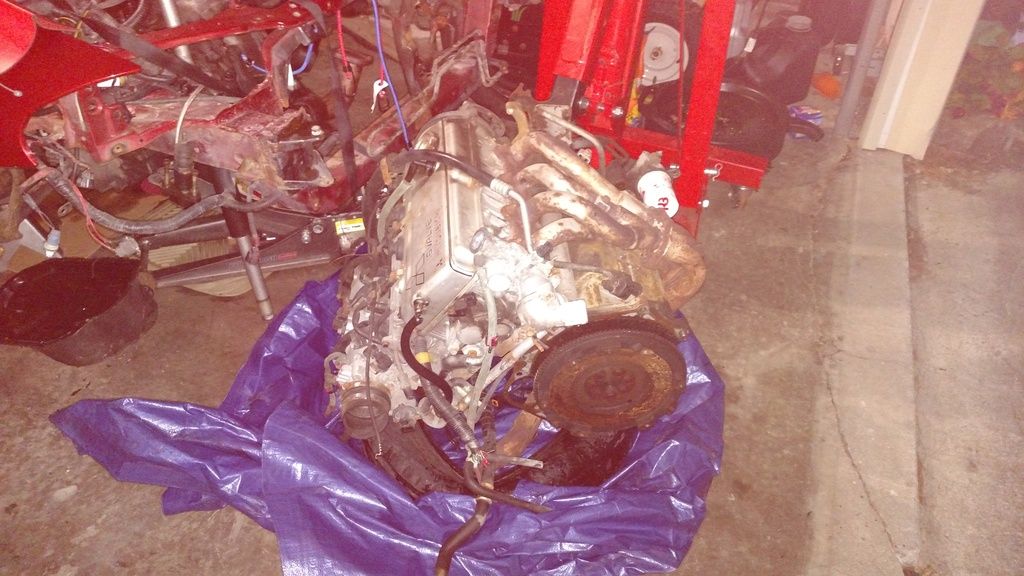

Picked up a complete, running 4g64 from a NT Spyder for $100.
Here's what im thinking, 4g63 block + 4g64 Crank = 2.3 Stroker Monster (the ultimate street/AX setup)

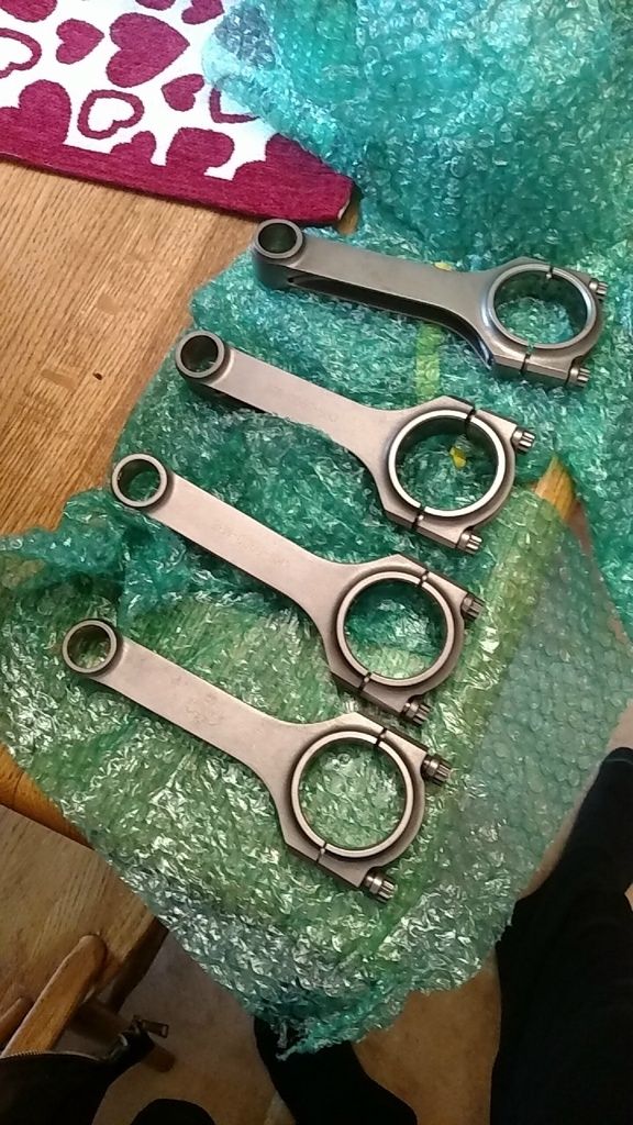

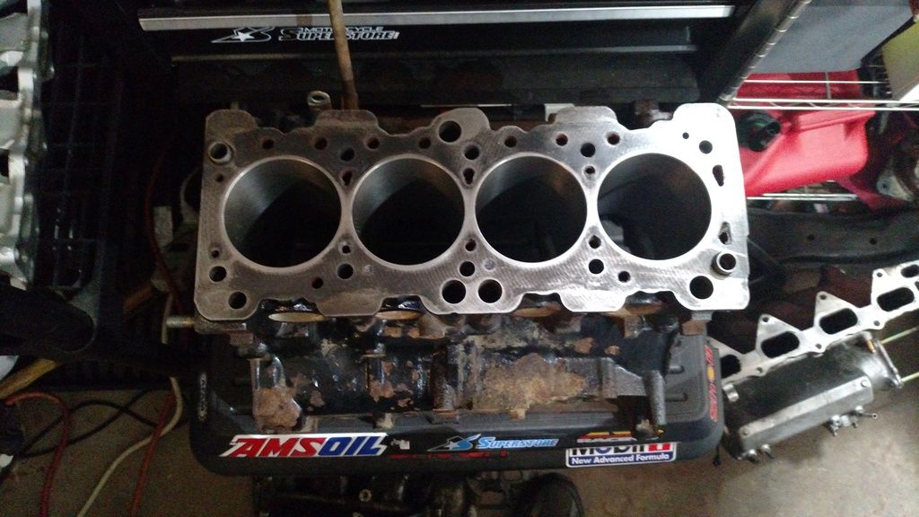

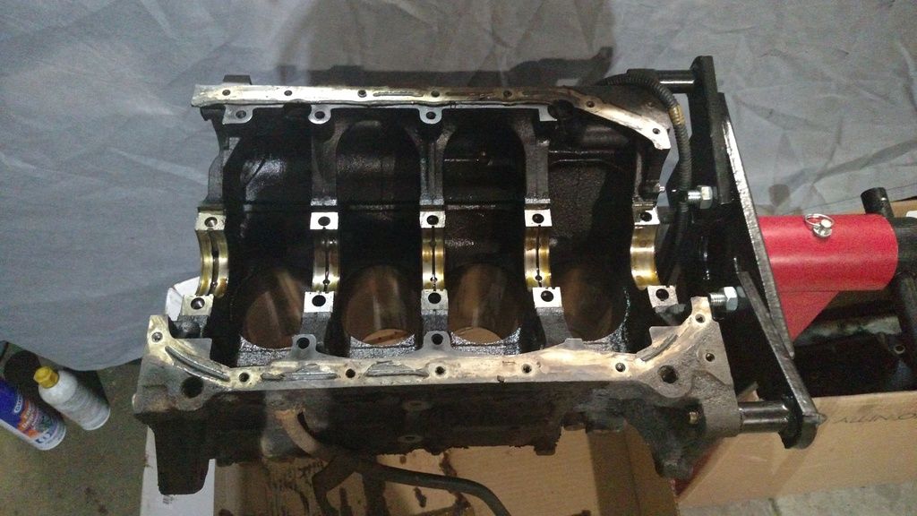

I was FINALLY able to get the crank bolt loose. I threw in the towel, loaded the block up and took it to a local Mitsubishi dealer. A service tech hit it with an impact and it came off in 3 seconds. And to think I broke two ½ inch ratchets trying to break it loose. Anyway, the block is bare!
I also picked up some rods!!!! Used, with very low miles, Eagle H-Beams for a very good price.
Snapchat--7011959497229986893_zpswc9t228d.jpg[/URL
Now that the 4g63 block is bare and ready for a good cleaning and hot tank, I plan on getting the 4g64 tore down.

One thing I’m really looking forward to is being able to really clean up my garage/workspace. So many parts laying around, the clutter needs to go.

Block and head are back! Head has been cleaned and the block was hot tanked and ball honed and I ordered pistons! Took my block and crank out to be measured and had the crank polished.

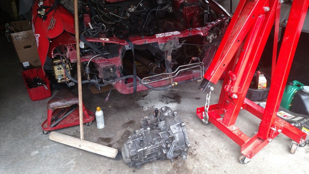

Getting one step closer every weekend. Took some time on Saturday to get the transmission out of the bay. I took a few minutes and shimmed the pivot ball. I also plan on giving it a good spray down and wash.

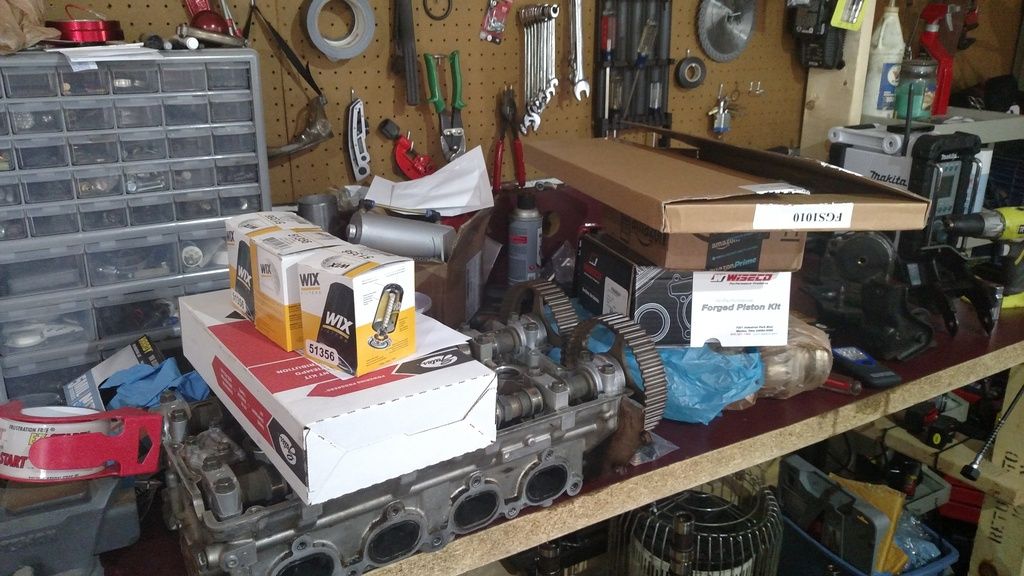

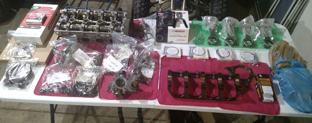

My forged pistons came in and they look beautiful.
Ordered the last few pieces of the build today. I ordered a complete DNJ Engine gasket kit and an entire gates timing belt kit along with a handful of WIX oil filters to have on hand.

The last bit of parts have arrived! Full Gates timing kit and a DNJ Full Engine Gasket set.
