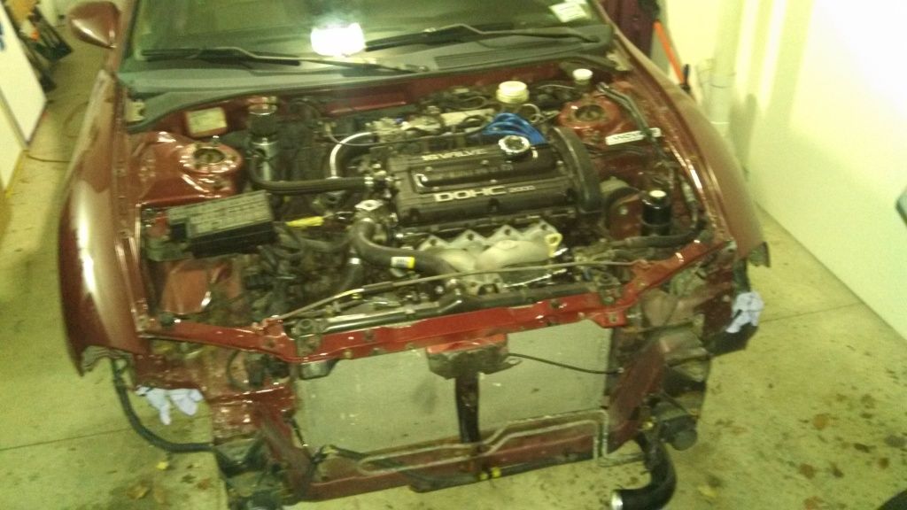

Got into it last night for a few hours. Most of it was just tinkering, but I started ripping parts off for the winter build.

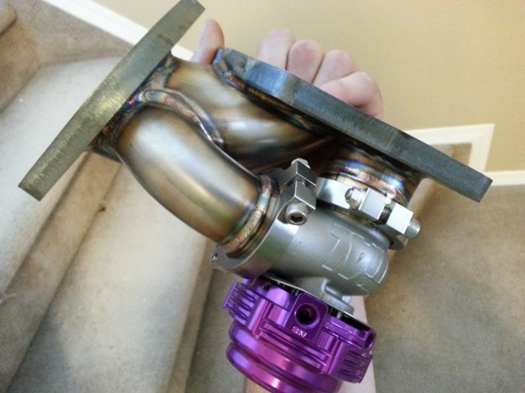

- Going externally gated

Are you planning external off 02 or external off manifold? What setup are you thinking?
Joel
I will be running a Tial setup off the O2 housing.

I'd reccomend punishments tial/02 housing combo. I picked it up and it's a thing of beauty. Can't wait to run it :) The MVS is also incredibly small.
Joel
That looks like a nice setup! I picked up a used setup to help keep the budget in check. Im very much looking forward to running external.

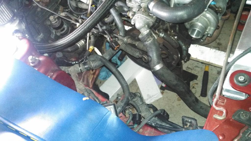

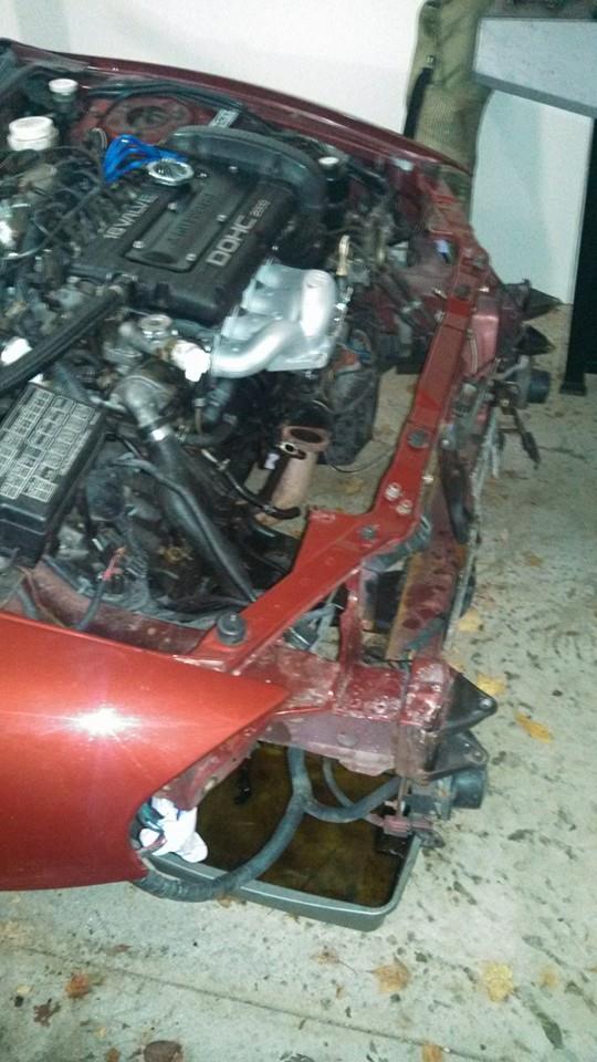

Ive been trying to mount up my 20g, and i've run into a problem. The 20g compressor housing is hitting the coolant I-Bolt under the water pipe. I've dented the water pipe a little, as needed. But now, the bolt is in the way. I was thinking about grinding the bolt down a bit. But wanted to bring it up her first to see what ideas are out there.

You might have to grind the bolt a little. How much do you think you'd have to grind off? I know there's a thread on here about possibly having to do this but I can't find it right now.
That's exactly what I was thinking. Honestly, I think you would need grind off a good amount, maybe half of the existing bolt head.
My only other option would be to use a different manifold, maybe go to a stock unit. Idk yet.
If you grind it, I would make sure you can still get a socket on the head of the bolt or grind the head all the way off incase you ever need to get the pipe off for some reason. I'm not sure if that bolt is a plug also so I don't know if just taking it out would be a good idea.
If you grind it, I would make sure you can still get a socket on the head of the bolt or grind the head all the way off in case you ever need to get the pipe off for some reason. I'm not sure if that bolt is a plug also so I don't know if just taking it out would be a good idea.
The bolt in question is an I-Bolt for the coolant.

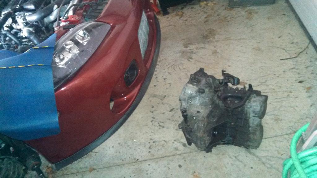

Currently, me and my buddy Justin (99ECLIPSEGSXDSM), are maybe another hour of wrenching away from having my tranny out in my garage. We plan on getting the tranny out today/tomorrow and hopefully having it back in as well.
Only real issue we have run into thus far, was the driver side axle being seized in the hub. Going to try to leave it in, and just wiggle the tranny out.

And the tranny is out! Great Success!! Going to spray it down with some degreaser to clean her up a bit.
So much room without that thing in the bay.

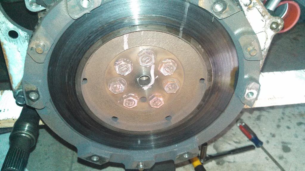

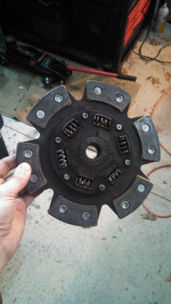

Got to pulling the pressure plate off. Revealed an interesting 6 puck clutch that was on the car. Couldnt find any brand on it. No clue.

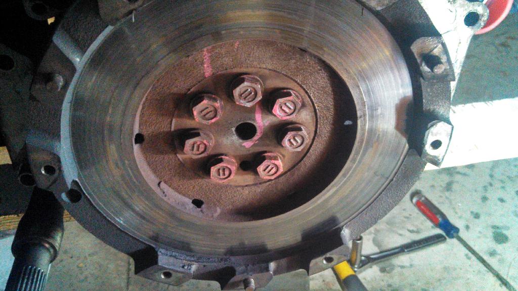

Anyway, got to looking at my flywheel. I have had people tell me to have it resurfaced, but I have also seen that when using a ceramic clutch, resurfacing was not needed and that I should just hit it with some emery cloth. Its not cracked or in bad shape at all. There may be a slightly uneven surface, but that would be gone during the break in period.
Thoughts?
