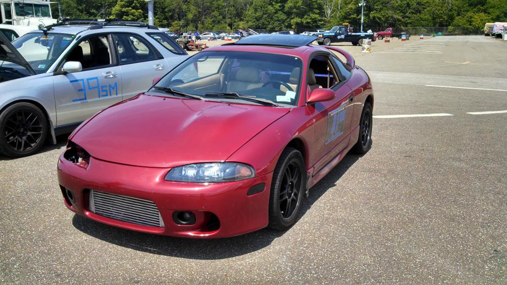

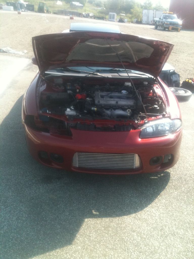

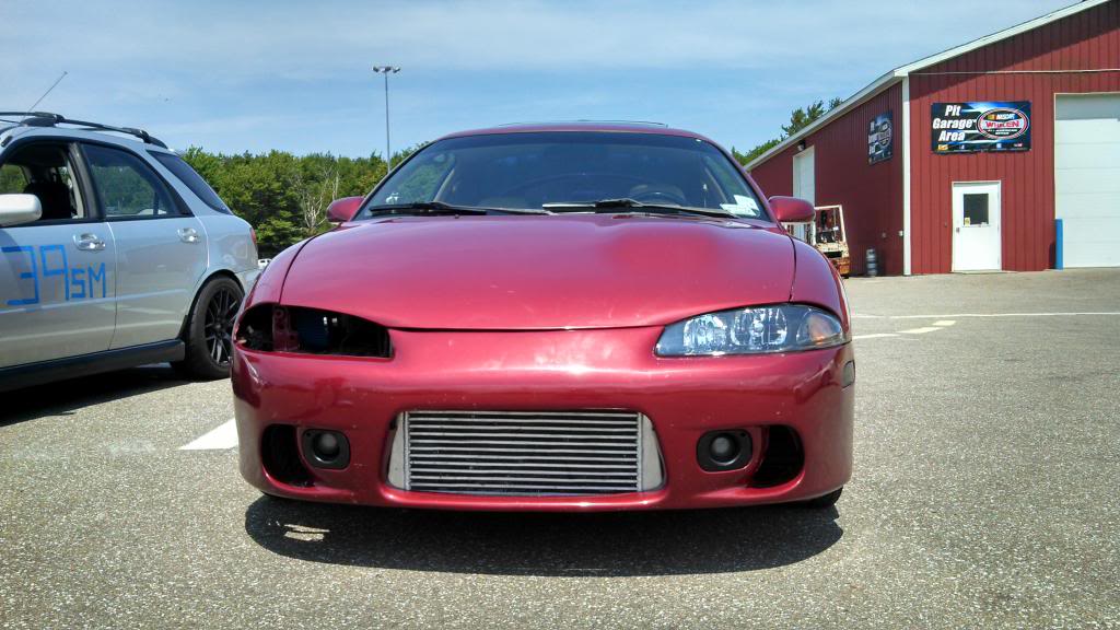

Only got a couple of stationary pics for the day. To help battle my intake and under hood temps, I removed the passenger headlight for the event.

Aaron and I have a great plan to keep his intake temps down. The cars not overheating but his temps are pretty high for normal driving so run after run at an autox event on a hot day like it was I can see them being through the roof. Taking the headlight out I could feel a little improvement over the last time I road shotgun
