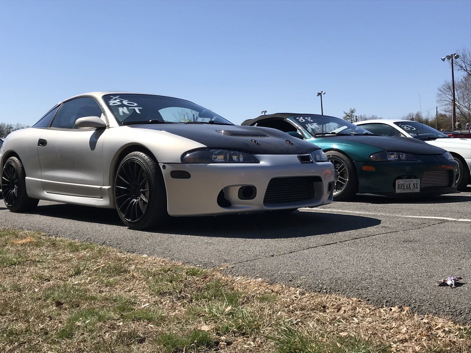

Well spring came a little early to Virginia this past Sunday. 65+ degree weather with the sun out. Perfect day for the drag strip.
I attended a import drag race event at Summerduck near Fredricksburg, VA and i had a good time with my friends and even ran the car. Its only a 1/8th mile track but it was still fun. Haven't been to the drag strip to run since High school.
Car ran a 9.16 at 88mph, with a .658 R/T.
Need way more seat time as I bogged on the launch. And need to setup my 2step for sure.

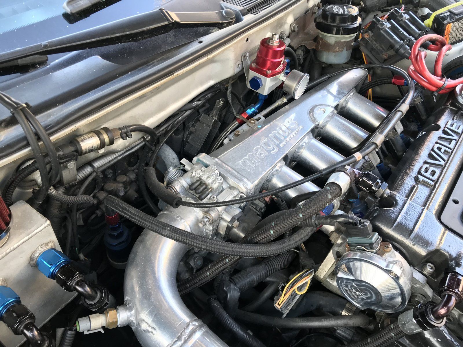

I'm not chasing any numbers here or going for big power and records. I just want to enjoy my car for what it is, and that is a street car. I only run 25psi on a turbo that's setup to flow 74LB/min. Its a complete pig on my 2.0 motor at that low of a psi level. If i was running 40psi on c16 or something that probably be different story, but im staying 93 pump which limits my boost/fuel/timing options. Maybe I will go flex fuel, but undecided.

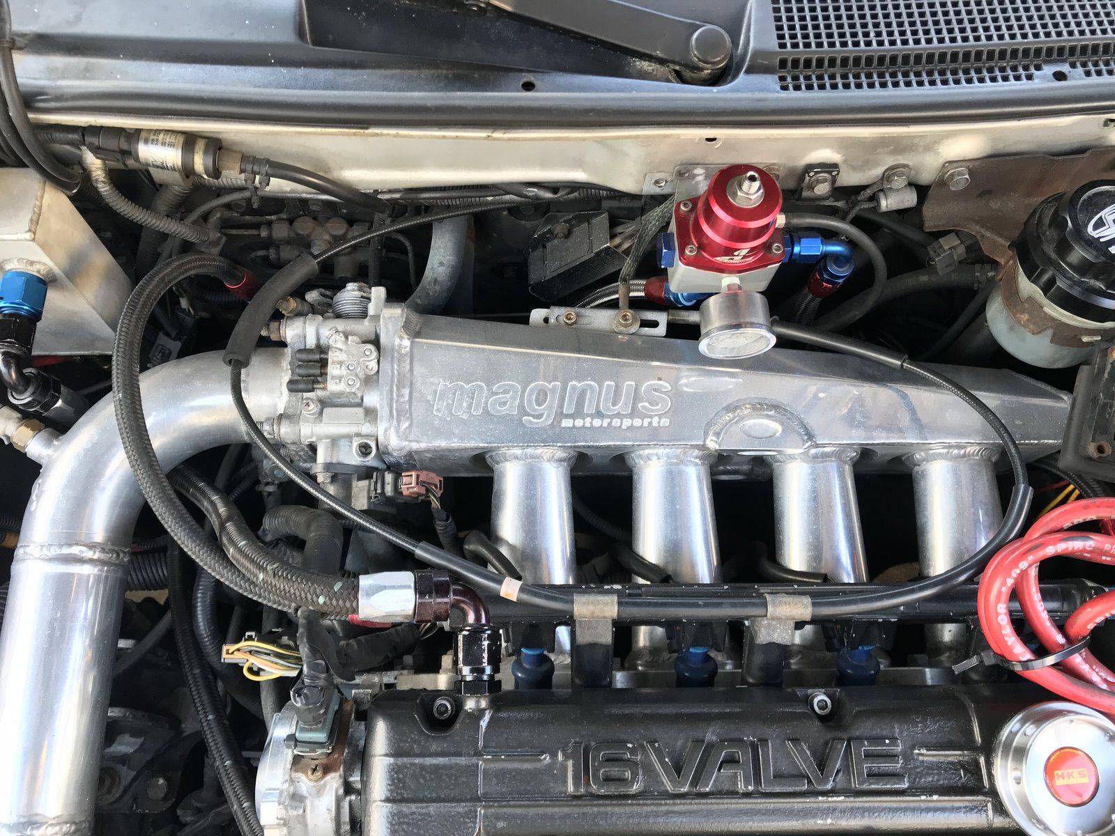

Anyways, I think the combo of my 6262 and Magnus intake are the causes for my spool issues. I'm planning to correct those two things this spring.

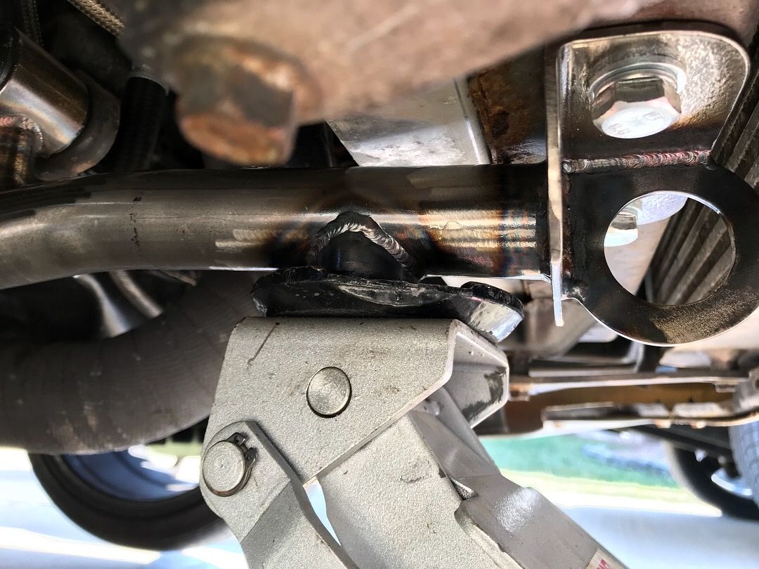

Installed my BoostedFab lower cross member bar this weekend. Its honestly a piece of art and the built in jack mount is awesome.

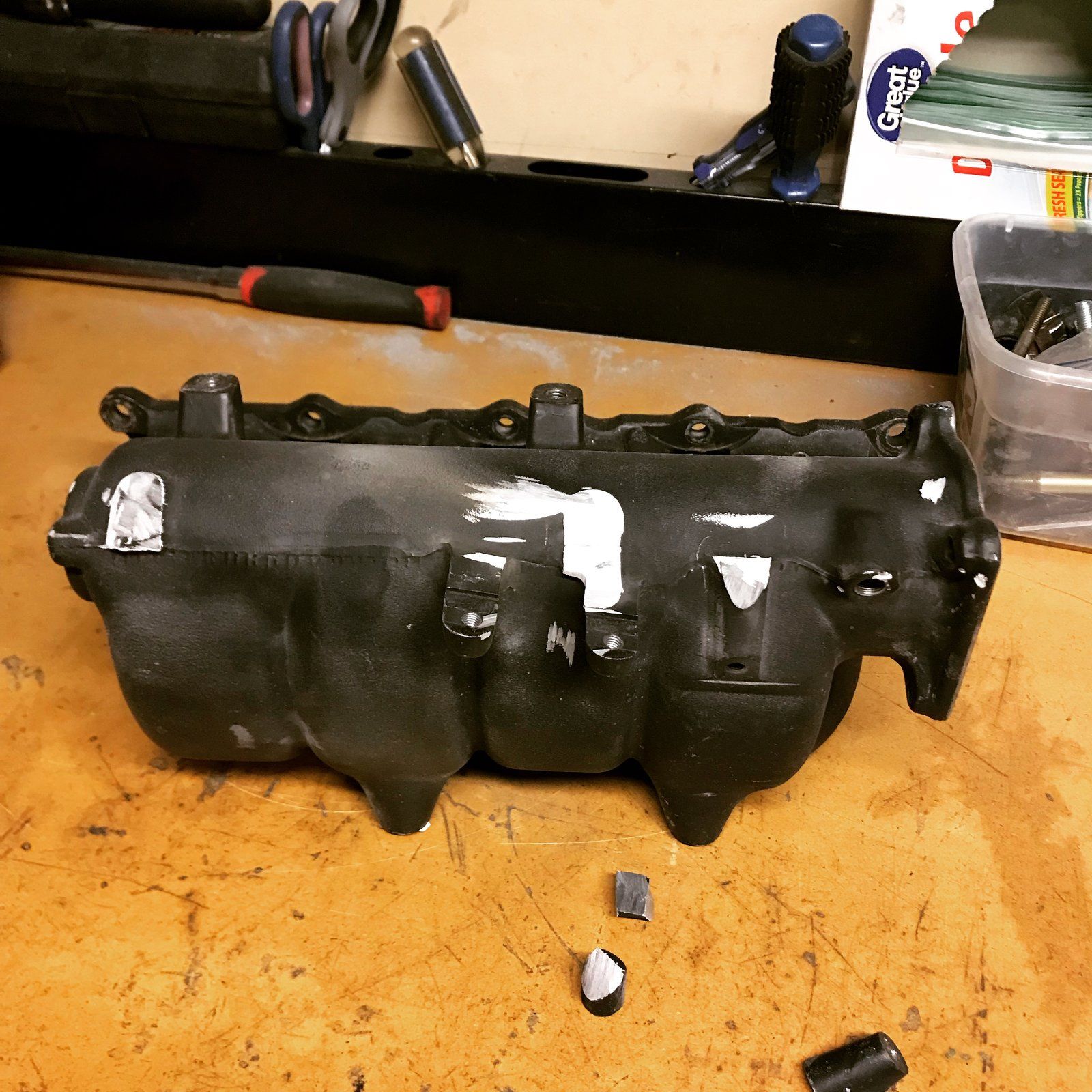

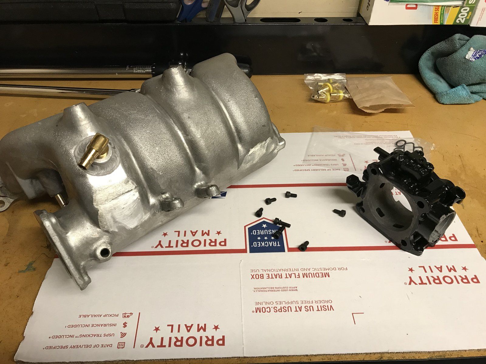

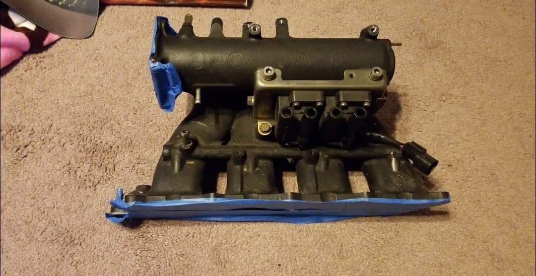

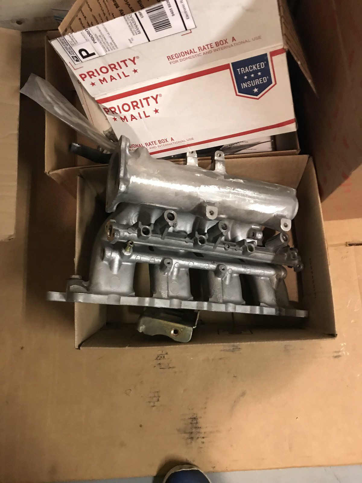

I also received my EVO 3 manifold this week, and immediately started working on it.
Going to shave off the brackets and ports I don't need. Then powder coat it black.

-Removed the Magnus SMIM and sold it. I decided to give the Evo 3 Manifold a try after reading up on it.

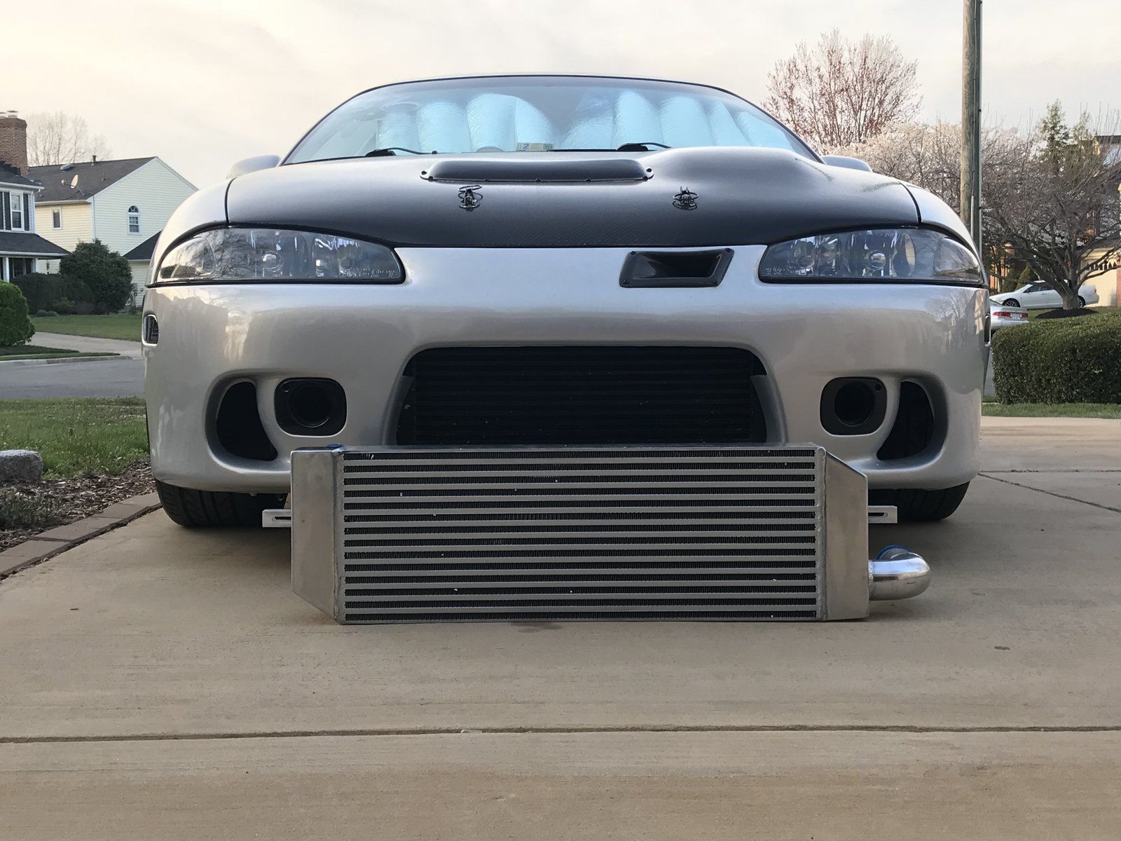

-Thinking about buying a new FMIC setup. One with short route piping to help reduce spool. Still on the fence but I'm looking at VRSF right now. Iv seen them support up to 600+ hp.

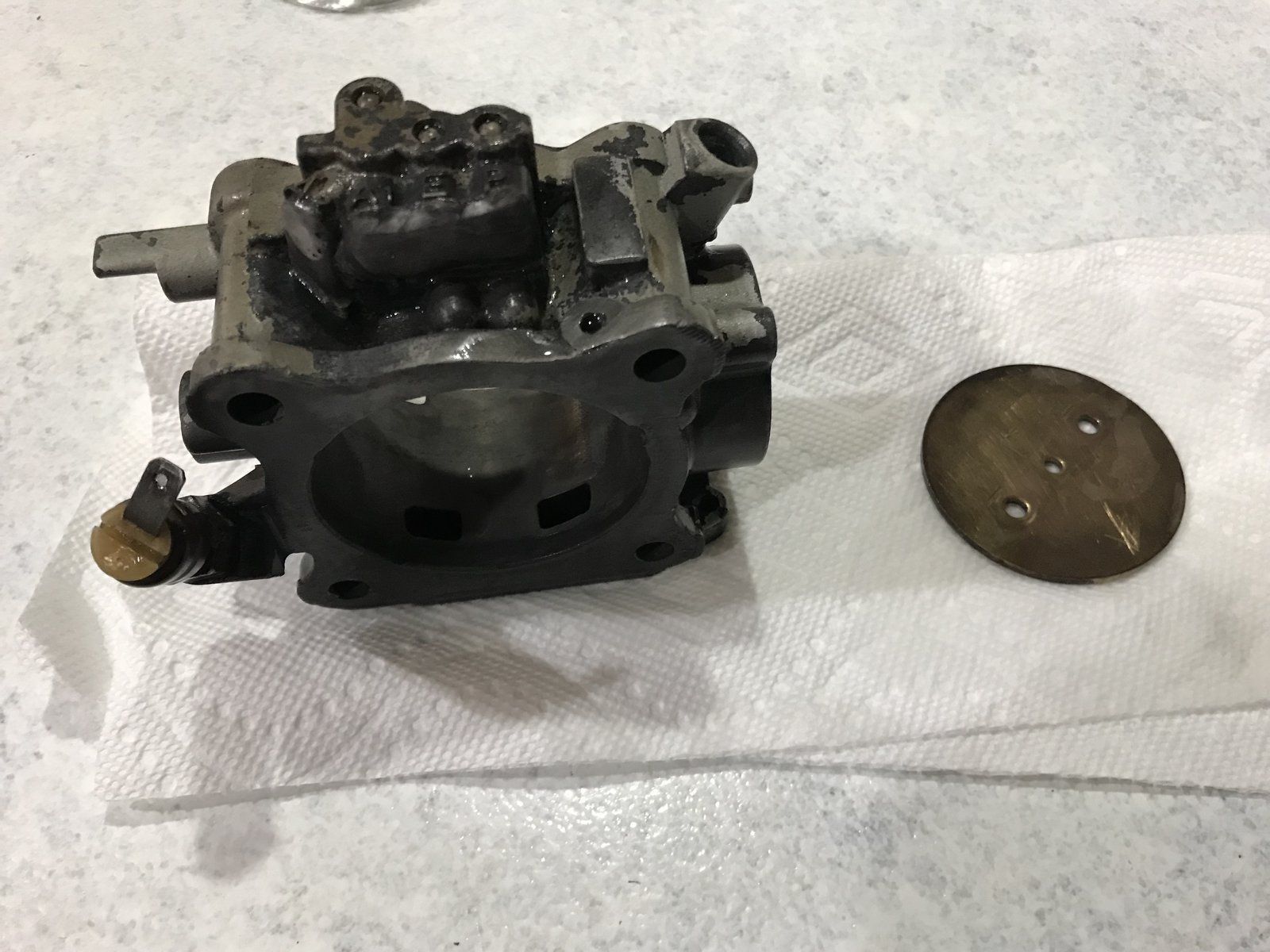

-Rebuilding my 1G Throttle body and have the vac ports welded shut.

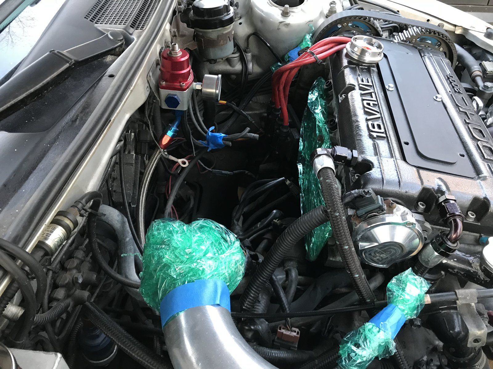

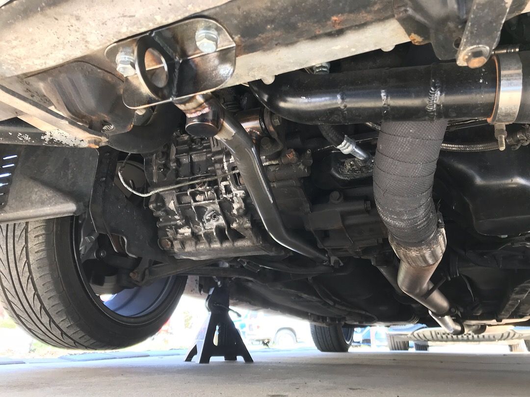

Finding out my new exhaust dosent fit because my DP is too long. (I was pissed to say the least it was 35 degrees outside)

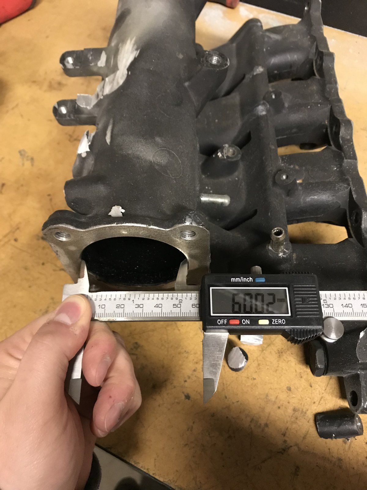

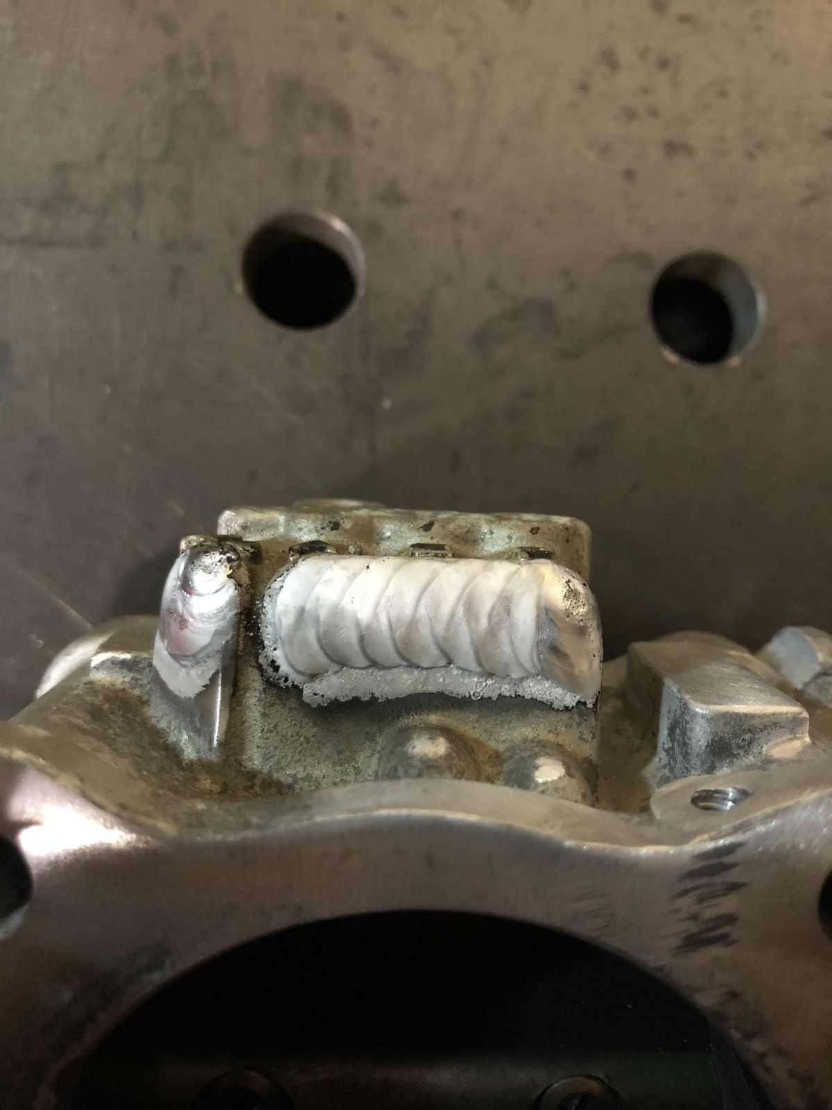

Got a local friend working on welding shut some ports on the evo 3 manifold. He will also be welding on a larger rear port, on the back of the manifold. This port will feed into to a vacuum block. I'm doing this for a cleaner install, and cleaner lines routing for accessories like Boost, map, afpr.

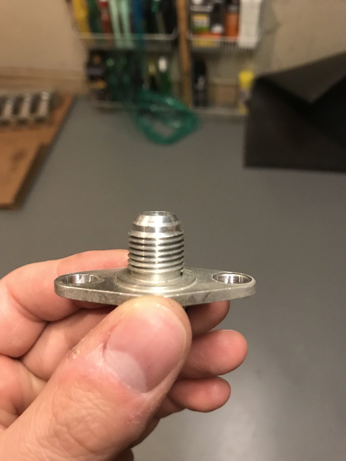

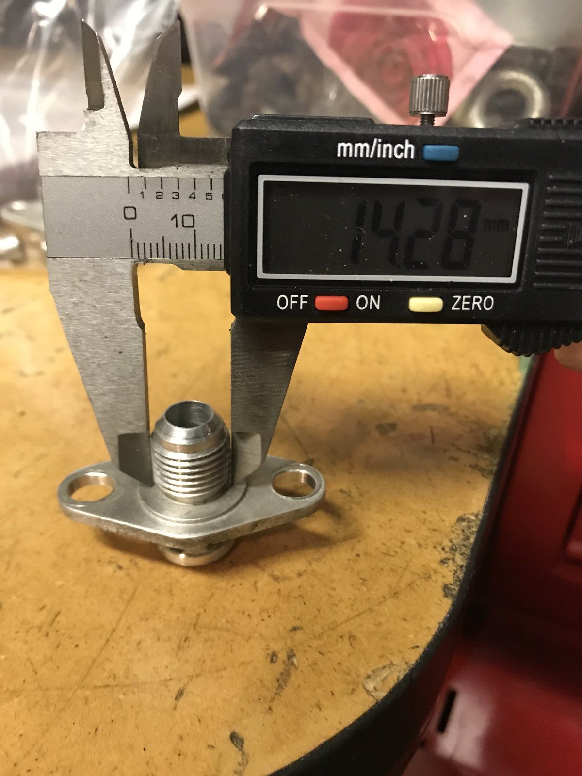

Measuring out my fuel line fittings. I may order new ones in black.

Yes! so far I need to modify the exhaust, and my upper FMIC pipe. So i thought why not just buy a new core with short route piping and eliminate the U-turn piping i have on the intake side.

Parts are starting to arrive & and Welding on the intake manifold is almost completed.

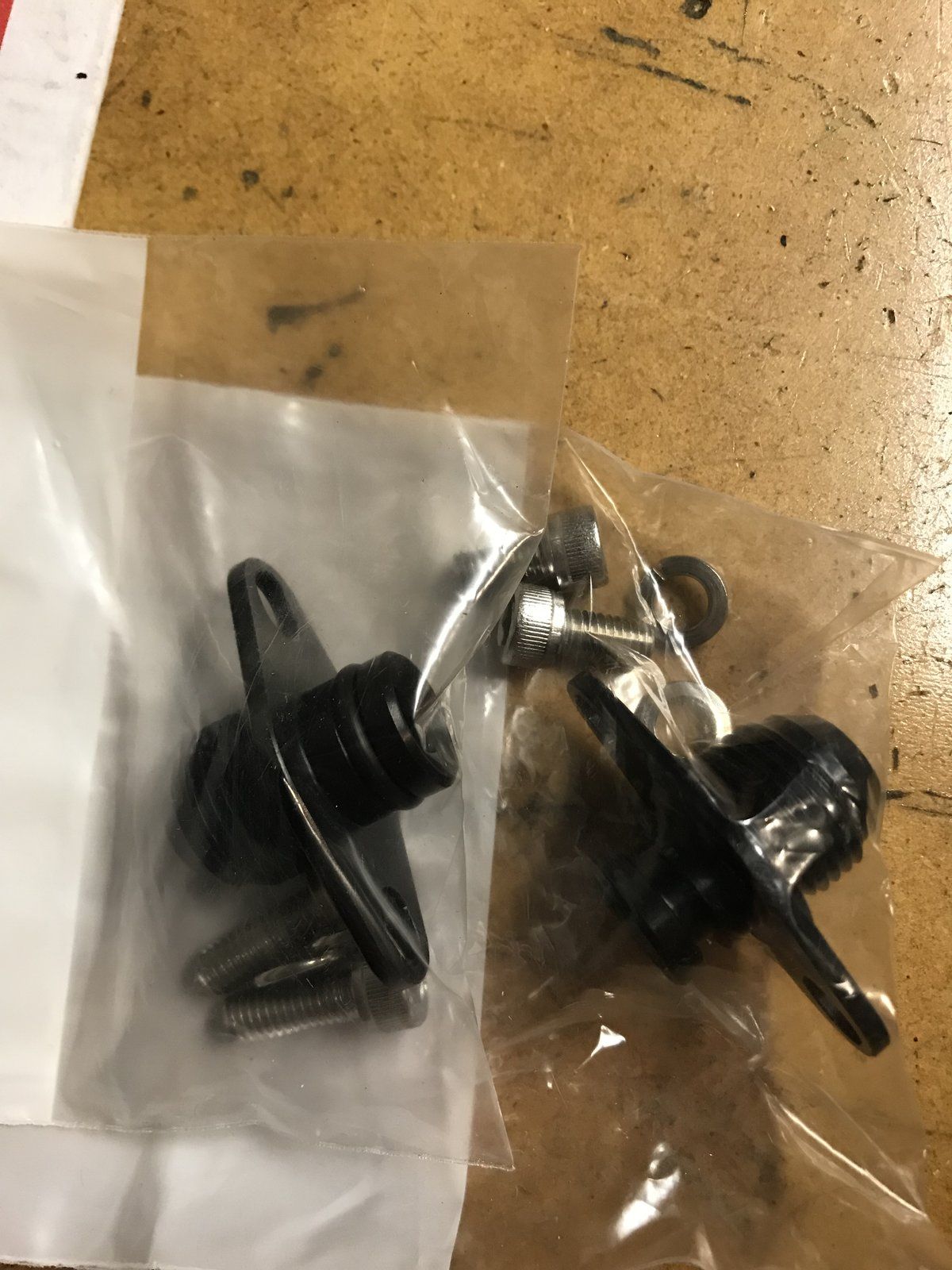

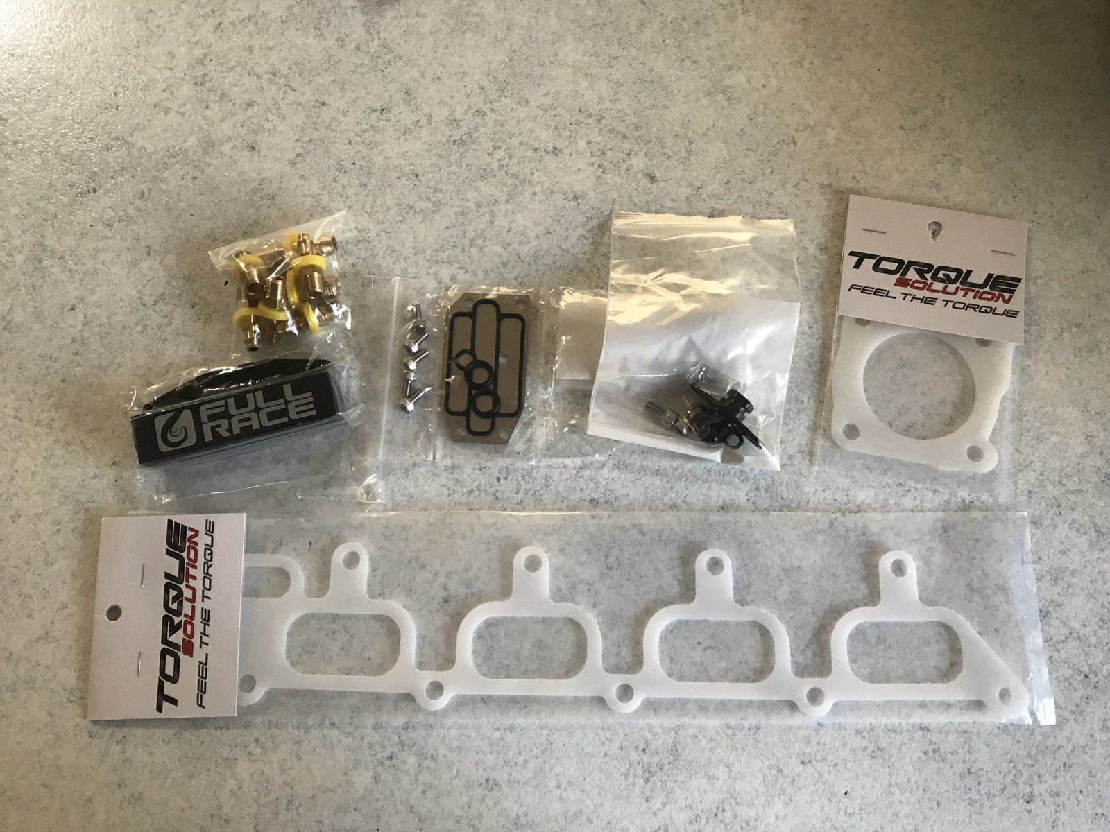

Got my first round of parts in from STM, Ebay, and VRSF... All of these items will be used to put my Intake manifold back together and tuck some lines behind the manifold.
Have to reach out to STM. Im missing one of the orings for my new fittings.
VRSF has some incredibly fast shipping. Arrived two days after I ordered. My one complaint is they could try and package these kits a little nicer. Yes it wasn't damaged or anything, but the foam that was used as packing material got everywhere in the fins of the core. You can see it in the pic below.

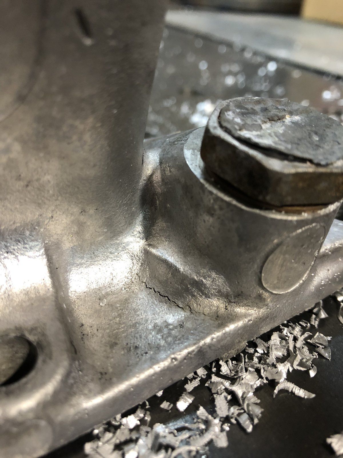

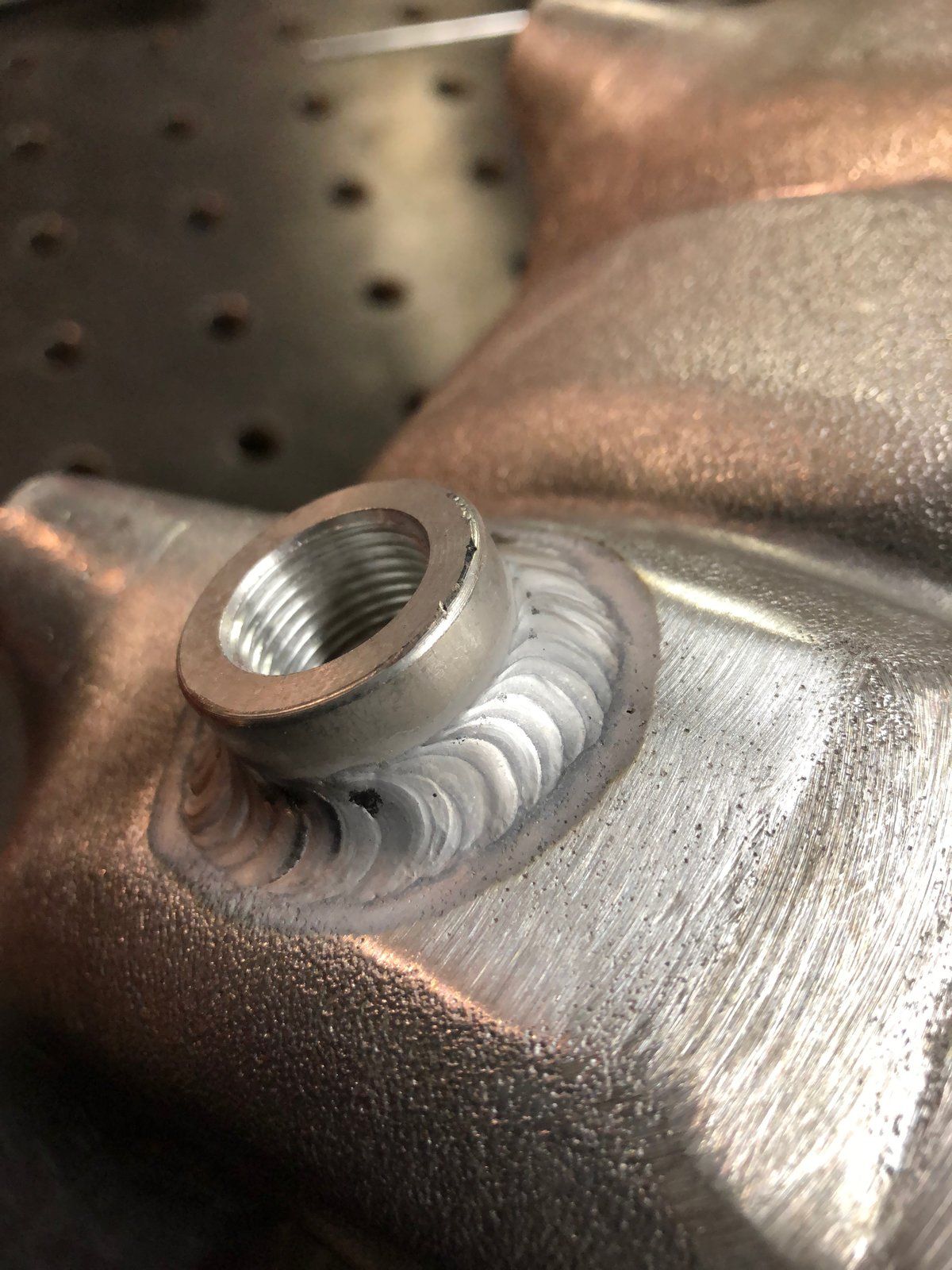

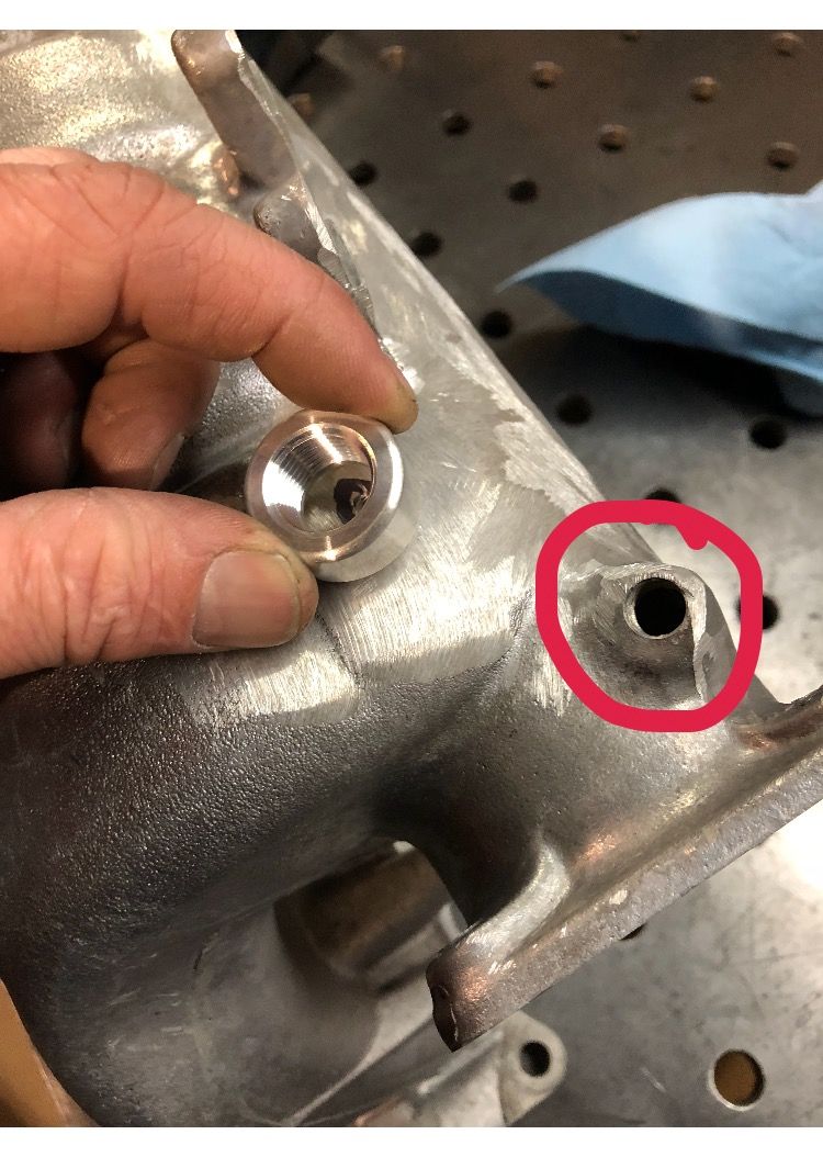

My welder found a crack in my EVO 3 Manifold. Very happy his took his time and inspected the manifold.
Welded shut all the external ports on the Evo 3 and did one main feed on the back.

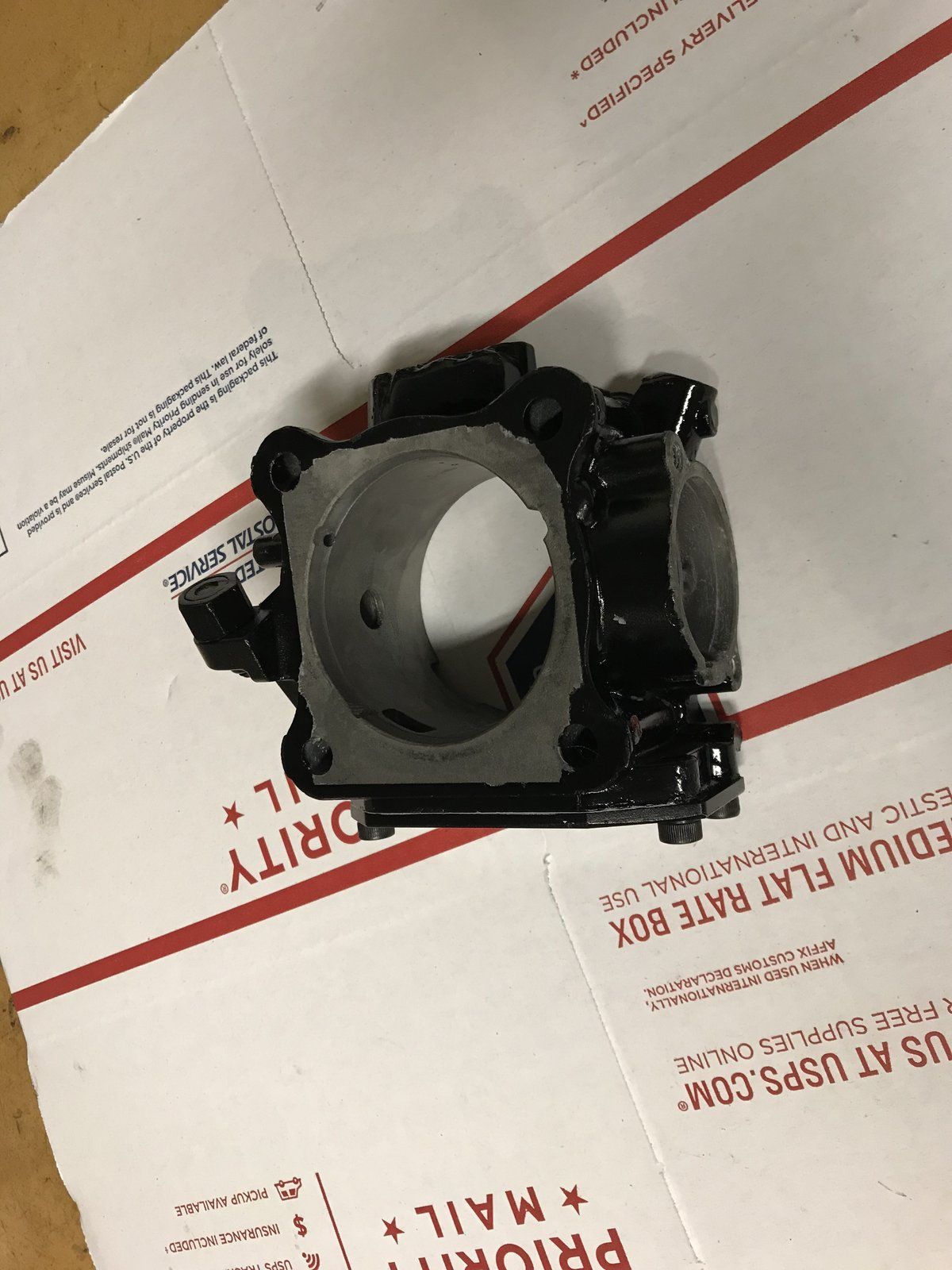

Also decided to modify my TB as well. We welded shut the four top ports and cut off a bracket. Just a little grinding needed now.

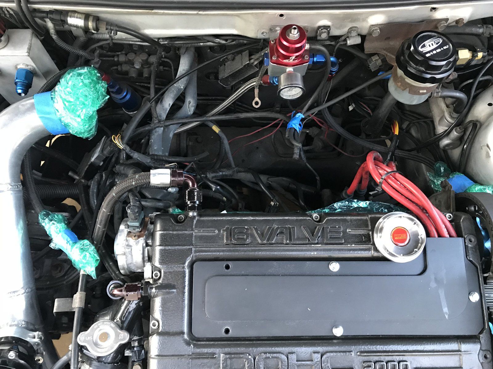

I got my intake and throttle body back form the welder. Very pleased with the price and workmanship. Picked up some black cap bolt hardware for reassembly.

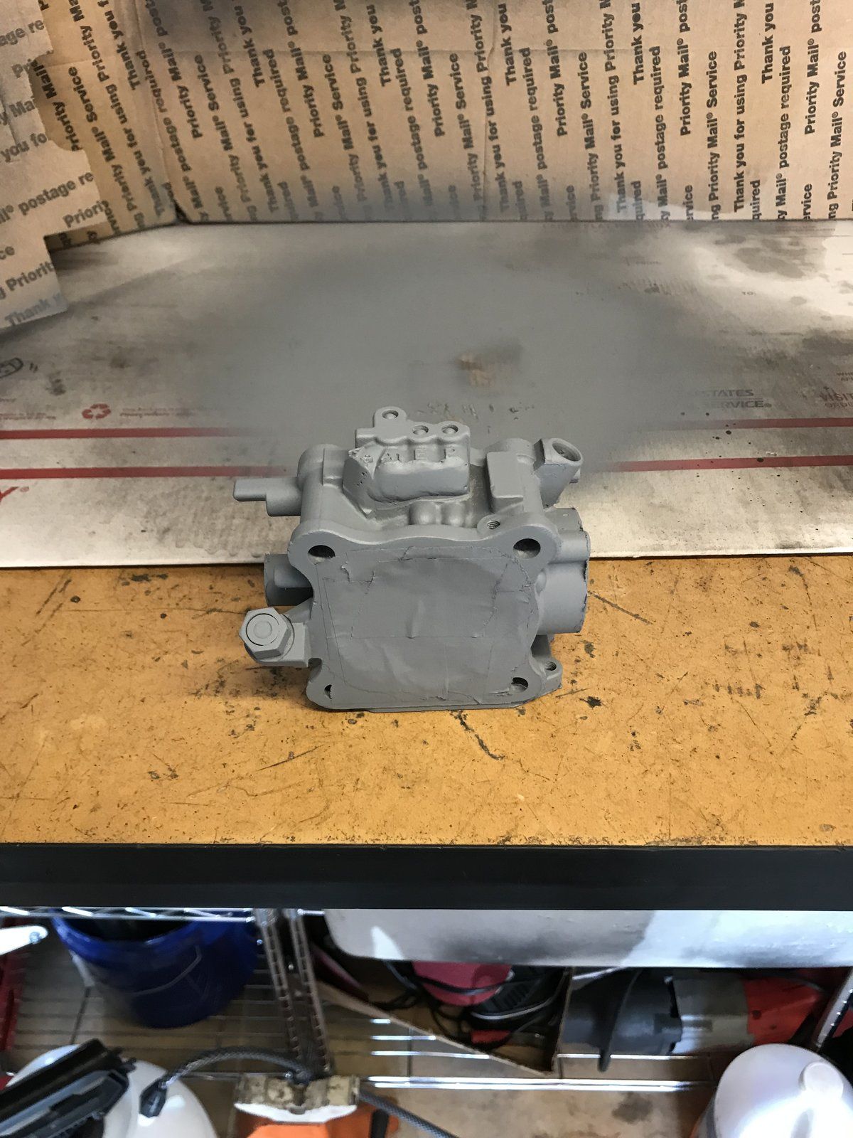

Cleaned out my Throttle body to do some paint work, and get it ready for the new Mil-spec seals. Also installed the FIAV block off plate from STM.

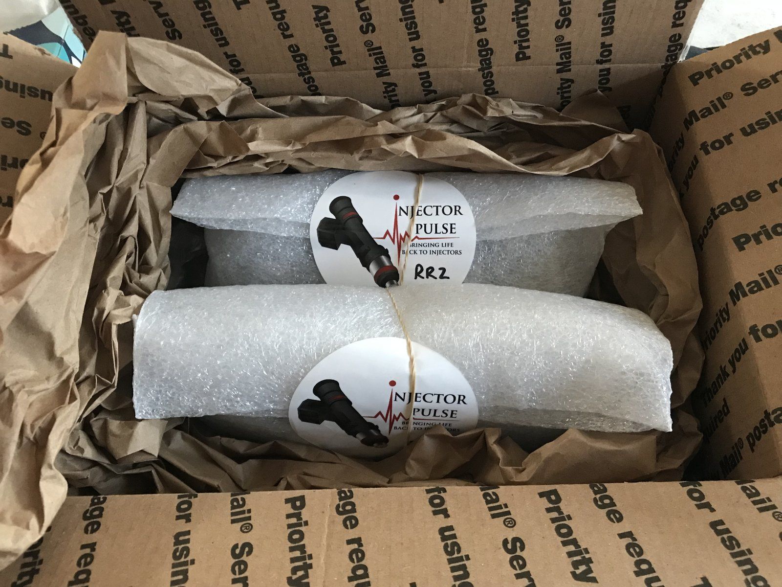

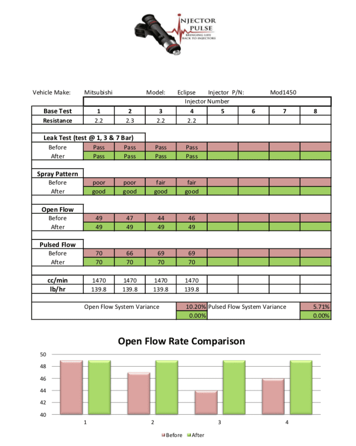

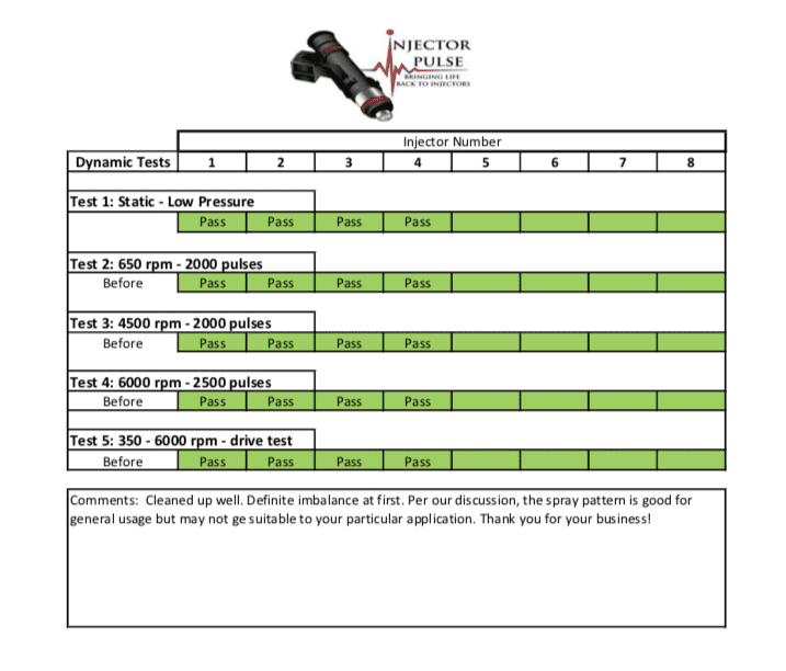

Also I got my Injectors back from InjectorPulse yesterday. I had them Cleaned and Flow tested. Honestly a great company to work with, I don't have enough good things to say about them. I highly recommend using them for Injector cleaning, and testing. I will also post my results below for my 1450cc FIC.

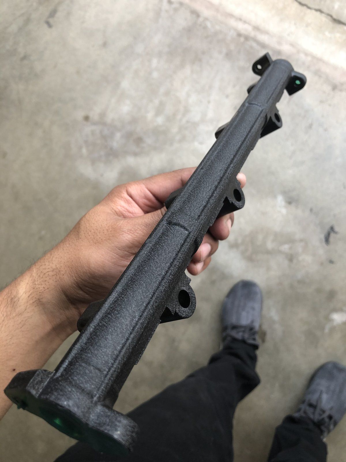

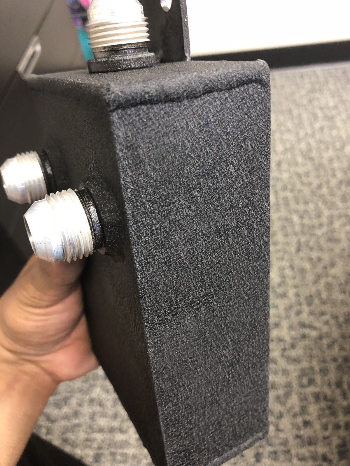

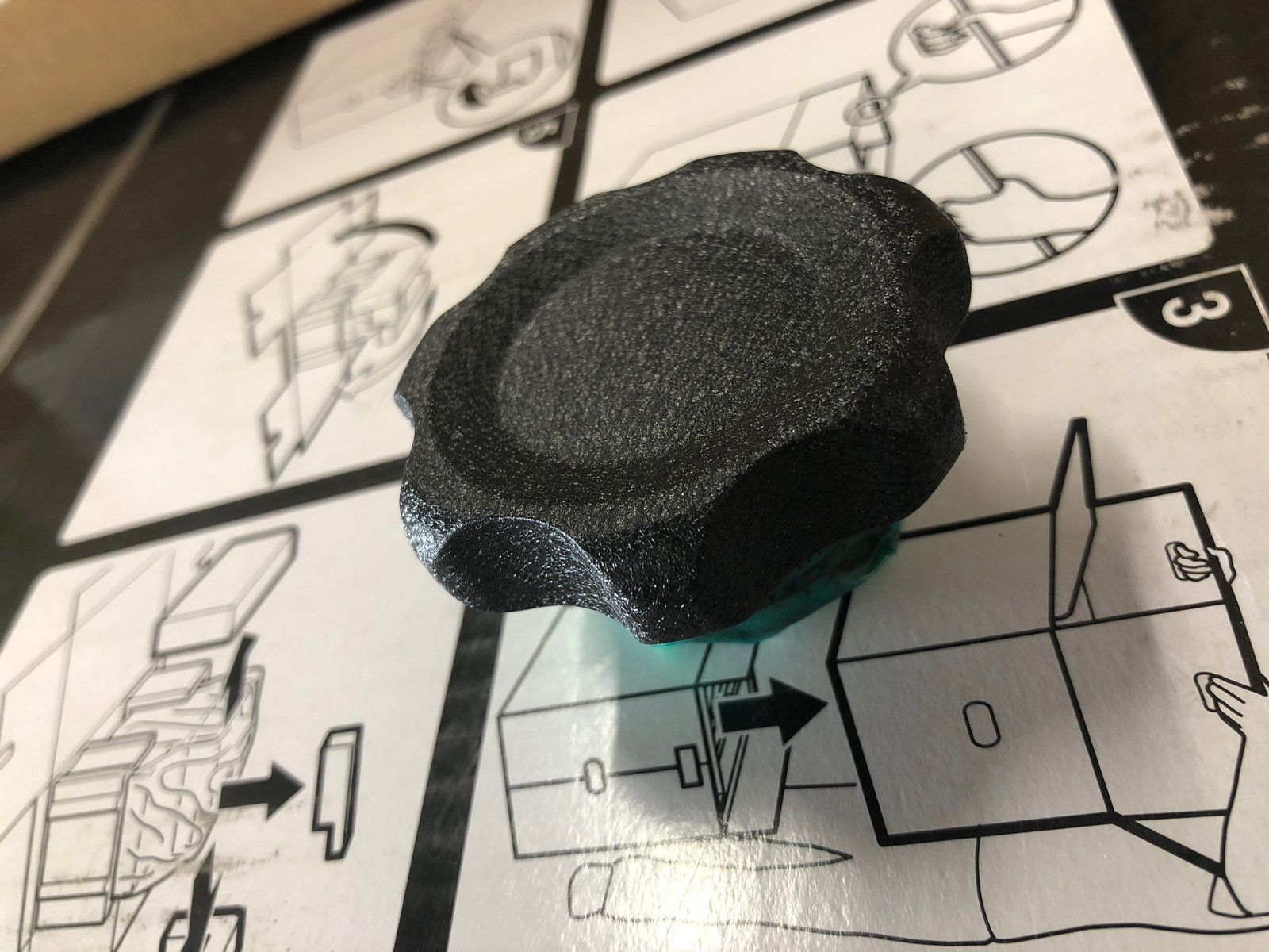

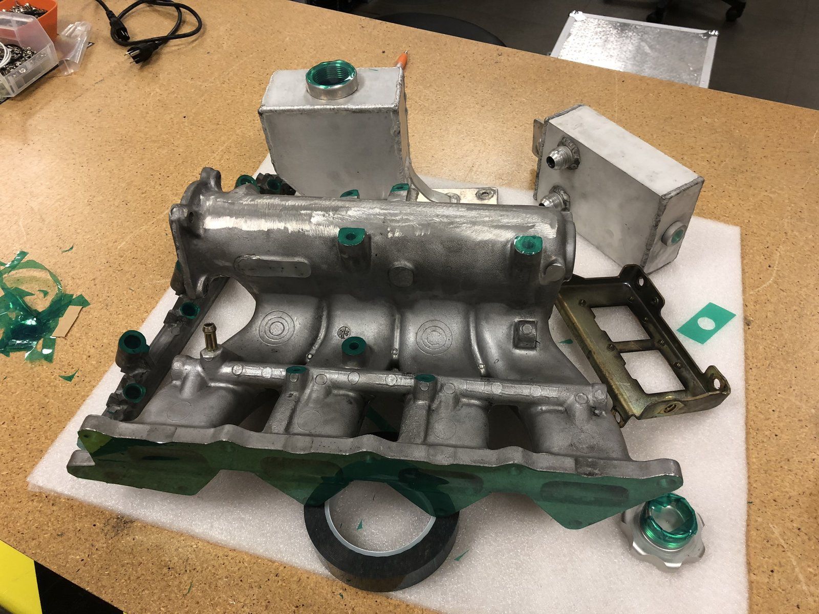

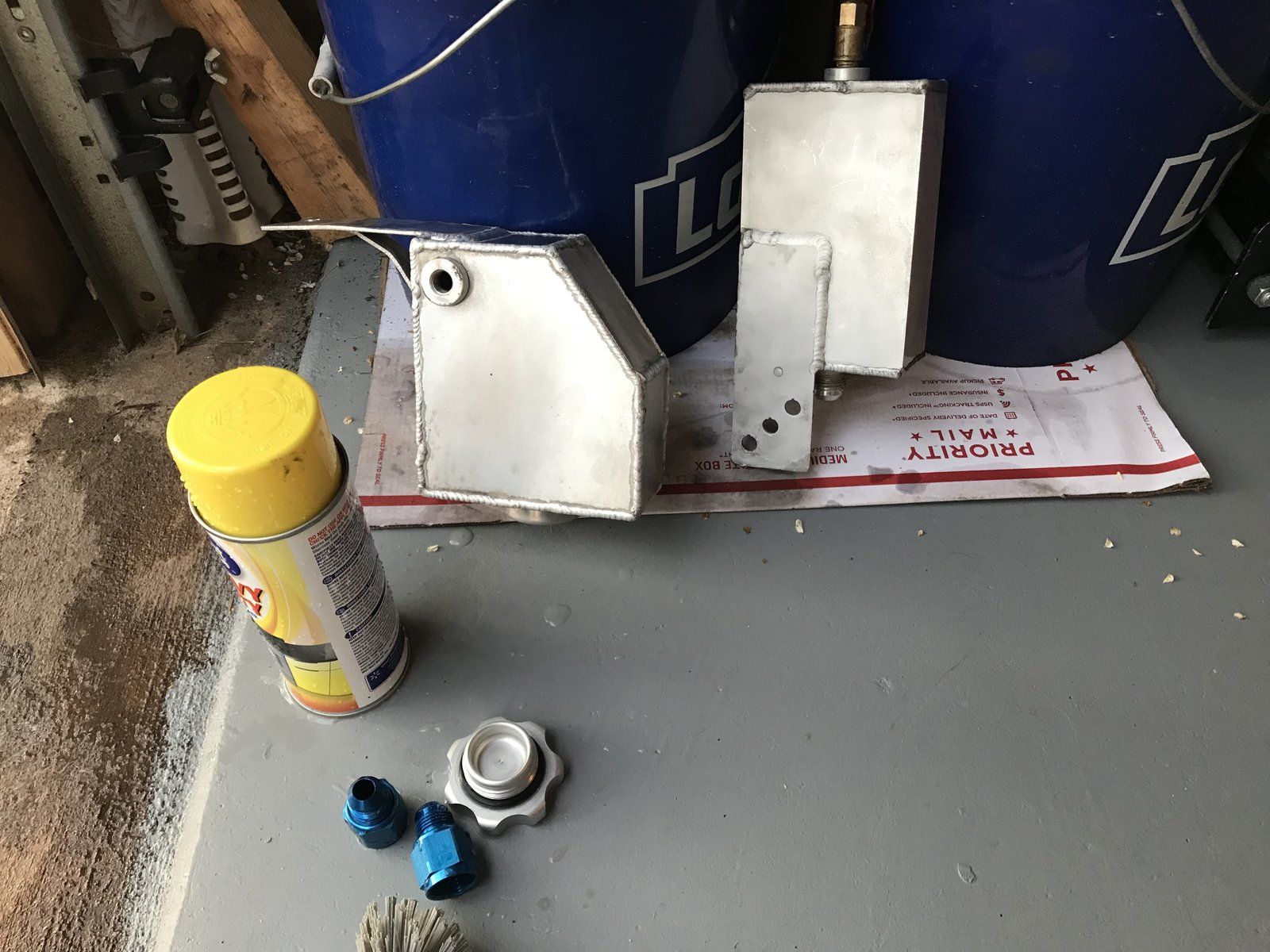

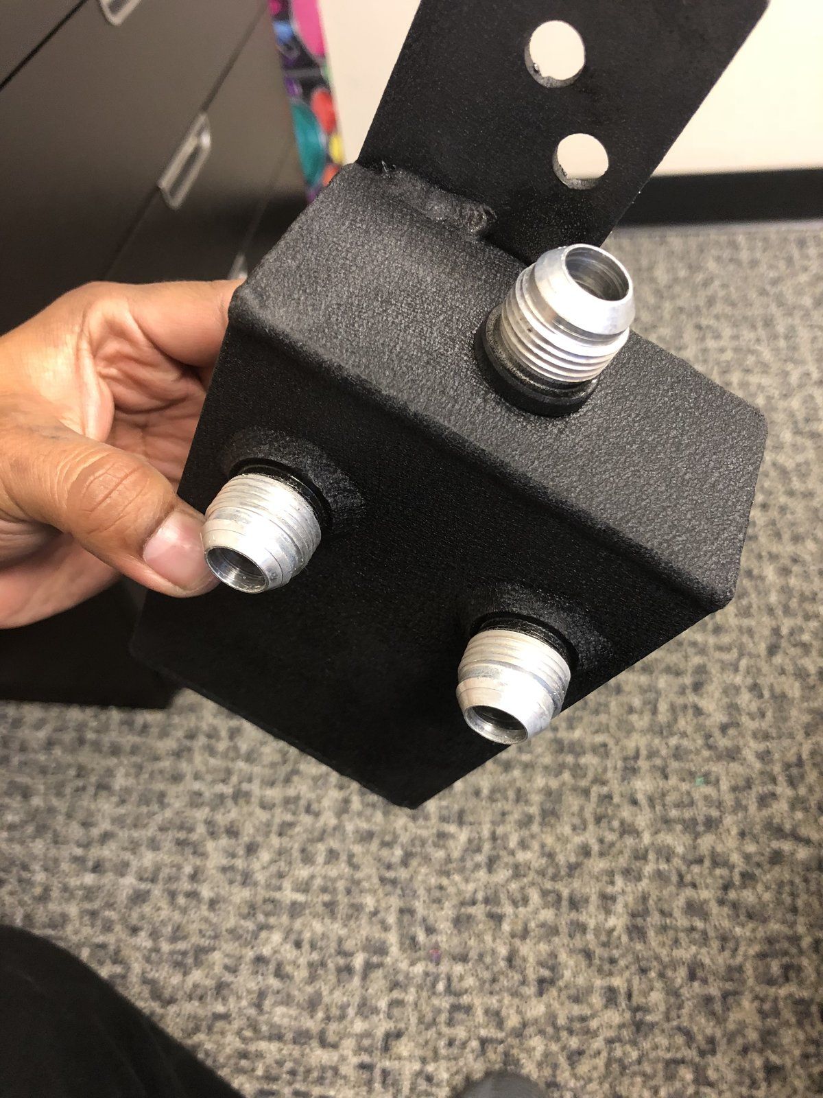

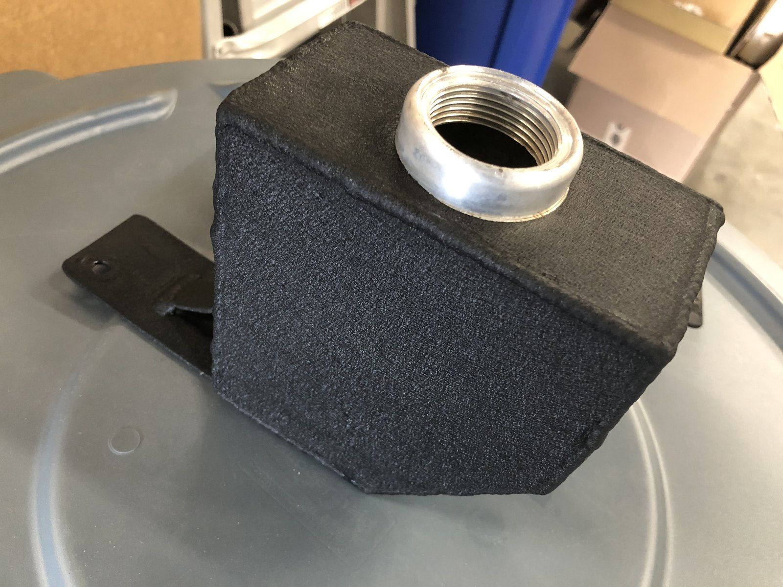

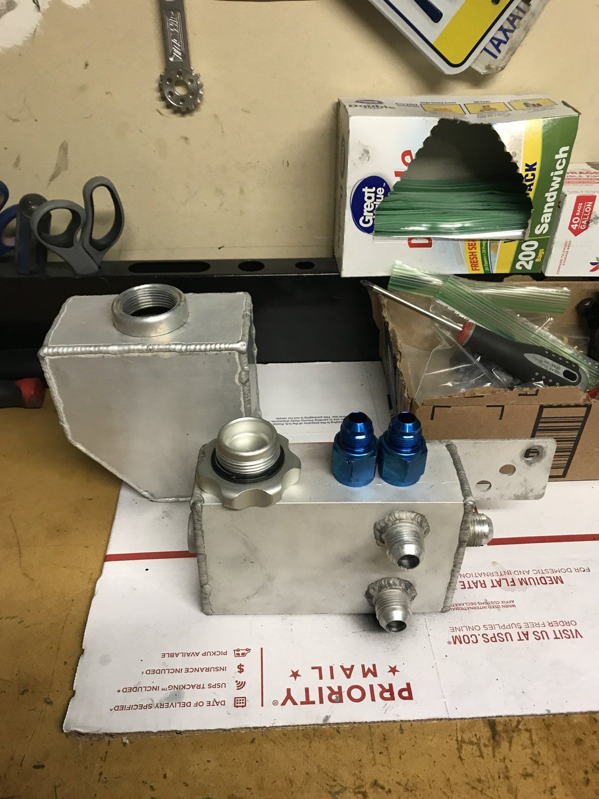

Also I cleaned out my Coolant and oil catch cans, to get them ready for Powder Coating.
Build Update 4/23/18
Dropped my Engine parts off for powder coating this weekend. I'm going with Wrinkle black.

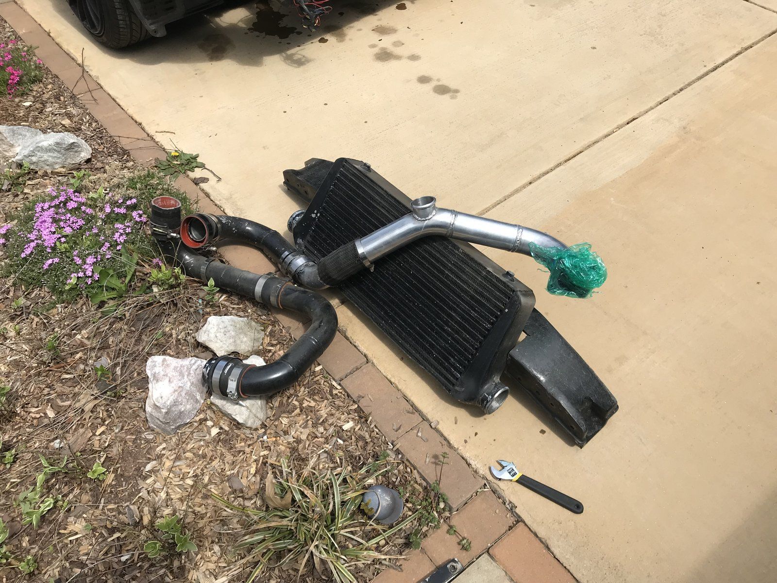

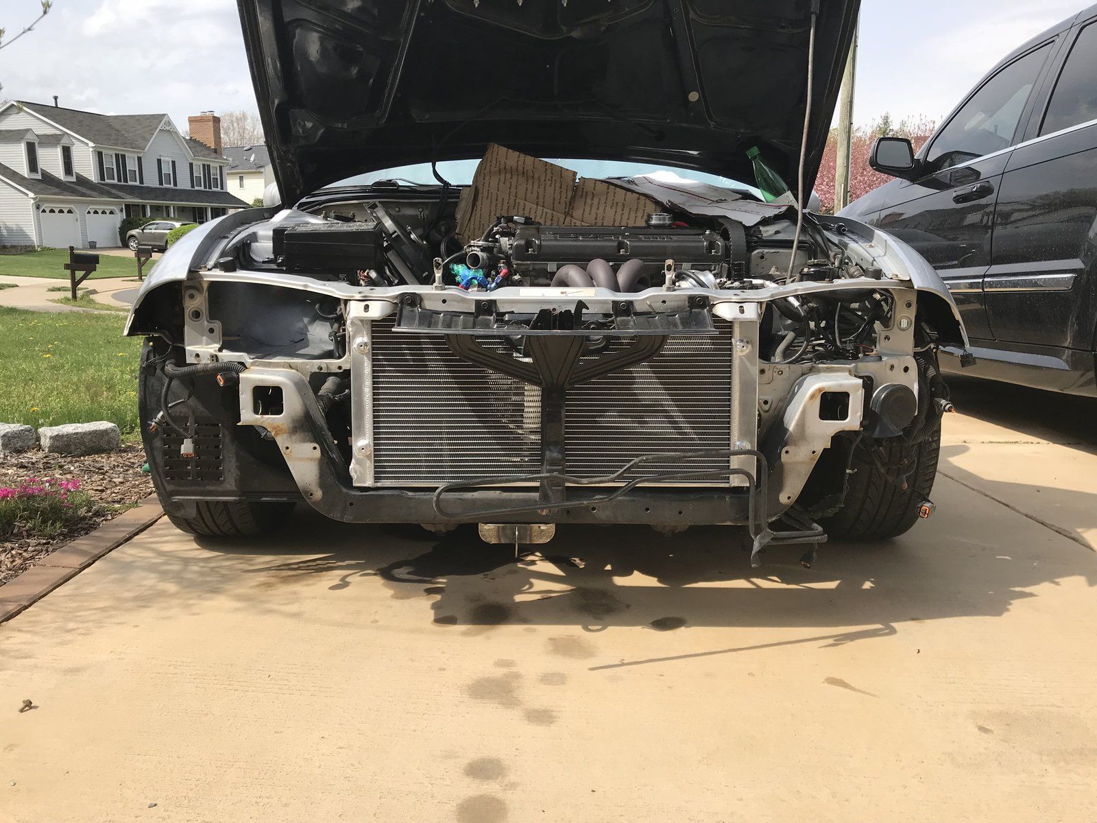

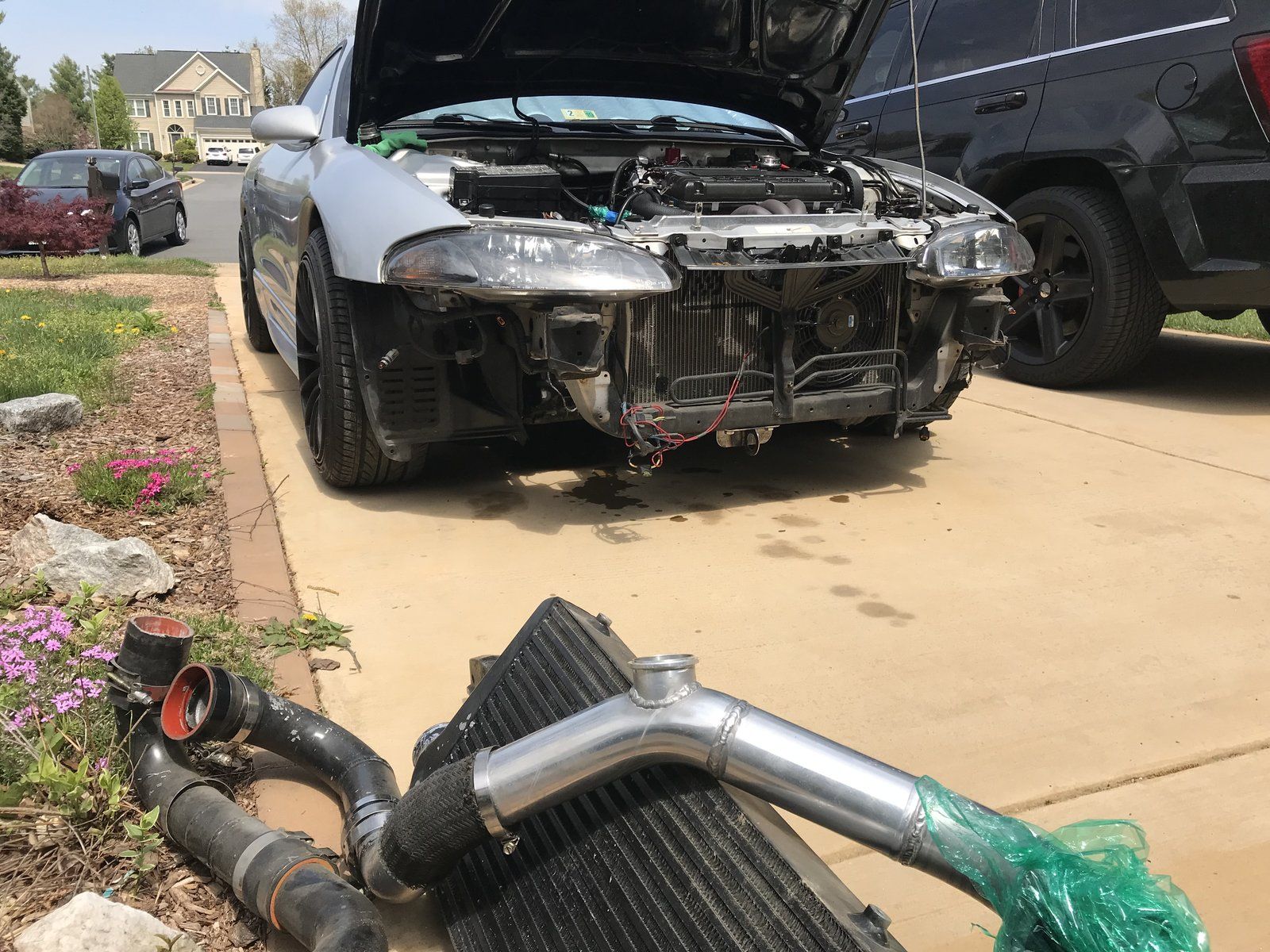

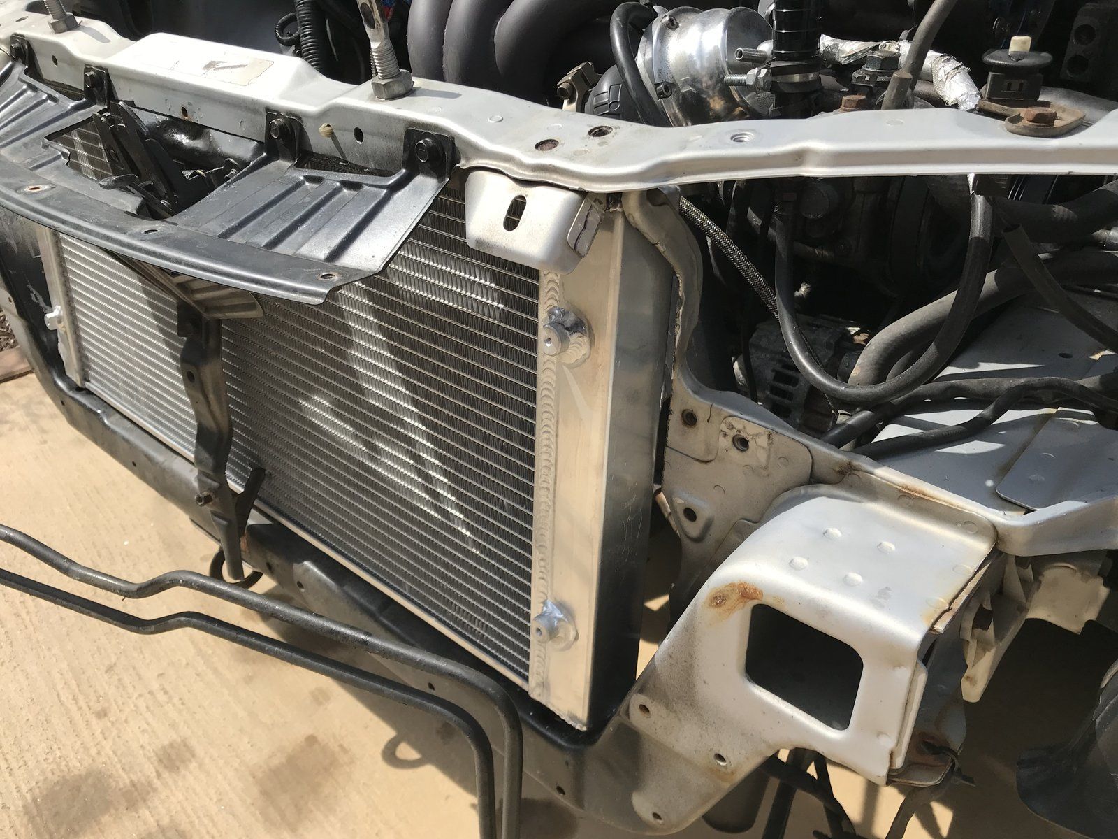

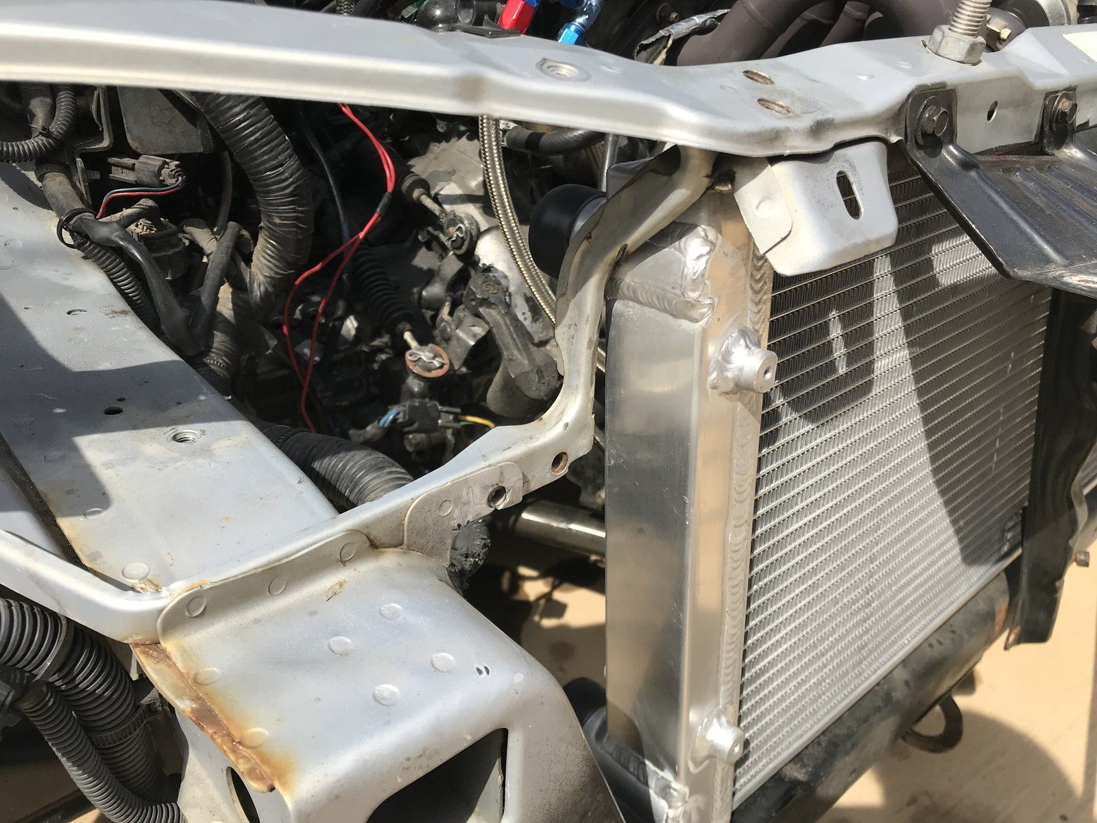

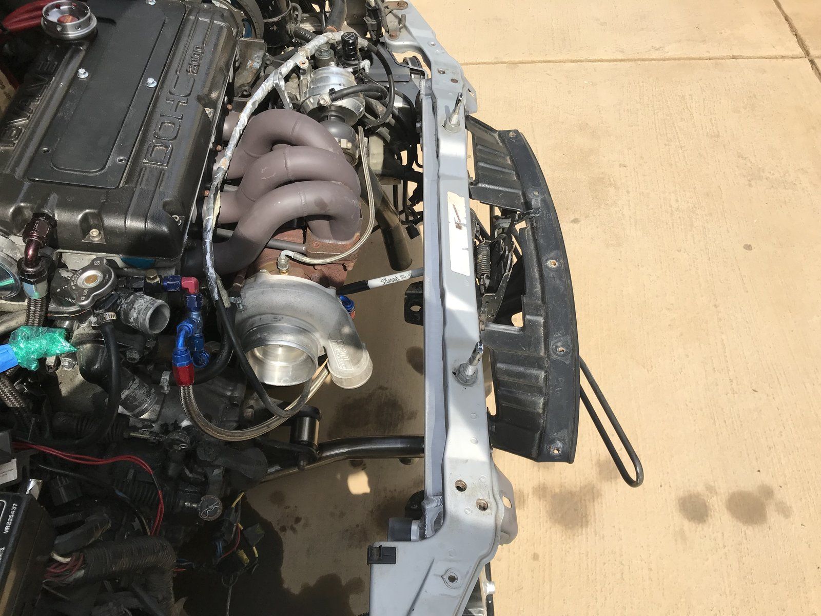

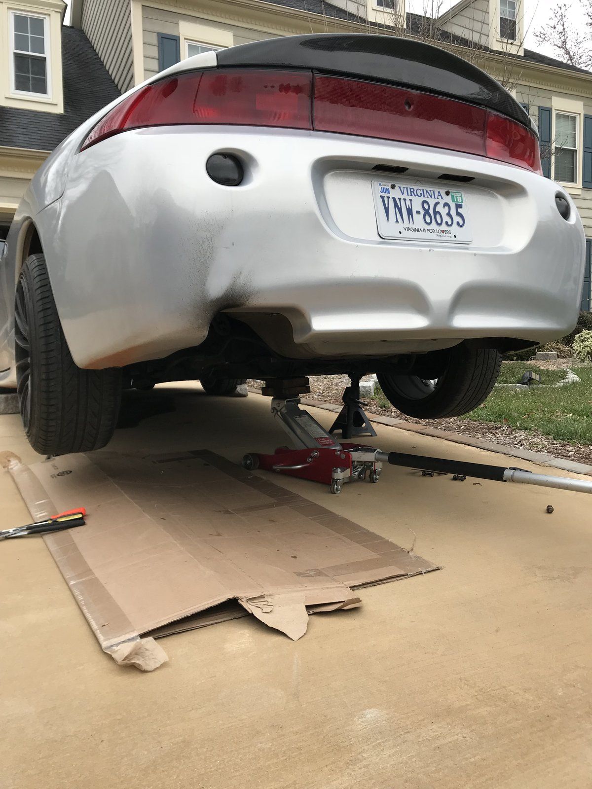

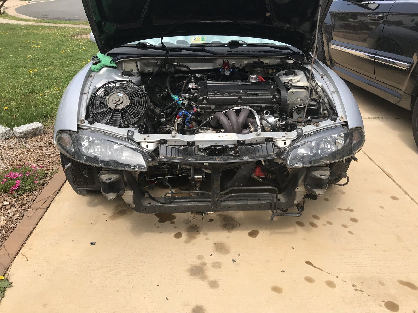

Also I got a lot of work done on the gsx getting my old Radiator, and FMIC kit removed for the new ones. This post is mostly going to be about the new Rad setup and what iv learned, so I can share it with others who want to do the same. The reason I went with this radiator is to accomplish a "tucked" radiator setup, while also freeing up more room in the bay for turbo setups, cosmetics, heat etc.
Here are the specs of my new VW MK3 Radiator:
Brand: HR Racing
Model: VW Golf MK3 2.0 MT 93-99 year.
Specs: Dual Pass.
28 x 12.5 x 2.25 (overall size)
Price: $130.00 shipped Ebay.
Pic for reference:

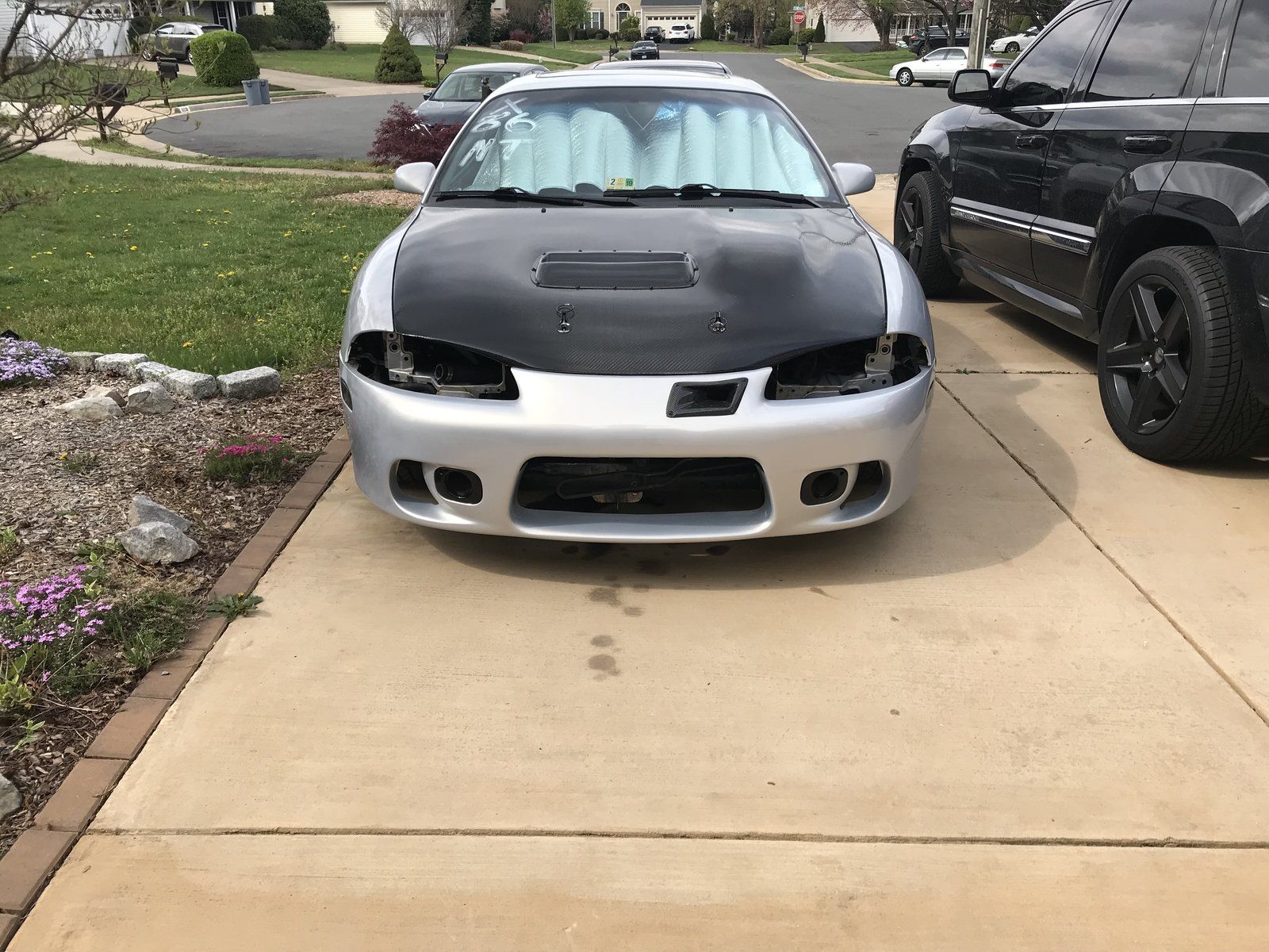

To do this install here is what I needed to remove from the GSX
-Bumper
-Crash Bar
-FMIC Kit
-Both Headlights.
-2G Style Radiator.
-Both Fans
-Power steering cooler.
Once all of that is removed. I took a look at this thread, and post #21 that showed another member doing this install, and what he had to cut.
http://www.dsmtuners.com/threads/vw-golf-mk3-radiator-like-scirocco-radiator-but-longer.434776/
Unfortunately, I think the dimensions have changed over the last couple years and my rad seemed to need more trimming of the core support to get it to fit. I ended up having to cut out material on both sides of the core support near the headlights. Along with some metal on the bottom part of the core. I also drilled holes in the bottom of the core to allow the post of the rad to sit in. I will buy some grommets later to finish it off.
At this time I was able to save my stock hood latch. I have proven to myself it is possible to keep it while doing this tucked core. So FYI to anyone who wants to do this and not have to run hood latches. I may still remove my stock latch but I am undecided at this time.
Right now I am figuring out Coolant hoses. It seems the OEM bottom one will fit fine. The top one needs to be replaced. I will probably also delete my power steering cooler as well.

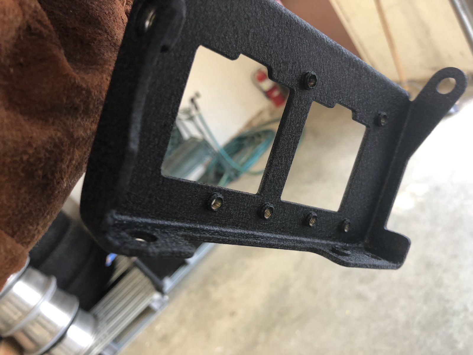

My buddy has this whole powder coating system and gave me a great price to coat a handful of engine parts Wrinkle black. He sent me some pics so I thought Id share. They came out pretty good grated we didn't sand blast them or anything, just a lot of oven cleaner and scrubbing.

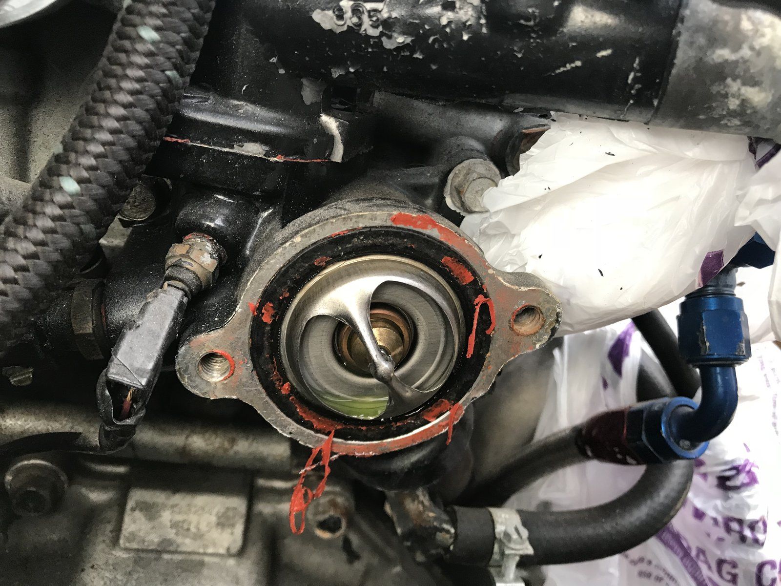

Also Decided to swap out my thermostat since the coolant was drained. No idea how old it is. For $12.00 its worth it. FYI I didn't put the silicon there.
