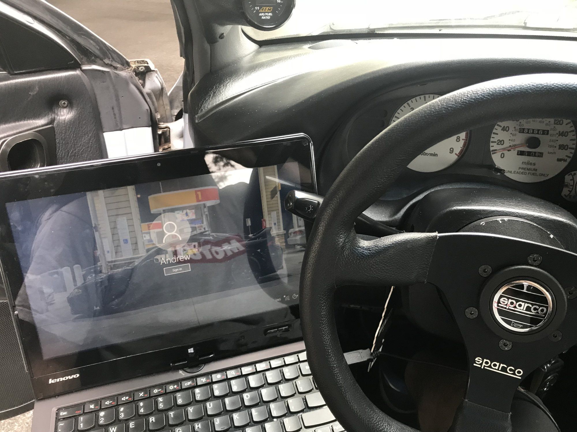

-Keep diagnosing the no start issue. Turns out half of my settings on link are missing. "Adjusted link and saved to ECU"

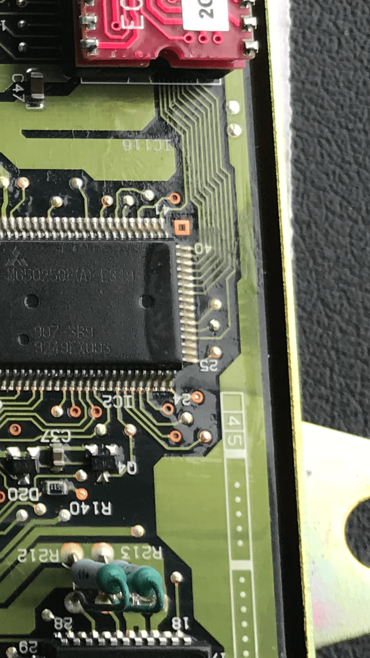

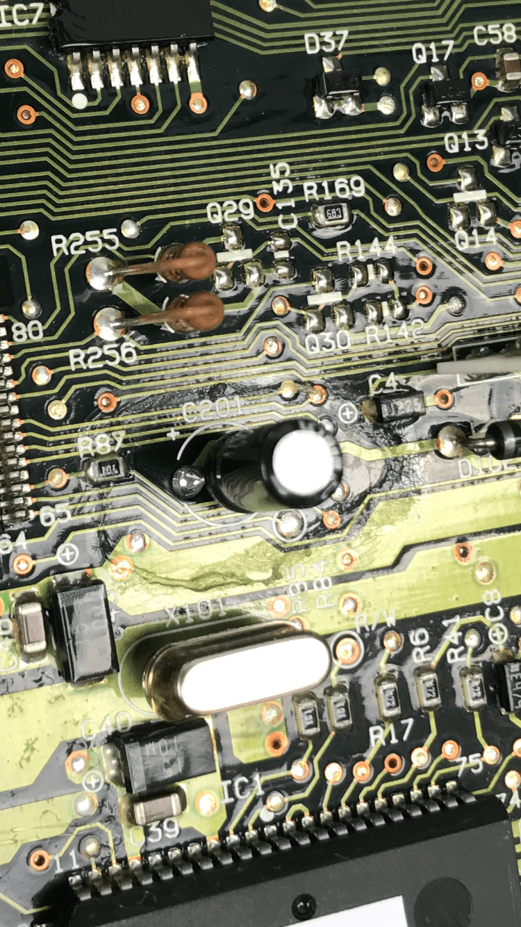

Well after more reading, testing and them more reading.... Things are pointing towards the ECU being the issue. After testing my resistor pack yesterday and it failing in the correct ohm range. I went ahead and pulled my ECU.
It looks a little suspect to say the least... Iv reached out to ECMtuning, to get some feedback.

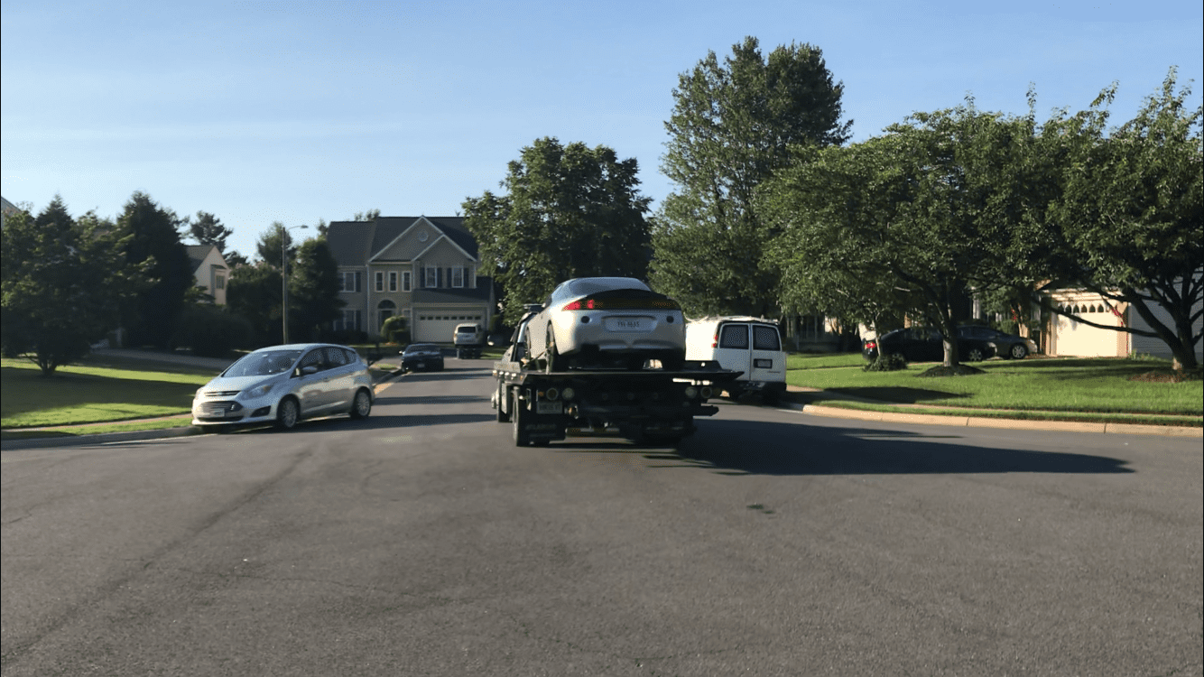

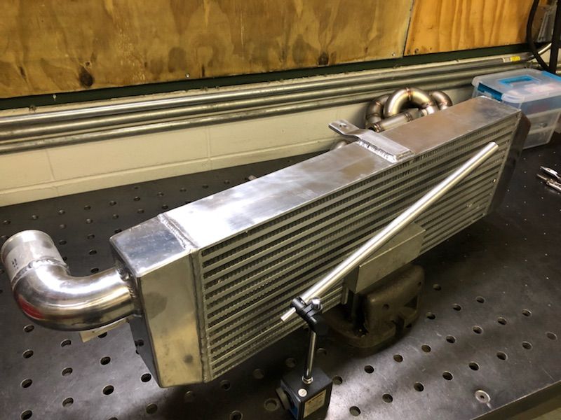

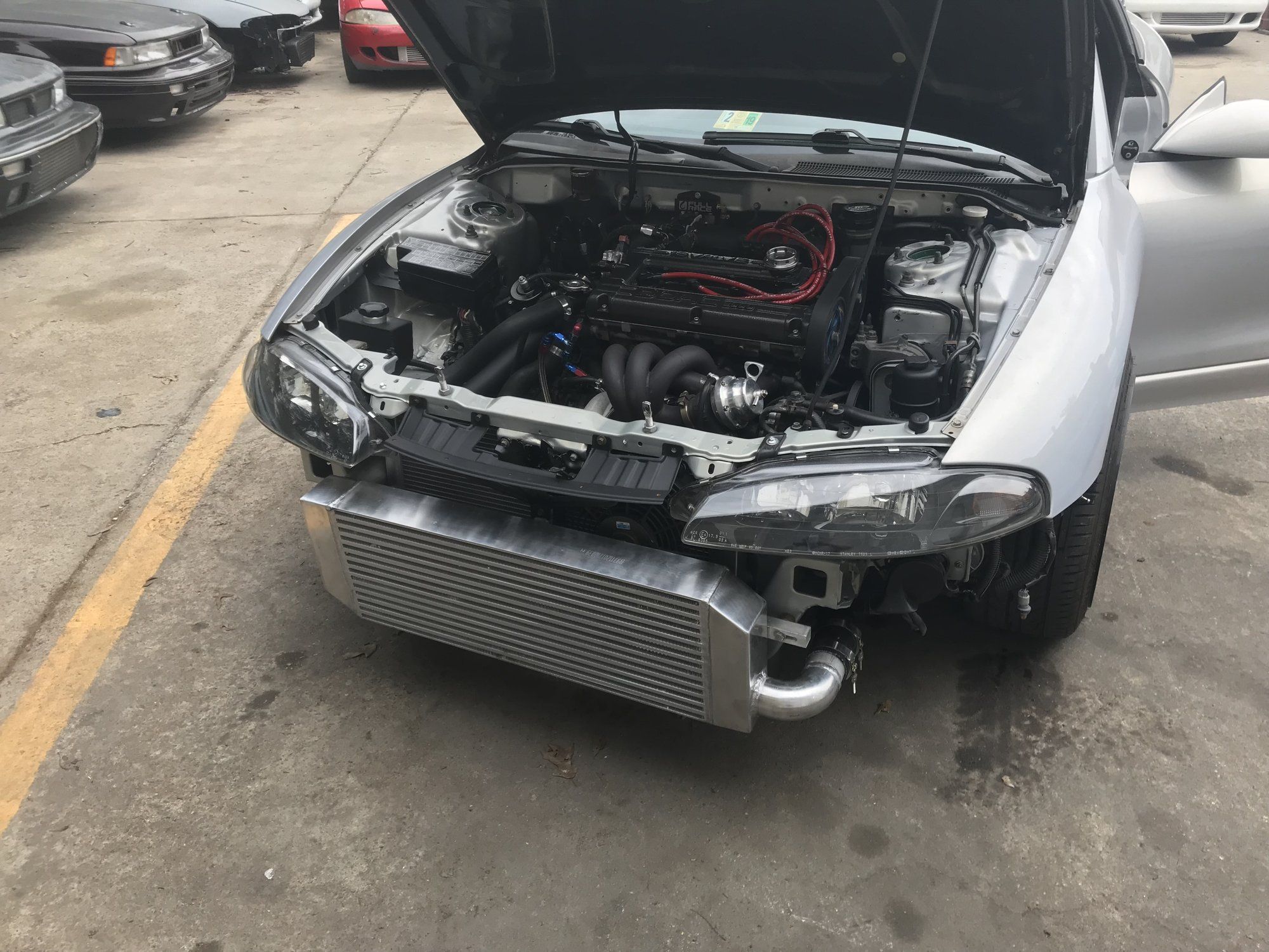

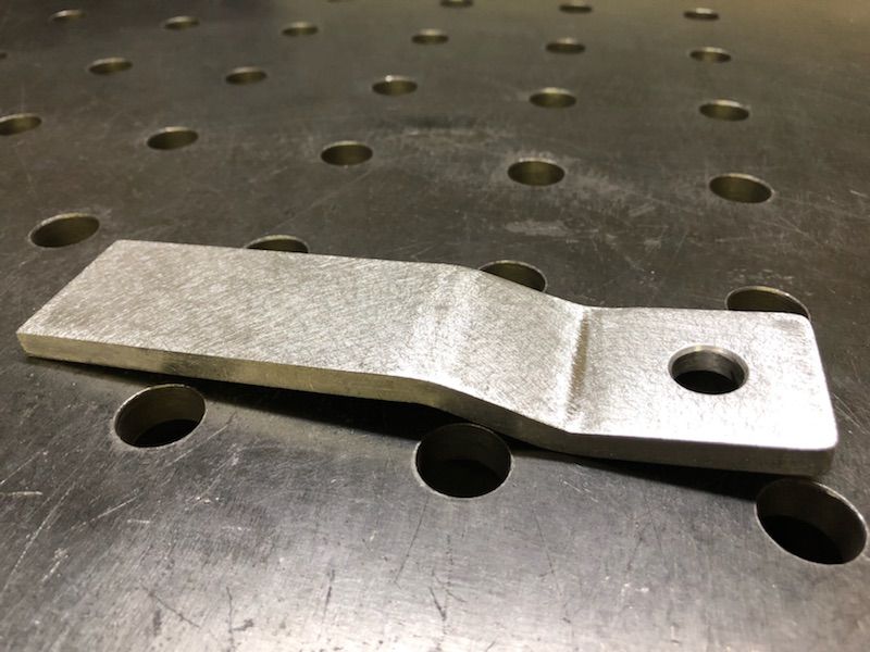

This past Friday, I had the car towed down to my buddies shop in Fredericksburg. He is going to modify the downpipe for the new catback exhaust, and maybe add a lower bracket to the vrsf core. In my opinion the core moves around to much with the supplied brackets.
Update 7/5/18

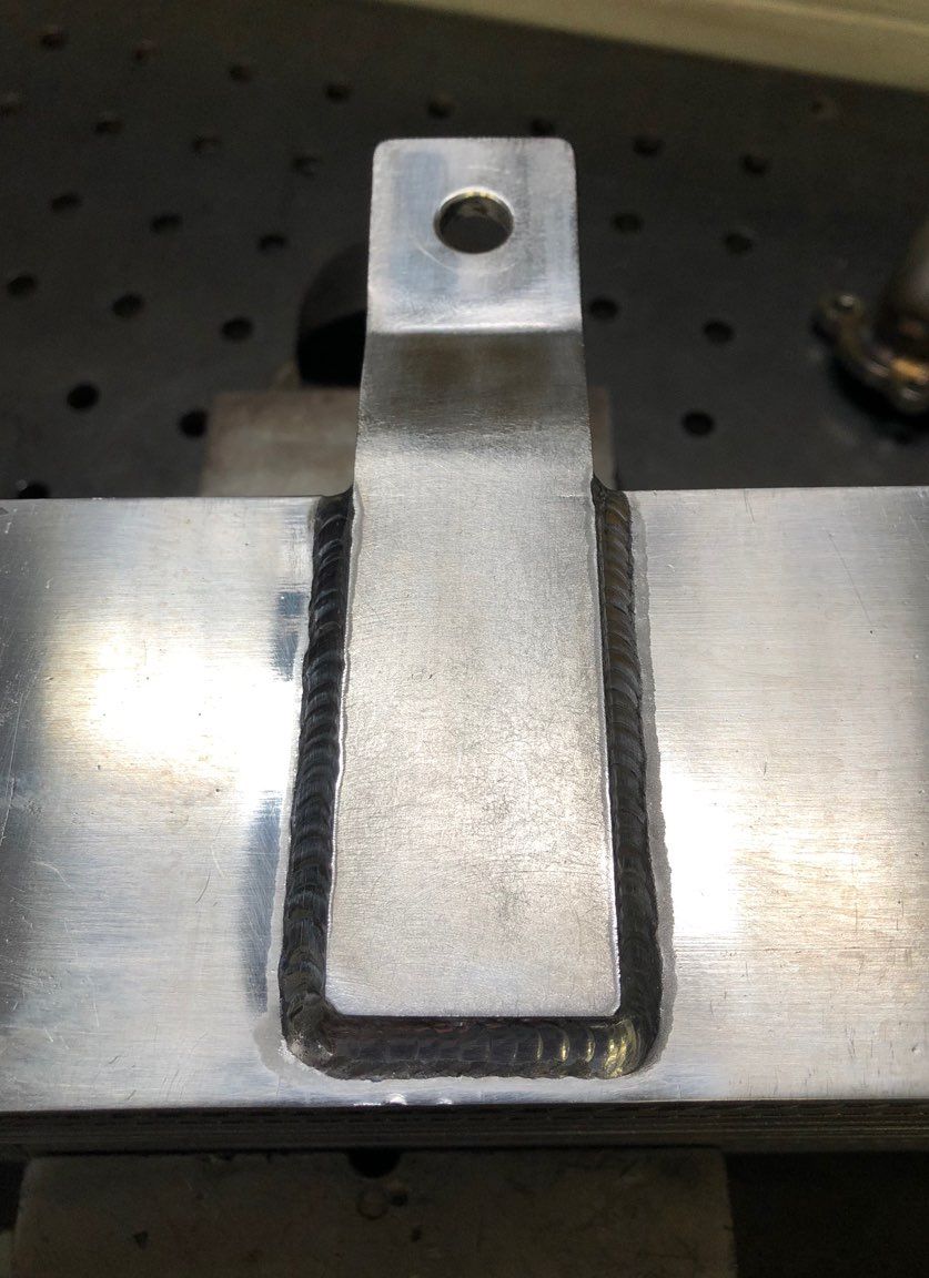

Well the welding work is all done. Ronnie is so quick even though I told him not rush and to take his time.
He added a lower bracket to the VRSF core to stop it from moving around. Take a Look at those welds. :O
I don't have any pics of the STM catback installed just yet, but I'll post them later. Ronnie did point out that my downpipe will need to be fixed eventually. It is rubbing against my T-case how it sits now. I'm glad He brought it to my attention, but I'm not sure how long I will be using this setup with all these cool manifolds the vendors offer. So I'm going to let it be for now.

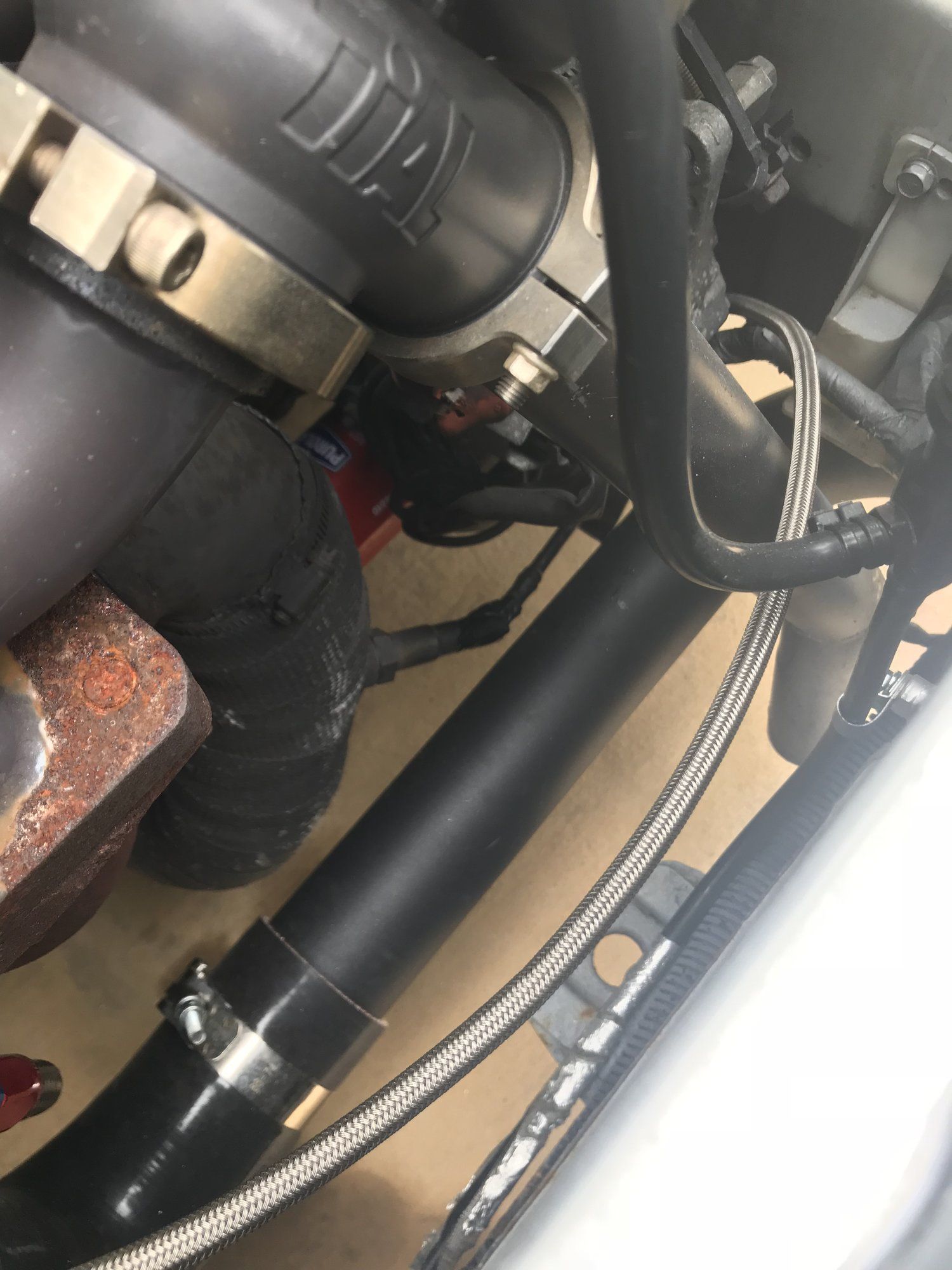

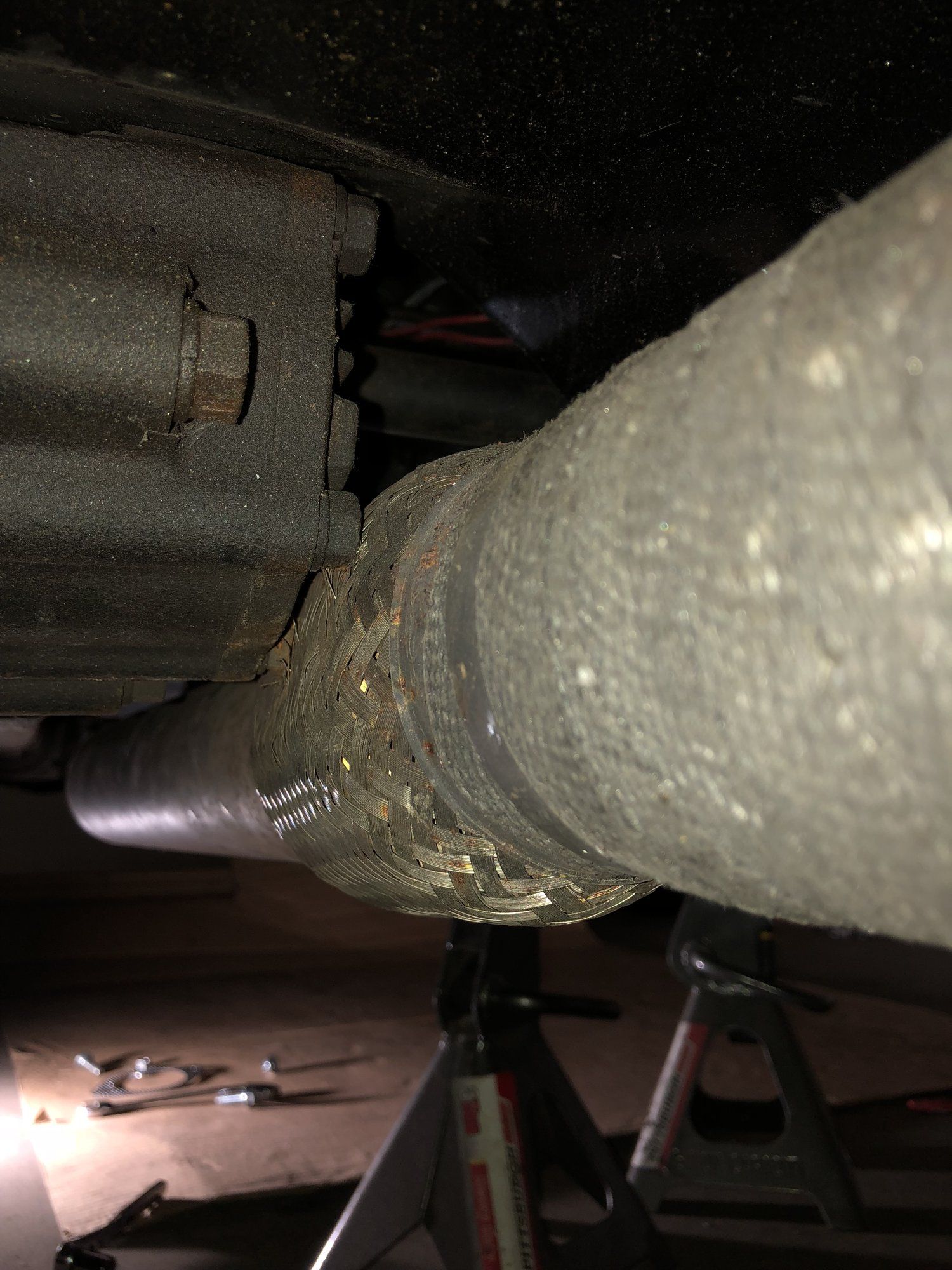

My 02 sensor was hitting my lower pipe when the engine moves, also my “service engine light” flashes when I tried to give the car boost on the ride home.

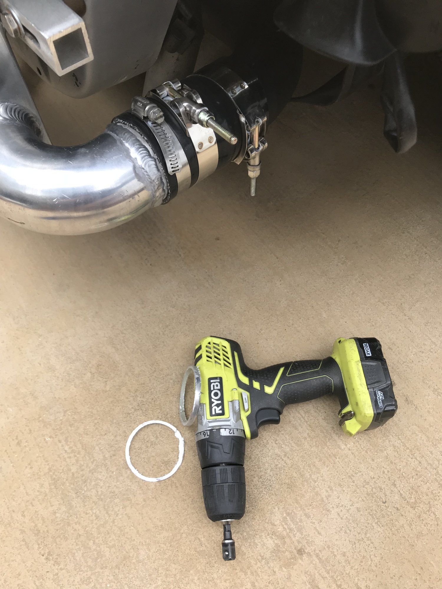

I went ahead and cut the flange on the fmic pipe .25 shorter, and re-installed the lower pipe. No more interference on the sensor. I erased the codes as well, I’m going to drive the car and see if the light comes on again.

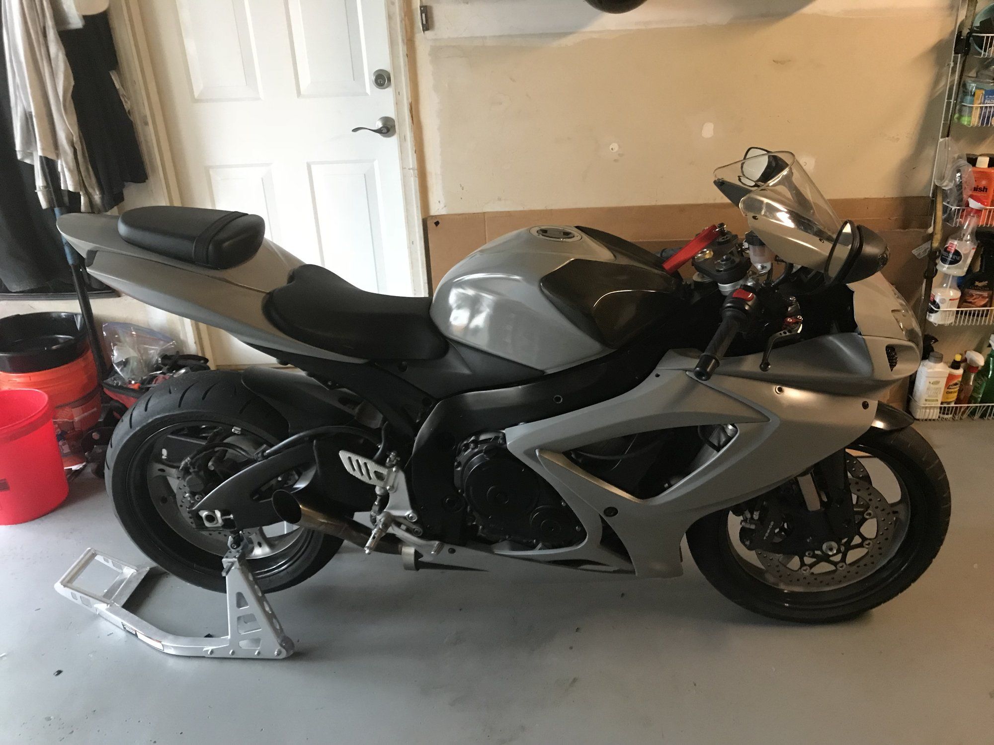

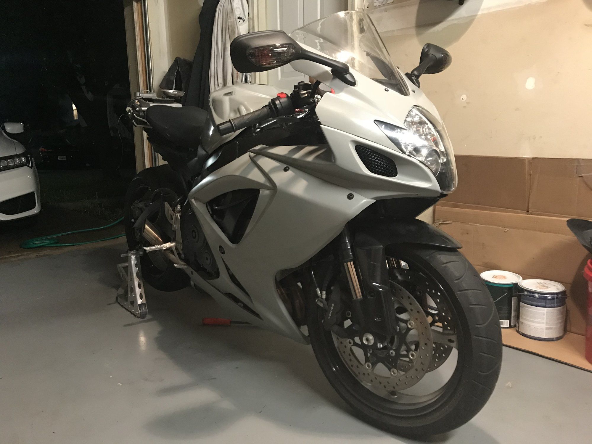

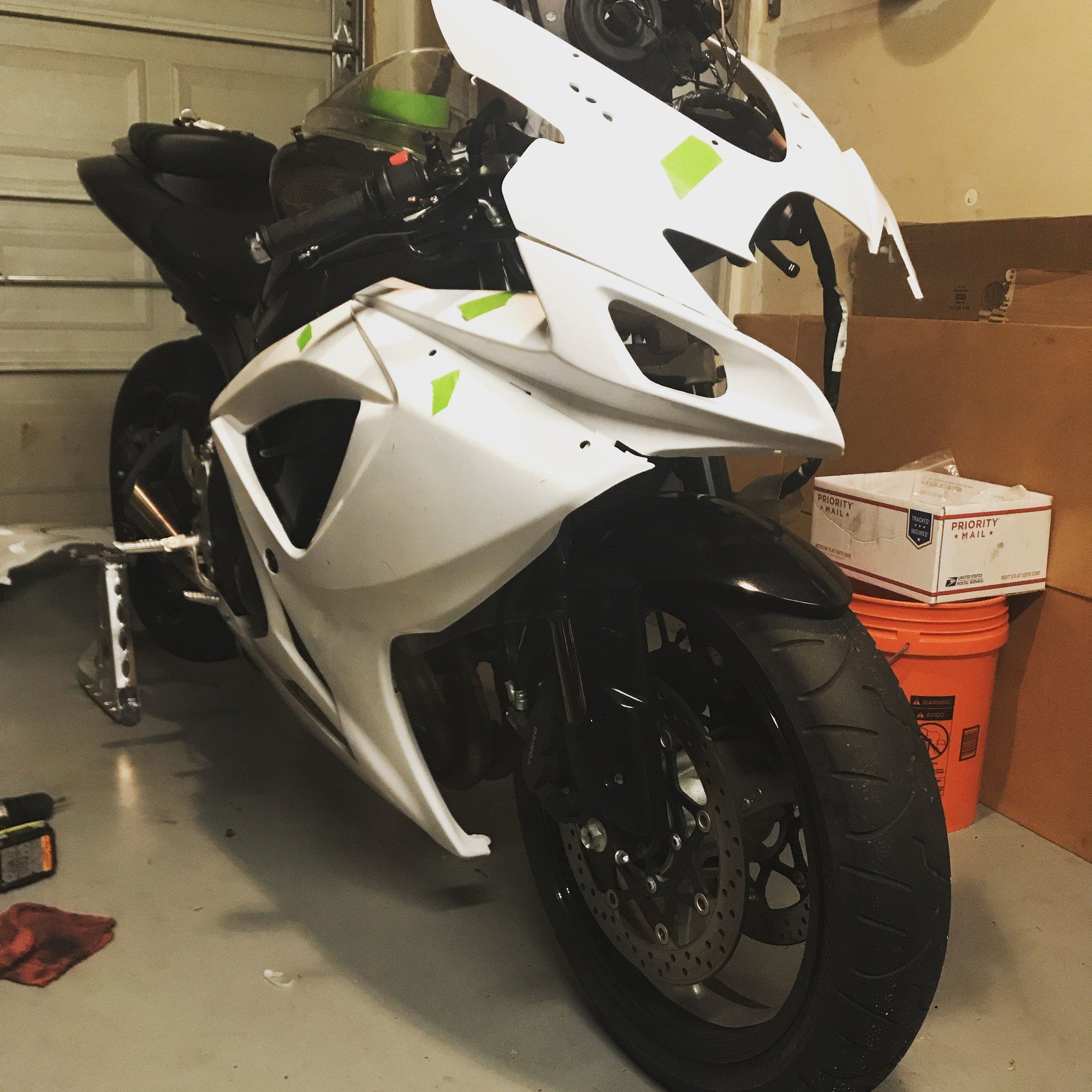

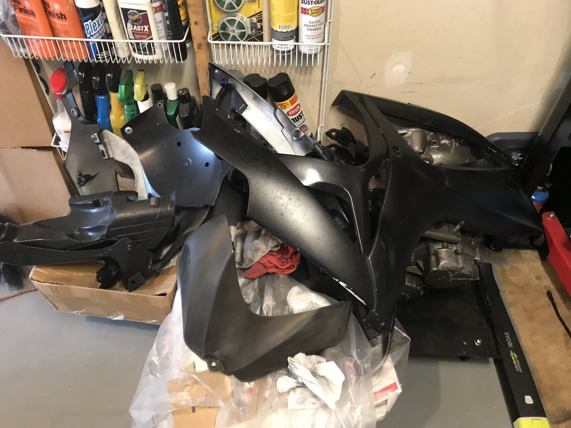

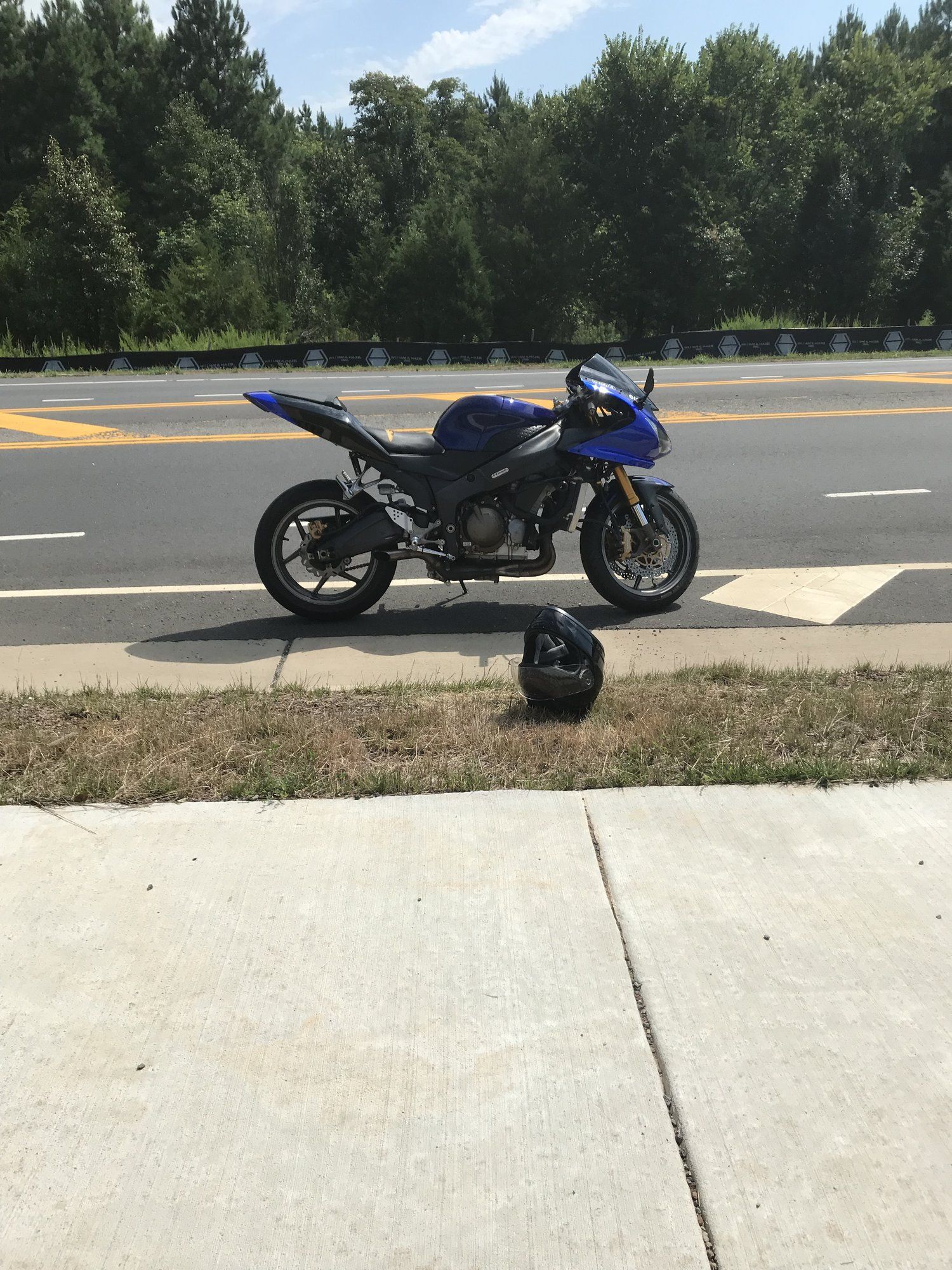

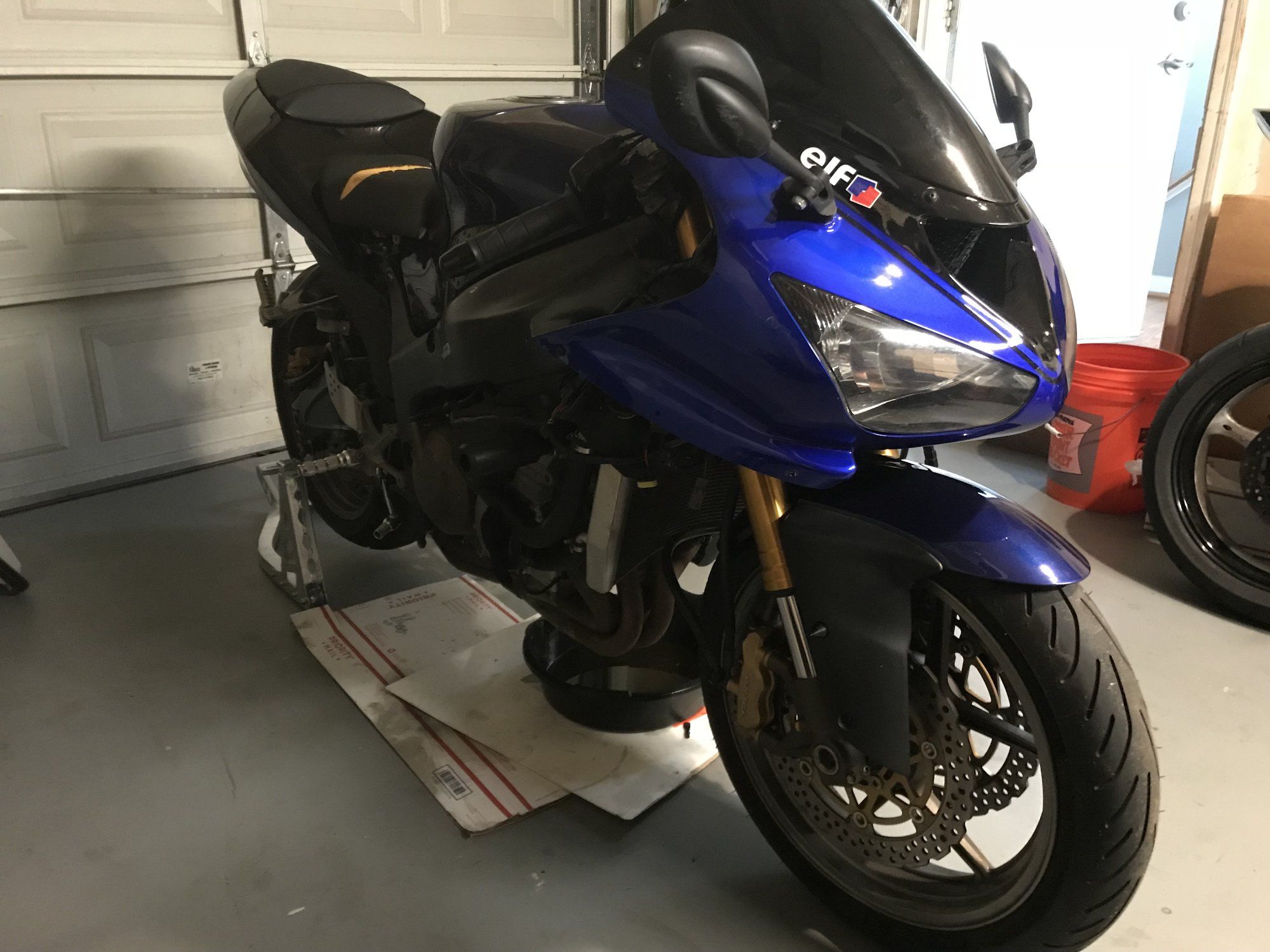

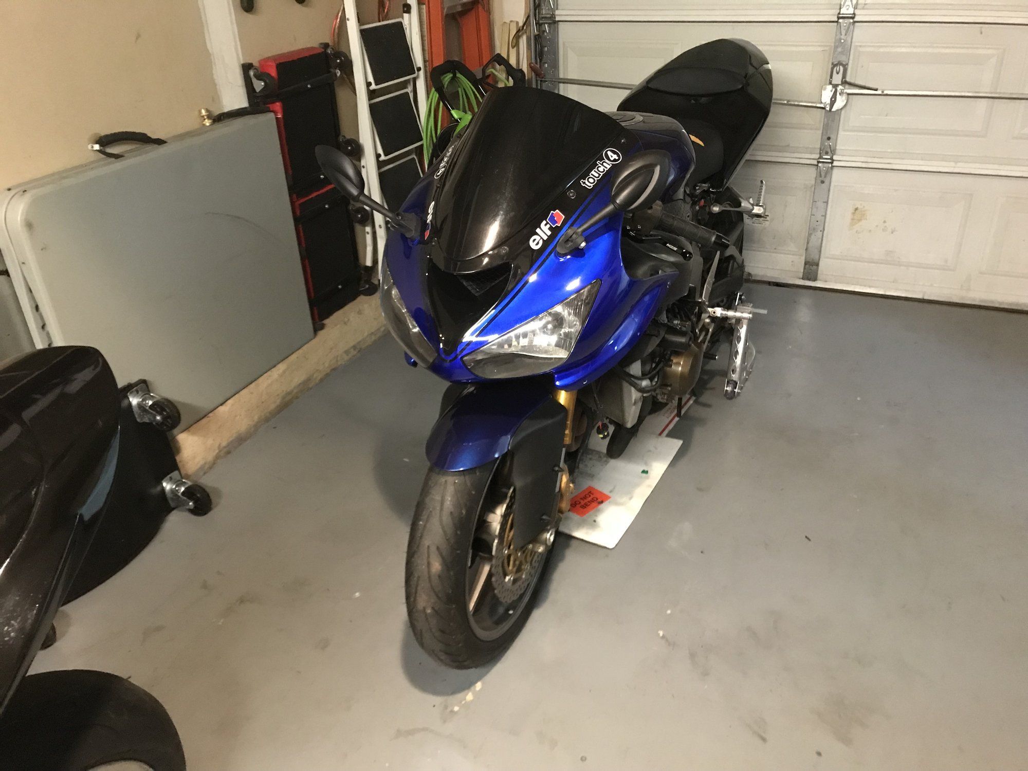

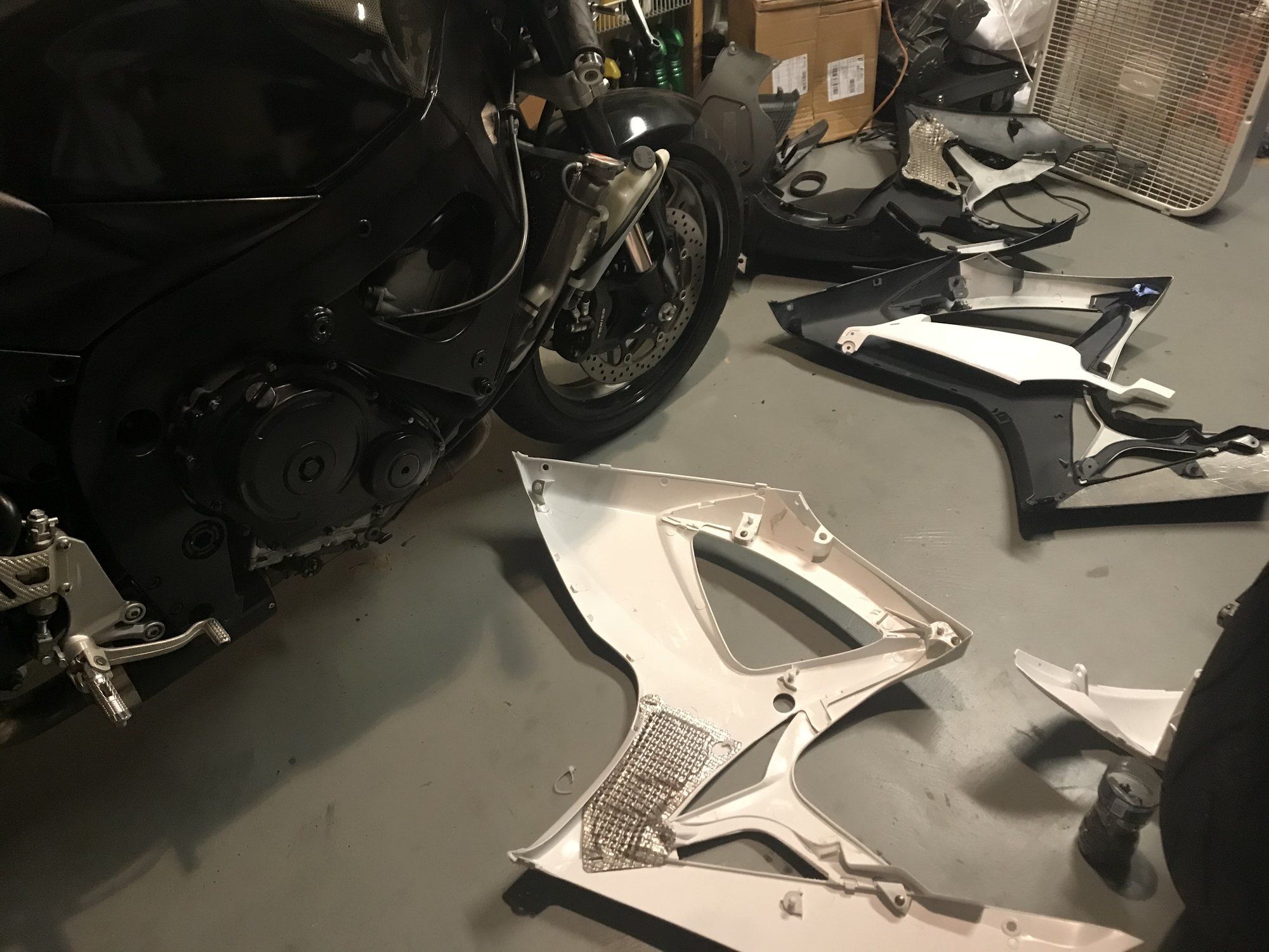

So I sold the 636 last weekend, and have switched my attention back to the Gsxr 750 I'v had sitting it the corner of my garage. Title finally came in so I could register it. Rode it a couple times last week to work. The bike looks good in pictures, but up close the fairings are in terrible shape.
Scratches and cracks all over. Iv been waiting for the title to come in before diving into this project, and the time has come.

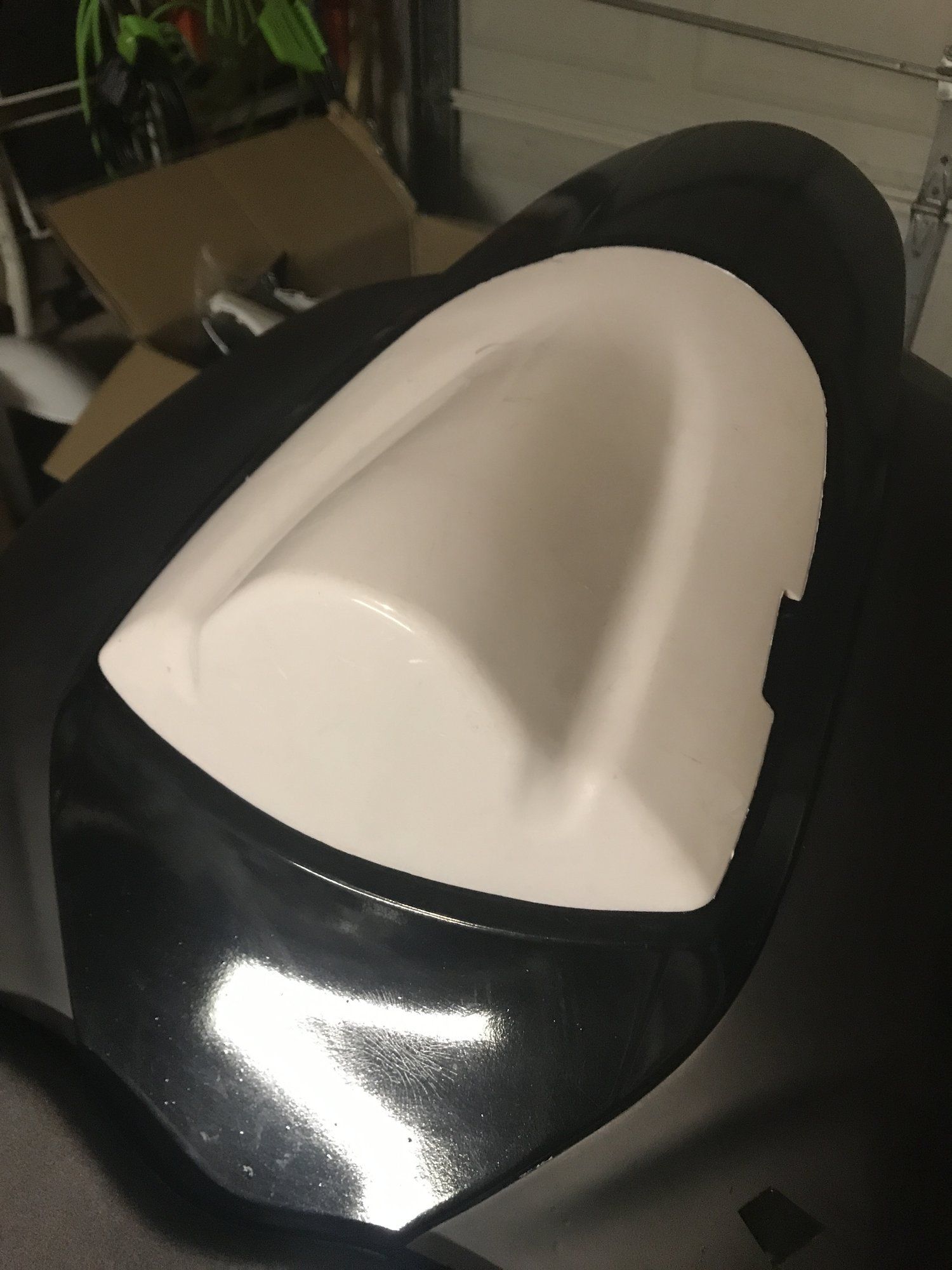

I got lucky and found some 750 fairings for sale local and picked them up for a steal.
Their fiberglass but the test fit went well, so its time to get them sprayed.

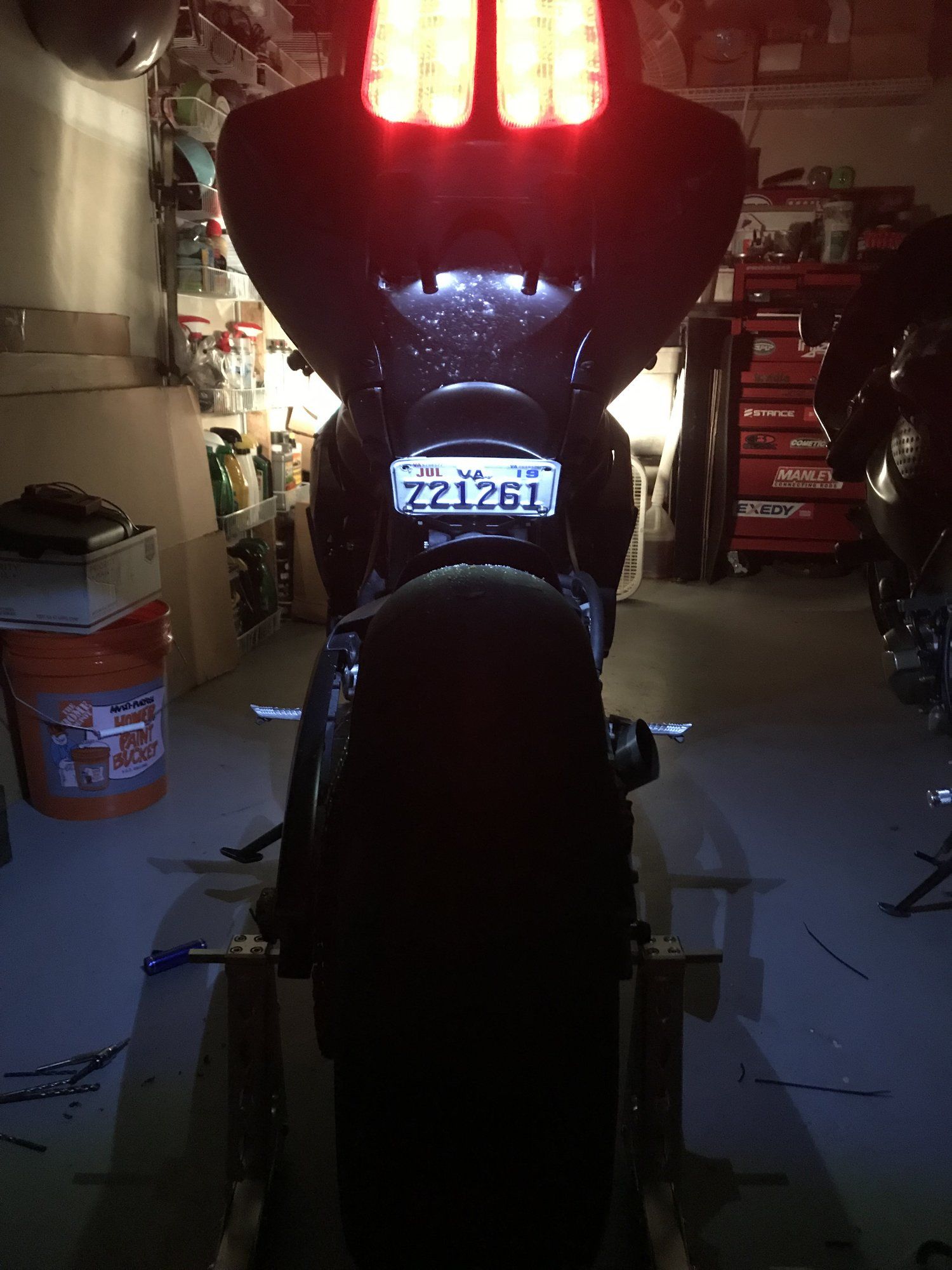

I low mounted the license plate and also installed some under tail LEDs. Might be a little to bright on the street at night, so I may switch from two to one LED. Well see.....

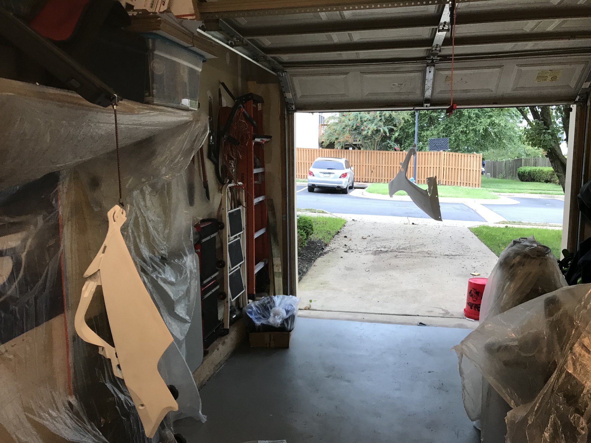

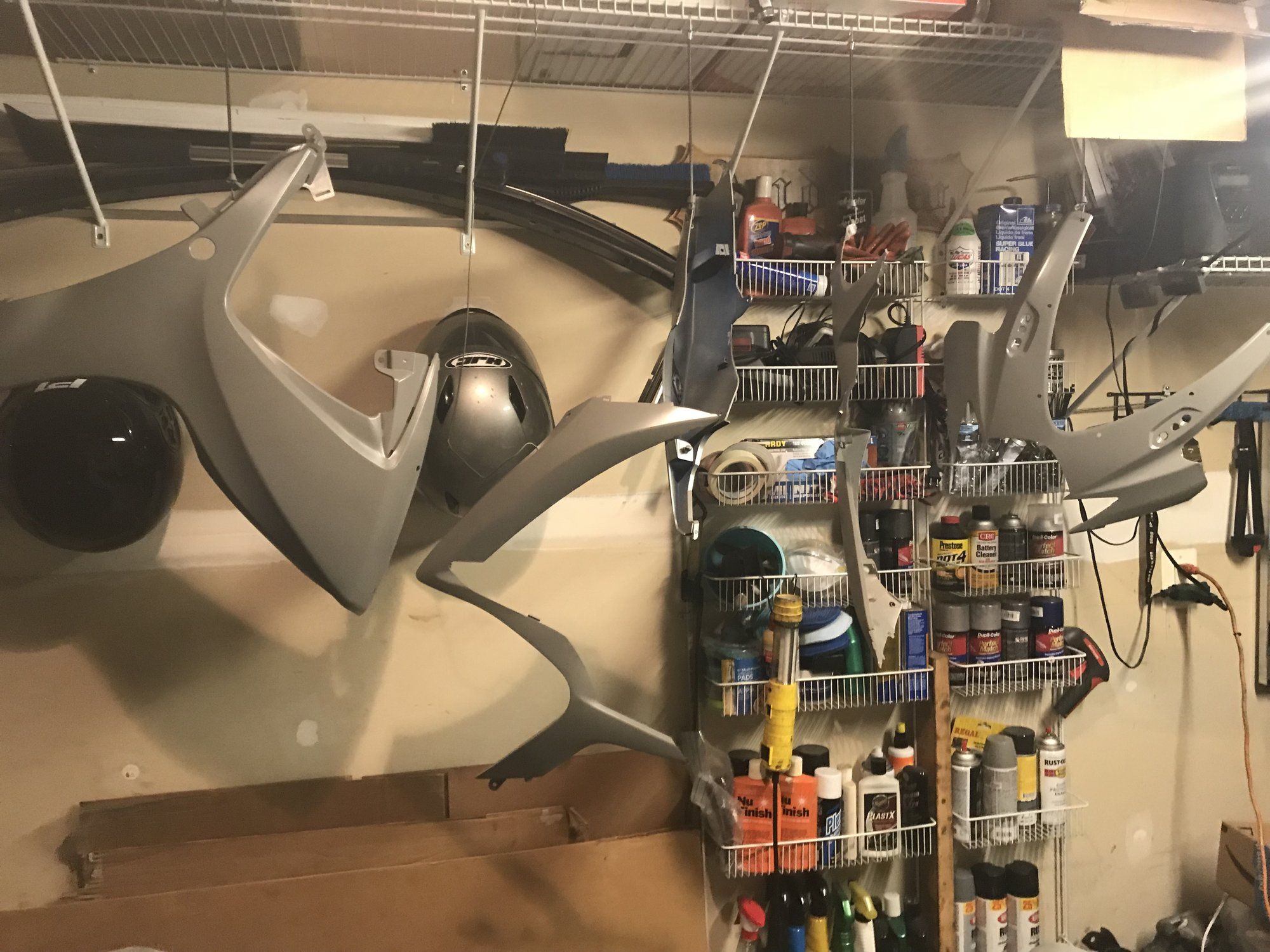

But, I have mostly been working on my GSXR 750 over the last couple weekends. I was going to get my fairings professionally painted but after getting a couple quotes,it just doesn't fit into the budget for this year. Va property taxes suck.
I decide to just rattle can it with some stuff I have at home, since riding season is almost over... Ill just wait to paint it next year, and get it done right.

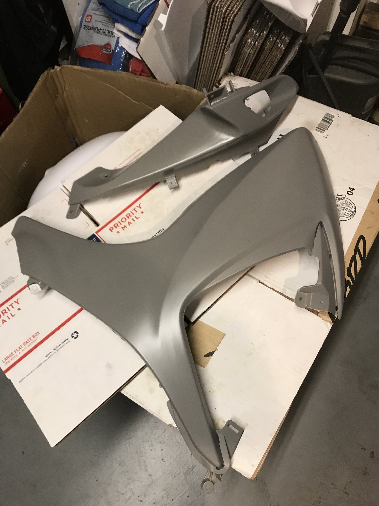

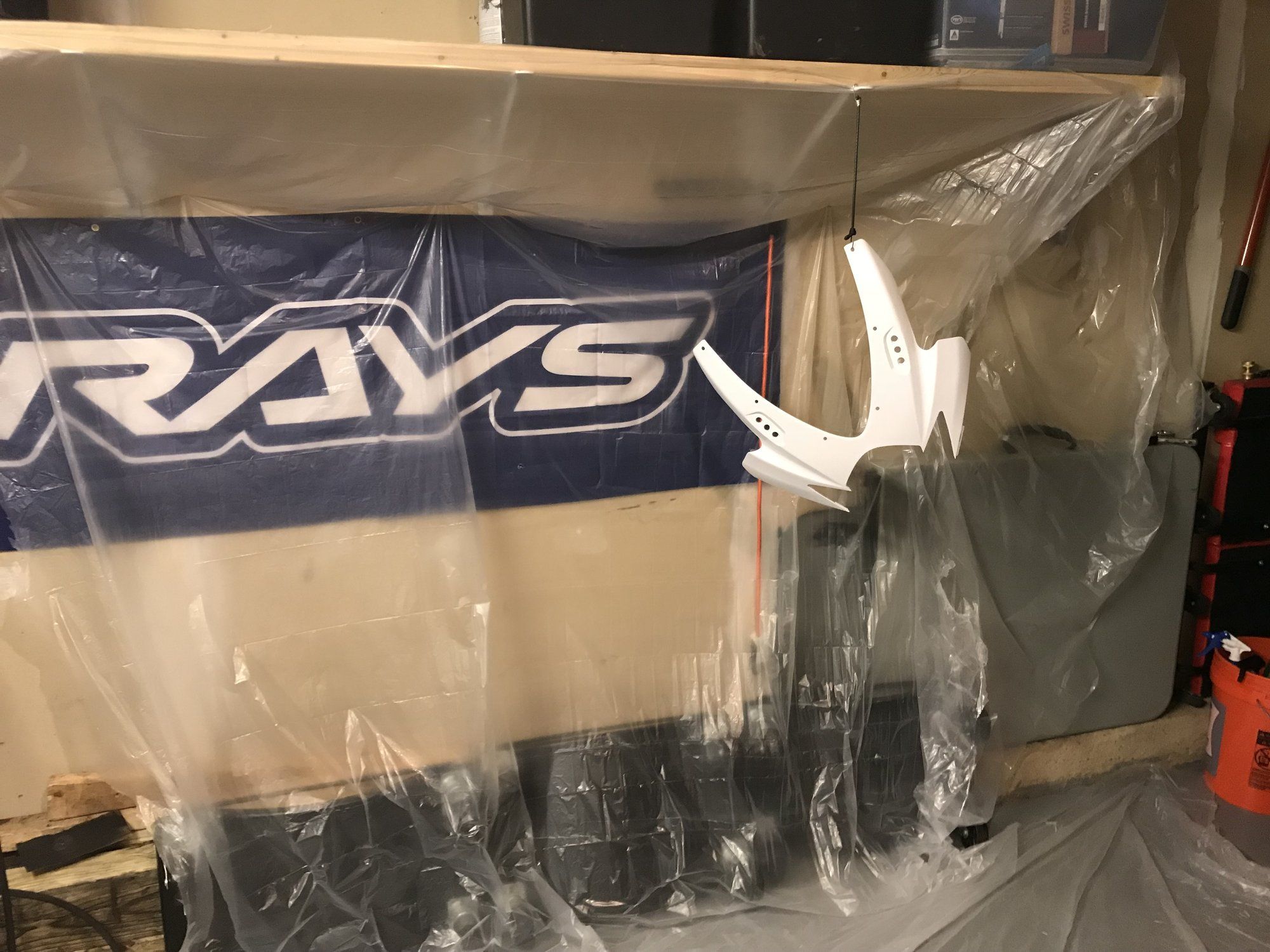

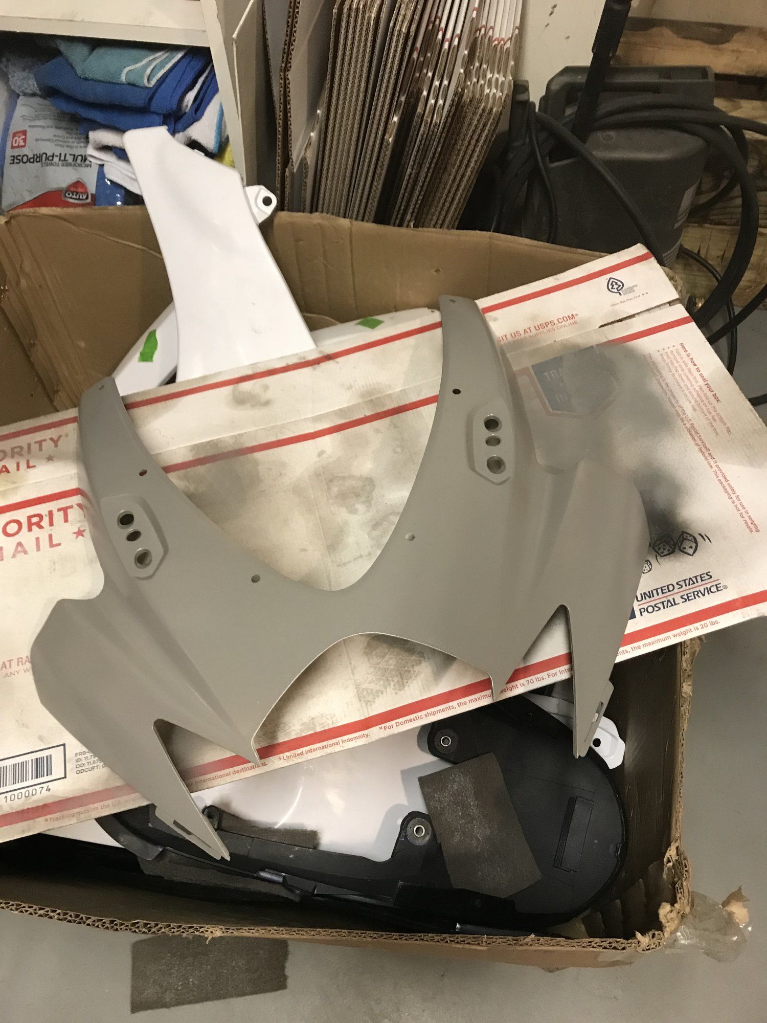

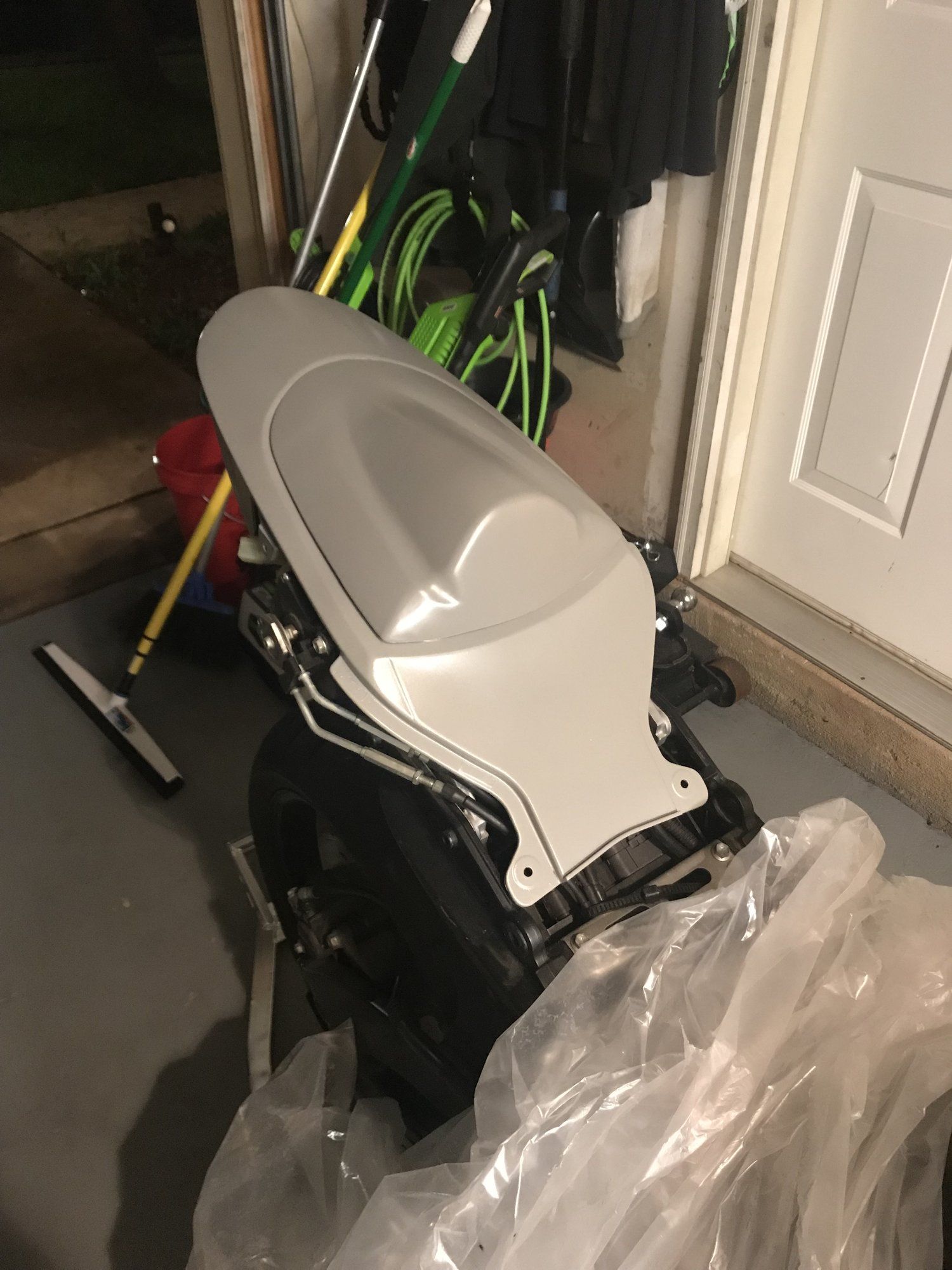

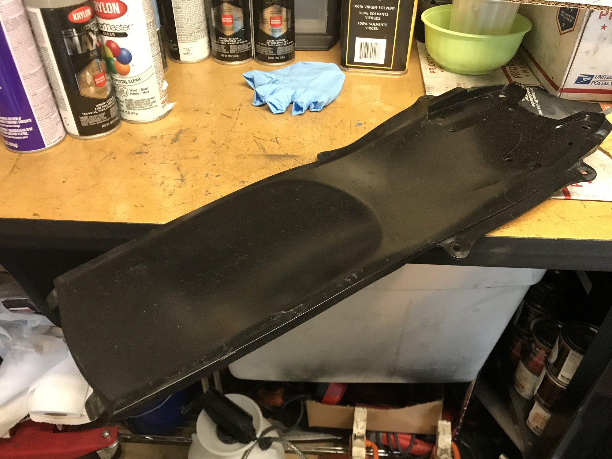

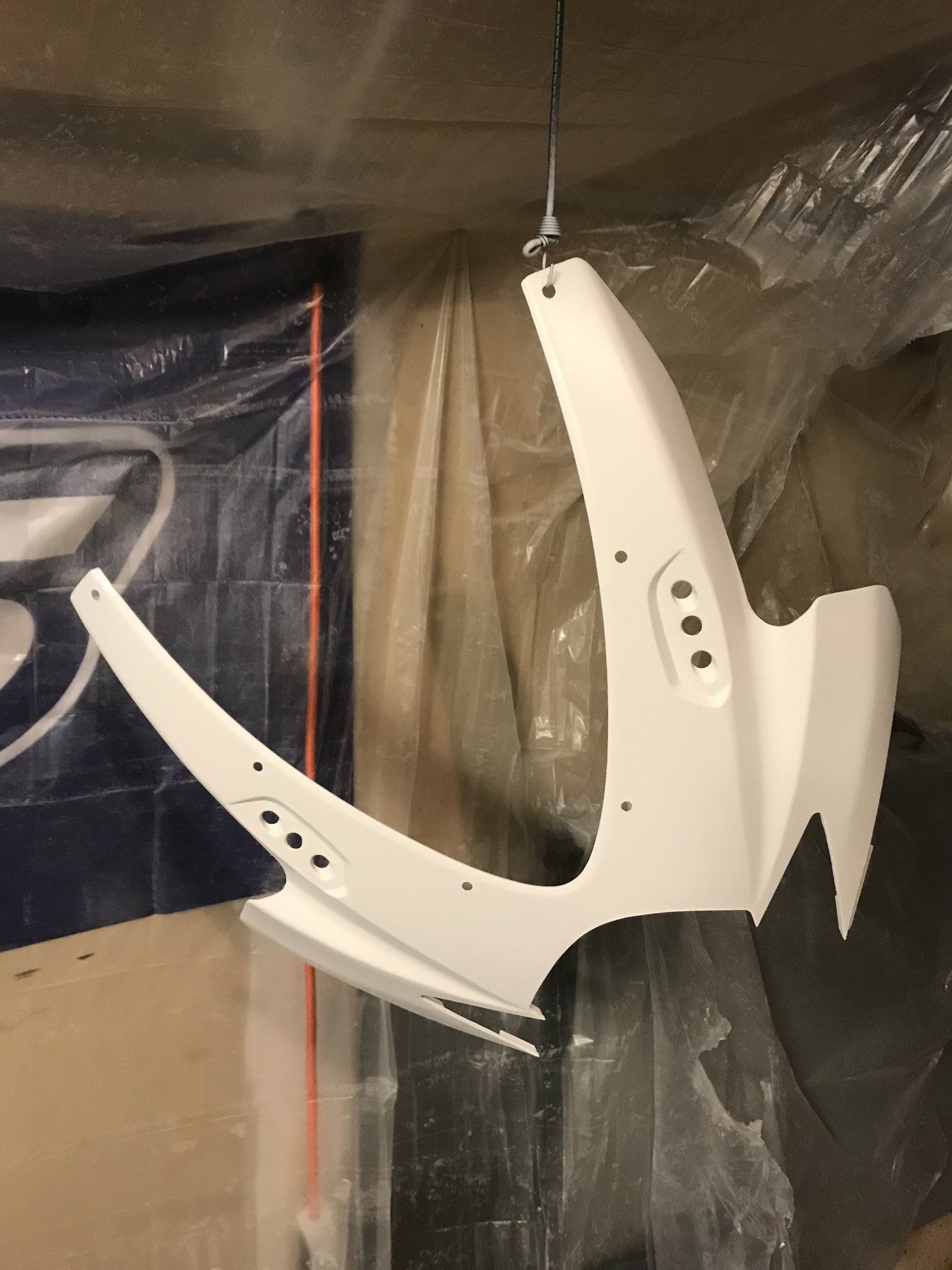

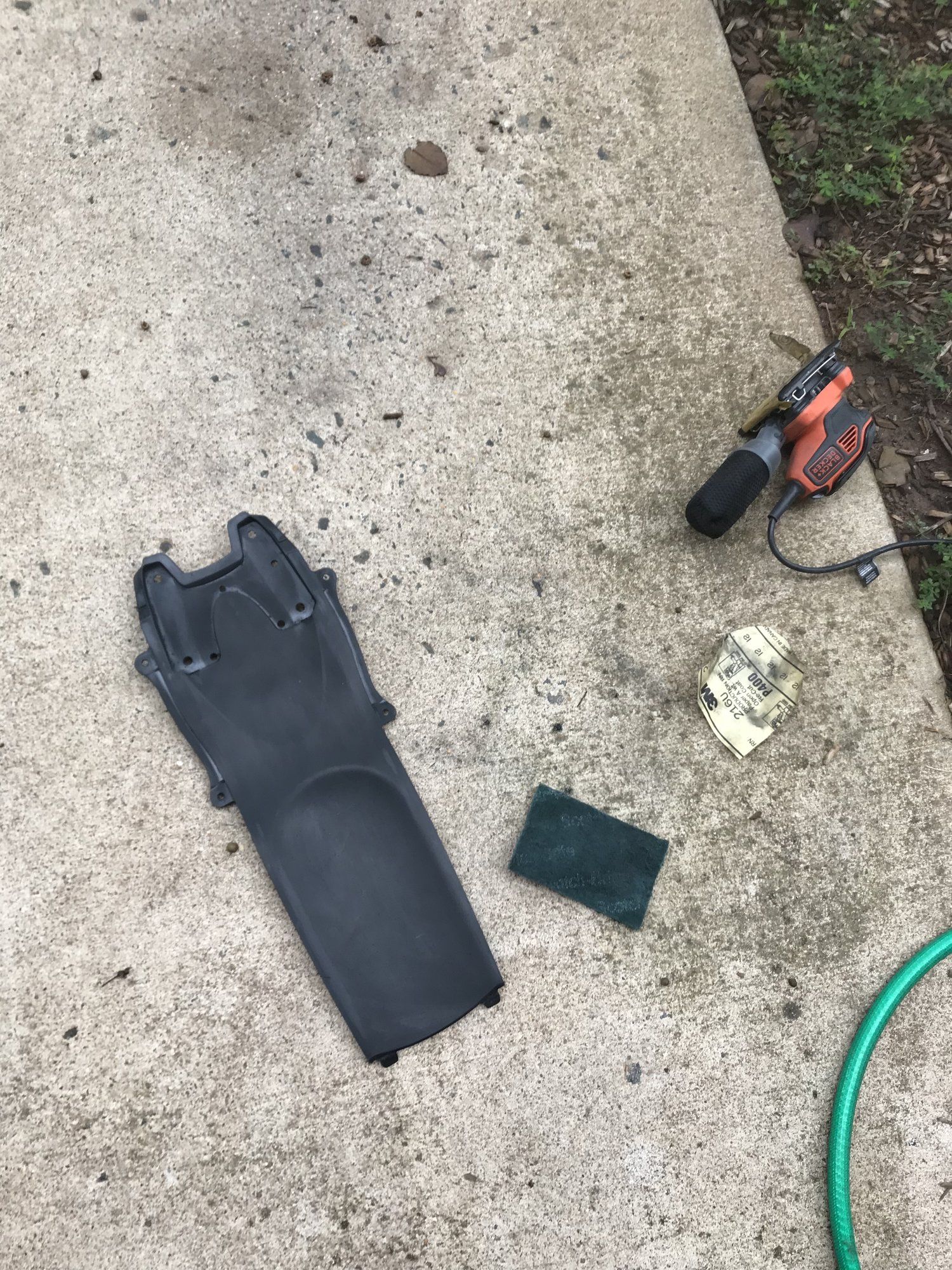

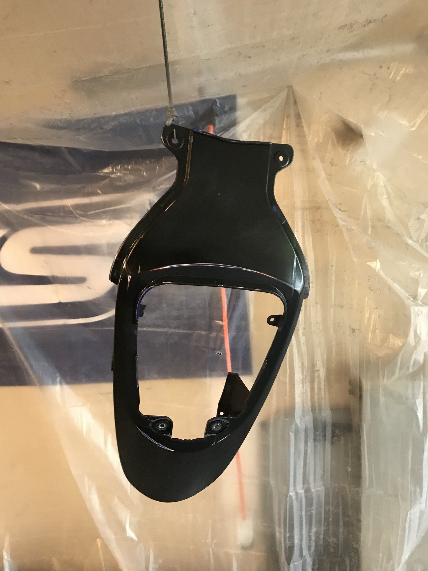

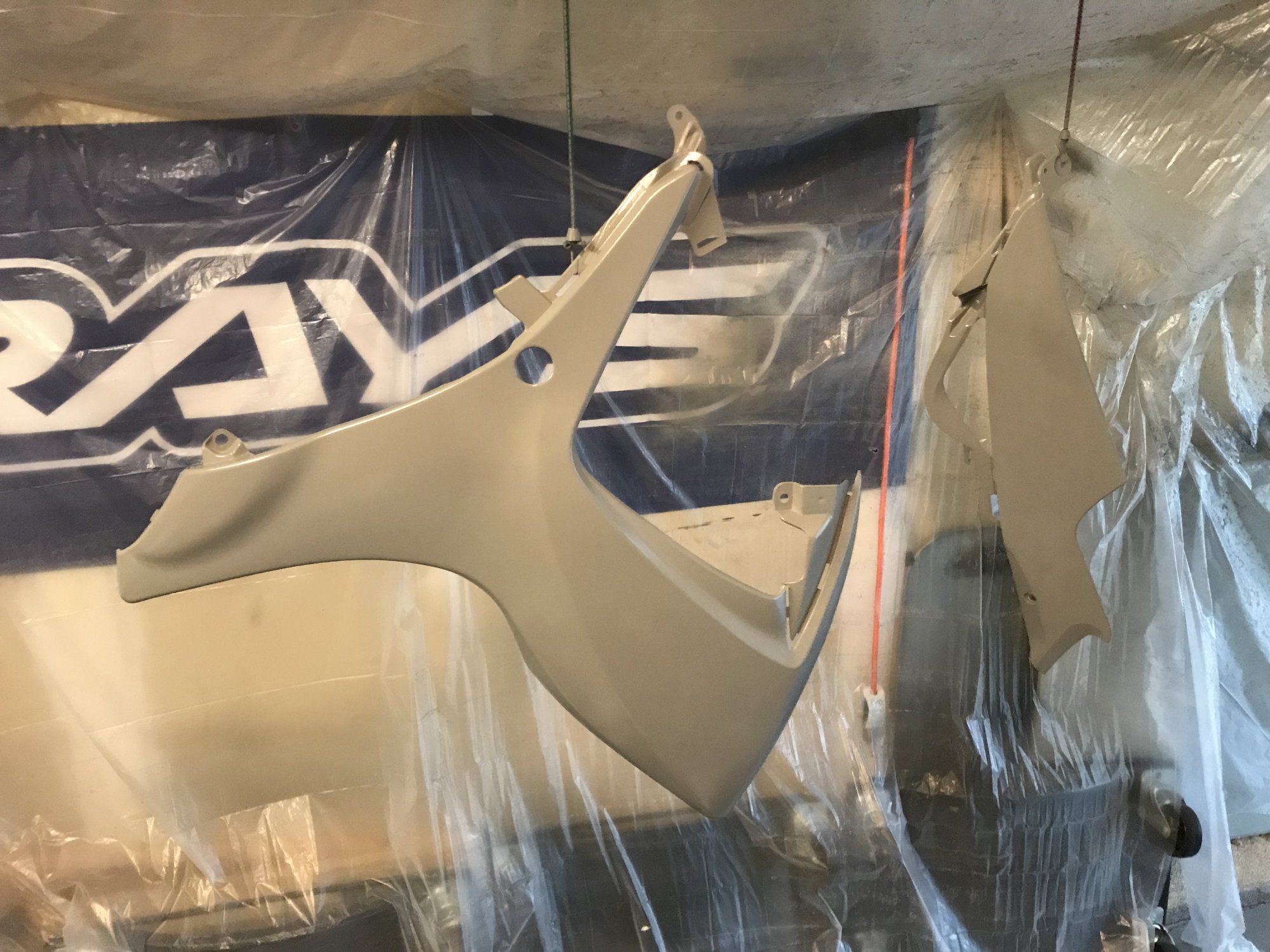

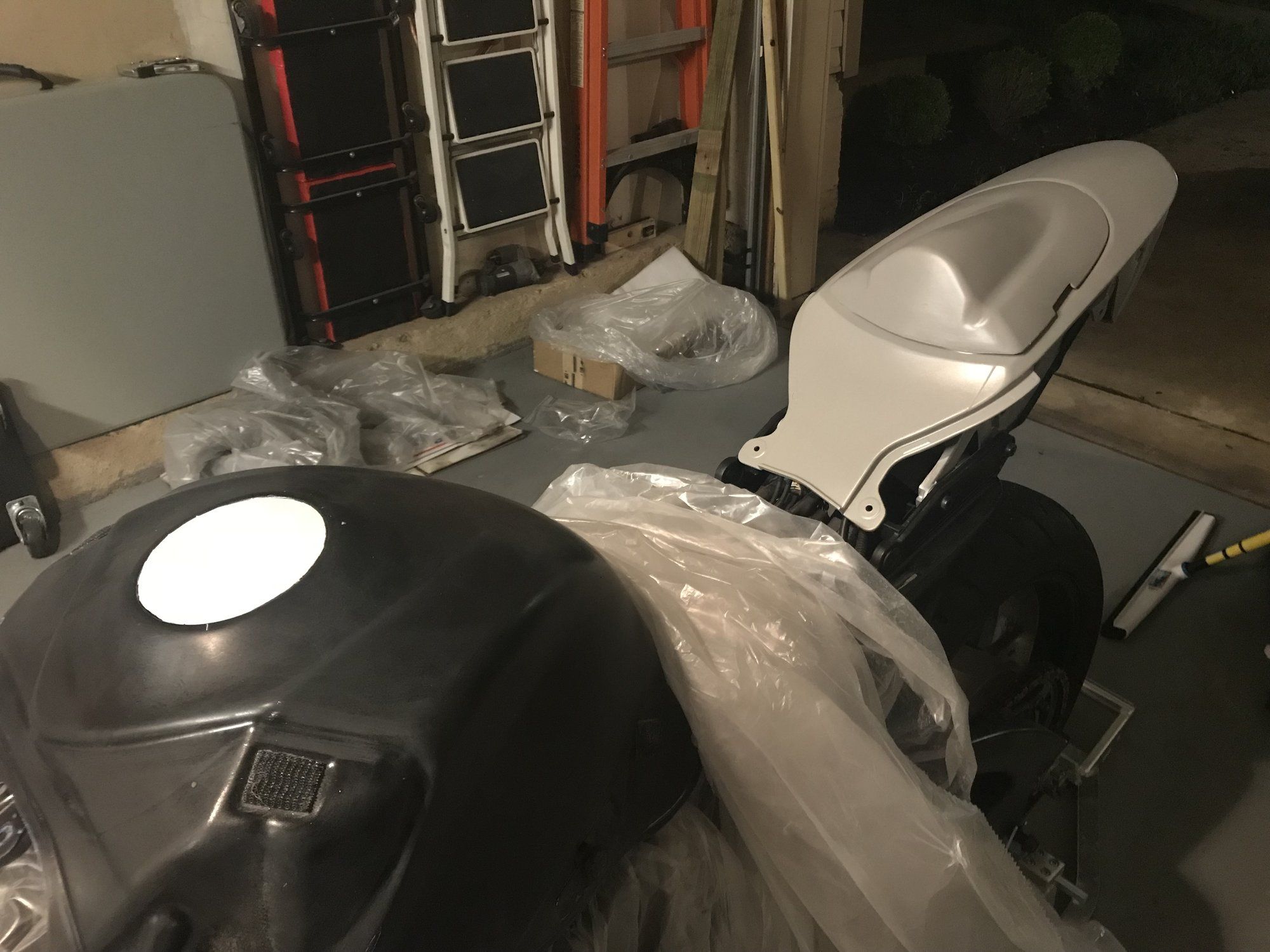

Starting to sand and prep the fairings for paint.

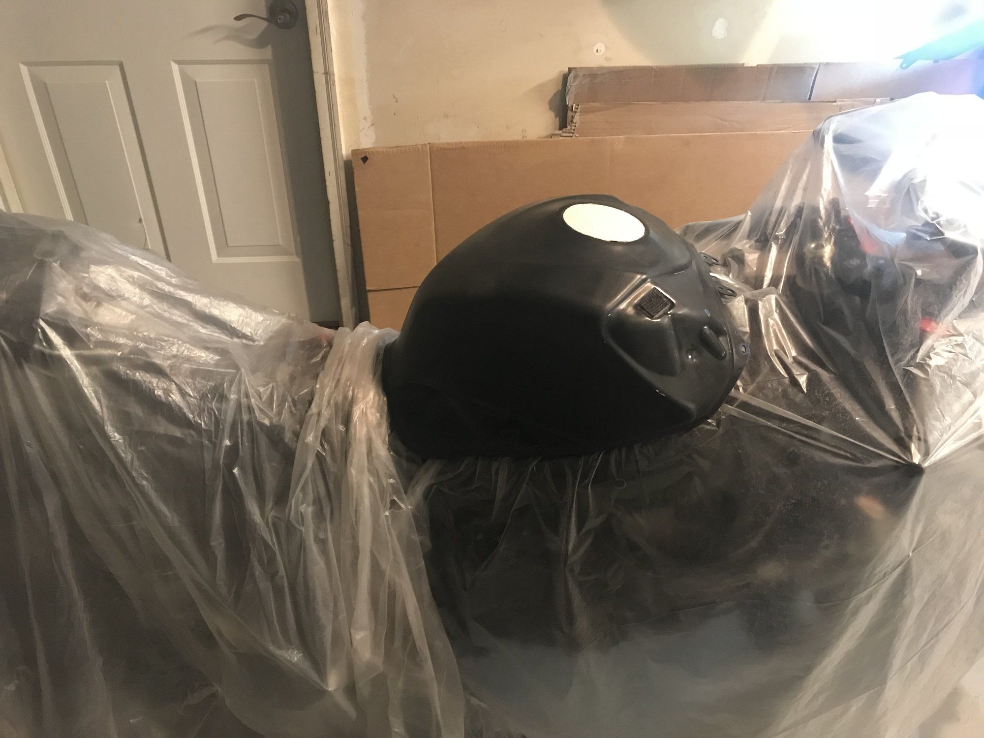

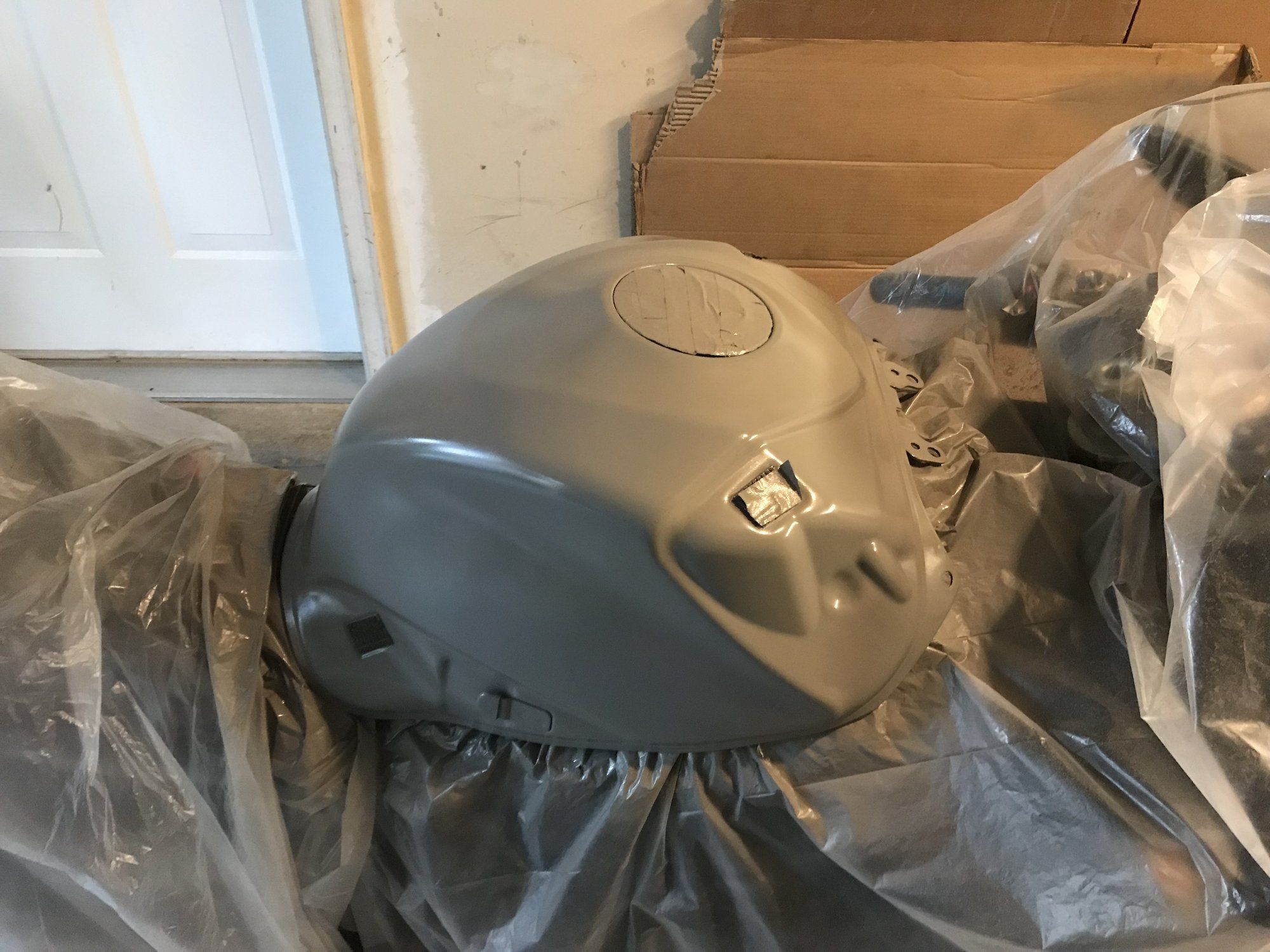

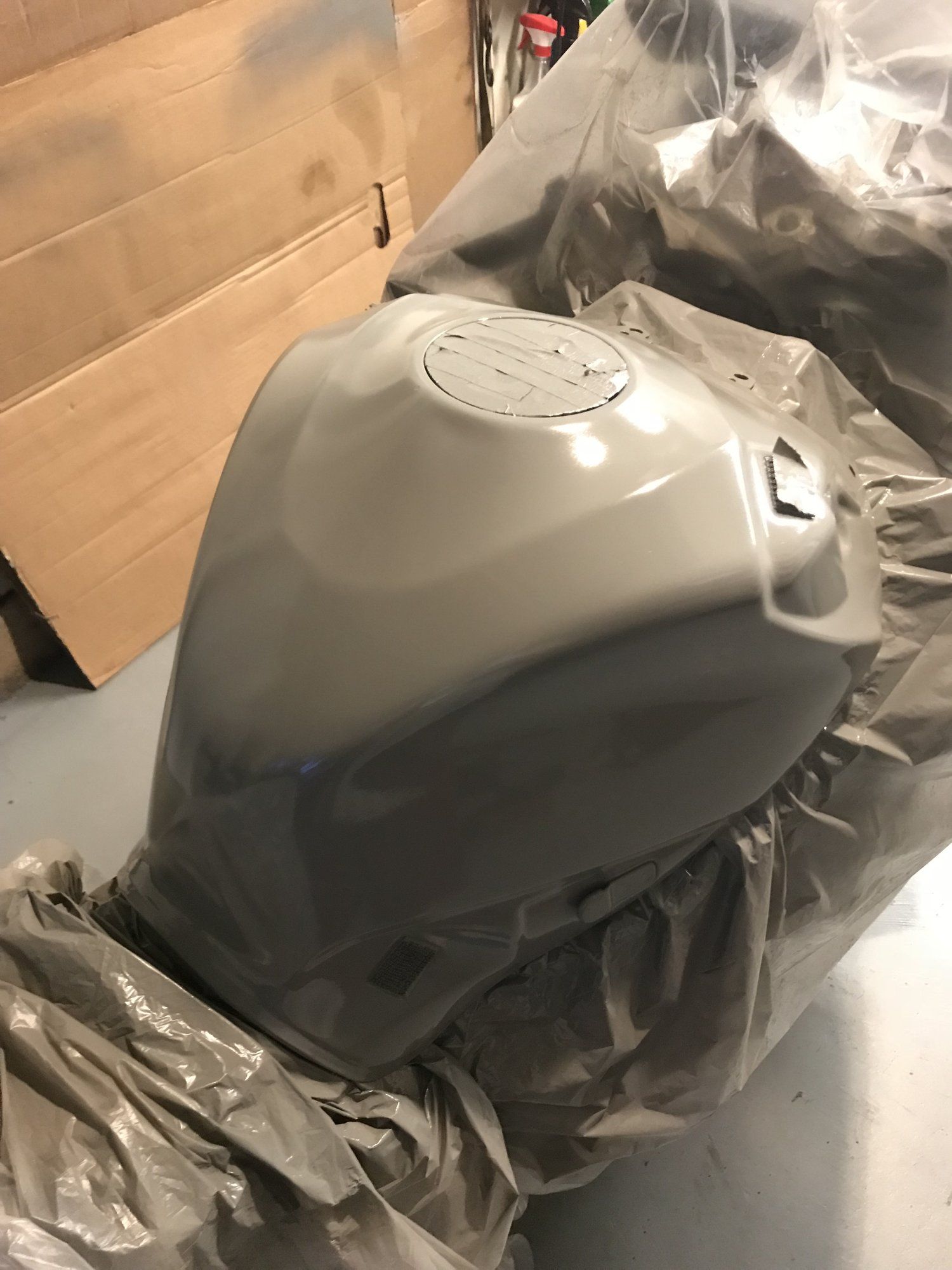

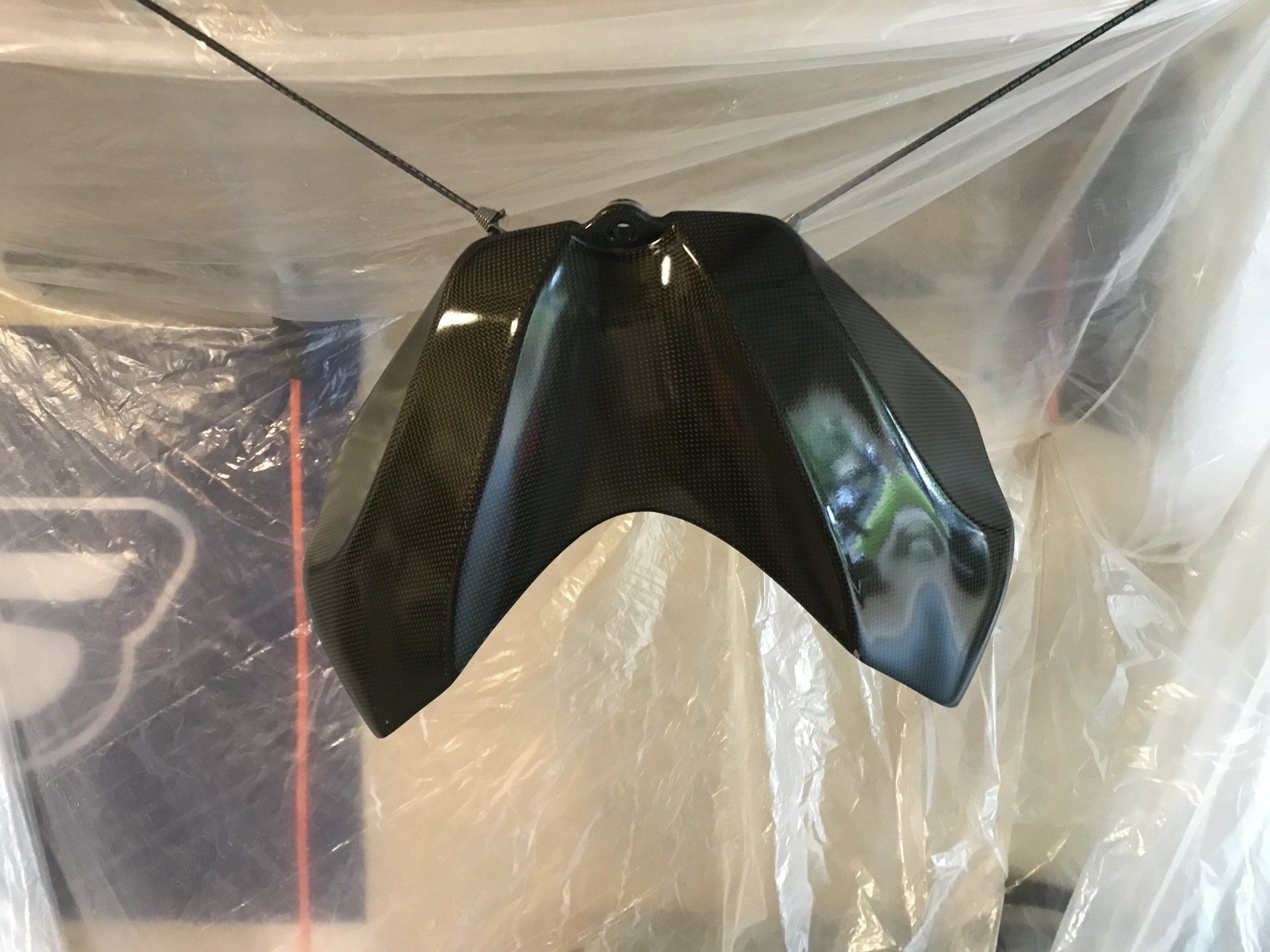

Starting on the tank. I am going to go heavy on the clear coat and then wet sand and buff. Not terrible for a rattle can job.

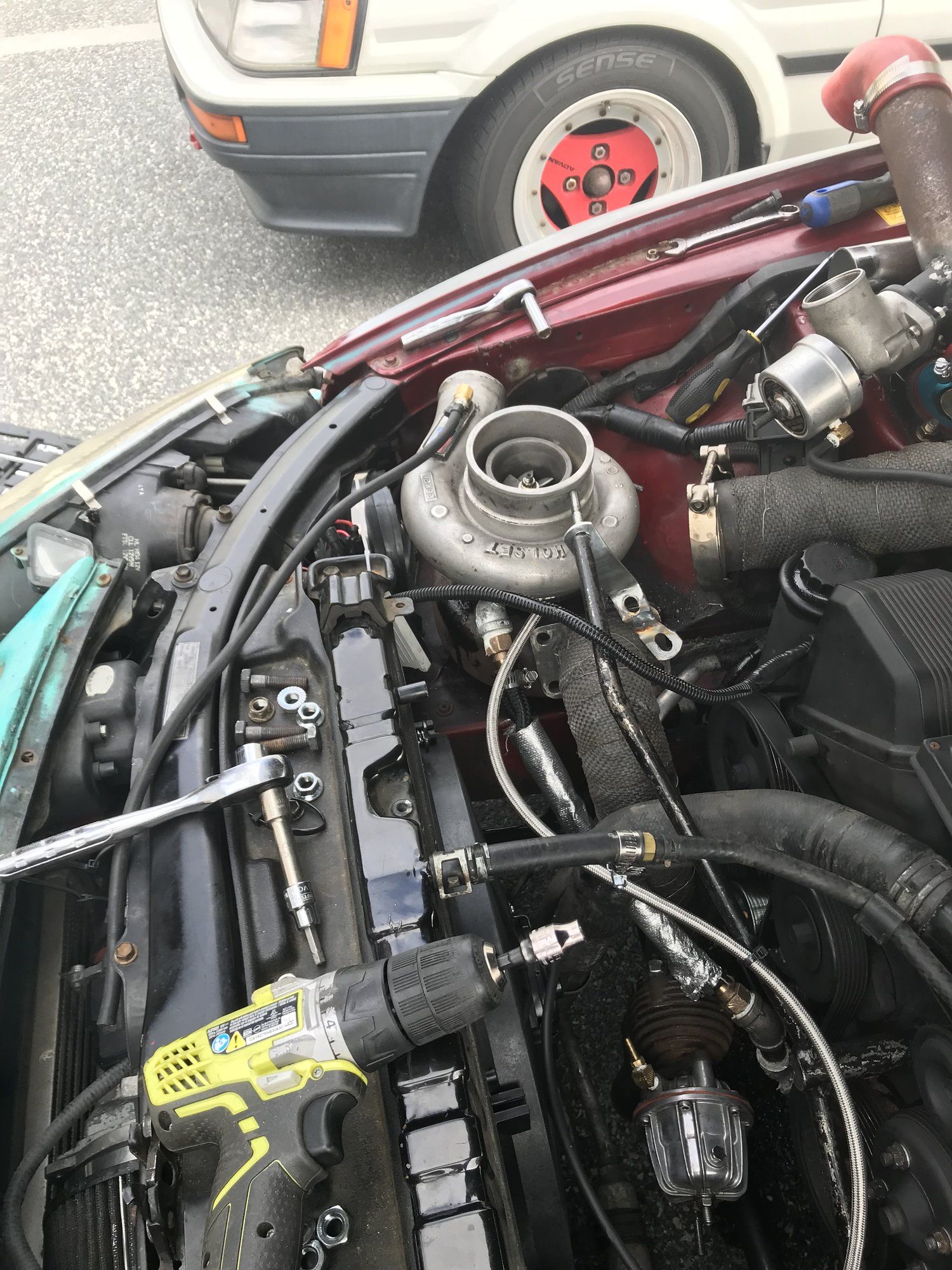

On Saturday, I went to work on the GSX with a goal of accomplishing two things. 1)Replacing my turbo return line to address a leak I have had for a while. 2) And replace the engine harness pig tail for the knock sensor. The Return line was straight forward, its a nice kit from extremepsi. And the new pig tail wired in fixed my knock sensor issues, big thanks to OHM Racing.
Took the car out boosting, no lights or issues. :thumb:

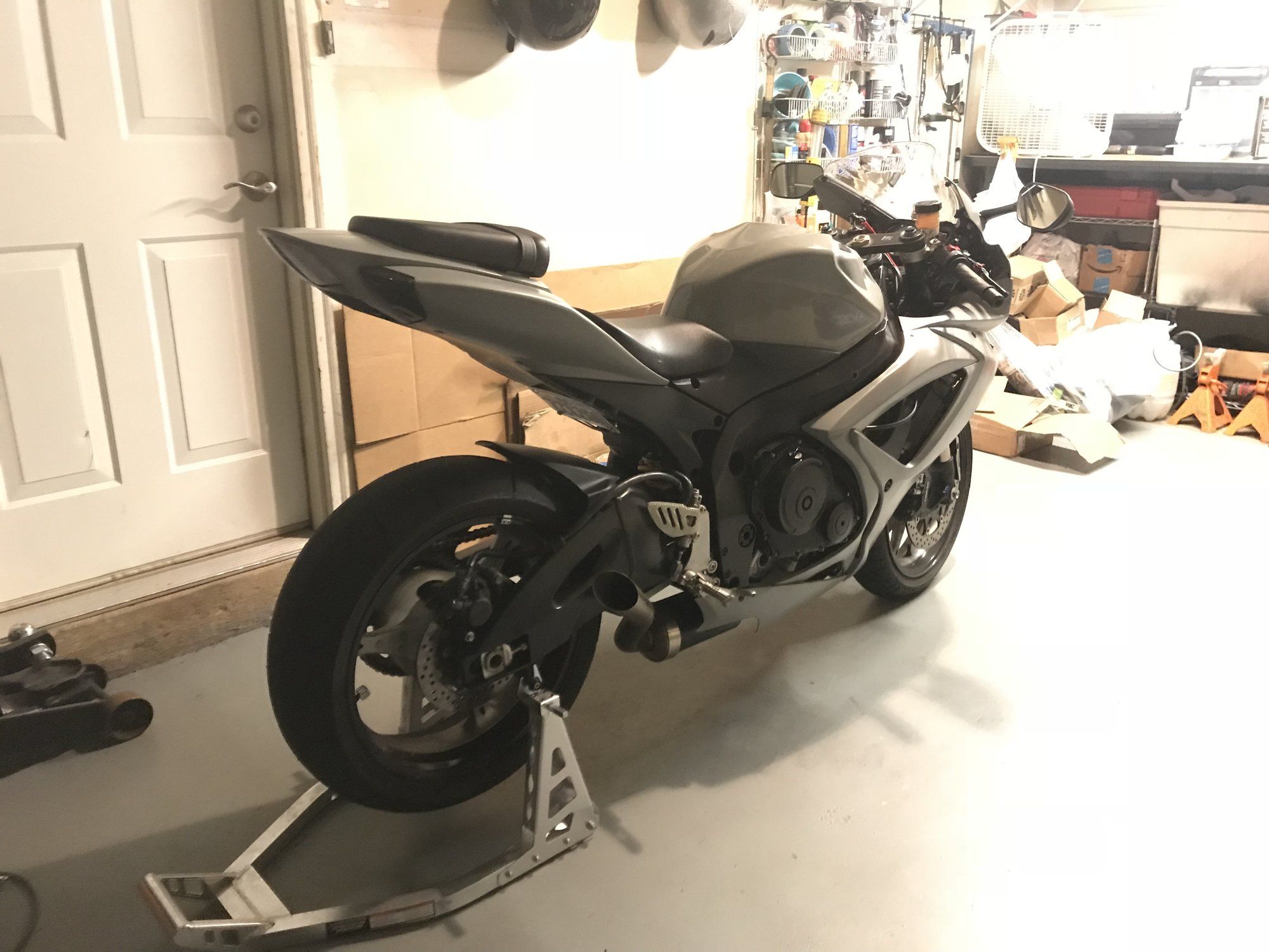

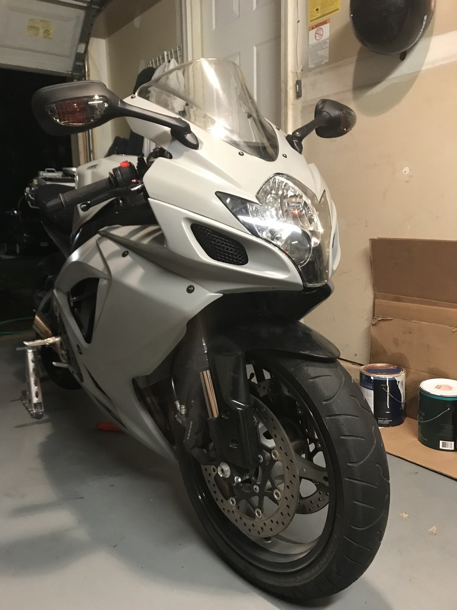

It was a very productive weekend for both the GSXR 750 and the GSX.

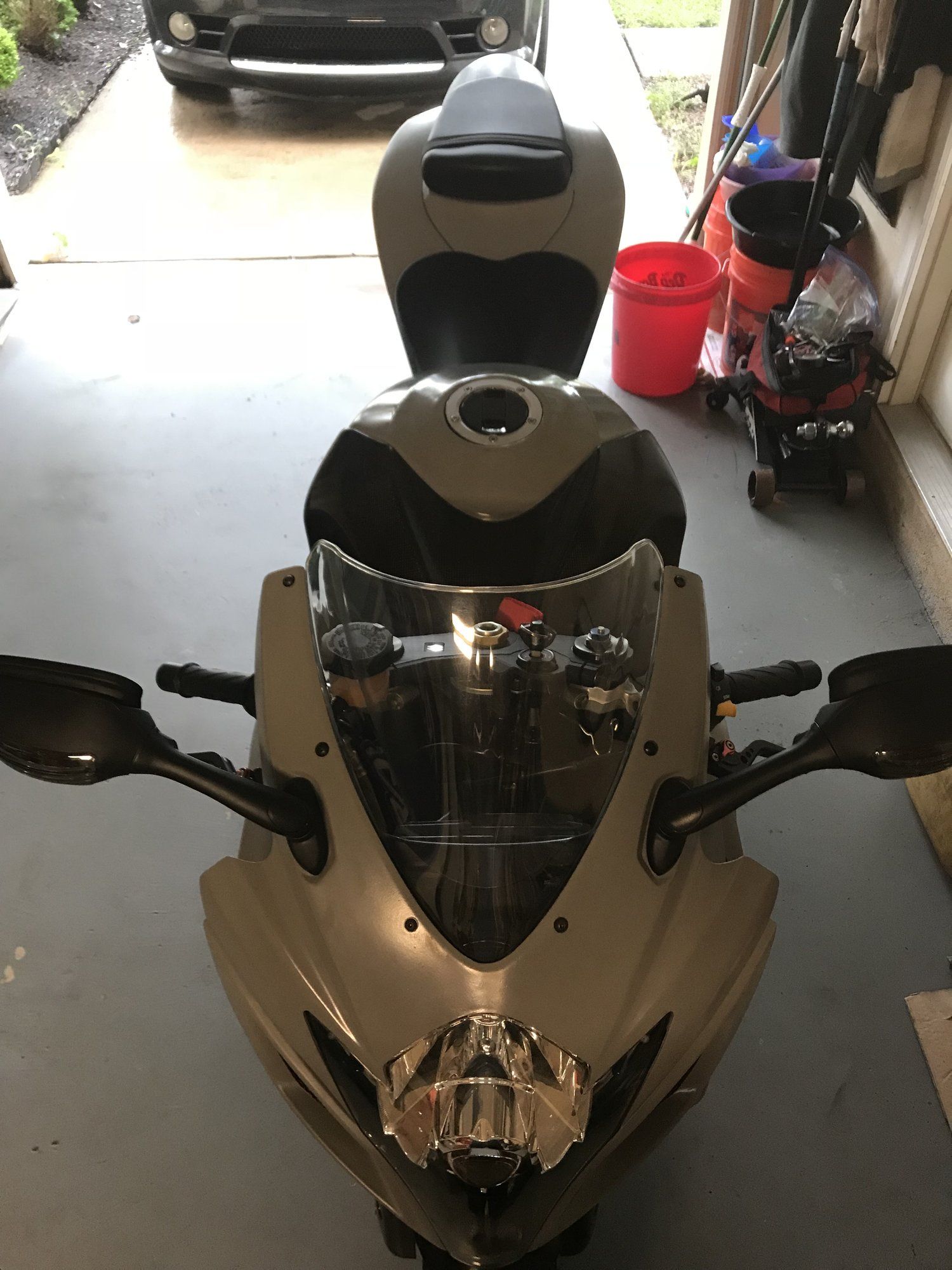

I finally finished the paint work on the GSXR, and got it fired up. Looking forward to getting a couple more rides in this fall.

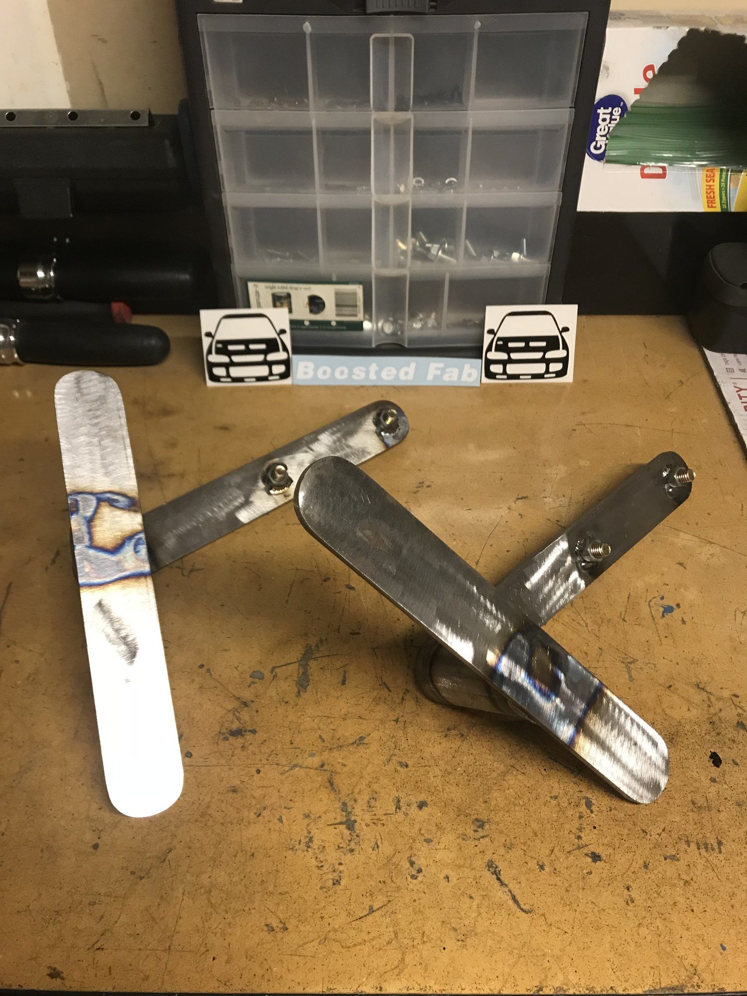

Also got my Bumper Support Mounts in from Boosted Fab. Great guy, I highly recommend you go check out his products.

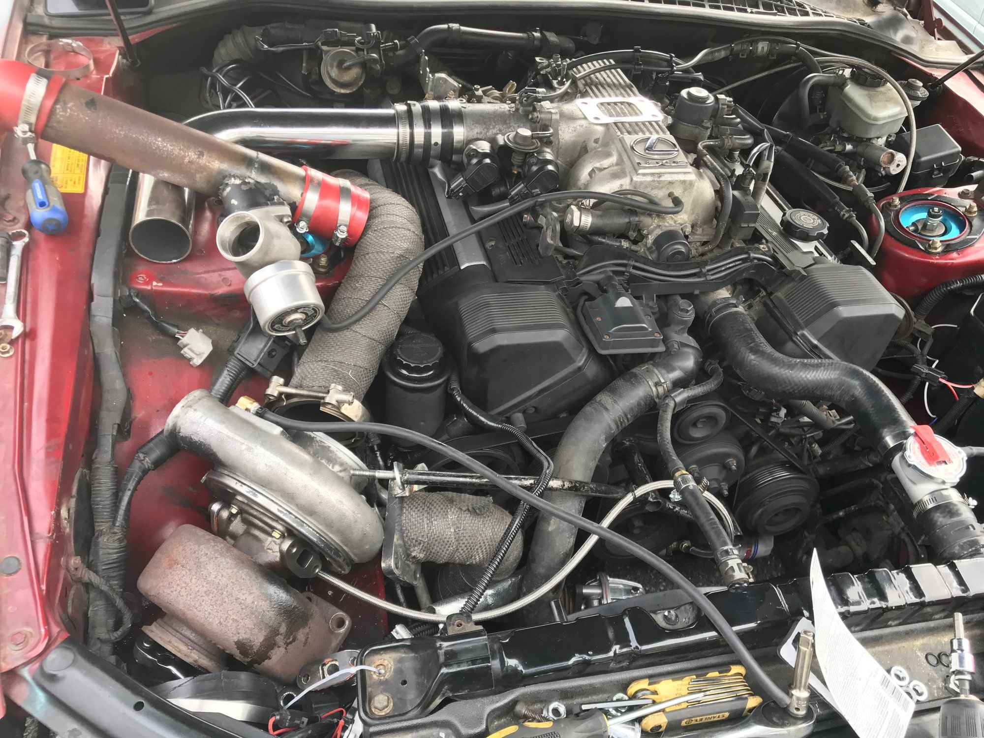

Friday, we decided to work on the SC400 as it was leaking at the turbo and Pws steering area. The turbo kit install was rushed so he was dealing with the aftermath of small mistakes. My buddy has owned this Lexus for a while now, but it was basically sitting un touched for about a year. In three days he got a turbo kit slapped on, running, and drove it to H20. Dude has balls, but thats Toyota reliability for ya. Pushing 8psi stock block. The 1UZ V8 engine sounds awesome with a turbo.

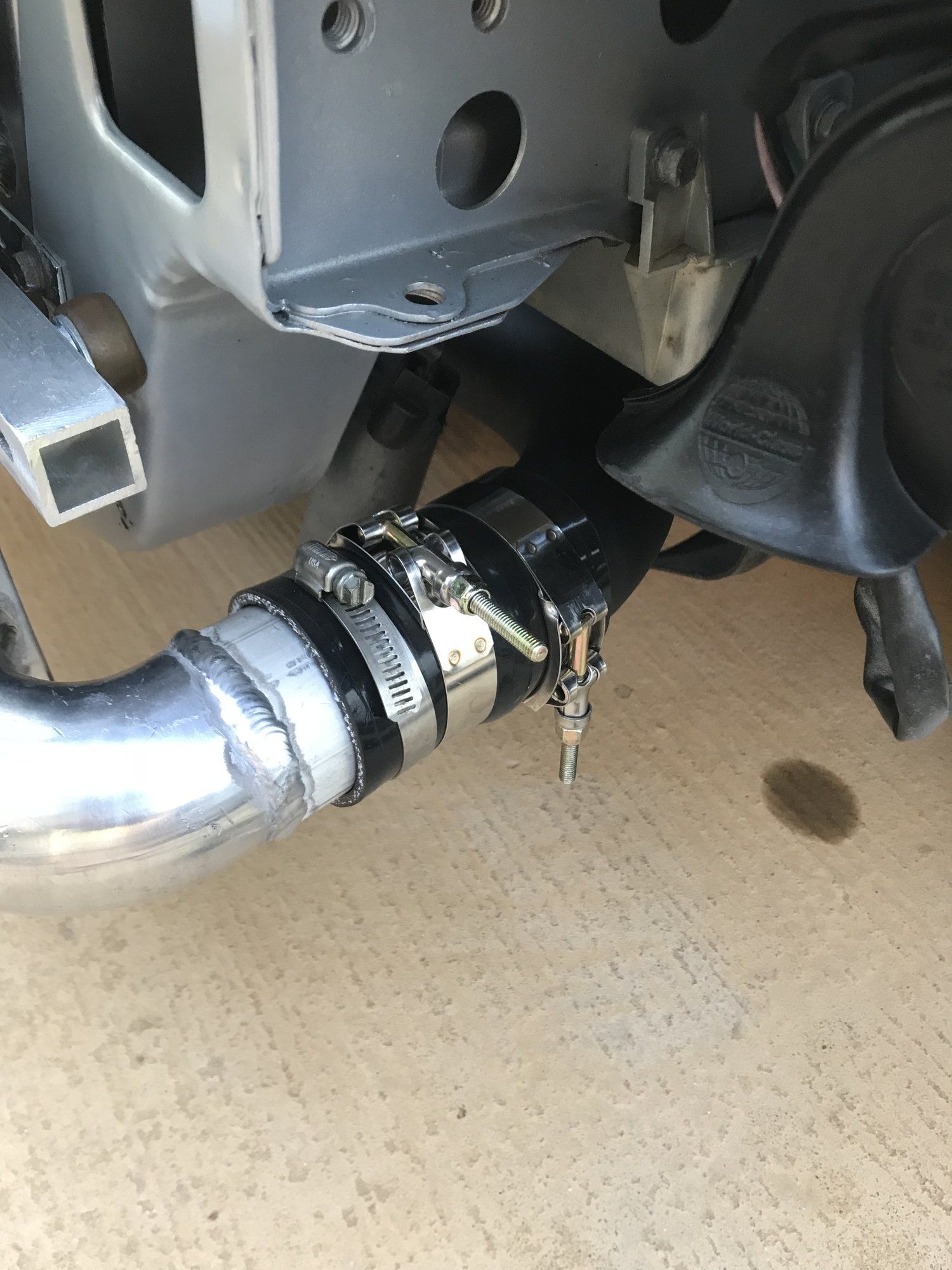

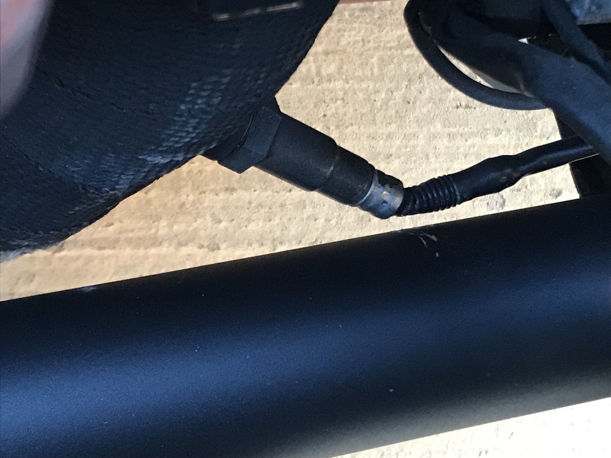

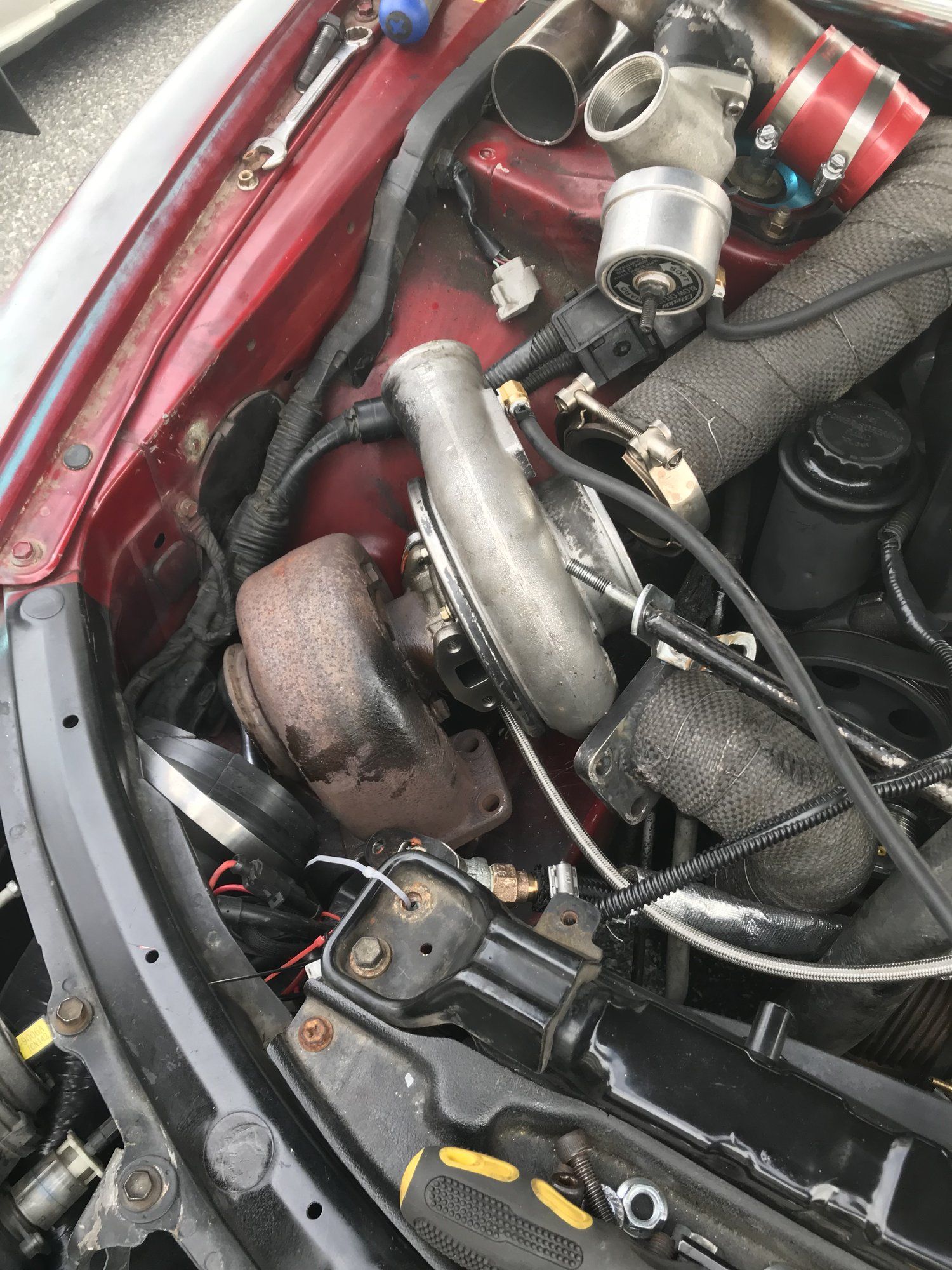

Got a check engine light for 02 sensor malfunction. My lower IC pipe is still touching it from time to time. I will need to do some trimming soon.

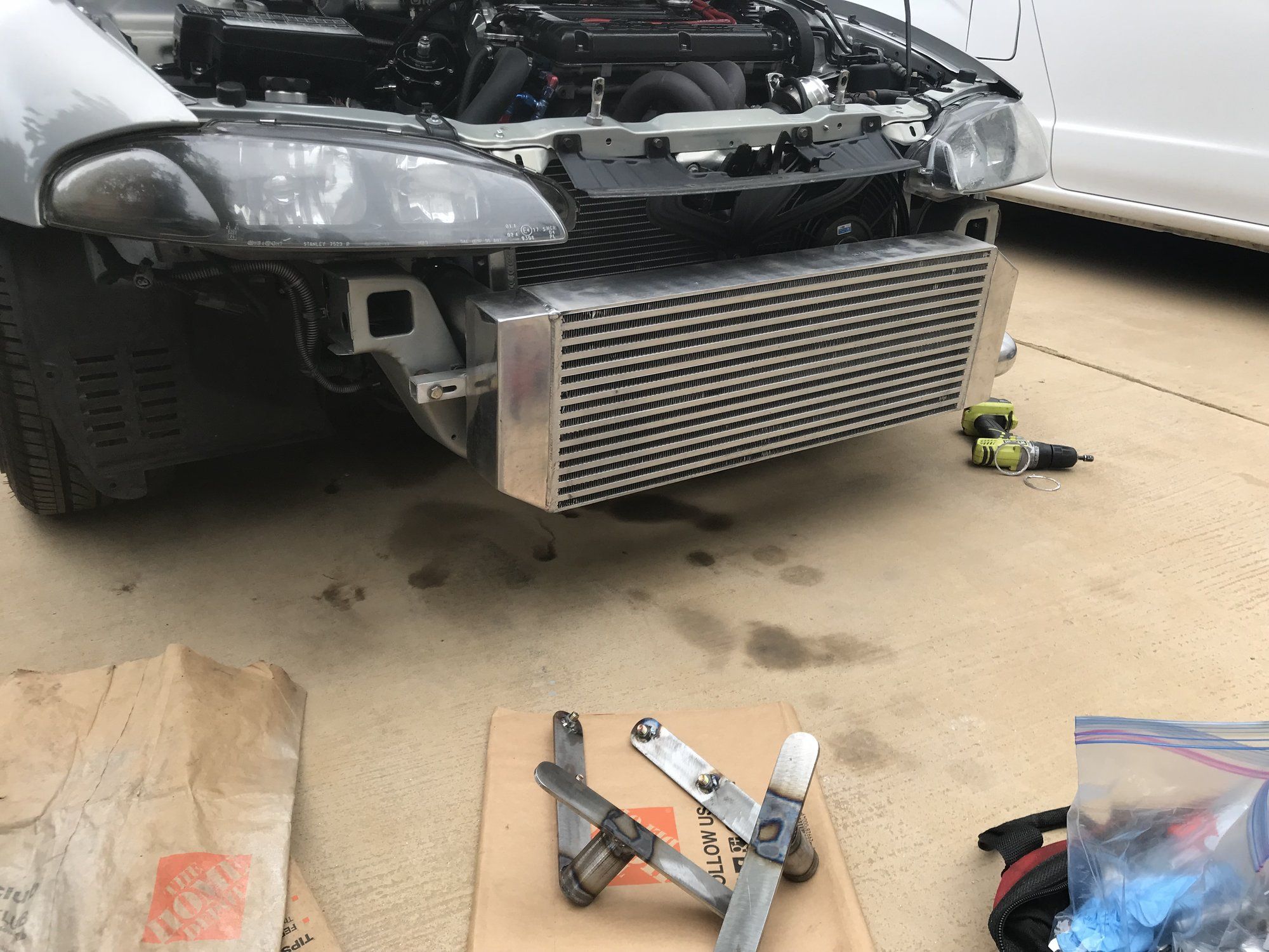

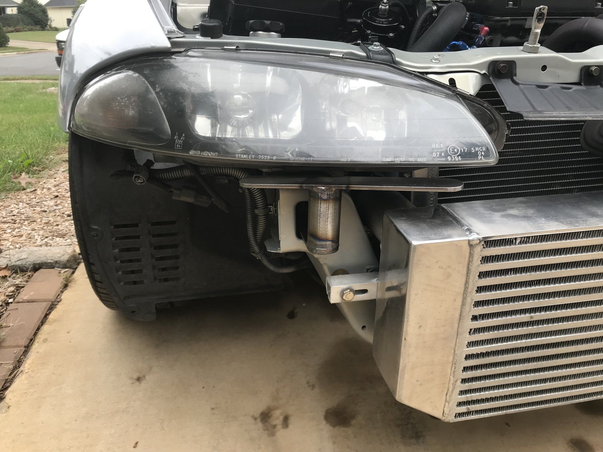

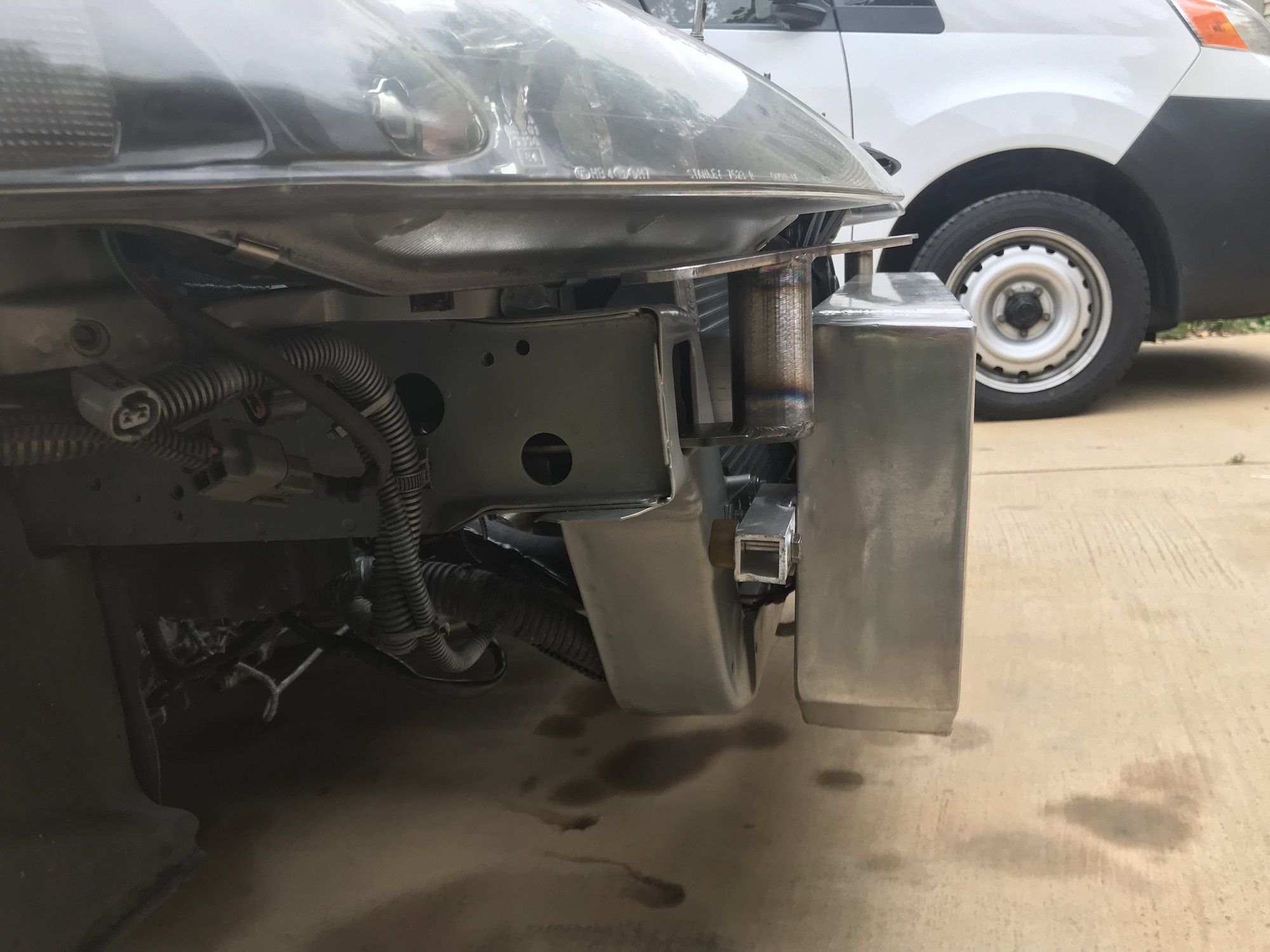

Boosted Fab Bumper Bracket install & Fixing Lower IC pipe clearance.

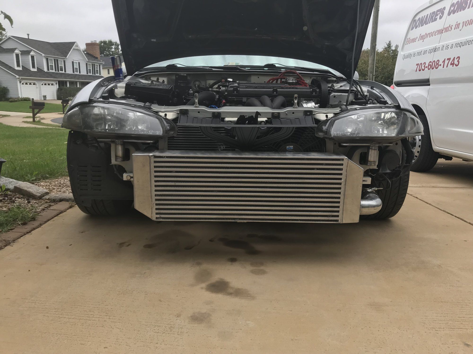

Another awesome and fairly priced product from Boosted Fab! These brackets help to support the front bumper when you remove your front crash bar when going to a bigger FMIC kit. They are adjustable to help pull in the gap you may have between your head lights and bumper. They included bolts and bolt into your frame rails.

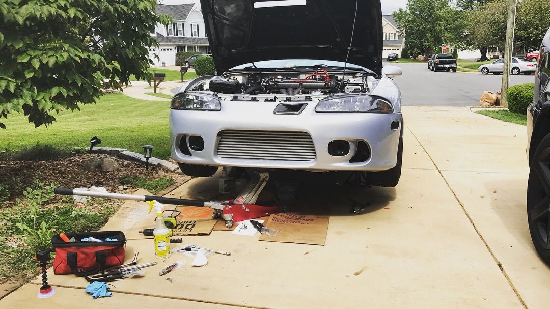

I was still having rubbing issues between my lower fmic pipe and 02 sensor. My angle grinder and sawzall made for a every quick fix.
Here is how much material I cut off the FMIC outlet.
Tons of room now.
